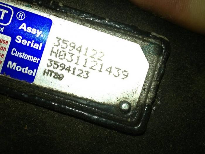

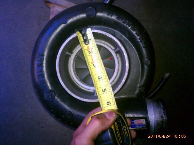

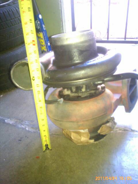

Since you guys seam to be very knowledgeable about holset turbos can anyone tell and I figure already I won't be able to use it but maybe I can trade it for an awesome set up I have an HT80 in great condition it spins freely with no shaft play at all
