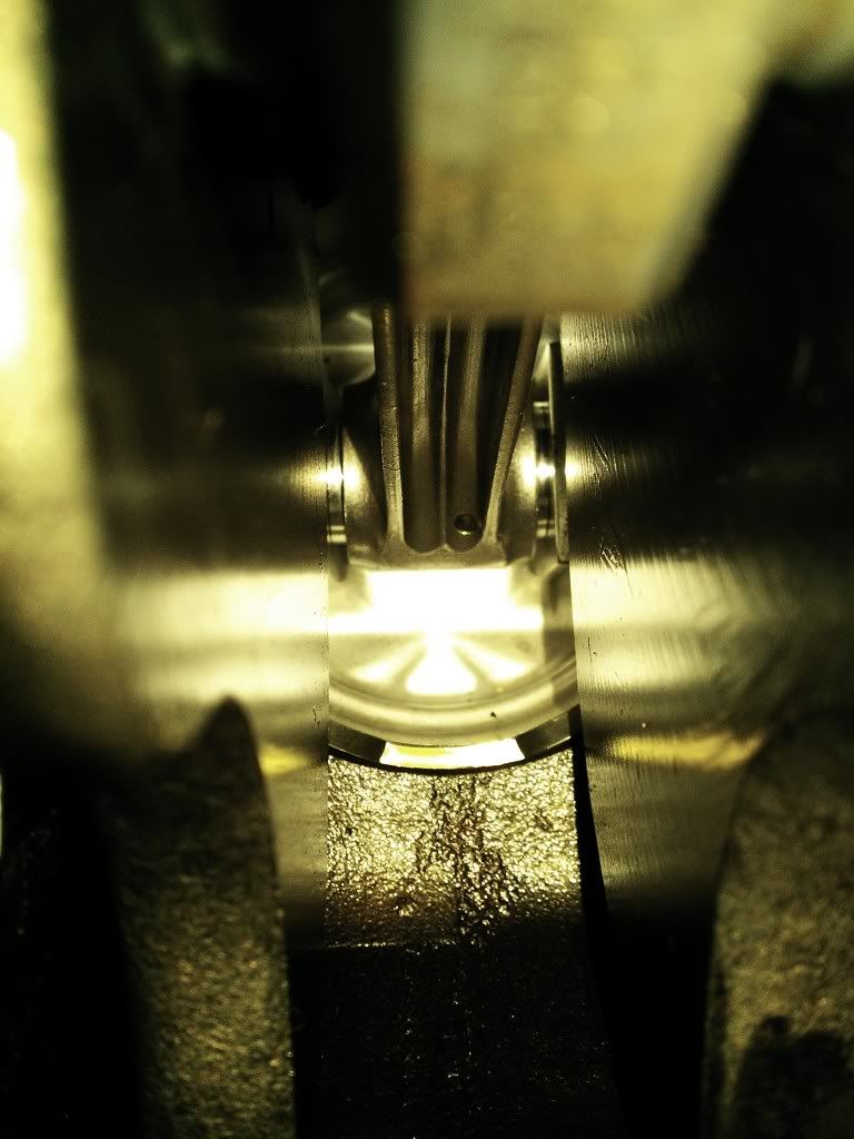

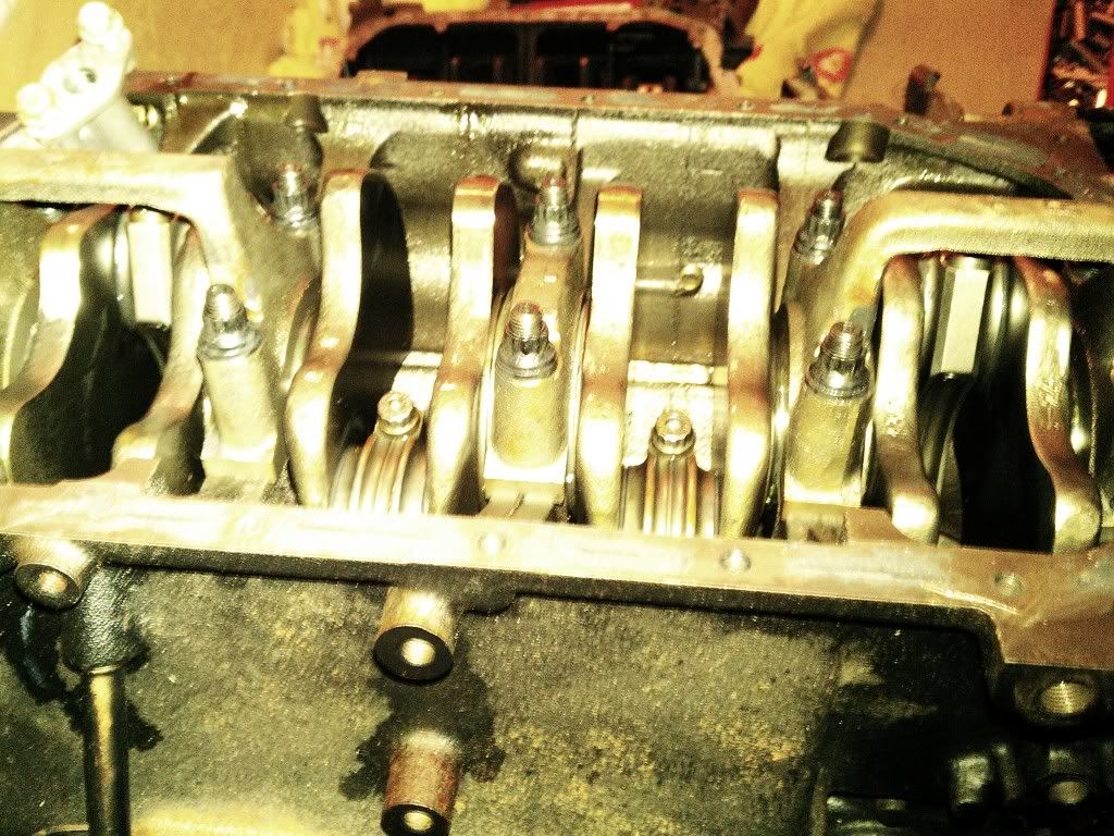

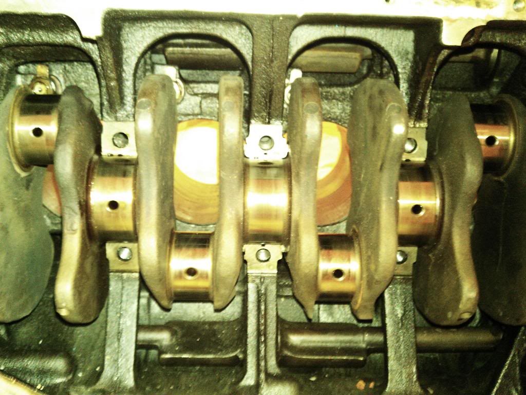

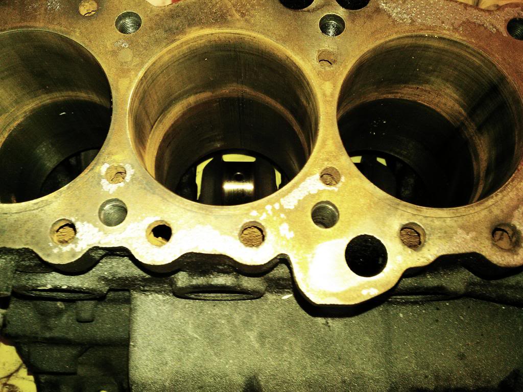

11/30 - I was looking for a new bare block to start my build.. well I found one and It happened to be a pretty sweet deal as far as I can tell. A local craigslist ad showed someone selling a full 4g63 longblock for $250 but they were uncertain of if it worked or not. The deal included the block, head, cams, adjustable cam gears, valve cover, alternator (not sure if works), power steering pump (not sure if works), and the intake manifold. Note that the head/intake manifold were from a 2g but it was in fact a 6 bolt block. In the end, I got the whole thing for $150.
After disassembling the new motor trying to figure out what was wrong with it I discovered nothing wrong at all, as a matter of fact there wasn't even any carbon build up on the pistons, it looked like it had never been fired up. The head looked pretty new as well. Probably one of the best finds I've ever had (ill post pictures in about an hour from now, im at work).

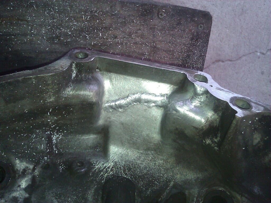

11/31 - pulling the trans to reweld the case, as well as create the bracket for the mount piece where the ear fell off (I honestly don't expect it to last, but only need to to last for maybe 30 days of nice weekend driving).
I dont have a before picture of the crack in the trans :ohdamn:

The block I picked up for $150. Ill be sending it to the machine shop to get it honed, cleaned and pressure tested.
The pistons that came out of the block. Look like they've had a little residue build up (like its been sitting for a long time)

The crack that this trans suffered from was due to the previous owner (btw the oil is so black its not even funny, definitely changing) somehow installing the trans wrong and by some sort of demon magic cracking the ear off of the engine block. The ear towards the front of the car (it has a dowlpin on it which goes/bolts into the trans), so the trans was only held on by three bolts with a maniac doing AWD launches.

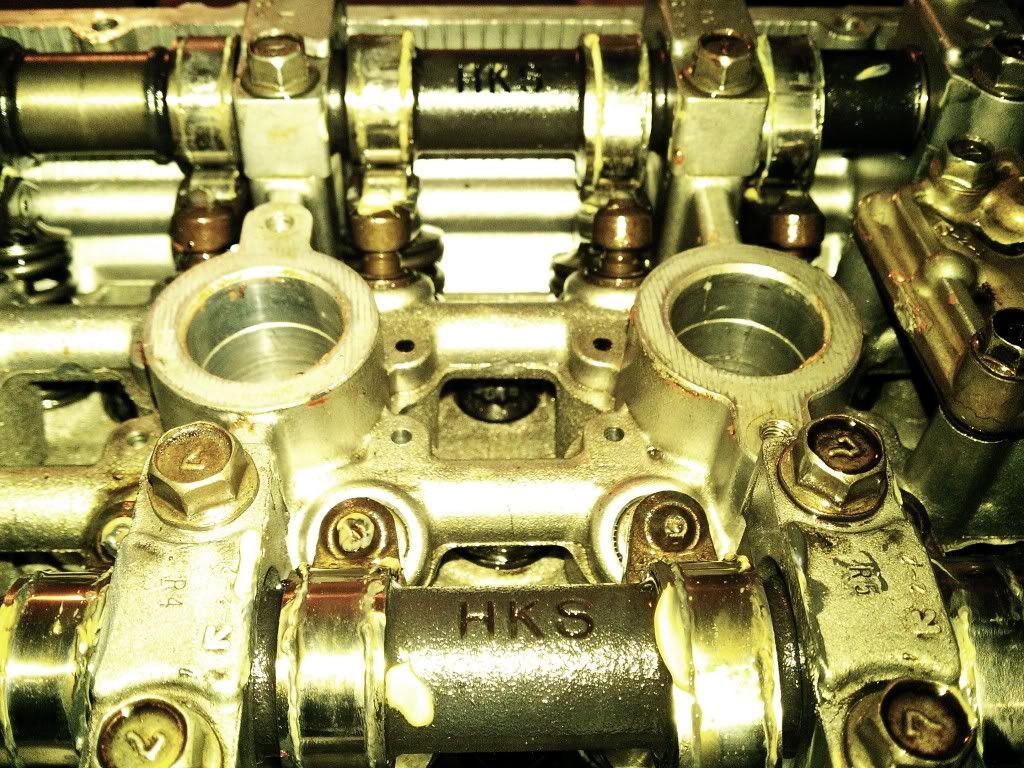

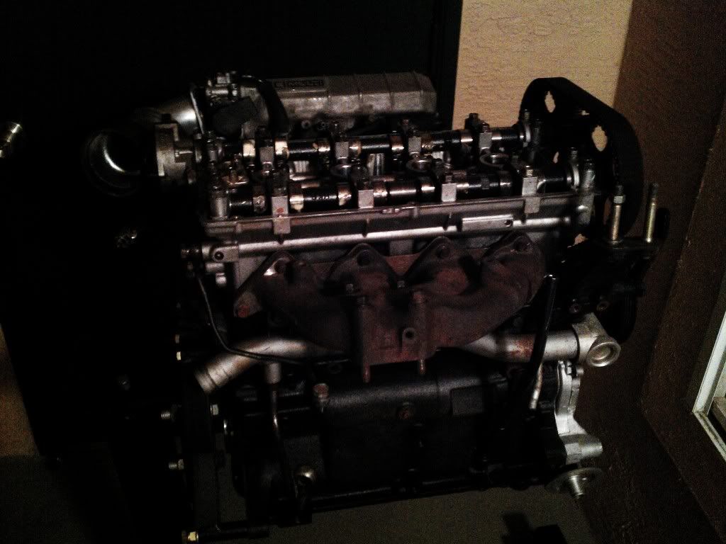

So.. I was able to get my hands on a built 2.3L stroker long-block with eagle rods and wiesco pistons, ported head, and hks 264 cams. This engine is pretty much new and hasn't been run. The deal on the engine also came with a 93 AWD Talon roller for $1000. I was able to sell the roller for $750 making my overall cost for the engine $250.
Off to a great start so far, not bad for $250. Next I need to run through the engine to make sure everything was installed properly, sell the hks 264 cams and get some hks 272 cams + adjustable cam gears. After that has been done I can order a jmf top mount manifold.
