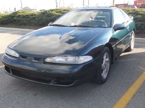

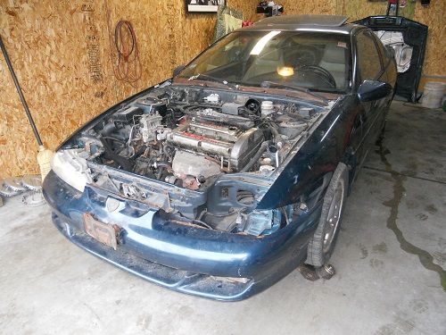

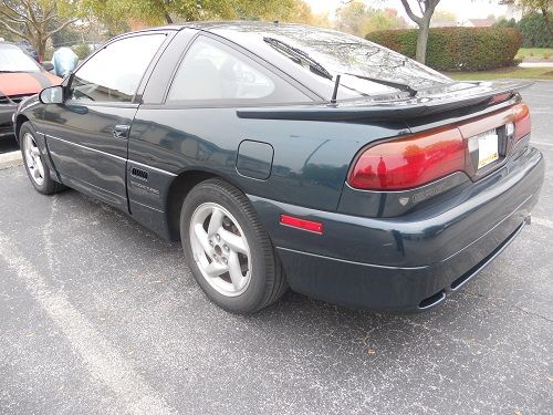

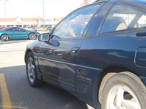

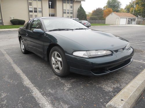

On May 26th I picked up my third DSM so here's to hoping third time is the charm. It's a 93 Talon TSI AWD Auto with 63,xxx original miles, forest green with tan leather interior. Seller was asking $1000, I offered $700 if he helped me push it into the trailer. A little dirty inside but the seats feel so good to sit in. They would have to for only 63k in the past 20 years... Trans apparently took awhile to find second and when it did it engaged pretty rough. I'm guessing wrong fluid or low fluid in it but plan to do a shift kit and clutch pack anyway. Motor is unknown because I think the owners started taking it apart in order to get to the trans.
Needs exhaust, brakes all around including calipers, shocks, tires, radiator, fans, ecu, trans work, plus all the misc stuff. I figure around $2k should get it where I want it for daily use. Or I could butcher my Laser and only be out money for new front calipers and auto trans parts, tough decision...

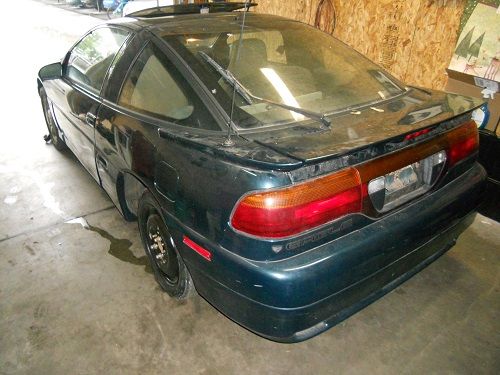

So right now the car needs an exhaust, radiator, fans, calipers, rotors and pads, tires, ecu, struts, hatch struts, cas, and motor is unknown. It is a 63k mile 7 bolt motor that apparently ran when the previous owner bought it but was taken apart too far when I got it to be able to verify. Turns over great by hand though. Most if not all of this stuff I had to get when I rebuilt my Laser RS so I might just rape that car to finish this one.

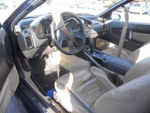

Did a full ArmorAll of interior panels, full vacuum, reassembled rear trunk area with privacy covers and all, replaced rear tail light, and windexed down the glass. Starting to look like a car again.
Took about 2 and a half hours but I got all the interior carpet and fabric panels out and carpet cleaned them with a unit I rented from Kroger. Just gotta wait for them to dry before they go back in but I hope at least the smell is better. Not much of the stains came up so I might have to replace the carpet anyway in the future.

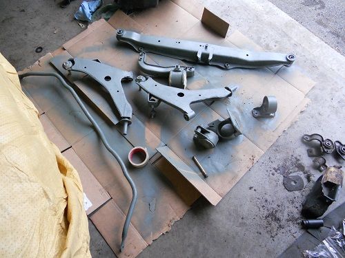

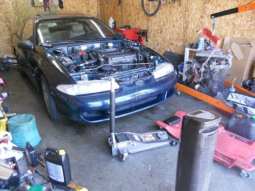

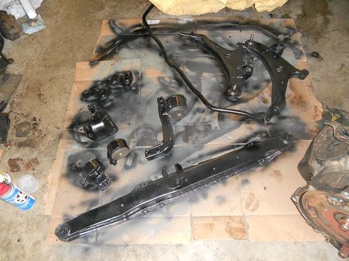

Chassis work has already begun on the front end with motor mounts, full bushing kit, Moog ball joints, Timken bearings, new outer tie rod ends.

Made a big order for the car today: Prothane Motor Mounts, Energy Suspension front control arm kit, front subframe bushings, front subframe to sway bar bushings, and Moog lower ball joints. The other day I picked up Wearever Platinum front pads, should really help hold me when brake boosting, and front Wearever rotors. Also picked up a new fuel filter to replace the oem from 1993!

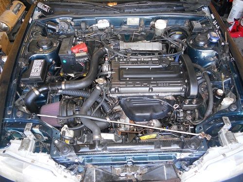

Well the good thing is I have about 500 miles on this car. Things have going pretty good. After I got the car physically put together, the ecu I had wasn't cooperating with the tcu. I was stuck in gear and had issues with giving it any gas. So I had no choice and ordered Link V3.
With the car running now I was still having a rough idle that plagued me from my old car. Changed the maf comp settings a little bit and added a new throttle body gasket. Things still weren't quite right when accelerating and I had never checked cas timing even from 1500 miles ago when this 6 bolt was in the Laser. Timing checked out at 10-11 btdc. I dialed that back in and am much happier with the throttle response.
Car was leaking trans fluid on the passenger side over and over even after new seals. Found out I was only putting the shaft all but an 1/8 of an inch from fully in.

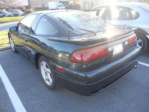

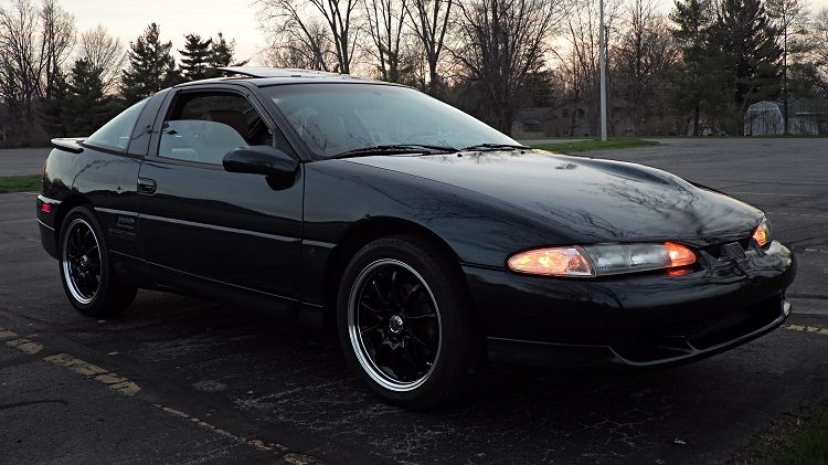

Here are some pictures from our local monthly DSM meet. Tried my first hand at washing, claying, and finally wax by hand.
Austin this thing looks great. One of the cleanest I've seen in a while. As for the dude who was worried about warping cylinders on a 2.3 I guess u must have it backwards. 2.4's have been know to crack cylinders not 2.3's. Keep working on this thing man. and keep it clean my young prodigy!. Lol. All you need now is a nice front mount, turbo and trans work and you'll be haulin in no time. wish I was still up there.
