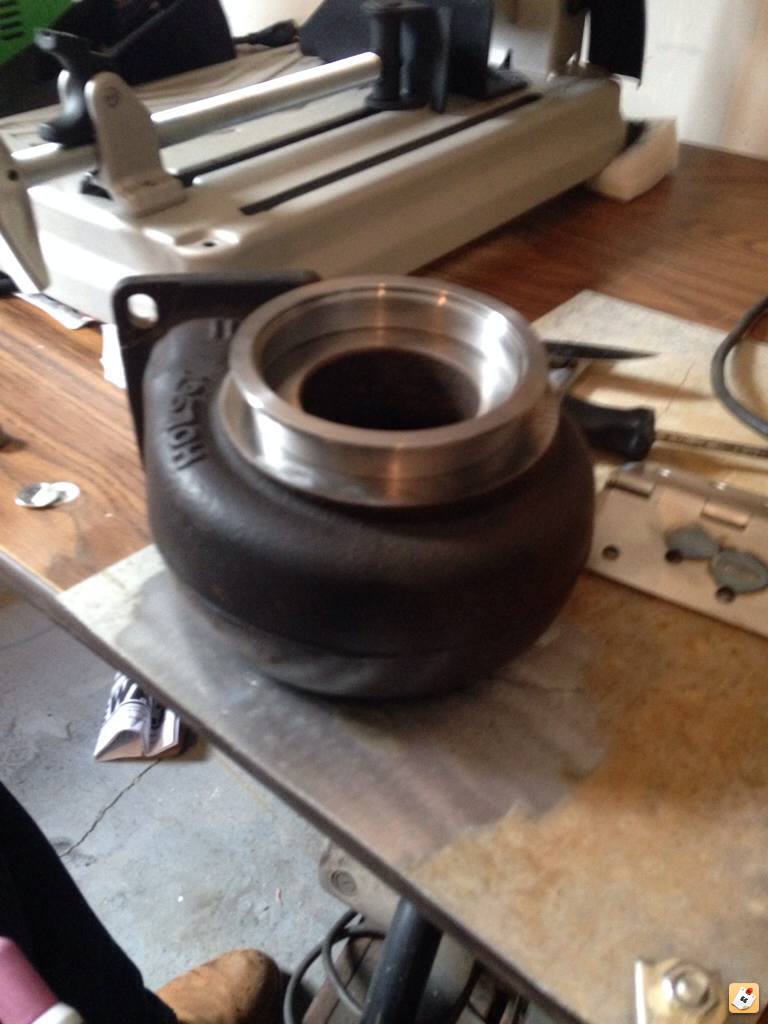

I noticed that the vband flange on the turbo was actually 4.75 and there was no way I was going to clear the alternator.
So I milled the vband off of the exhaust housing.

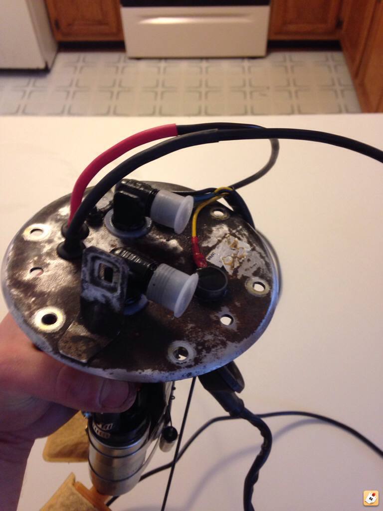

Next was the fuel system. I purchased 2 Walboro 255's and made my own double pumper setup.
I then installed a 8an feed to the rail with a 6an return.

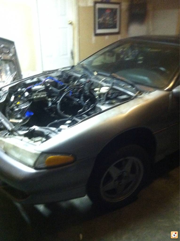

As of yesterday I took the car down to JSF (Joe Styles Fabrication) to my very good friend Mike McLaughlin. As of now we are work on a full 4" turbo back exhaust for the HX52 project. Last night we finished tacking up the downpipe and it is looking a fitting great. I did realize that no matter what I was going to have to relocate my alternator so I ordered the Jay Racing alternator kit. Here are some pictures from yesterday.

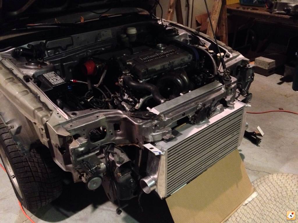

I picked up a XS power Evo front mount intercooler for free. I was thinking about using this on my setup since it was free and all.
So I'm thinking about welding 3" outlets to it and see what happens.
What do you guys think? You think I will be restricting airflow or do you think that intercooler will be able to handle the airflow? The website says 1200cfm. After all it was free and all
I've never run one of those intercoolers, but from what I hear they are not efficient, I use etss with my fp green, more people will swear my ets too they make a great fmic, but does cost a bit.

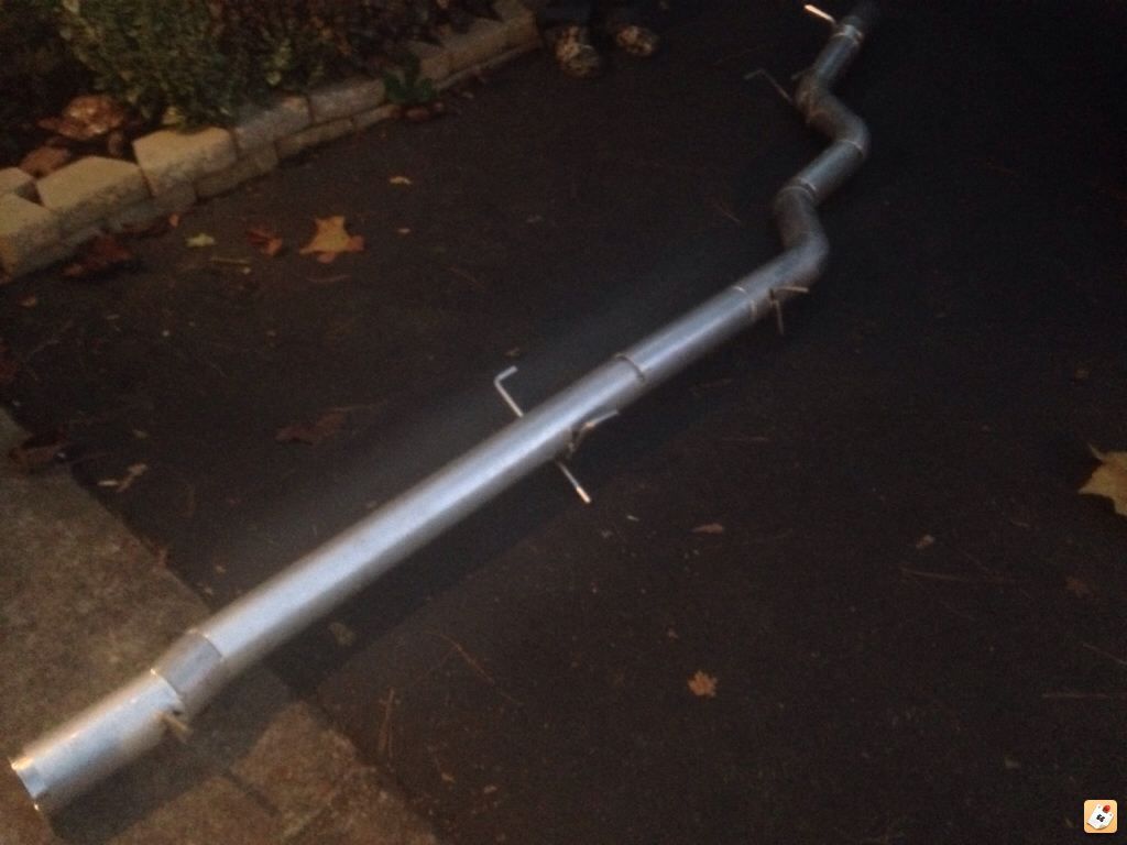

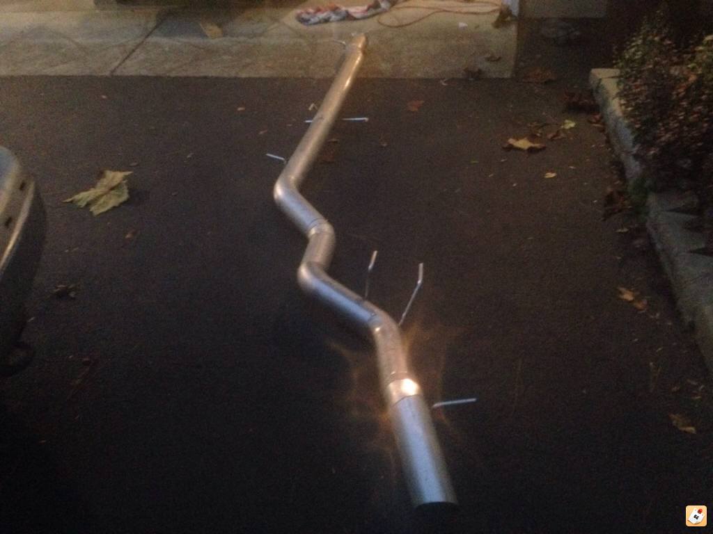

New update. I got my 4" aluminum exhaust done and I must say I am very happy on the way it turned out. Very clean and a lot of clearance, well more than expected.
Sorry for the pics it was getting dark. I'll take some more later

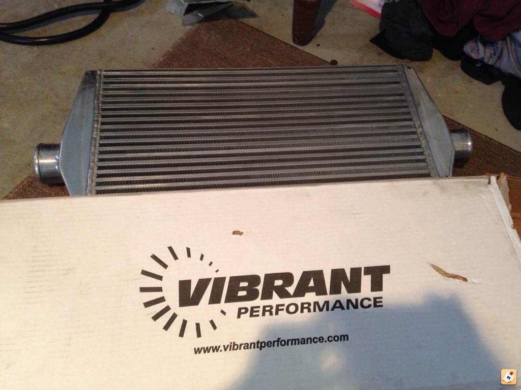

I also decided to switch out on using the eBay fmic idea so I picked up a vibrant intercooler. Got a very good deal on it brand new. I got it mounted and now I'm working on routing the 3" piping.

Who made the exh system for you. and do you have an idea on the weight.
I made the exhaust system. I'm not exactly sure on total weight but I can say that it is light as a feather.
