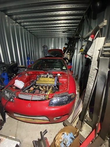

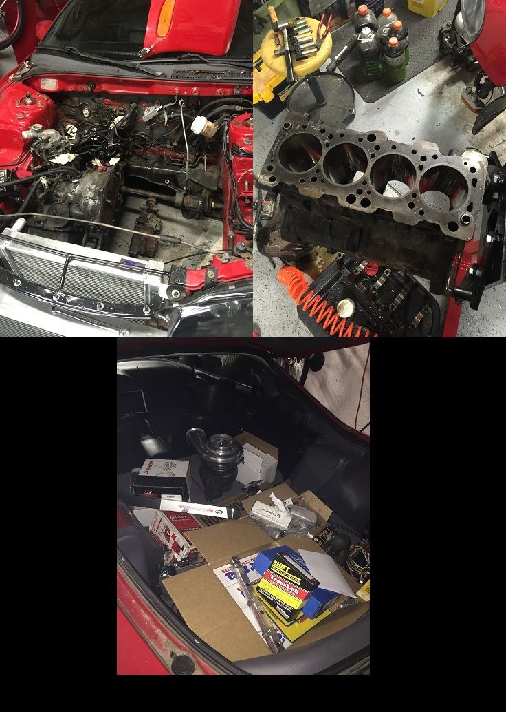

well i have everything i need to get the flash running!!!! ive been hustling on getting it running this week!!!!!
what i have done since my last post
-i hooked up fuel system with a bunch of an fittings
-i did the shift kit in the valve body-still need to put in trans
-got my driver side metal motor mount in innovate- im using steel rather then aluminum so i can weld a bracket to it for my mechanical fuel pump later
-i bought a cheap battery
-installed timing belt and did the timing
-installed kiggly oil pressure regulator in the head
-primed oil system- used a drill on the oil pump to flow oil through the motor, did this before installing the timing belt
-installed stock 450cc injectors
ill make a video update tomorrow after i get off of work
things left to do
-install knock sensor
-install exhaust manifold
-install intake manifold
-plug back in my engine harness
-plug in ecu with dsm link v3 full
-install throttle body
-install speed density sensors
-install o2 sensor
-install iacv
-add coolant
and maybe ready to start!!!!

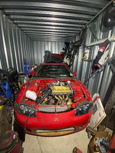

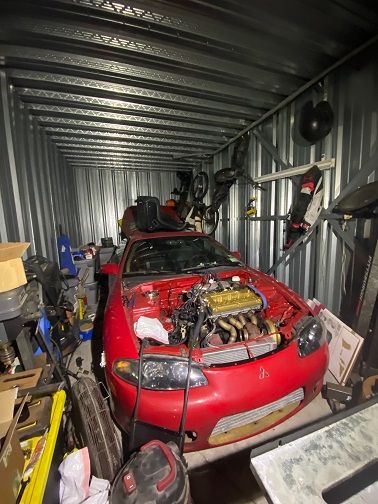

did a few things since the last video!!!

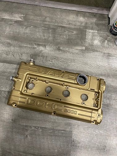

- welded -10an fittings to valve cover

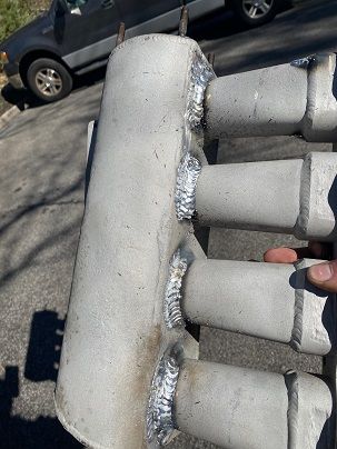

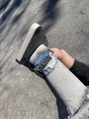

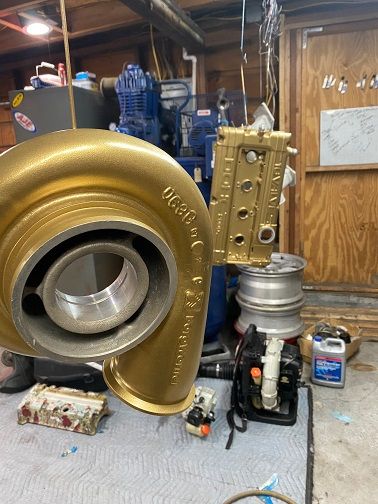

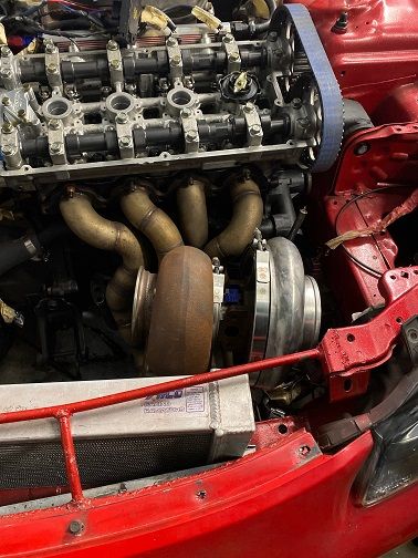

- bought used top mount t4 manifold and turned flange to fit my big a*s turbo

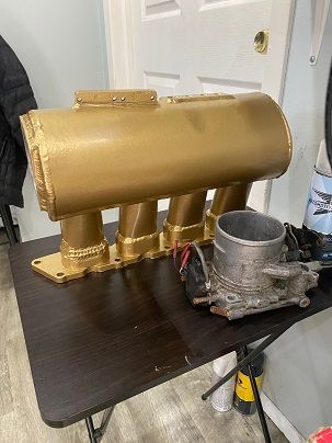

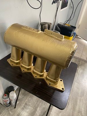

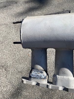

- bought venom intake manifold (still working on cracks and powder coating)
- powder coated valve cover and turbo snail!
Side exit exhaust?
yes sir LOL its going to be a 4inch exhaust pip coming out of the passenger side front bumper. i still have a few thing to mount and mock up before the pipe can be made and put on. i have to install my engine cross brace underneath, and make a mount for the rad, basically i have to put on a few things still before the pip can be put on. :D

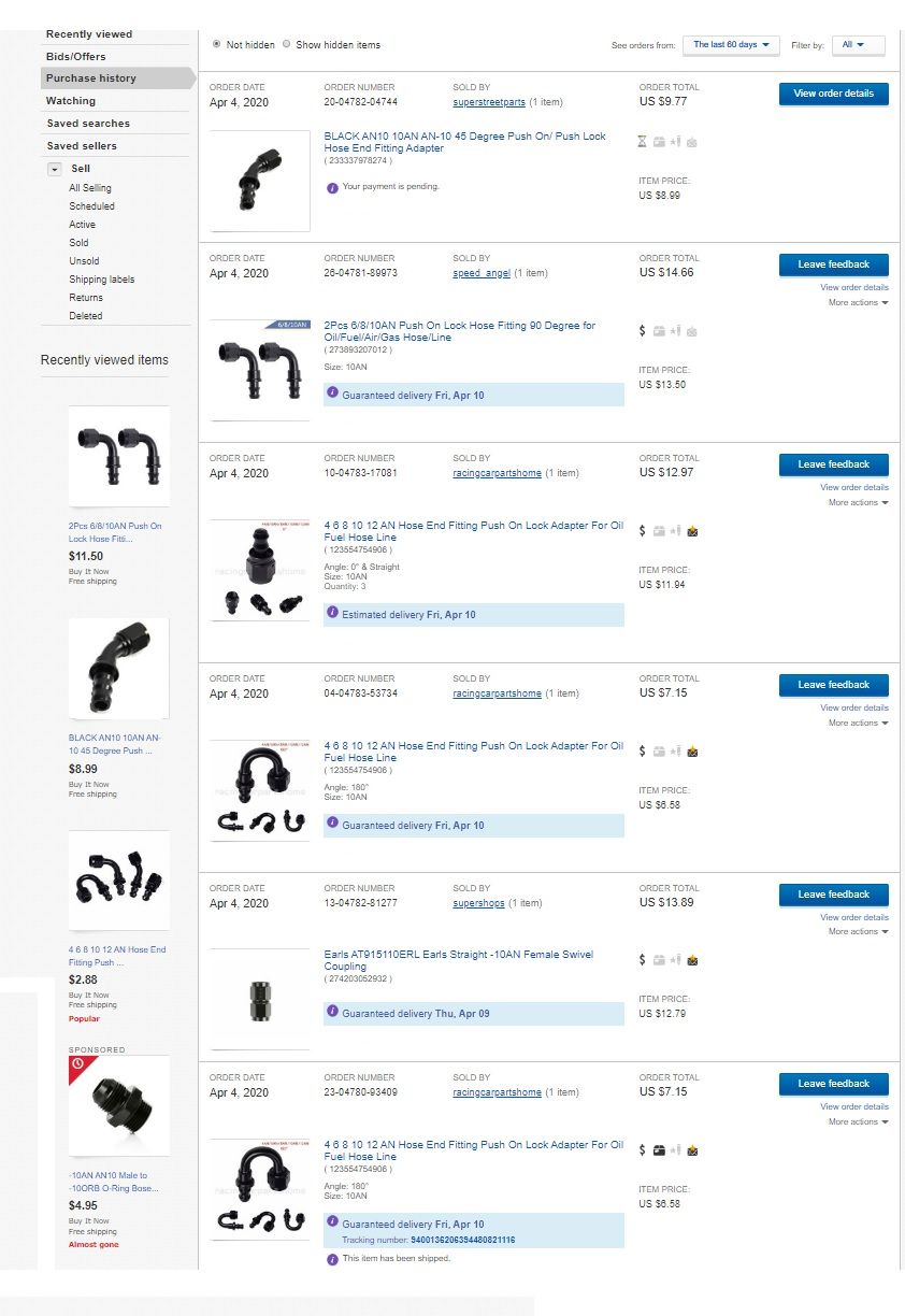

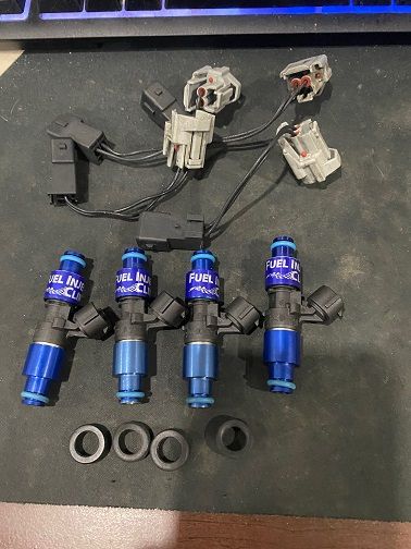

fic 2150cc injectors, a current member point them out for sale on ecmlink fourms

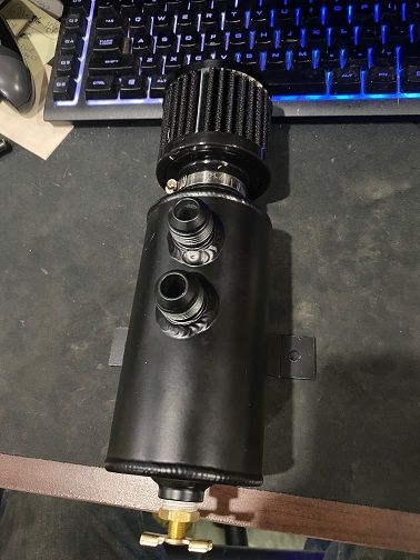

10an baffeled catch can, ebay
new aem wideband sensor, wagner part number 250-25036. this sensor works for aem LSU 4.9 sensor, i got it from rock auto for $65 +tax
