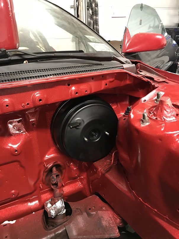

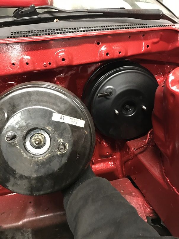

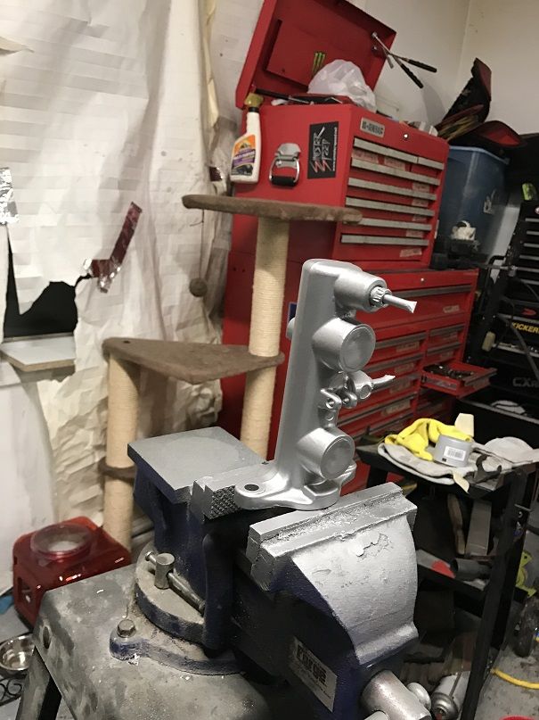

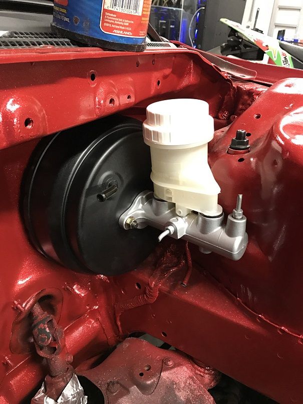

i picked up a 3g brake booster and 3g master and non abs proportion valve for that brakes.

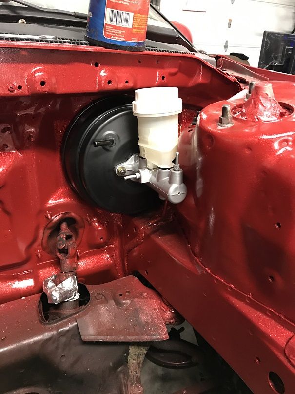

first i rebuilt the 3g master cylinder so it fresh,
next i cleaned and sanded the booster and master (no before pics sorry)
then self etch primer then some fresh paint,

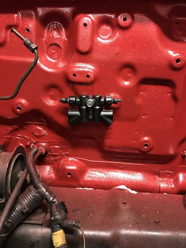

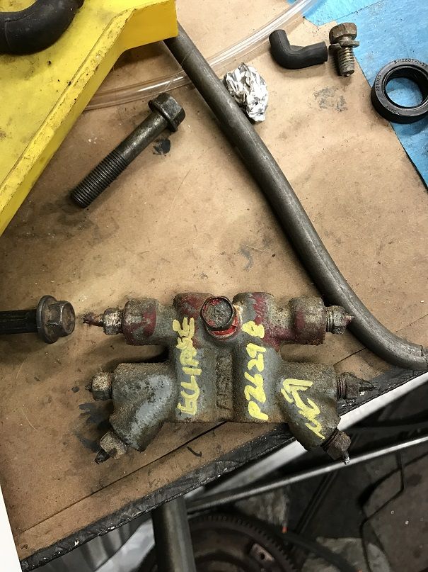

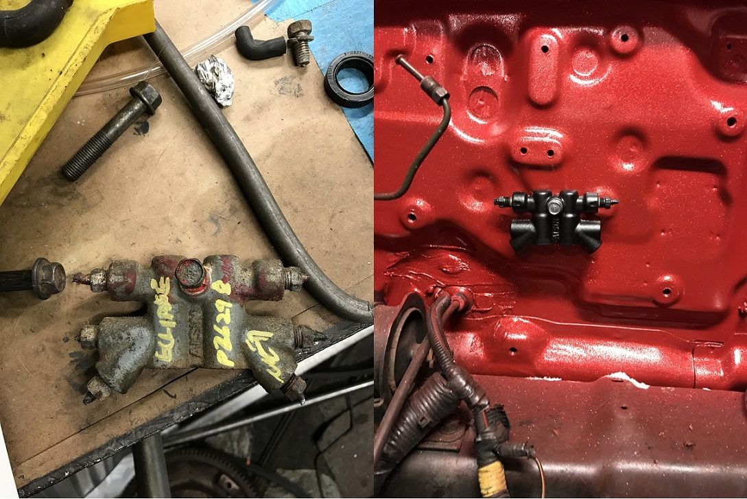

next im gonna do the proportion valve, either black or silver kinda undecided? what do you think!?
Brake plans- vvv
-front- Magnus front drag calipers and rotors, launch control solenoid (TO DO)
-rear- stock evo caliper and rotor, launch control solenoid, (TO DO)
-brake master, 3g master and booster, using it for the bigger plunger and brake booster (DONE)
-non abs proportion valve (PAINTING)

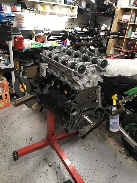

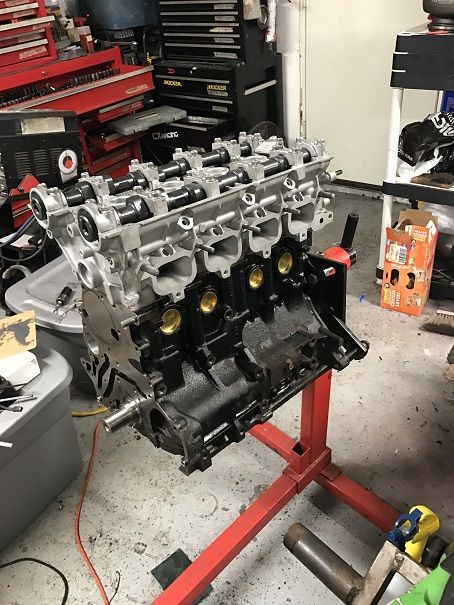

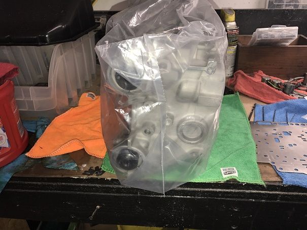

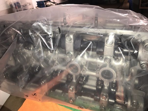

MY MOTOR IS DONE!!!!!!!!!!!!!!!!!!!!!!! I JUST PICKED UP THE HEAD IM GOING BACK TOMORROW TO PICK UP THE ROTATING ASSEMBLY (no room in car)!!!! STAY TUNED!!!

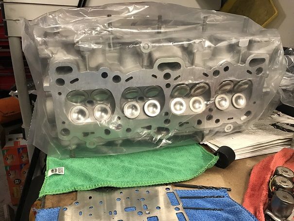

whats done to my head?... this!
1g head ported
GSC Power S3 Billet 4G63 DSM 280 Camshafts Set
8 Ferrea Competition Plus Intake Valve 35mm +1mm
8 Ferrea Competition Plus Exhaust Valve 31.5mm +1mm
16 Ferrea 6.5mm Valve Locks Keepers
8 Ferrea Exhaust Valve Guides STD
8 Ferrea Intake Valve Guides STD
Supertech 96lb Dual Valvesprings Retainers
BLE 4G63 Evo 8/9 & DSM Solid Lifter Conversion Kit

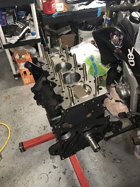

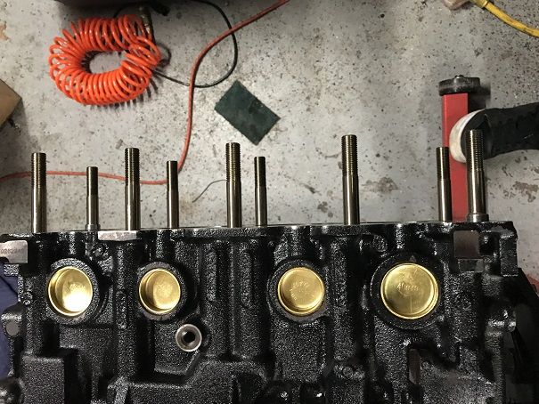

Boostin Performance 1/2" L19 4G63 Head Stud Kit
BP Spec MLS Head Gasket

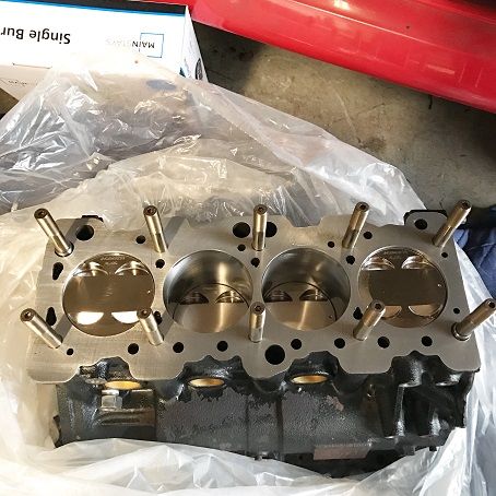

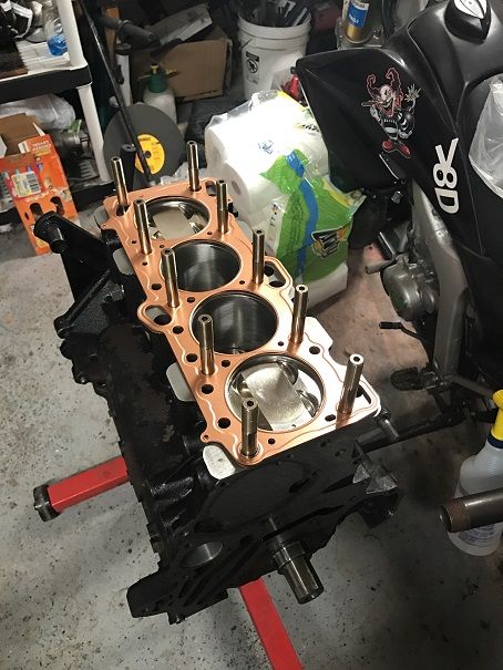

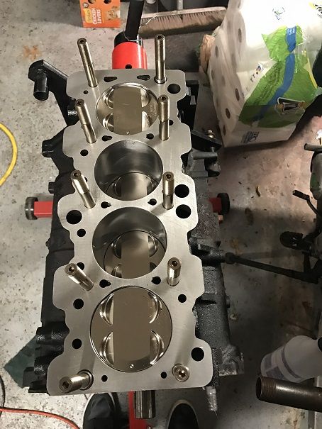

OMG LOOK!!! IM SOOOOOOOOOO CLOSE!!!! THANKS boostin performance for the studs!!!! can the motor hold 1000hp? with supporting mods?

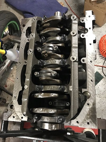

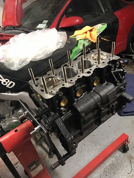

bottom end
howard i beam rods
acr race main and rod and thrust bearings
wiseco hd 1400 9.5:1 stock bore
arp main studs/bolts
everyhing you can do machine work wise (pics below) total $2,596 just for the machine work (no o ring)
what a beaut!!
thanks bro-

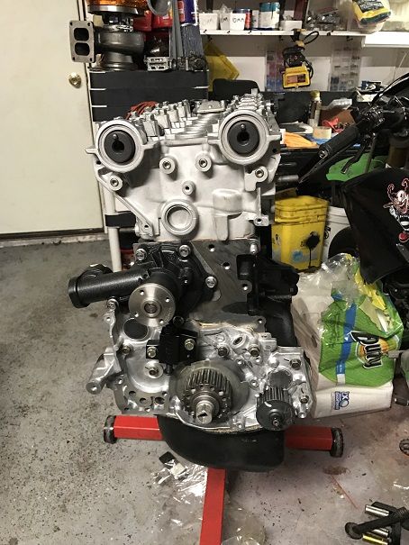

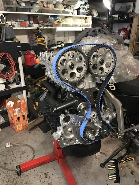

engine update!!!

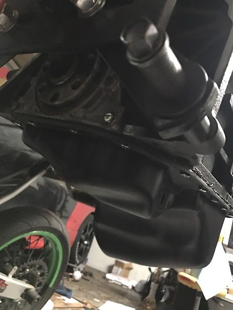

front acl case and oil pump put on - brand new
rear main seal put on - brand new seal
cam seals put on - brand new

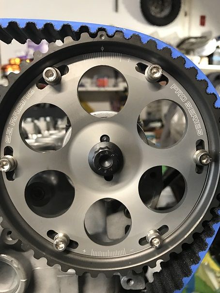

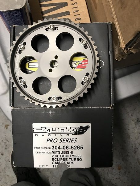

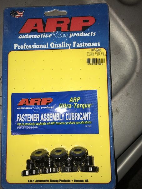

i just pick up skunk pro series cam gears from my local shop E-SPEC tuning
putting on gears and belt tn along with flex plate and arp crank bolts

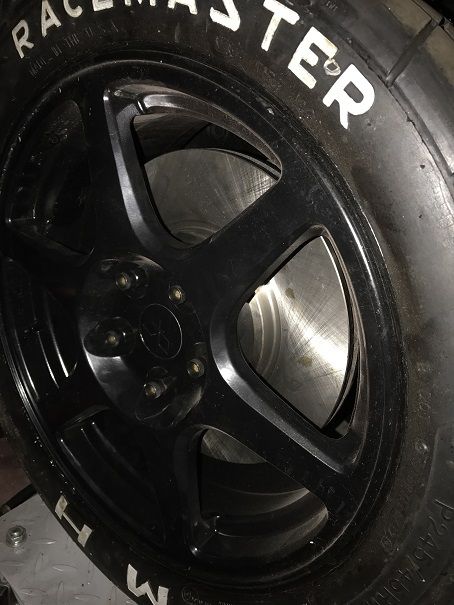

i am also starting on the front brakes again, im doing the cts-v swap, i have the mustang rotors, 5mm spacers,
(need to arrive still) centric rings - calipers

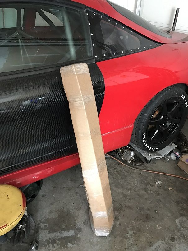

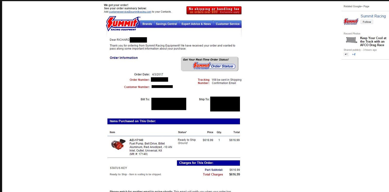

some new parts i just ordered and got
ordered the big bad aeromotive pump today!!!
also just got my arp cam bolts today as well

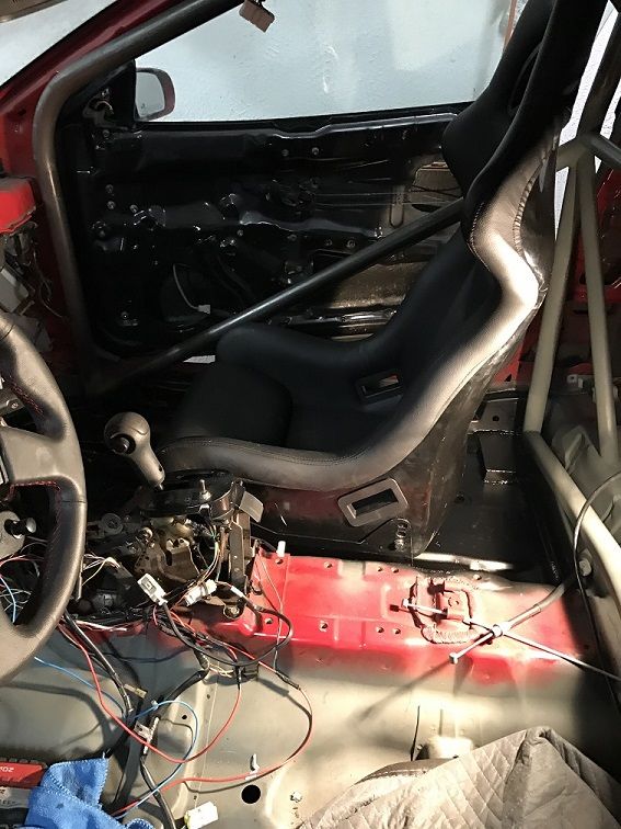

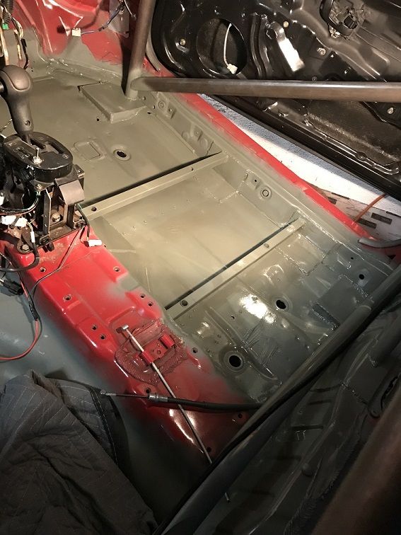

this is how she sits!!
