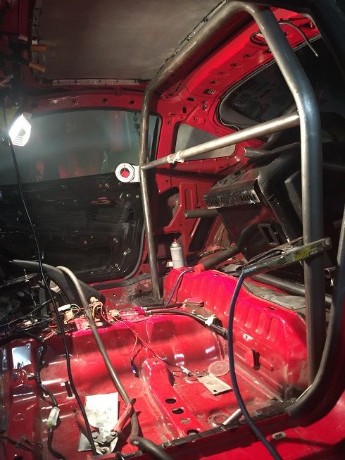

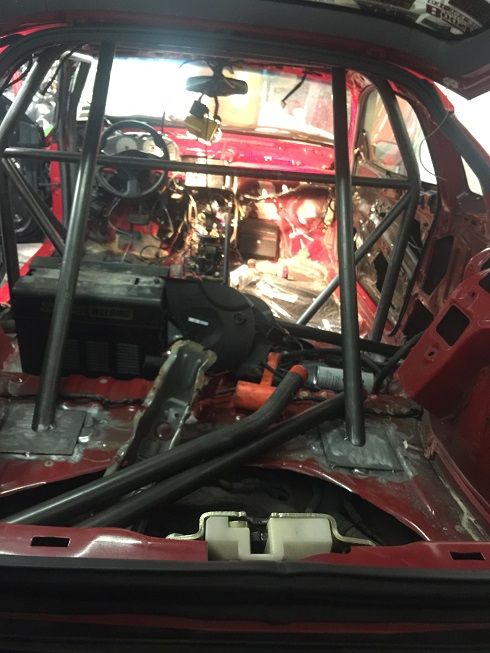

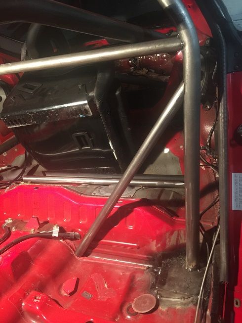

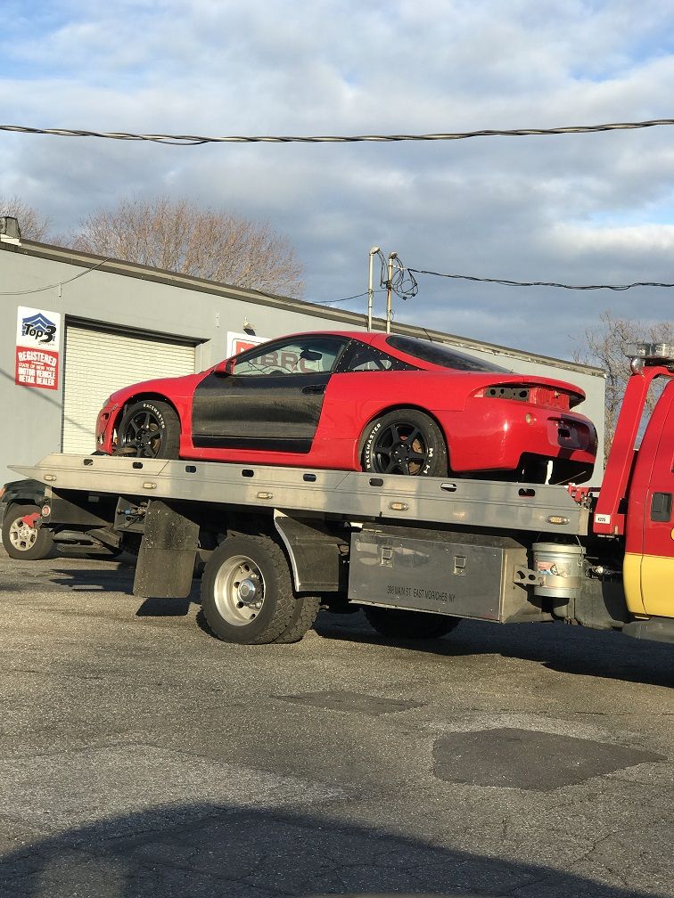

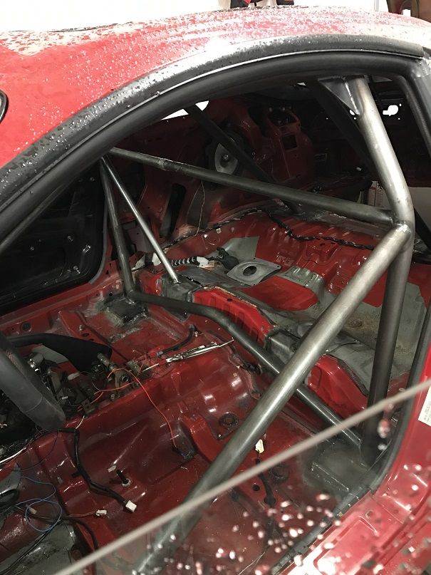

well she got dropped off today at the roll cage shop to do the final welds on the 10 point cage, 1 step closer guys, and p.s. still waiting for my motor to be done -_-, but dam she looks good!!

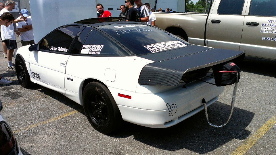

If you got a carbon fiber oem wing and painted the top red like gofer that would look sick with your doors.

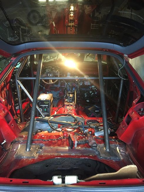

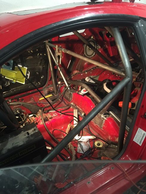

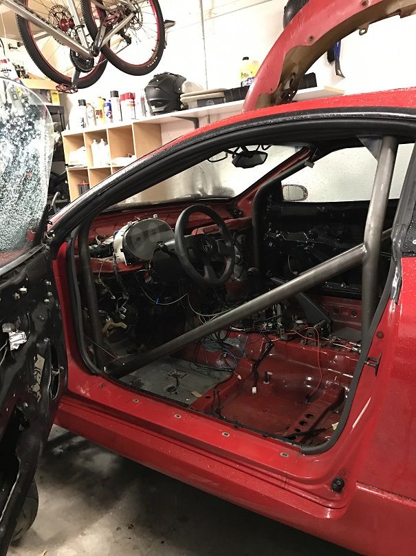

I GOT MY CAR BACK!!! my 10 point roll cage is all done they did it in 2 days, well i did most of the hard work, like everything, they just came in and welded it all up for me!!! im one step closer to my goal!
What are your plans for the doors? Going to gut them? There is a guy on Facebook that sells aluminum covers for the doors for like $185 shipped. I may get some for my 1G.

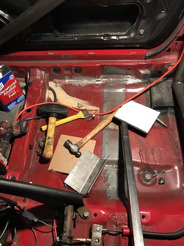

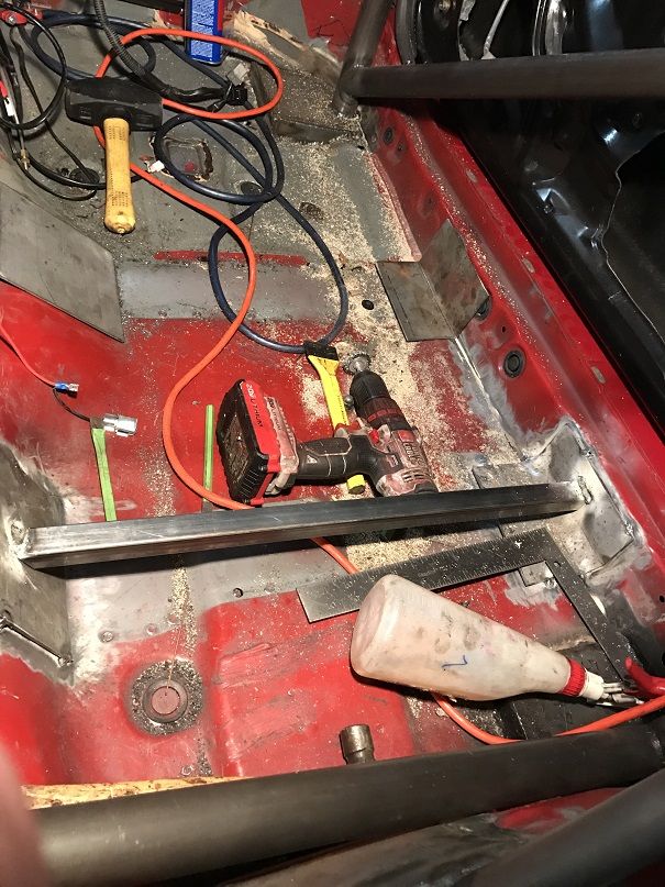

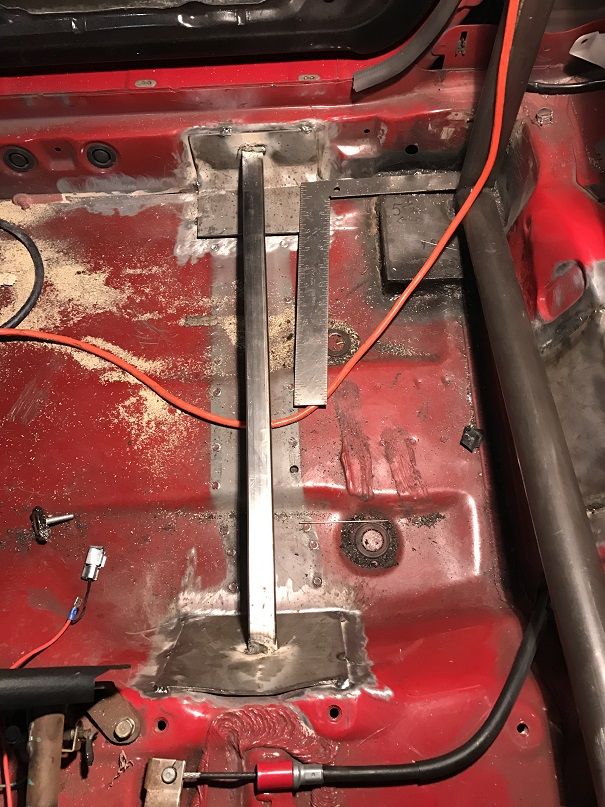

i started working on the passenger seat, removing the tack welded stock mount and making my own, the passenger seat is going to be fixed no sliding bracket, the driver is going to have a sliding bracket,

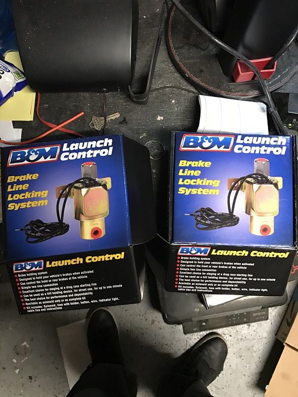

also i got a goodie for my self today, i picked up my launch control solenoids,
Brake plans- vvv
-front- Magnus front drag calipers and rotors, launch control solenoid
-rear- stock evo caliper and rotor, launch control solenoid,
-brake master, 3g master and booster, using it for the bigger plunger and brake booster
-non abs proportion valve
-all new hard lines are gonna be ran,

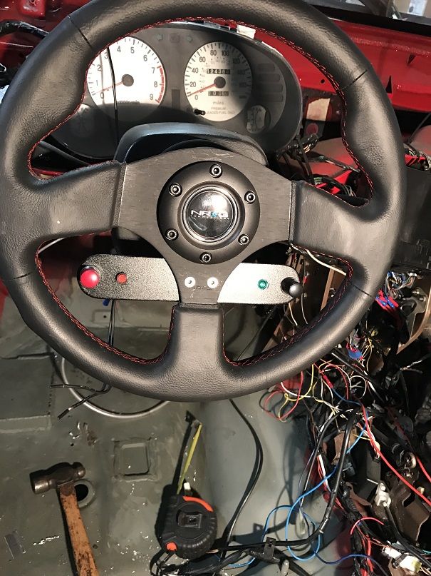

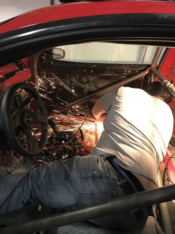

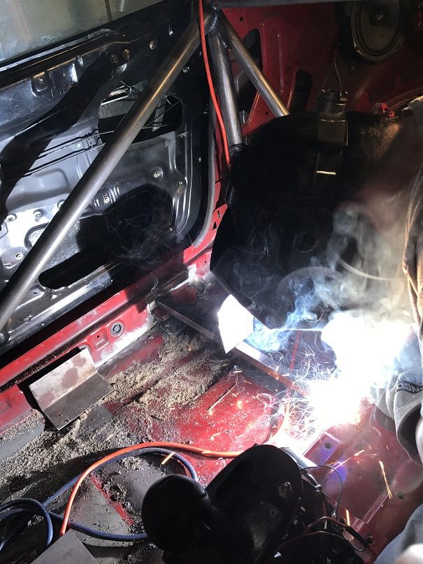

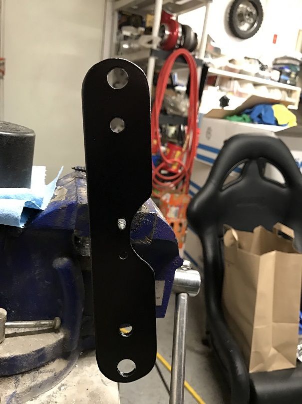

got a picture of my buddy matt helping me grin and weld up the seat brackets today, me and him also made a cool bracket for the steering wheel so i can add my launch and nitrous buttons to it!!
