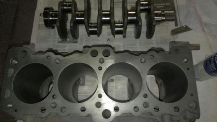

I hit up an old friend that I hadn't spoken to in years who has a really impressive 420a rs. He set me up with a fully built short block 6 bolt that had been completely machined already and I bought it for a huge steal. Came with je pistons, a .020 bore, balanced crank and balanced and shaved rods.
Well today I finally brought the engine out to my buddies shop so we can get it running! :D I'm taking the flywheel to be machined, picking up an act sprung disc, and a few more odds and ends. I'll have more pics to come very soon. I absolutely wanna thank the vendors on here who have saved my butt multiple times by getting me the parts I need. I will have pics up real soon of the work we will be doing. Stay tuned!
Well the car has been slowly making progress. I got a new mishimoto intercooler, the clutch disc and throw out bearing. Unfortunately, my rods are no good and the turbo is shot. Also my thrust bearing is too big. So I'm getting some scat h beams, a new set of acl main bearings and a rebuilt 18g turbo with an external wastegate. Hooray for having to spend an extra 1400 bucks... Lol but myhopes are still high. If anyone has any advice, im def all ears :)
