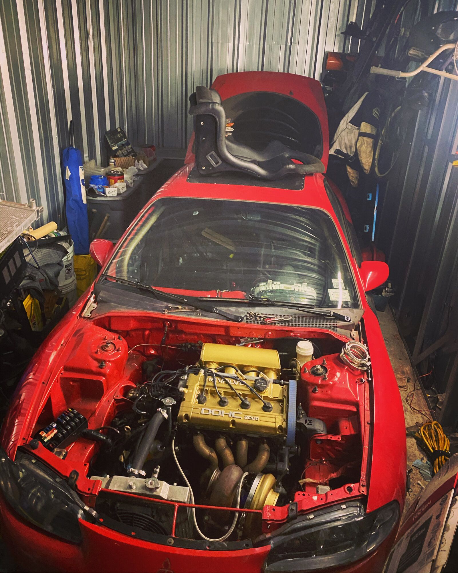

Drag Race Build My 2g dsm second build, this ones going smoother
building an 8 sec drag car
up date on what i got going on!!!

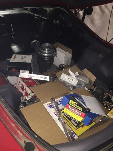

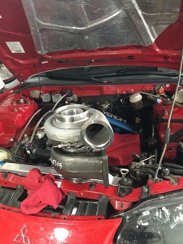

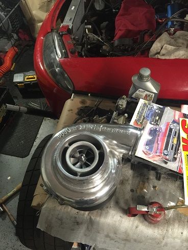

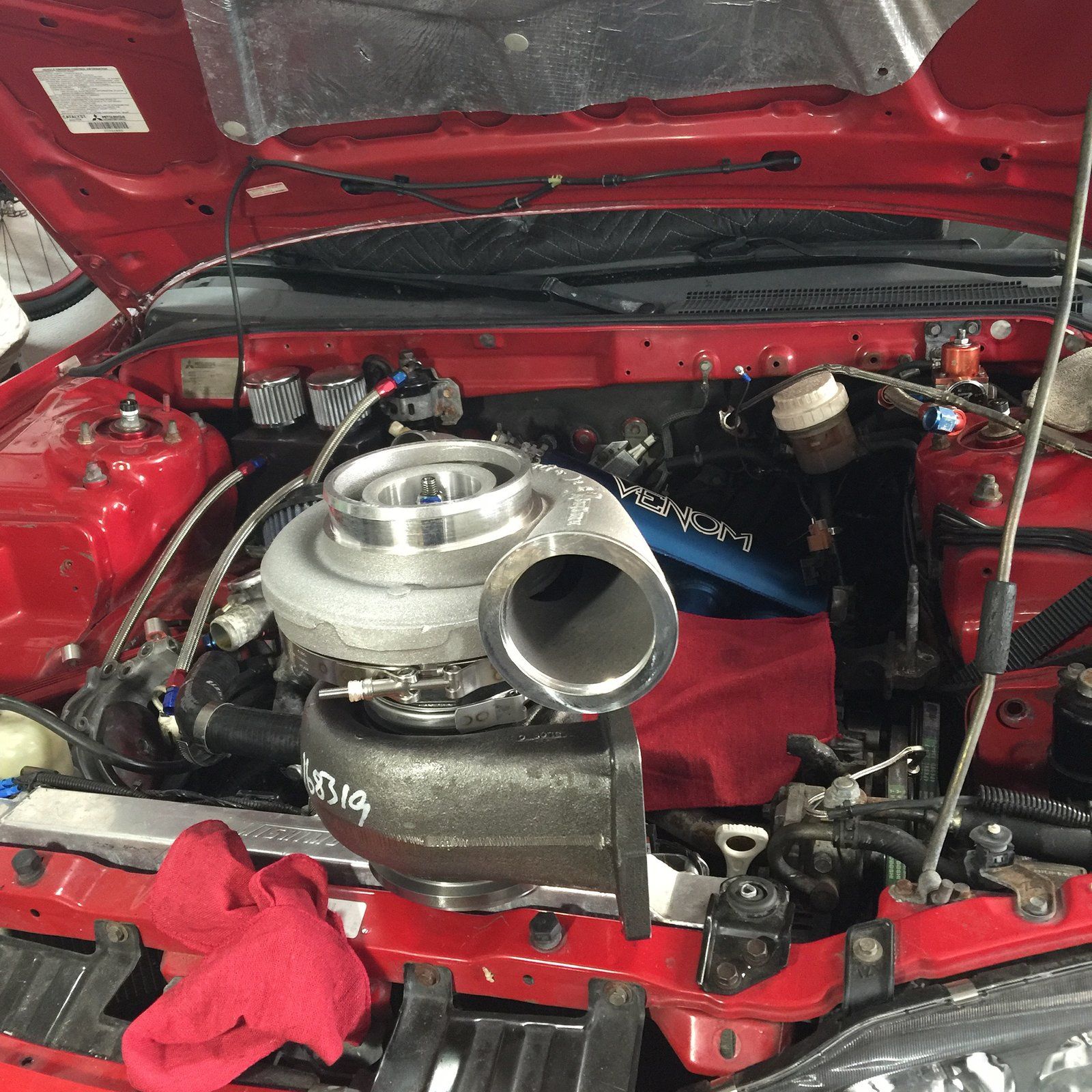

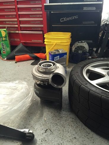

my borgwarner s400 came the other day and i just finished polishing the cold side tn! what you think?

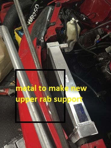

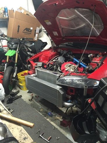

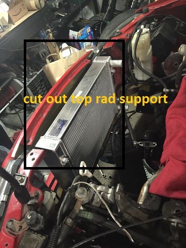

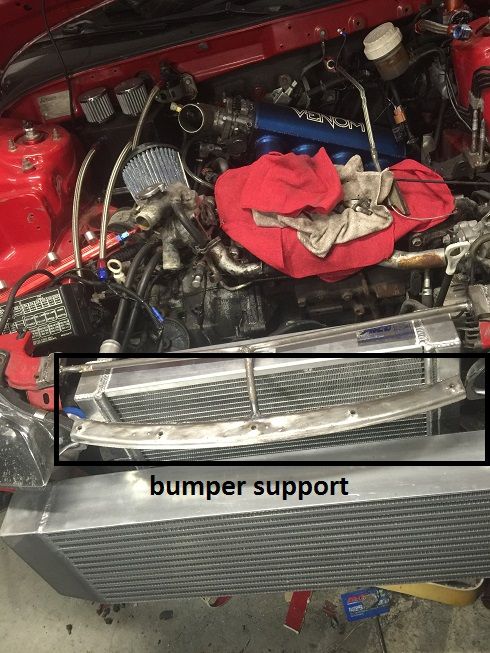

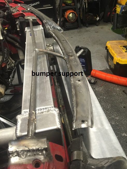

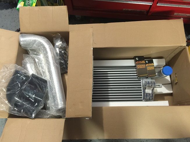

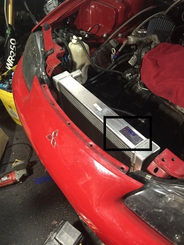

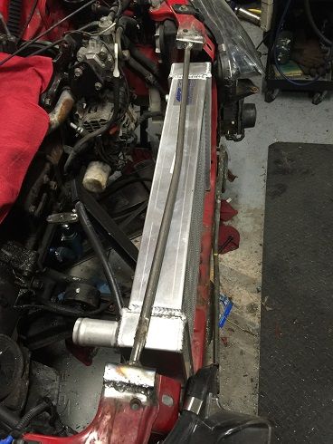

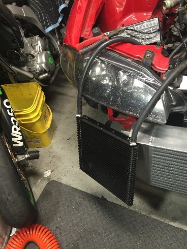

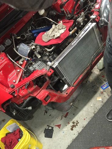

also my afco radiator came as well im currently working on that will keep you posed!
update!!!

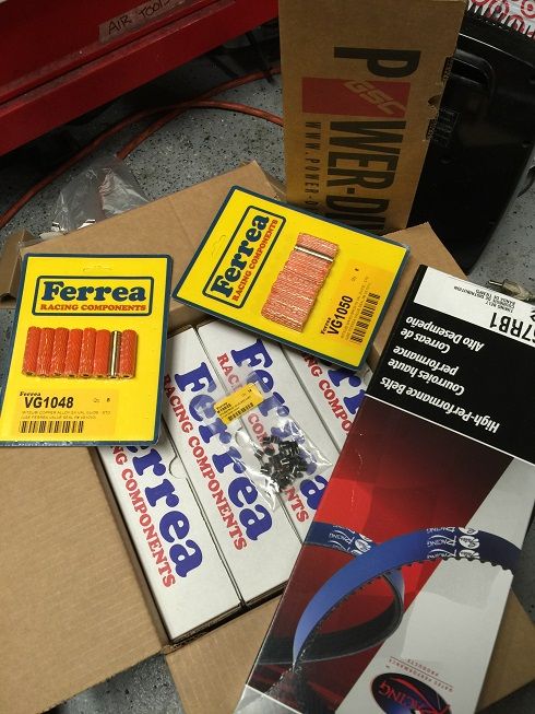

GSC Power S3 Billet 4G63 DSM 280 Camshafts Set
8 Ferrea Competition Plus Intake Valve 35mm +1mm
8 Ferrea Competition Plus Exhaust Valve 31.5mm +1mm
16 Ferrea 6.5mm Valve Locks Keepers
8 Ferrea Exhaust Valve Guides STD
8 Ferrea Intake Valve Guides STD
Gates Racing Timing Belt
im just waiting on my Supertech Eclipse 96lb Dual Valvesprings Retainers

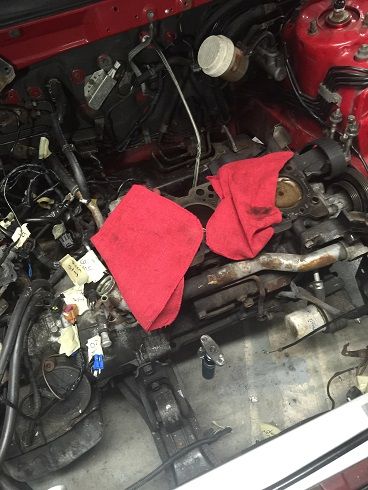

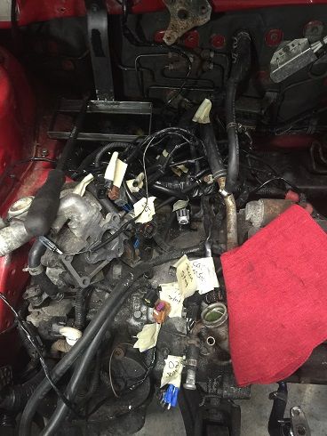

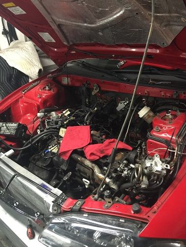

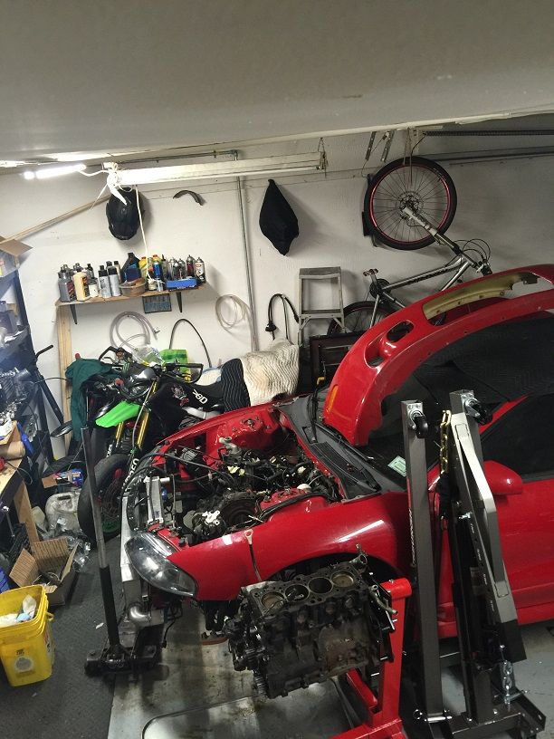

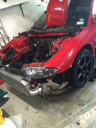

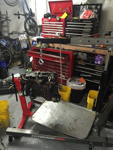

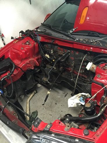

so i picked up my Supertech Eclipse 96lb Dual Valvesprings and Retainers today, so this means i officially have all the parts to build the motor now!!!!! =) =) =) so today i ripped out the rest of the motor to get it ready for machine work and to get it built and same for the head check it out!!

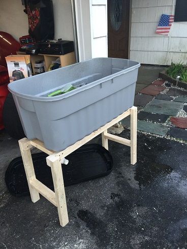

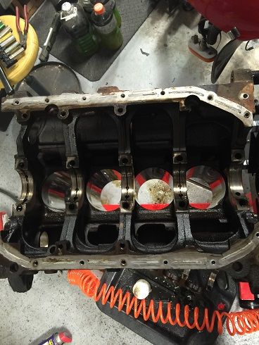

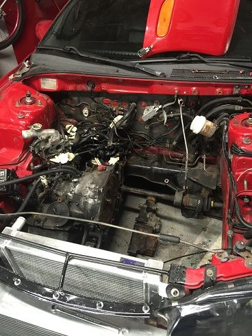

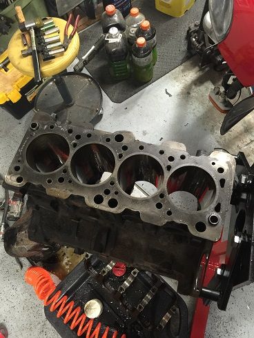

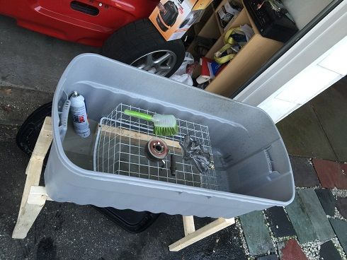

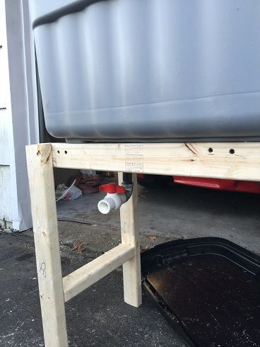

so today i took the time to build a parts cleaner bin you know for all that old caked on oil ;) but more important i totally stripped the block. and a heads up a 99 gsx block dosent have oil squirters and i never knew that om going to start a thread about it.

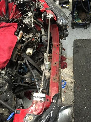

here is my shifter set up that i did!!!

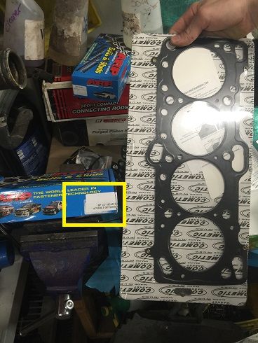

here is the new head gasket and boostin performance 1/2 over-sized head studs and main arp studs as well

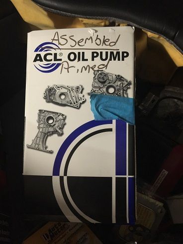

this is the new acl oil pum, i allready put in the balance shaft delete kit and primed the oil pump with grease!!

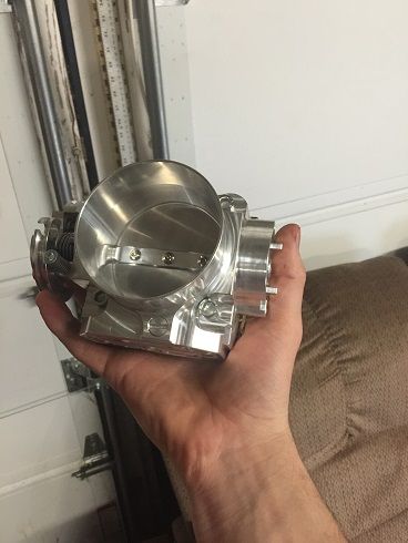

my 74mm s90 throttle-body showed up the other day!! this is a piece of art!

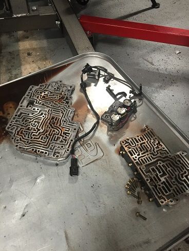

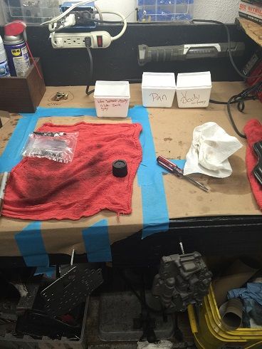

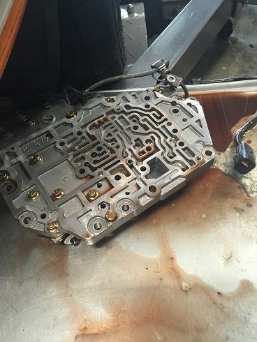

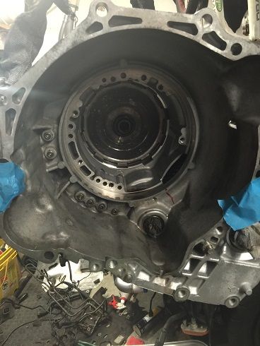

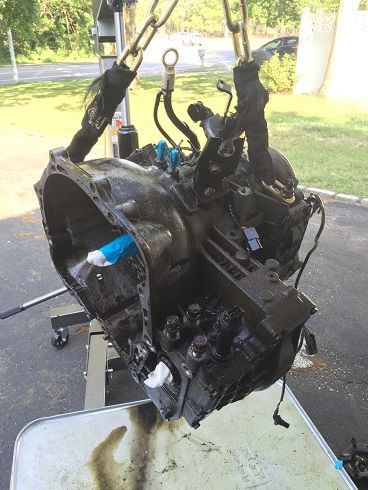

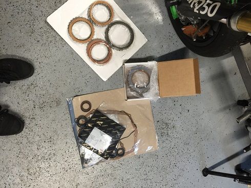

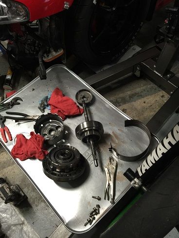

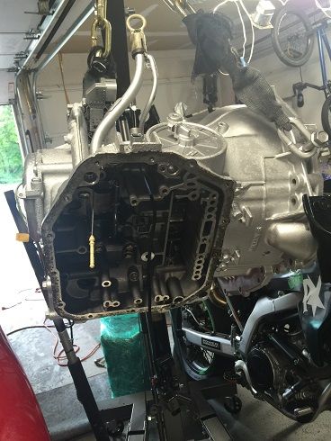

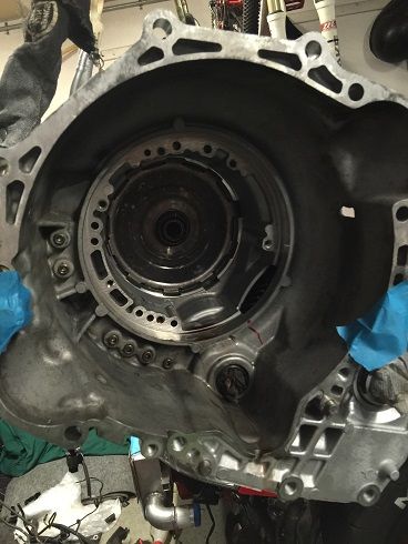

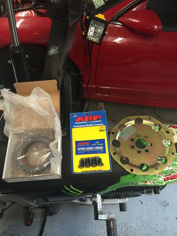

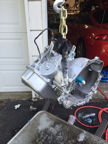

here is my trans i did this the other day cleaned and painted ready for me to start building it, new clutches and band and shift kit will be goin in i will keep you up dated on that

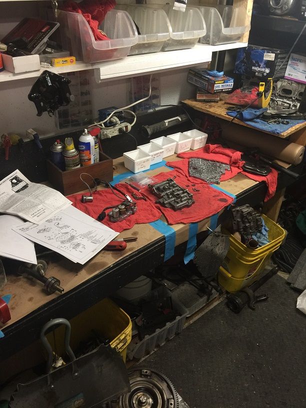

im currently working on the shift kit to the tranny, ill keep you up dated!!!
