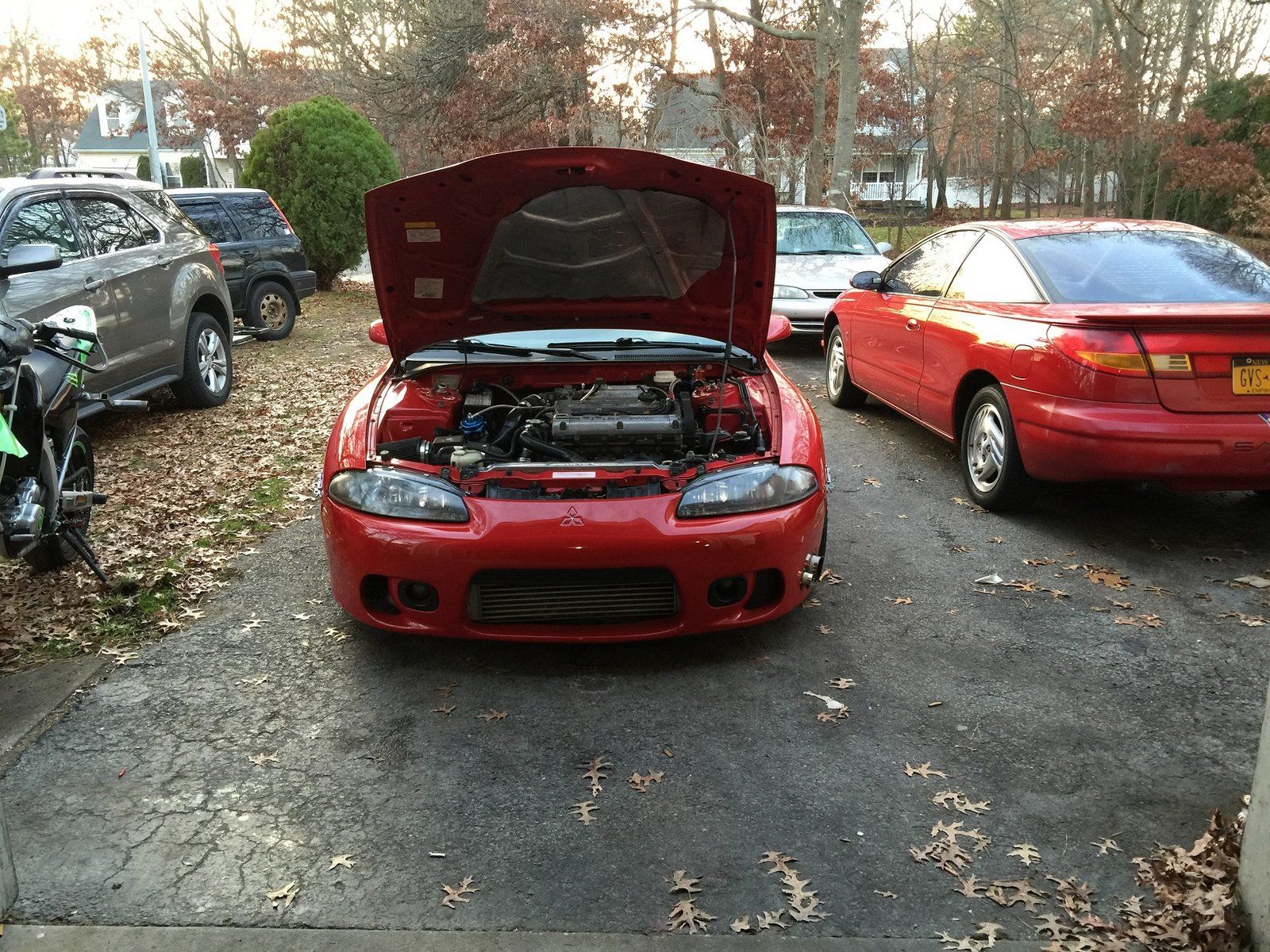

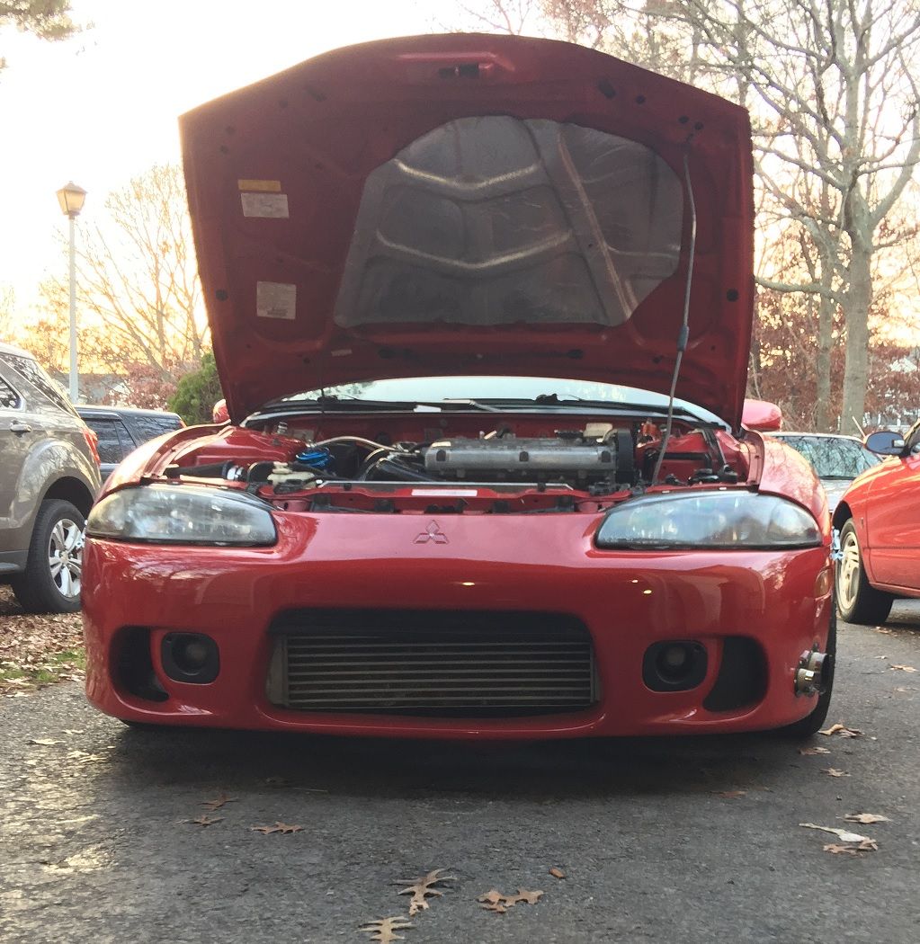

Drag Race Build My 2g dsm second build, this ones going smoother
building an 8 sec drag car

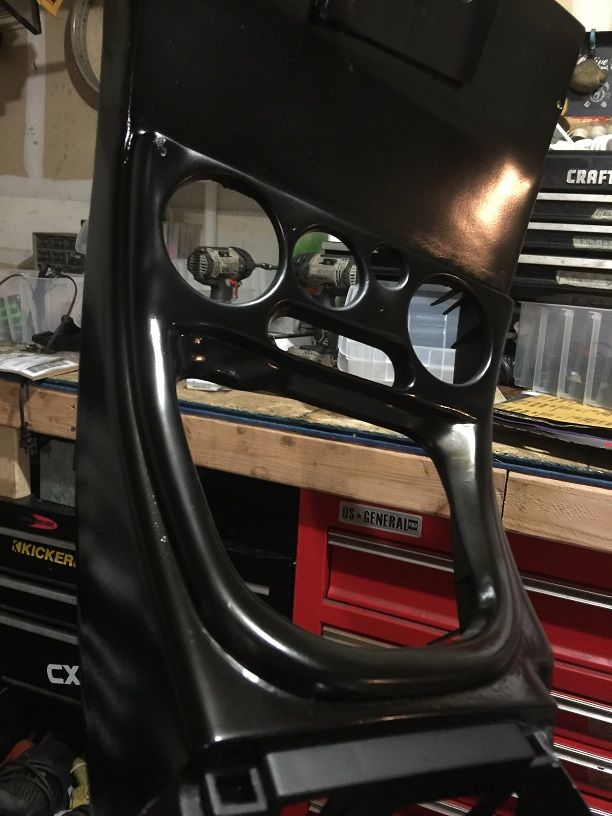

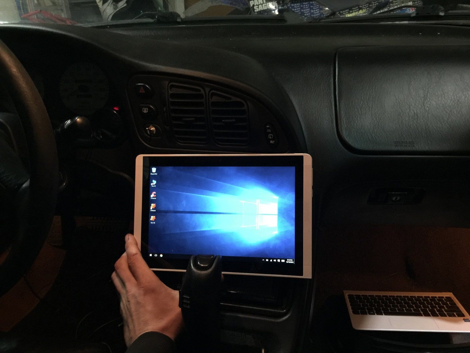

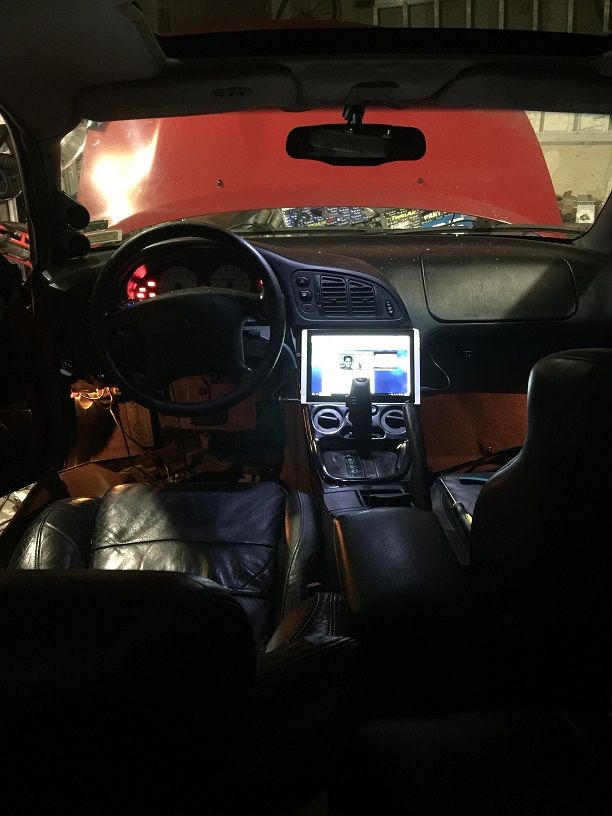

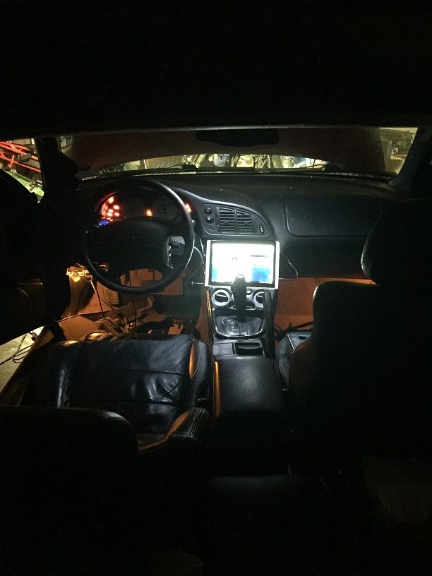

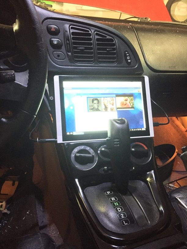

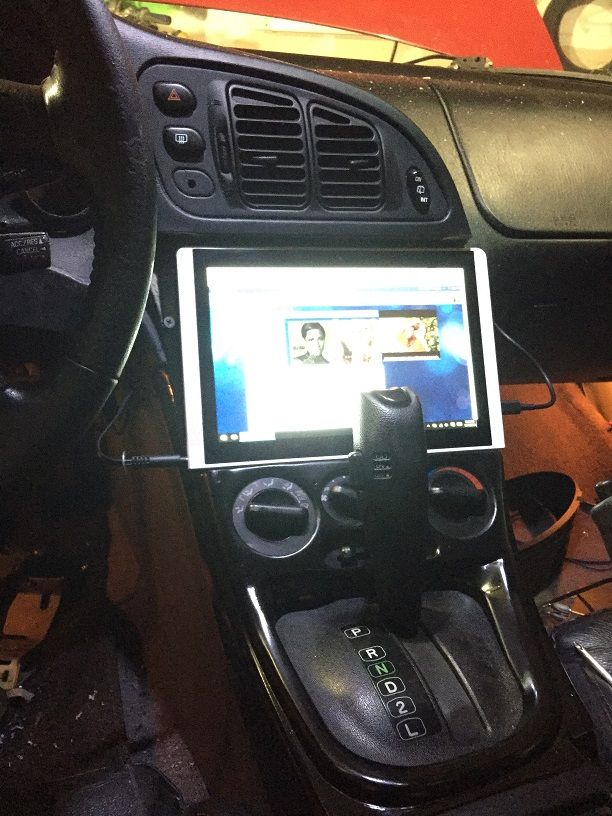

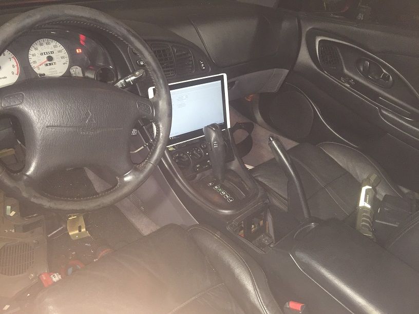

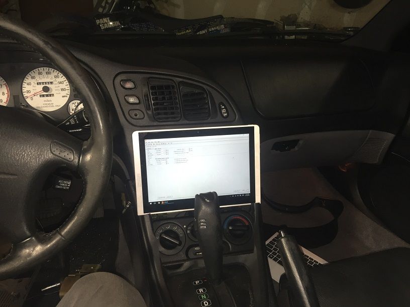

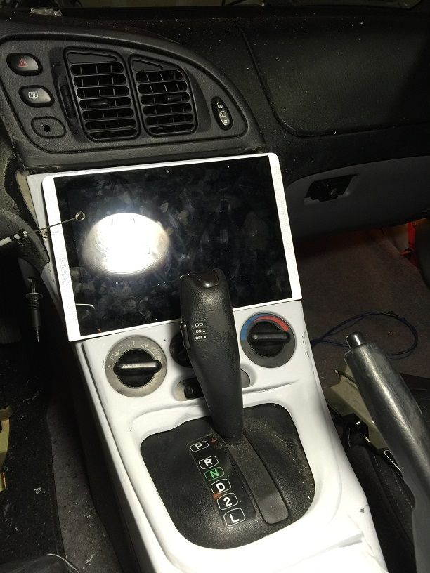

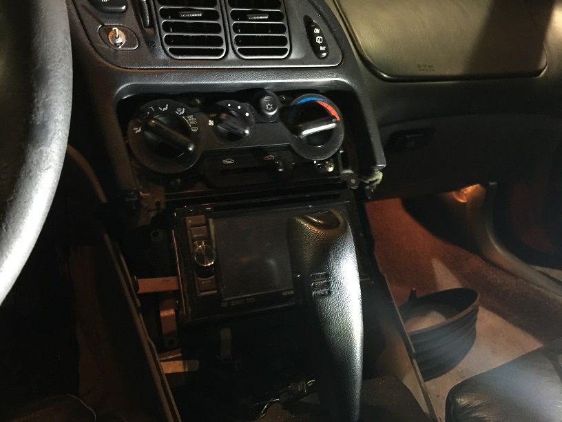

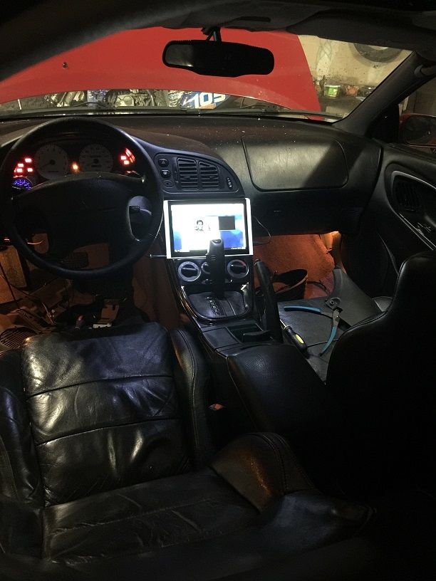

I like that tablet in the car. I may look into that when I go link instead of ecu flash. I'm liking all the pics, nice build man. Will be watching the progress as you make it. Keep up the nice work :thumb: :dsm:

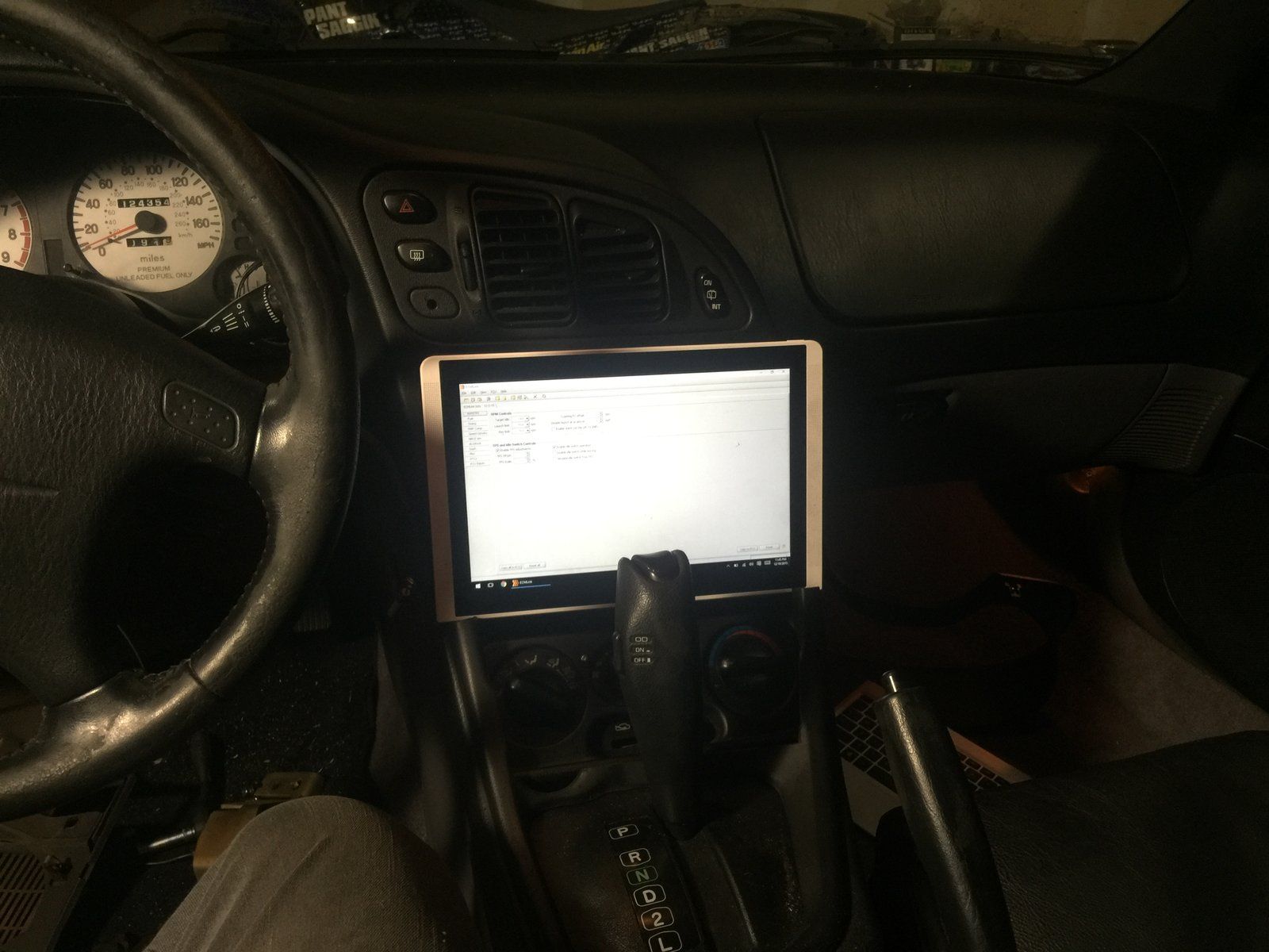

Good work, I can't wait to see link on the screen. You are able to run v3 with the blue tooth key board, I may be influenced by this ;) Haha. I don't want to take your idea, as that does looks fun to do. I will stick with a comp in the passenger seat haha. :thumb:
here you go just for dsmtuners :thumb::thumb: need help with yours let me know ill answer all questions best i can!!!
On that tablet are all the functions on link available? Basically that just as good as a computer? Also is the radio/ speakers wired into that? Or is there a radio still, I didn't see one.
If it's ok I may do this with many future plans that will be coming up next spring time. I really like that a lot, good work and thinking outside the box. :applause:
i used a windows 10 tablet so yes all functions are available!!! yes just as good as any computer or laptop! the headphone jack is plugged into an amp, the amp then runs the car speakers, what i used was a headphone jack to RCA then all you do is plug the RCA into the amp then take the speaker wires and connect them to the amp, MAGIC now any music i play on the tablet will play through the car and the volume is controlled through the tablet volume buttons!!!!

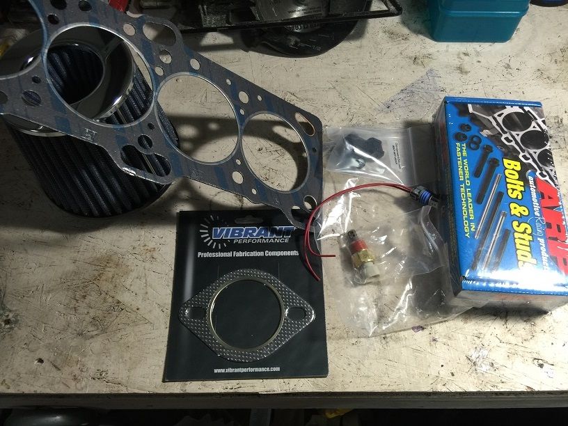

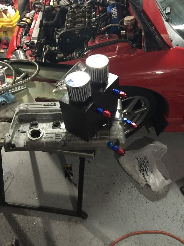

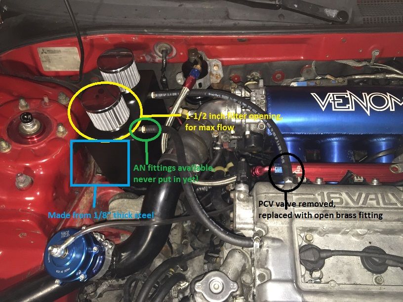

the next few day im going to be installing some small goodies for now!!!

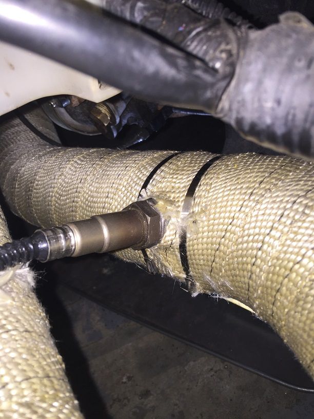

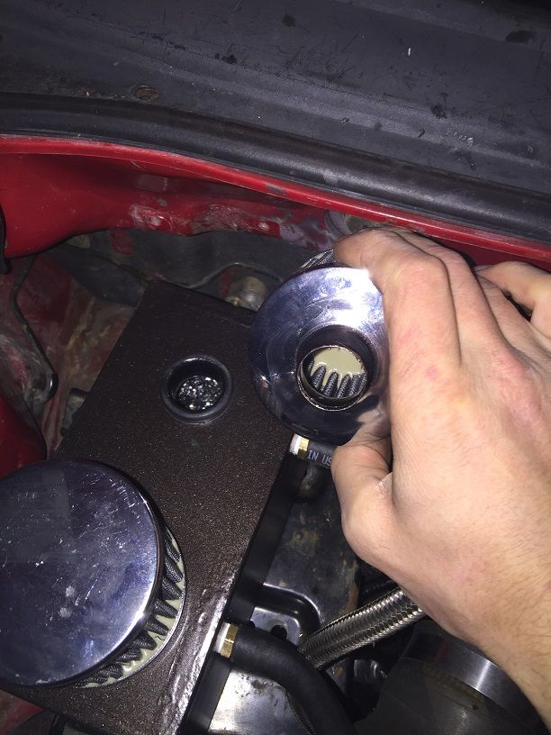

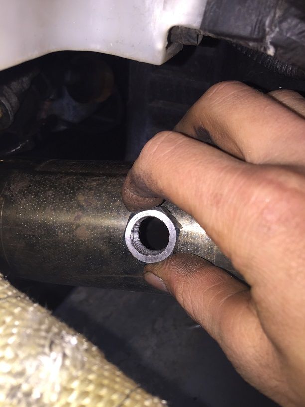

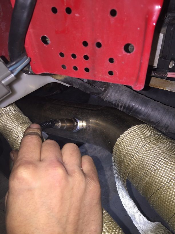

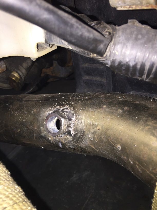

arp studs, new head gasket, filter, and speed denisty with aluminum bung stick around

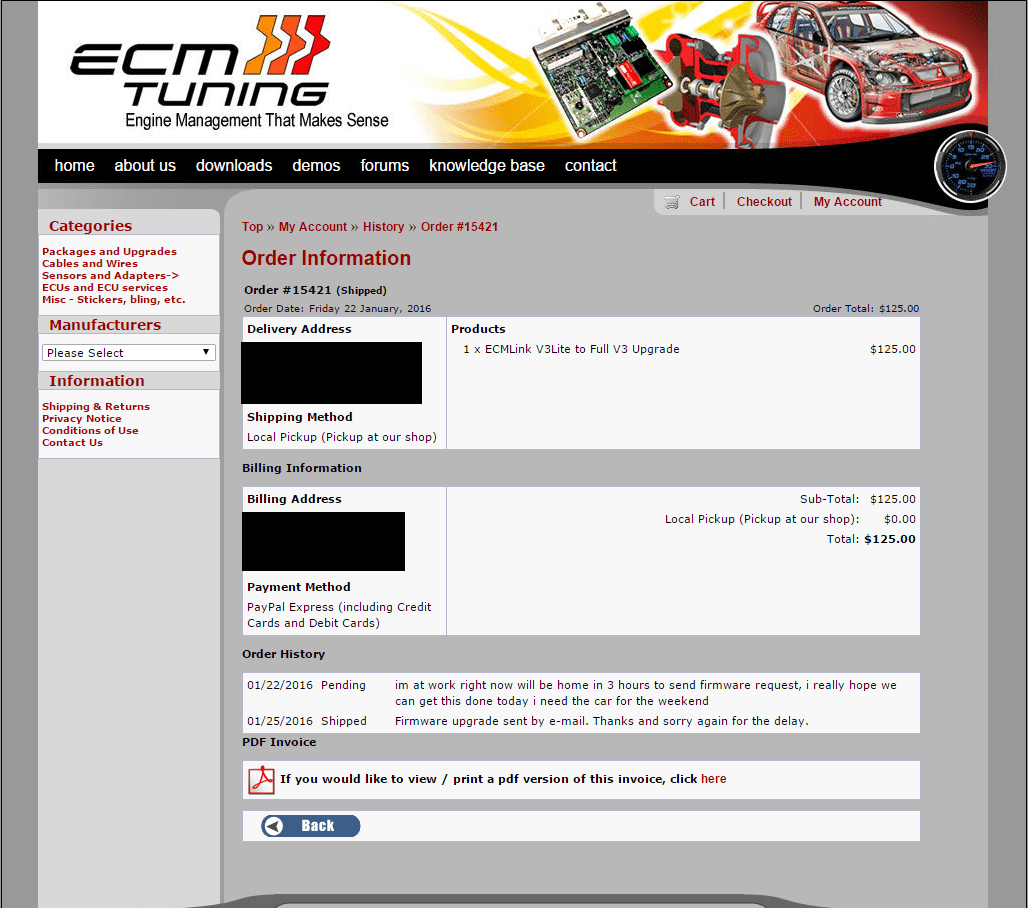

okay here is another great addition that i suggest to every using ecmlink v3 light, SPEND THE EXTRA $125 AND GET THE FULL, much more tuning abilities!!

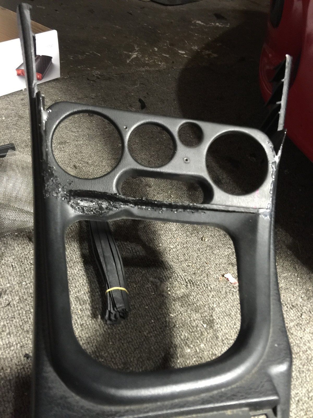

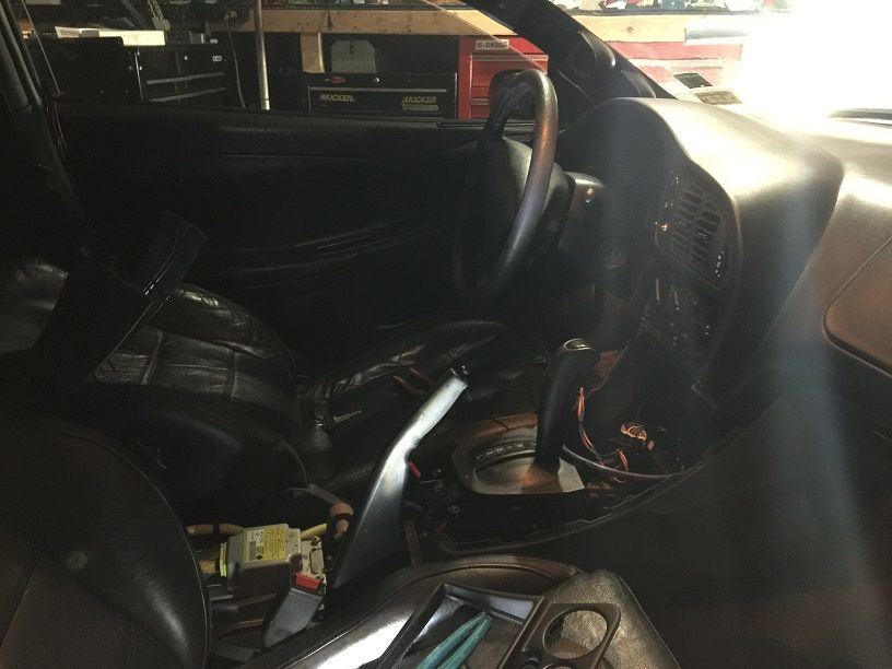

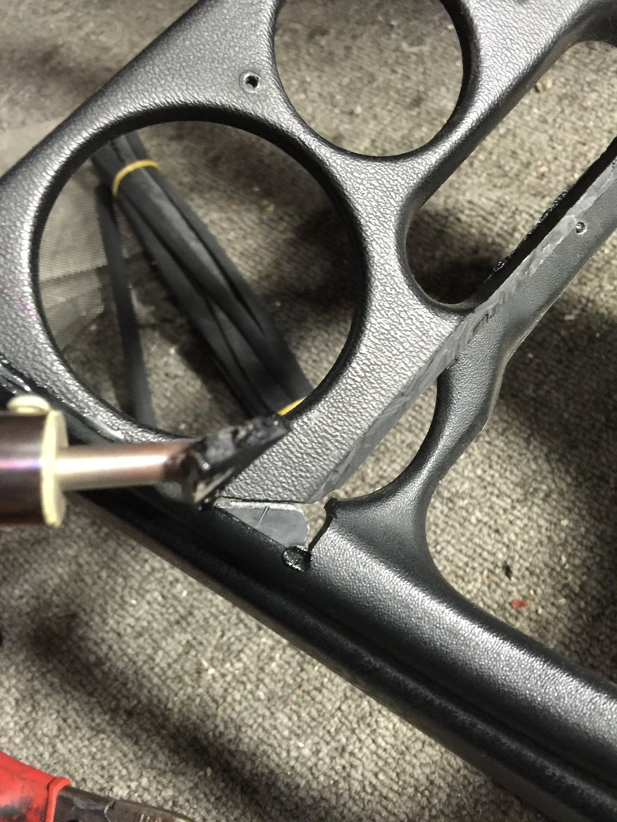

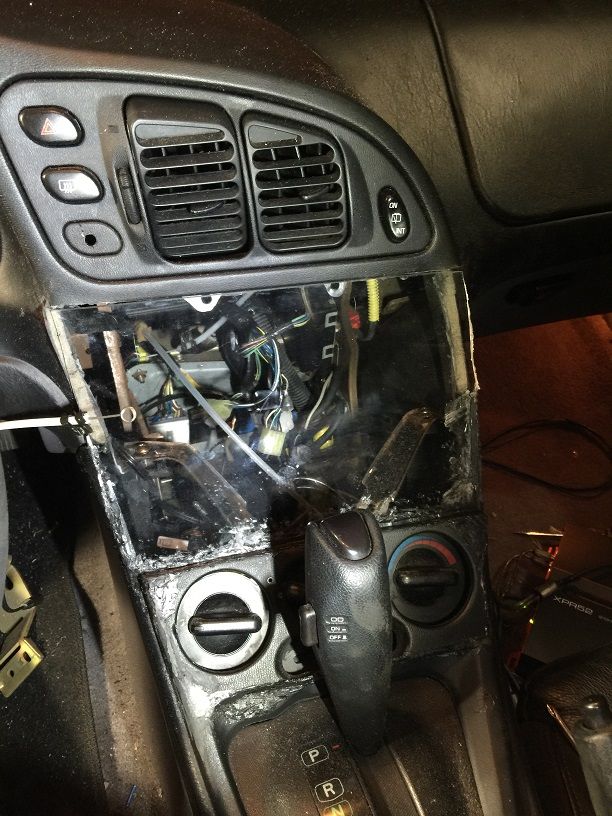

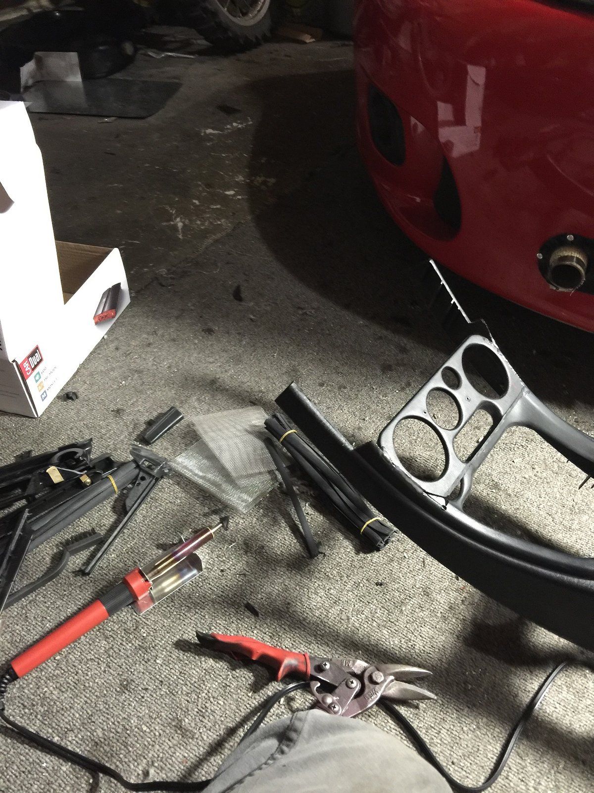

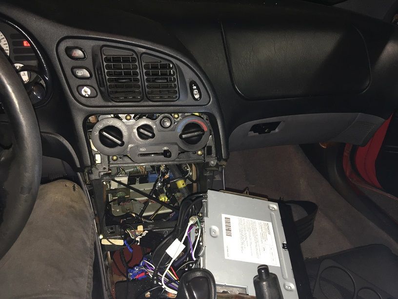

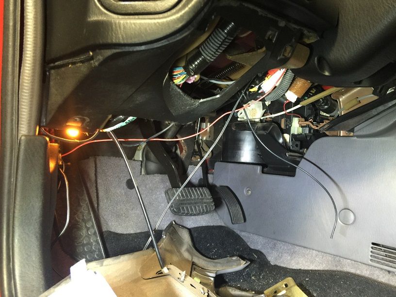

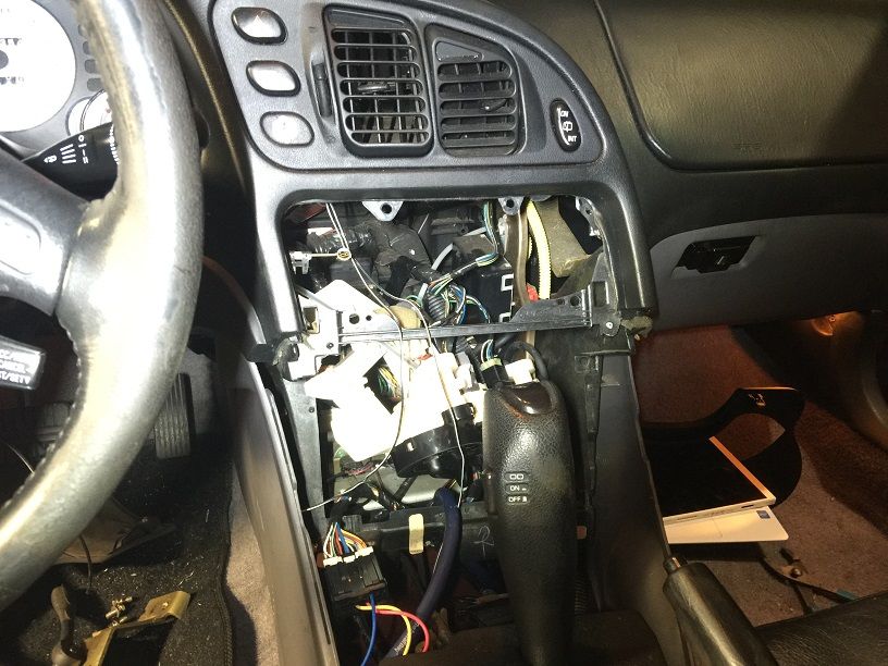

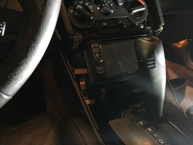

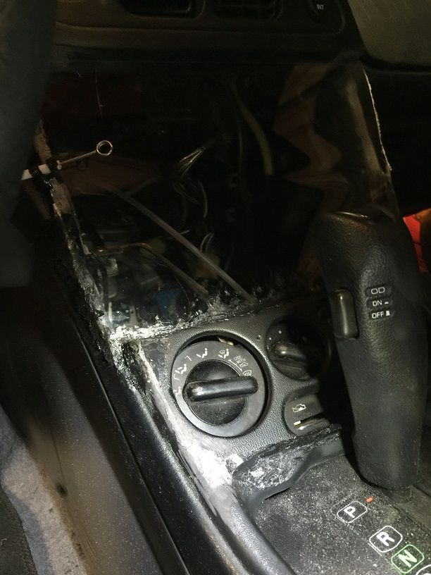

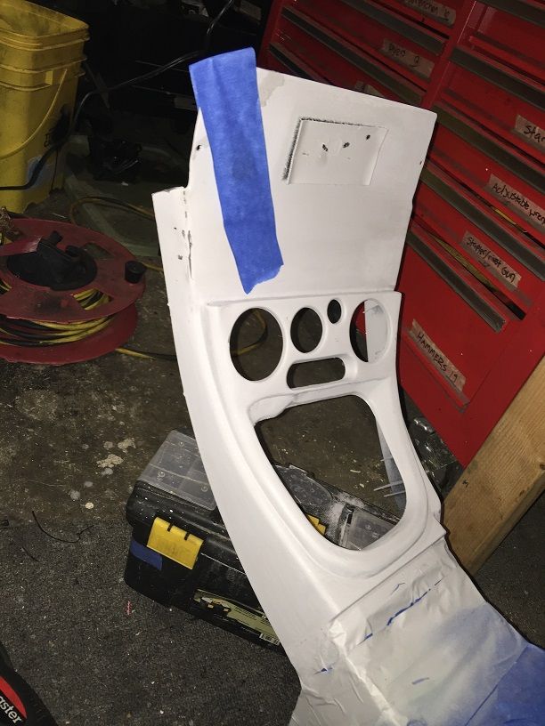

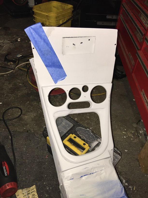

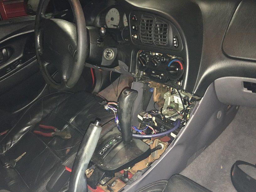

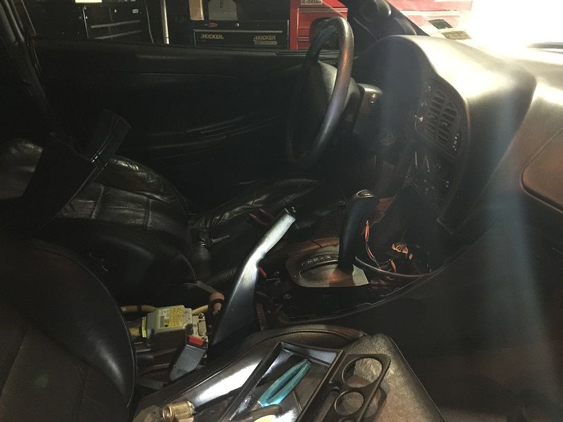

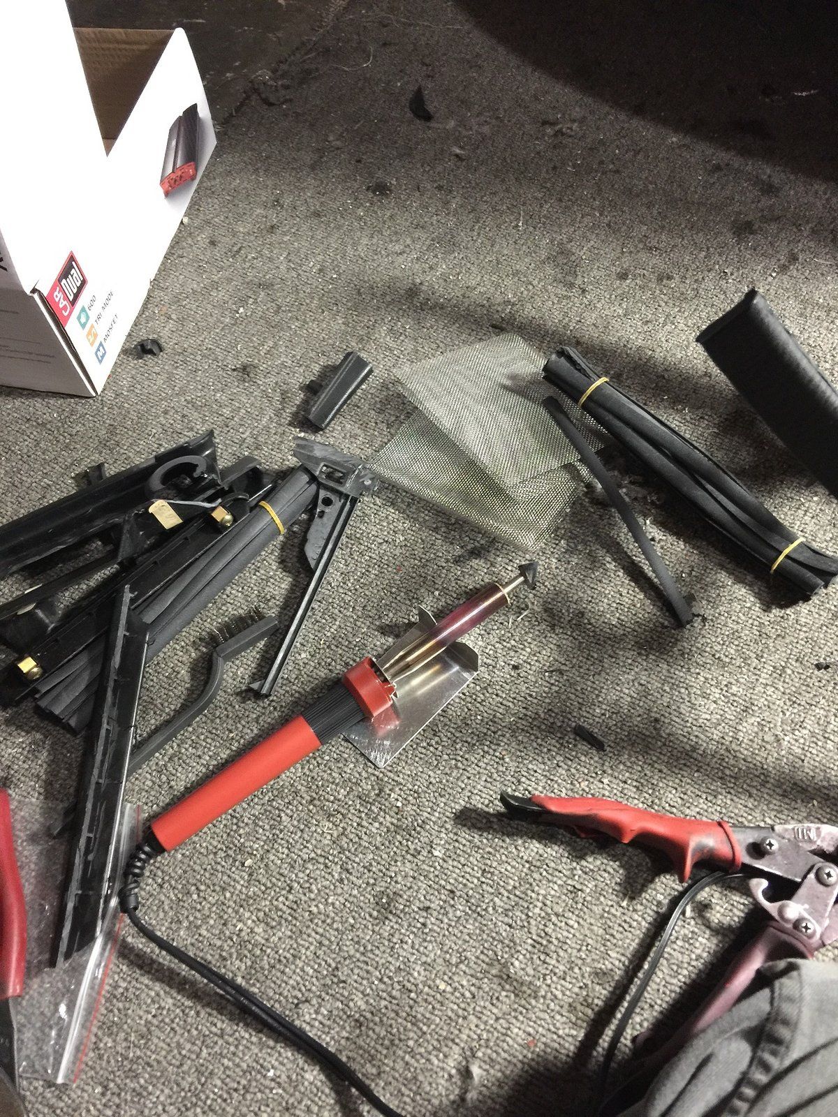

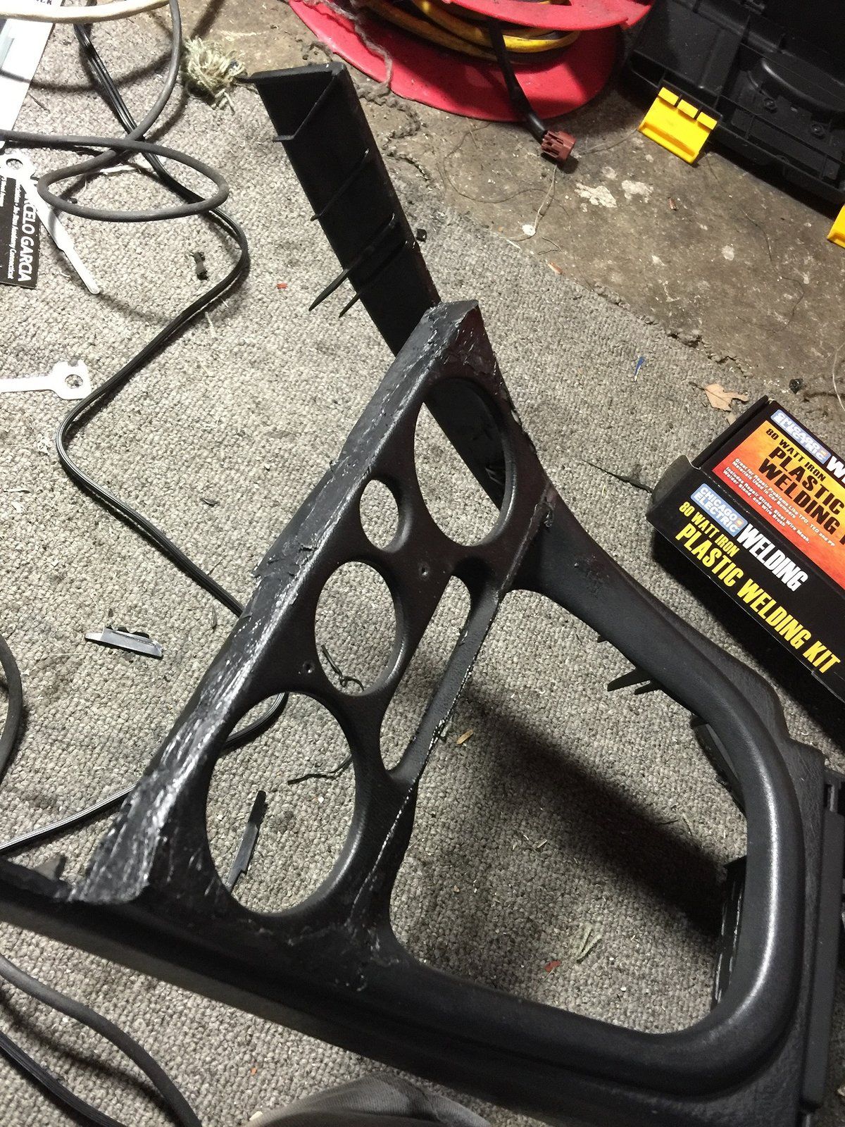

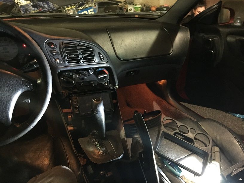

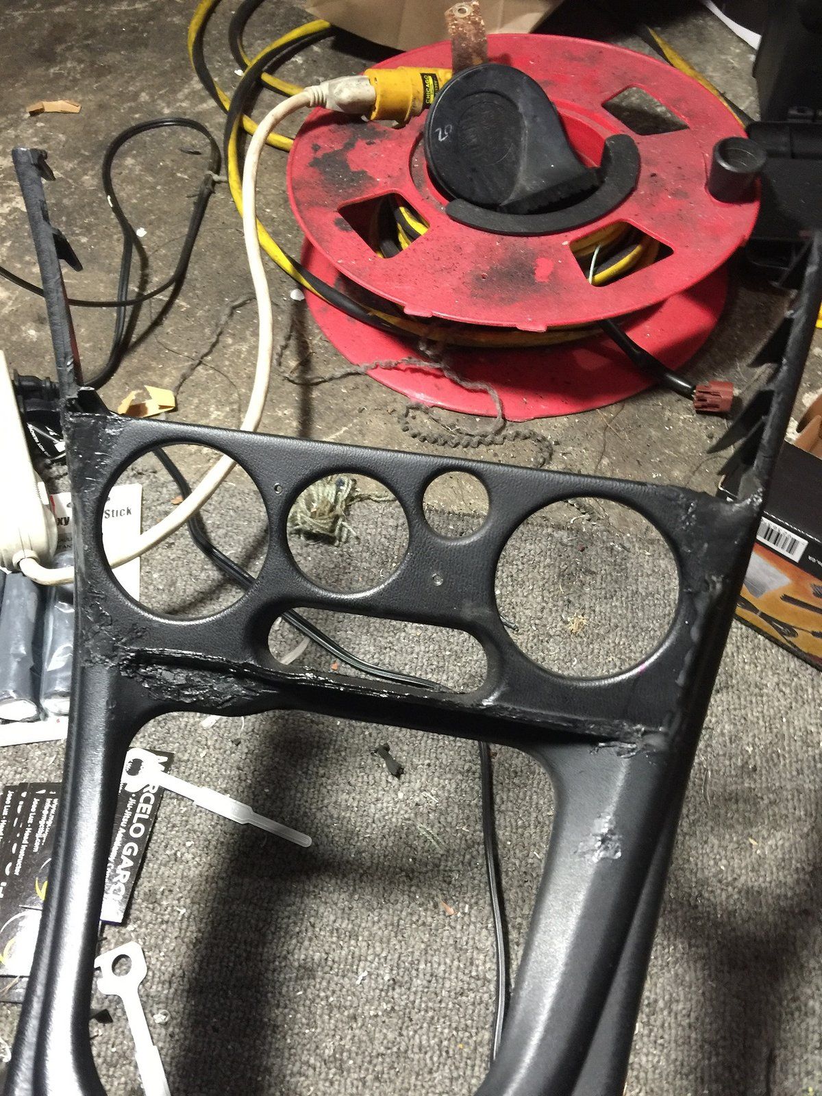

Do the cables for the heat and A/C controls reach when you relocate them down there?
i had to extend all wires and yes i used proper gauge wire, now as for the metal cables the only one that reached were the hot/cold one all the others i had to extend, i extended by using lawn mower metal cables same concept steel rob in casing but i was able to cut the casing and make my own ends and lengths so all my controls work as factory ROFL
