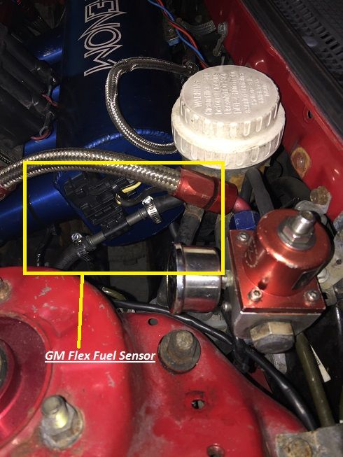

i still gotta finish the wiring for the flex sensor, those are the wires you see in the background (blue-red-brown) will be wired up tn, then i gotta set the setting in ecmlink

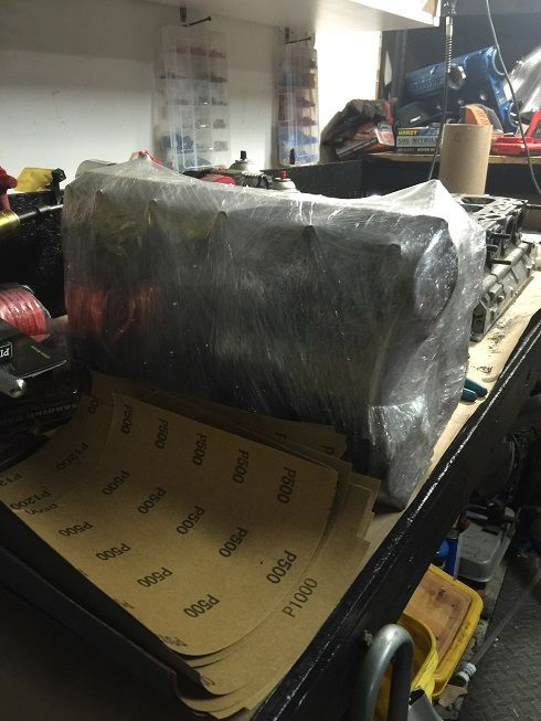

But again like the updates, still following and will watch to the death of me haha good work man loving the spray bottles in the background and all that clear wrap on the head.

What's the flex fuel sensor for? Can you switch fuels with out a re tune? I just haven't heard or read of those on our cars. But I never thought to look into it either.

yea thats the beauty of a flex fuel sensor its not just a tune for 93 or e85 but both, example first they tune with 93 then drain it then tune with e85 then they do a 25% 93 and 75% e85 the 50-50 then 75-25 ect, the best part is i can run either e85 or 93 or a mix of both and the sensor will pick up the ratio mixture and the tuning map will change fuel tables and timing and boost levels AUTOMATICALLY!!!!

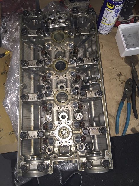

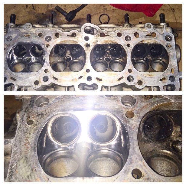

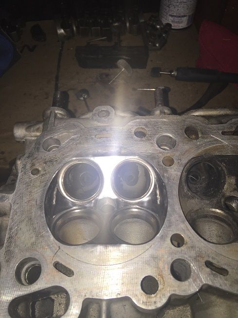

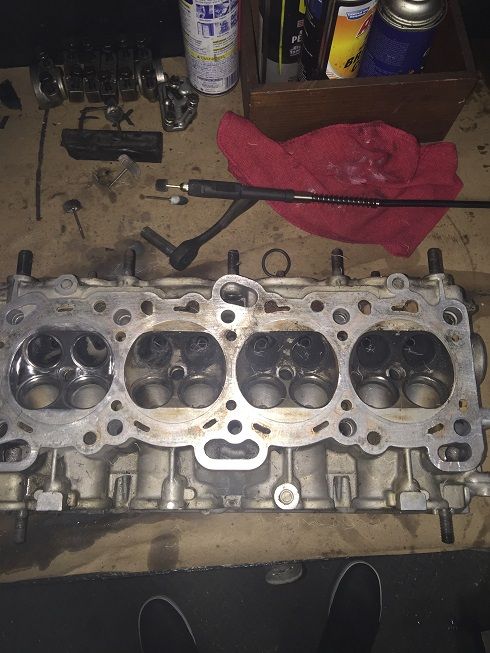

okay so my first project for my new head is to polish the valve area, reason less carbon build up and less chance of detonation and i will post a video of how i did this, ill make a how to on it so stick around and yea 3hrs work so far very tedious!!

its $125 for the upgrade ecu to full all done through email very easy and $65 for the flex fuel sensor and $10 for the pigtail here #1 ecu upgrade http://www.ecmtuning.com/product_info.php?cPath=25&products_id=55 #2 flex fuel sensor and chevy dealer will carry it! http://www.ecmtuning.com/wiki/ethanolsensorparts #3 the pigtail for sensor http://www.ecmtuning.com/wiki/ethanolsensorparts a total of $200 give or take a great upgrade
