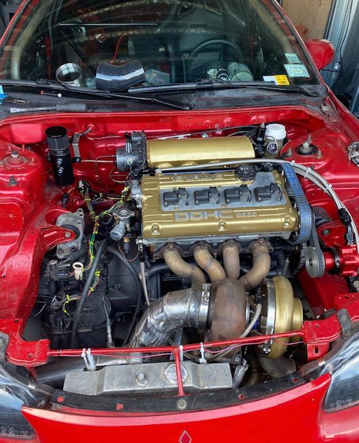

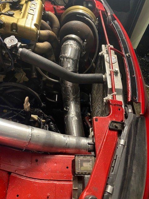

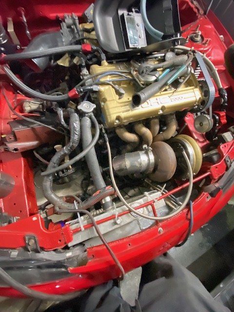

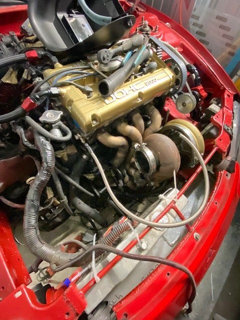

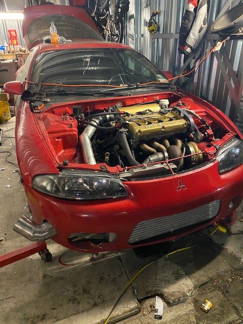

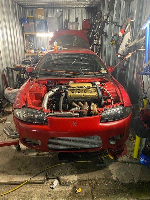

i got the driver side intercooler pipe welded up today! so thats all done now. this is a picture from today that i took, sorry the exhaust pipe is off, i have to finish welding it up tonight,

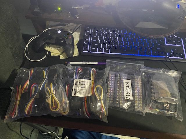

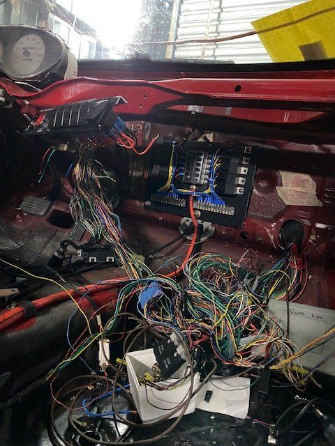

tonight's projects for the car.

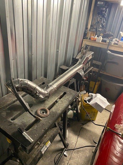

1) finish welding up the exhaust pipe.

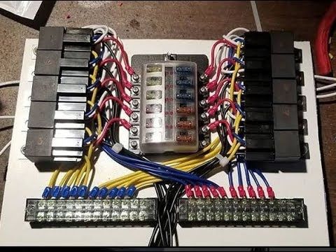

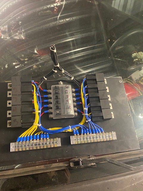

2) making a custom relay/fuse panel. this way i can get rid of everything thats not needed!
in the picture is 10x relays, a small fuse block, and 5x connector strips.
bottom picture is what i will be building******

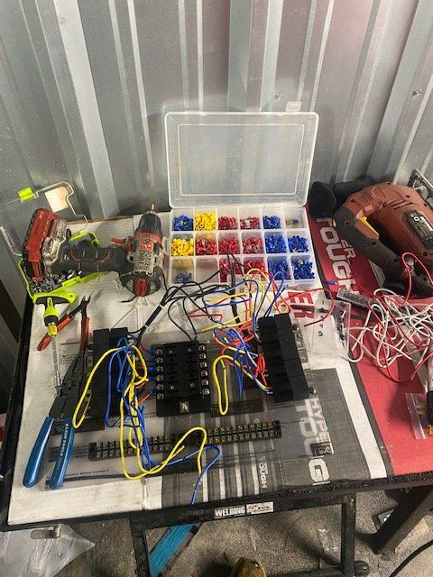

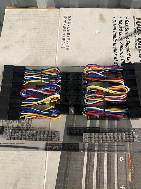

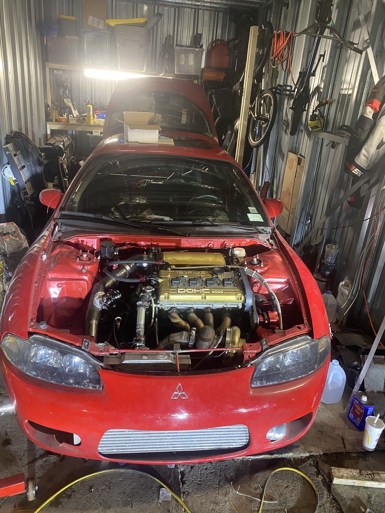

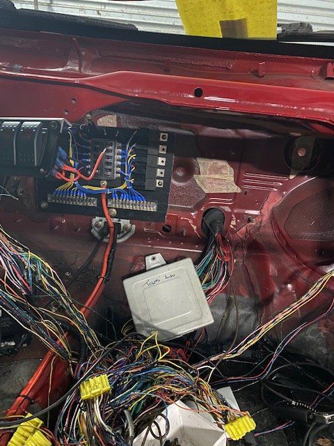

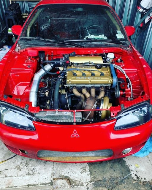

just got in. so i got the exhaust all welded up and added a bung for the wideband. and got my relay/fuse panel all done as well!
exhaust
and this is the relay/fuse panel

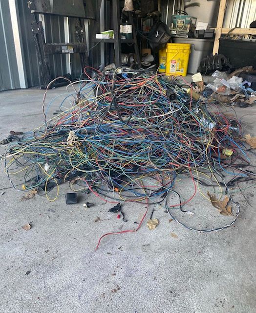

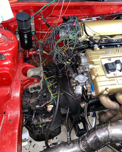

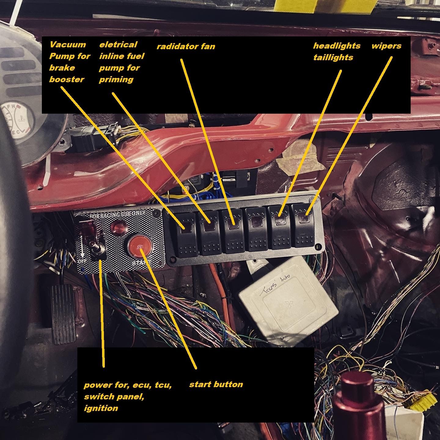

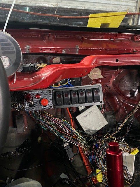

finally! got the engine and trans wiring done, i just have to tidy up the interior harness today
update.
engine harness done
trans harness done
external wastegate done
installed coil on plug and msd box
needs to finish
interior harness (tidy up)

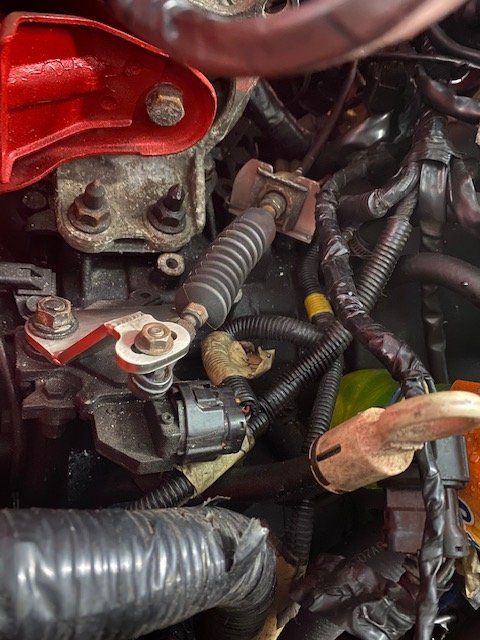

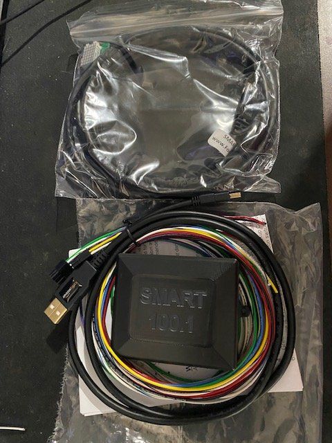

shift box (need to order still) ORDERED A SHIFT 100.1 WAITING FOR ARRIVAL)
