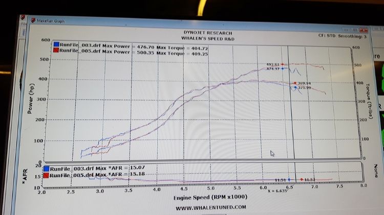

Took the car to John at WSRD Saturday and the car made 500/409 on a stock 6 bolt at 28psi on e85. It had more in it but old plug wires held it back up top. Overall I'm very satisfied and the car pulls well for just an fp green.
Good to know someone made 500hp with the FP Green. Completely stock though??? Not even aftermarket cams? If so that's impressive. Here I thought I would have a hard time reaching 500 on e85, GSC S2 cams with a ported head and a bump in compression. You have given me hope.LOL
You have a dyno sheet Tyler? Interested to see where yours makes power. If your Green spools like mine that's going to be a pretty wide powerband compared to other 500whp setups.
I should qualify further discussions by saying my turbo isn't an off the shelf green hta....it's been ported to fit a gtx30r billet wheel. Flows closer to a red now. If anyone is interested I can type out all relevant bolt ons as well.

You should change the thread title. Huge bit of missinformation.
I thought FP used to make a turbo with the red compressor and the green turbine? Wasn't it called the Green XL? That seems more in line with what your doing here. I agree its still very impressive to get that HP out of that hot side. Good Numbers!
What RPM do you start to spool?
4-4.5k is when things really start moving in 3rd. This is an ideal street car turbo imho. I don't feel like I'm beating the piss out of it just to leave a stoplight and having the external dump open every 20ft like it was on the 16g, but it doesn't lag enough to where I feel like I've got no torque on the street.

You made some good power, no doubt, but not on an HTA green turbo.
Agreed. Given the rushed nature of my initial post I thought it unnecessary to spell out that it has a gtx30r 11 blade billet compressor wheel fitted. Especially considering it only adds a few lbs/min. Hopefully any ambiguity has been resolved.
