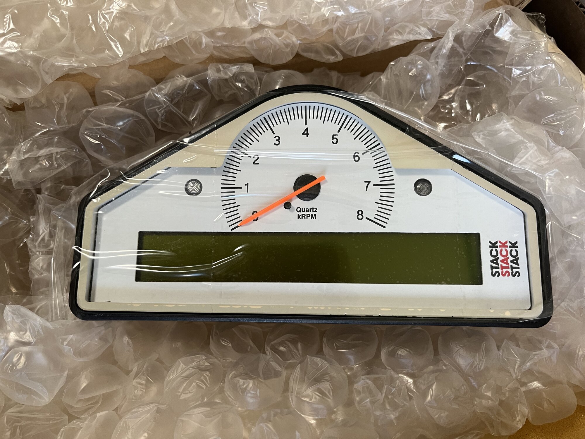

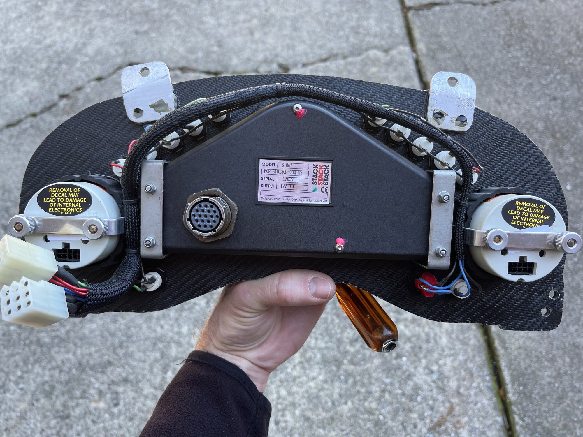

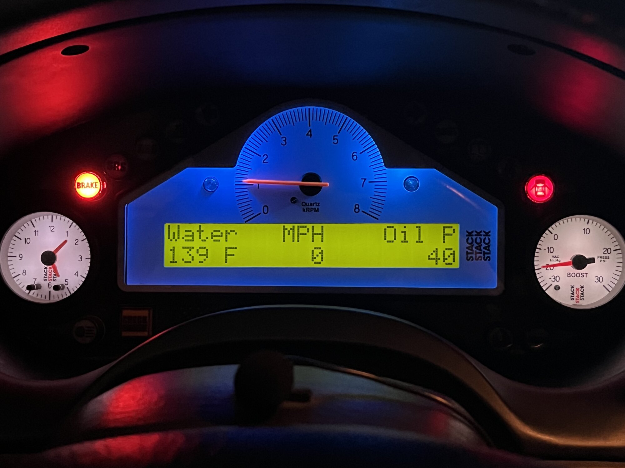

Yeah! I have a dash again! - but I’m annoyed. They didn’t do what I asked.
bolt that back on
Squeeze the assembly back in the dash, working around the edges to try and plug everything back in before bolting it down
The LED were supposed to have been swapped out for white ones. It looks exactly the same as it did when I sent it to them except for the fixed needle - which is fluorescing. hmm , thats new.
i’ve complained, we’ll see what they say.
open
closed

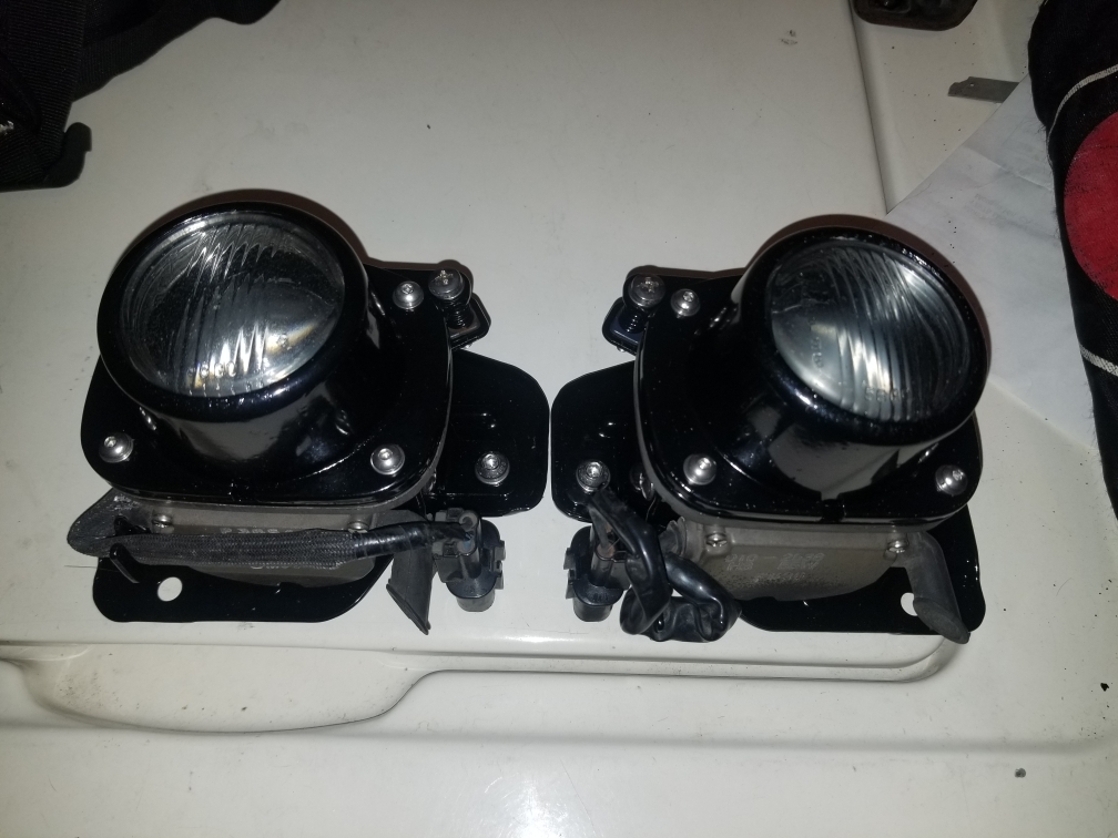

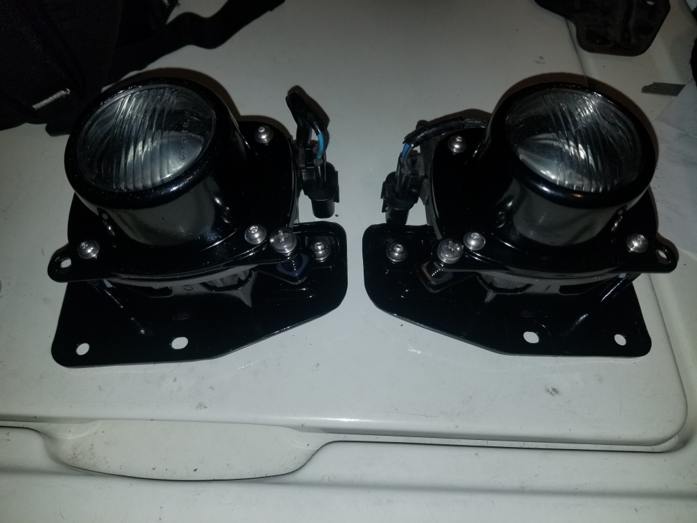

I wonder if the fog bezel would look better as grey/silver, or finish them with trim black/satin… hmmm

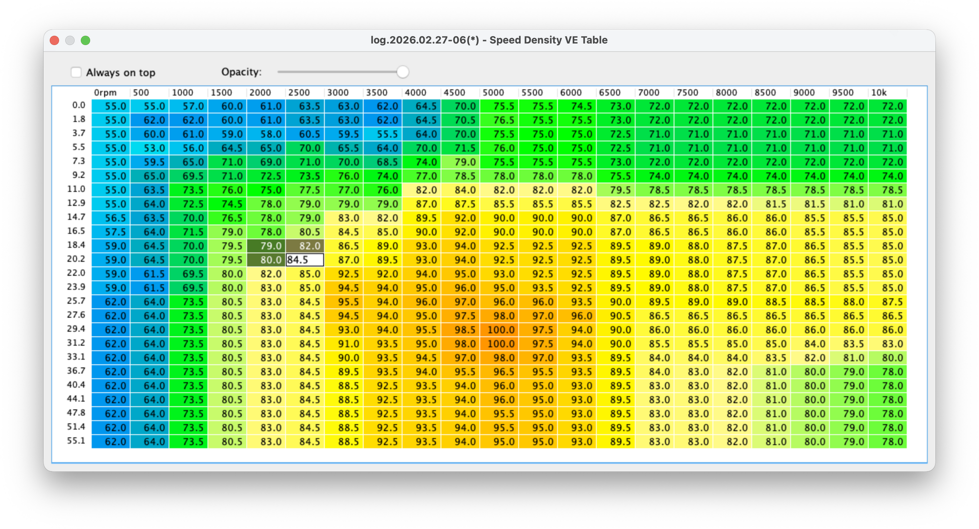

Had to look up in my STACK notes for the Vehicle Speed and Fuel Level sensor calibration data - ran the procedure to plug the values in and then - ya know, a test drive.
I got into 3rd WOT on a hill in the on-ramp and it dragged out the whole bottom end. I've not had data in this area of the map - I think I'll use it.

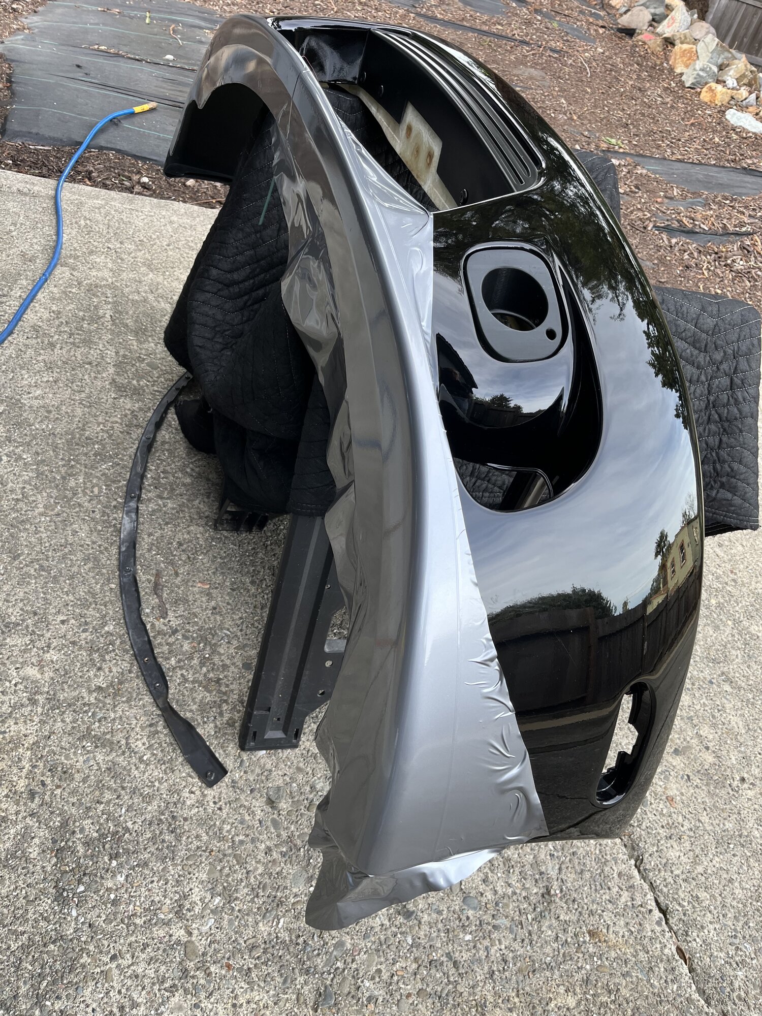

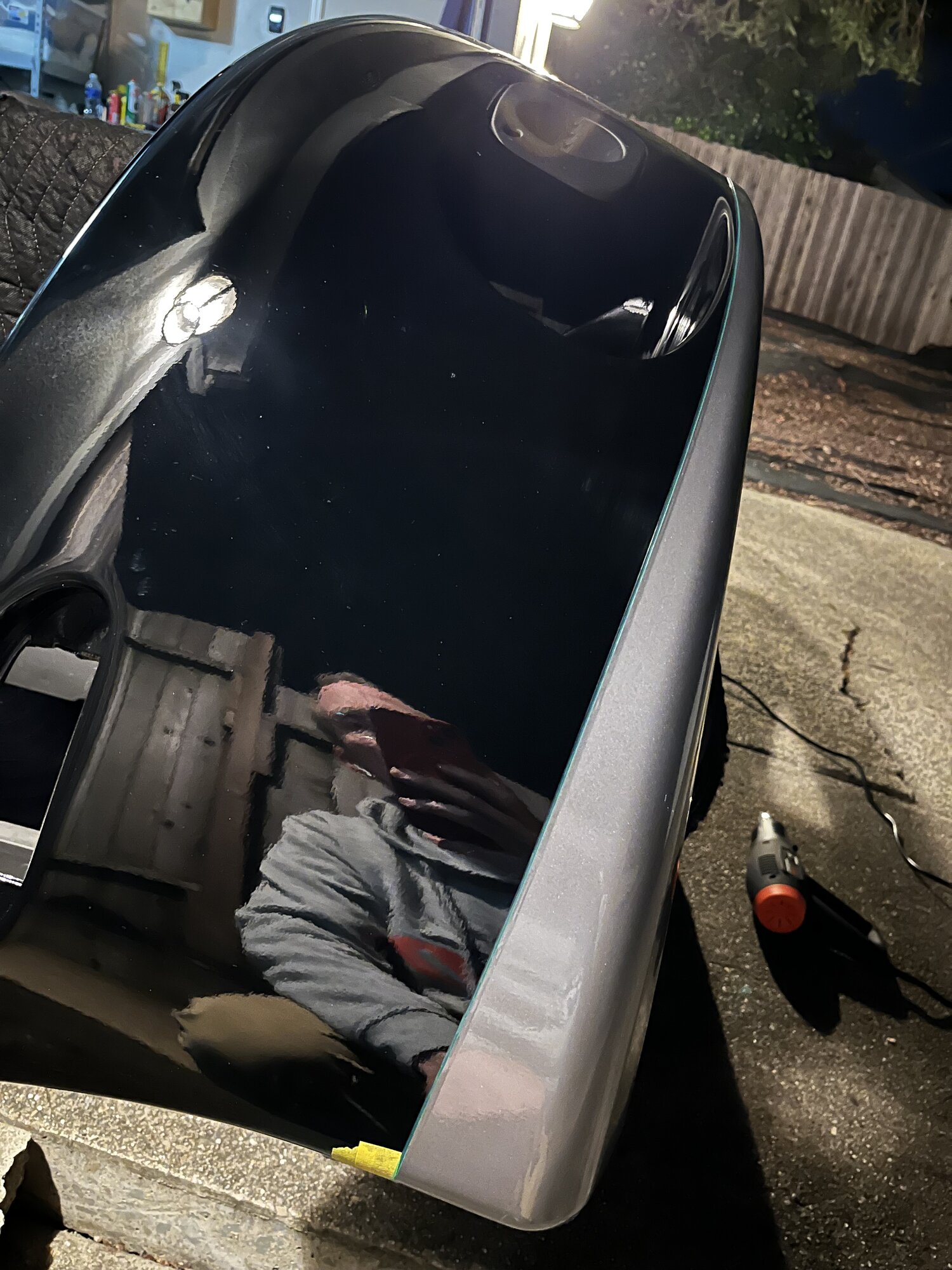

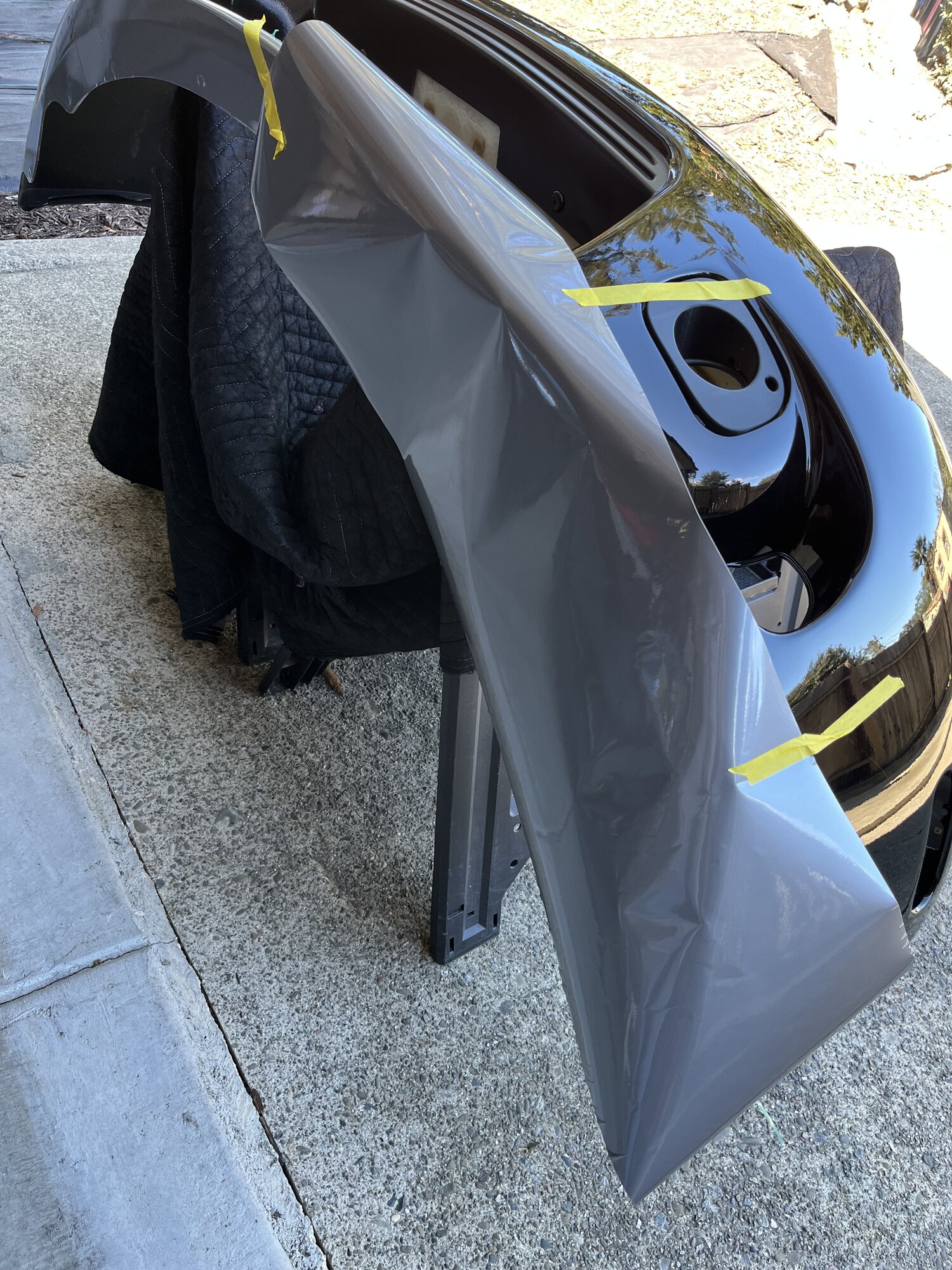

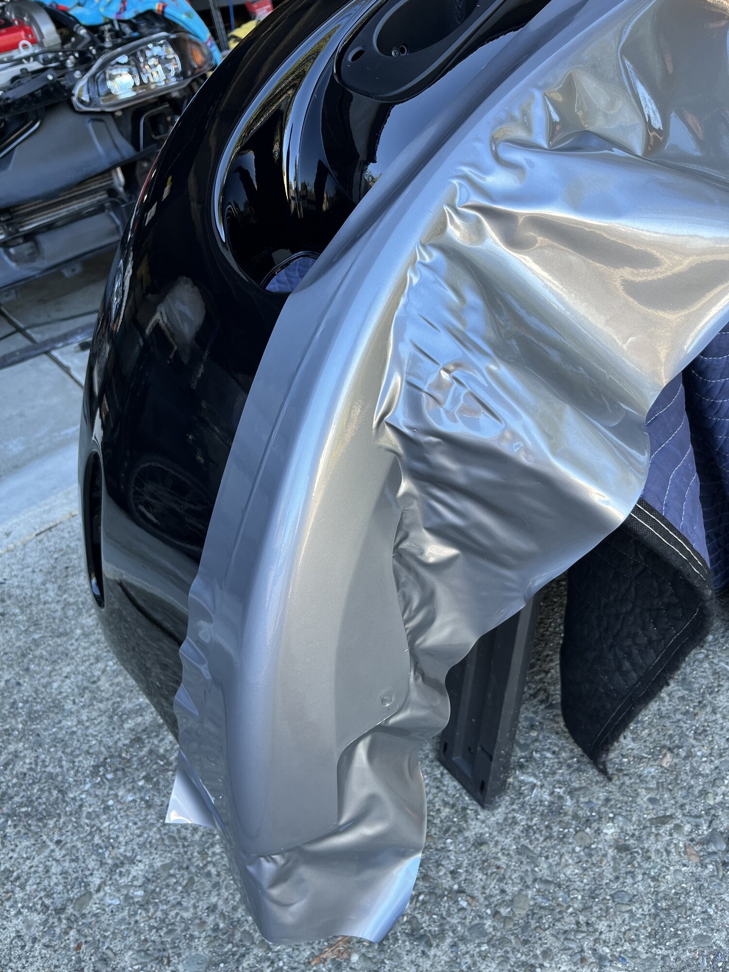

Had to wait for the wind to die down in the early evening.
Side 2

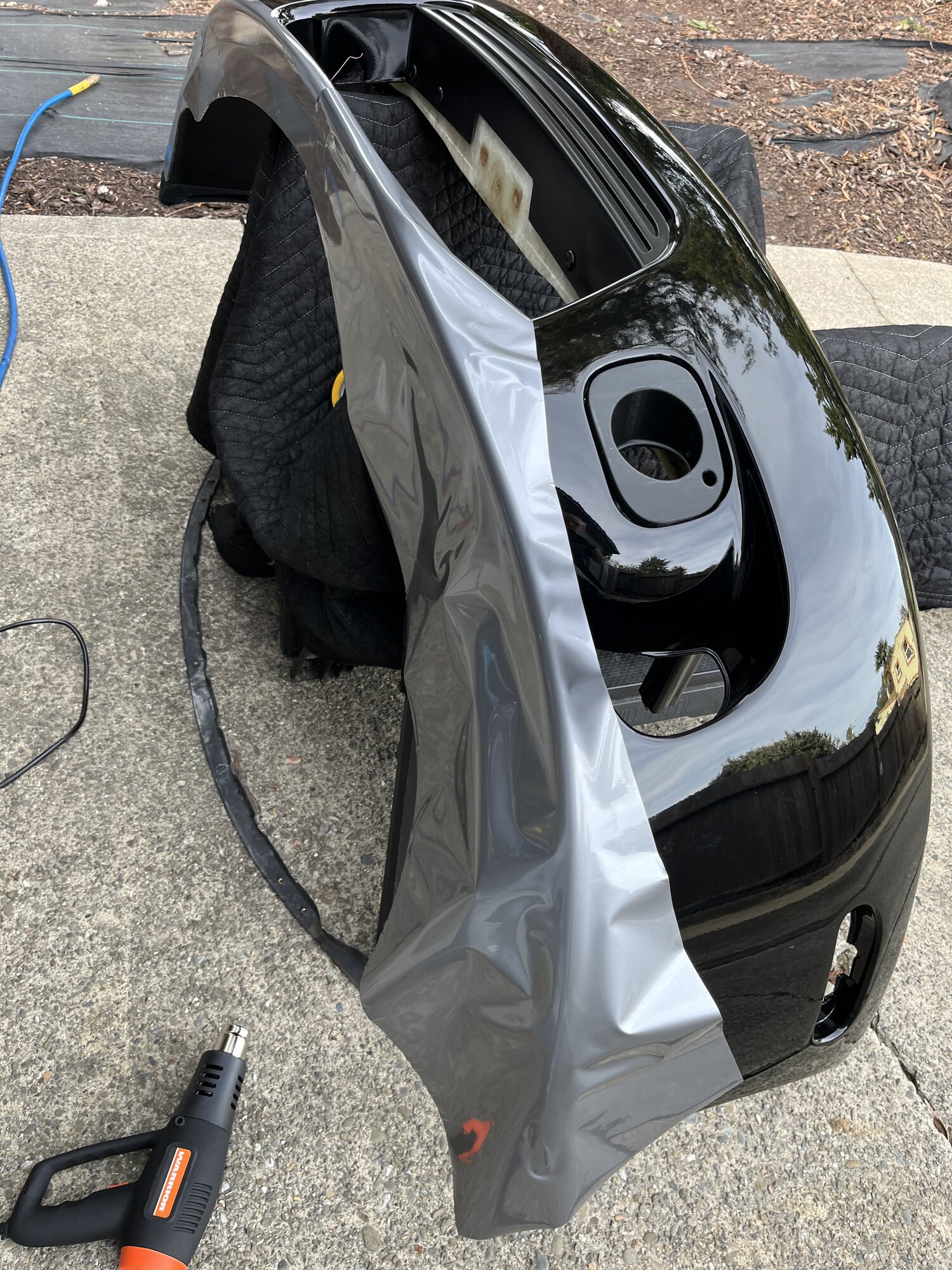

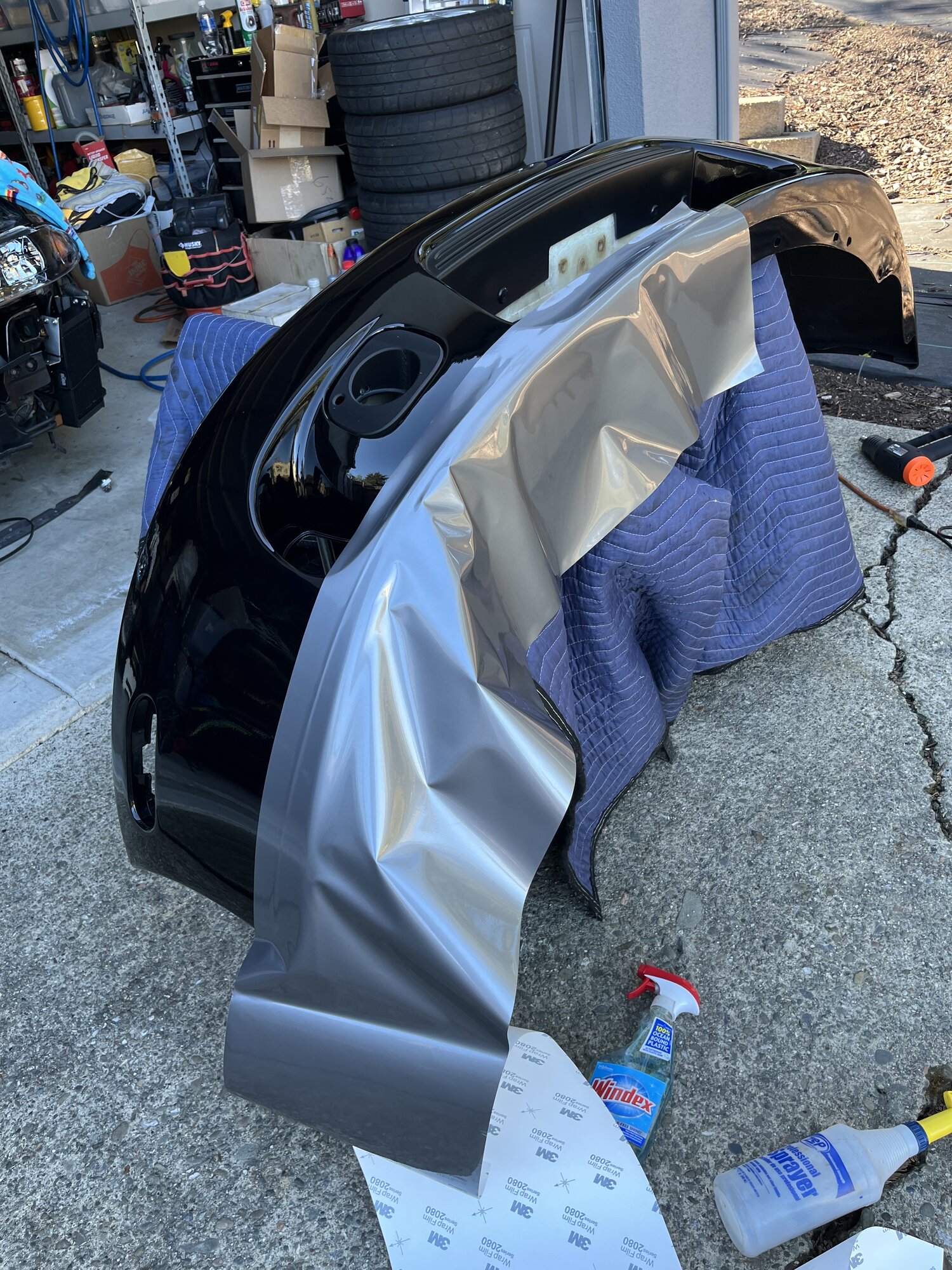

This time, I’m going to try and let the material lay, and from a large space, stretch into some smaller areas. Its easier to stretch than shrink

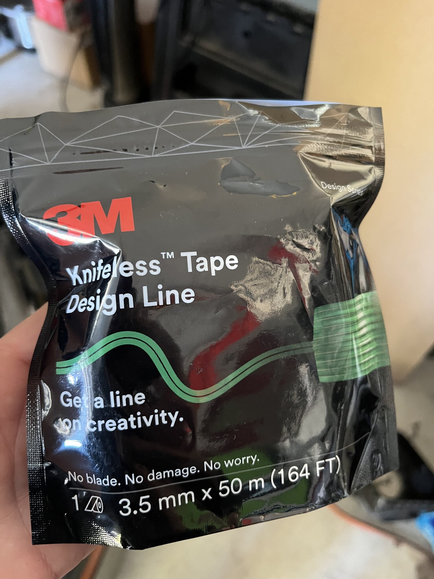

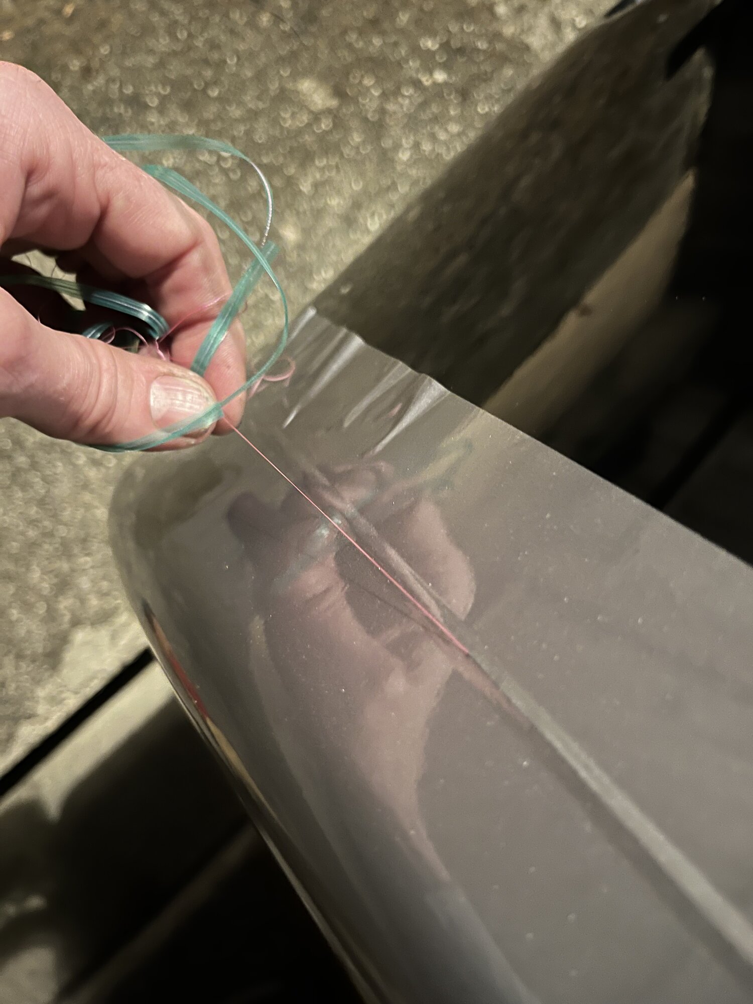

Getting the thread started cutting in the knife-less tape takes a bit of dynamic effort to get it going. This time I started it, before laying the silver down, thinking if i broke the thread trying to start it, and had to re-tape it, i wouldn't have to scrap the vinyl due to a failed cut start

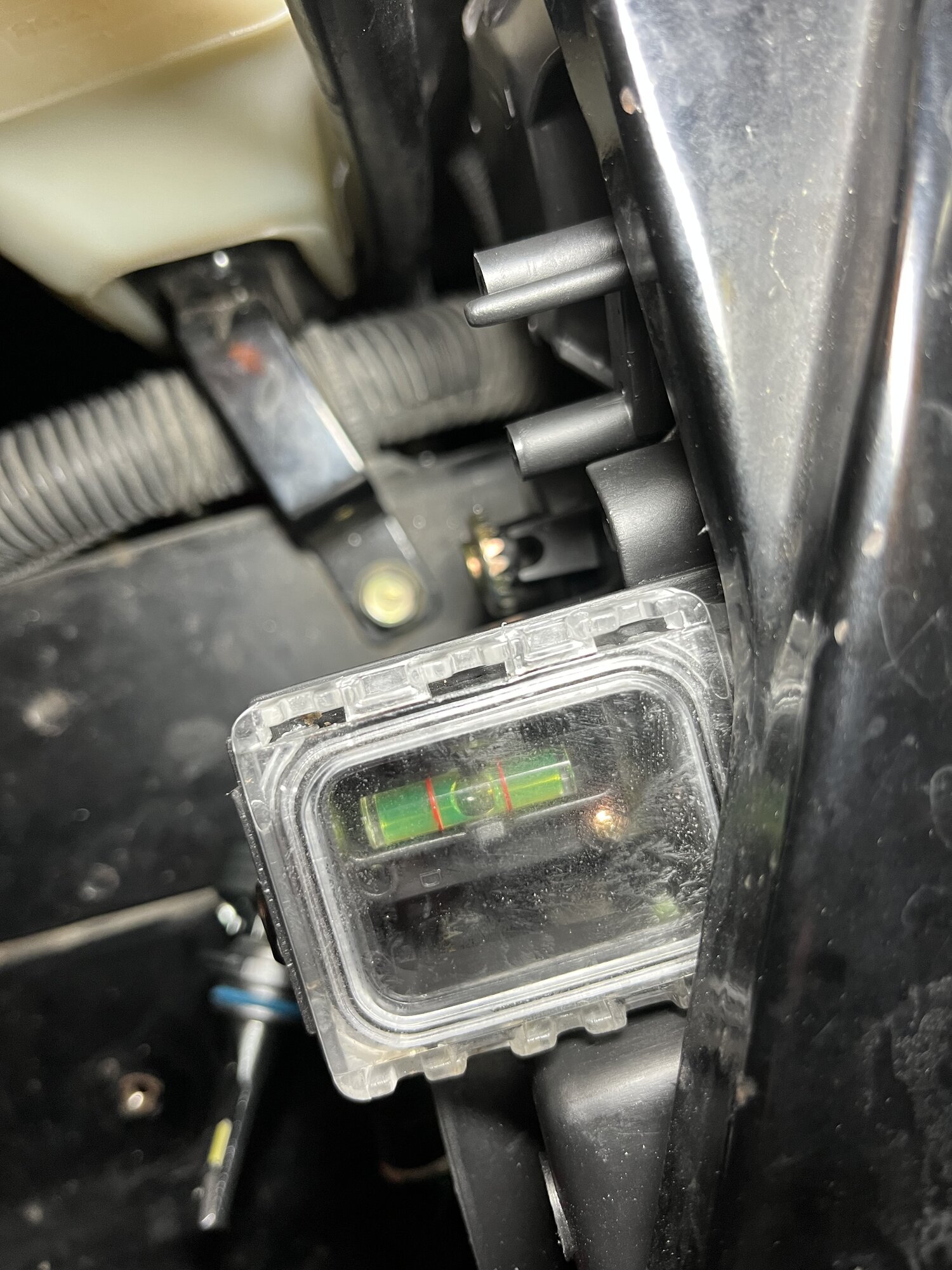

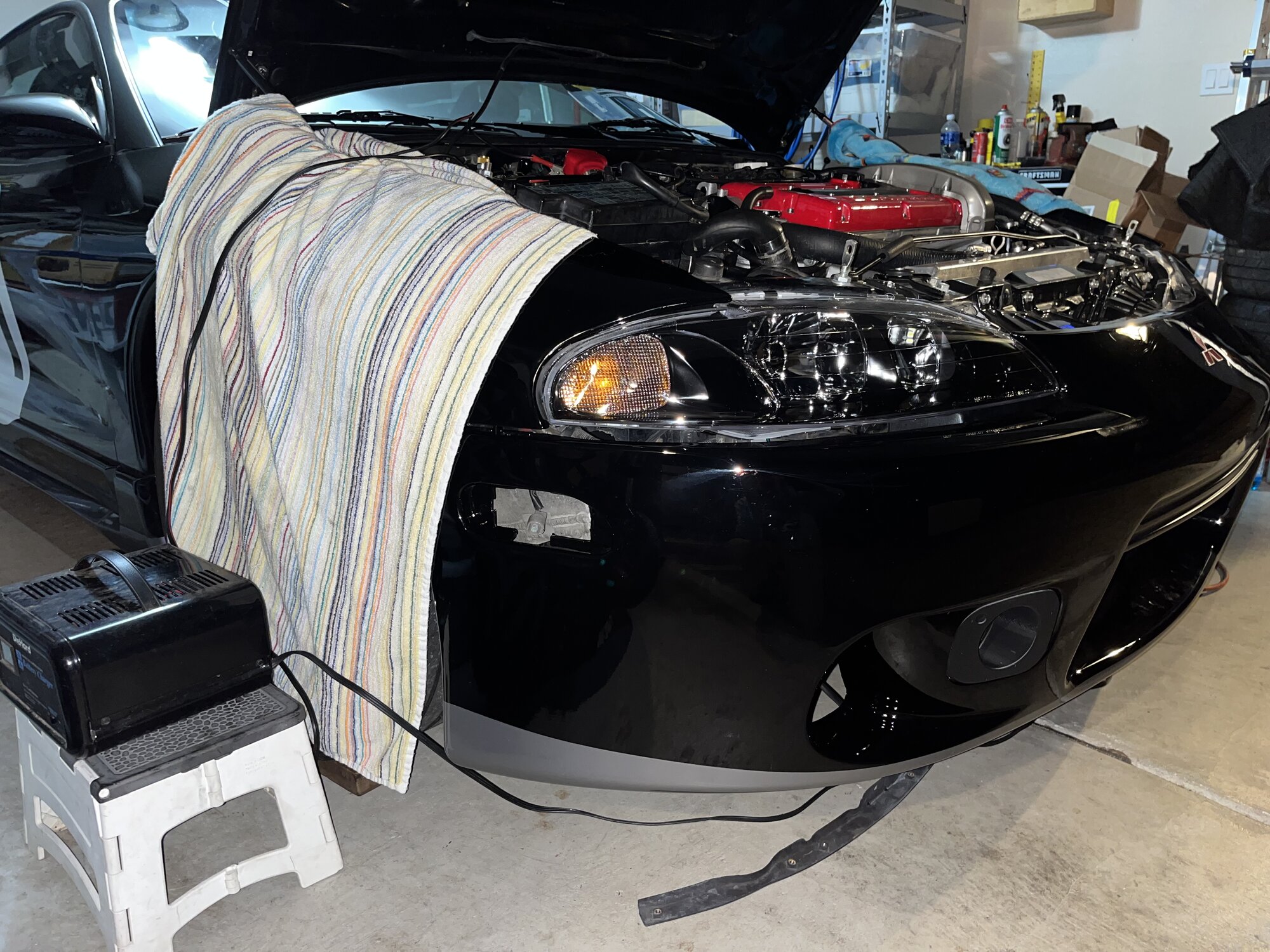

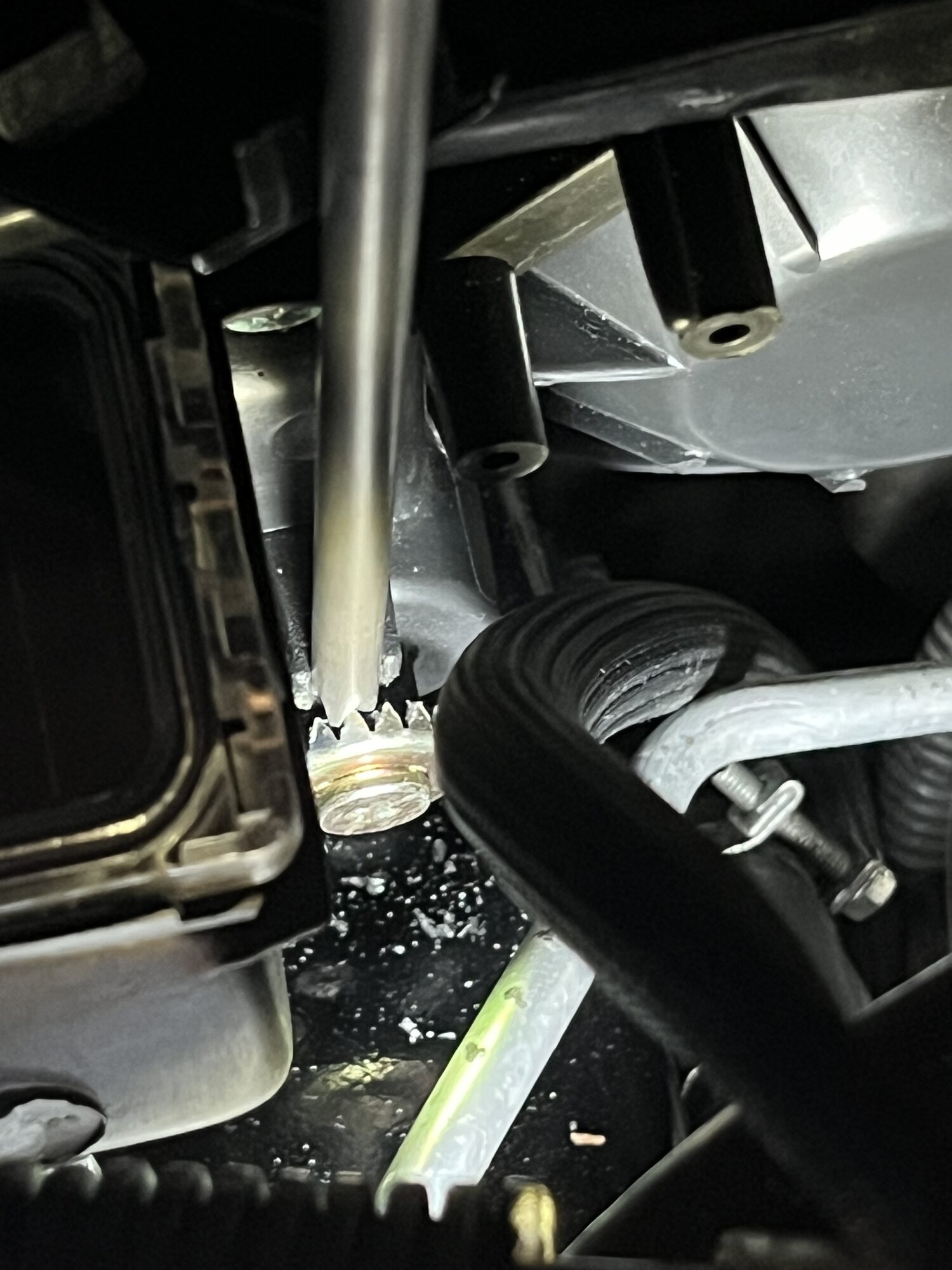

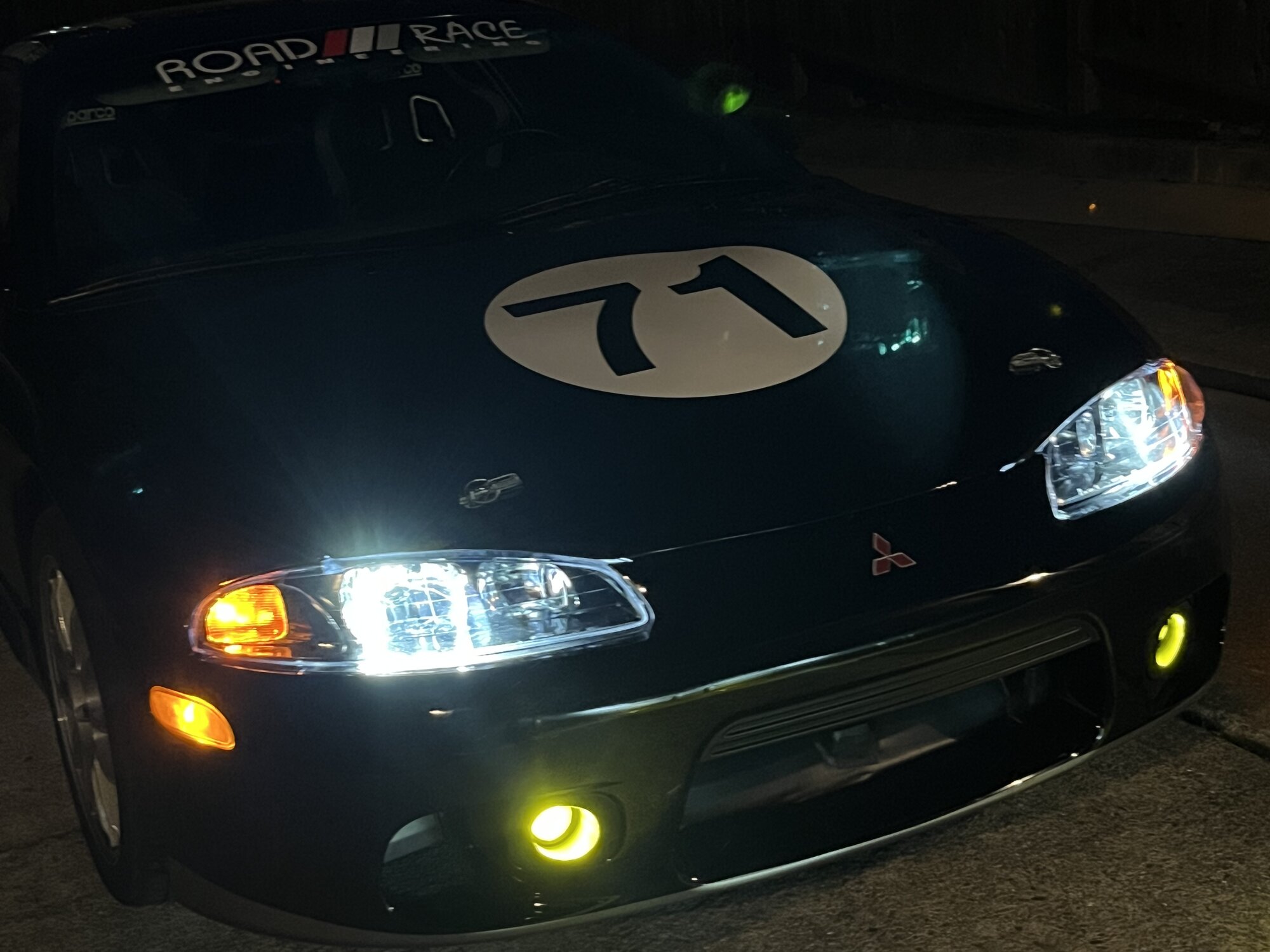

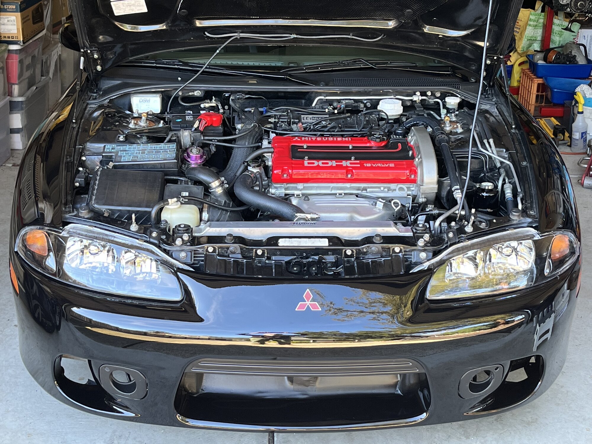

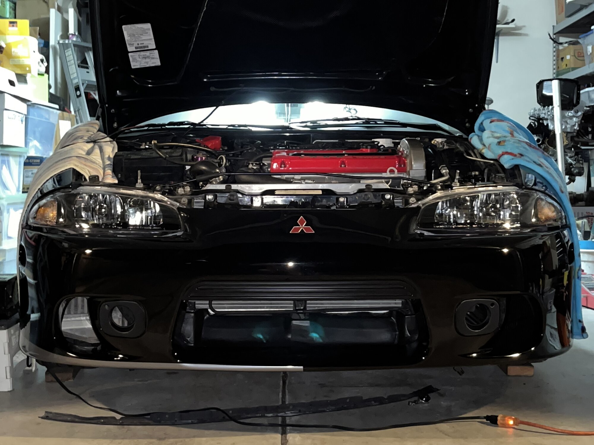

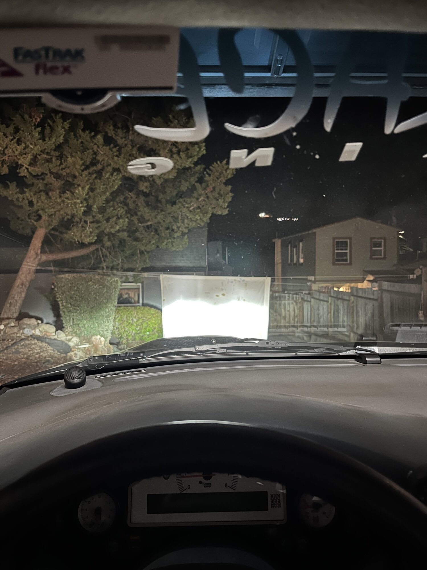

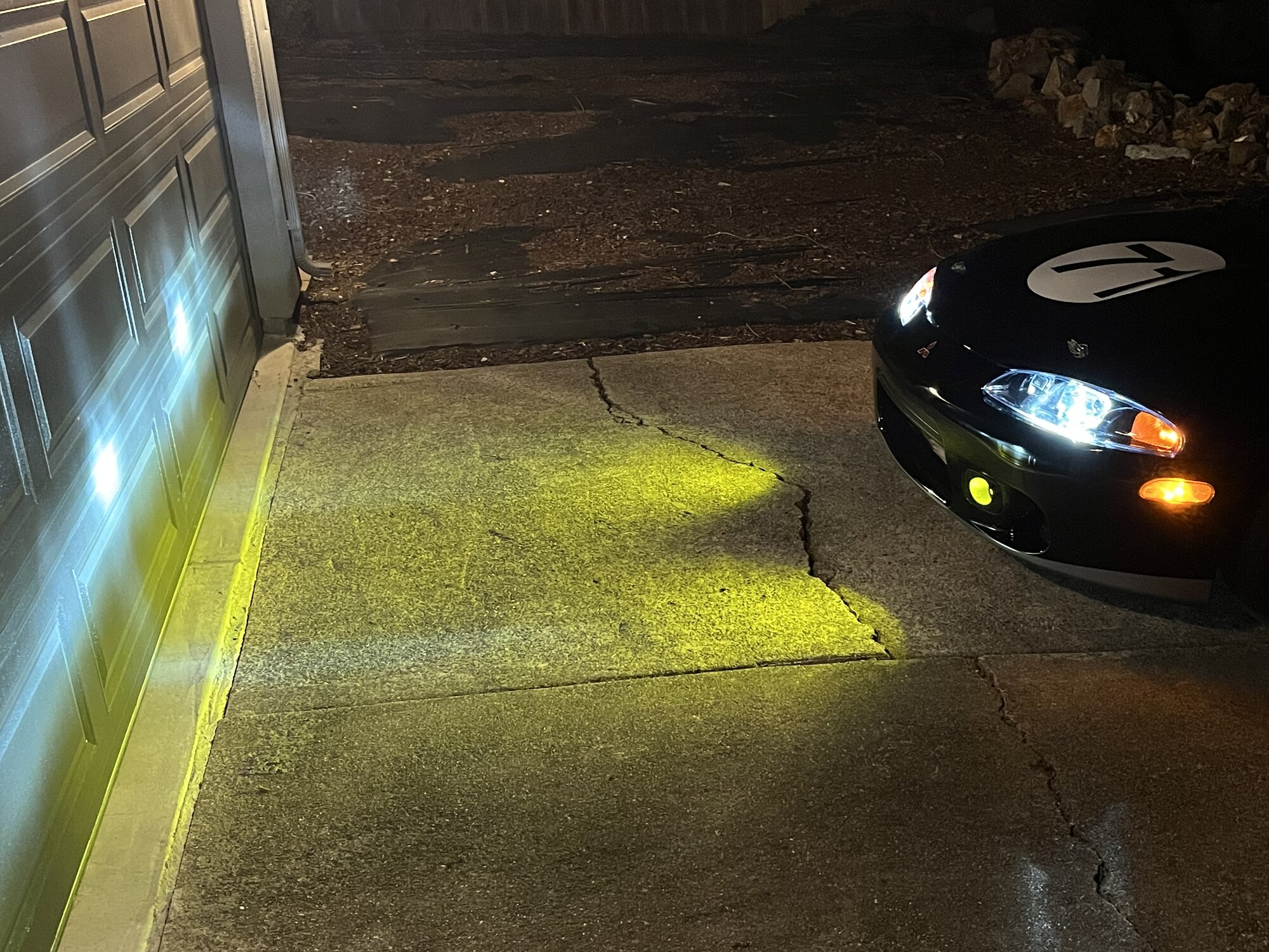

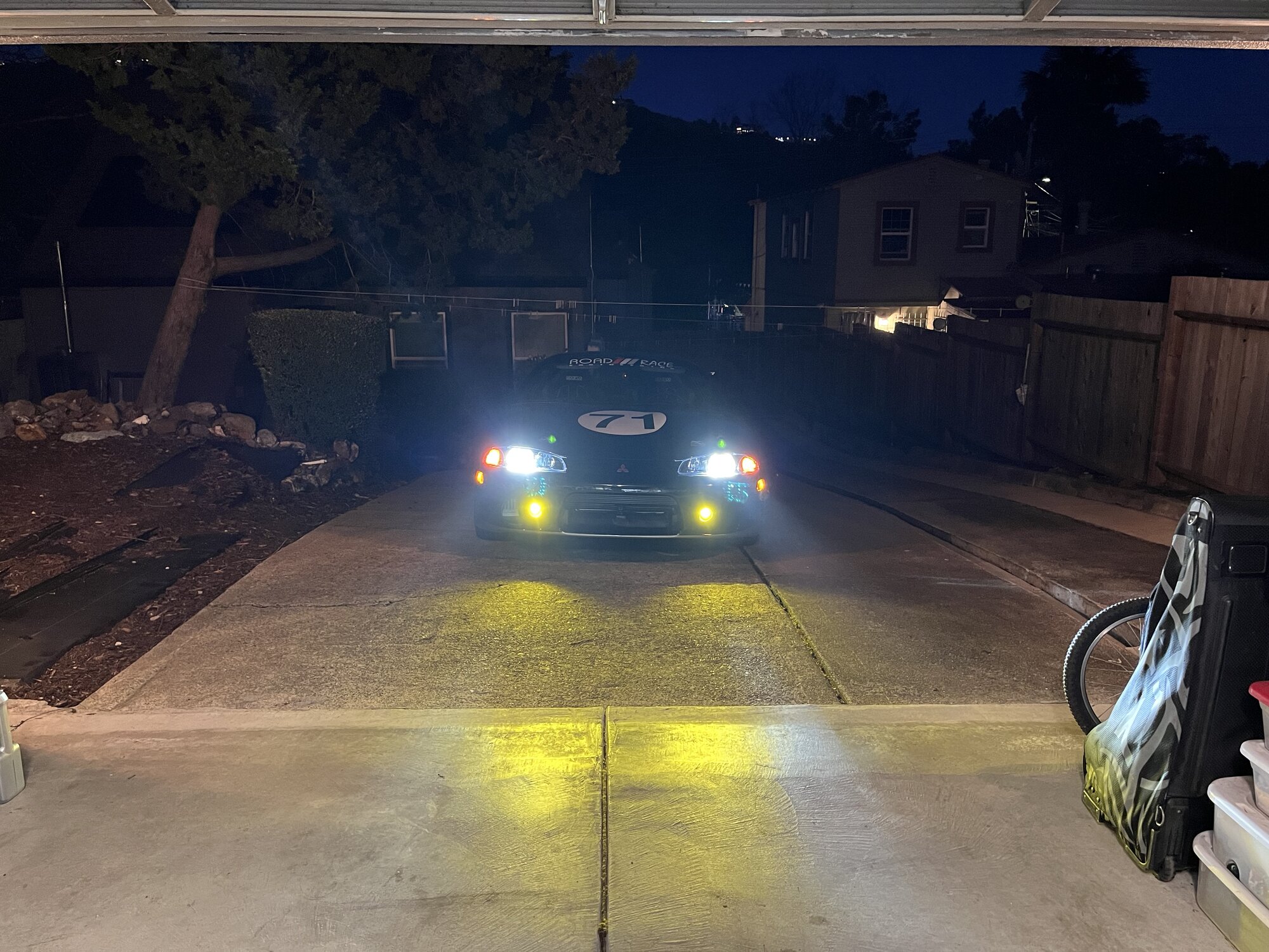

I am this many years old - and just now learned you use a long Phillips screwdriver to spin the headlight adjustment wheel
The levels on these Taiwan Eagle Eye headlights are bogus- I leveled the car, then pointed the lights, then bent the levels until they were reading level. LOL Calibration complete!
Ding - your adventure log has been updated.
Side Quest - Aim your new headlights - Completed!

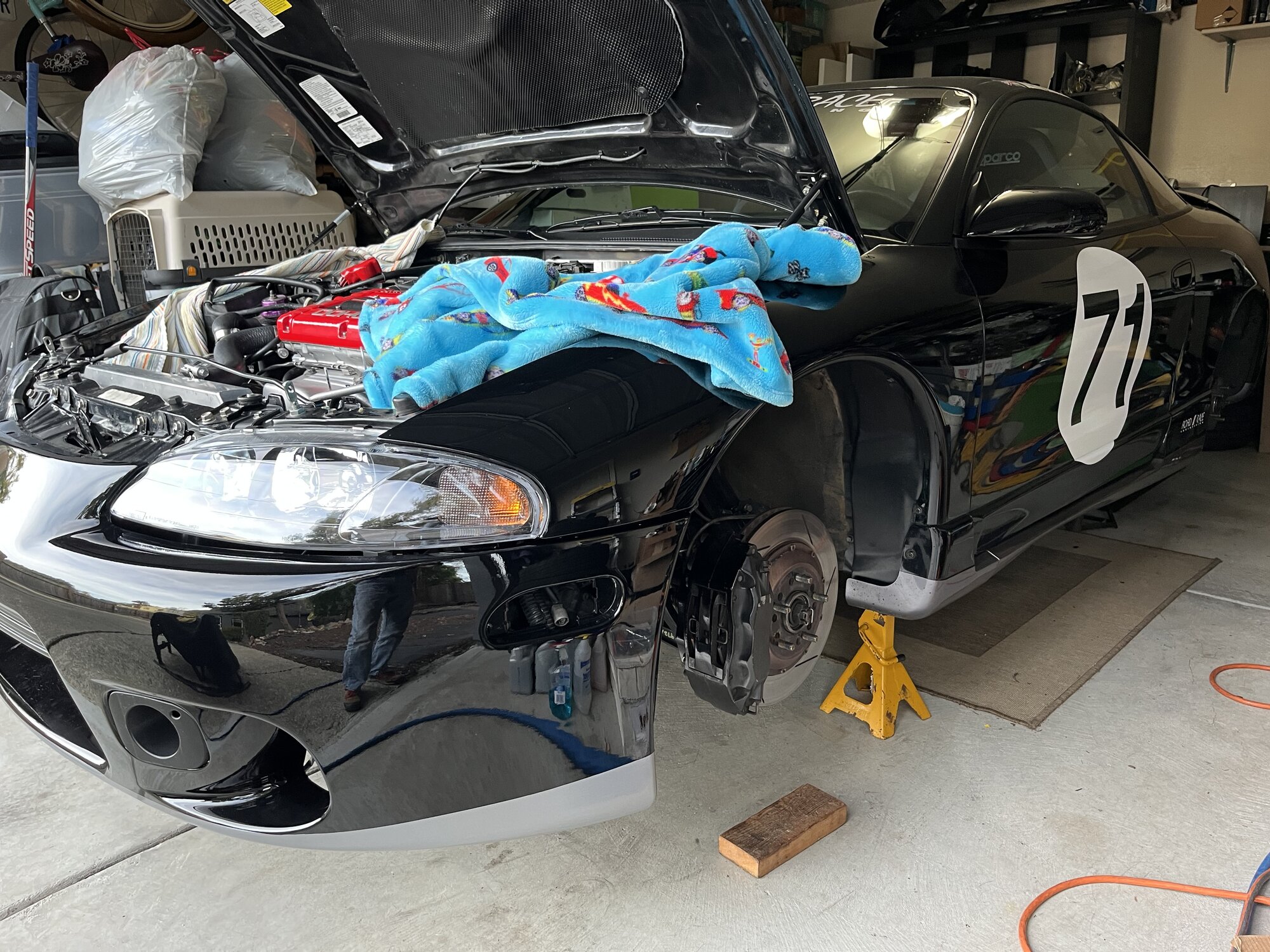

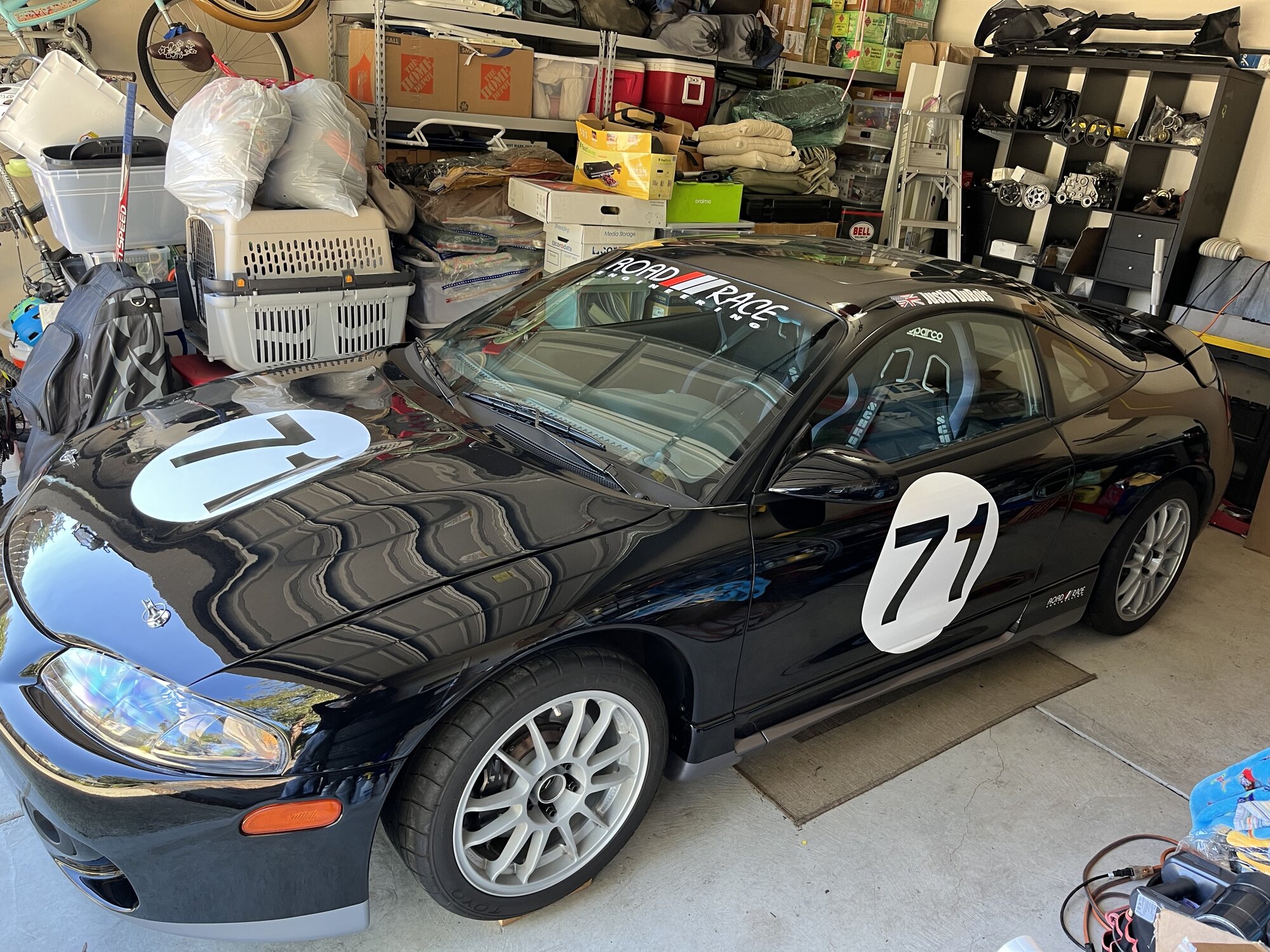

Back at the track, this time I drove the DSM 550 miles to Nevada today.
To prepare, I did a little extra and checked gearbox fluid level (was overfull) and always top off the transfer case (took two pumps)
Rear diff was dry and dusty, no indications of fluid leaks so I didn’t touch it.

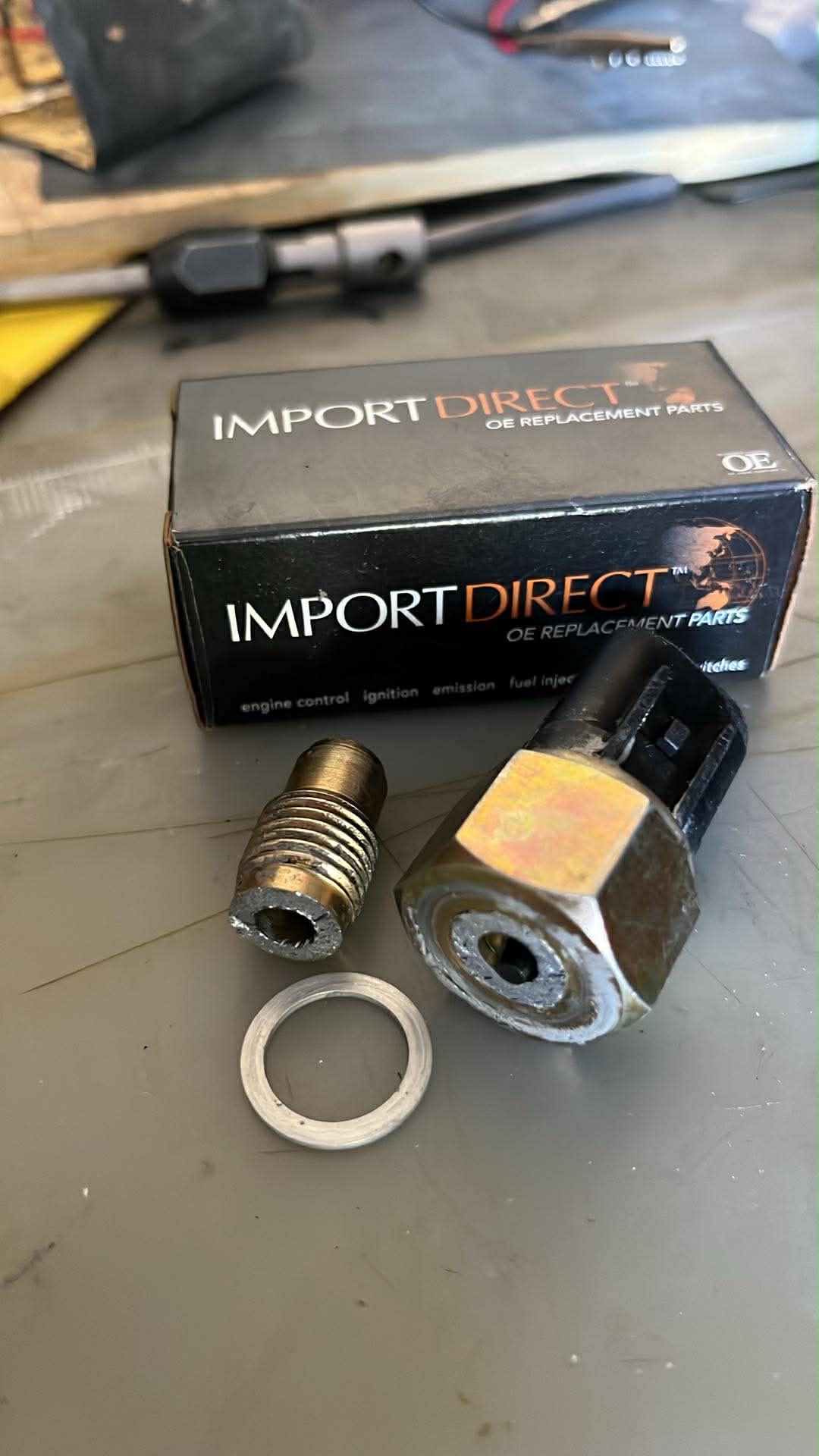

I did mess with the backup switch, trying to seal a leak, and you saw how that went! There is a risk of over-preparing, and introducing a problem where one did not exist. I think I found the edge of it.
Killed a bunch of bugs. Everything working.
