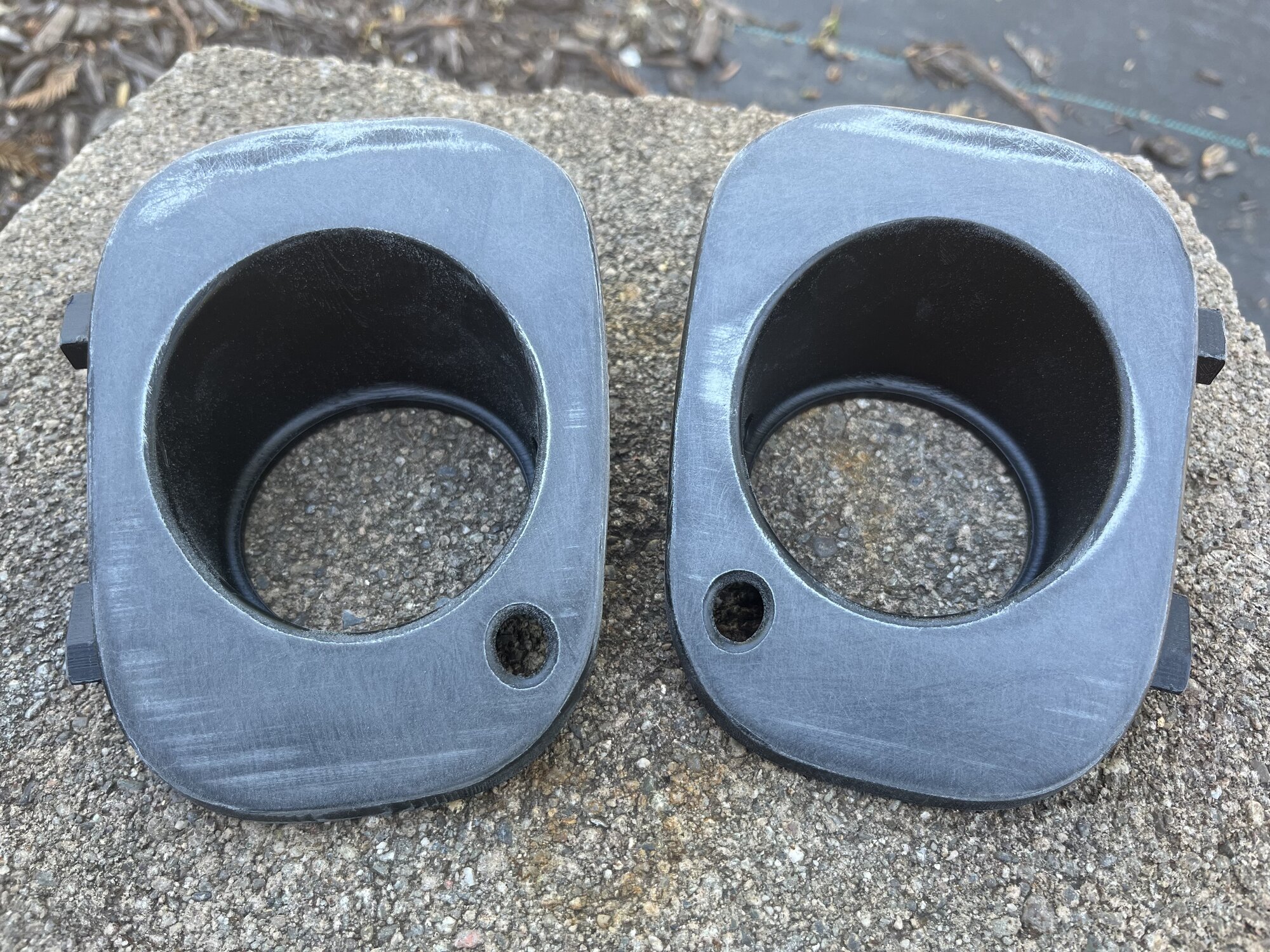

Color x1Maybe a little body filler would make the lines disappear. Don't need much, just a little.

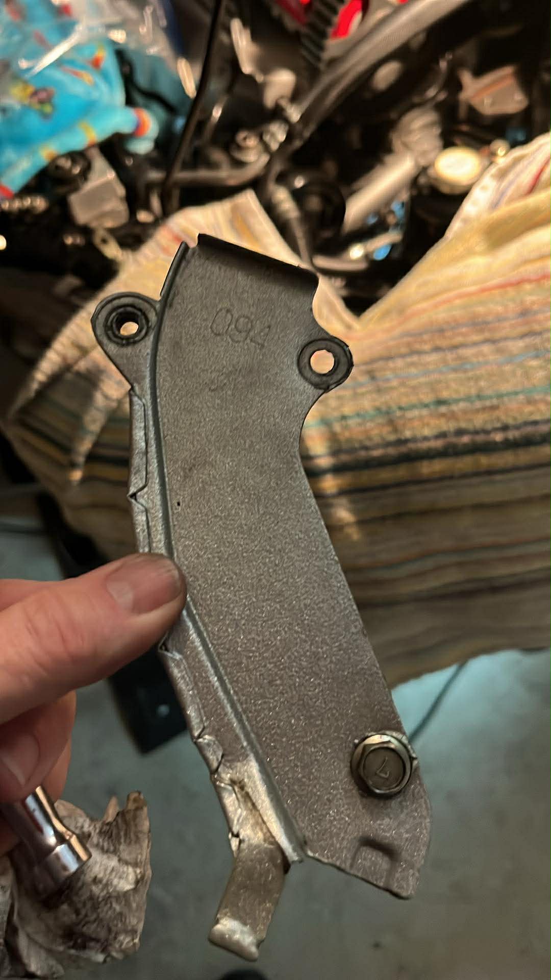

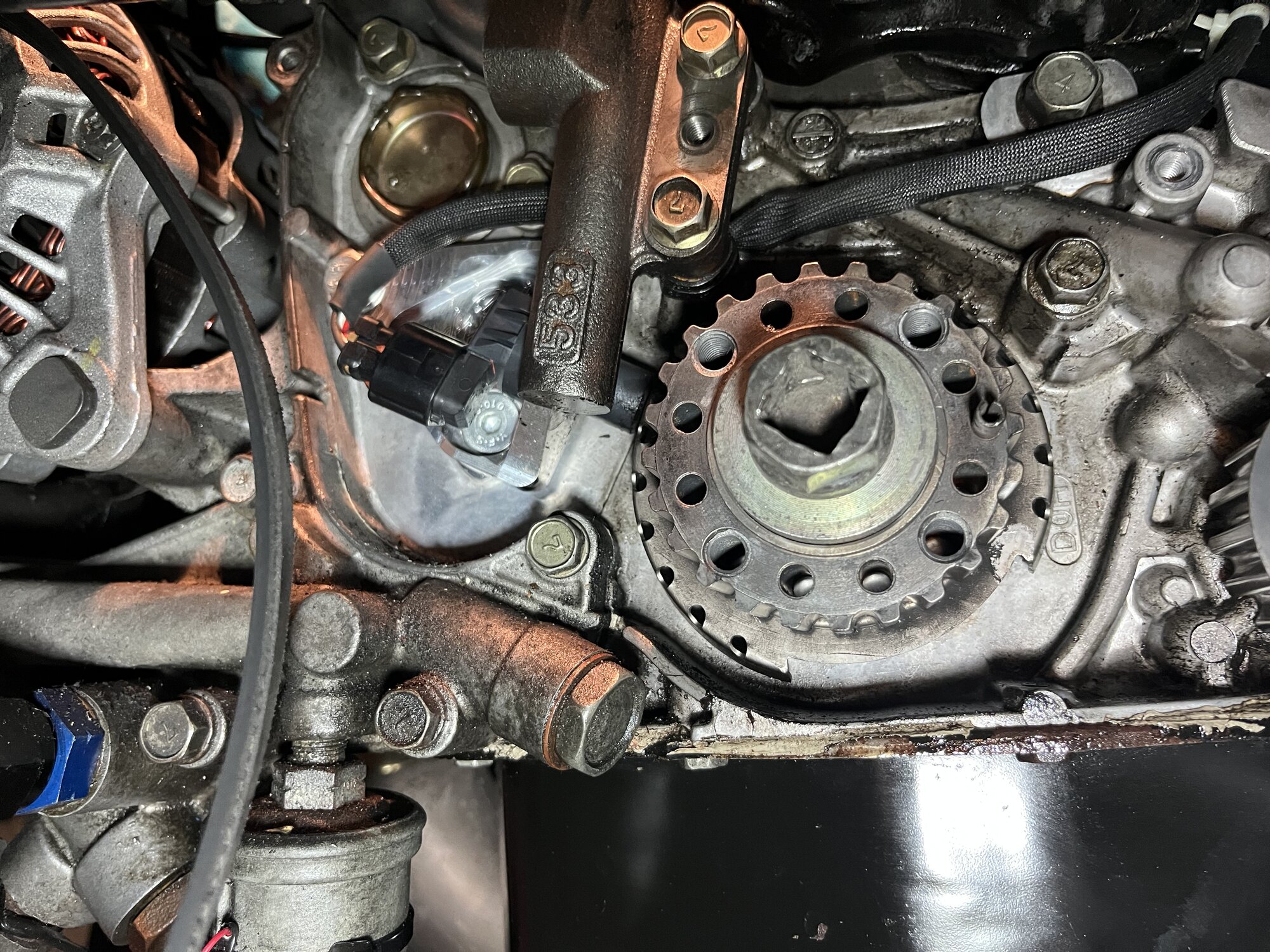

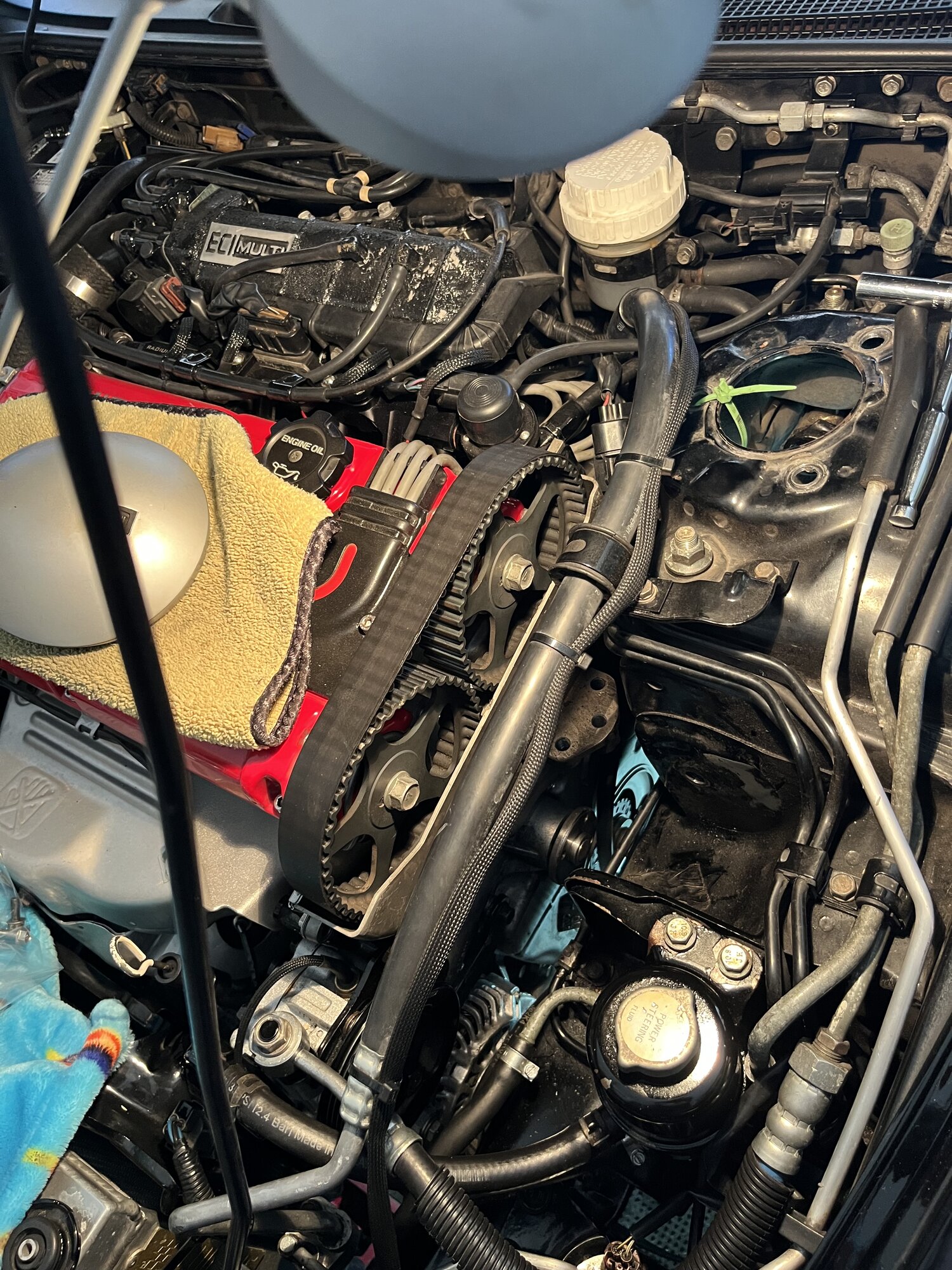

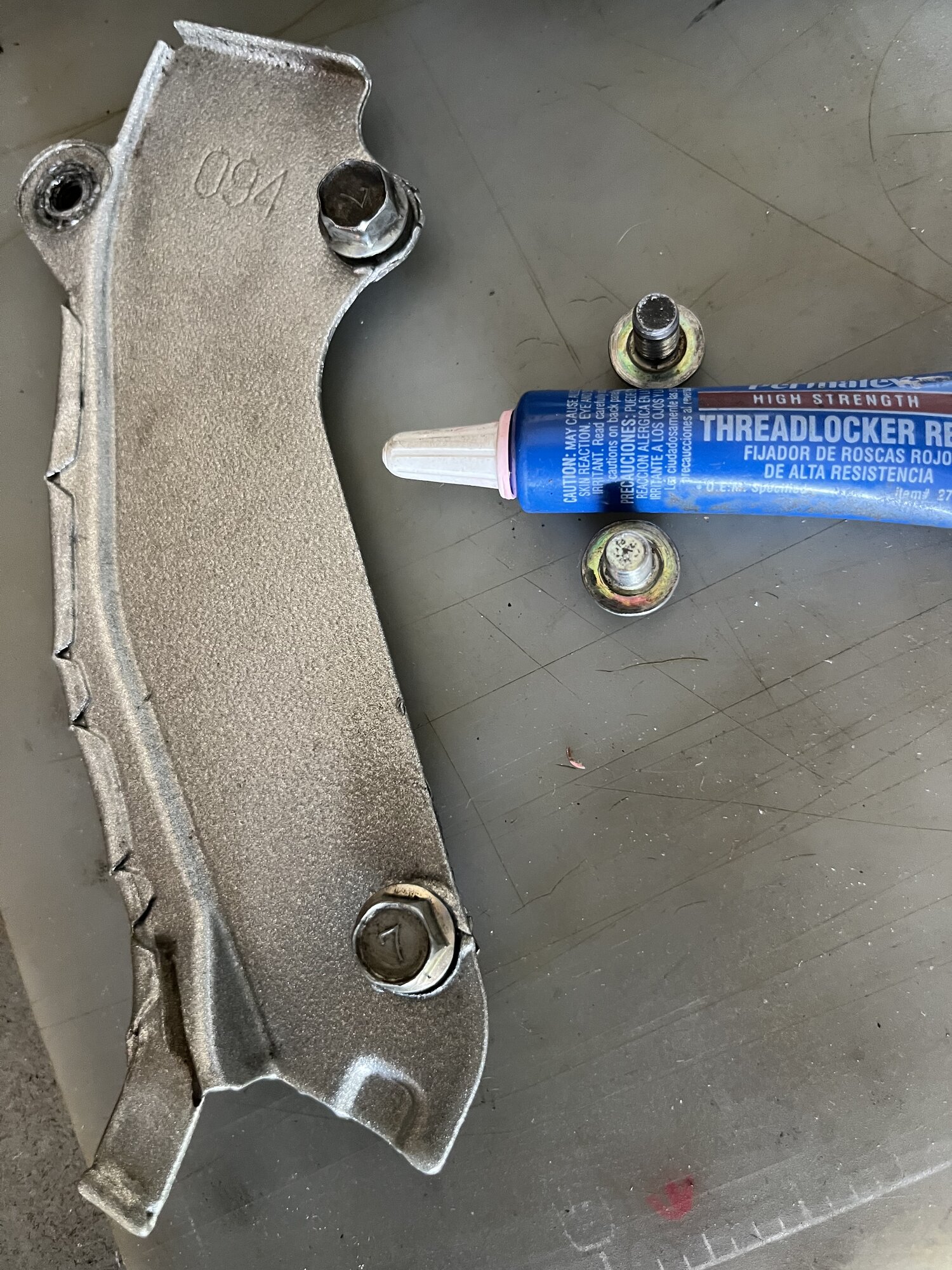

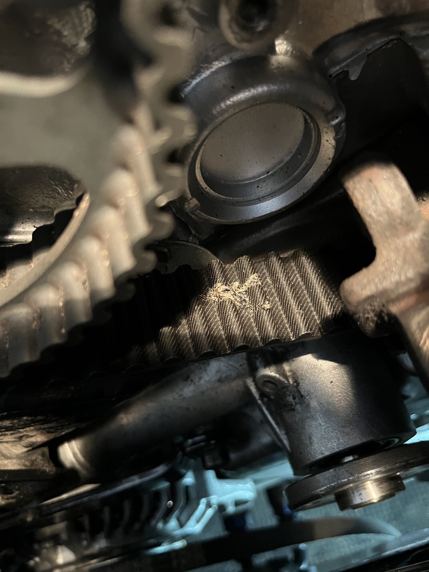

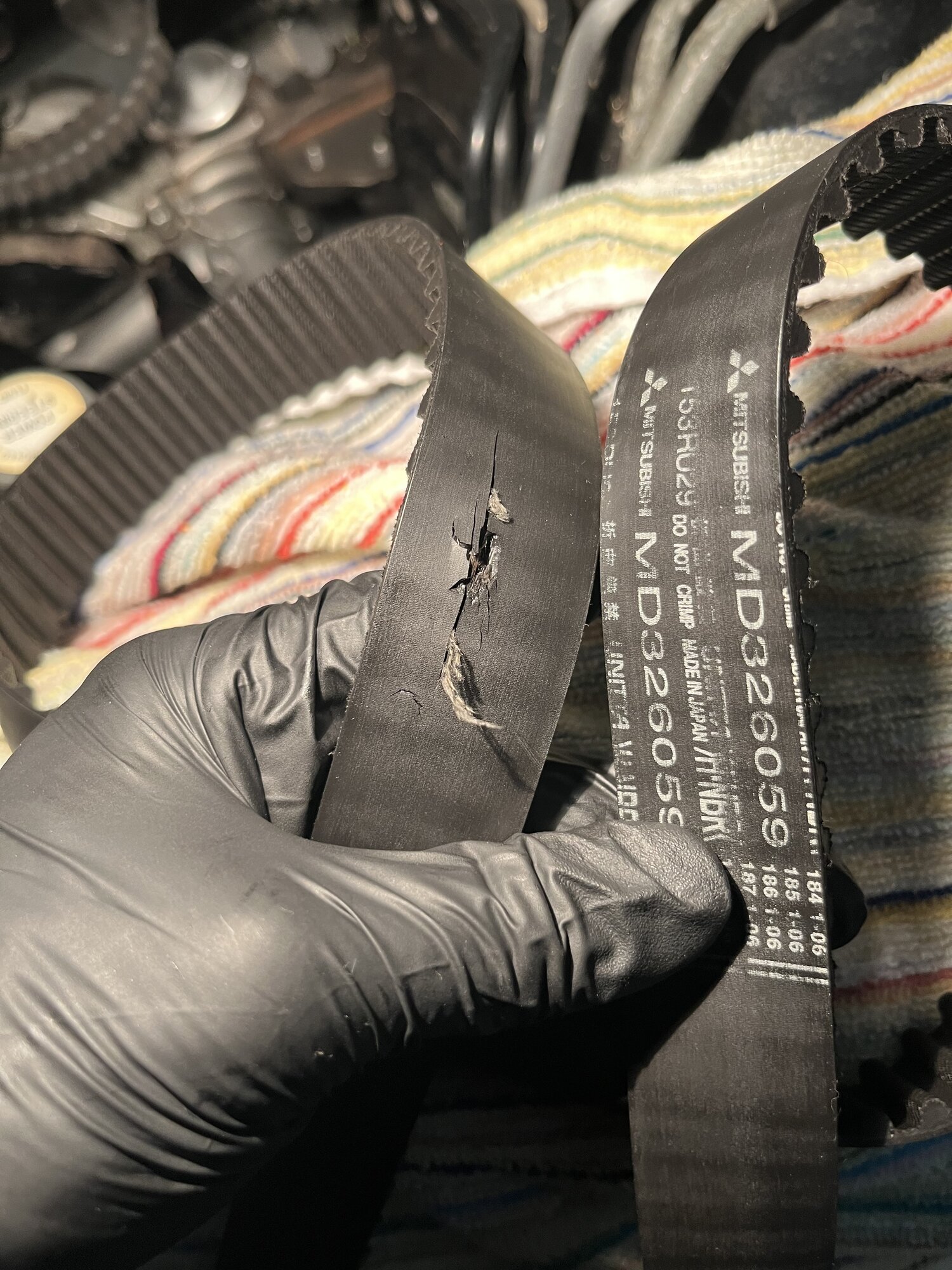

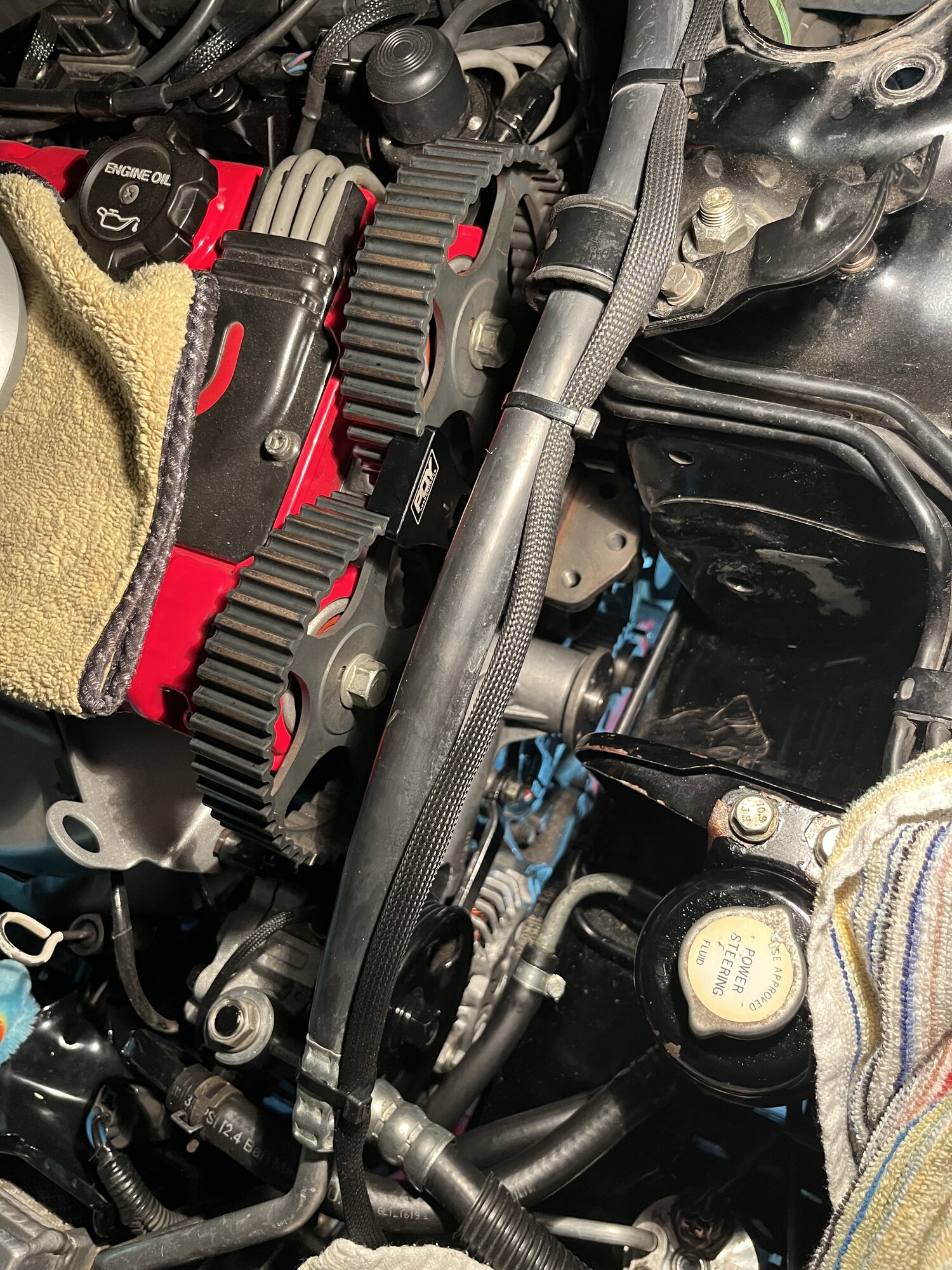

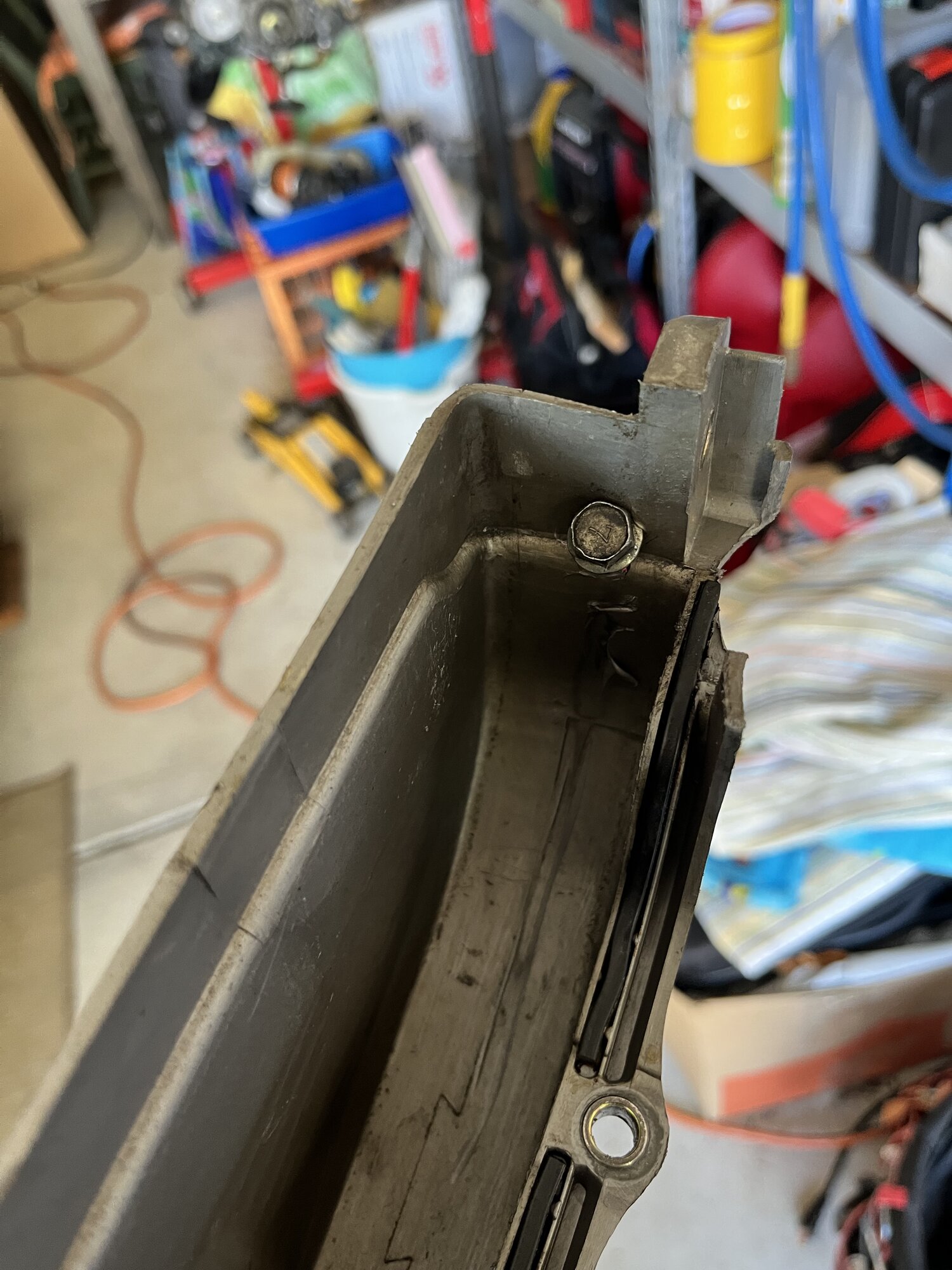

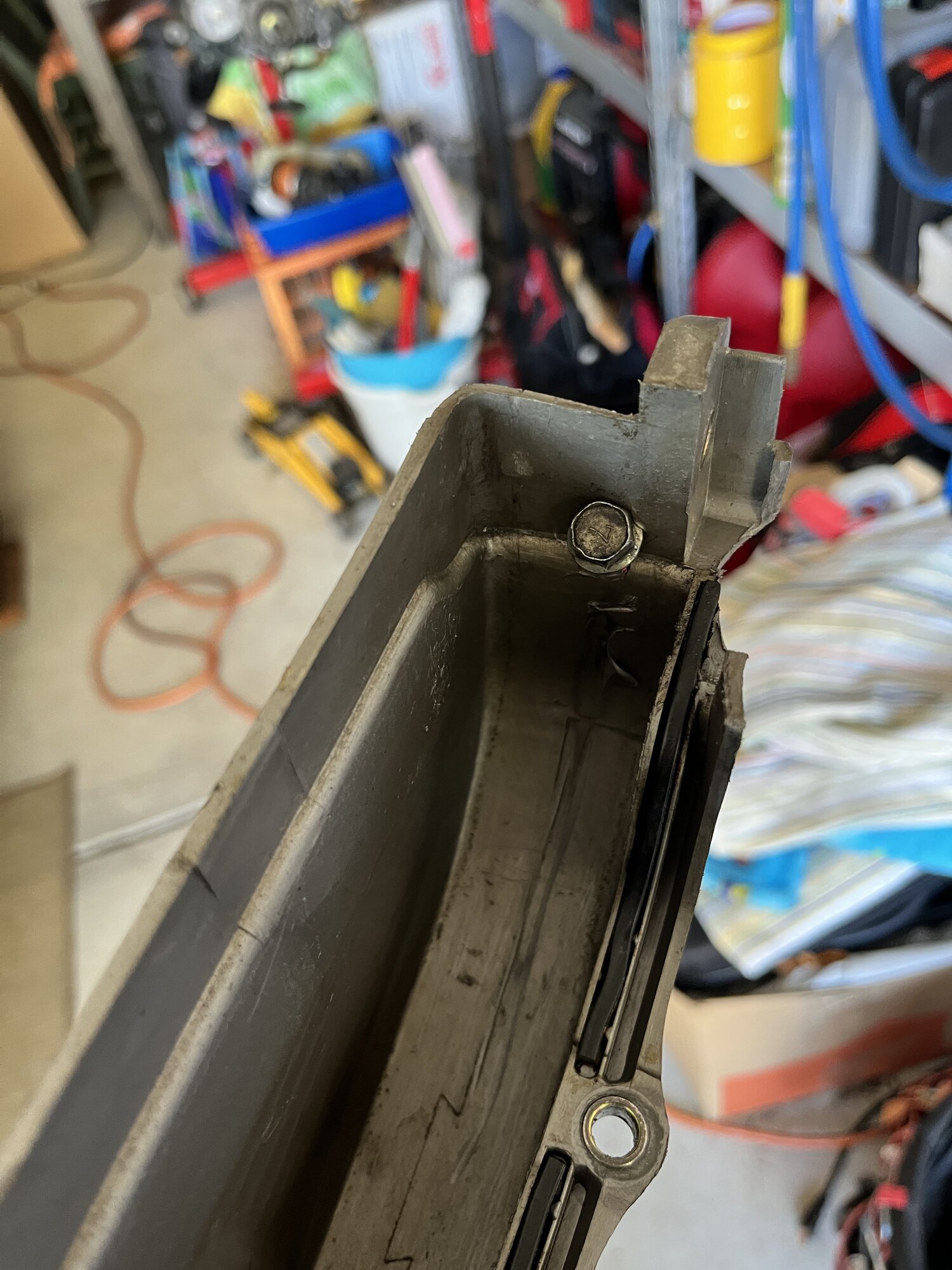

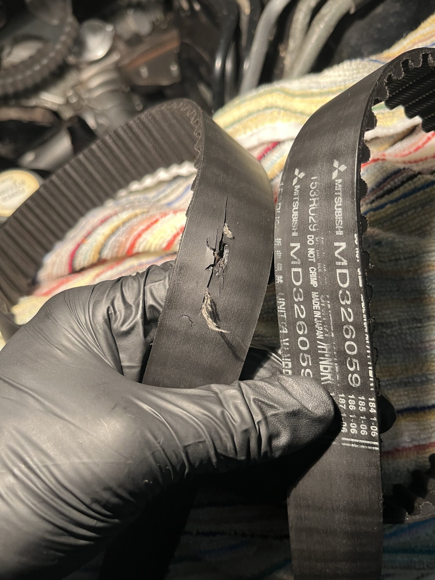

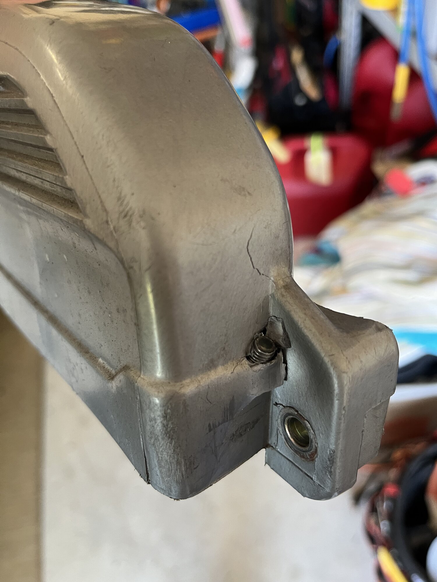

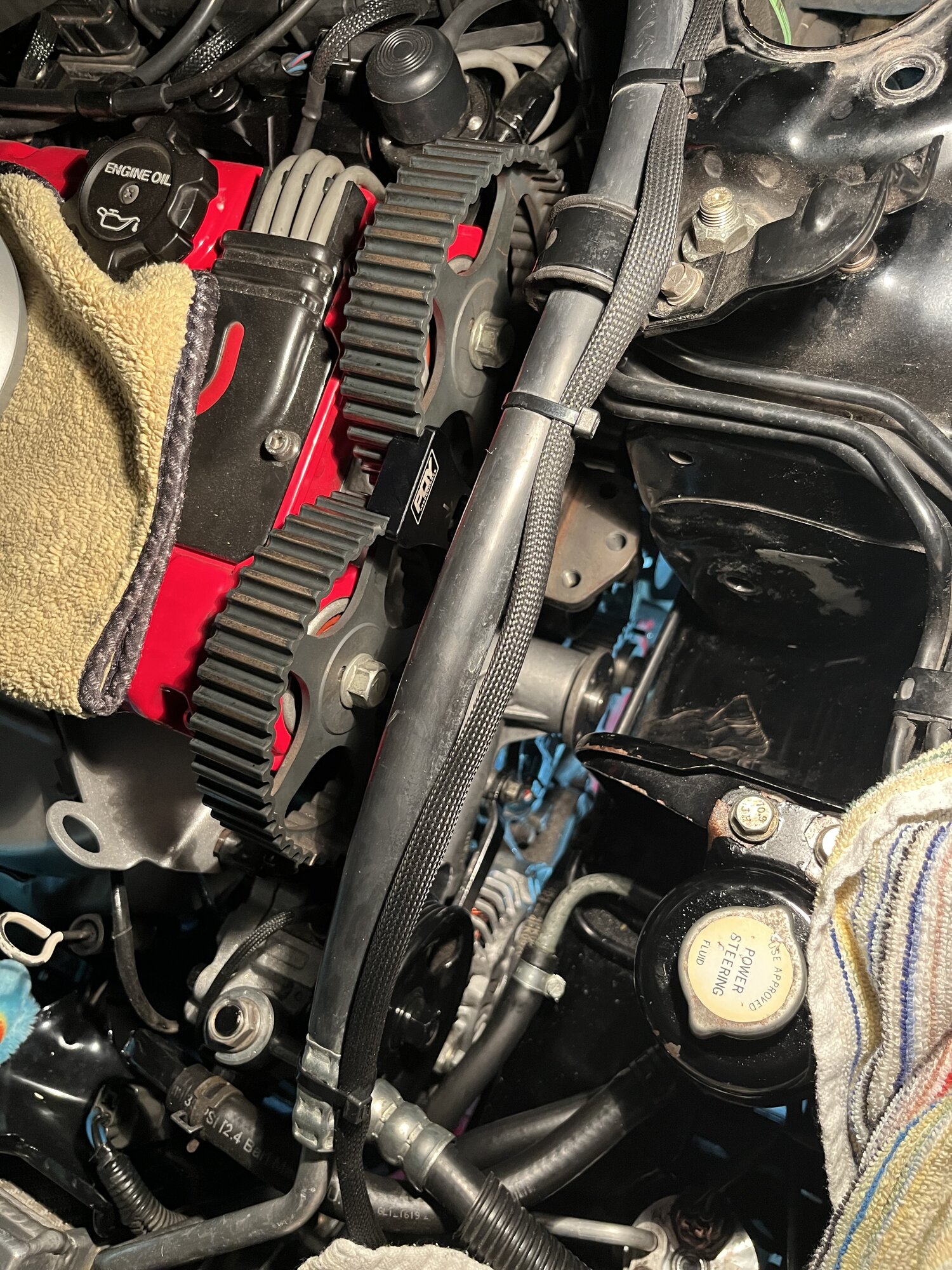

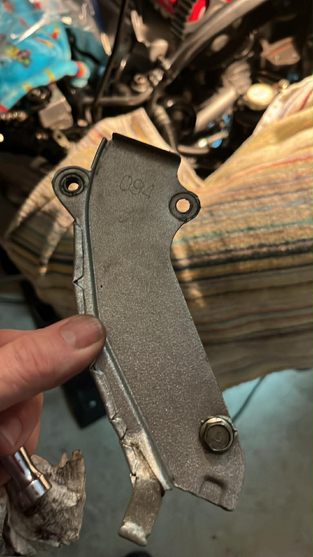

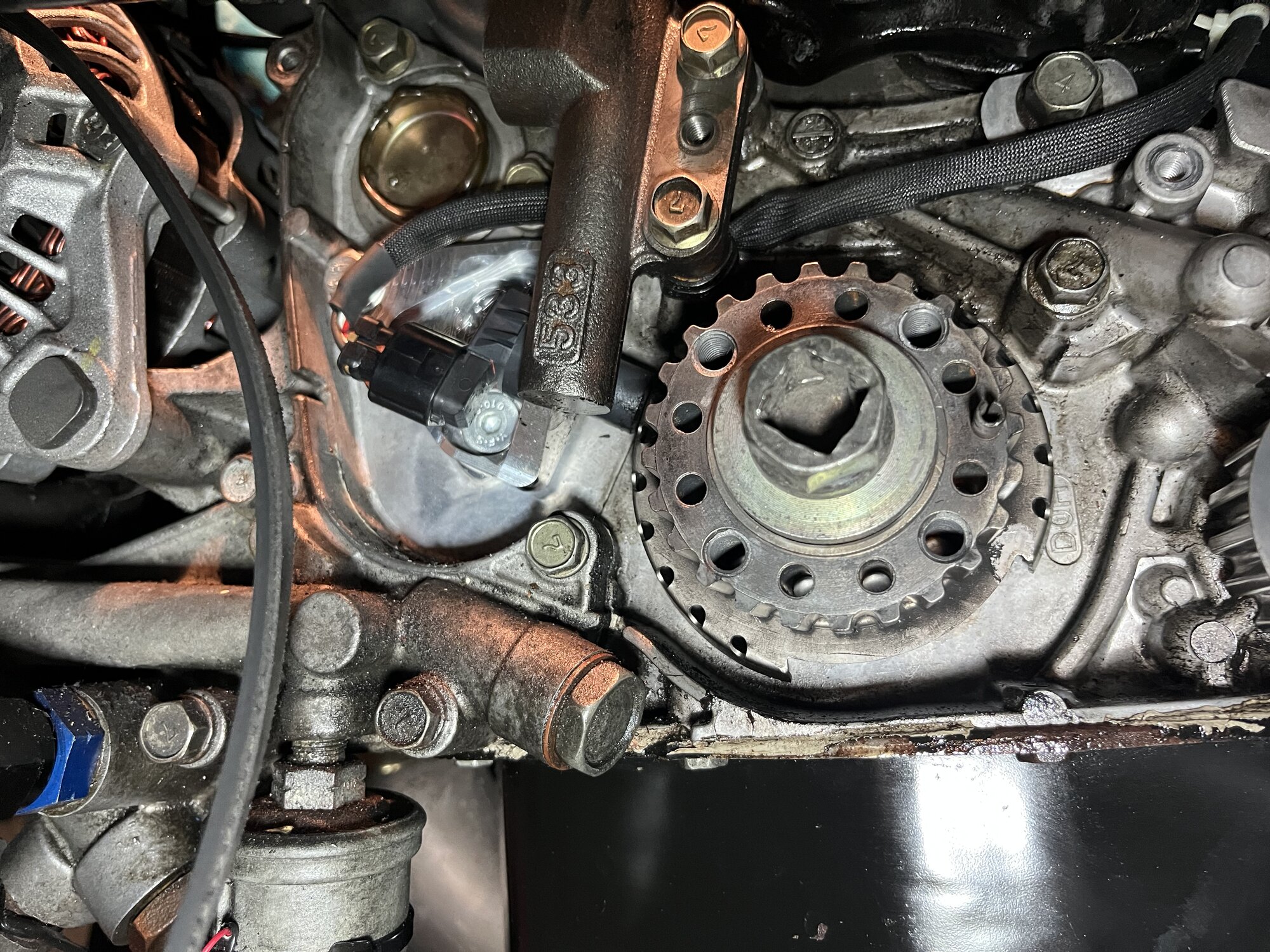

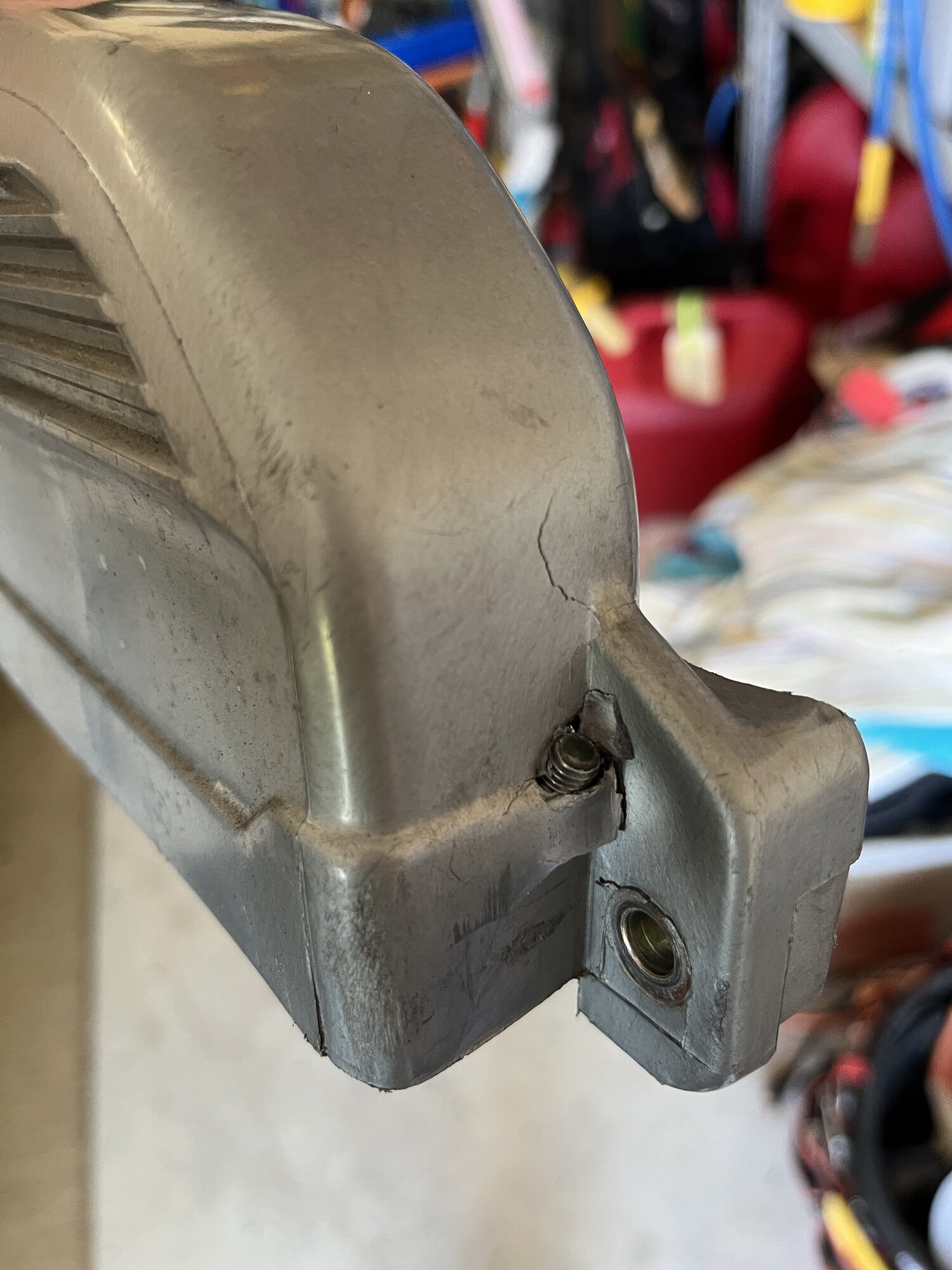

A bolt under the cover fell out. Loctite will be for the bolts that are in the belt area under the covers.If all the covers are present why the need for loctite?
Wow. Thats kind of surprising.A bolt under the cover fell out. Loctite will be for the bolts that are in the belt area under the covers.
pretty lucky to have unbent valvesWow. Thats kind of surprising.
Wow. So I guess we shouldn't powder coat those parts. Never occurred to me powder coat might affect bolt torque.pretty lucky to have unbent valves
I caused this! Powder-coat compressed, bolt gets loose, and backed out with vibration, ended up between a cam gear and the belt- poking a hole, carrying it to the back of the upper timing belt cover punching through the plastic, pulling all the way through the belt on exit - where it stayed.
View attachment 788805View attachment 788806
PC under any bolt head is a risk - especially if it gets hot.Wow. So I guess we shouldn't powder coat those parts. Never occurred to me powder coat might affect bolt torque.
