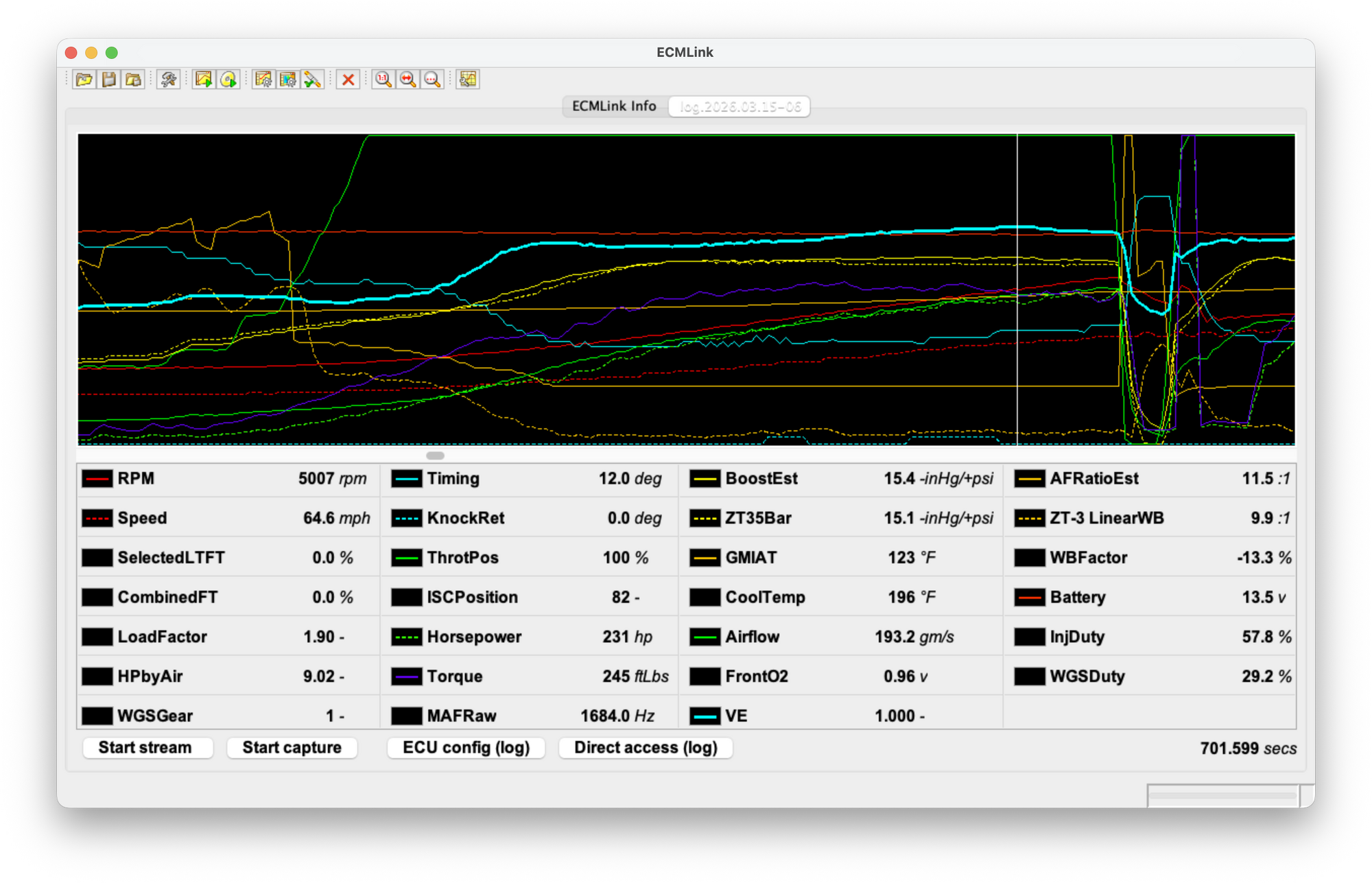

Lots of video and data to sift through - first - let's look at the tune. I saw the whole time really rich numbers on the WB on track so I didn't fuss with it. It was wrong in the right direction for longevity.
Above, is a pull from the first sessions - before heat soak. This goes right over the VE peak (1.000) at 15lb of boost. I ran the whole trip with the boost turned down - and this shows me exactly how far off the global fuel has drifted - likely due to the various E-85 sources in the tank.
So, you are saying that your WBFactor was way off here (about -13%).
Hmm yeah, google overview says e85 ethanol percentages are all over the place in Nevada, can be 65-70%. That would be like "winter mix" e85 in colder states. And that would make your actual AFR richer than AFRatioEst.
Fascinating - "Bad" E-85 has more moisture and that burns richer... - and colder. It's like a water injection for knock control without extra pumps and sprayers
I think it is time to invest in a test kit.
Do you think you got wet E85? I wasn't really thinking about that.
I was just thinking about how your car would be running richer if you are running, say, E70 in a car tuned for e85.
But I tried that out on the calculator, and I don't think E70 would throw your WBfactor off by 13%.
I think it would only give you about 6.5% too much fuel.
What that would change your AFR to, not sure I'm doing this right, but I think that would change your AFR to 10.8 (not 9.9)(talking gasoline equivalent AFRs here of course).
Stumbling along by the same method, I figure E51 would do it. I think E51 would change your AFR to 9.9.
I'm basing all of that on the idea "Fuel increase at E100 = 63%" like in our ethanol sensor setup.
Well I doubt that your E got all the way down to 51%.
Because water has a dielectric constant that is a lot higher than either gasoline or ethanol, a small amount of water (I think it's about 4%) will throw an error in a flex-fuel car, and the supposed limit for water in E85 is 1%. Water makes the flex-fuel sensor read a lot higher, like trying to fool the ecu, and when the reading goes over some point, the flex-fuel car will just assume there's too much water and it throws some kind of error.
All the E85 I've run through my ethanol sensor, I've never had an ethanol % reading in a log that seemed off at all, and I would if there was ever much water in it, because FlexEthMix would read way high.
Maybe you should put a flex-fuel sensor in it, even if it is just for logging.

Reset E-85 global fuel
Could be seasonal blends, or just a different ethanol % from a different station. In Michigan it's only e"85" in the few summer months. Spring/fall is e78, winter is e70. They will still call it e85 year round though.
I would have to change global fuel about 5% on the 85 to 78 change. No noticeable change otherwise with the car. For a 13% change, I suspect you came across some e70.

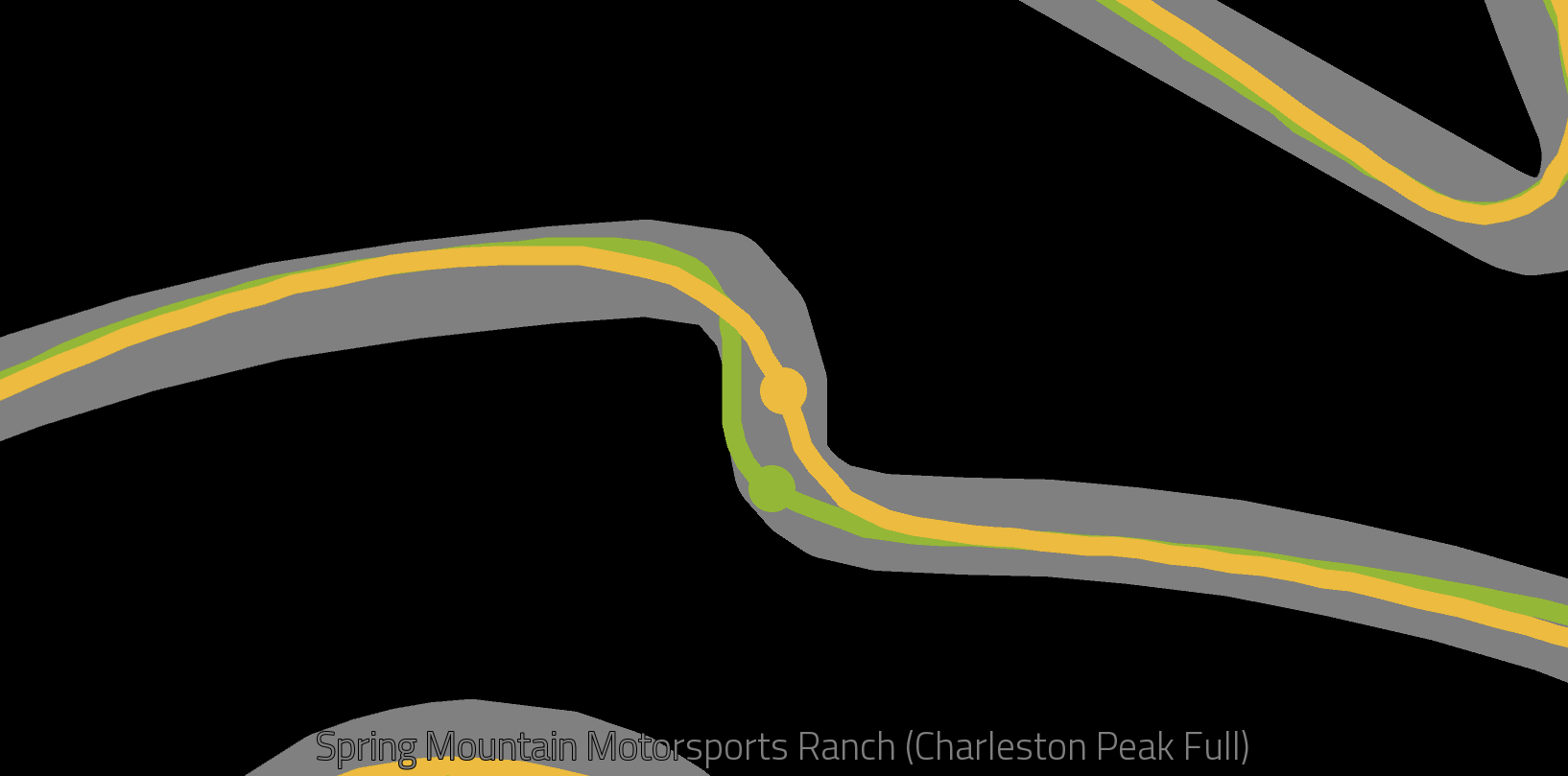

A learning moment from first session - F-ing turn 11. again.
Travel from Right to Left - The point of divergence is on the crest of a hill - the turn in is blind. At least I didn't end up behind the cones when I fell off this time.
