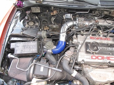

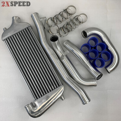

So I am doing a 4g64 turbo conversion and found a t25 at a junkyard that seems to be in decent condition. I want to have a fun DD and plan on running 10 to 15psi boost. I also found the SMIC intercooler at the yard as well. Personally I would like the FMIC cuz imo it looks better and hopefully functions better. But not sure if its worth. They both price around 200ish so if either one is an option. They are both ebay kits and I don't have too much budget left over to spend. If there are any other alternates please share! Thanks

Oh sorry I did not explain it well. I mean't I already have the SMIC and t25 but was deciding if its better to get the Piping for the SMIC to complete it or get the complete FMIC for a little bit more.
But yeah after some asking around and research I think ima run the SMIC because some people said they had ac problems and some cooling temp problems, but there are loops holes around that. But I plan on just DD it. Kind of want something fun and simple. Thanks!
There is loop holes around the coolant Temps and ac. But it's not worth all the headache for something under 350whp. It's like I told ya I'd stick with the smic. Plus look around for a used set. I bought some a couple weeks ago for 80$ with couplers and all.
I've heard 2 things that might help you here.;
1. I've heard that a lot of ebay FMIC kits tend to suck. The quality and fitment of the parts tends to be a bit sketchy especially once you get to the cheaper side of things. You can look up a lot of forum posts on here where people talk about how terrible their ebay/cheap FMIC is. Although it does give you the steez factor of having a FMIC.
2. When I brought up using a FMIC for my t25 to my DSM mechanic, he all but laughed at me ROFL. "A SMIC is plenty of intercooler for the dinky little T25, especially at those (stock) boost levels" is what he told me. You should also save quite a few bucks going SMIC as well, as people are looking to get rid of their SMIC stuff a lot to upgrade to FMIC (including me LOL).
