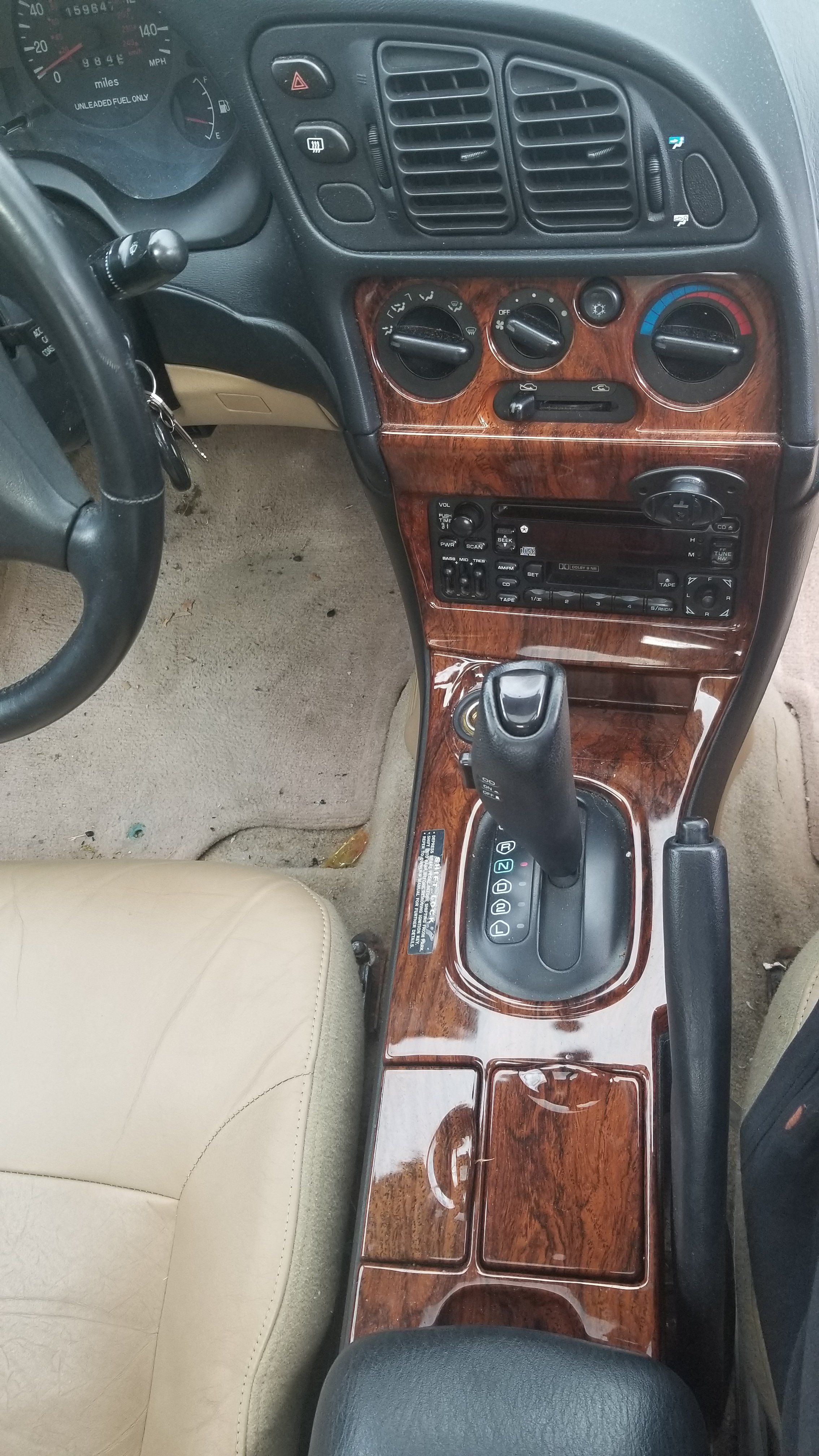

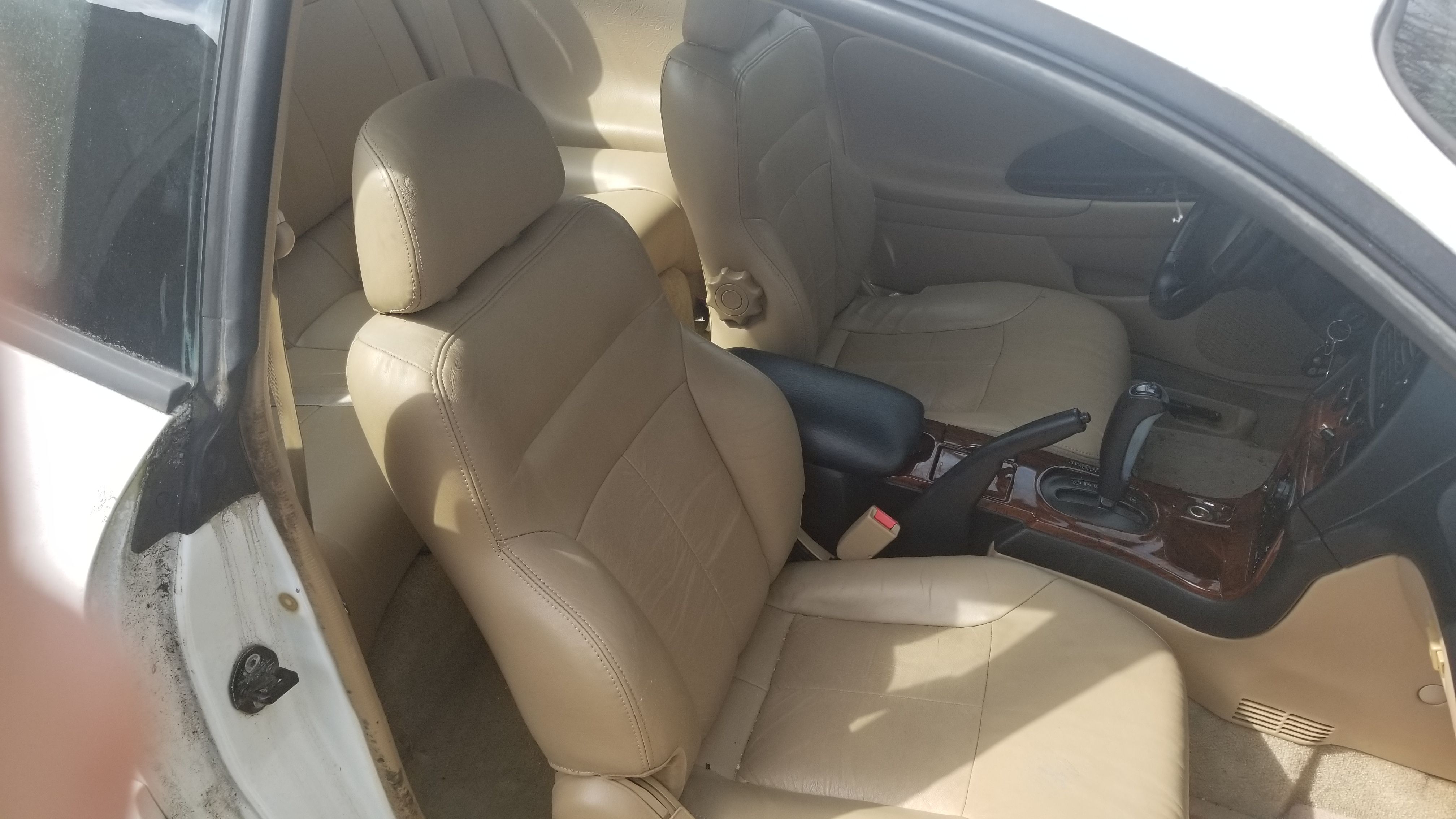

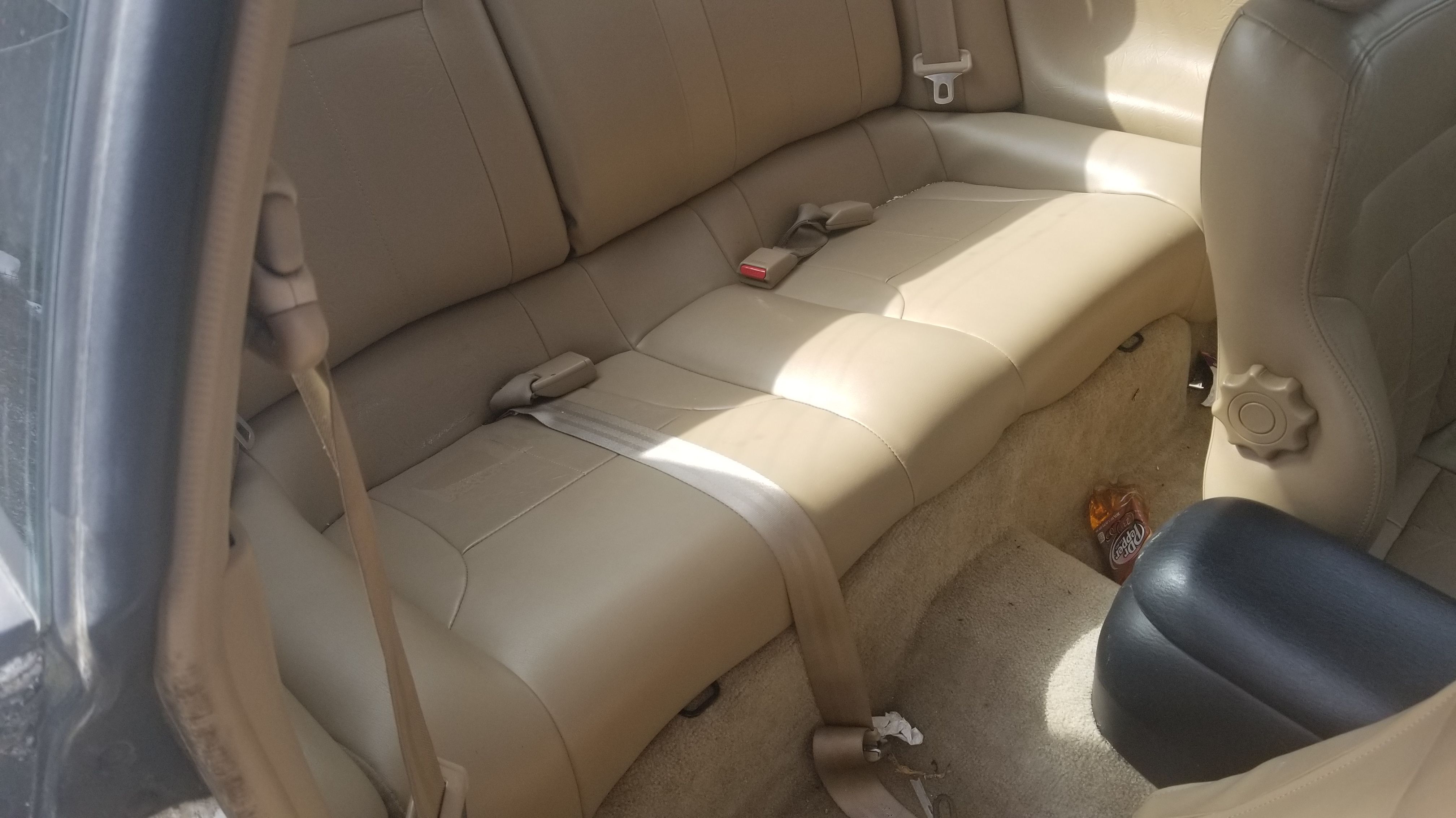

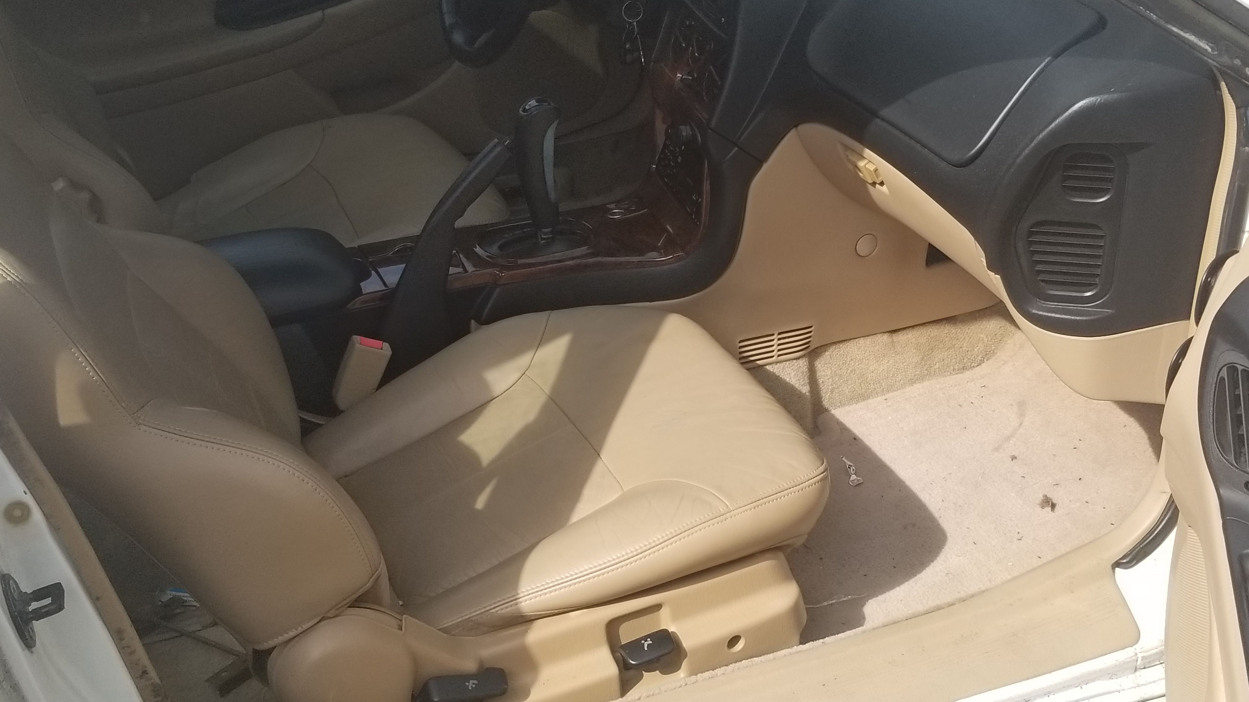

Got the Sebring donor car last night. Just look at the interior. Amazing for a '98.
20190321_160832.jpg 20190321_160910.jpg 20190321_160850.jpg 20190321_160841.jpg
It hasn't been wiped down either. Got it for $250. I think all that is wrong with it is an overheating. I've never seen the sticker by the shifter before.

been spying on this thread for a couple days, now you have peaked my interest. Is that faux wood trim premium on a sebring? I kinda like it, also those seats with some TLC will look fresh off the dealership floor!

@Dreams Realized I went back and forth about the wood trim. But after seeing it practically brand new...it is so ugly I think I like it!
