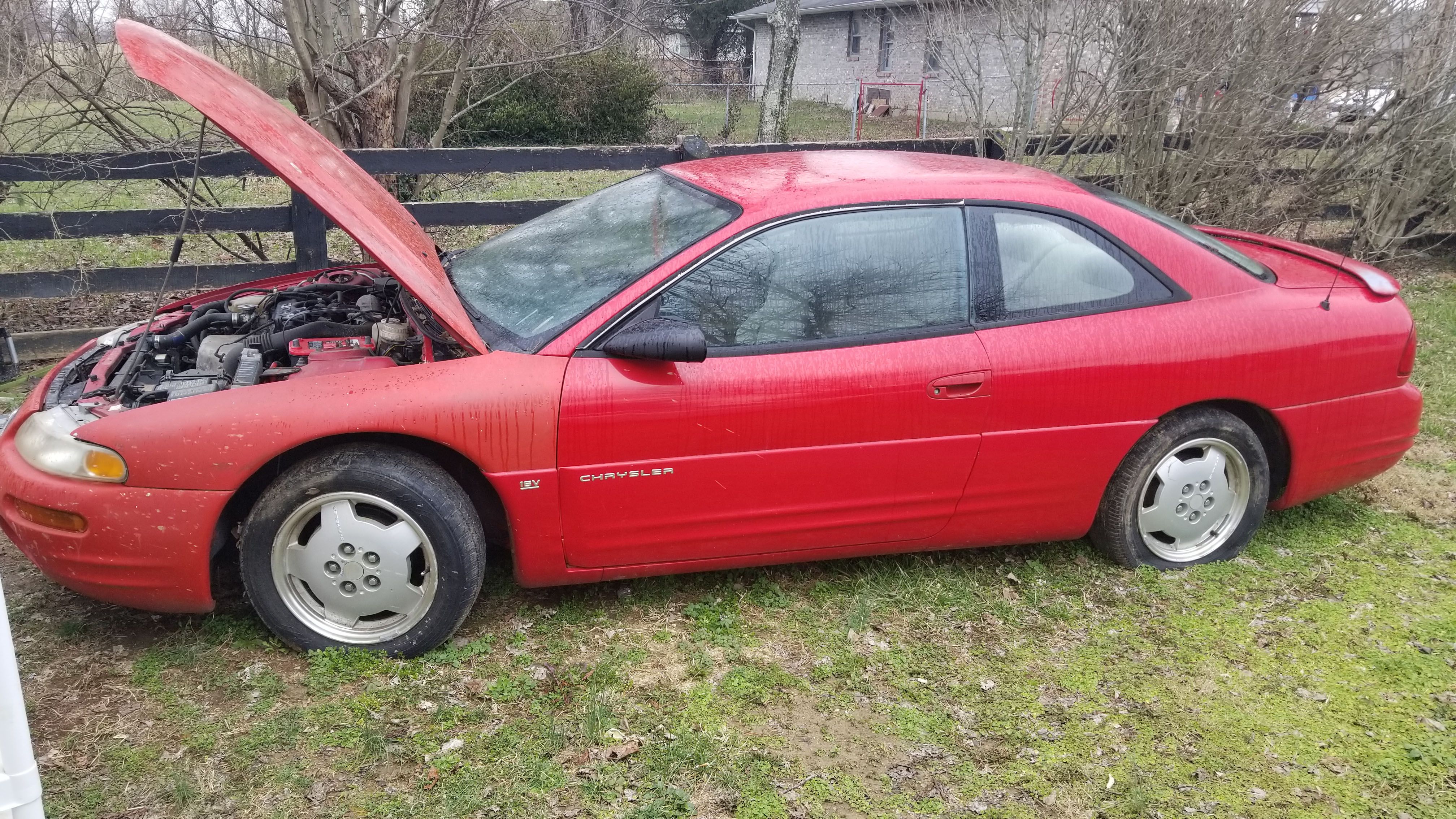

My story started with me wanting to do something nice for my wife. She still has her first car, a 1997 Sebring LX, and I thought fixing it up for her would give me a good reason to turn a wrench on something that didn't need to be fixed by yesterday. It wasn't long before I found the connections between her Sebring and the world of DSM. I've never stepped foot into the tuner world before so this is all new to me.

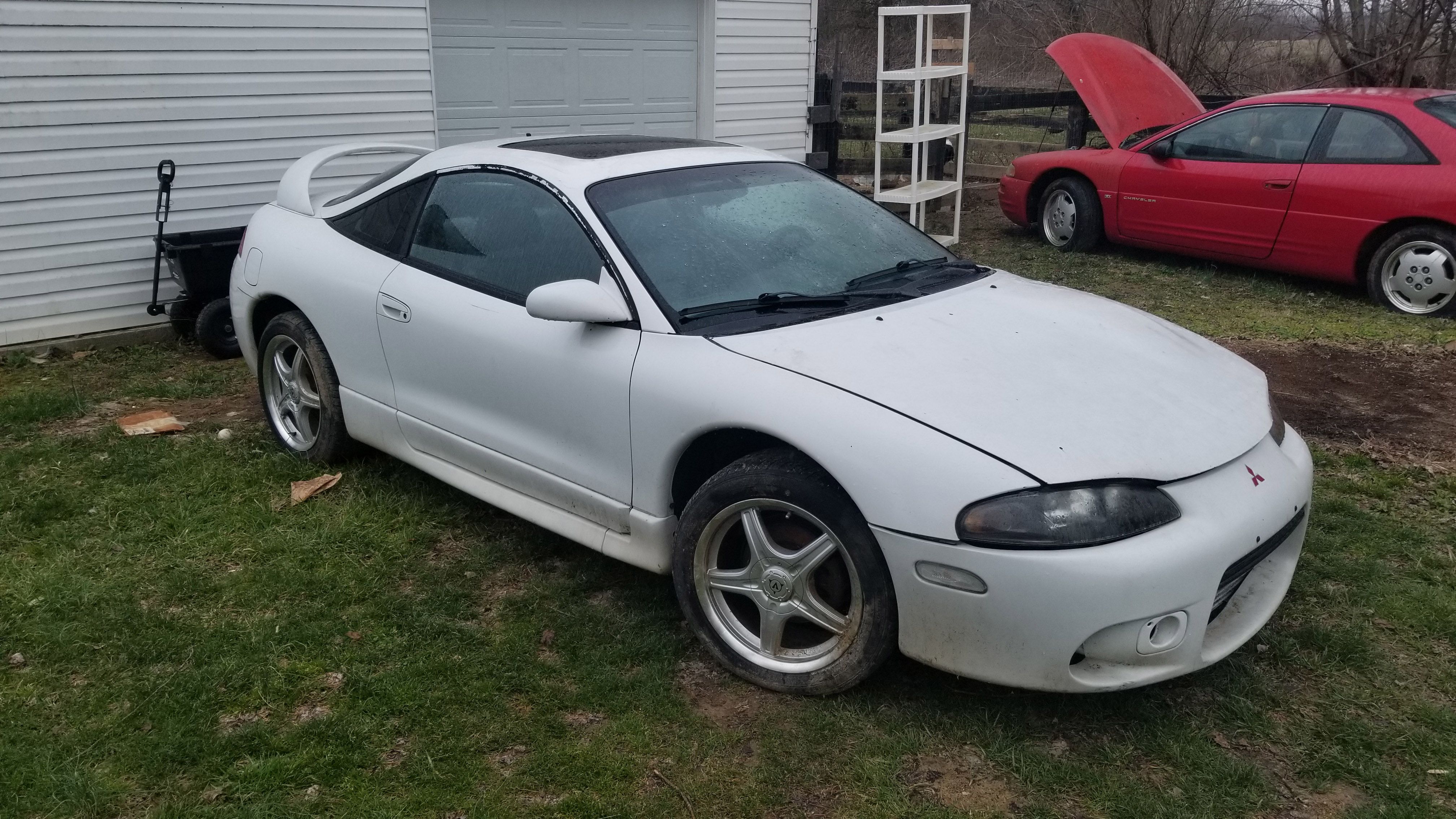

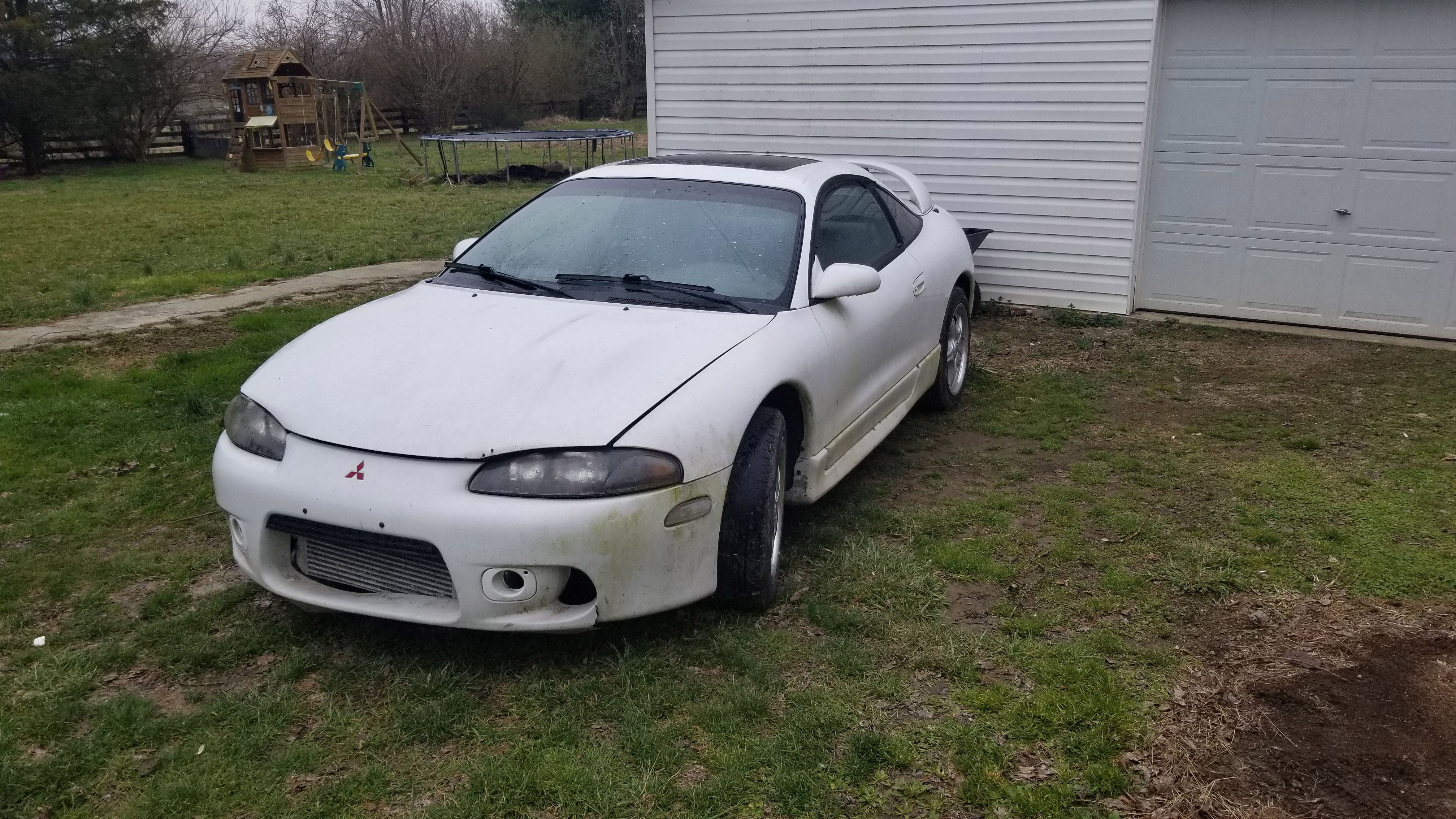

I started looking for a donor car. I really would like to turn the Sebring into an AWD. I am not too worried about the front end, wiring, etc but the rear is something else I would imagine. I did manage to find a 1997 GSX that seemed to be in fairly decent shape. It had been sitting for a year and the guy that owned it got it from some sort of house/land foreclosure where the owner had left it behind.
The GSX seemed to have been in mid-repair as the valve cover was off and a nearly new head sitting in the trunk. Other than that the biggest thing was the turbo was missing. It also came with an extra front diff, extra valve cover and a few other bits and bobs. Considering the price, what I was wanting and likely the rarity of finding a non "showroom" quality GSX around the Kentucky area any time soon, I pulled the trigger. I pretty much just bought the extra parts and got the car for free.

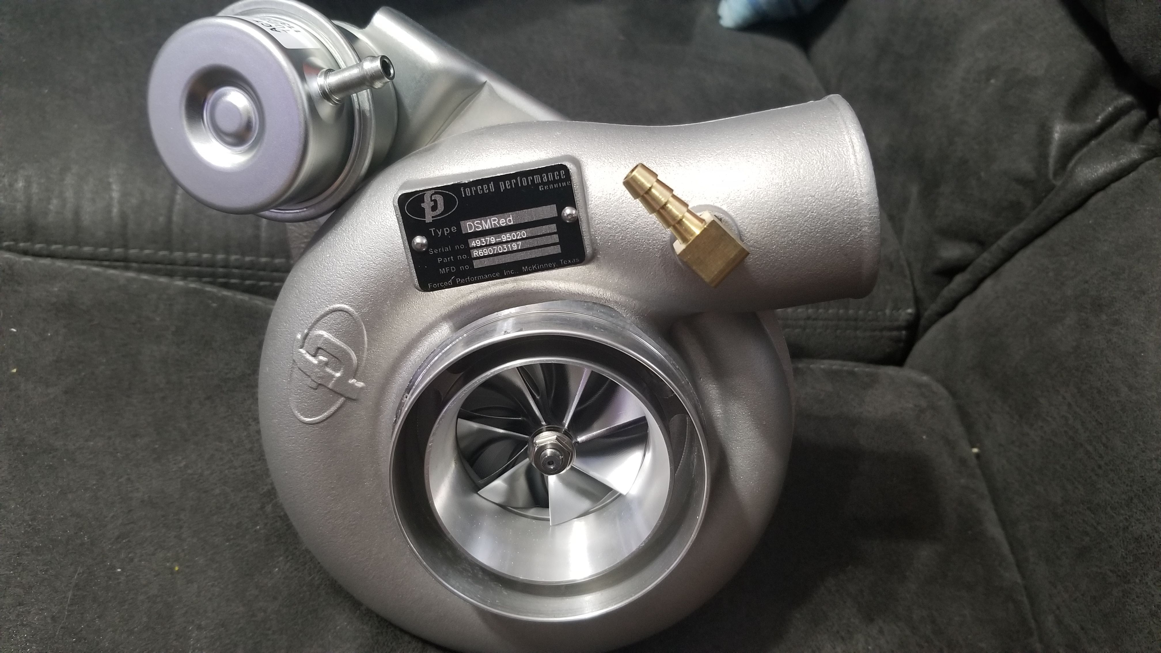

To pull the band-aid off things I knew I had to start somewhere. The first place, the turbo. Reading for many hours, it seemed the wanted HP rating dictated everything and the turbo was the king in terms of one part that requires to be right to get your wanted HP. In my case, I want the 400-450 range as that seemed the high end of OEM parts like the crankshaft. So, to get the ball rolling, I purchased an FP Red turbo and I'm going to allow that to dictate other things, fuel injectors, pump, etc.
I know the rear swap will be daunting but I figure, worst case scenario, if things don't work out I'll still have a decent GSX to restore... but I'm hoping to score major brownie points and turn the Sebring into something nice.

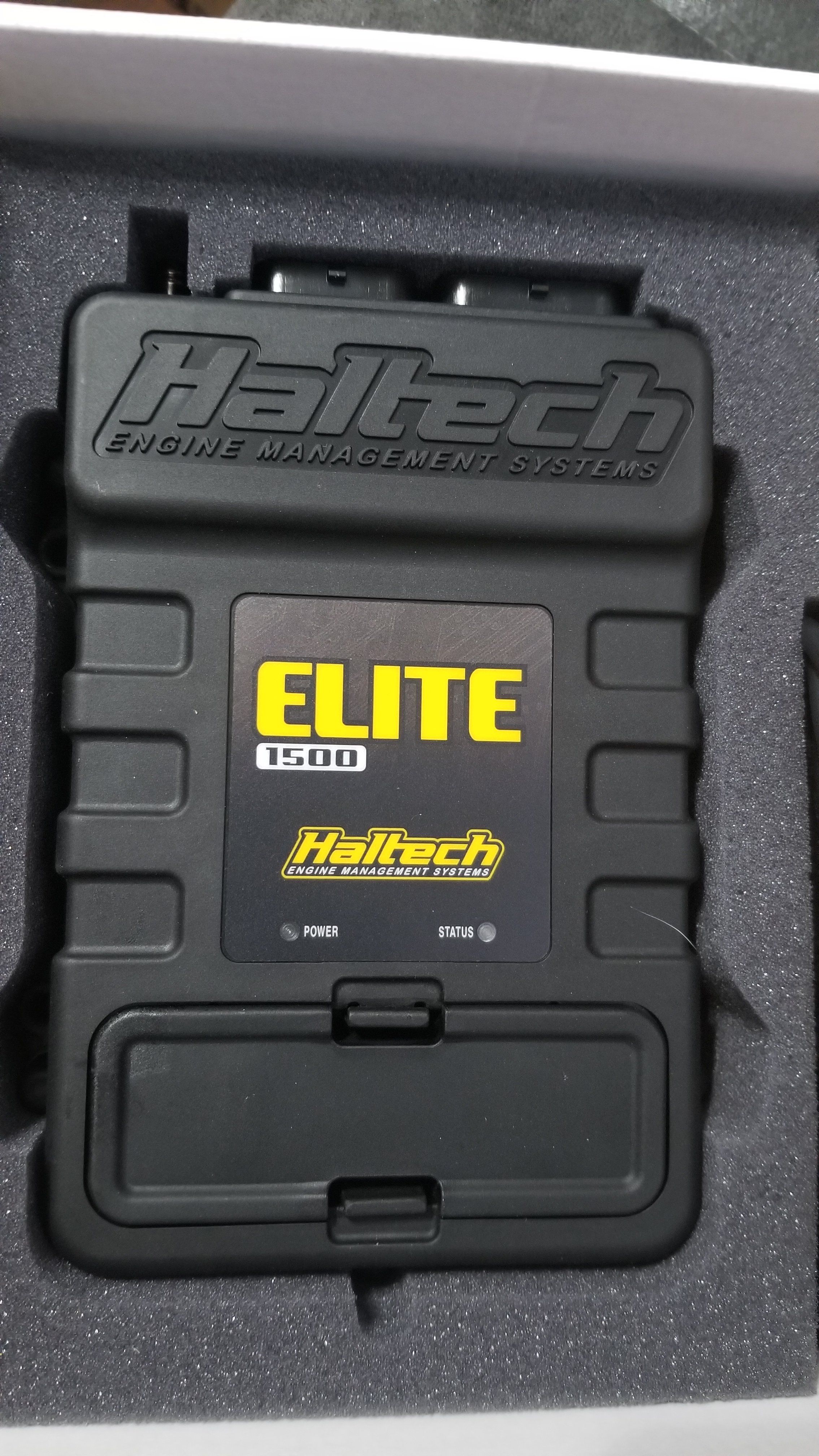

I do want to add though, for everyone... Haltech is an amazing company. I ordered a wiring harness to go long with my ECU and they screwed the order on the harness up. The sales rep drove 45 minutes to my house to personally pick up the wrong order he had sent out and to apologize. I've not seen service like that in a very long time. Hopefully their ECU is as good as their service!

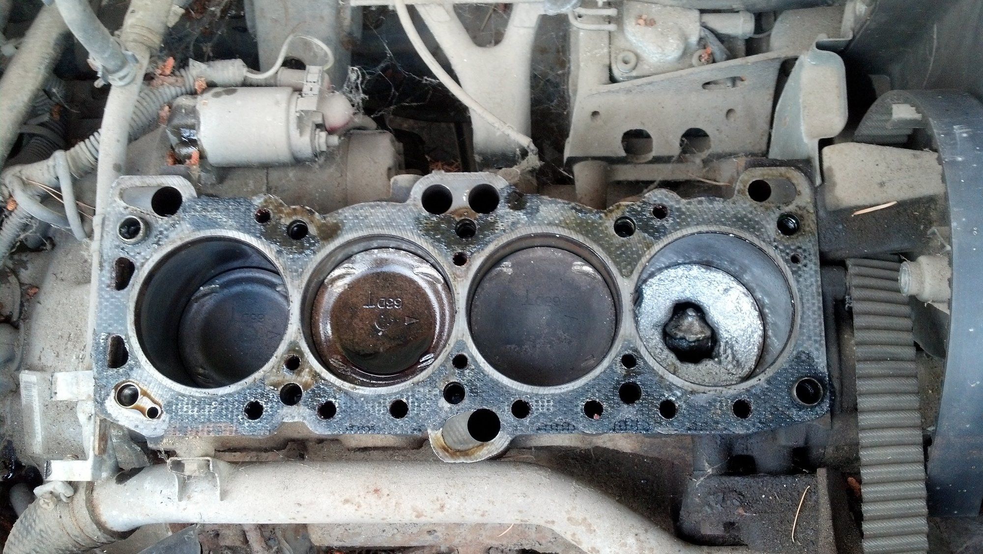

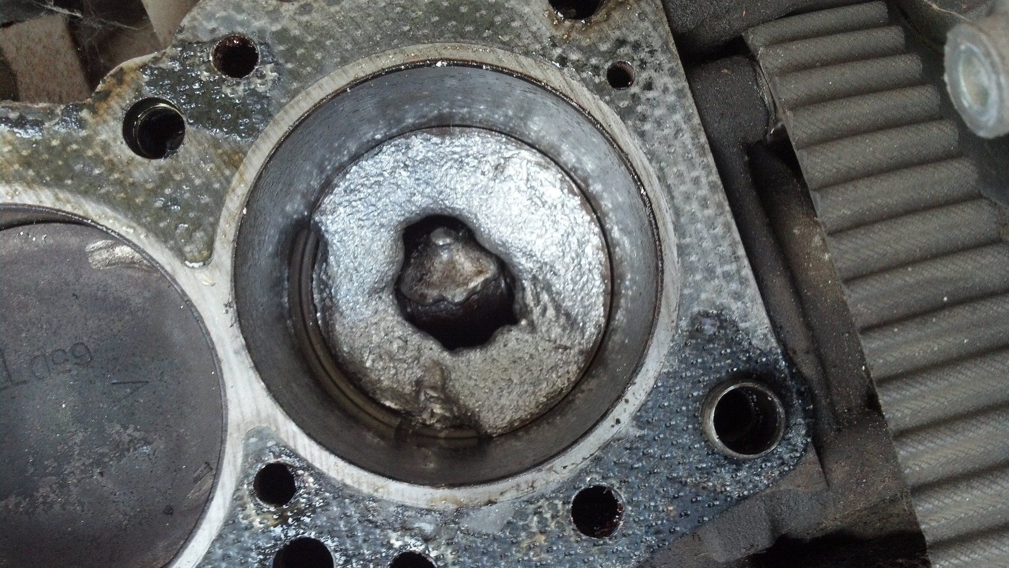

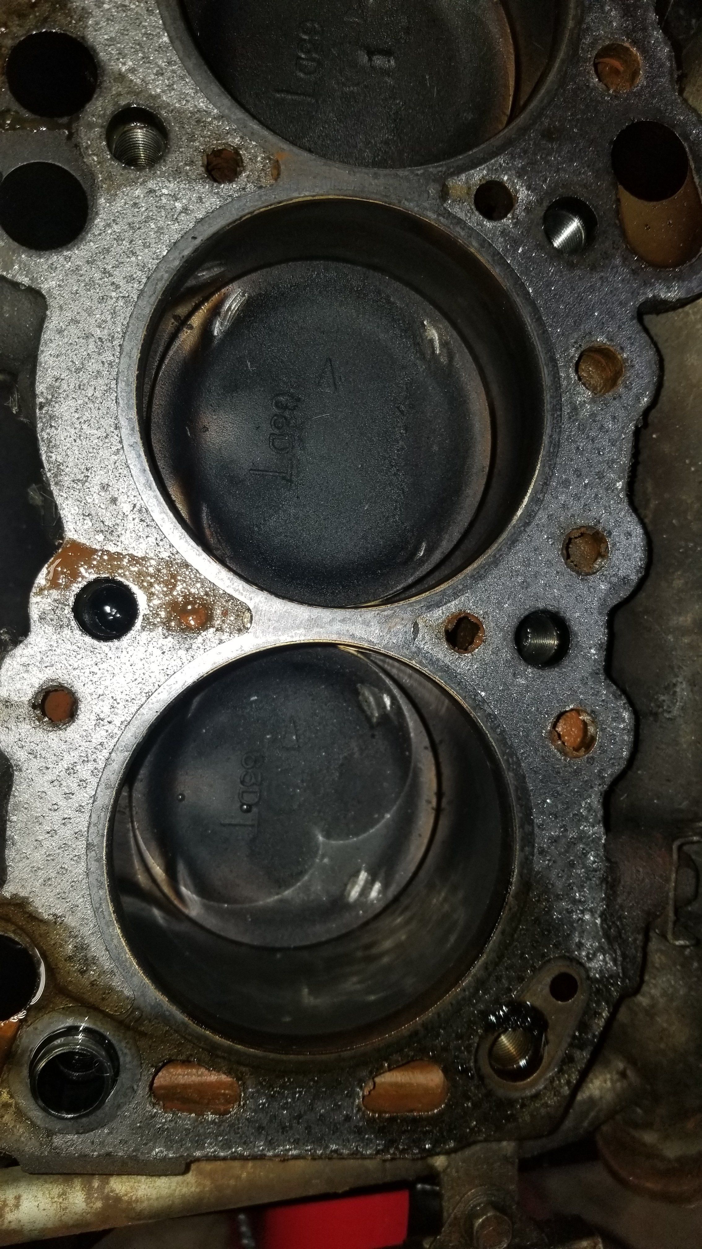

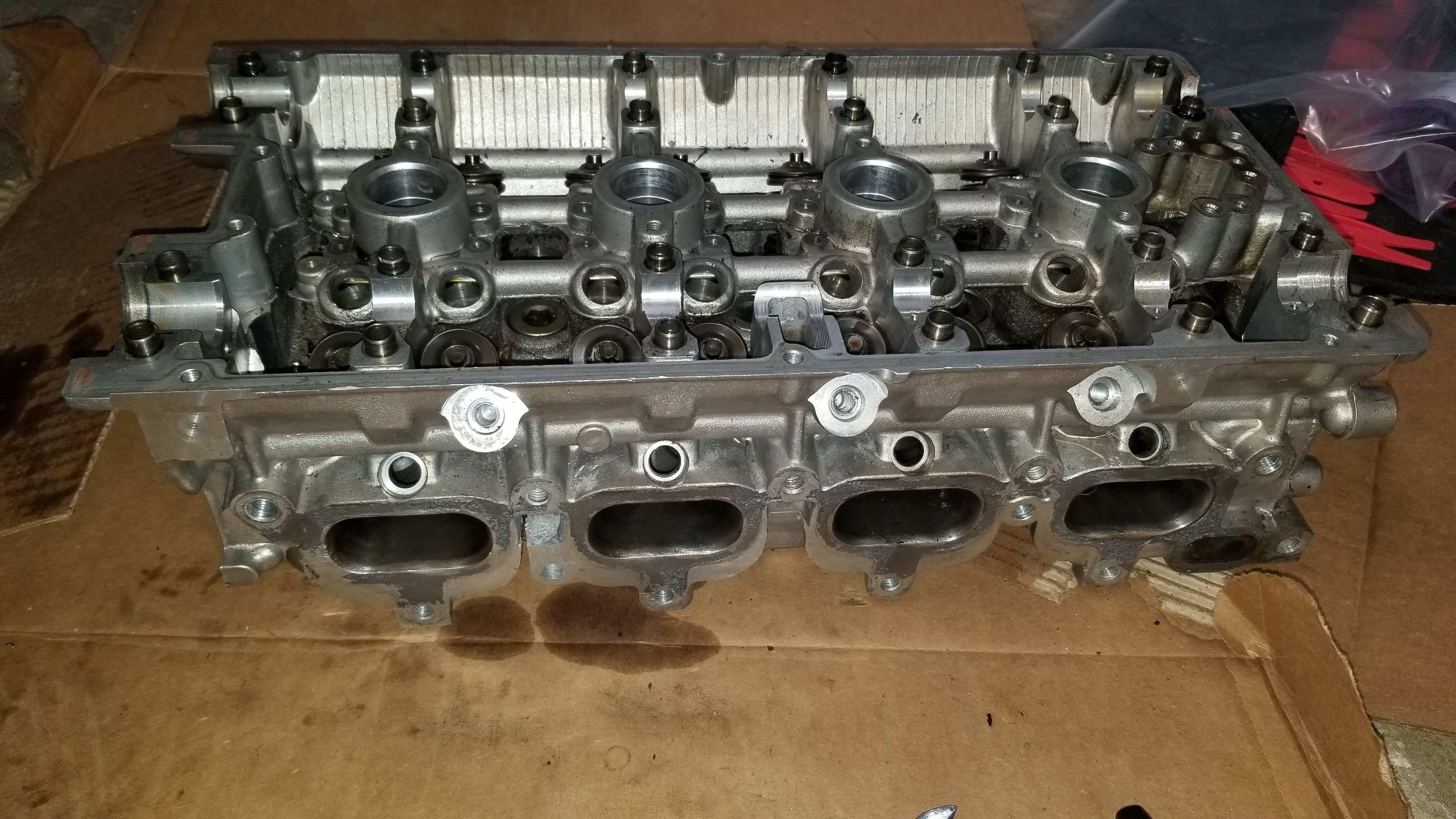

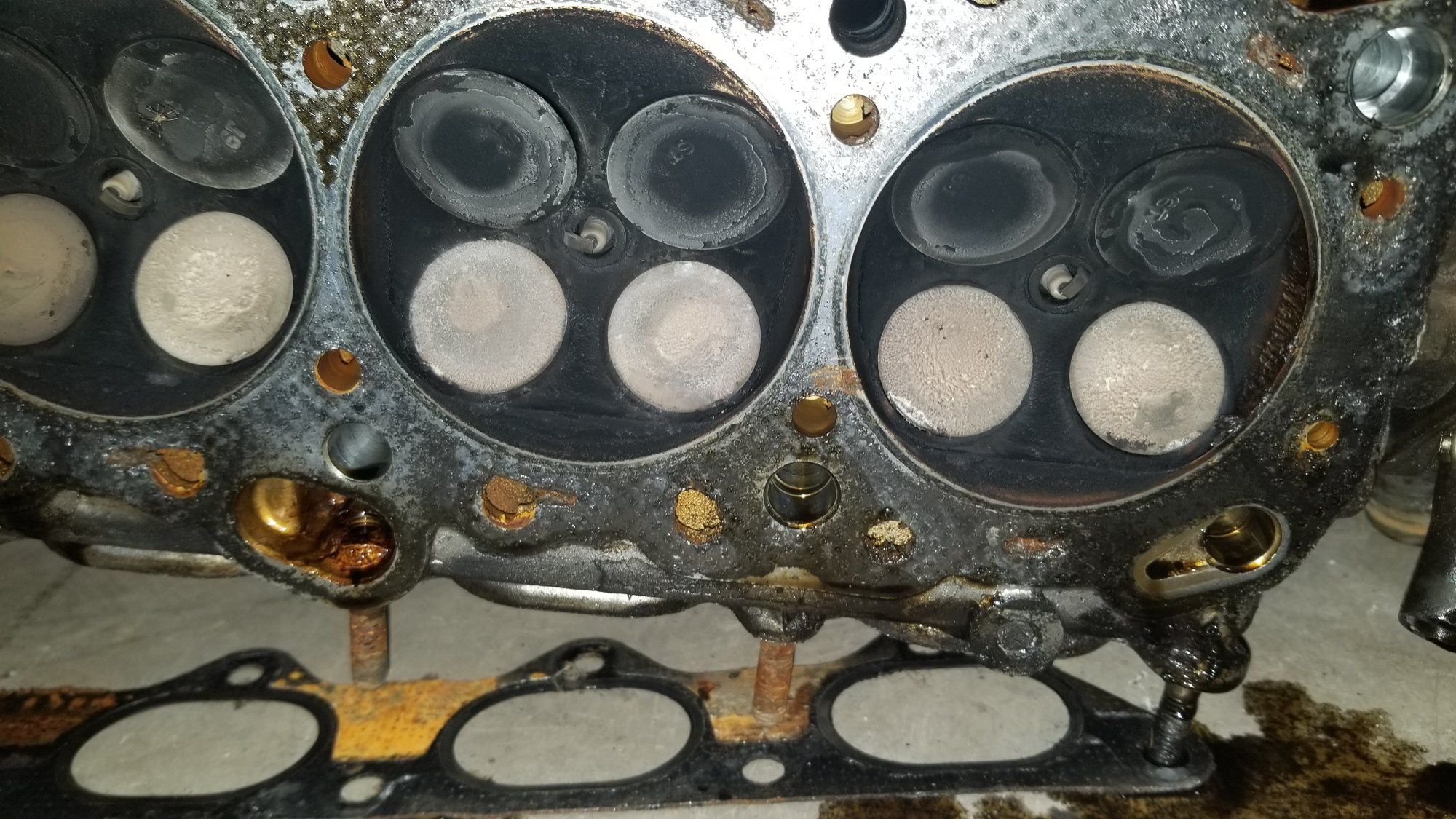

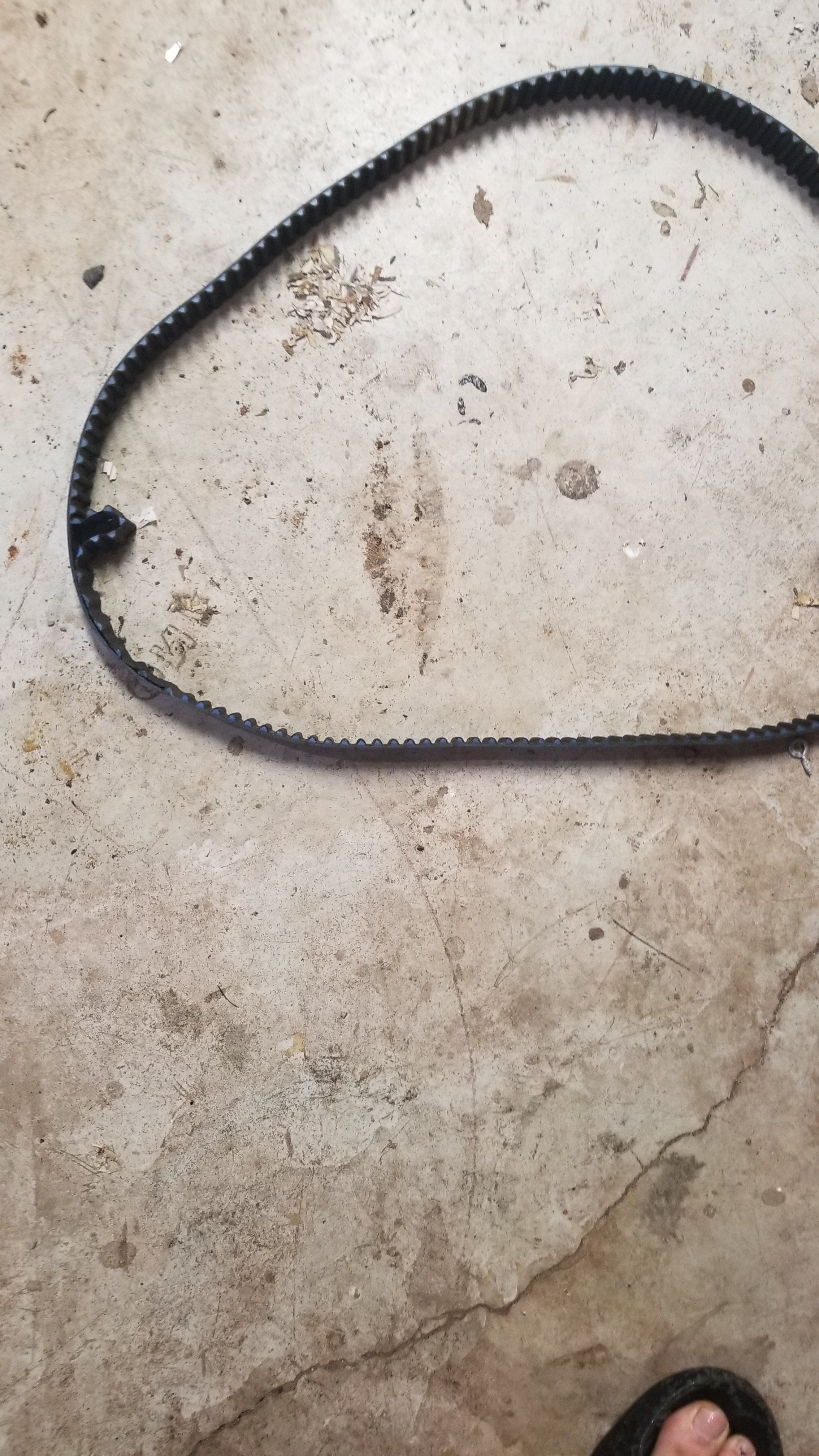

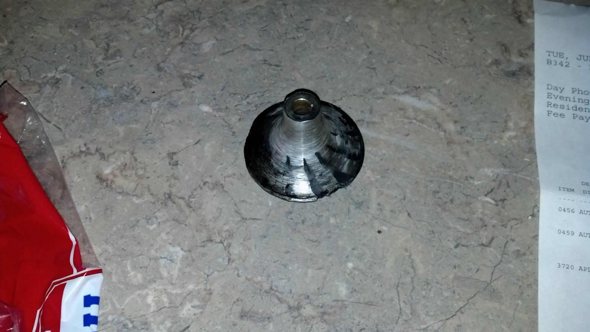

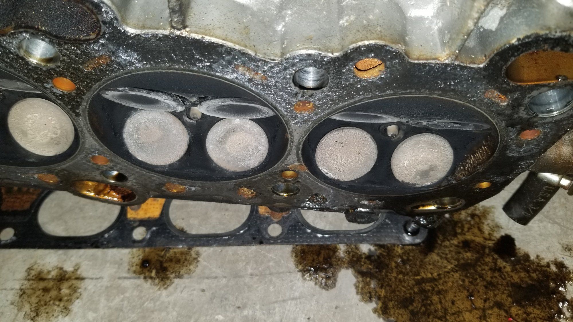

Found out a little more about the motor today. I was curious as to why the car had a nearly pristine 2g head in the trunk. Turns out the timing belt broke. a Gates Racing timing belt. And being an interference engine.. and yeah the pistons were pretty banged up too. But the piston bores look pretty good, well enough to to take to a shop and have them fixed up anyhow, which I was already planning on doing.

Got any pics of the damage on the engine?
Here's mine from a parts car I picked up that was list as a "runner". Luckily I got it for essentially nothing.

This damage was nothing as bad as what you had. I'm not too bummed about the valves and pistons though. The car came with another head with valves, though I'll likely be replacing them anyhow as I doubt stock would be able to push my hopeful 400+whp I'd like to get out of this motor. The pistons I'll be replacing for sure. It just depends on what they have to do at the shop with the piston bores as to what I'll be getting. Still debating on piston ratio though. I'm still very much a noob, learning as I go.
400whp not out of the question at all on a stock bottom end, people have made over 500whp with stock internals. But with anything tuning and supporting mods are key.

Agree with @buhay6, 400 is doable on stock pieces, tho id consider that close to pushing the reliable limit. 450 I'd consider a fair max for anything expected to last longer than a year that's driven regularly and as hard as most of us drive our cars.
If you're already this deep in, forged rods/pistons and some decent head parts aren't a bad idea. If the stock valves are in good shape and you're not going crazy with the cams/springs, they're less crucial than the bottom end and can easily live in a 4-500hp setup.
Aside, that amount of damage on the pistons isn't bad, about how my red 1g was when I got it, and I just checked the pistons over, polished the dings out and put it back together.
