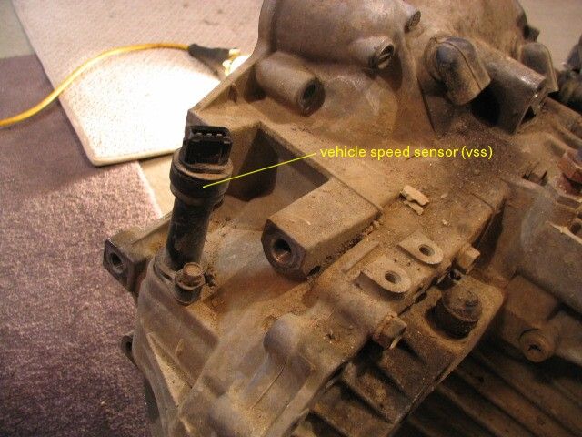

Well I got my trans out right now actually but if I got a pic of the back side and yall could point it out to me that'd be great
It is inside the bracket that bolts the trans to the rear roll stop (engine mount). It is about 4-5 inches long and is held in with 1 bolt. When you pull it out, there should be a little plastic gear attached to it.
Yah I found the plug. And I figured out the problem.. When we pulled the engine and trans out my buddy told me that he never even unplugged a plug from it.
