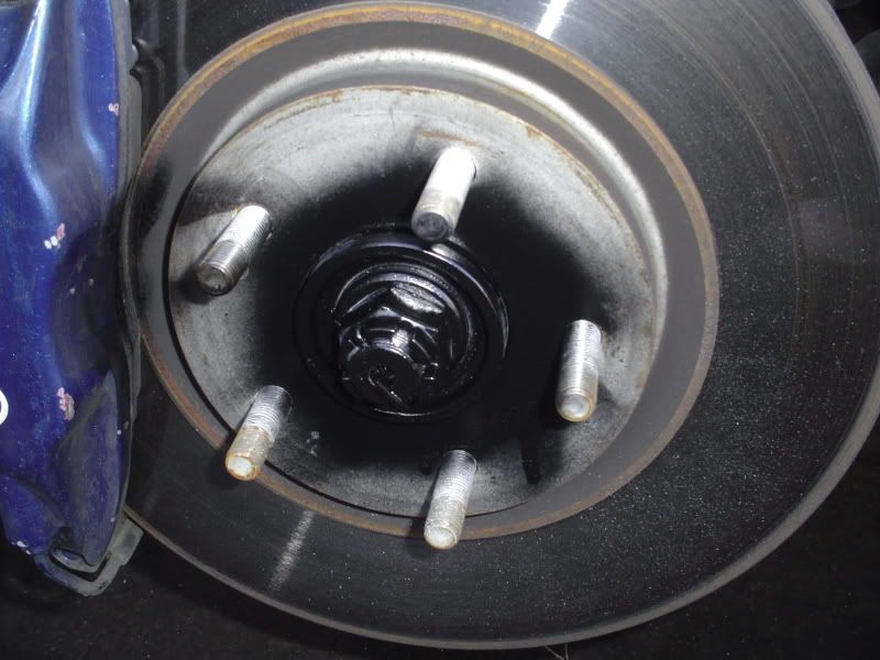

painted the axel nuts black on the front just have to do the rears now

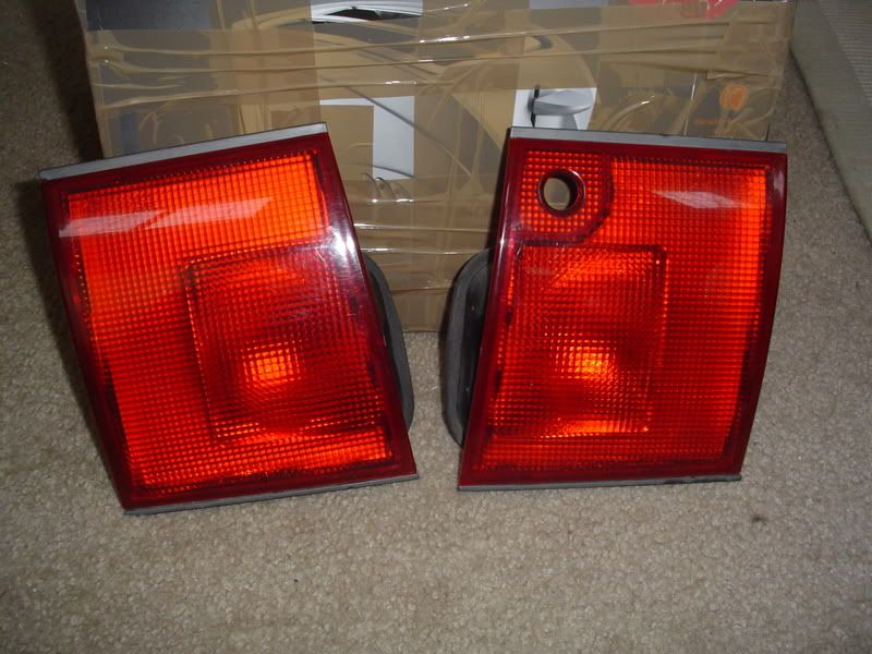

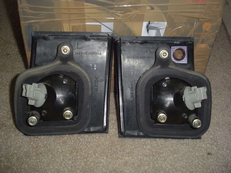

also never took pics of the rear fogs in so

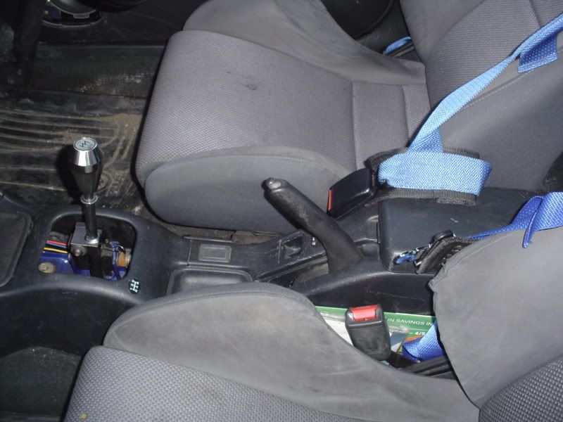

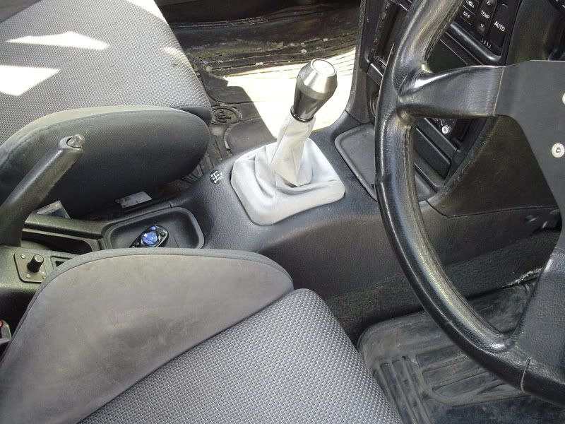

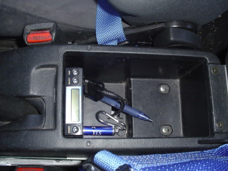

also picked up a full evo III center console so it is all black now. It was the evo shifter plastic and the gray mirage console.
also moved the turbo timer from were it was to in side the console now.

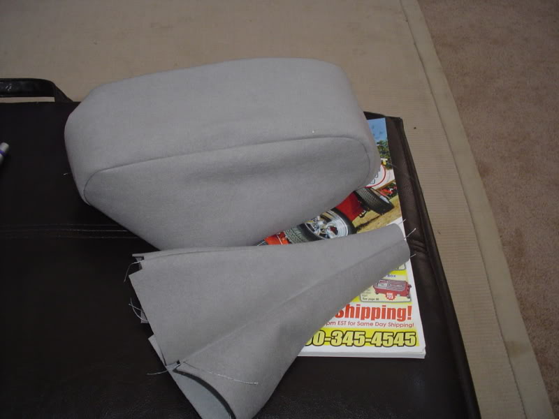

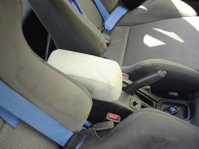

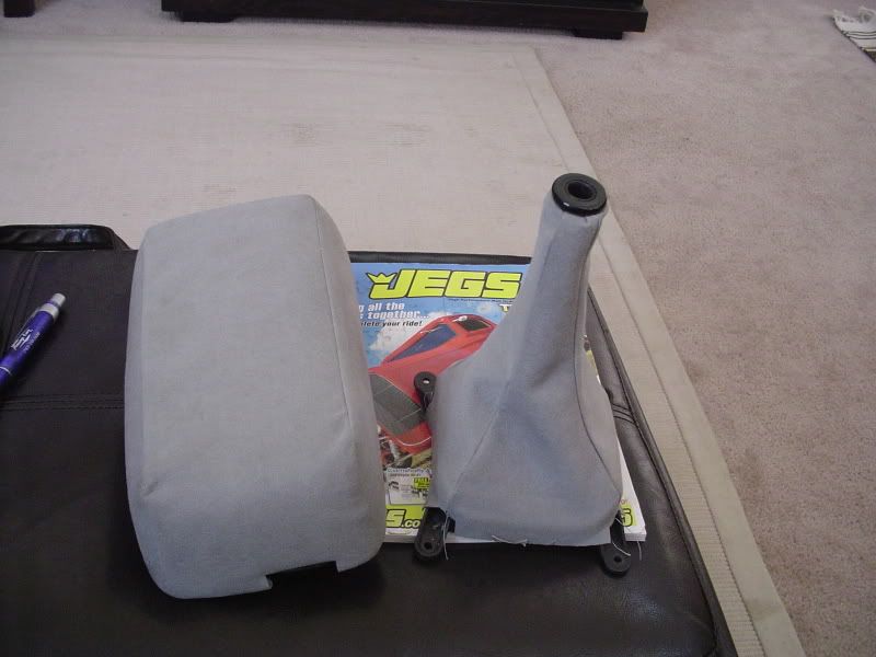

here is what Ali made for me yesterday they are suede. I still have enuff to do the head liner and the rear speaker deck.
after I got them put on. I just used some extra thread and drilled holes into the plastic part for the shifter. the oem one was glued and I did not want to glue it on.
all back in the car

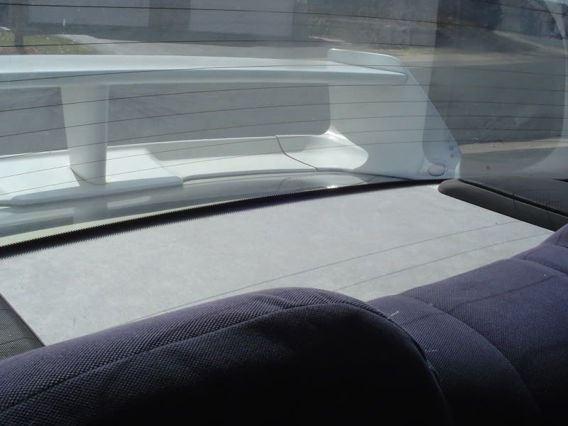

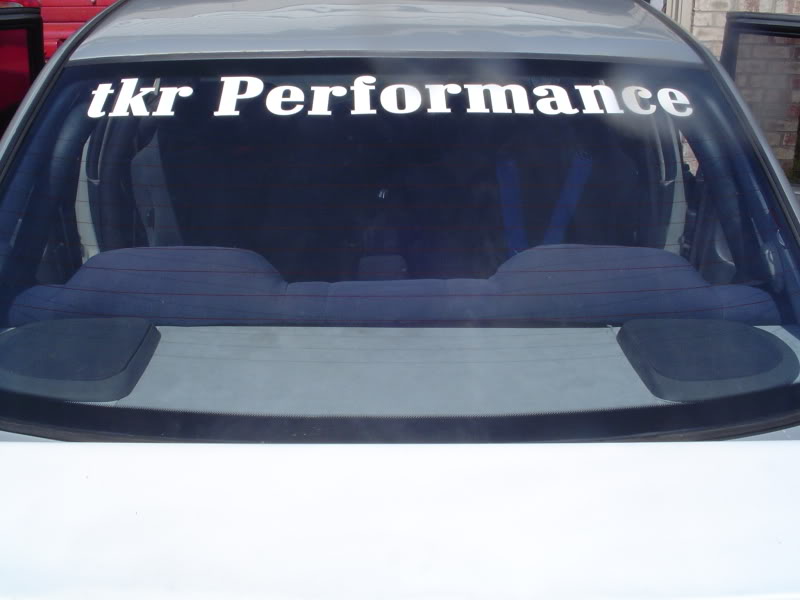

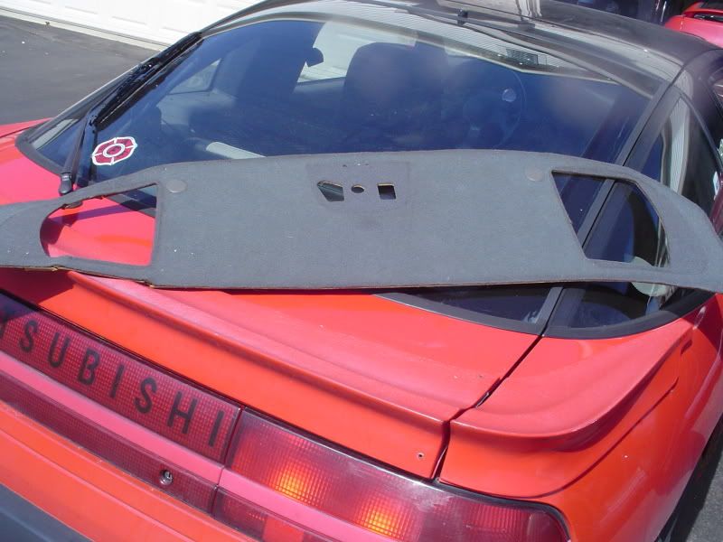

made a new rear speaker deck this morring and covered it in the grey suede

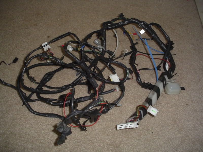

here is the old one that had the 3rd brake light holes in it still and it was falling apart after we took it out to run the evo trunk harness
the new one

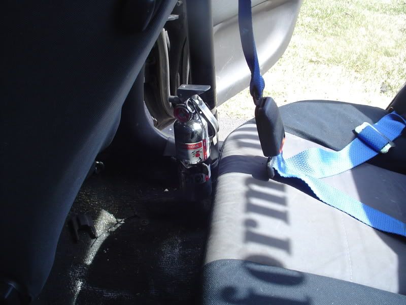

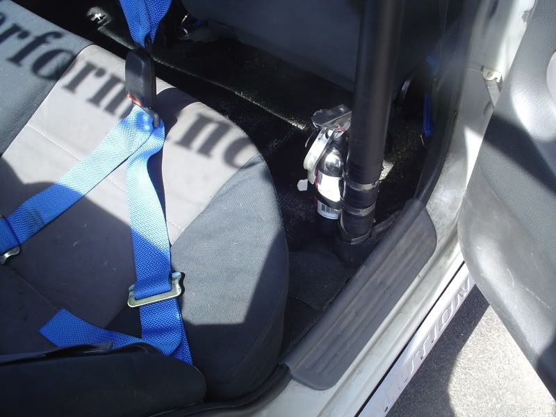

also yesterday when I was cleaning up the garage I found the bracket for the mini fire extinguisher. So I thought why not put it in the car it was just sitting in the garage and it is ricey chrome. it got mounted to the cage behind my seat.

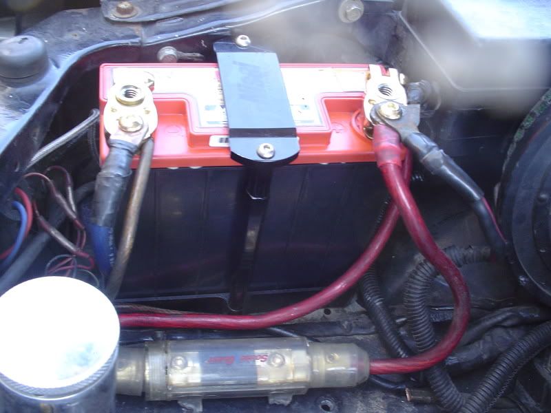

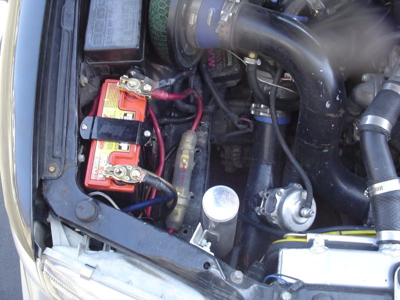

picked up a mini battery kit local out of a evo 8 for 125.00. got it all installed with out the extra piece for the evo 8.
the yellow top with the tray and bolts was 50lbs
the mini kit with tray and bolts 23lbs
I was able to shove it all the way past the frame rail on the car by the fender just enuff room for it to sit in there. It frees up a ton of room also when I redo the fmic and piping later on.

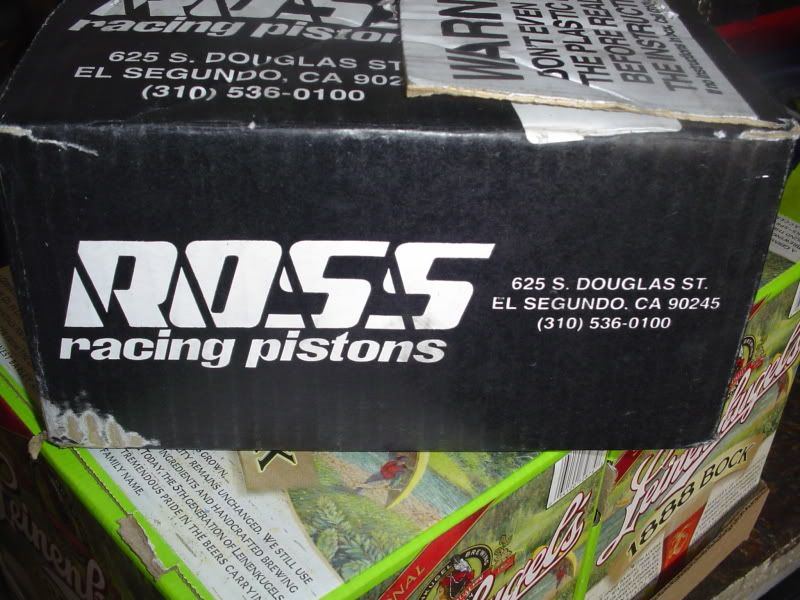

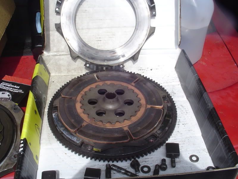

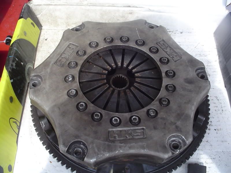

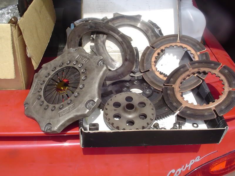

last sat. was are spring dyno day. I would have loved to put it up on the rollers, but the QM twin plate is on its way out the disks are just worn out. It has been daily driven for over a year on it so it has had a good life span. but any way I got a ton of free parts in a box and a few parts I will be using also

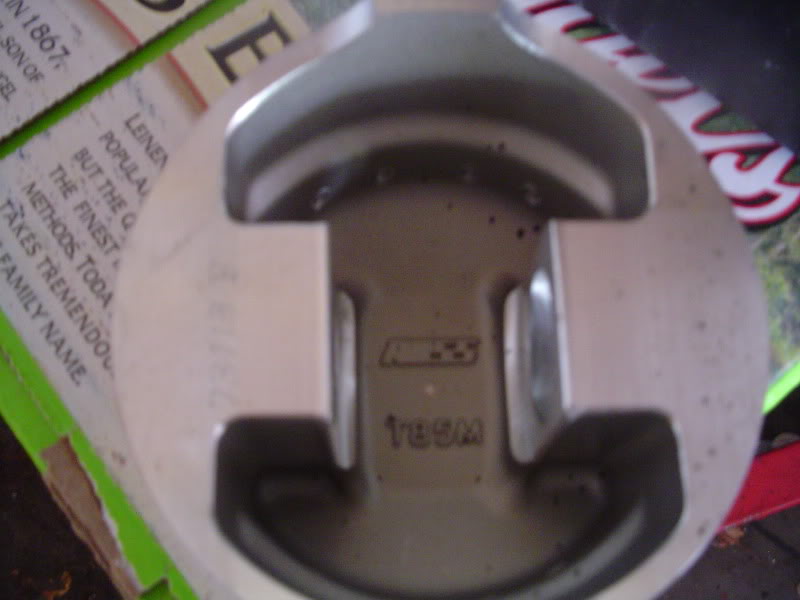

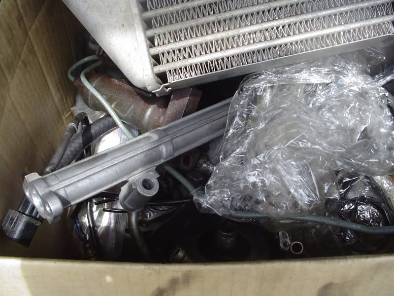

the box of free stuff. some of the stuff, 2g smic,2g fuel rail,2g acumlator,2g sensors,7bolt oil filter housing,2 sets of 2g cams,ect

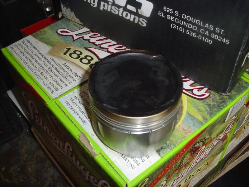

I will be using these some time when I build my 2.4 they have under 1k on them. Got the for FREE just need to get rings and pins for them. They still had the orignal invoice on them for 472.62
here is the replacement for the QM twin plate. the HKS twin plate is a 100.00 cheaper for the 2 disks. I will save the QM and use it in the spyder. I paided alittle for it. A whole lot of 20.00. they are a little over 1800.00 for it new so I think it was a great deal

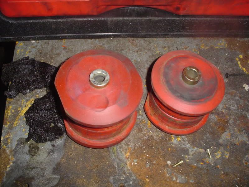

last week we went to the junk yard and got some parts for the mirage hatch,but I found a 94 talon that had polly mounts in it still. Picked them up for 5.00 each. u-pull-it rocks :)

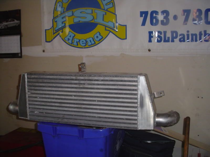

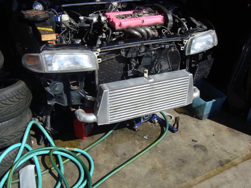

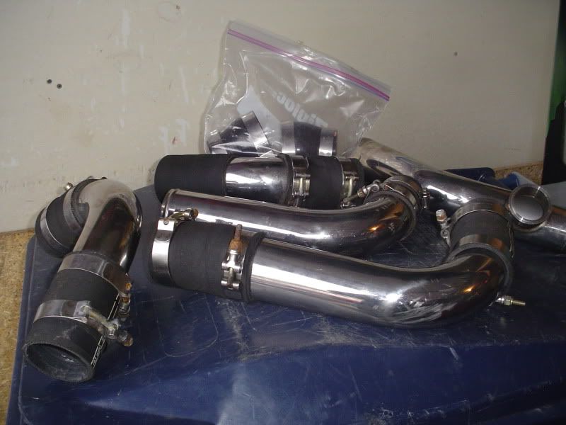

also traded the 95 awd tranny I had for the buschur 2g race fmic kit
it is going in tomorrow just have to move some stuff around on the car to get it to fit.

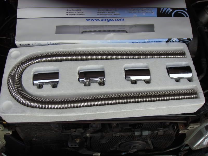

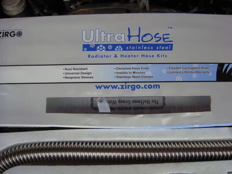

s.s. radiator hose got it for 60.00 comes with 4 ends and is 48in long so it is good for both hose's

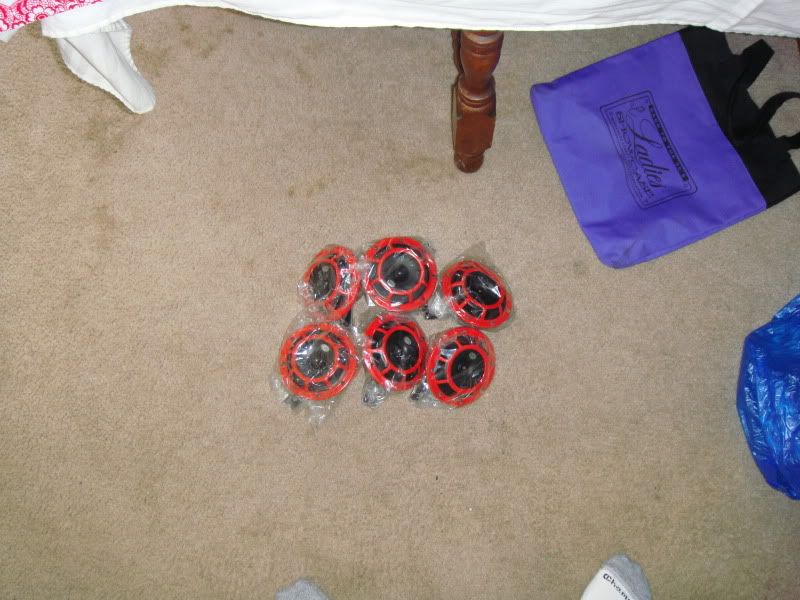

Found the best deal ever for horns for the car got a set for the evo,talon,and hatch. They are hella super tone horns the 118db ones that sell for 55.00 a set. I got them all new for 6.00 a set the guy had now clue what they were.
