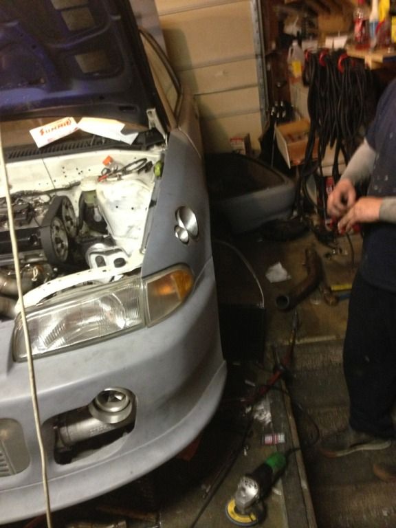

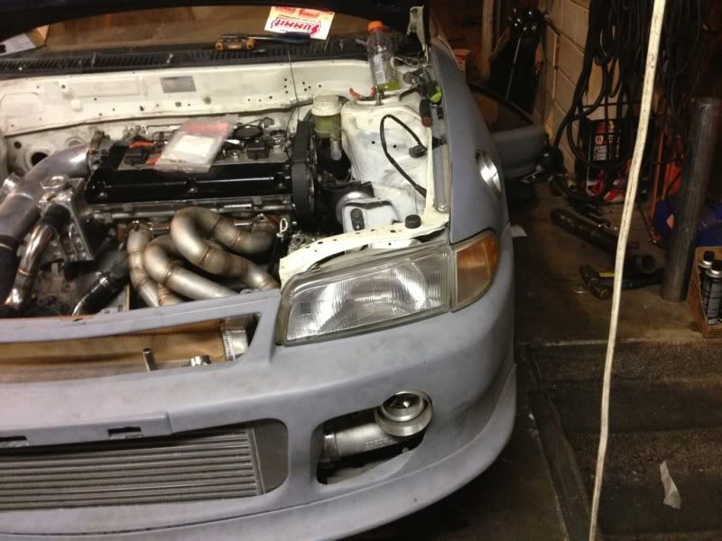

93 Mirage/ Evo clone drag build

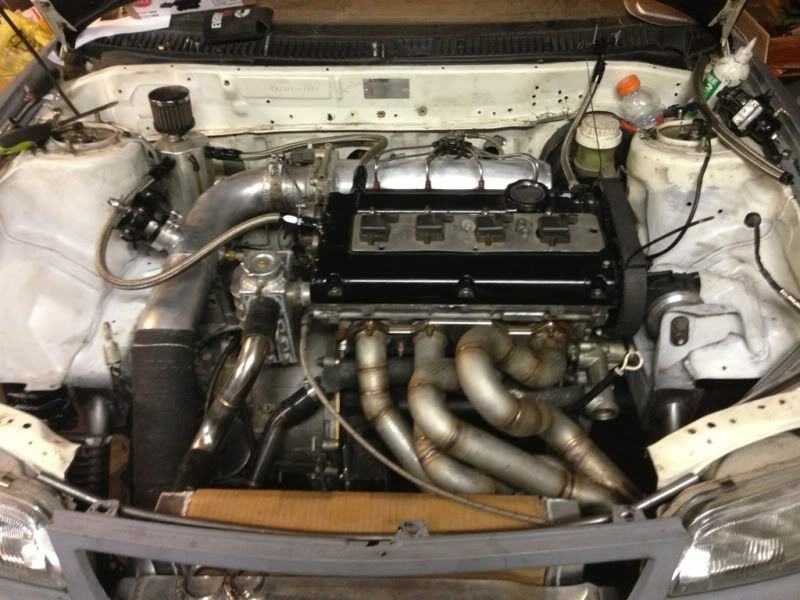

More pics and progress guys
evileclipse

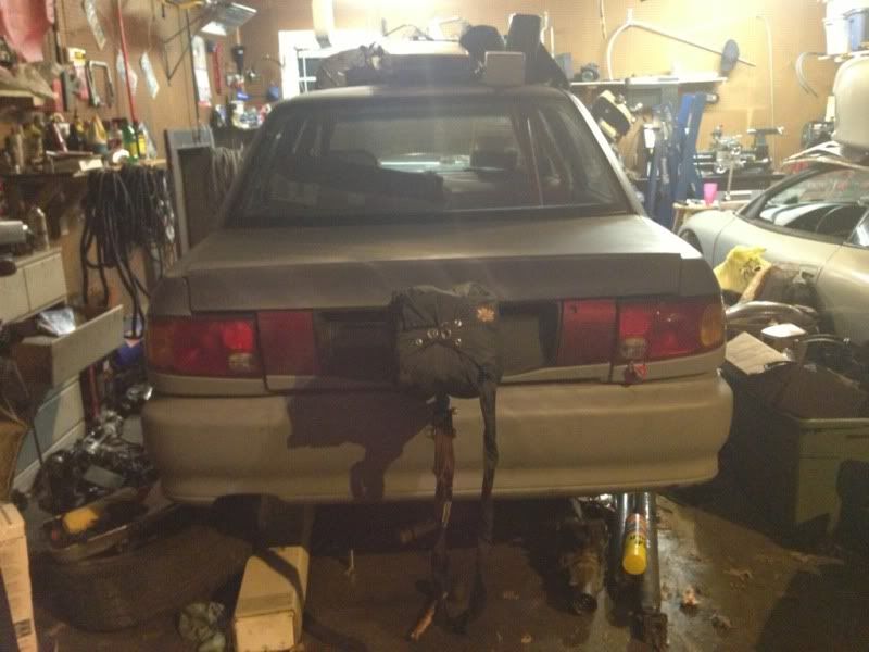

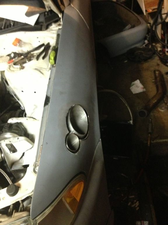

You can run the car I'm building. Haha The exhaust comes out the same fender.

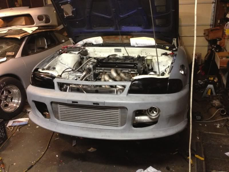

Working on getting it ready for a race may 4th.

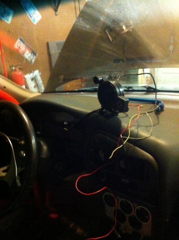

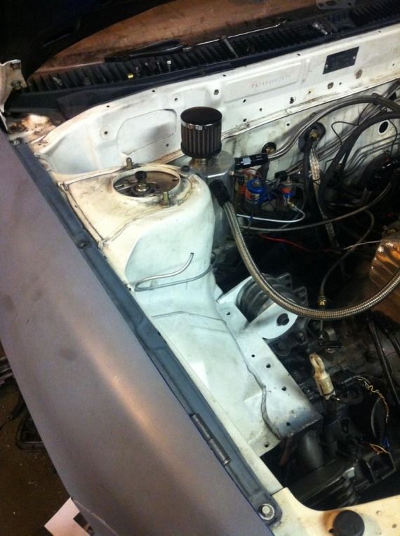

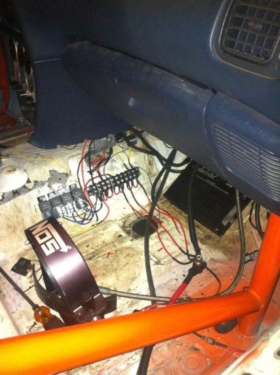

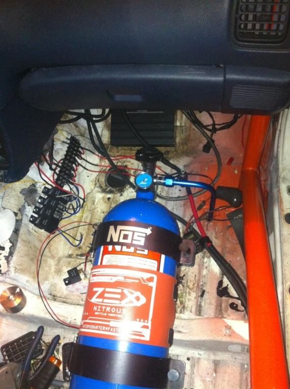

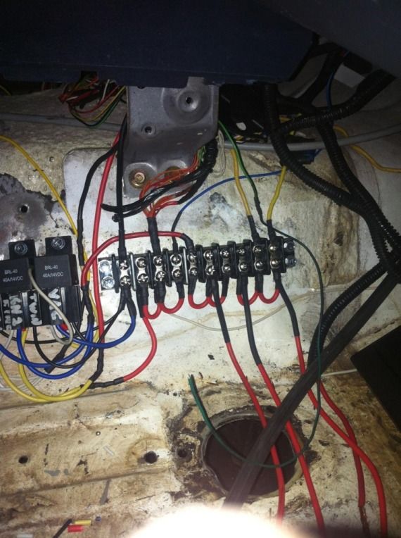

Working on nitrous and wiring

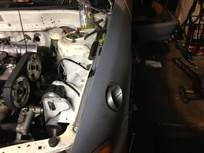

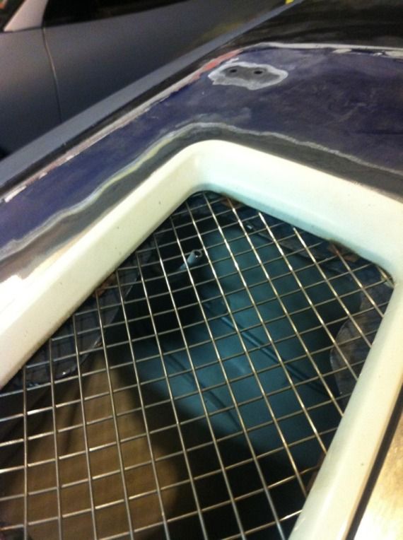

My ricer purge out the stock intake vent
Wiring

By chance have you had it on a scale yet?
Super badass! Once I'm done tinkering with my stupid 98 auto. I'm gonna start the awd swap on my rage. Nice work.

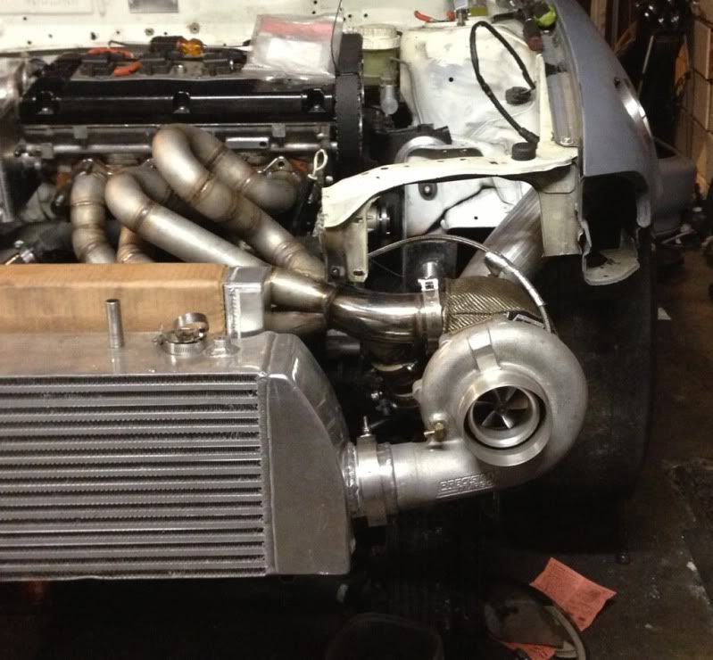

Not yet. I'm hoping comes in around 2400 though

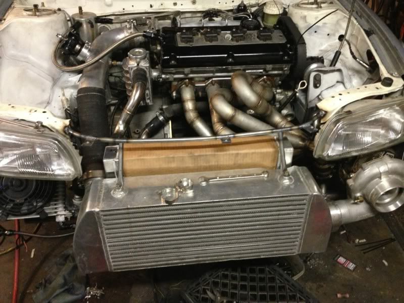

Keep the updates coming! Great work so far! How much more cooling capacity did you add with the custom radiator? Also, what torque converter are planning to use?
It added around another gallon from my old setup with the Honda radiator. So hopefully no more getting hot after a pass or worrying about other person taking a long time to stage. As for the converter I'm reusing my sinister 9" from my 1g. Pretty much everything is converted from it with some changes here and there.

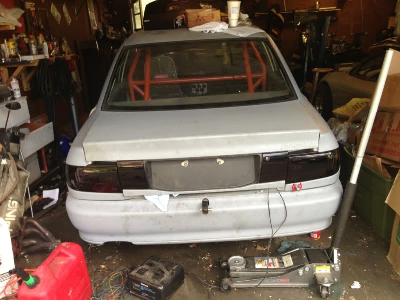

Felt like doing some VHT on headlights and tail lights.
Awesome. I currently run a honda half radiator with a 12" slim line pusher fan and my temps after the run are around 220* or so which isn't bad but I'd like to see it at around 200*-210* range. When time permits, I'm going to attempt building a fan shroud for the slim line.
I'm digging the obama styled headlights :cool: Keep the updates coming!
