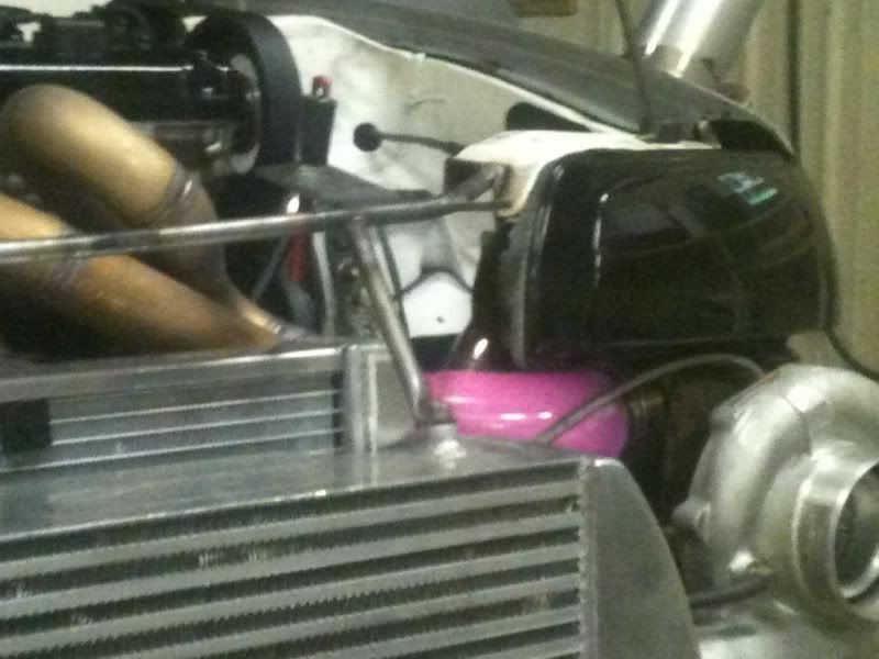

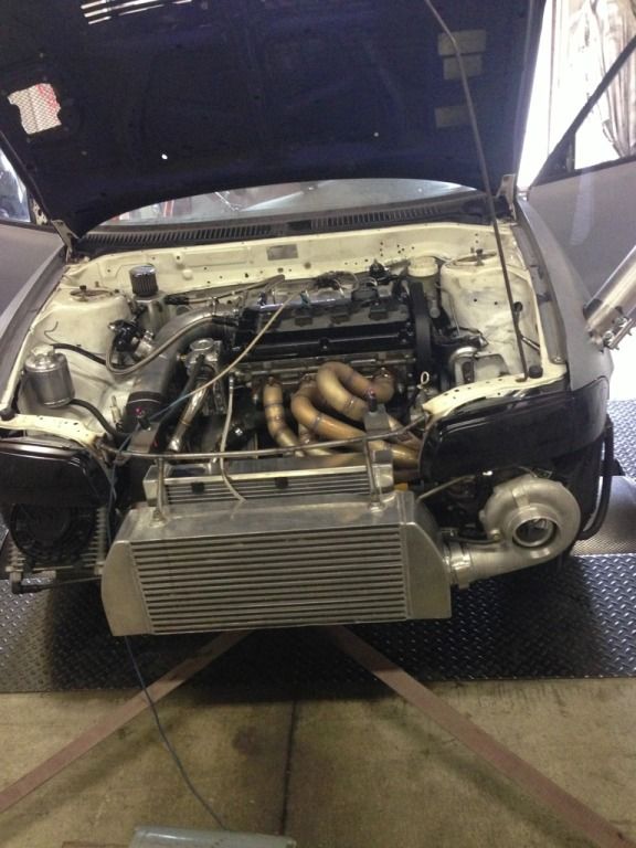

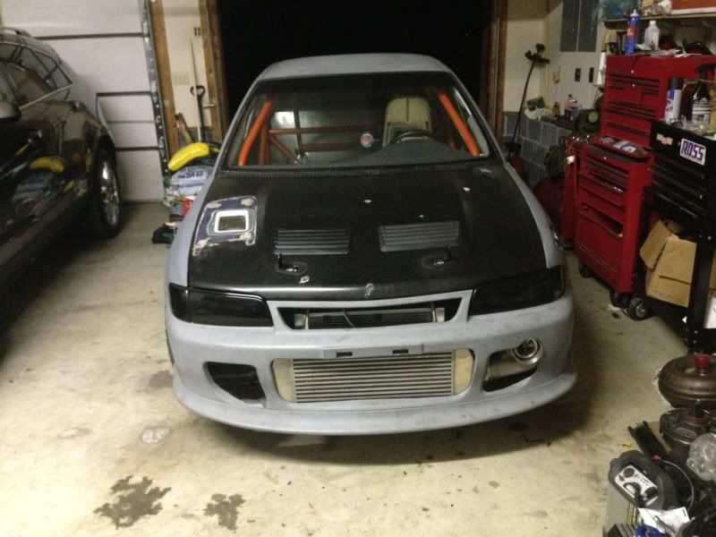

Well went to the dyno yesterday and had issues all day. Started at 10am ended at 2:30 am. I had an aem 5 bar go bad, as well an injector stick open dumping fuel into a cylinder, a few decent size oil leaks, and issues with the boost control solenoid. It was a long day and couldn't have been possible without friends loaning me parts. We made 522 on 26psi through the auto. Last year the car only made 550 at about 46-48 psi so we've made huge gains on low boost. Hoping to fix the issues and hit the track on low boost. We will be going back at some point to crank the boost and see what it will do. We had so many issues we didnt get any videos.

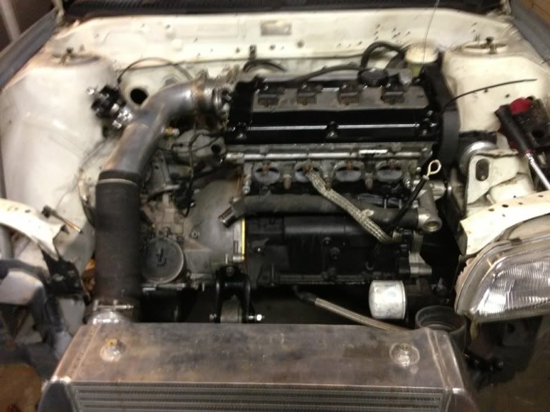

Here are a few pics though

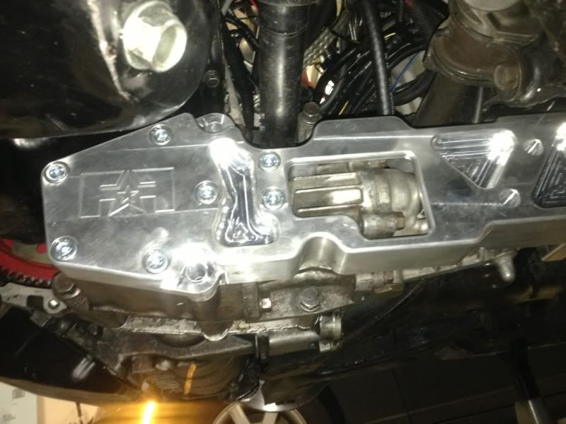

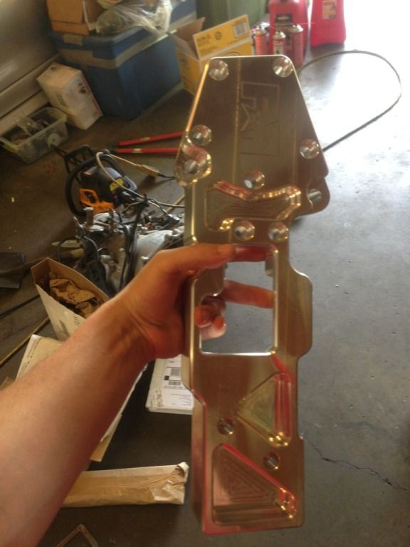

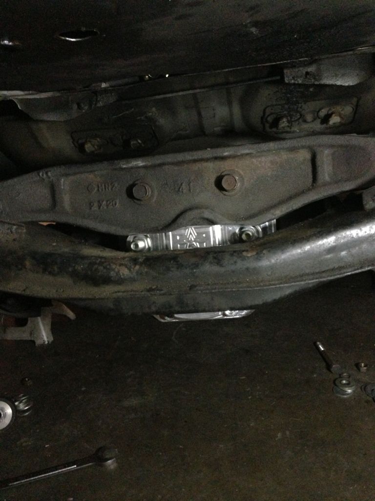

Transfer case brace in from frontline fabrications !

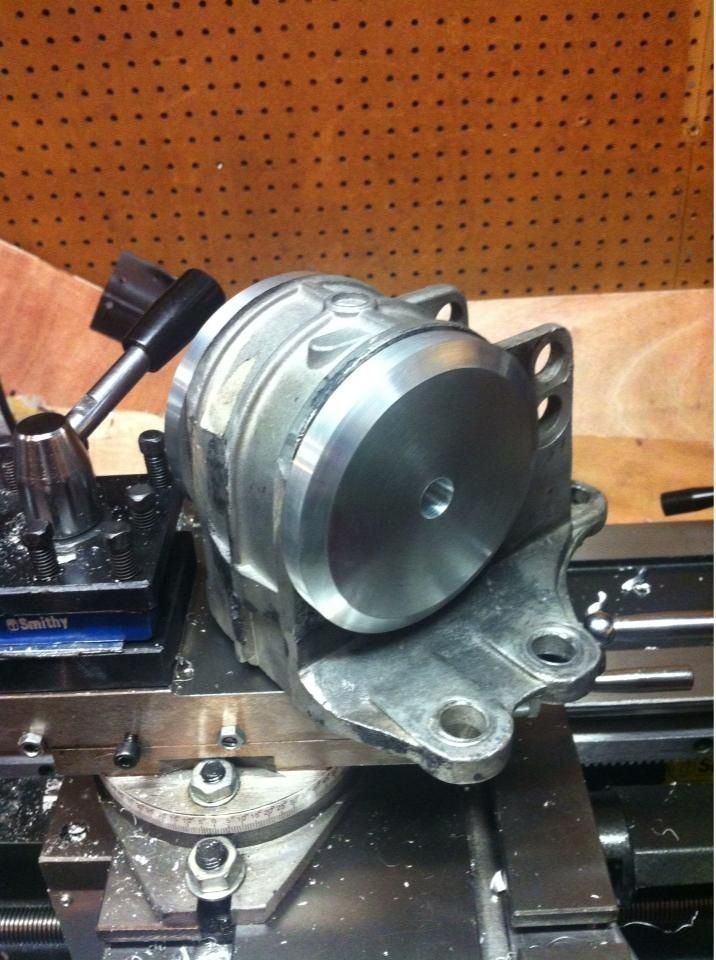

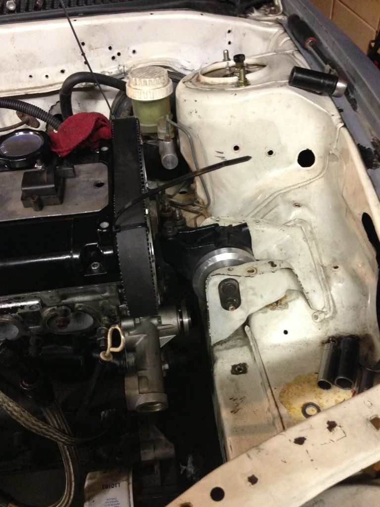

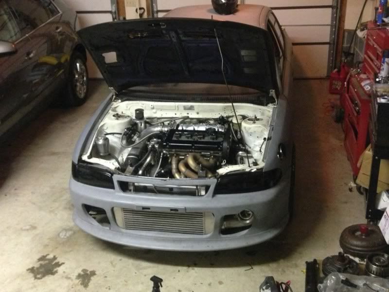

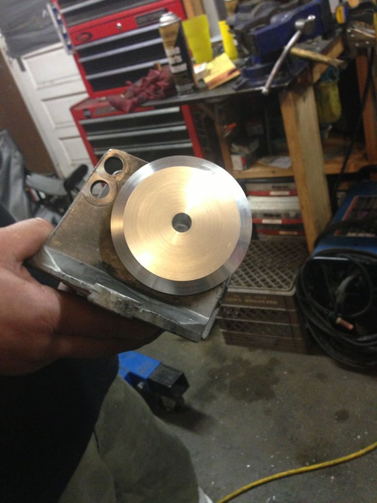

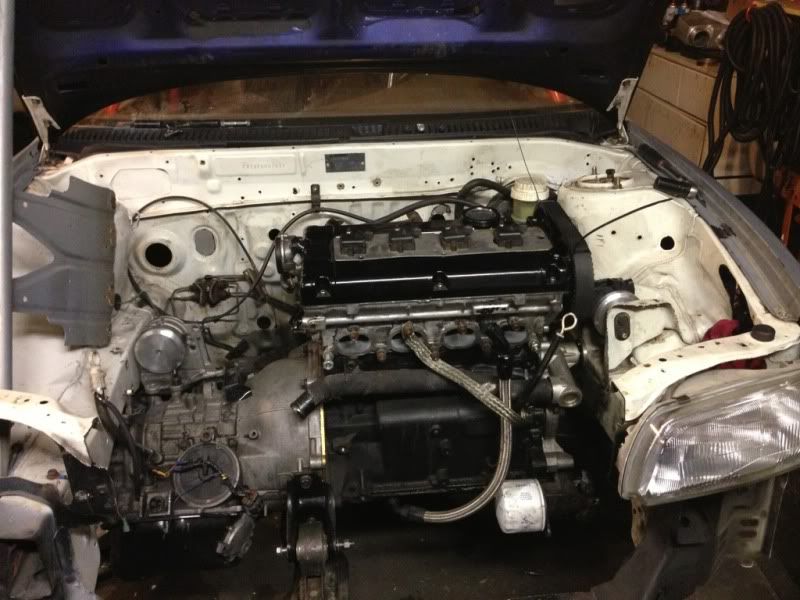

Finally got car to other garage. We just got a mill/lathe/drill press in. So we made some aluminum mounts and worked in getting rear diff and motor in.

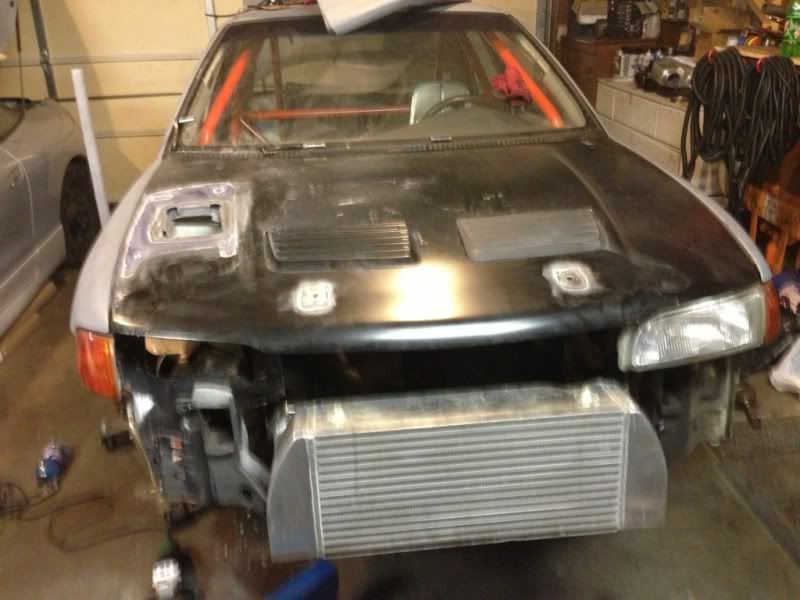

Bumping this for some answers.....tried atrempting an auto swap.......trans is hitting the pass side A arm, the frame rail, k member, it physically doesnt fit in my car. How did you even get that thing up and on and clearing everything????
