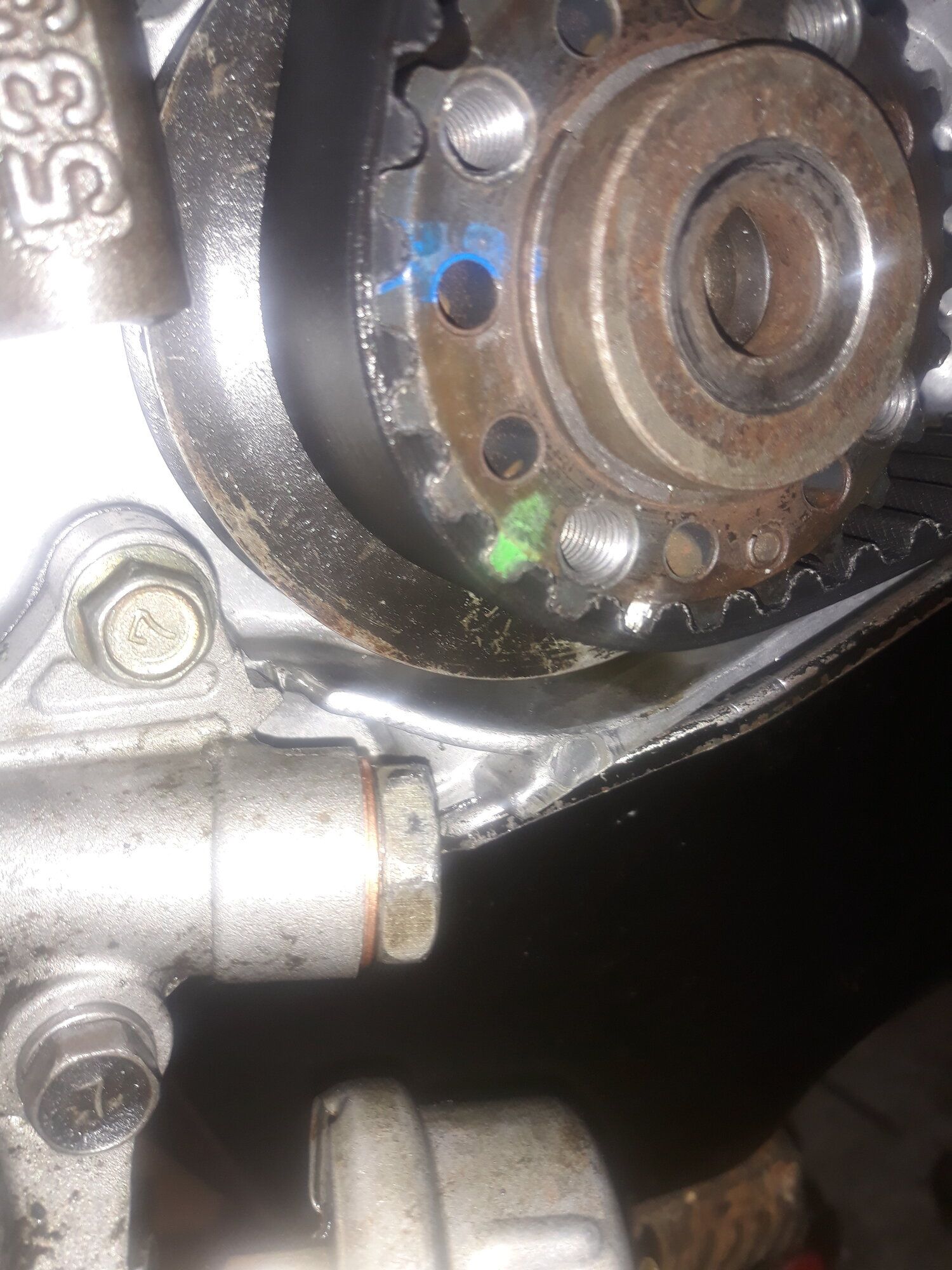

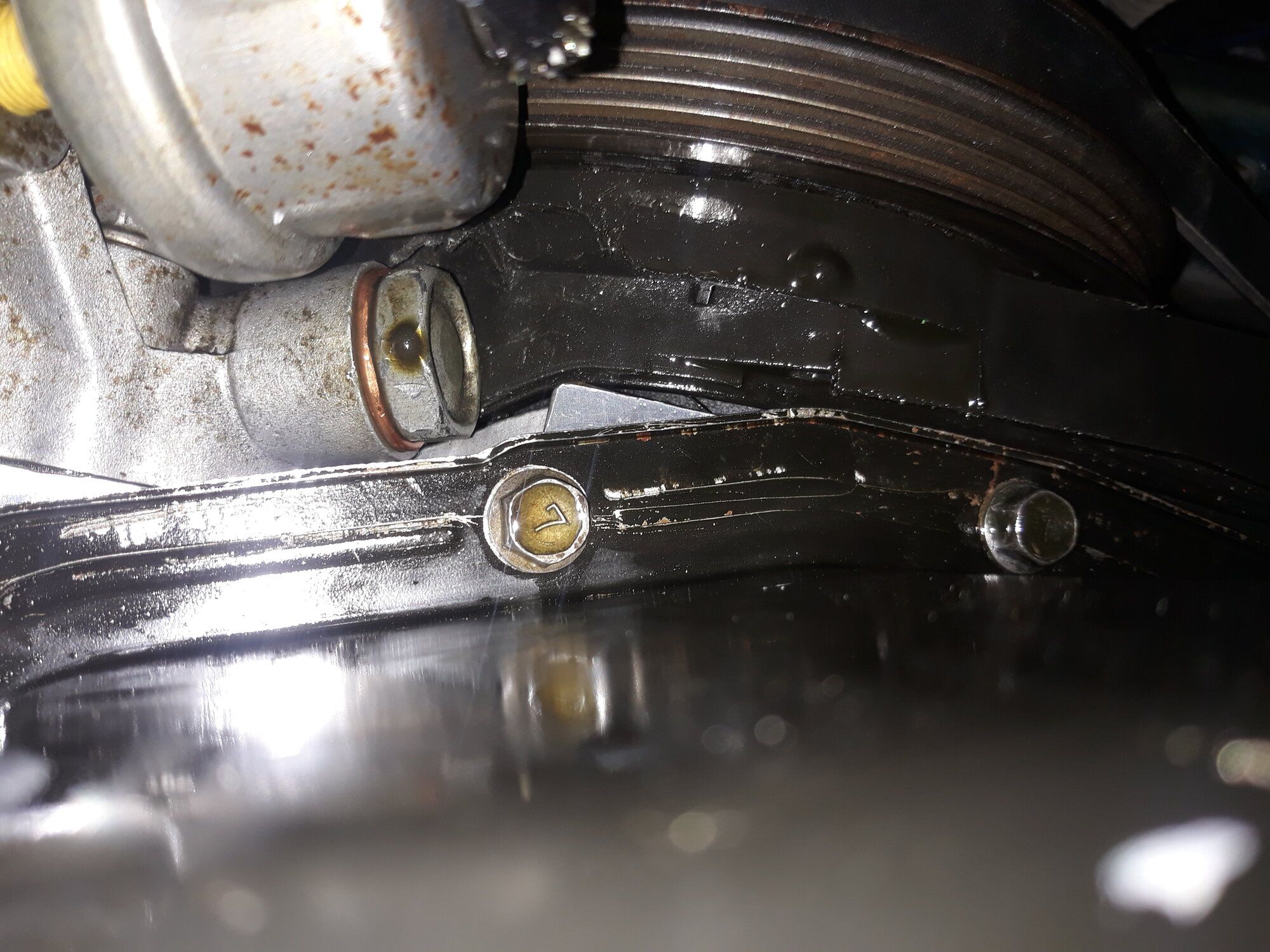

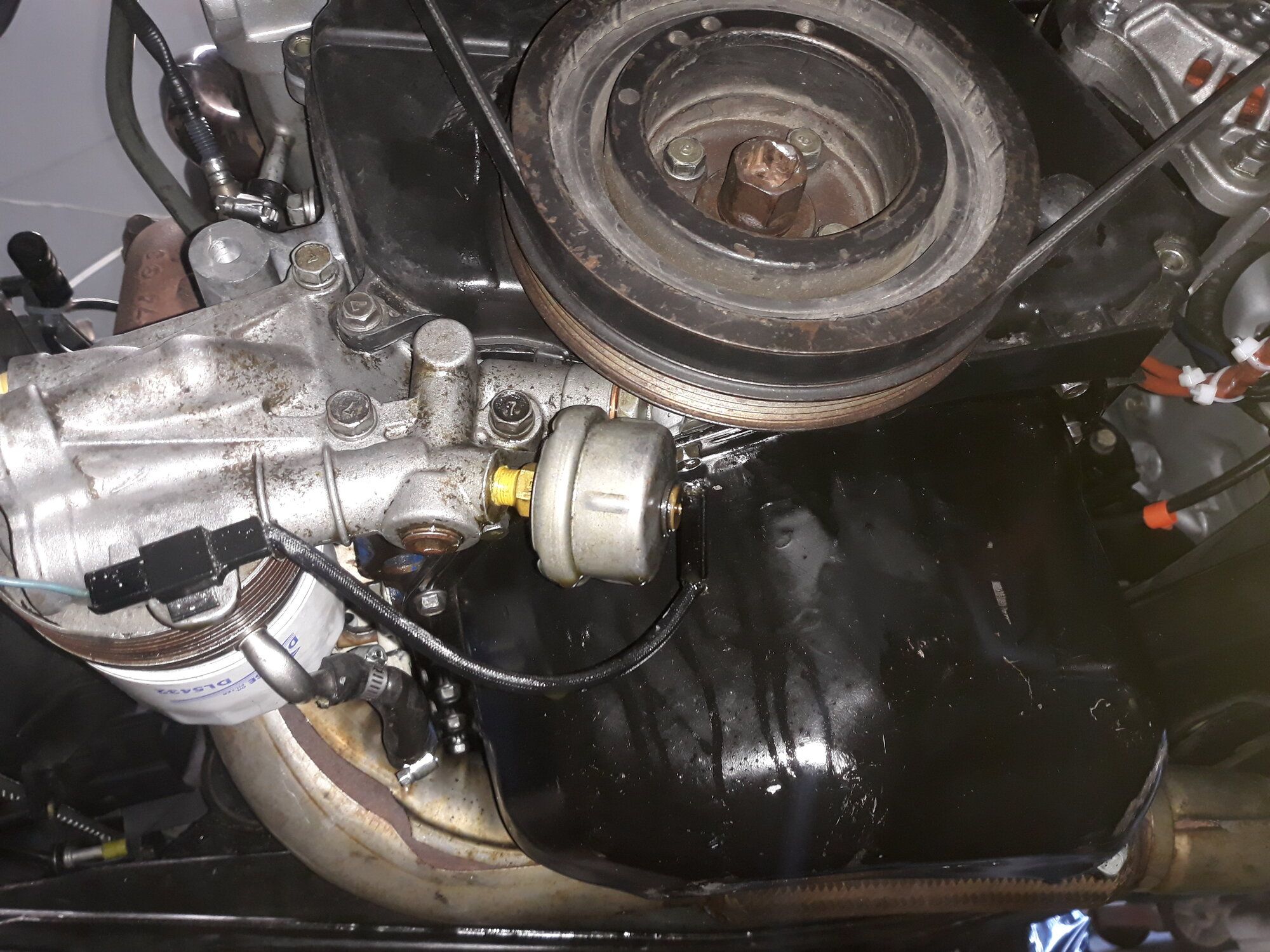

Looks to be under the cover. Remove the cover, clean it and run the motor.

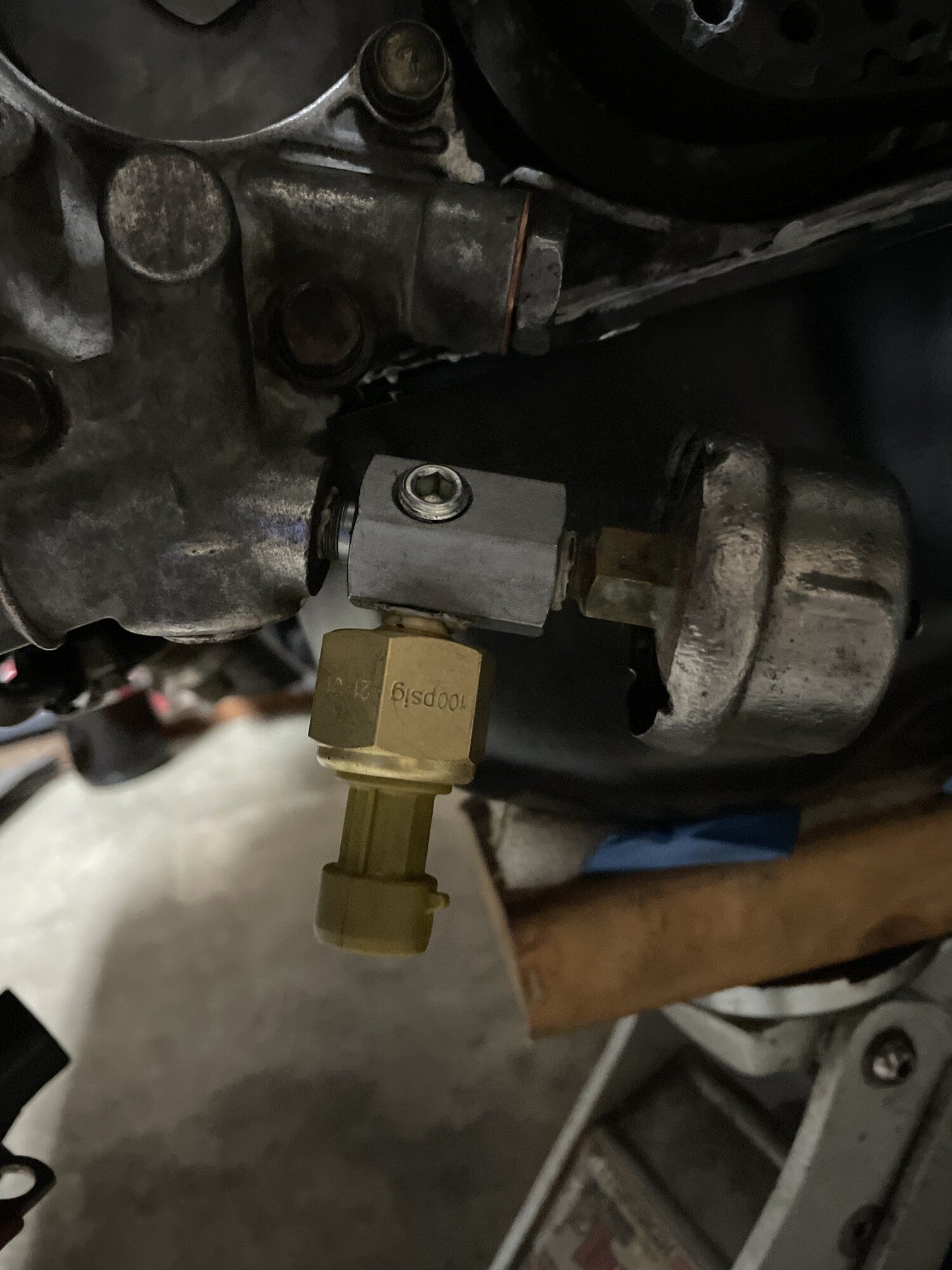

The factory oil pressure sensor doesn’t look to be in far enough. This is mine
I had cracked an OFH before this one. Im not leaking from there, but yes i am afraid to go a bit more. I believe i have enough thread on it, good eye tho.

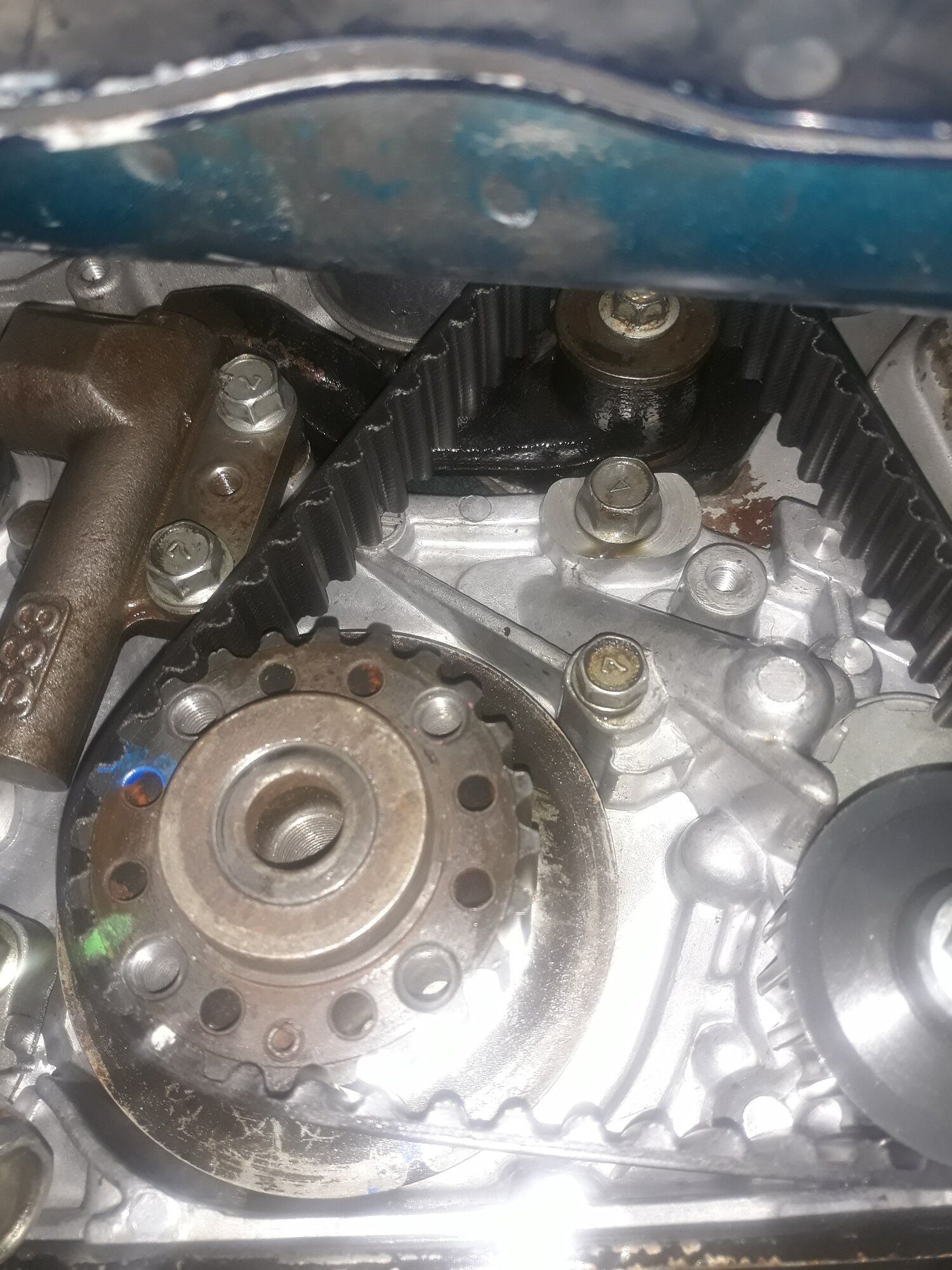

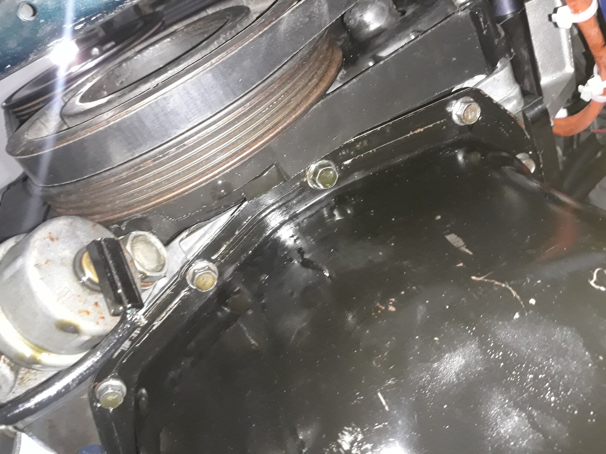

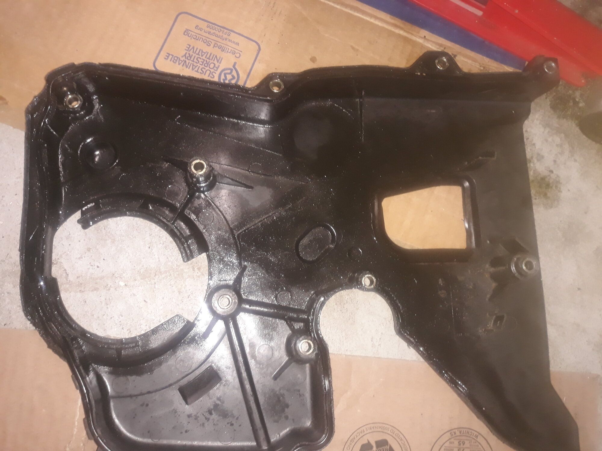

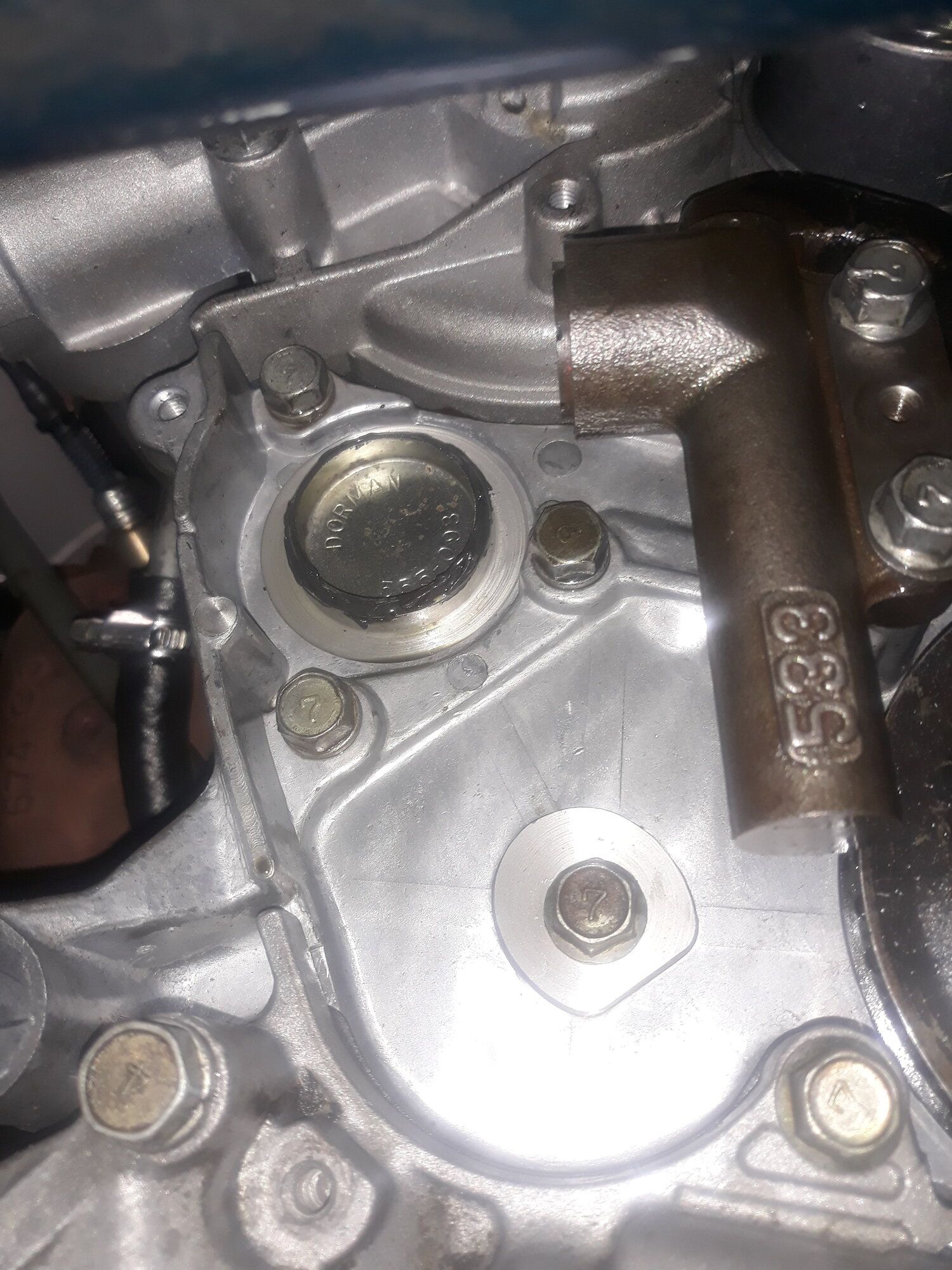

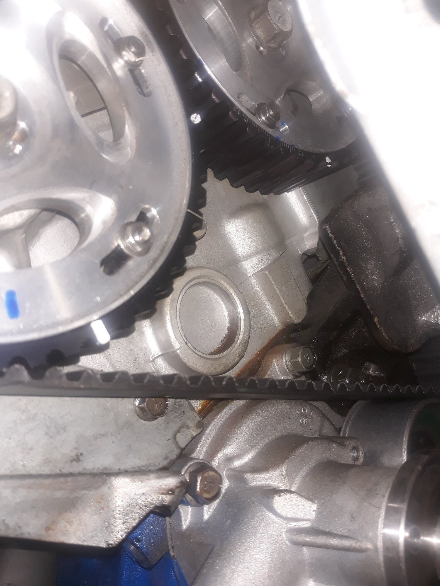

The timing belt will fling it up as you can see on the inside of the timing cover. How old is the crank seal, oem?
I rebuilt this with all new seals. It was an older(new) seal though i believe. I was gifted a lot of oem seals but this build is over 10yrs old and seals could be weathered. Could have failed or user error.
If you’re going to remove the pan, put it on a flat surface and check the flatness. Two of my bolt holes were stretched about 2mm so I hammered them flat. I think that’s going to fix mine.
Im going to let it cool for couple of hours. Ill remove the pan, check flatness, & go over all the bolts for it as well. Ill be back to attack it, this evening. Thank you so much Tony & Vegas for your patience & time/help. Yall some real ones 💪🏼🤝🏼🤘🏻

Oil leak fixed, added new seal to the oil pump which is brand new. Used dawn soap and water bottle to let it trickle/pour down on belt, i hand turned cleaning oil off. Its very clean & the bt is fine.

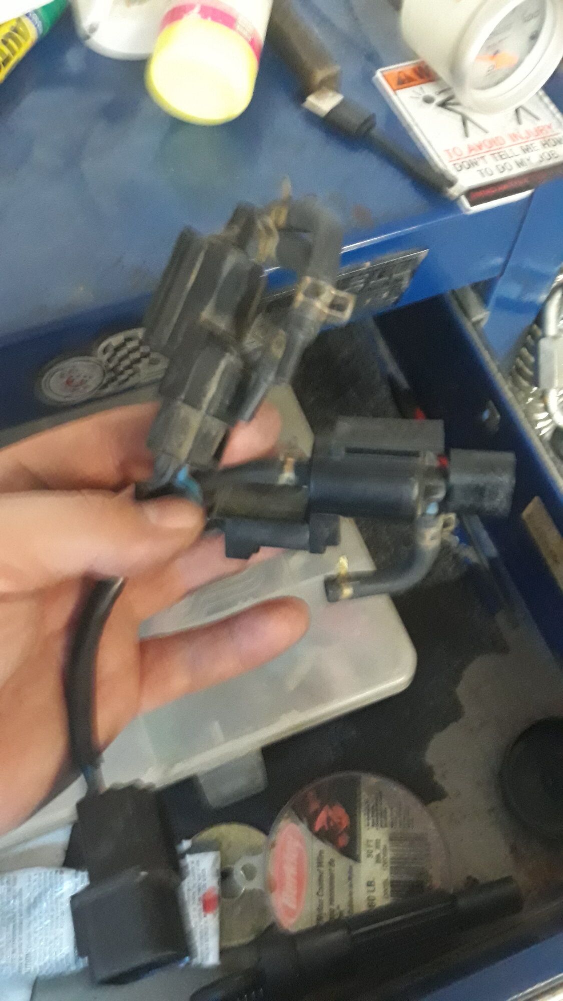

Idle surge was next issue to tackle before anything. All seals, o rings etc had been replaced on throttle body. Tony & i diagnosed the iacv stuck. Took it off, ran hot hot water on/thru it to see it function. It did not. We attempted to repair, no luck. Purchased a bypass plate, deleted the water coolant hoses and the issue was still there. I checked my isc for continuity & volts. It would only budge a hair when power was applied. I mistakenly applied 12v which it says NOT to do. My isc was fried. Purchased an inexpensive ebay isc for 20 bucks. Isc still reads 0. We took off all vacuum lines to pin point leak. No leak but we eliminated the bs in the corner for emissions
I ran one intake hose straight to my boost gauge and the other to my adjustable fuel pressure regulator. Isc still at 0. We upped my set rpms for my 280s at 1k and isc started reacting more than it has ever. Isc at 30, tps at .63, no surge.

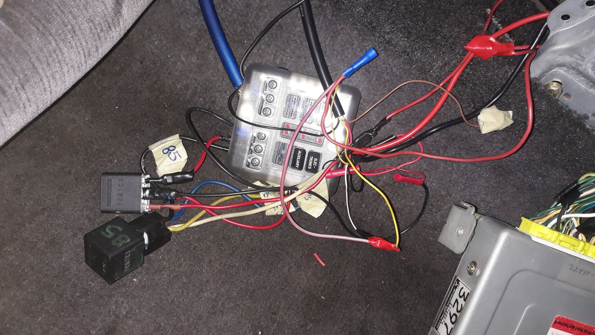

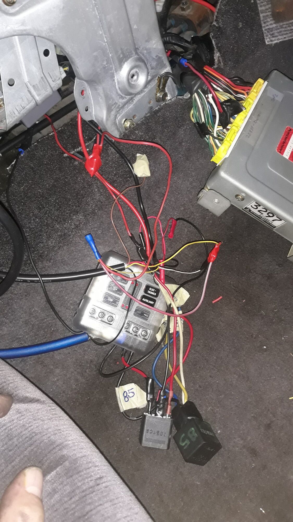

That would lead me to believe there is a wiring issue. 7.2afr= 0 volts for an LC2. I would think there is no signal to the gauge from the o2 sensor
Youre absolutely right. I had wrote ecmlink to see if they have had issues with 02 sensors being dead on arrival. They just sent me the wiki links and instructions. Yes, they did write me a little help & i knew it had to be on my end.
Maybe the lc1 is wired differently, maybe i had to much going on because it was the first instruction i had missed. I was one wire off. The gauge & everything began to work. I noticed it didnt show up in link & a quick article from Marty said i needed to split that signal wire. The lc2, gauge and link are working perfectly fine.
Wiring up this lil fuse box probably overloaded me. Now these relays, boxes & other electronics are so much easier to do. Im still learning these terms like deadtime, global, afr, lftlo, etc.. ill get it soon. Tony has been in Miyagi mode & has helped me get this thing rolling. FOREVER grateful for all yall🤘🏻🤘🏻🤘🏻

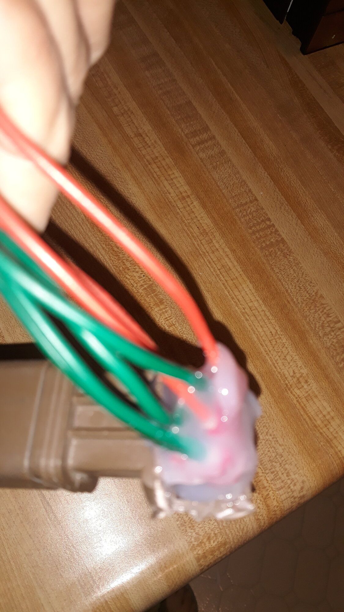

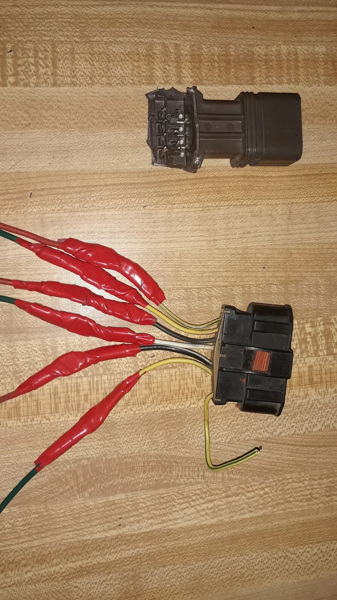

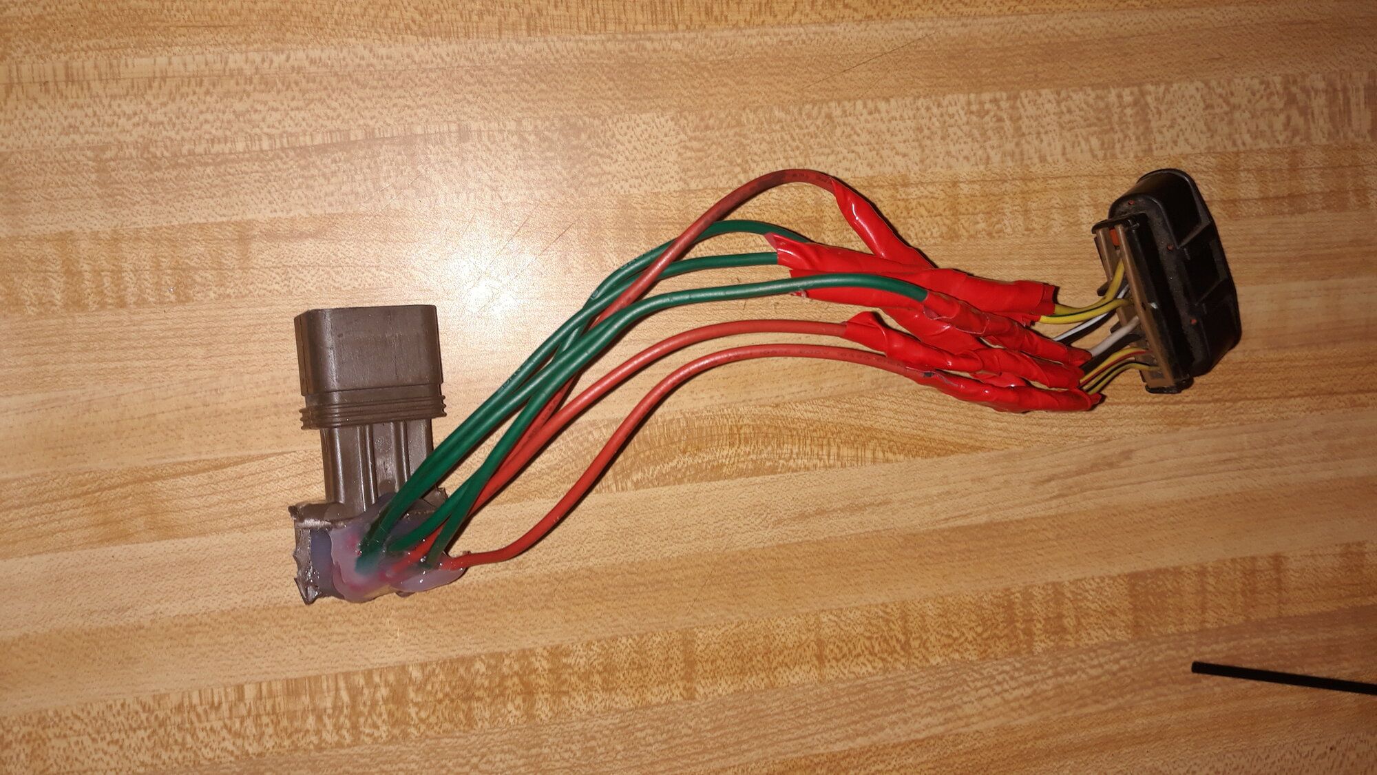

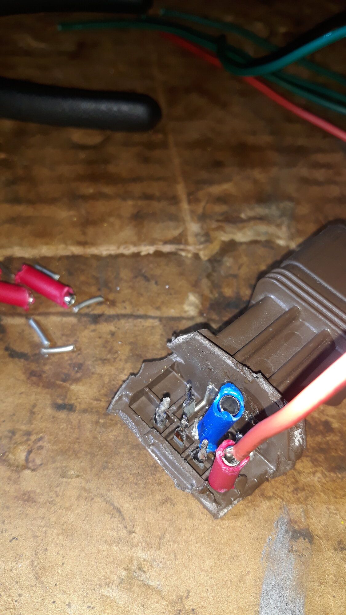

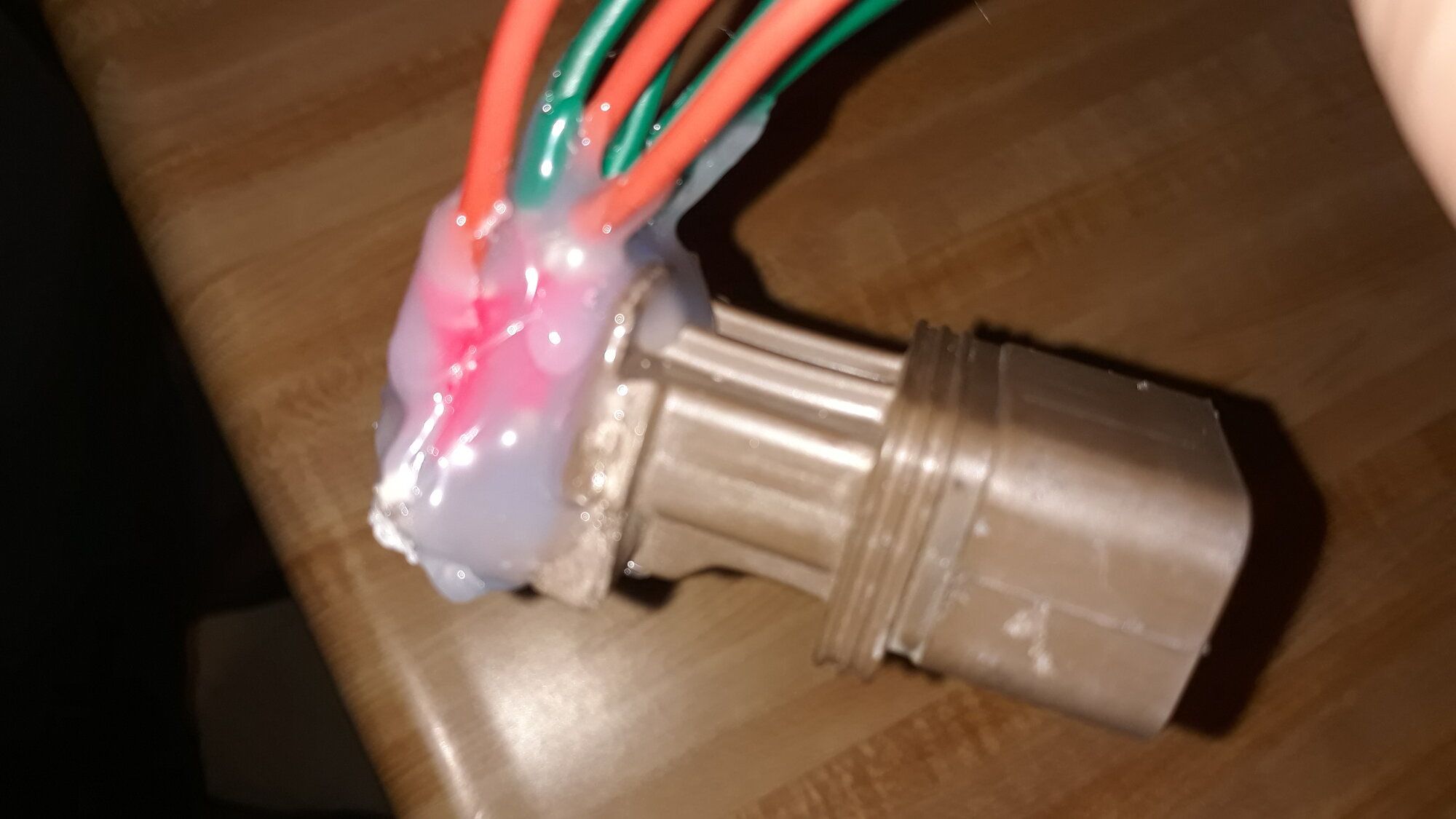

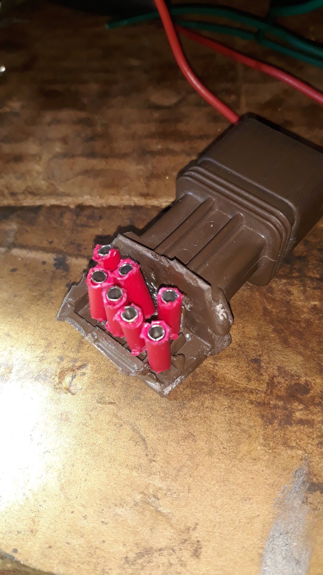

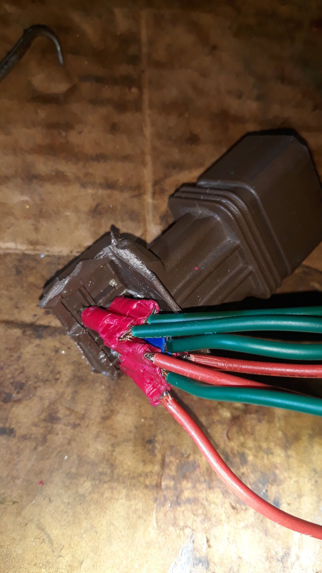

I have a box full of connectors, one being a transistor. I removed pin 8 and put in pin 5 spot & followed the instructions on dsmfaqs site. I ripped my 1g maf apart, extended the wires on the transistor & began.
I tried soldering but im using a pos tool, im jacked up on coffee so my hands are in no shape or form for this type of surgery LOL. I place a connector, a piece of solder and placed wire in, hoping i could heat the wire and the solder would bind it all. It didnt LOL
I just pre crimped to place over the prongs, it fit snug so i cramped onto wires next, then placed back over. I used my ryobi glue gun afterwards to hold it all into place. I checked continuity & everything looks extremely promising. Ill wrap these wires up with that black plastic wrap stuff tomorrow & we should be good to go 🤘🏻

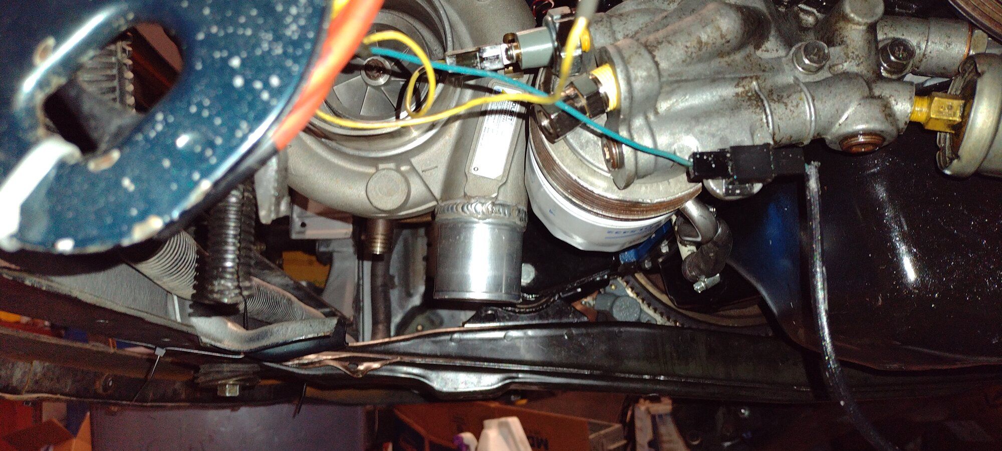

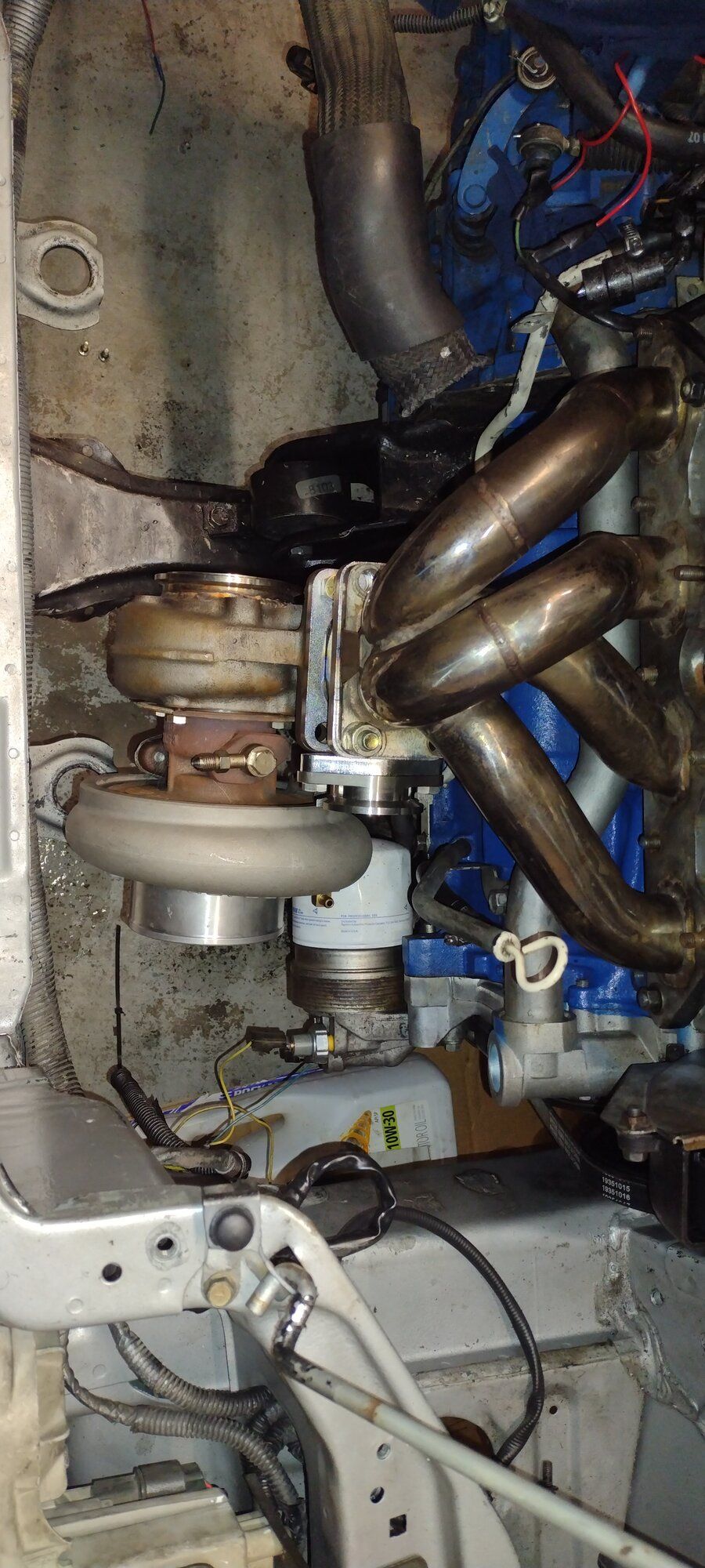

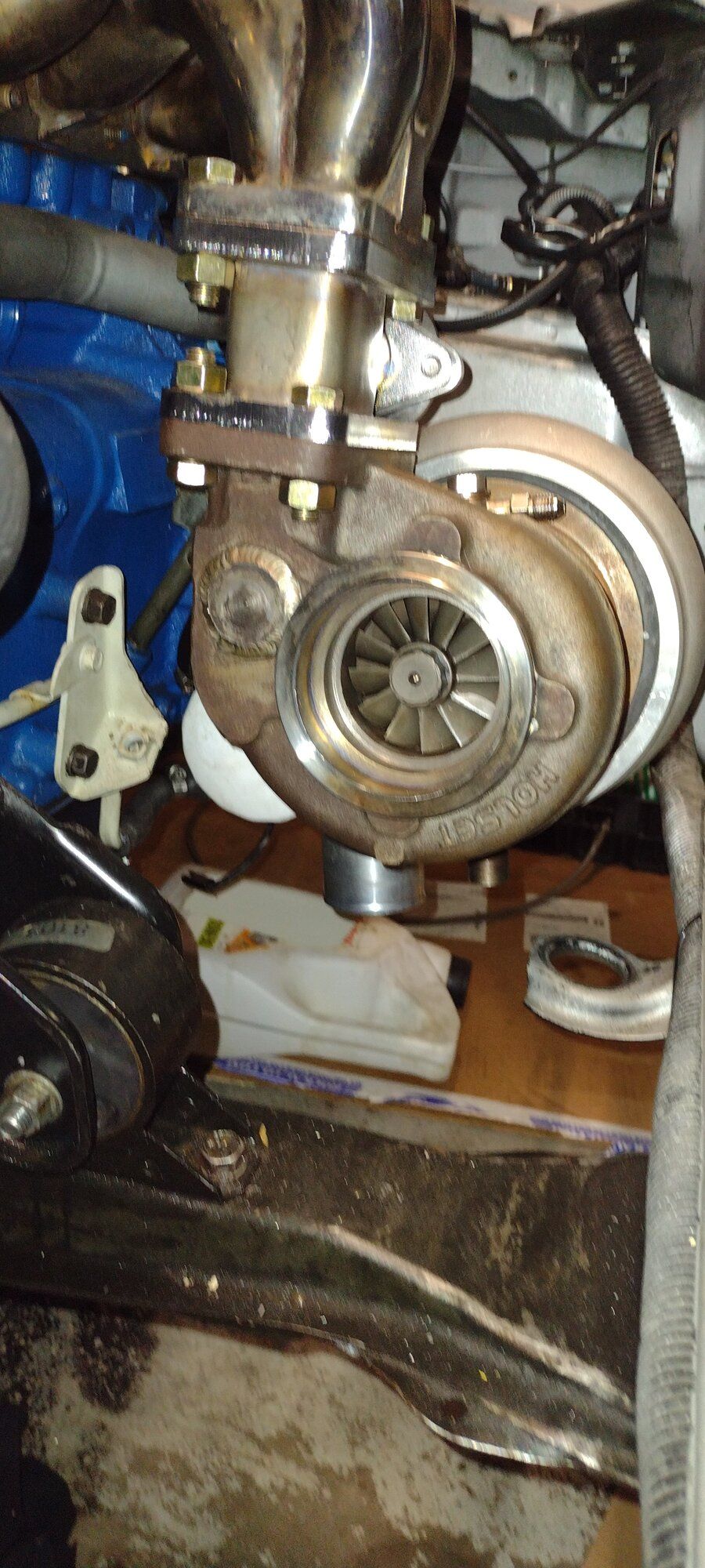

This he351 isn't going to fit. I've clocked it in all directions & with this OEM radiator, there's no chance. I have an mvr44 & this brand new turbo & can't do shyt with it. Now I gotta read up on which bolt on style turbo will help push this engine. I'm not paying no 800 + for a manifold and I'm not replacing this radiator. I still need a fmic LOL
I feel my best bet is to sell all this stuff & save up for a new setup. My brain hurts from all this 🤬🤬🤬🤬
Bummer. Yeah there’s a lot that goes into turbo selections that aren’t stock frame. Good luck Lorenzo!!!
Right on T🤘🏼
I'm looking into a 20g setup. I can't sell this stuff. I rather throw it back in the closet till a time comes. I ain't done with machine. this isn't the first time it's said no to me LOL.
So what's the current status of the car? Running and driving? What about pulling a radiator from a small car at the junkyard and mounting it under the front core support? Can usually create a few easy inches that way.

The vehicle runs perfectly fine. I didn't get to drive it much at all cause my 1g maf was acting up. I have the 2g maf now but I don't think I can get it hooked up to the holset. I have Speed density but I need a front mount because my iat sensor is on a straight pipe and I only have OEM side. I gave my 16g to my brother with his Honda setup. He was saying the same thing about using a half sized radiator. I'm just not familiar with these Mitsubishi cooling systems. We know they're extremely picky and I'd hate to be fighting my car to keep cool.
I have a t3 to t3 adapter w a wastegate spot on side of it and that throws the turbo out forward a bit. Im going to look and see if I can push the radiator out forward like you say. That could definitely help.
It's either pay for a 20g and bolt it all up w the side mount and 2g maf, or purchase a fmic and small radiator to hook up this turbo up to SD. One is easier and will cost me less.
