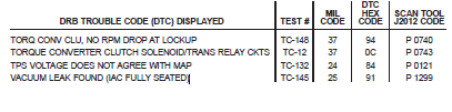

I'm posting this for all the people running evo scan with false codes appearing when checking for dtc's. Codes such as code (24) vehicle speed sensor and code (31) knock sensor, in reality those codes are for different things altogether. This list is a cross between Mil codes and P codes and should help with finding the actual problem and tuning off different periphery bits.
Hope it helps!
