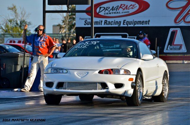

Car went 2 passe down the track and then they kind of looked at me seriously after running 9s and not having a fire jacket. So the talon went 9.92 at 138.9 mph. Going back friday with a boost controller and a fire jacket and we will see if I can get here down. Car is extremely smooth. High 11 AFRS with pretty moderate timing for e85. These freakin FIC 2150s are awesome. I am only at 60% IDC. Plenty of injector to go. Tuning this car with DSMlink has proved to be easy no matter what setup it has had on it. 5 bar map sensor and the car idles like stock. Spent maybe 30 minutes tuning the car. All the Kiggly parts are holding up. I am going to make sure the torque converter bolts are tight tomorrow but I am sure they will be good. Here is the time slip:

That pic makes me want to cry. Love it! This was one of two cars I was really looking forward to seeing results from. Can't wait to see what else is in store, congrats!!

and that is a sick ass picture!
