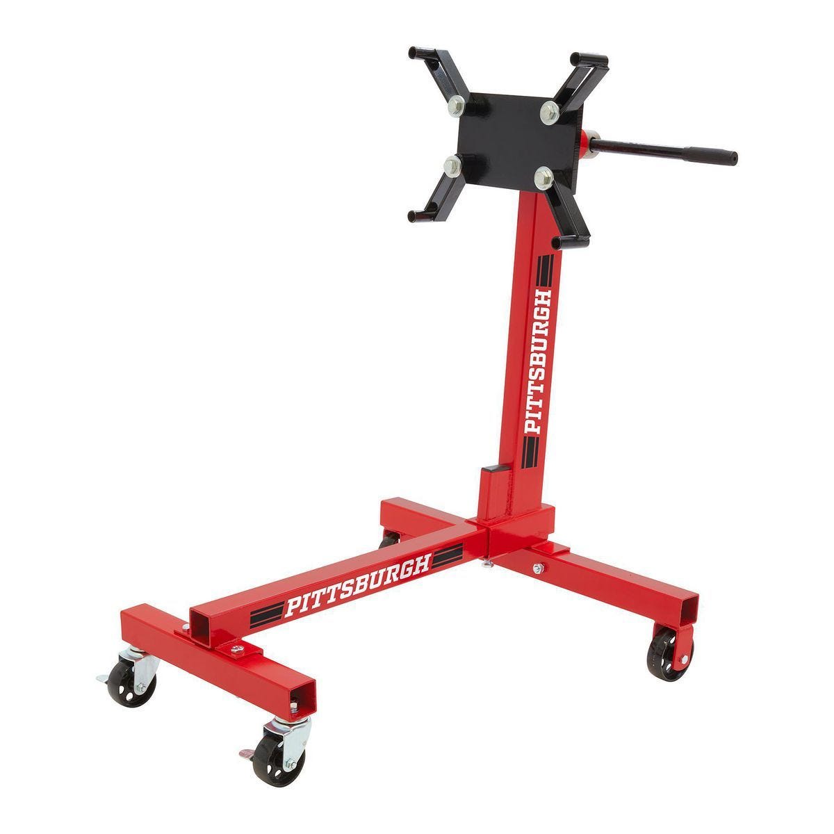

Most stands should be universal. I used a harbor freight stand like this:
You have to remove the transmission, use longer bolts and mount the stand to where the trans was bolted.
Do you know the exact size of the bigger bolts? And thank you!
M10 but length depends on your stand. I bought mine a little long and used a stack of washers so they wouldn't bottom out.
I have the same stand you showed but the reason I didn't use it was because they had told me the bolts wouldn't fit it. That's why I was asking what engine stand would work with it.
I didn't buy my stand new, but as far as I know, they don't come with bolts that mount to the block. Just go pickup some M10 of the proper length from your favorite hardware store.
Same stand. :thumb:
My bolts are 3" long BTW
Little more detail - your bolts need to be M10x1.25.
I used 75mm bolts and about 3/8" of washers.
Same stand. :thumb:
