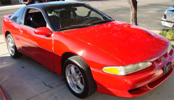

A true barn find
I know nothing about this car. I am looking to make a fun car out of it.
Thanks a lot guys I’m pretty pumped! Knowing nothing about the car other than what you can see where would you guys start ? The previous owners knew not one thing about it and wasn’t able to talk to the builder.
