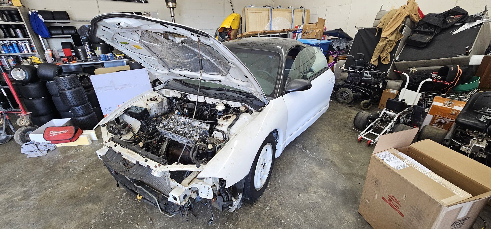

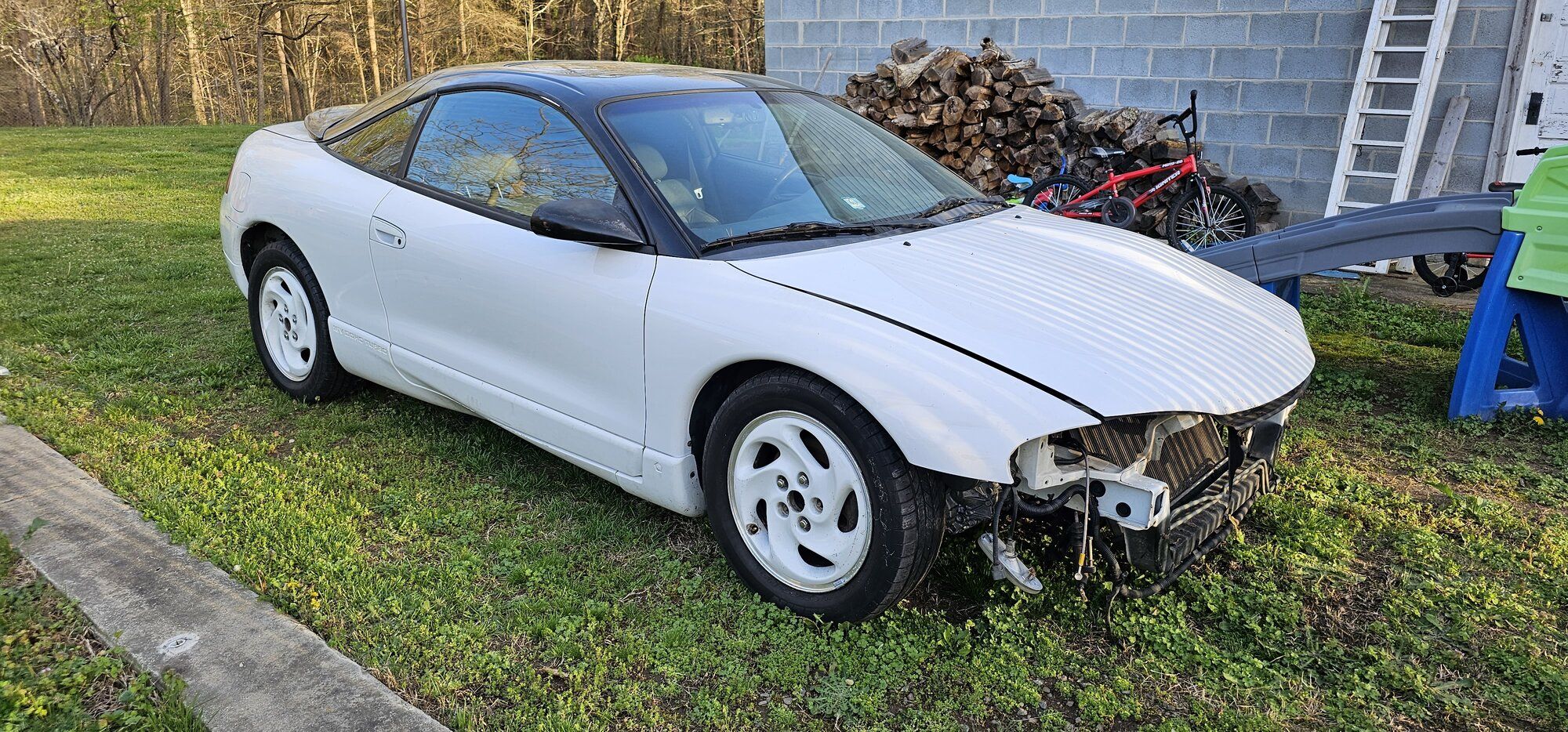

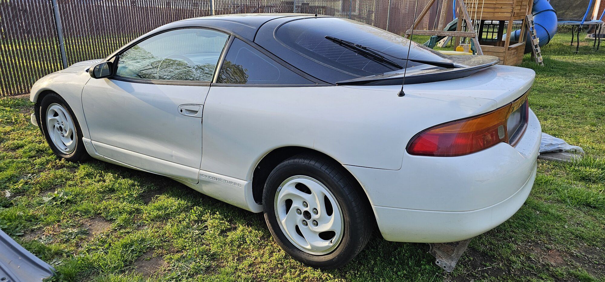

Hey guys. New-old member but couldn't remember my old username. I had a NA car waaay back when (almost 20 years ago) and always wanted to finally get ahold of a AWD Turbo car. Found this gem about 10 minutes from me and had to buy it.
It's been sitting in a garage for 15+ years. Mostly stock besides some coilovers, but the engine bay had been pretty well stripped down for a build. 117k miles and virtually no rust anywhere what so ever.
Short term goals:
Get it running driving in a fairly stock form then enjoy the "build" process over time. Drive it to work some and just enjoy the car. Maybe some mild bolt on's and get it looking nice.
Long term goals:
Maybe 400-450 wheel horse and keep it mostly street-able. Occasional auto-x or drag weekends and some local car shows like Cars+Coffee.
Trying to get the car on the road, running/driving for under $6k. So far I'm in it for $4500 for the car and motor.

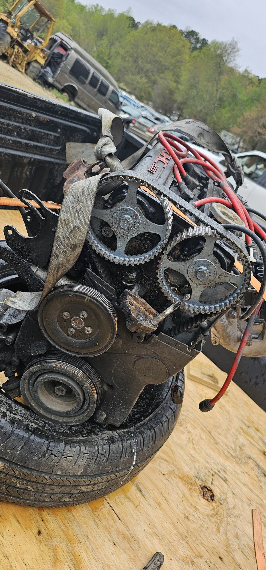

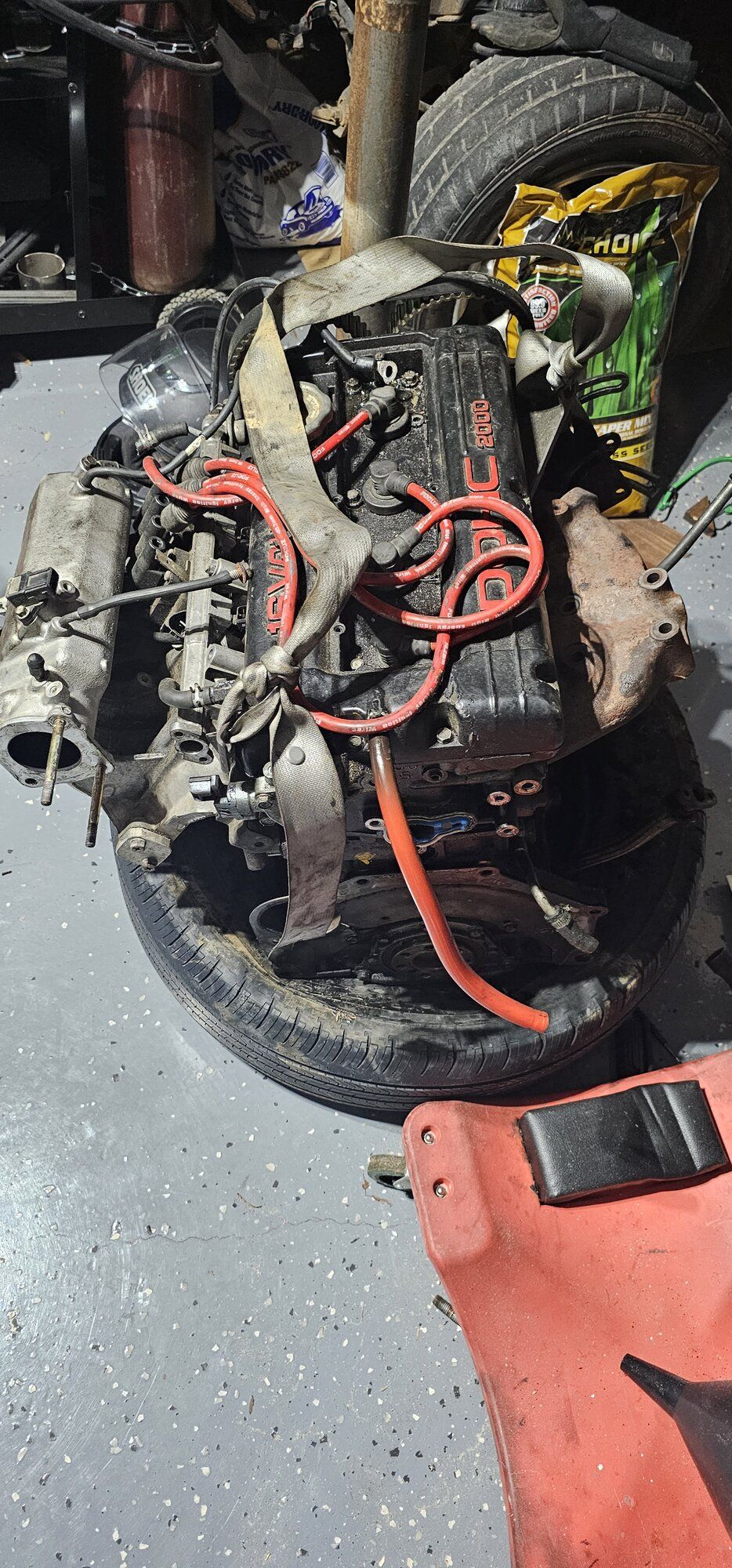

Motor: Got one picked up from the scrap yard with 107k miles.

Looks very clean. I'd say you found a good one, and TEN MINUTES FROM YOUR HOUSE......NICE!!!!!
Nice dude congrats , I found a 95 tsi 10 min from my house but the rear section of both rocker panels are rusted bad , your lucky you found one so clean .

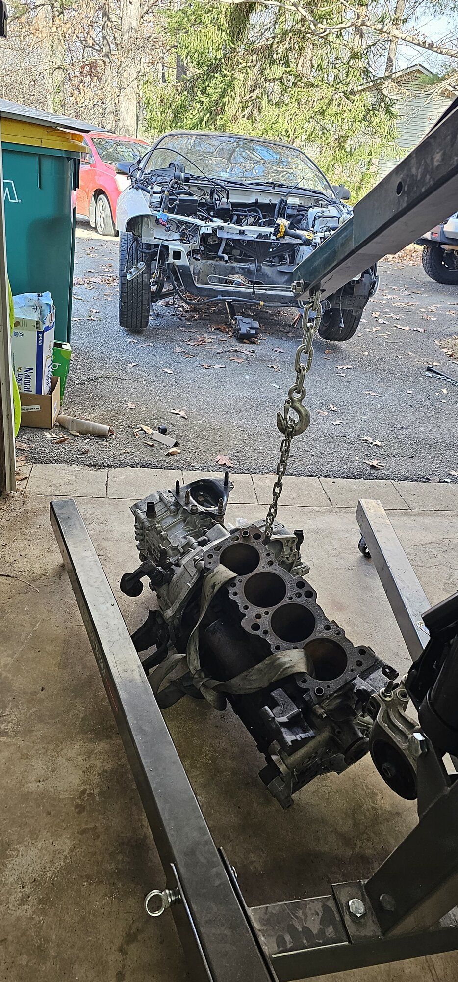

Guess I'll hop on for a 1 year(ish) update.
Slow progress. Life's busy yadda yadda. I'm also not a mechanic so I'm slow. This is a forever car so I'm in no hurry.

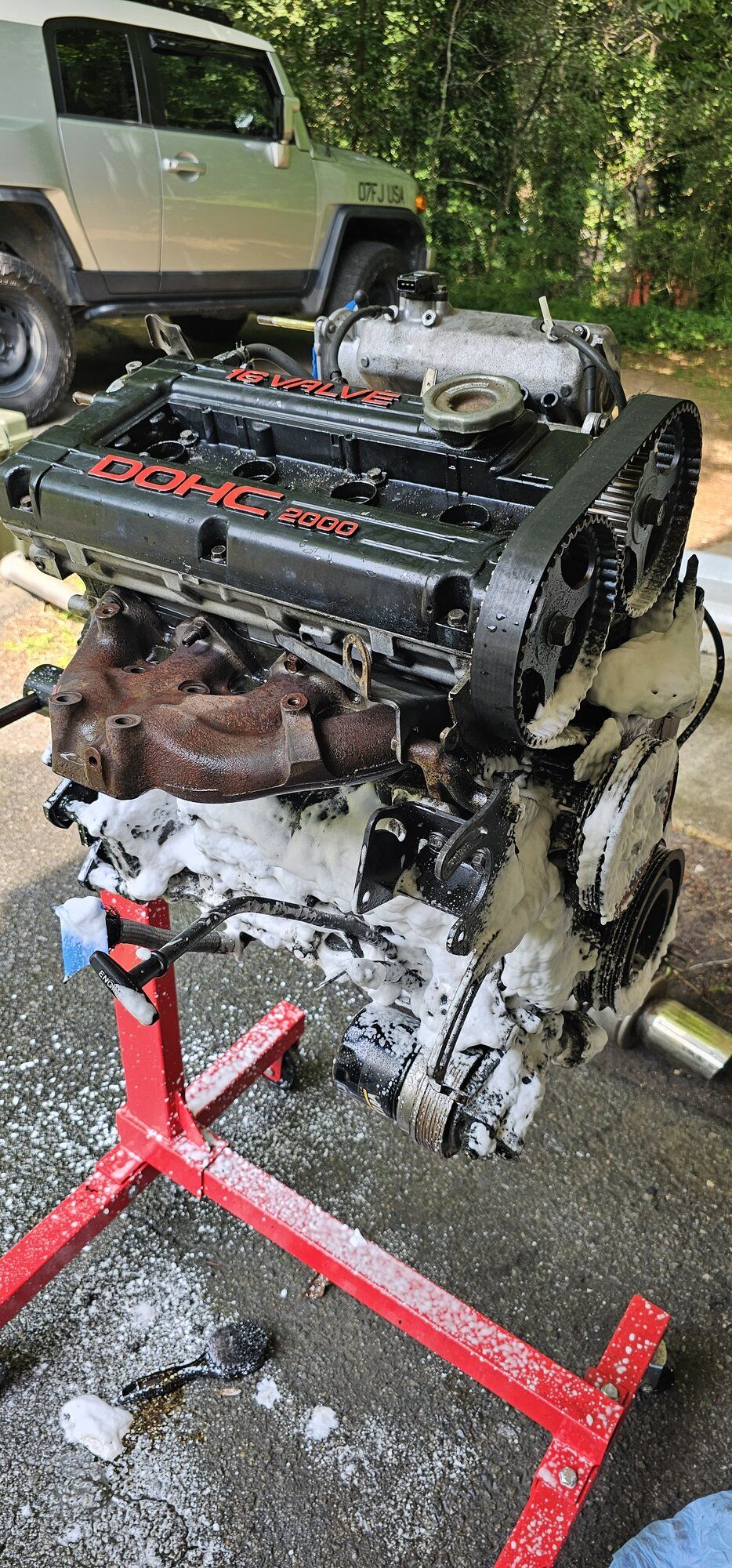

The used long block I picked up got degreased, fresh timing belt kit, water pump, and any seals that looked remotely sus (most all of them). I didn't want to completely tear this block down as it isn't going to be in the car forever. Just want it to run and drive so I can make sure the trans is good, along with all the drivetrain components. Basically want to get the car's feet under her before putting in a built motor etc, and just tinker with the car and enjoy the process.

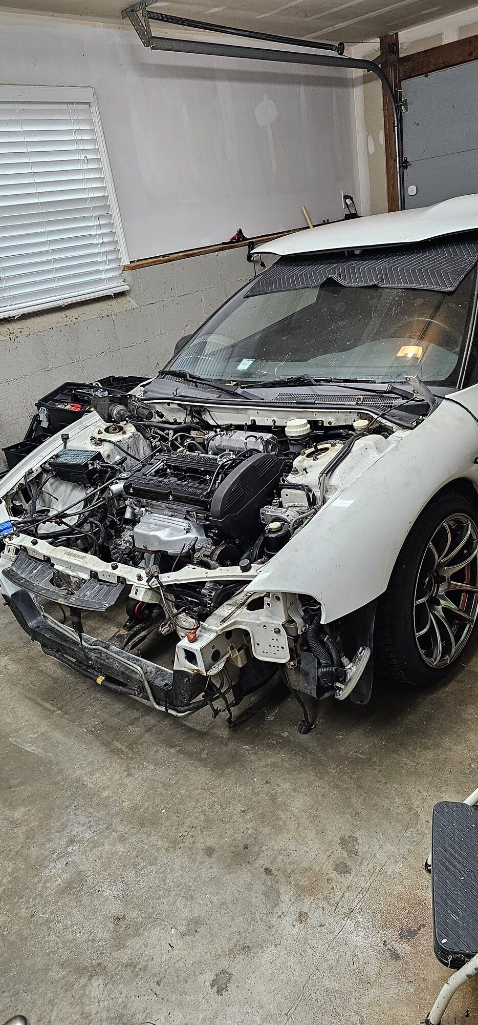

Ran into a broken stud or two. Had a pretty, all black, valve cover with the car so swapped that over. Old bare block out and long block bolted into the car and most of the wiring connected.
Also notice the wheels. The tires on the car were dry rotted so picked up something temporary that holds air and can actually see the road, just to move the car around and hold me until I decide on what wheels I actually want. The tires are a bit stretched for my tastes, but they're fine for getting it to move under it's own power. Again, temporary.
Also found a small 16g and some 750cc injectors for a reasonable price last weekend. Debating on swapping the exhaust manifold and risking fighting another broken stud. We'll see.
The fans may have been a waste, but I can still rob the connectors off them if needed.
