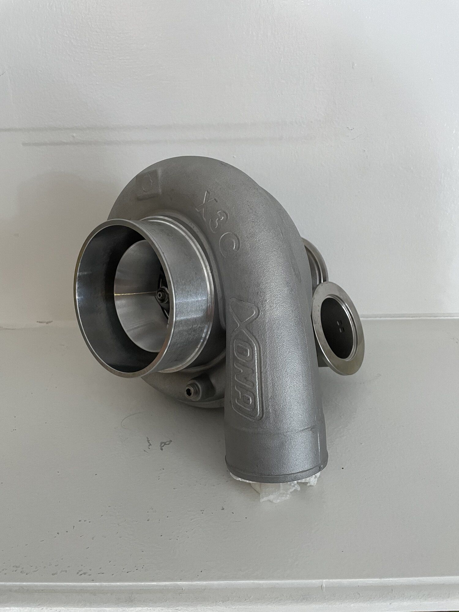

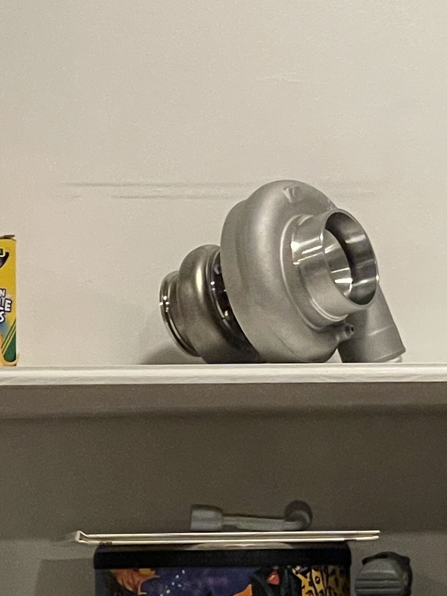

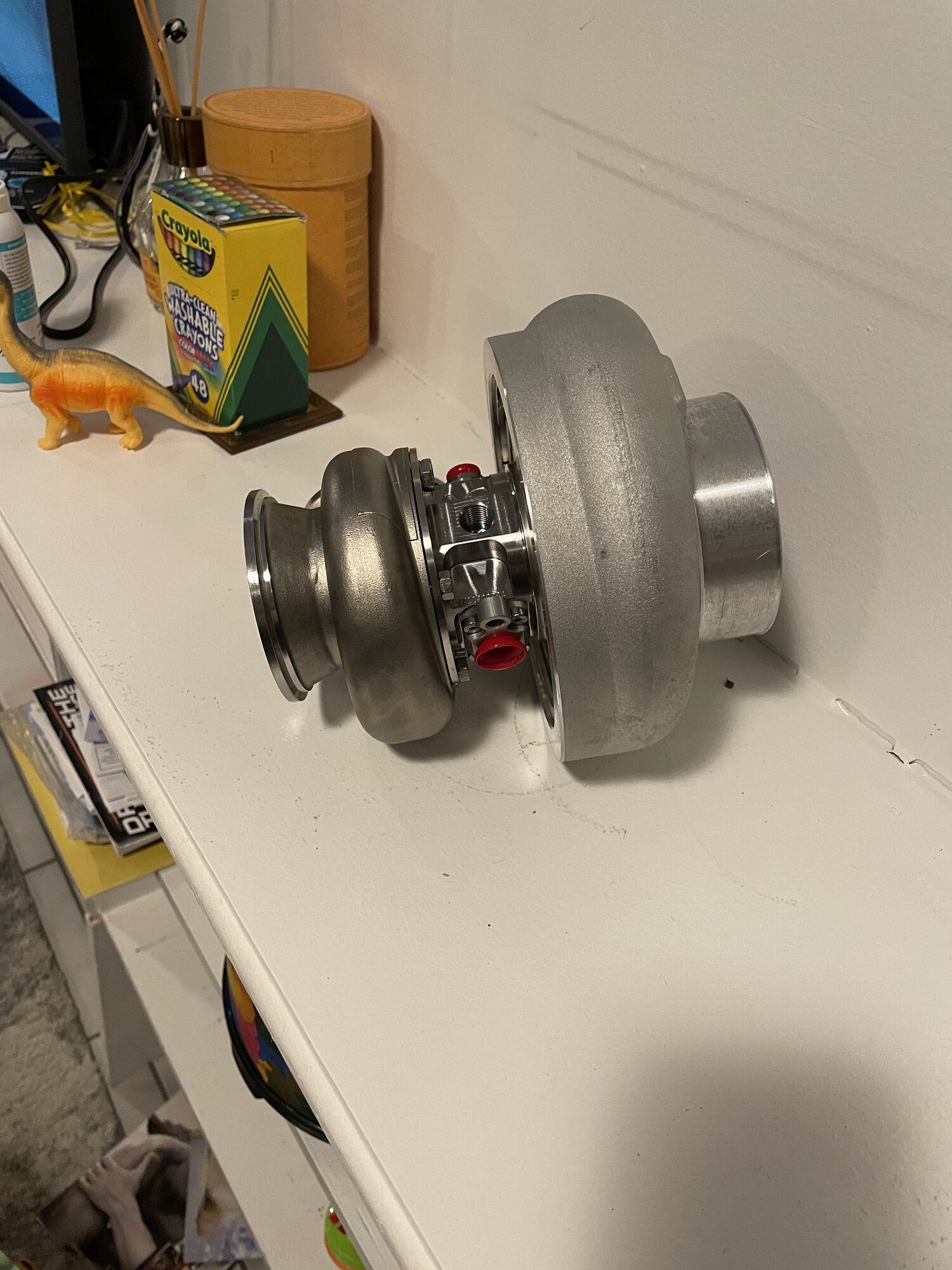

New turbo from Xona Rotor came in. I decided to stay with them just to see how it goes. If it truly was the blown intercooler pipes that caused the wheel to fail, then it is what it is. Excited about trying this new setup.
