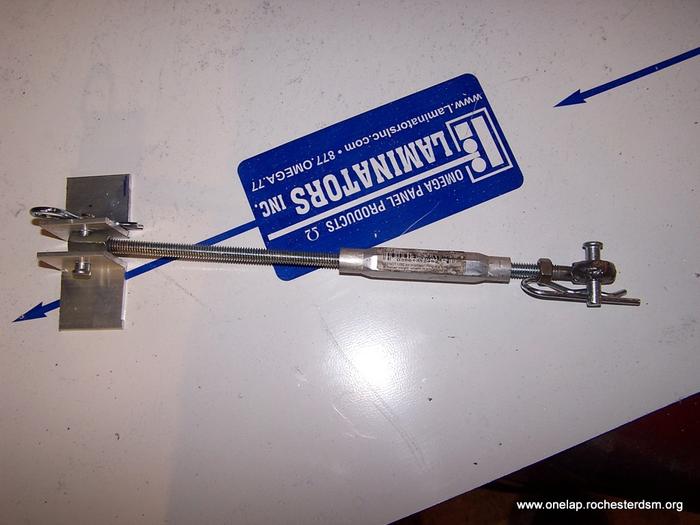

My splitter support rods came with some pucks to keep the splitter from bouncing off the track. The supplied hardware was too short to fasten through the splitter and they're a tapered Allen head bolt, so I had to make my own. Took some pan head Phillips, 8×1.25×30mm screws and chucked them up in the lathe at work. Cut them into a 45 degree taper. Hopefully this weekend, get it all assembled. View attachment 631632View attachment 631633
Got to spend a little time yesterday on the splitter. Started working out the splitter support rods. Professional awesome stuff is great. But I do have one complaint. The clevis mounting for the splitter side of the rod is 8×1.25. Fine. No biggie. But the clevis on the chassis side is 5/16ths 24. Like, not only is it a pita to have to have two different size bits of hardware, but one metric and one standard? That's kinda ridiculous. So I got it all mocked up. I'll drill holes and finalize the the support rods today.View attachment 631800

Thanks! Appreciate it! So the splitter tunnels are from professional awesome. Right side tunnel? And yes, I have a duct in the bumper that has a hose attached that blows on the alternator.

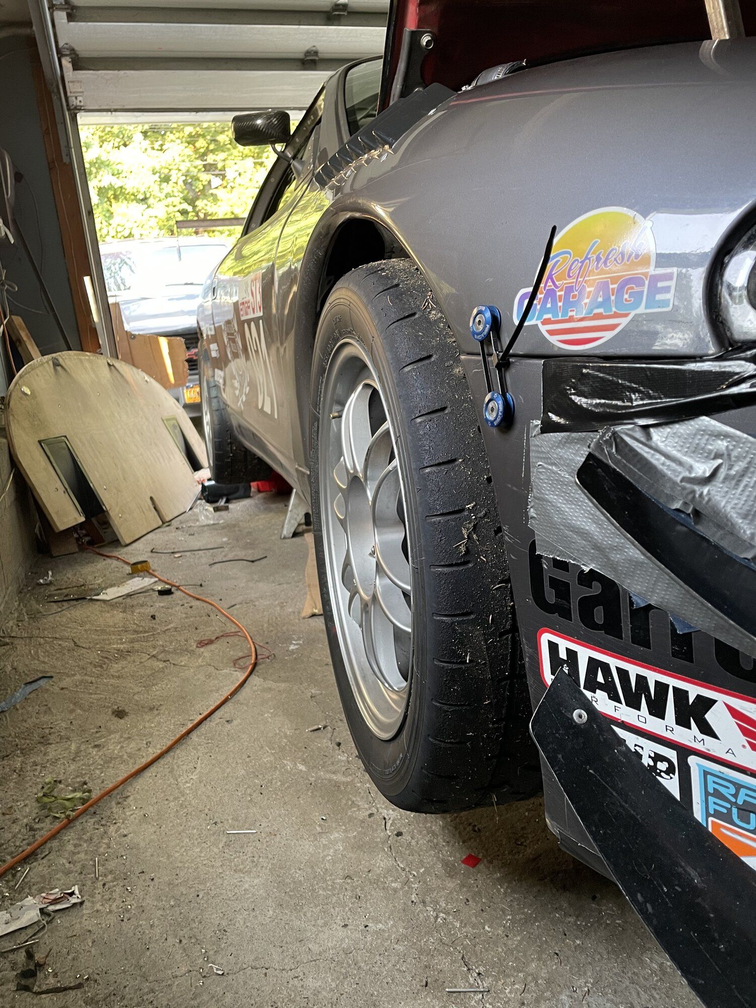

Went out for second session, and first time coming down the front straight, the professional awesome splitters rods failed and the splitter dropped to the track. Came back around, my awesome guys got the splitter off the car and had me back out with enough time to turn a 1:31 lap, which was already 2 seconds faster than my previous PB. I had been able to stand on the splitter, and I’m roughly 210-214 pounds, so the splitter was making more downforce than that. Luckily the splitter survived with minimal damage. The chassis mount broke so I’ll have to make a new one. As for the splitter support rods, I’m just going to continue using the proawesome splitter clevis’, but use threaded rod instead of the compression style fitting they use.

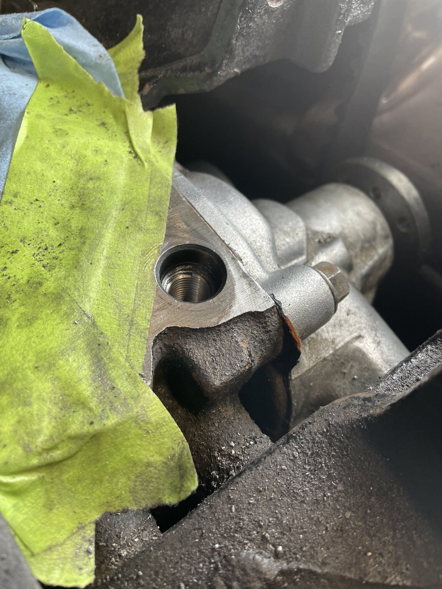

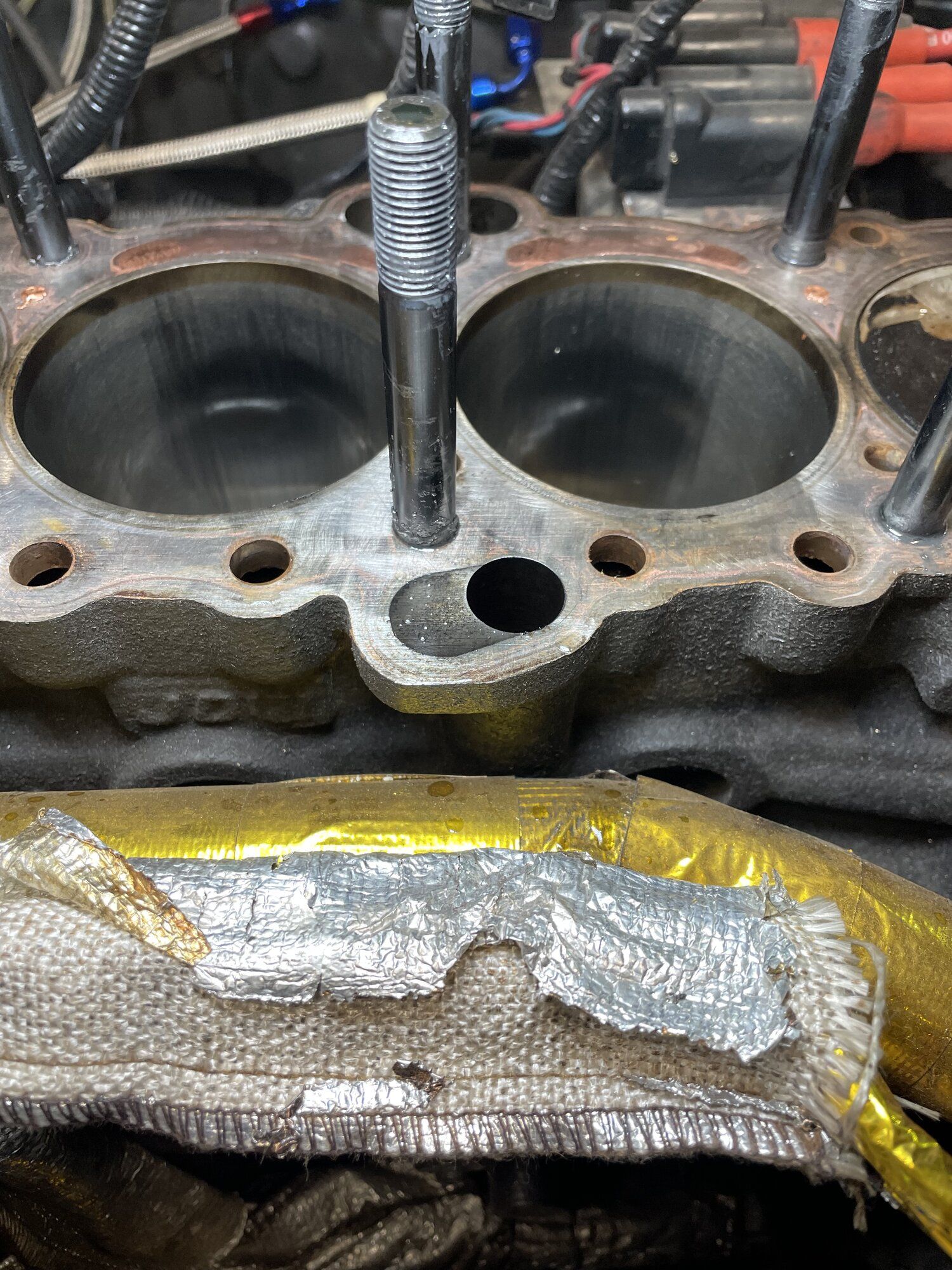

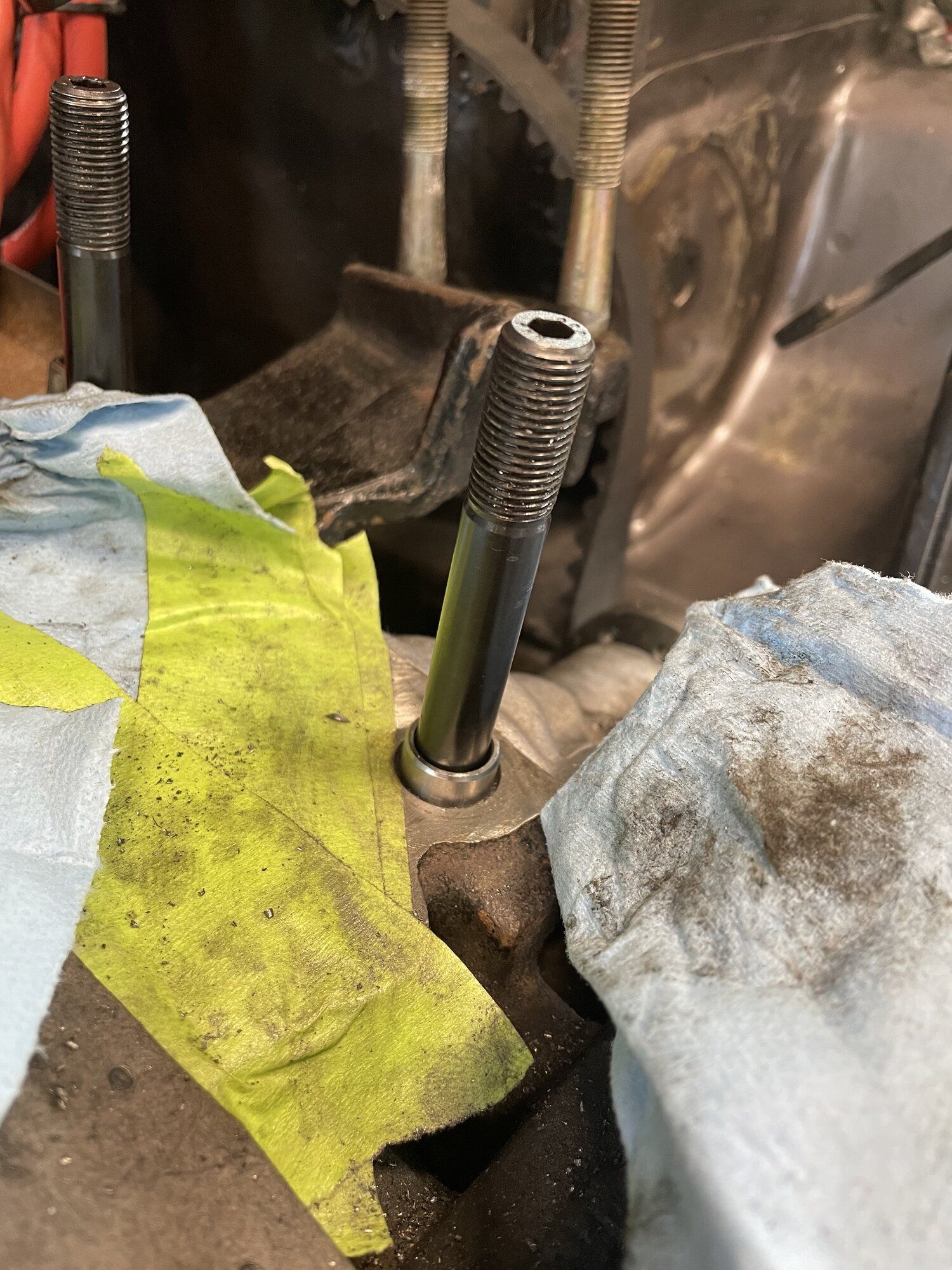

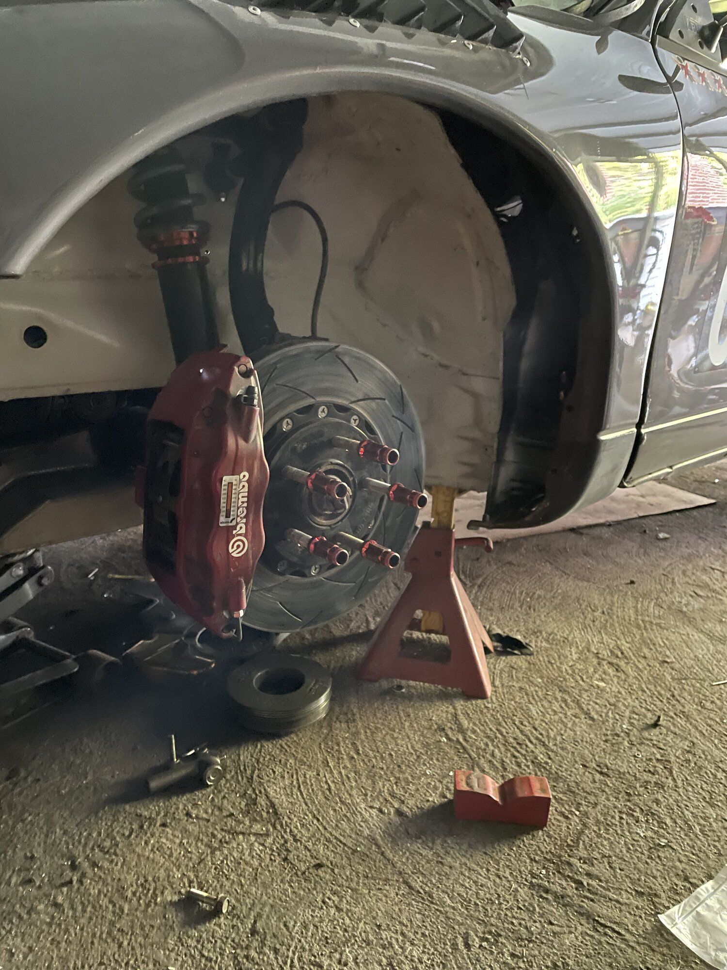

Sunday, we were at lightning. Went out first session, did my warm up lap, one flier and and a cool down lap. The whole weekend, the car was getting very hot under hot lap conditions. Getting up to 250 water temp. I’d see it get to 250, I’d cool the car down to 210, and start another flier. The water temp would skyrocket almost immediately, so after my 1st flier of the day, I pulled in. We discussed the situation and determined that we might be lifting the head. So we decided that after the motor cooled, we’d retorque the head. As we were retorquing the head, we did find some loose studs nuts. More like 70lbsft instead of the 90 we run. So we’re bringing them back up to 90 when we noticed one stud wasn’t taking the torque. Turns out the stud had pulled the threads out of the block. So we were done. But, my one flier was a 1:13.7 something, and that was fast enough to give us the win in class! I’m confident that if we didn’t have the issue with the stud, we would’ve gained time and had another fastest time of day. But, it wasn’t meant to be. But we’ll take it! We now have a 25 point lead on 2nd in the championship with one event left in October, so there’s no chance 2nd place can catch us. Overall an amazing weekend, with amazing friends, doing racecar things.

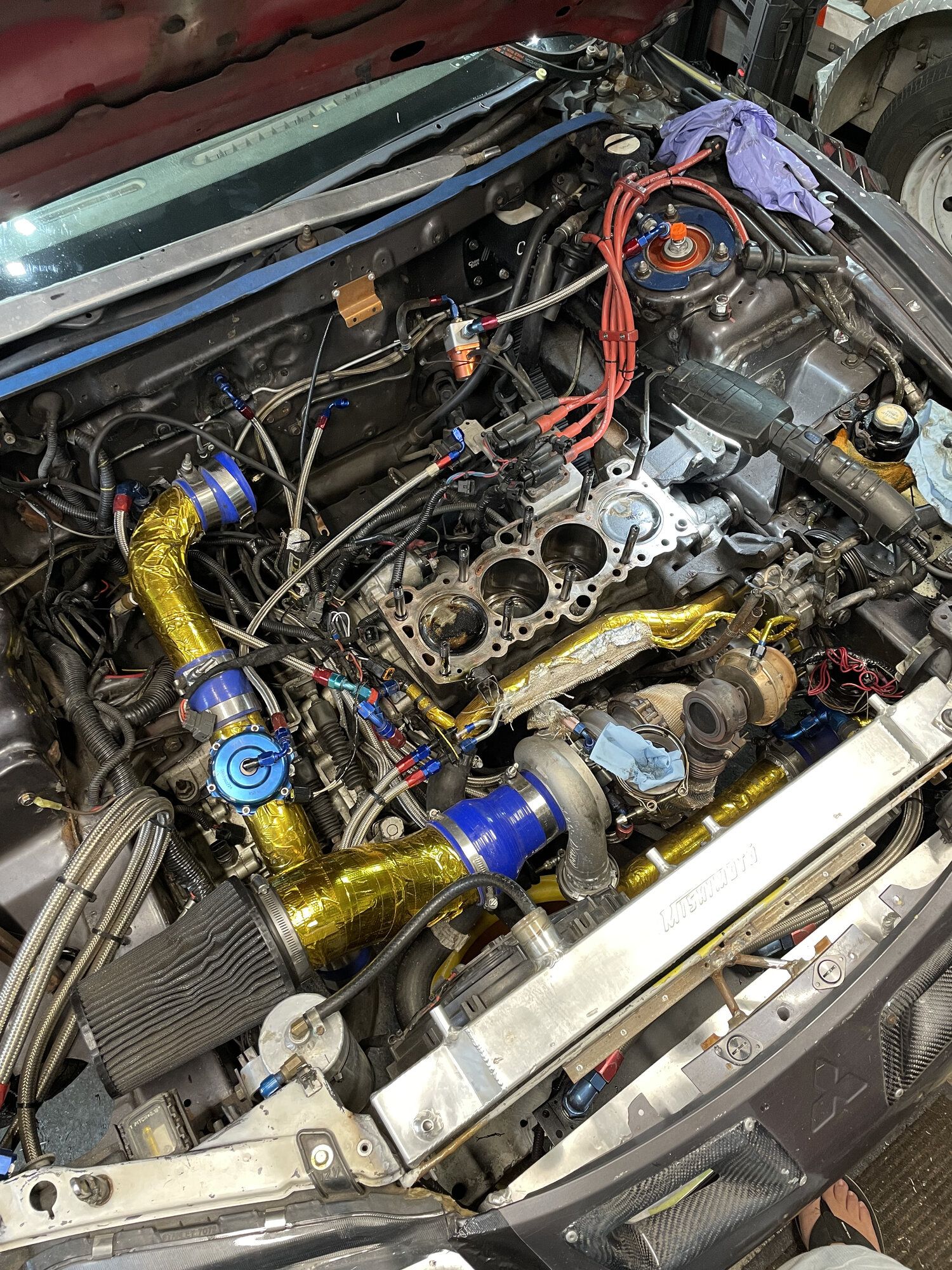

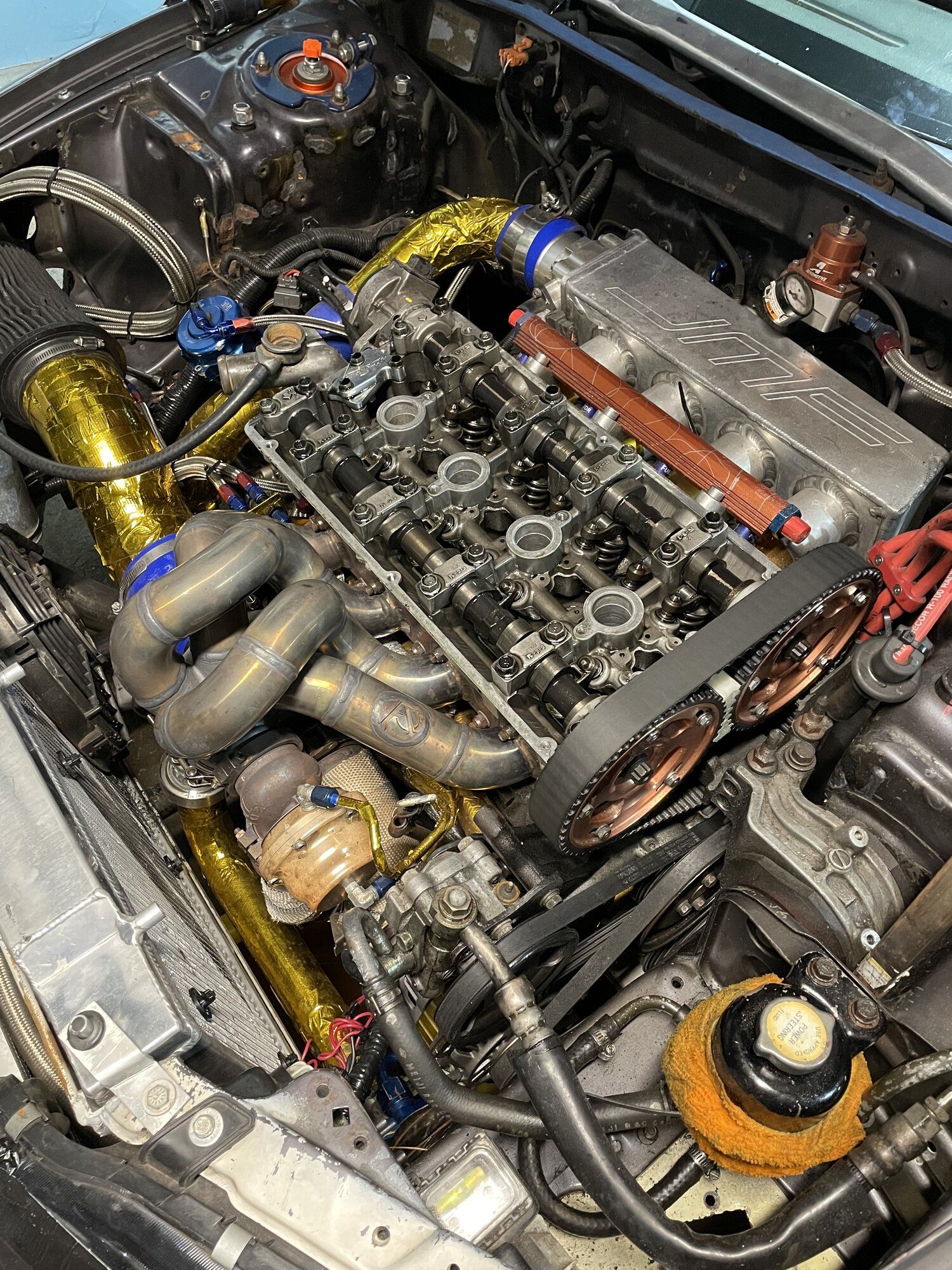

Got the cylinder head off last week. Everything looks ok. Cylinder walls are unhappy, but that’s something we’ll address over the off season. Only one more event to go so I’m not going to go crazy. Not burning oil, and compression is perfect, so just going to repair the block and get ready for Lime Rock in October.
It's hard to tell in the pic, but the cylinder walls don't look horrible to me.
Nice work on the track. Persistence is the key, and you keep going back at it. Love the progress and updates.
They’re pretty banged up. I’ll measure out of round and taper after the last race and see if I can get away with a fresh hone and new pistons or what. Thanks!! I feel like the car is really rounding the corner on reliability and the development of everything. When the car works, it works great.
Got my helicoil kit in yesterday, so hopefully I can find the time tonight or this weekend to get it all repaired and back together. We’re getting ready to do some renovations on the house, part of which is redoing the garage floor, so everything has to come out. We’re starting August 30th, so the car has to be mobile by then. A neighbor offered to let me put my stuff in her garage while the floor is done, so that’s a big help. We’ll see if that happens though.
