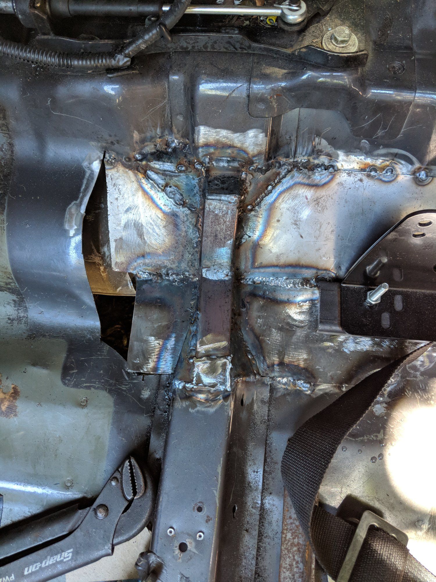

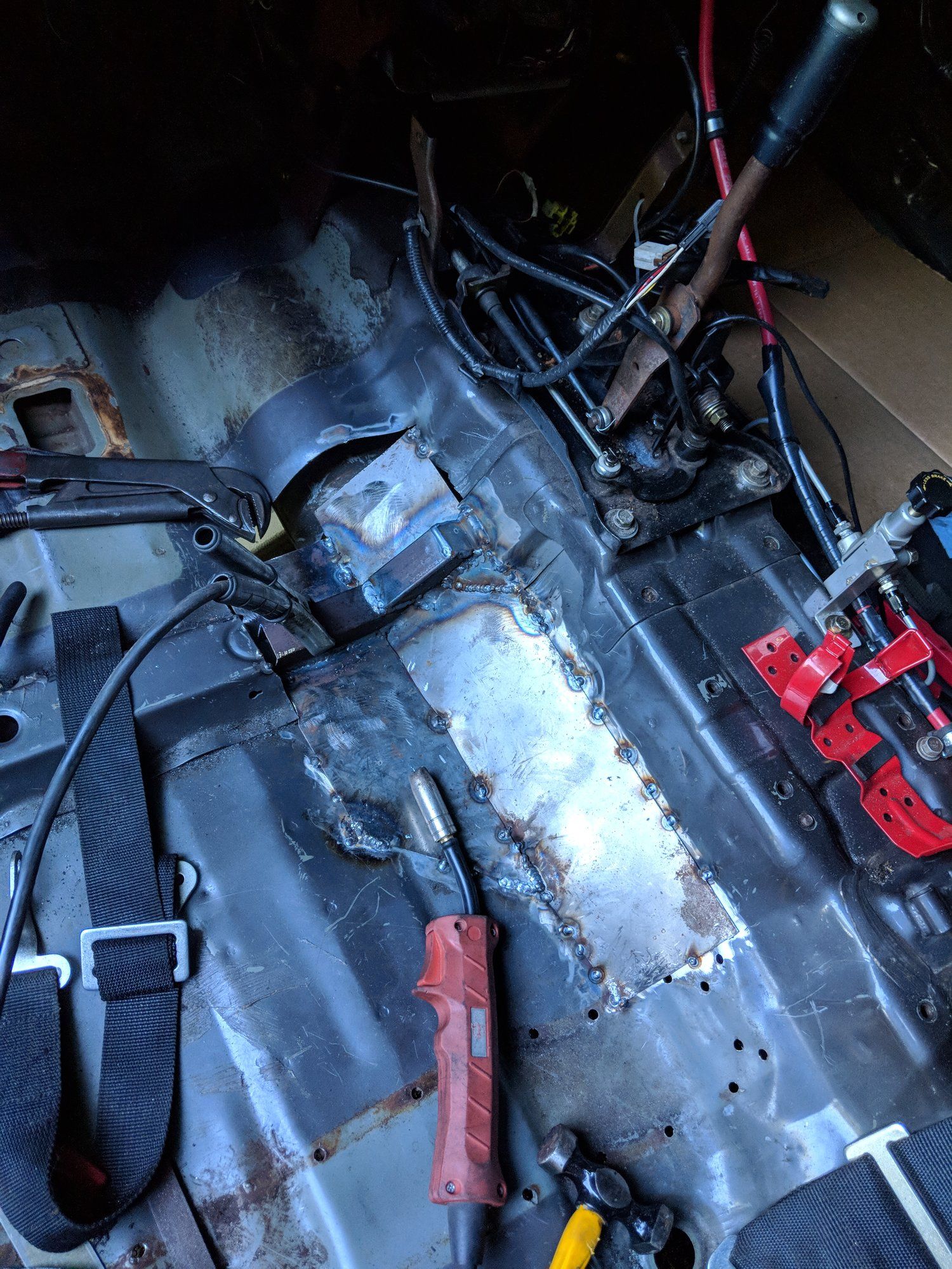

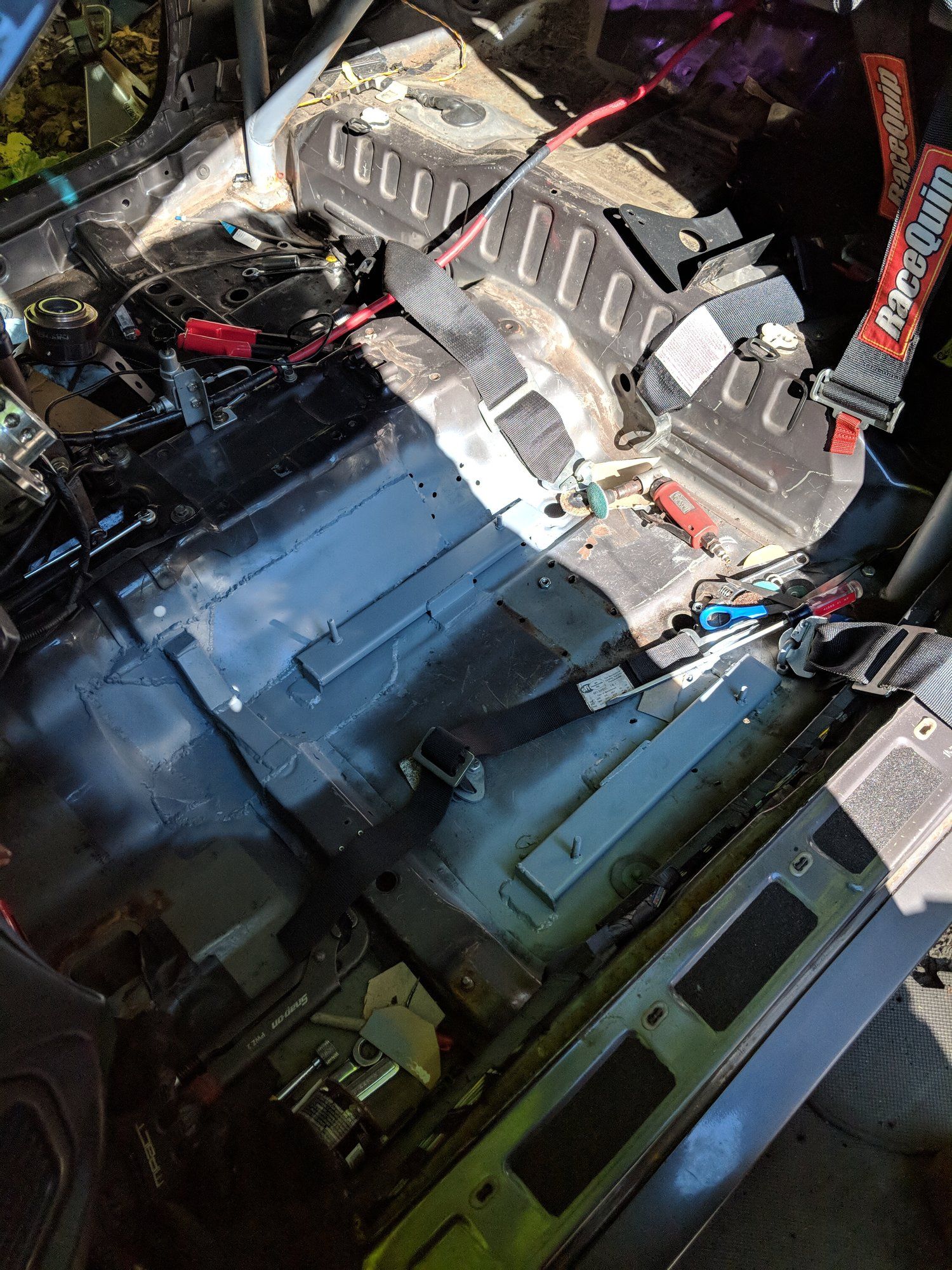

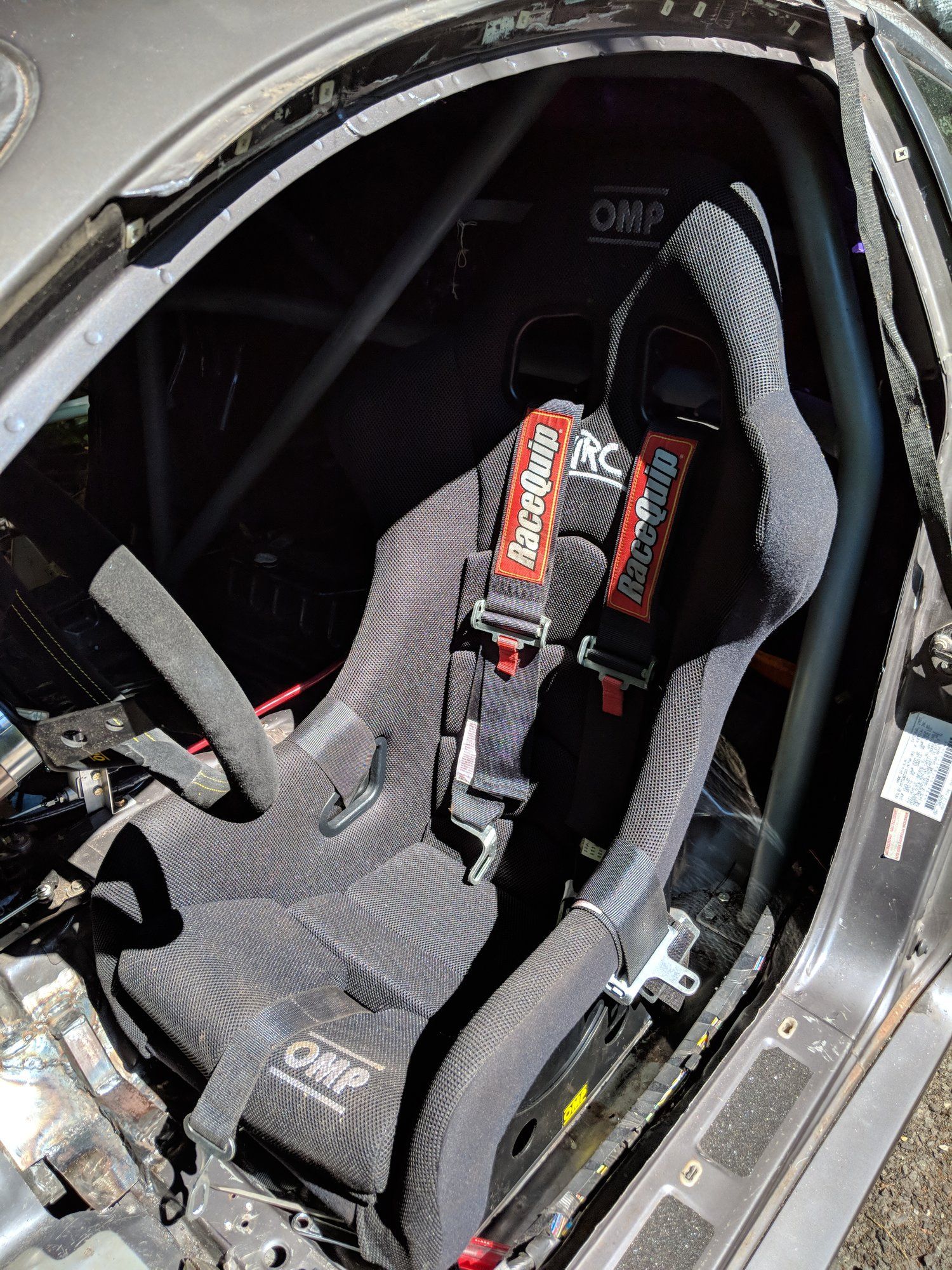

Got the new seat in the car this weekend. A lot of metal work and welding. Came out ok. Seats solid. And it dropped me down about an inch and a half in the car, which is good. Going there tomorrow and Friday to keep getting the car squared away.

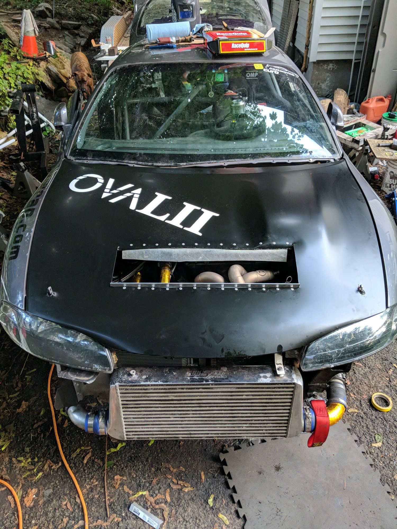

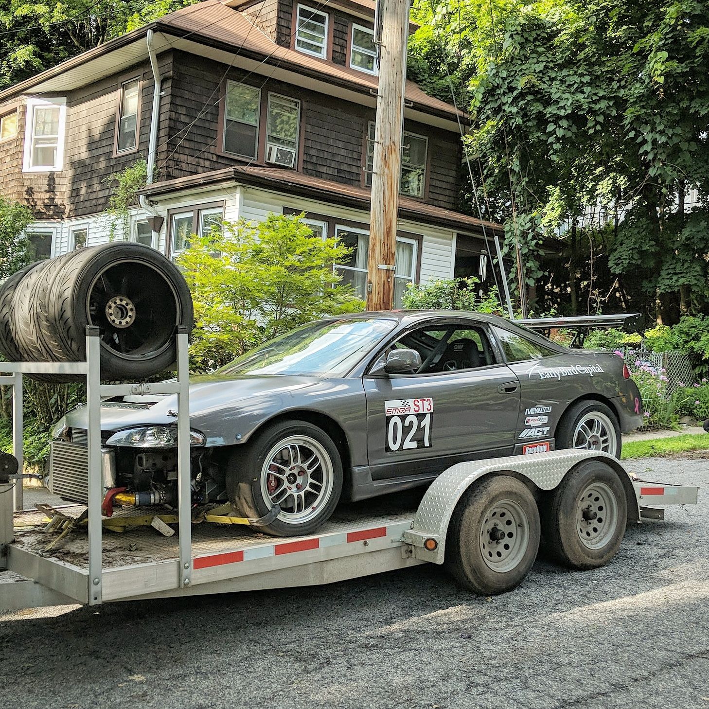

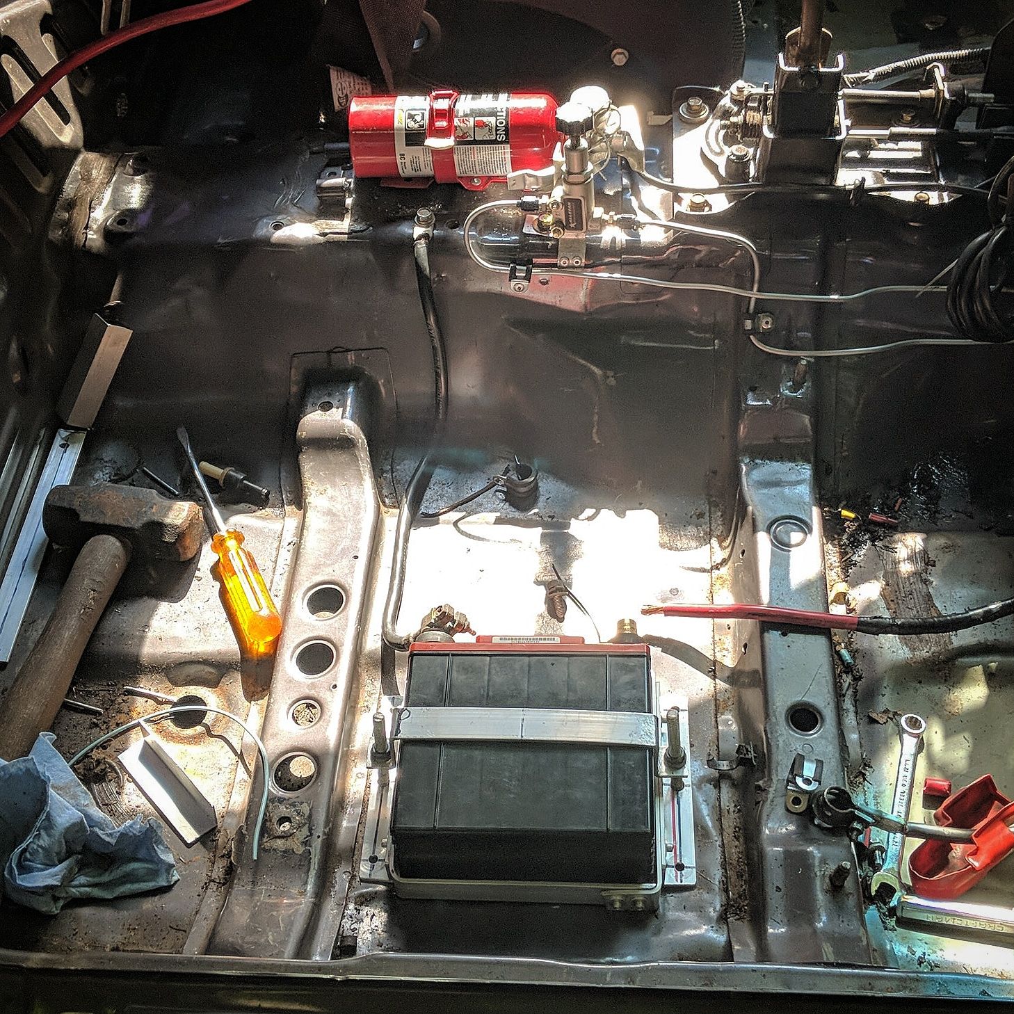

Put in some good work over the weekend. A lot of little things. Made a new battery tray for the oddyssey battery. Got that mounted and wired. Ran a -4 braided hose for my OP gauge and now that's reading properly. It had been lazy prior, now it's nice and responsive. Hood pins are done. Tint is off. My buddy from LIWraps came down and decaled the car. Fixed some things on the truck as well. Loaded the car up on the trailer. Loaded the truck with my track supplies. Hoping to have a good weekend. Not gonna focus on winning. Just gonna focus on learning the car, and what it wants, and in doing that, I'll naturally get faster. Bringing the spare trans in case we have trans issues since 4th was giving me problems last time out. Really hoping to have a good weekend.

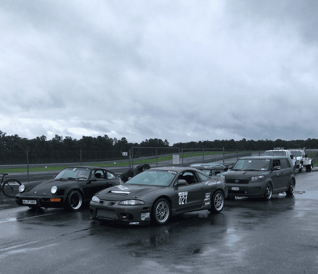

Well, we had a hell of a weekend at NJMP. Here's the run down.

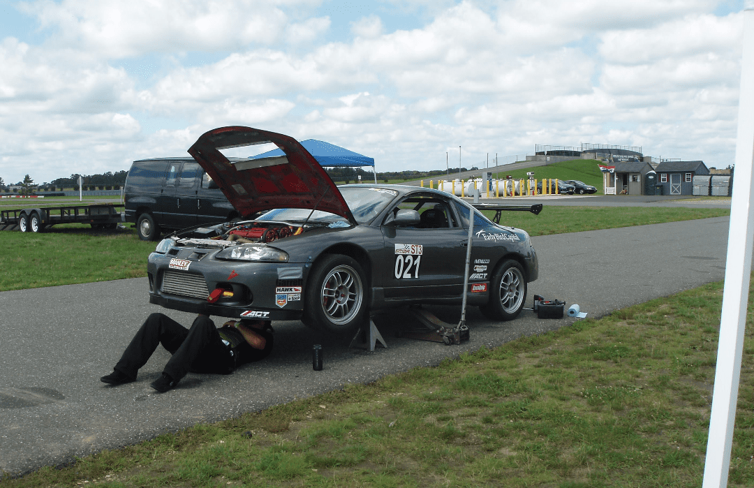

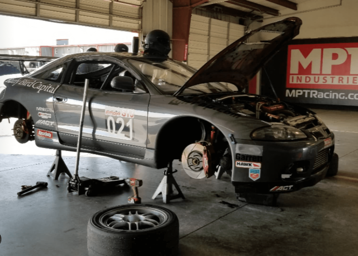

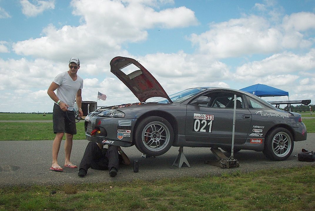

First session out, in the bowl section of the track, I noticed the oil pressure gauge was bouncing between 60-80 psi. Came in immediately, and changed the oil. Cured that problem. Next session out, a combination of the cas nuts vibrating loose, and getting on two wheels off the T1 curbing, knocked the cas out, there by rendering the car a rolling road block. Got that sorted after getting towed back to the paddock. Next session out, popped a vacuum hose to the map sensor, causing misfires and no drive. Pulled in. Fixed that. 4th and final session, cooked off a 1:17.8. Which was good for second place behind a 1:17.7. Got beat by a tenth. That was pretty incredible though. Never been to lightning at NJMP.

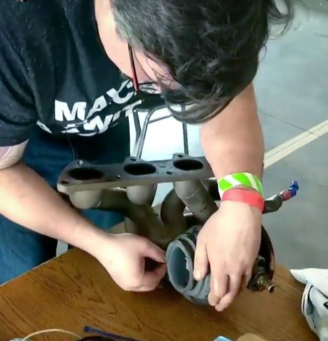

Now to Sunday at Thunderbolt. When I was warming the car up Sunday morning, I noticed some electrical fluctuation, and the brake and charge lights were on. So we replaced the alternator causing us to miss 1st session. Went out for second session. Car was doing well, still learning what the tires can do. 4th gear has been an issue all season. Not going in fully, pooping out when I release the clutch, or sometimes it works fine. But more often than not, it's a problem. That session we went a 1:37.1. I went 1:36.4 there last season, so I was confident we could definitely beat that time. That is until we were going over the car and found d out that the dreaded stud curse hadn't been solved. Even with the stage 8 locking nuts, the studs started extracting themselves from their home. Blew out the gasket. Had no choice but to pull the turbo AND manifold to get it sorted. Missed 3rd session. Got it fixed for 4the session. They had combined the intermediate group with the student/beginner groups to save time at the end of the day. A lot of traffic. Definitely was not gonna have a chance to go faster. Then I looked at my water temp and it was pegged at 250. Took it easy for a couple laps to see if it would cool down. It didn't, so to save the motor, I parked it. Was still able to secure 3rd place in class.

No. No NLTS. If we can get the 4th gear issue fixed, we'll probably put it in. 4th is pretty toast at this point so a trans fix is definitely in order. And the problem we're having with the manifold studs actually loosening up in the flange. The nordwashers won't work since it's not the nut loosening up. It's the actual stud. Even with the Stage 8's in there, the stud still loosened up and worked it's way through the nut. Probably gonna drill and safety wire the tops of the studs that protude out of the flange.
I am planning to safety wire the bolts that hold the turbo to the manifold myself, they constantly vibrate loose and blow gaskets... I know you are using studs, but should fix it in either case.

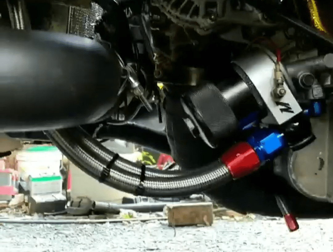

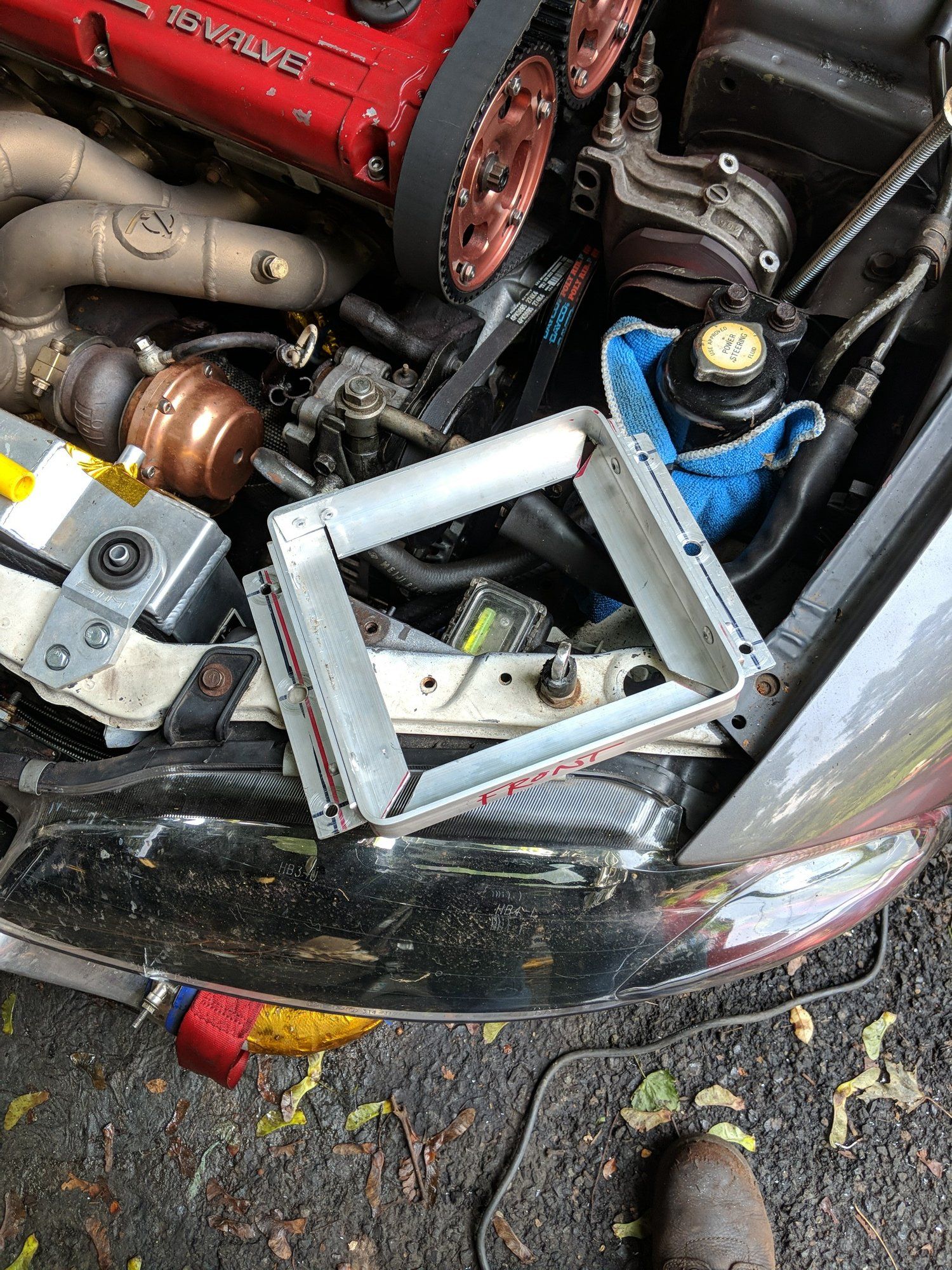

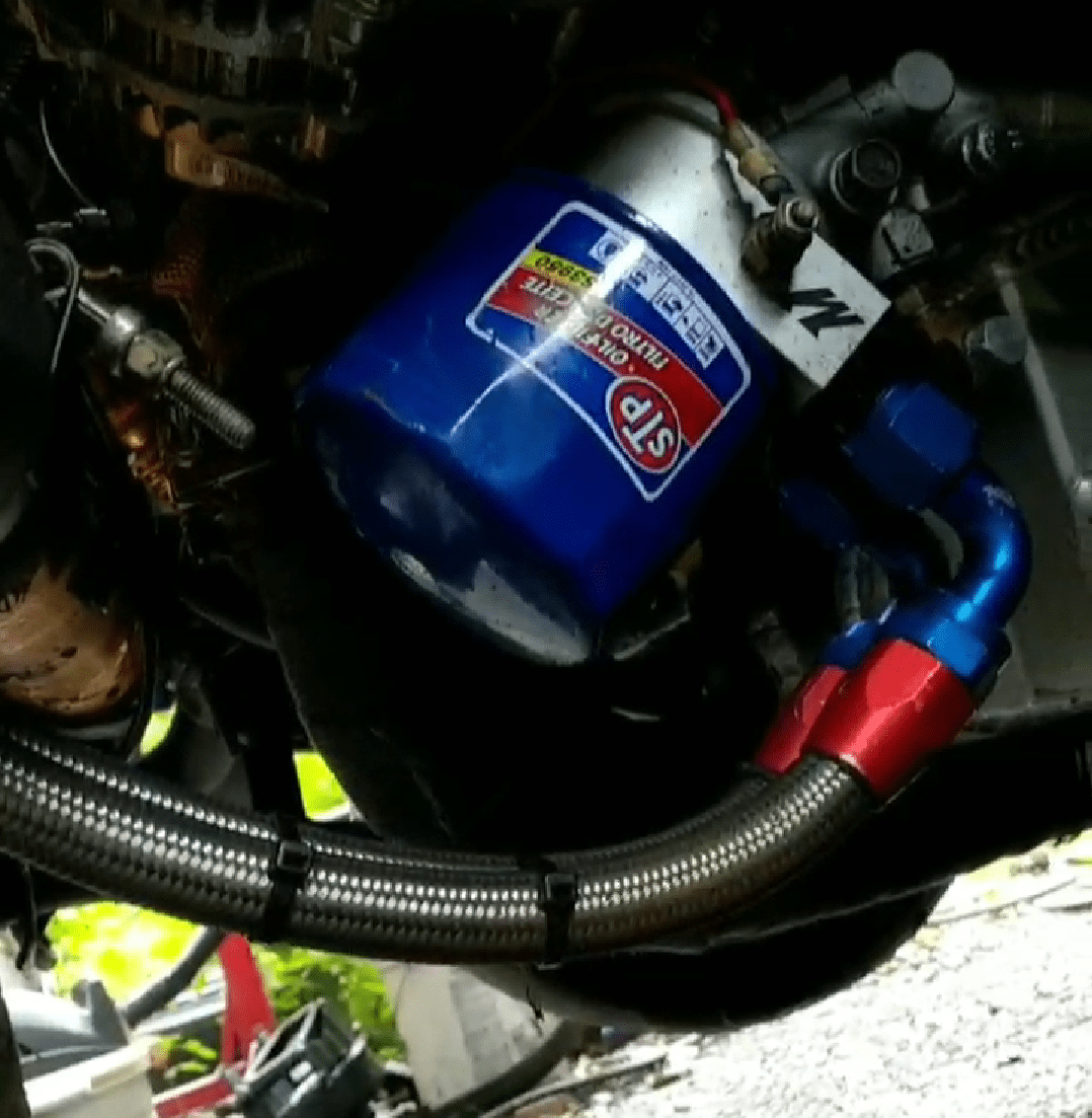

I was worried about my oil lines from the oil cooler hanging too low and any possible off road excursions catching the lines and causing issues. So I converted from regular 90° fittings to -10 banjos with straight fittings. Definitely happy with the outcome
