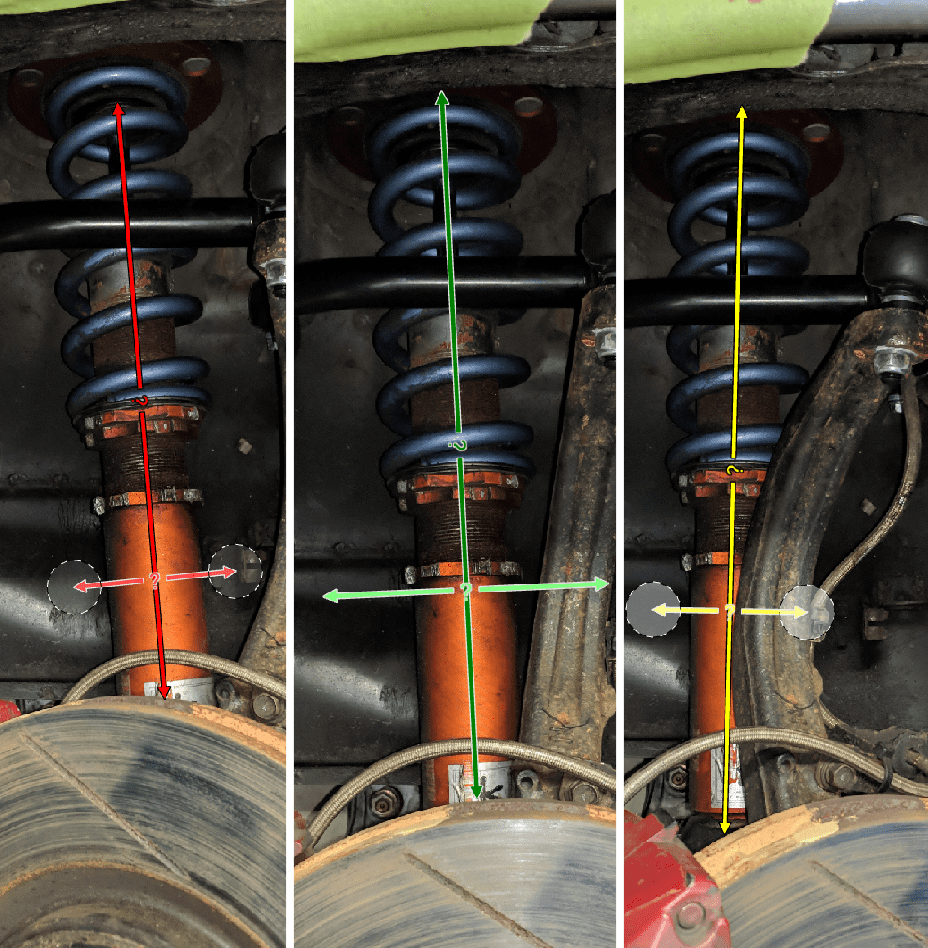

The setup on the car, I actually went to heavier Swift springs cause the KSport springs rotted and were junk at that point. I went with 16K front and 14K rear with this setup. I emailed KSport about putting the coaxial mounts on. We'll see what they say.

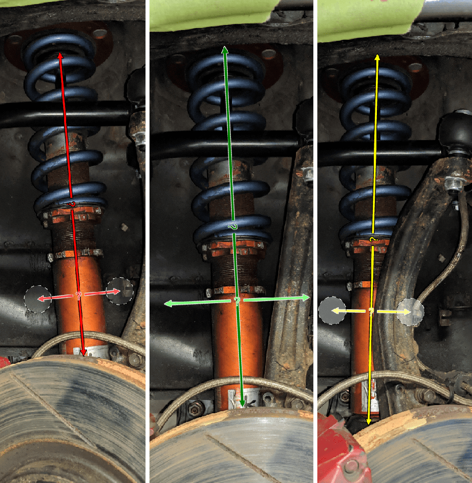

So, just got done sending emails back and forth with KSport. They said the shock should only be moving up and down. I guess we're gonna be re-engineering some stuff. No biggie. We'll make it better than what it is. And then show them. Lol
Got the coilovers in yesterday. Did a little experiment. I have video but it's too big to load on here. But I did take some pics. Working on ways to make the suspension better. Lowered the car an inch. Didn't align the car as I was beat by the time we got it done. Definitely should be interesting next season.

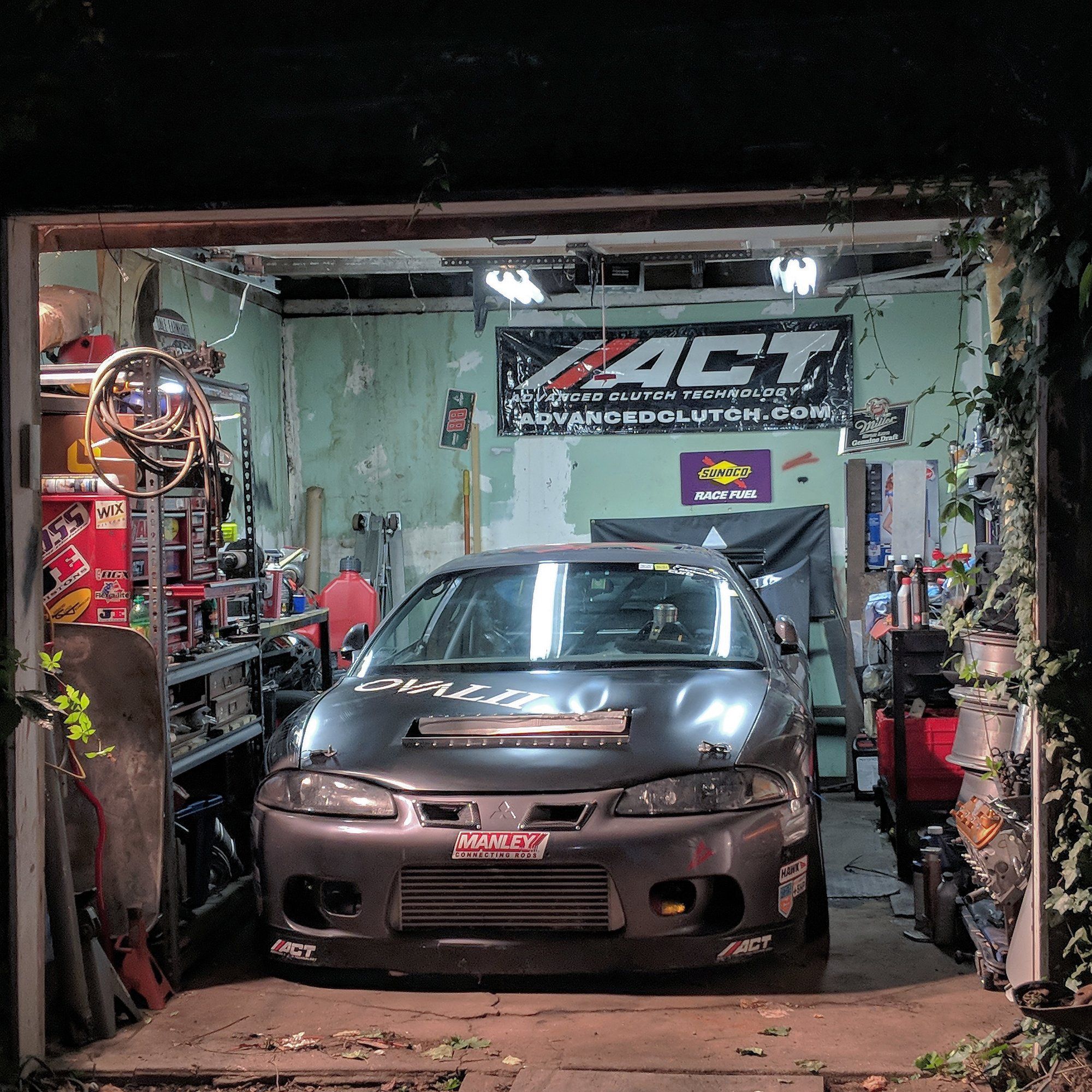

Not too many updates. Cleaned the garage up a bit. Got the car in there. Since we're not going back out till next season, I figured I'll put the old girl in the garage so she can spend winter in somewhat warmth/covered. Still going to get a new car cover, wash/detail the car really well. Got some issues/upgrades to work out over winter, so I'll take a look at that stuff in between diaper changes LOL. But for now....pics.

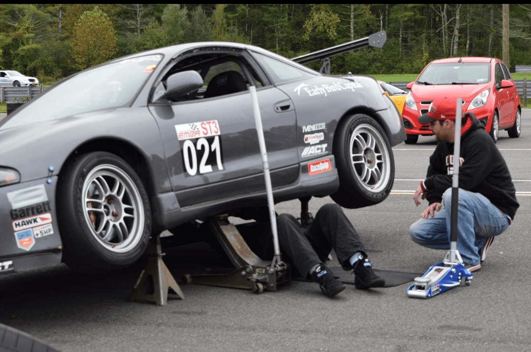

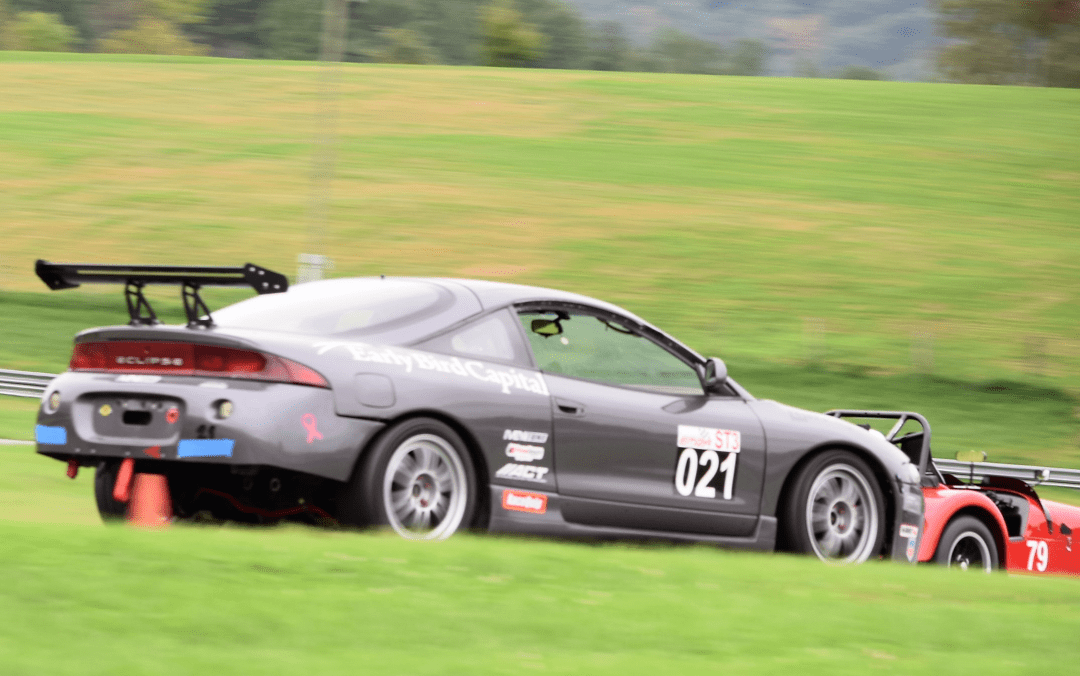

Well.....I thought I was done for the season. But my wife was gracious enough to let me get to the track one last time this weekend. So on Friday, I loaded up the car and brought it over to my old job to align it. We set the car pretty much the same as before. Except with the added camber from lowering the car on the KSports. It really blows my mind how much camber Bobby's arms can give you. So we dialed in -4.5° front and -1.5 in the rear with the toe set to 0° front and rear. The car is still on the trailer so on Saturday morning I can just head over to the garage, hook up and go. I went into the advanced group (blue group) since I'm decently quick there, and it offers much less traffic. The goal is to go a sub 1 minute lap. I went 1:01.6 there last fall, so fairly certain with the new setup in the car, the slicks and some added seat time that it shouldn't be a real issue. Really excited.

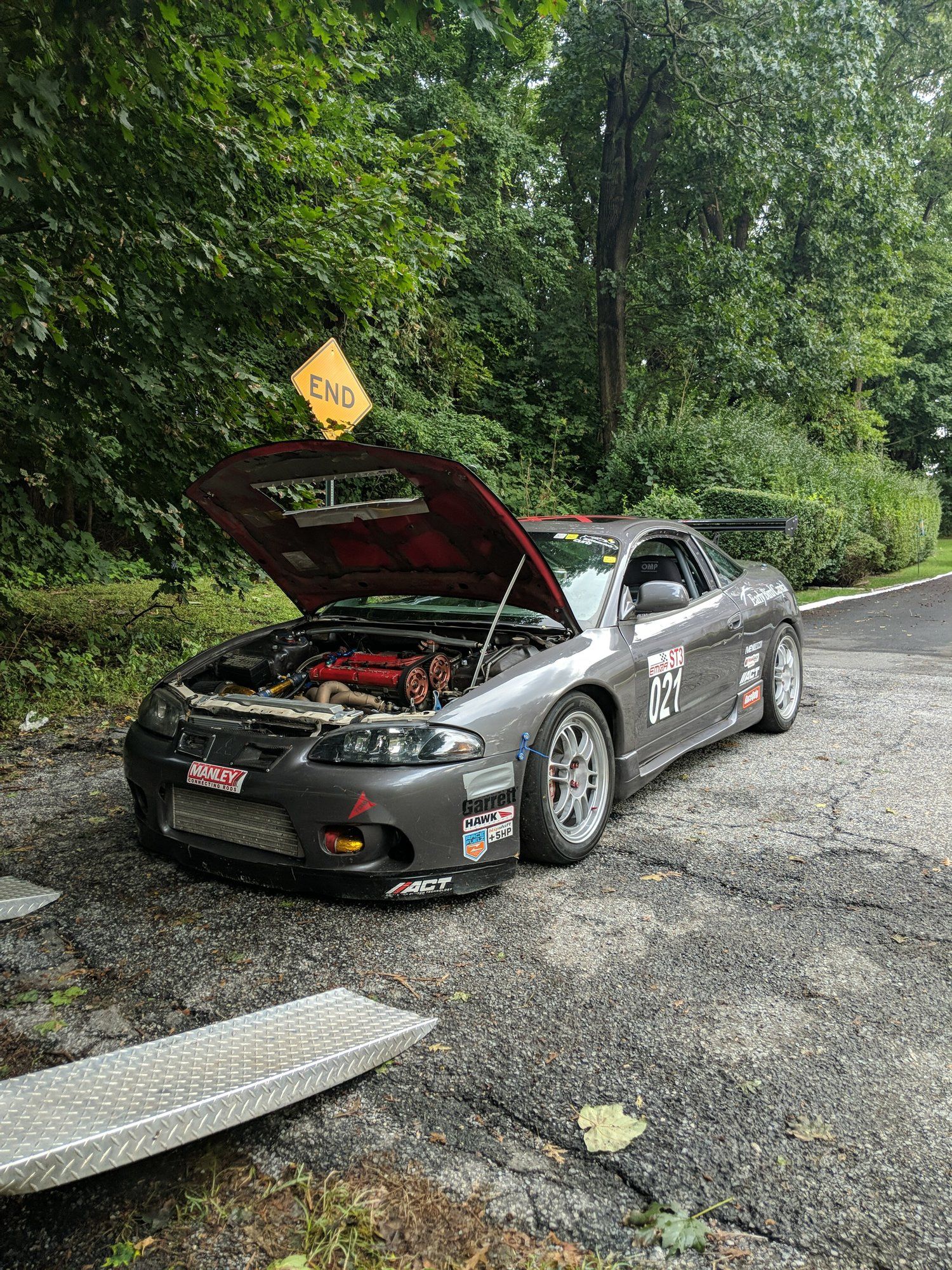

Results from Lime Rock were ok. Went out and found out quickly the spring rates are way heavier than the previous setup, which would induce some bouncing out of the corners which would delay my ability to get back to full throttle. Then, the oil feed line for the turbo leaned up on the turbine housing, which melted through the DEI heat barrier and subsequently the oil feed line. Started spraying oil all over. Actually really lucky it didn't start a fire. But that ended our day. Improved our personal best to a 1.01:3. Not the sub 1 that I wanted, and with for track time, I'm confident we would've gotten there. Still, came home 2nd so not a terrible day. NOW we put the car away LOL.
