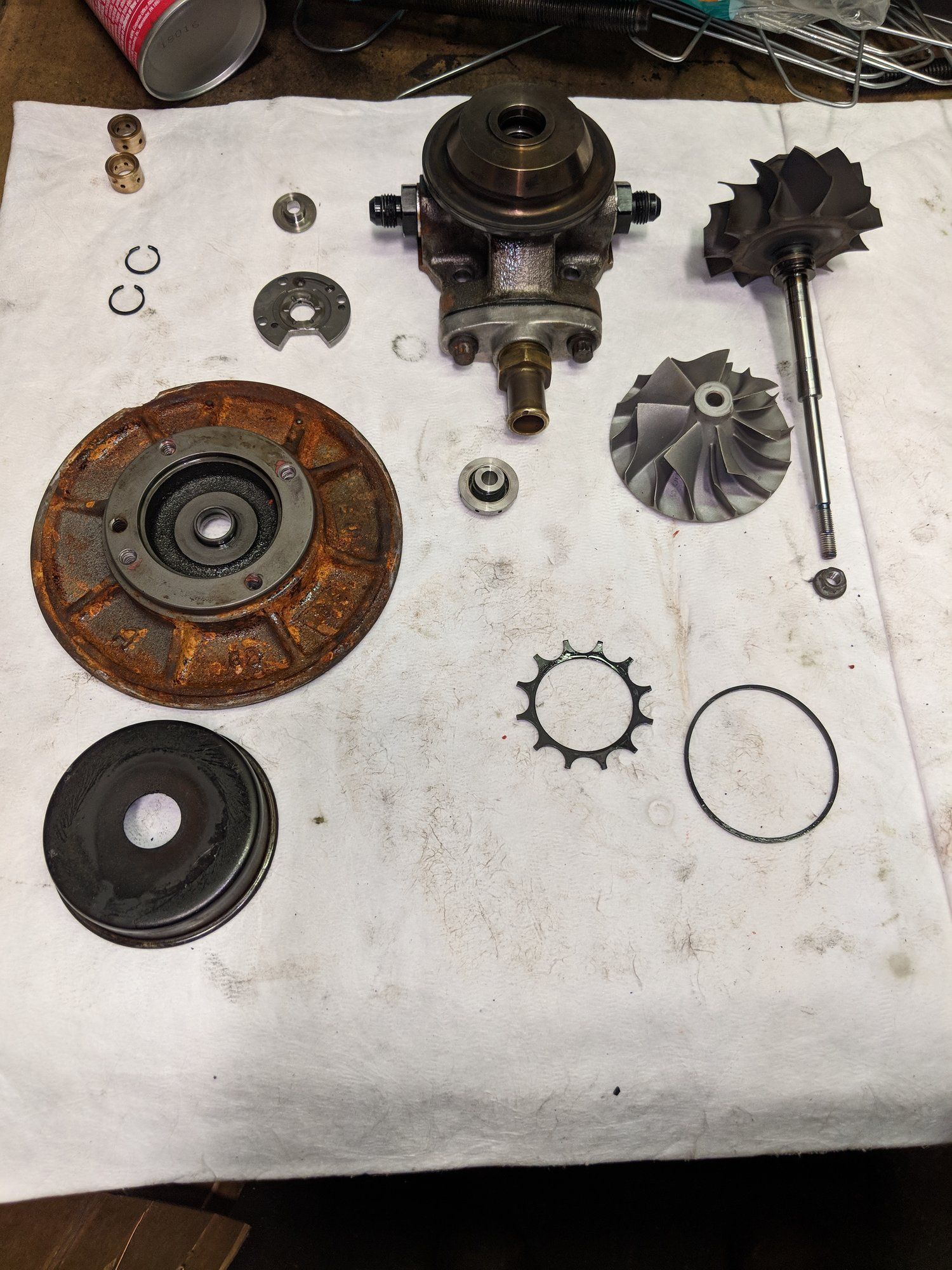

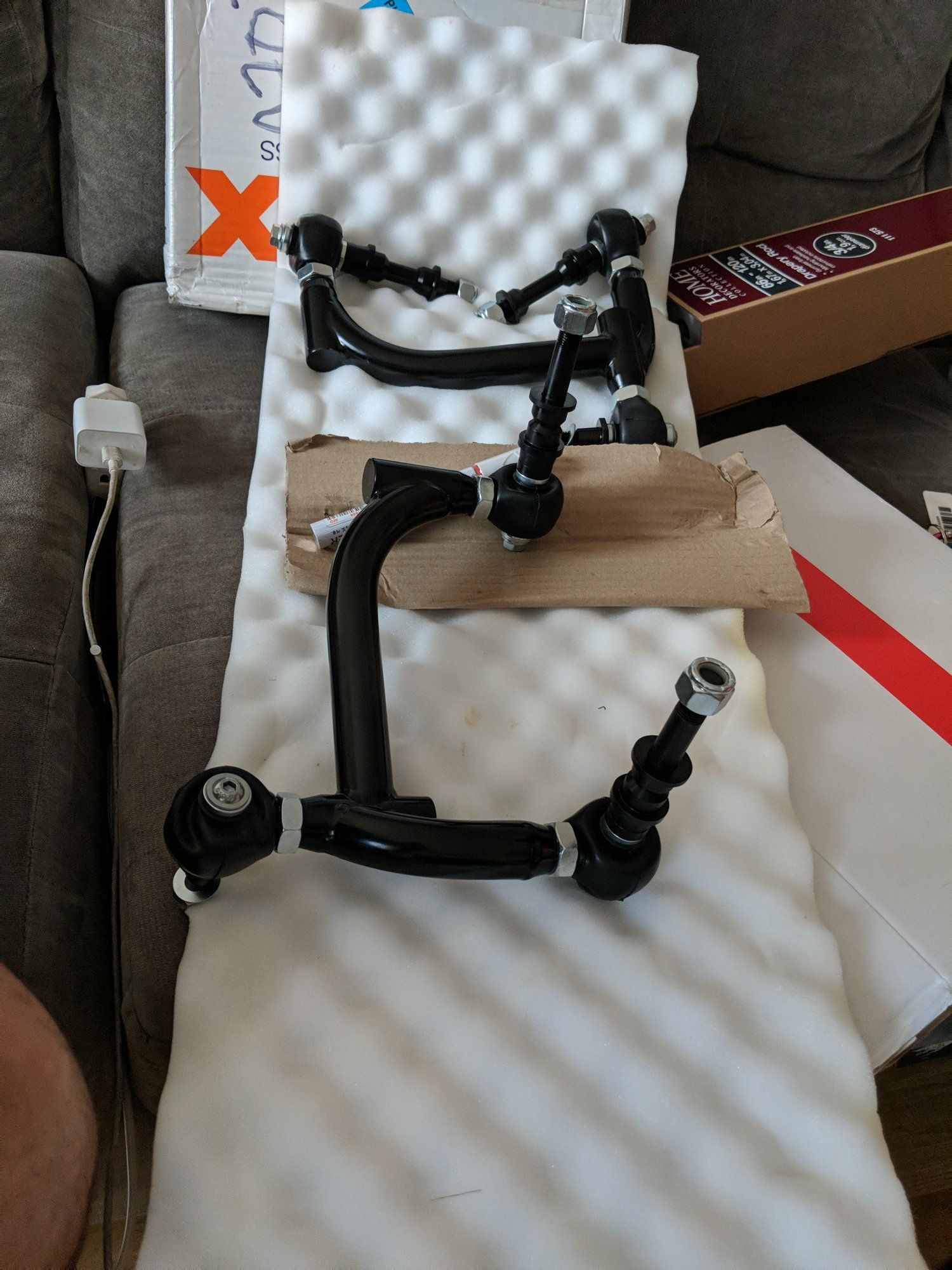

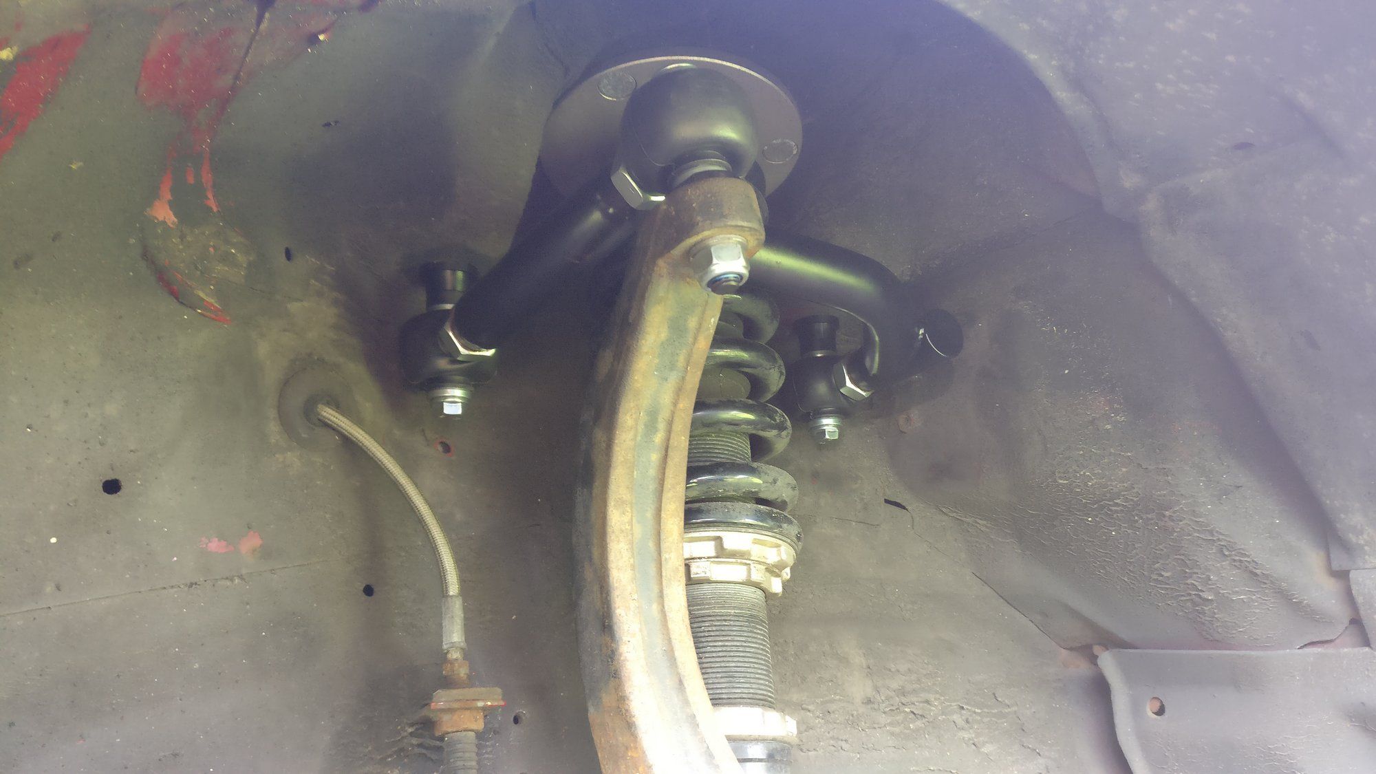

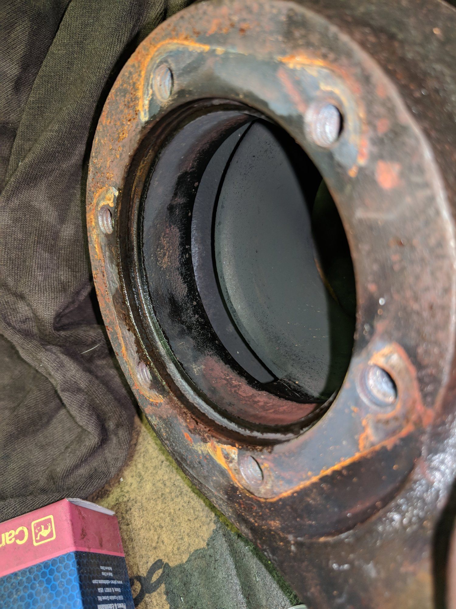

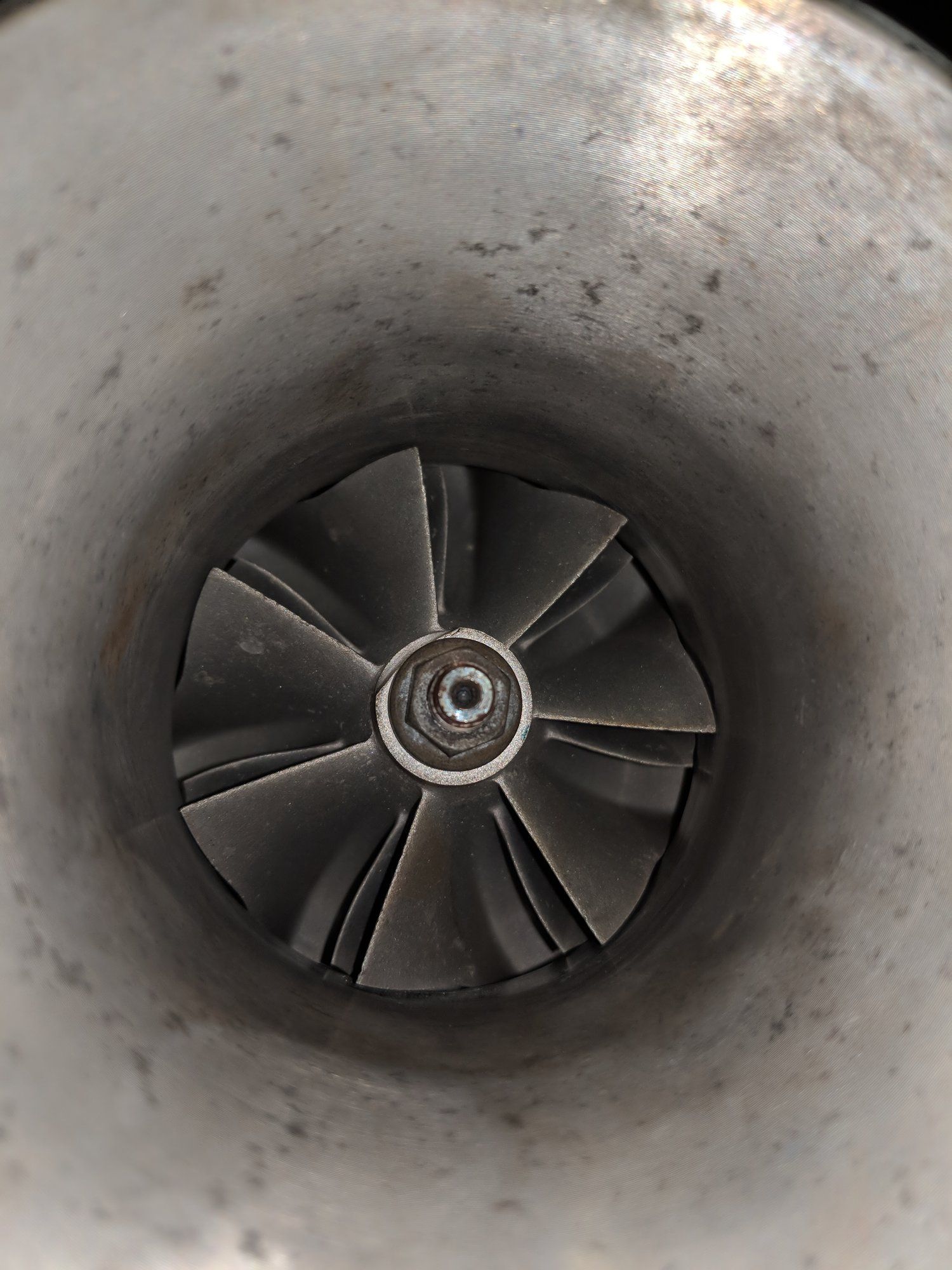

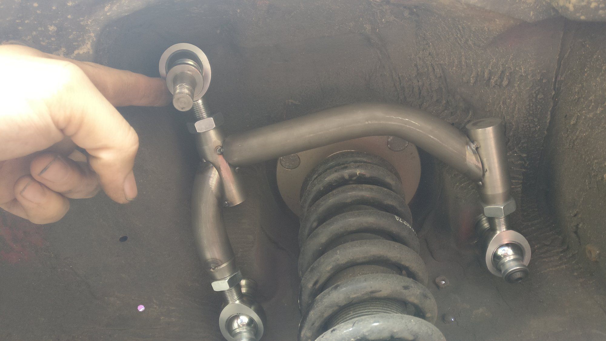

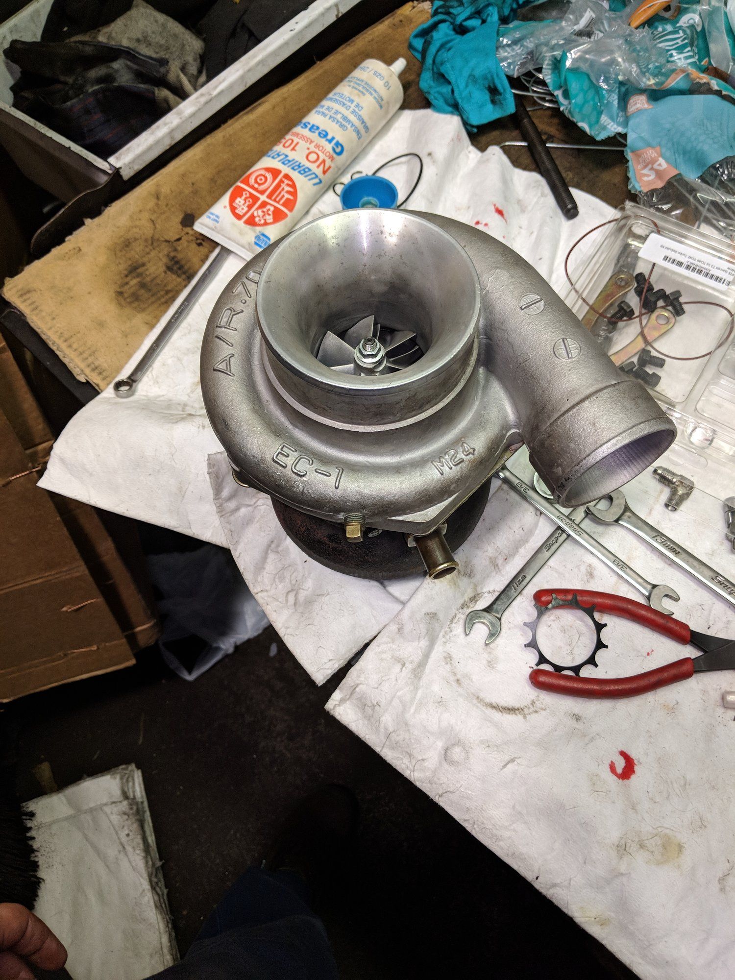

Update: went to the house on Saturday, pulled the manifold and turbo, drilled the studs and safety wired them to keep them from spinning out. While I was doing that, I noticed that there was rubbing marks on the compressor housing. Checked the play, definitely insane play. So I ordered a rebuild kit, and today got the turbo back together. Still trying to get to Pocono. Also got my arms from Bobby!!!! They are stunning and I can't wait to put them in!!
The control arms look awesome! Let us know how the fitment and clearance is!
Fitment is perfect. Nice clearance and no issues like the SPC or Megan arms have,

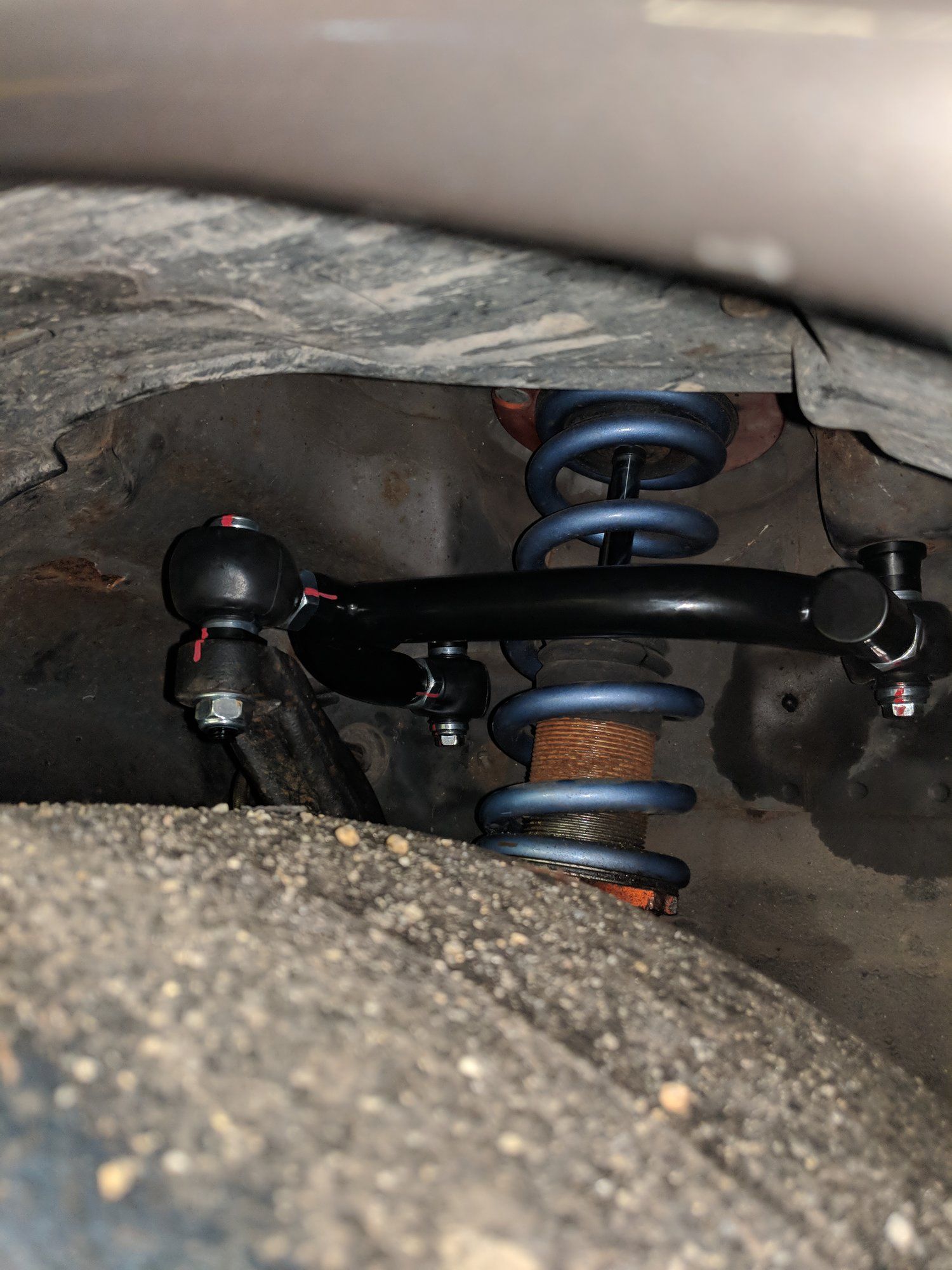

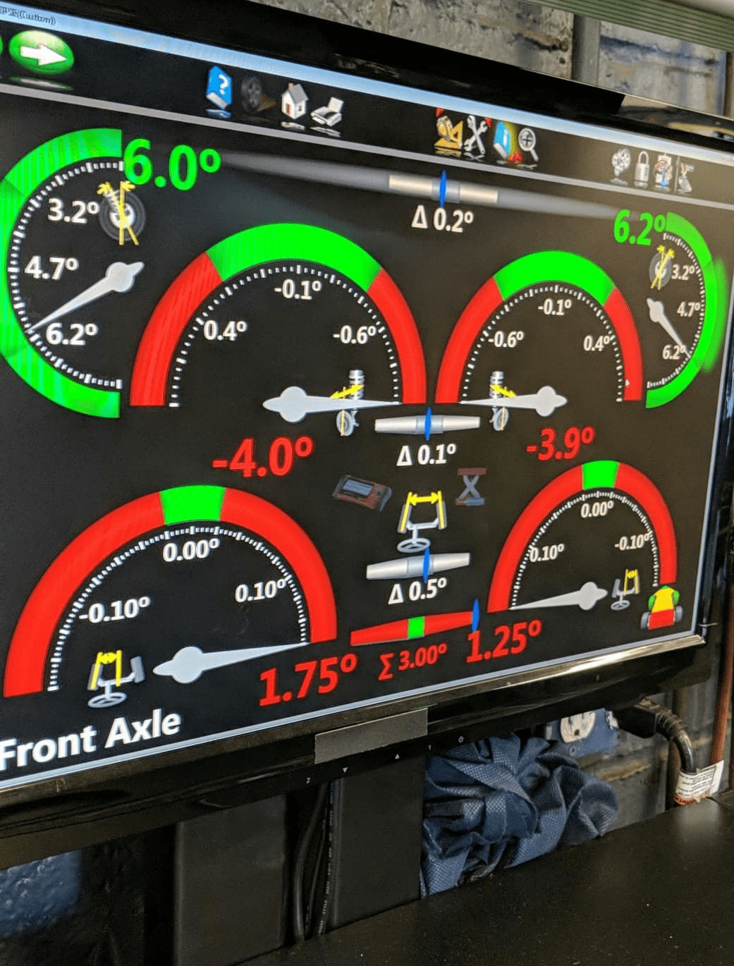

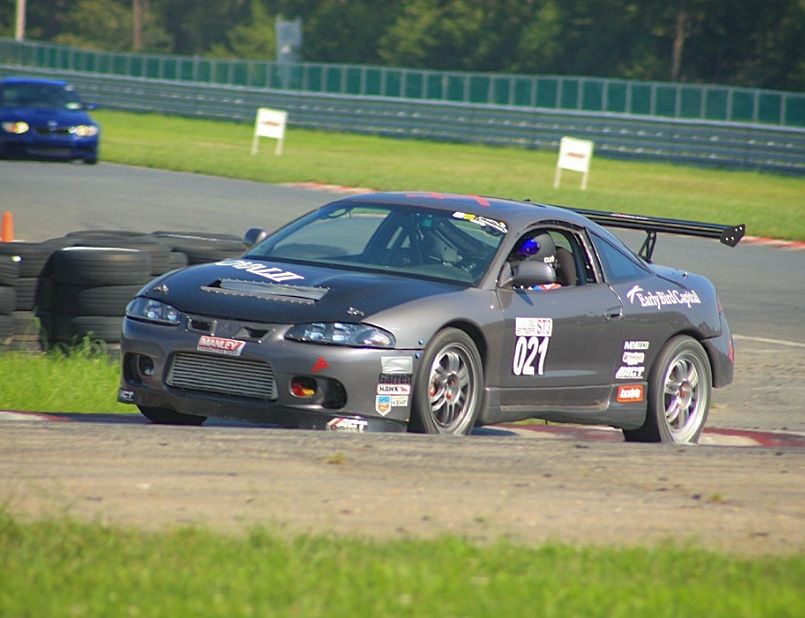

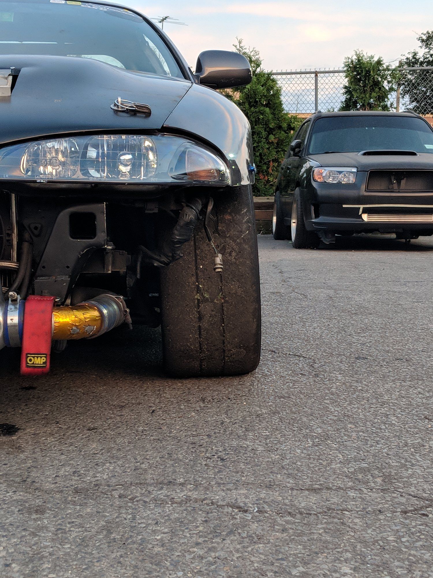

Got the arms installed last night. And man. Absolutely awesome pieces. With all the bearings bottomed, we had an amazing -4° of camber! Pretty wild. Can't wait to try them out. Installation was a breeze. The track we're going to is pretty tight. Mostly 2nd and 3rd gear with one upshift to 4th every lap, so we left the camber at -3.8° and we'll adjust as needed. But all in all, super satisfied with these things. Bobby did an amazing job. Can't thank him enough for all the work he puts into making such killer parts for these cars.

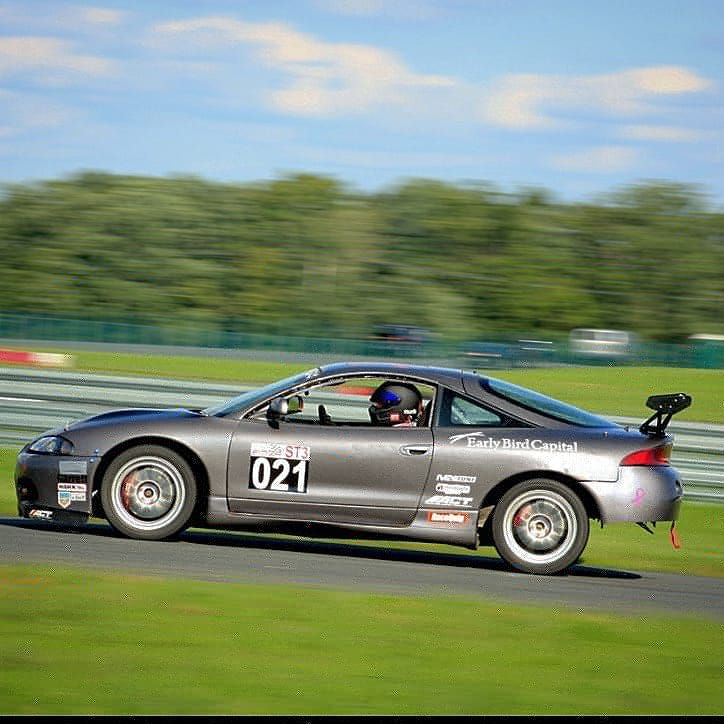

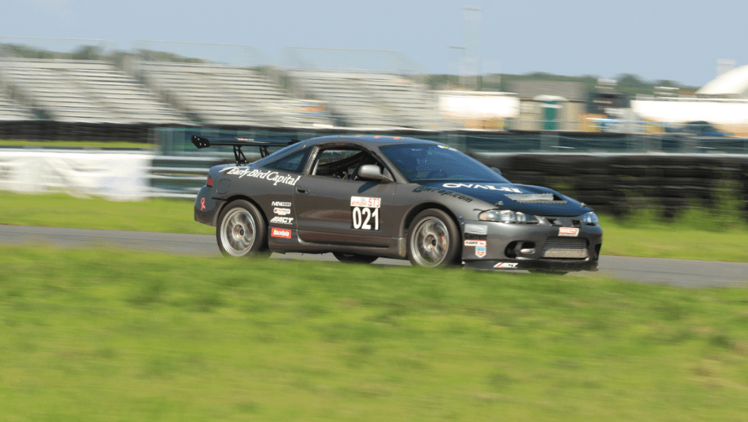

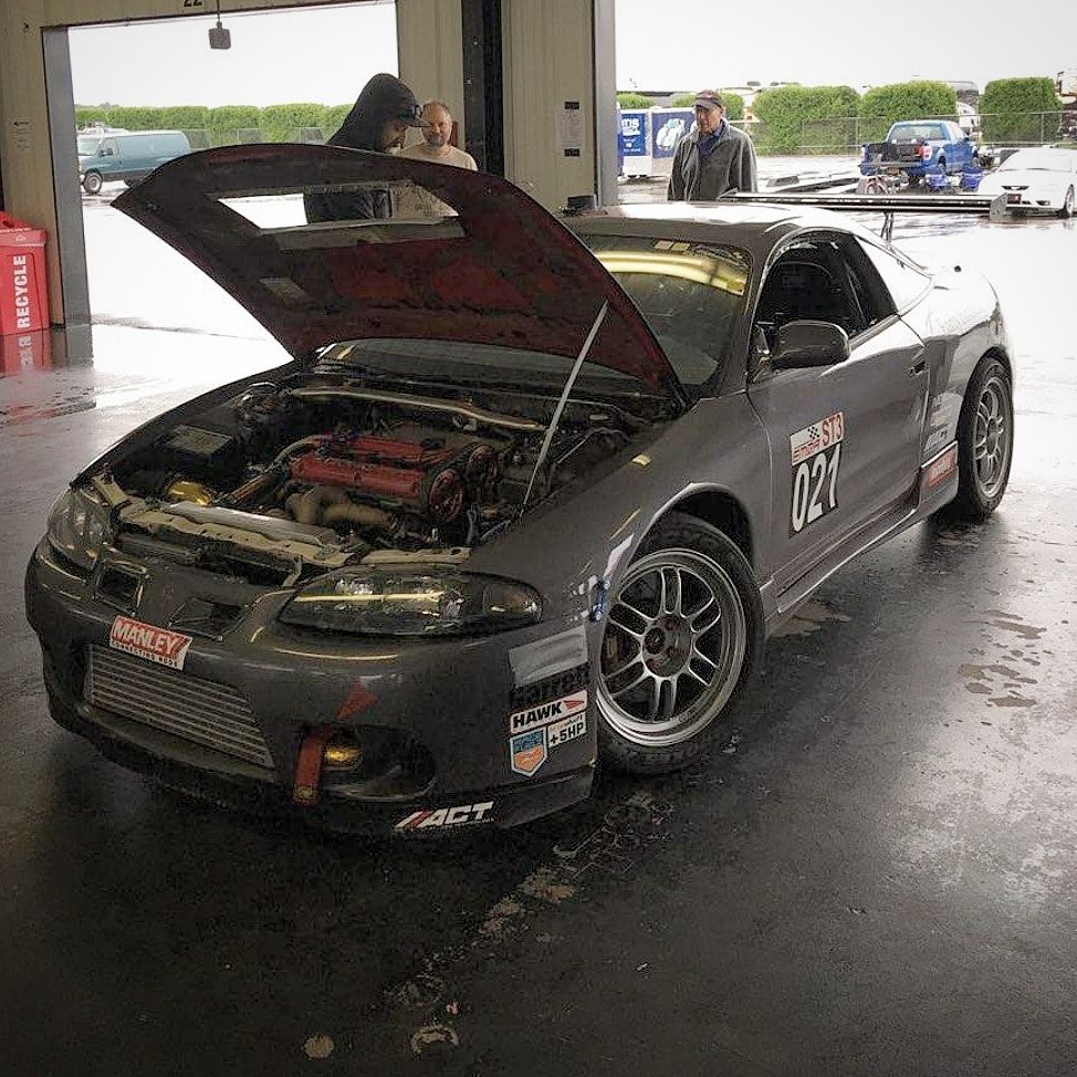

Just got back from Pocono. Had a really good event. First half of the day was dry. But after lunch, the rains came and never stopped. Still raining as I write this. The good thing is, we won! We set fastest lap in the dry. And once it started raining, we felt confident enough that our time wasn't going to get beat that we didn't go out in the wet. And we were right. So that's the race report.
The other bit of this weekend that was awesome was that this was the first test of Bobby's upper control arms. And I have to say, they were amazing. Absolutely amazing. The front camber that was gained because of them greatly improved front grip at turn in all the way through the corner. The increased caster greatly improved straight line stability. At 135mph before getting on the brakes for a fast kink, they instilled great confidence. Bobby's arms were definitely a factor in is getting the win this weekend. I can't thank him enough for all he does for our cars.
We all know that doesn't matter. Winnings winning.
But in all actuality, it was by about 8 tenths. I went 59.4. 2nd place went 1:00.2 or something like that.

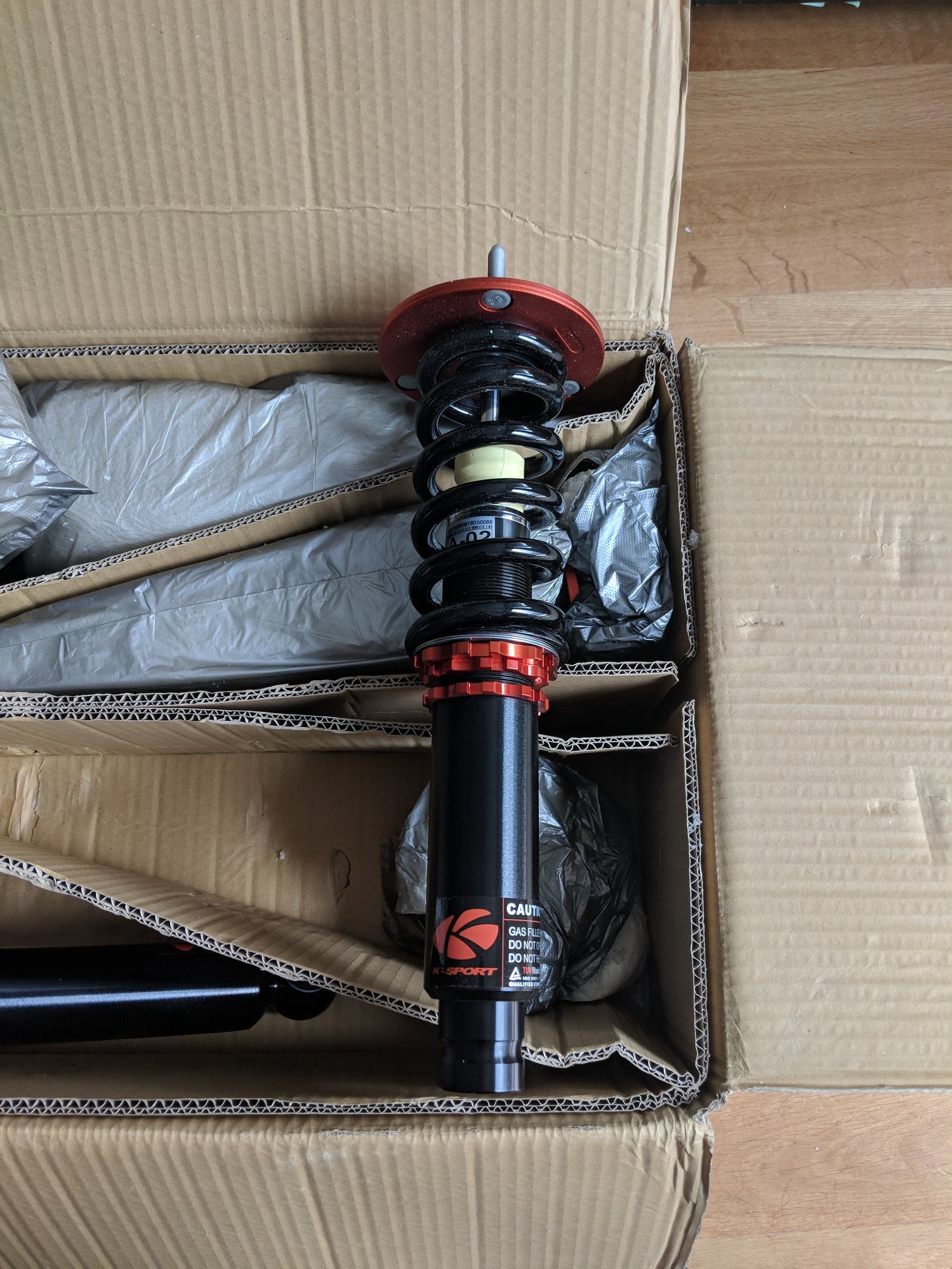

Nice! New parts! Out of curiosity though, since you actually race your car, why not go with a suspension setup that has a coaxial upper spring hat?
