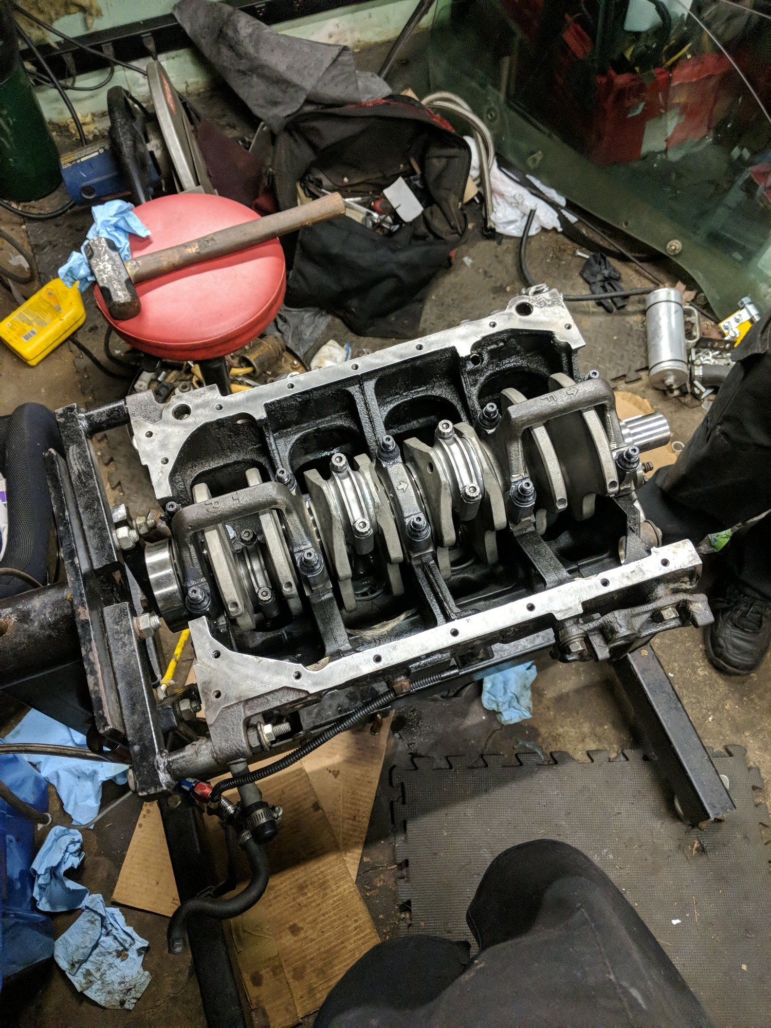

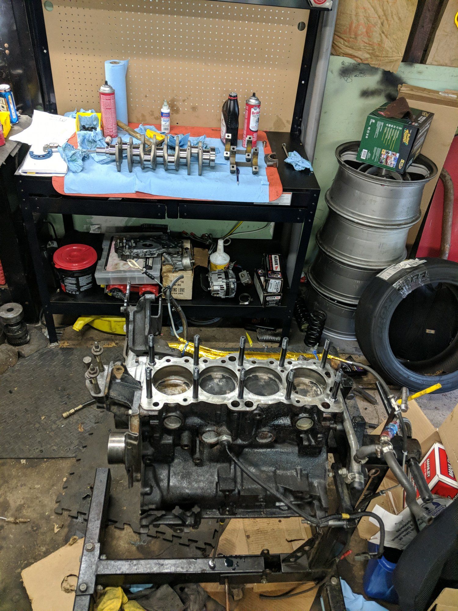

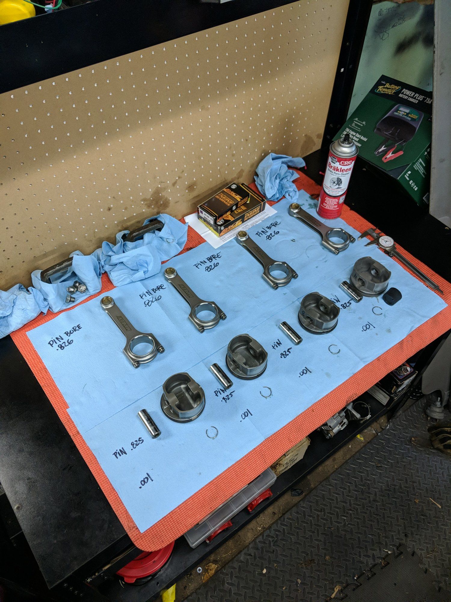

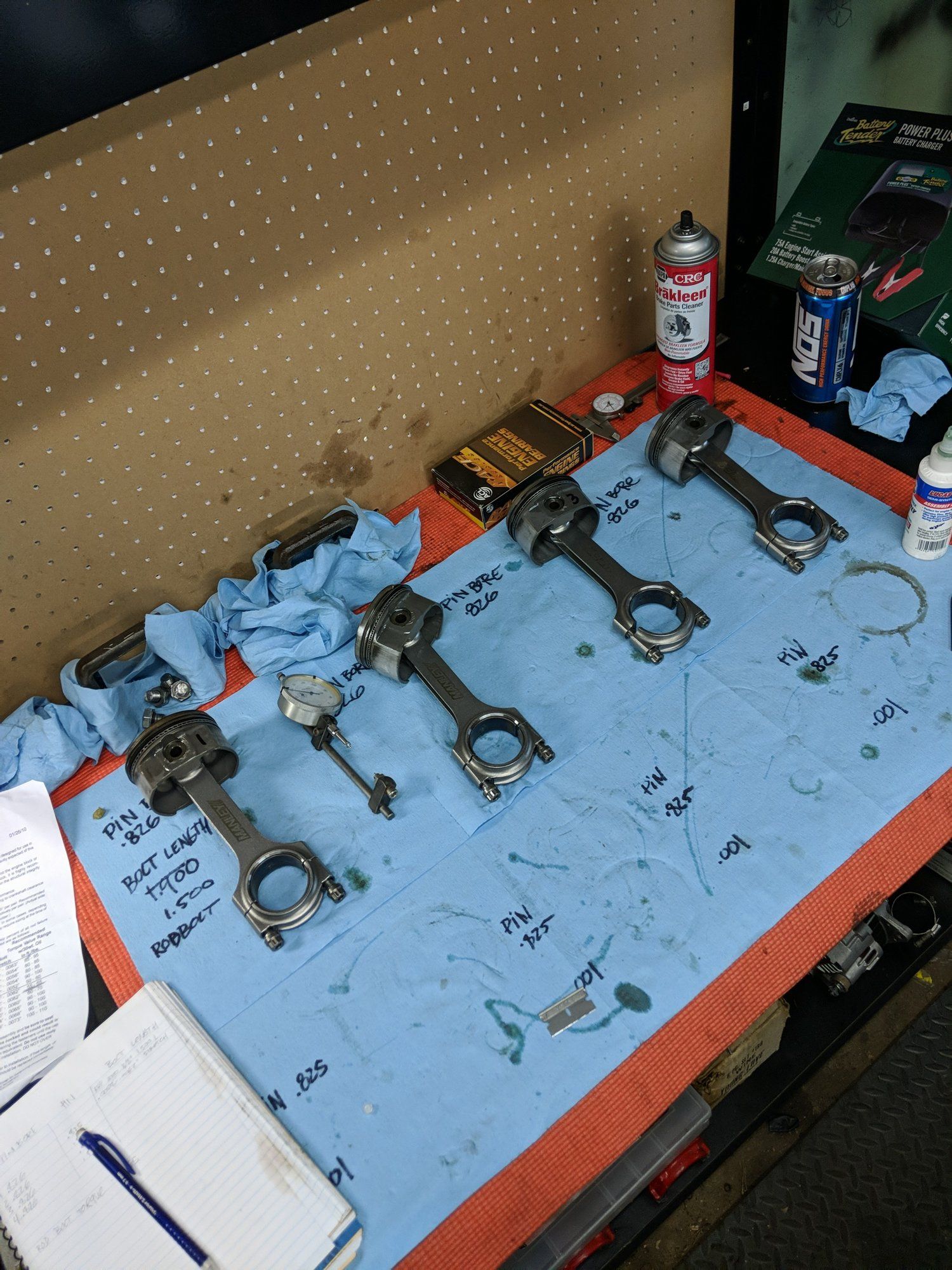

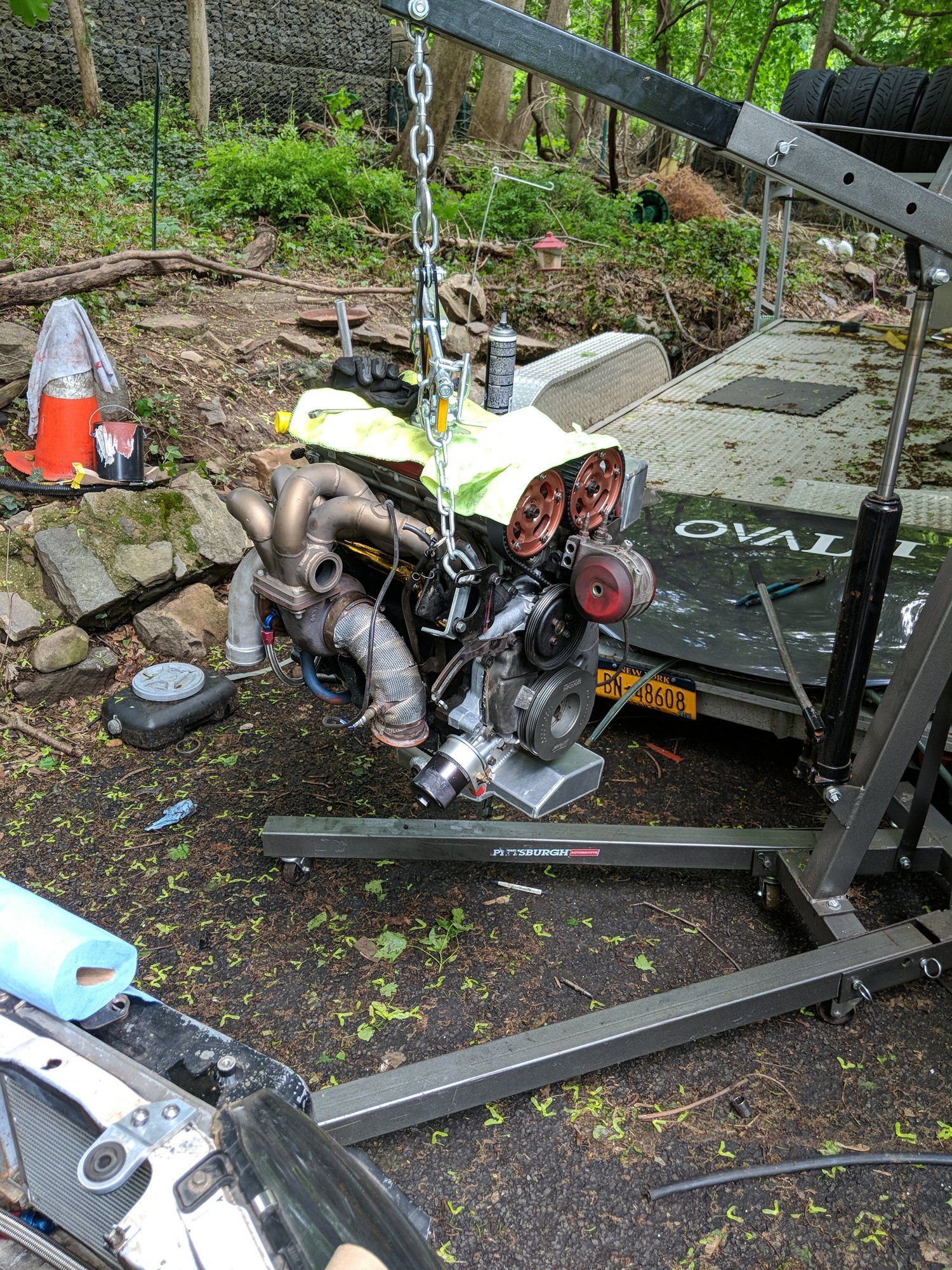

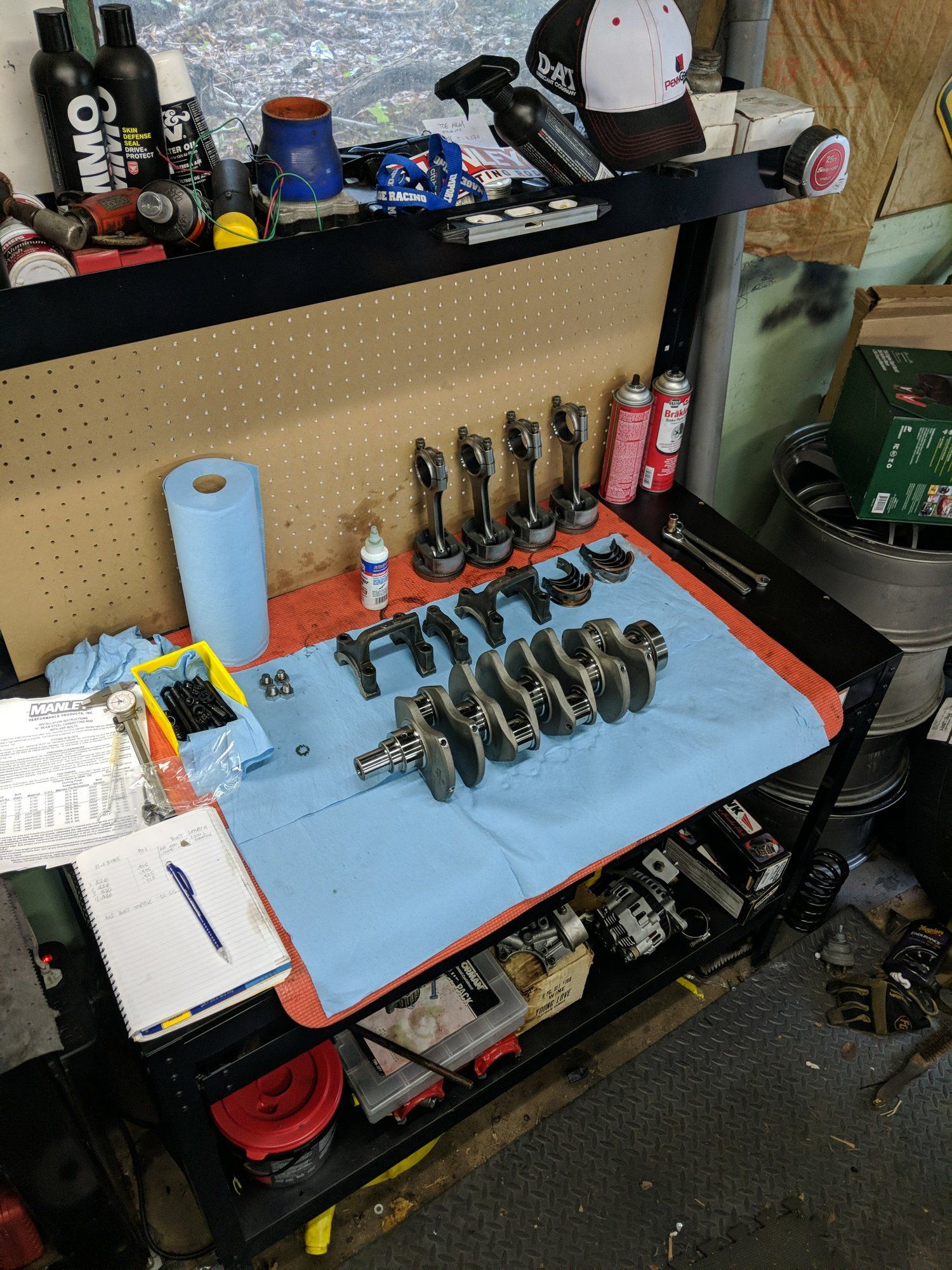

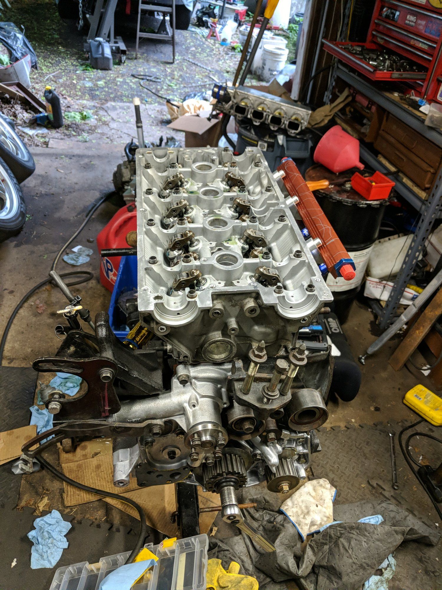

Got everything back from the machinest on Friday. Headed to the house early on Saturday morning. Mic'd everything and got the rotating assembly assembled. Going back to the house tomorrow to clean the head out and put that on. Hustling.

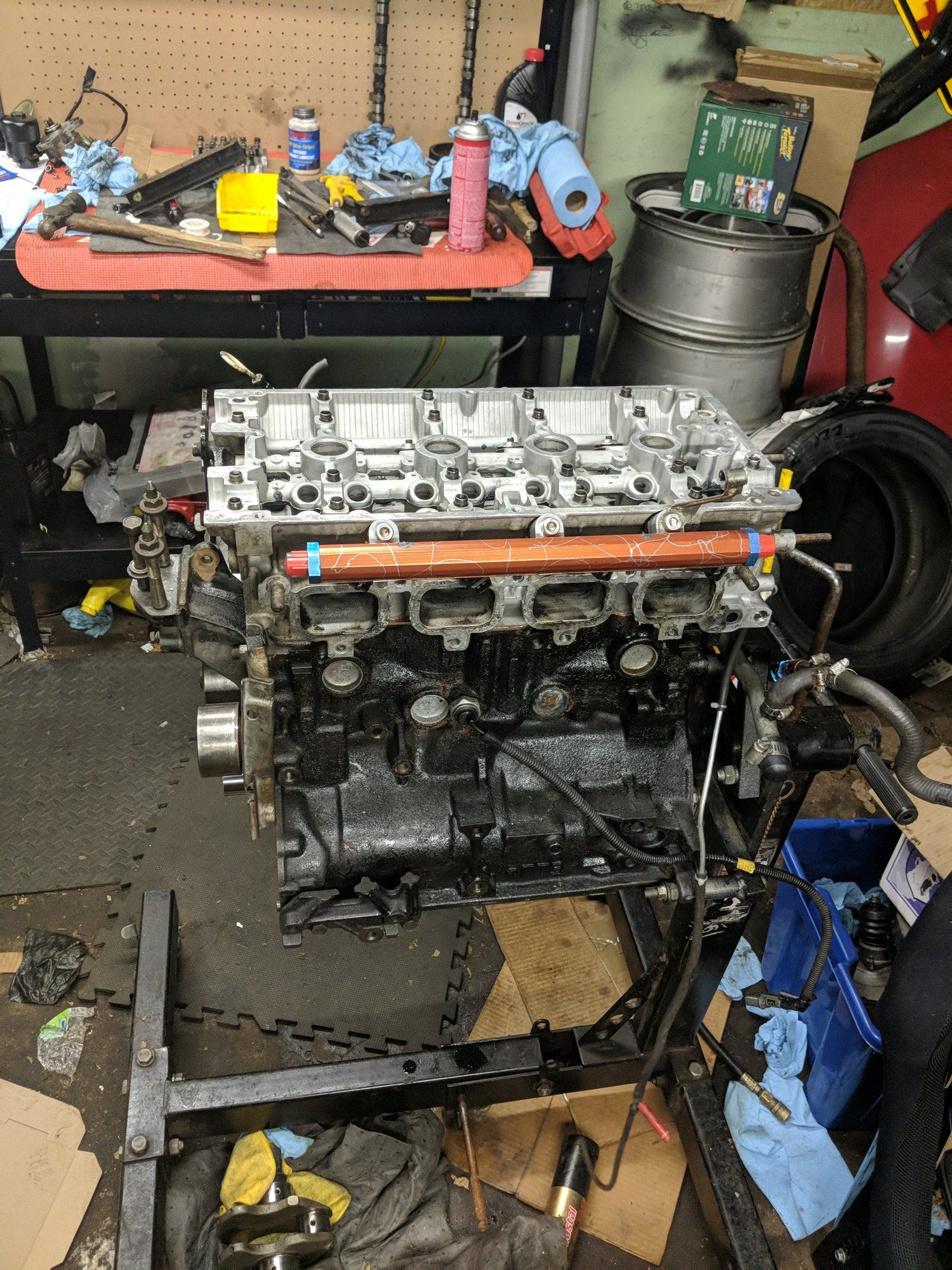

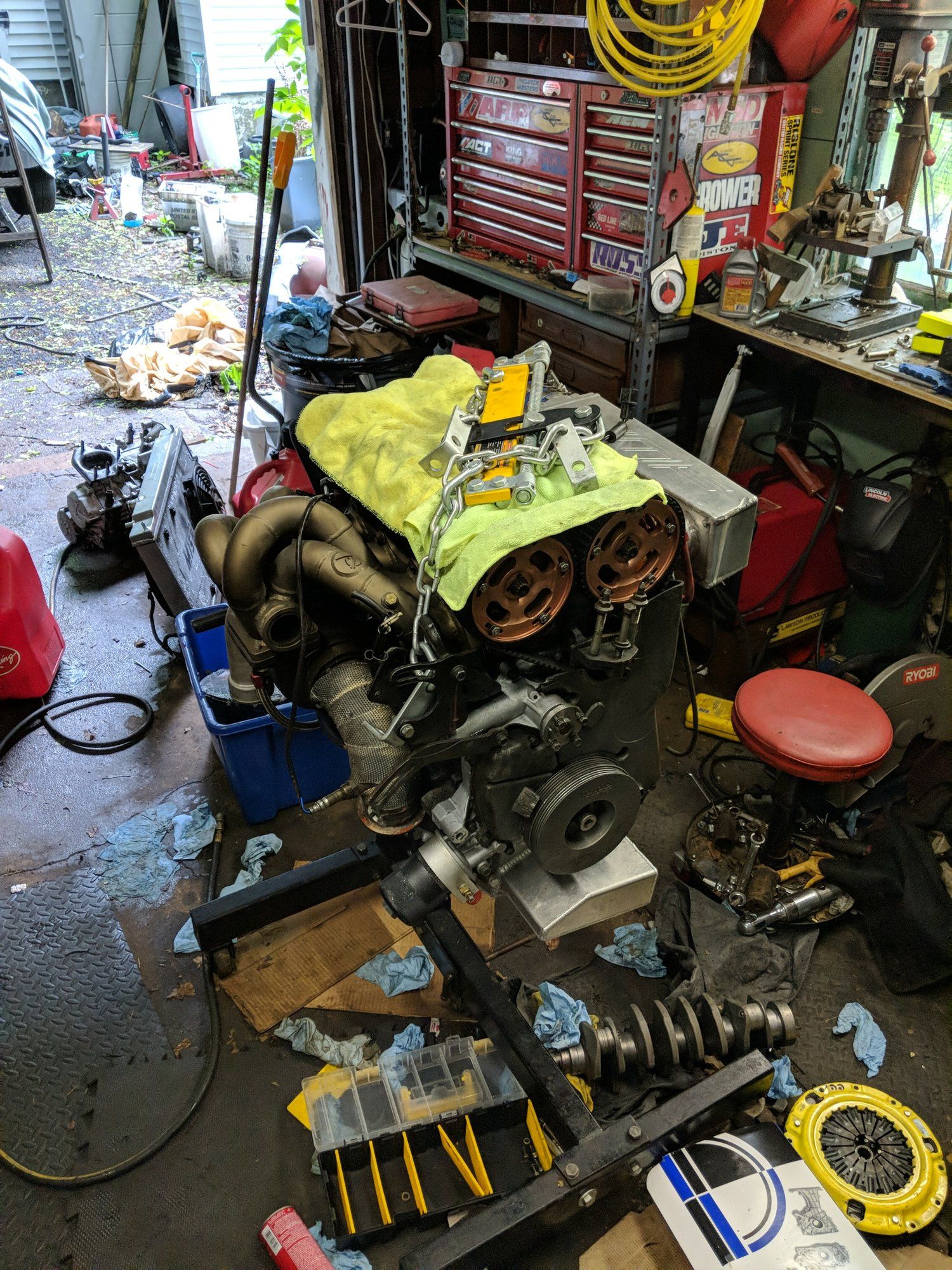

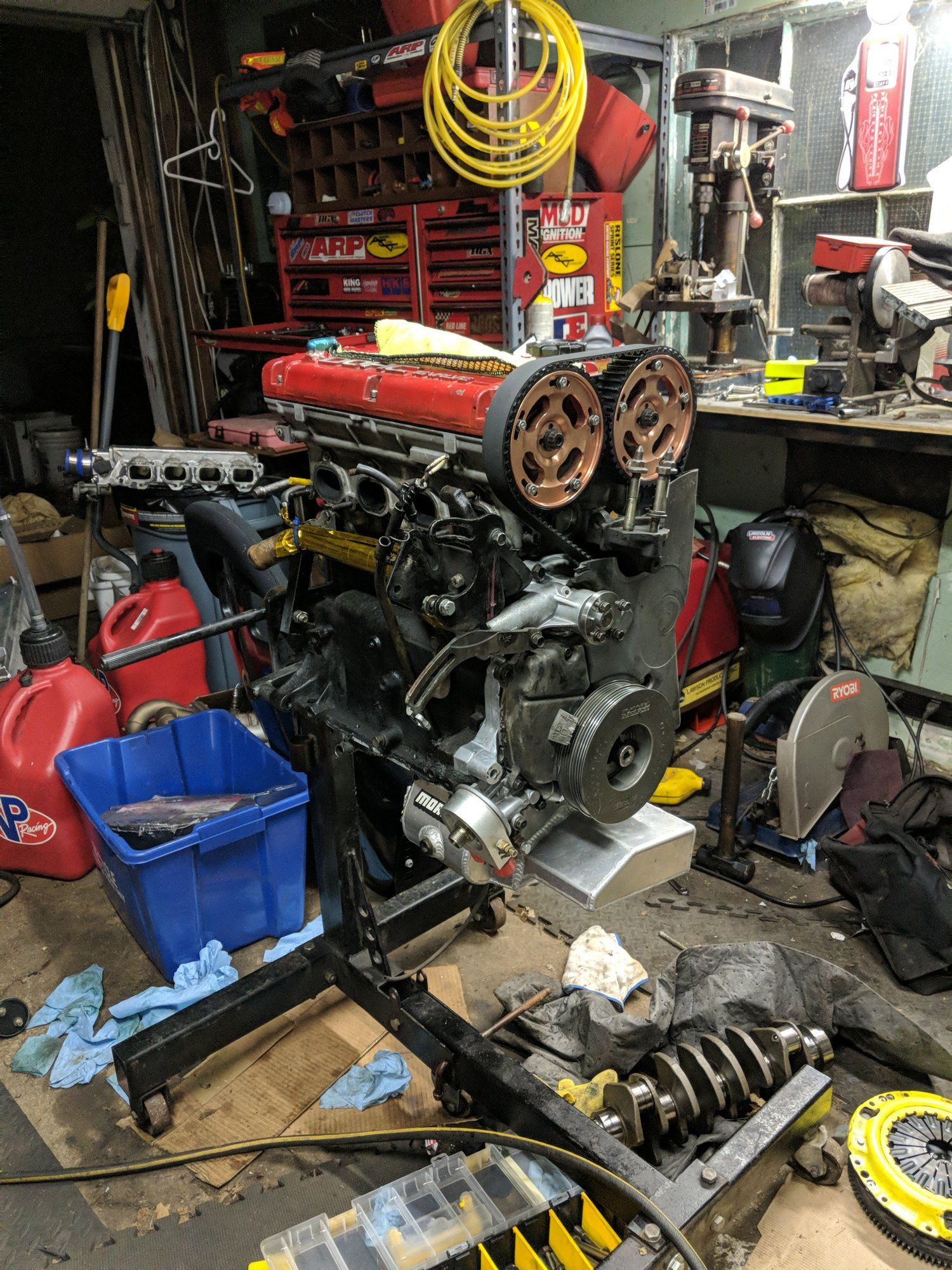

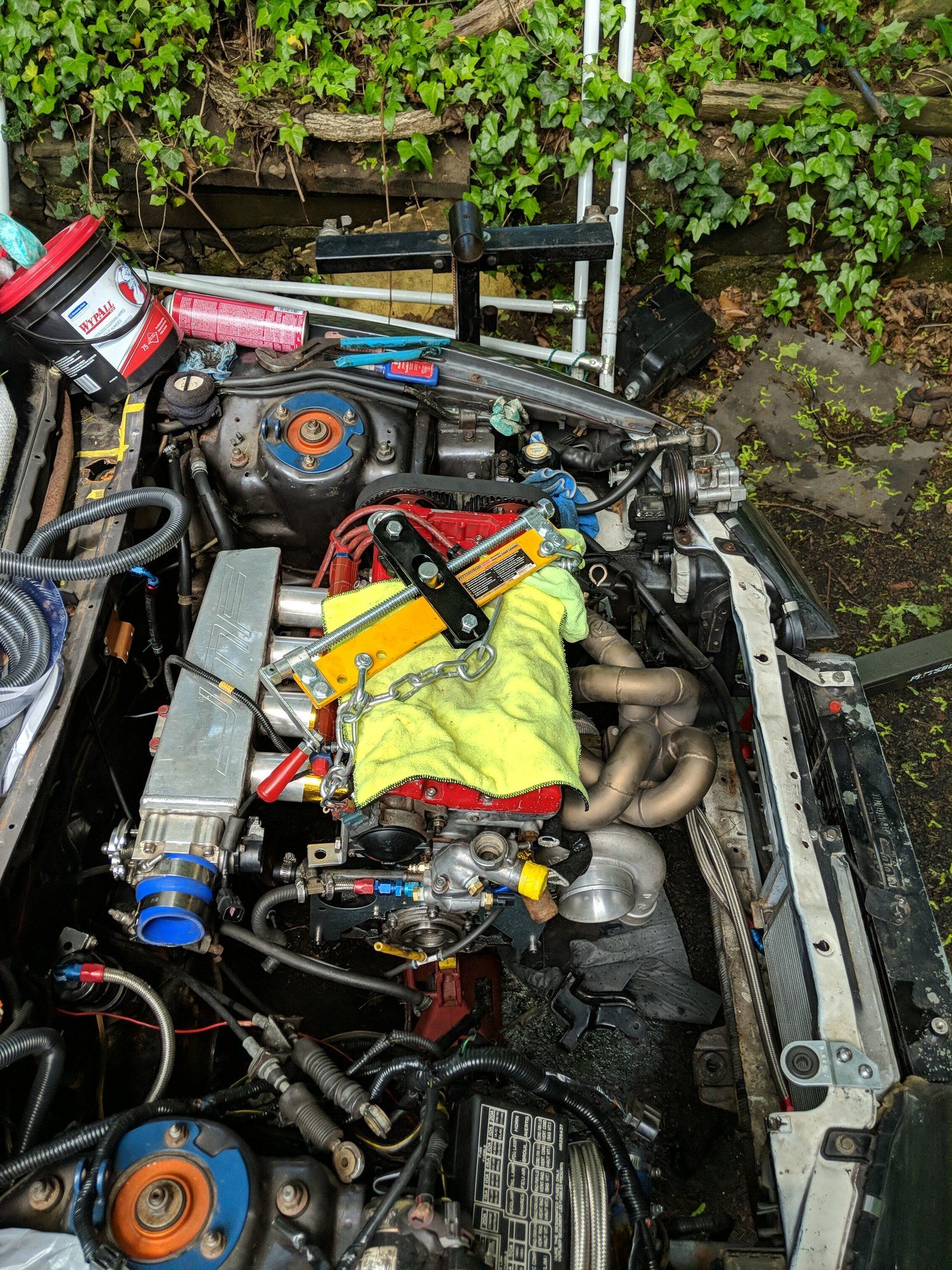

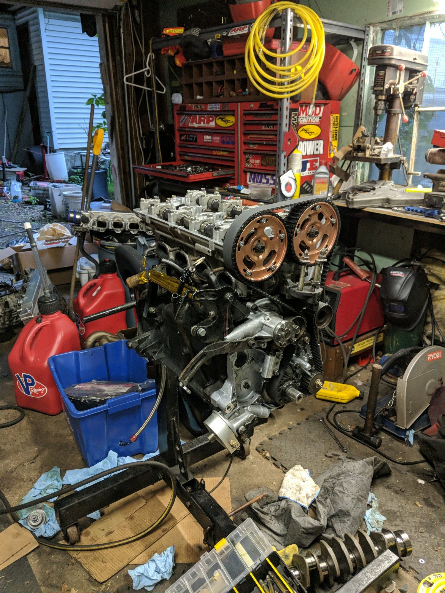

Got the head on last night. Took all the plugs out, gunked, hosed brake cleaned and blew out everything in the head till nothing but clean air was coming out of everywhere. Bled out the lifters. Can't believe how much junk came out of them. So I bled them, cleaned them out with some brake cleaner and have them soaking in oil for when I go back on Friday to finish installing the cams and installing the new front cover and timing belt. Going to try really hard to get the motor in the car this weekend. I also brought my tstat housing to work today and cleaned it up. Capped off all the ports that I'm not using anymore. Waiting on my new Auto Meter water temp gauge so I can put the sender in. It's looking less and less like we'll make Summit Point next month, but we're still gonna try our best.

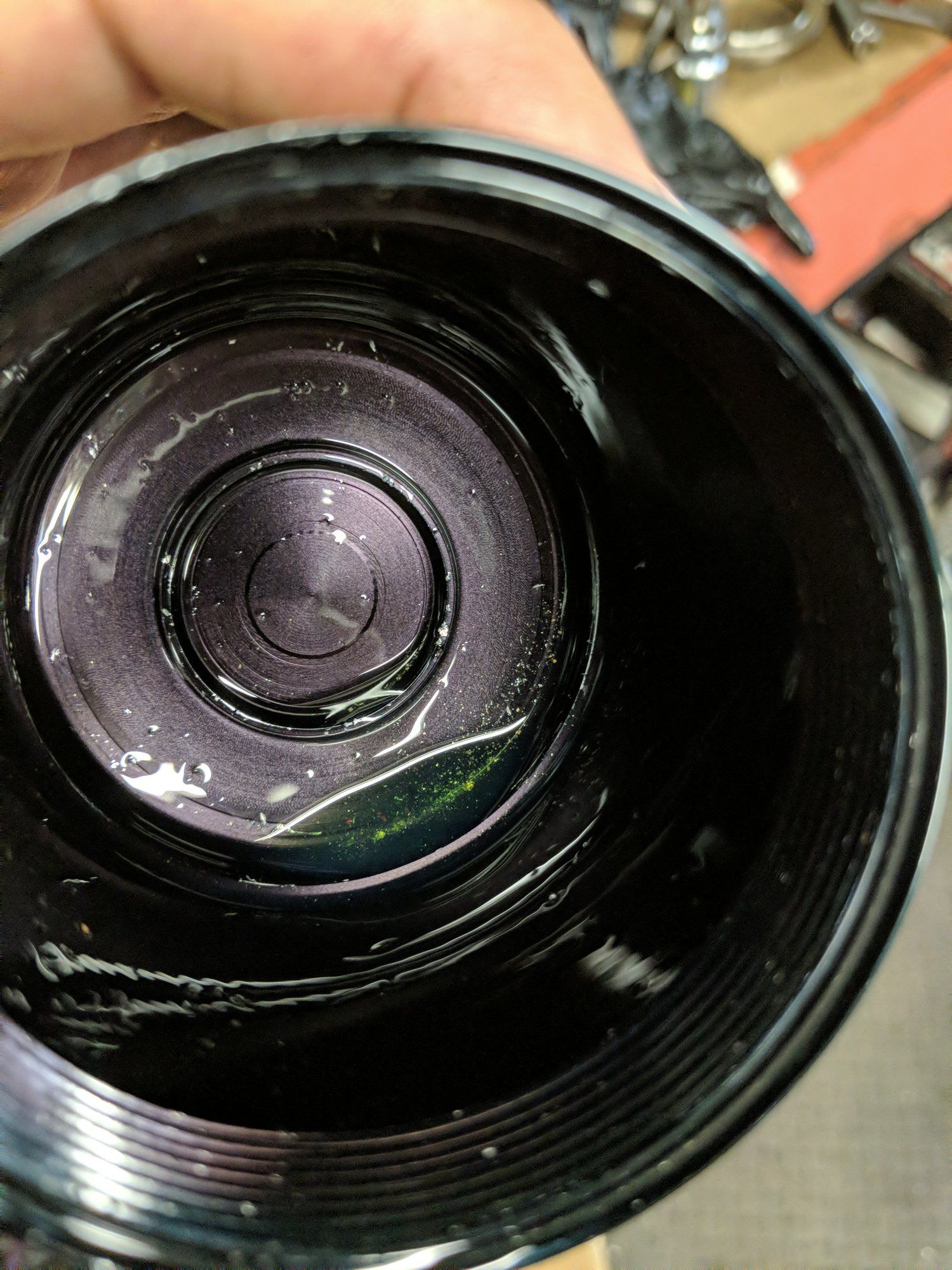

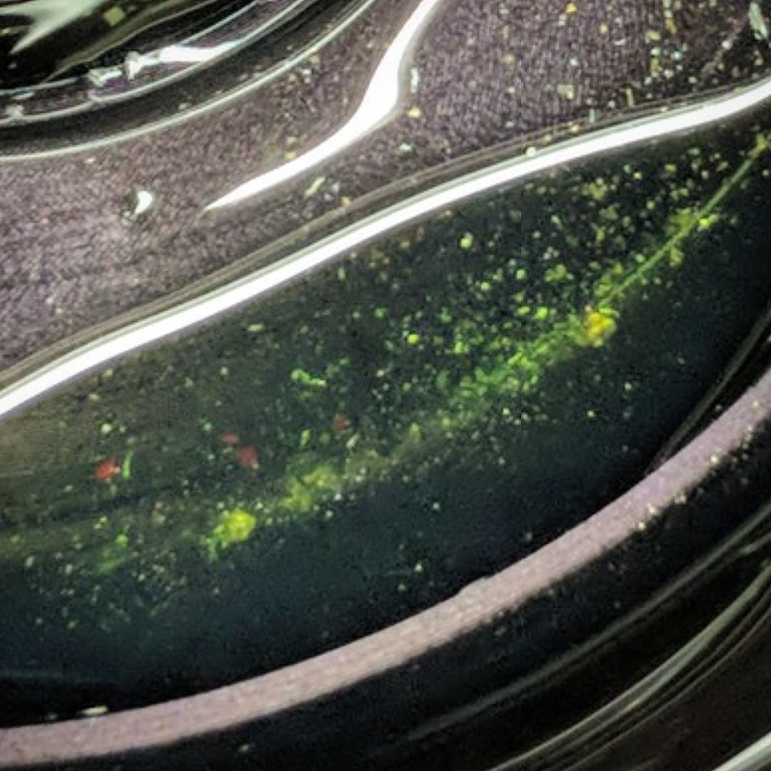

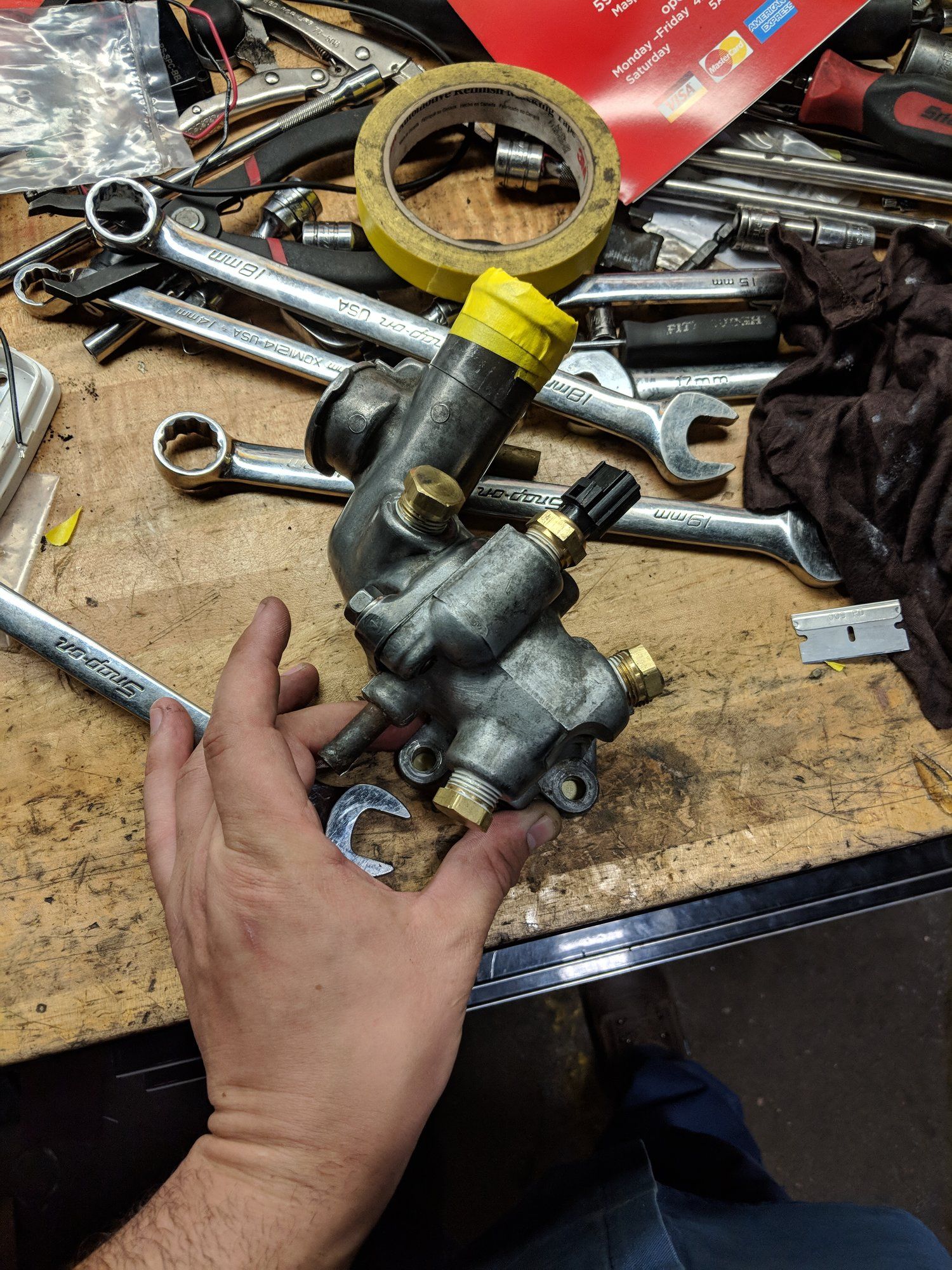

Got the motor fired up on Sunday. Ran it for a while. Oil temp and pressure was perfect. Water temp was perfect. After about a half hour of running and checking for leaks, I decided to pull the filter off and check it out. I have the Magnus oil filter so checking on things is a breeze. Pulled the filter apart. Metal. Freaked out. Primed the filter. Put it back on. Ran the car. More metal. Drained the oil, nothing on the drain plug magnet. Cleaned the filter. Ran it. More metal. Strangley enough, there was also what looked like red paint chips. So, my current theory is, the oil cooler still has junk in it, even though I washed it, blew it out, washed it, blew it out again. The red paint chips I believe are from the parts washer at work. Luckily (hopefully) for me, the oil that leaves the pump goes through the cooler first and then the filter. So whatever junk is coming from the cooler is getting caught up by the filter doing it's job. I bought a new cooler, gonna install that when we get back from vacation next week. Also gonna make up new cooler lines to be safe. The car was running absolutely perfect, with everything reading exactly where it all should be. I even redid the TBelt with the factory tensioner and new pulleys. Got rid of the solid tensioner. I don't make enough power to warrant the solid one. Hopefully everything is ok and when I put the new cooler in, the metal in the filter goes away. Crossing my fingers, toes, eyes, T's....everything.

Well, we got back from Europe last night. Went over to the garage today, changed over the oil cooler, changed the oil and ran the car for a bit. Pulled the filter apart, no metal! So you know what that means? Going racing this weekend! Gonna spend all week getting the car ready to go/tying up some loose ends. Gotta make a new gauge panel for the water temp and wideband gauges, gonna take the car up and down the neighborhood for a couple pulls. Then pull the filter apart just to make sure things are good. Then loading the car up Thursday and heading to summit point Friday night withy buddy. Should be a blast.
