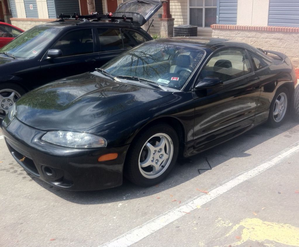

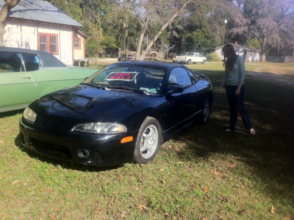

Well I've been meaning to do this for a pretty long time, so here it is. I picked up a '98 Eclipse GS this past winter here in Florida. When I first laid eyes on the car it was "OK". So I called them up and met the "owner" at the car for a drive. To my surprise when I arrived the said "owner" was shoving a long piece of wire in the door to unlock the doors since he BROKE the door handle! (Big surprise there, typical issue as we all know) So finally I just crawled in through the hatch. Turns out he was a friend of the owner and I talked to guy down to 1900, which I still felt was too high but the car was growing on me. So a mechanically inclined friend and I took her for a drive and all sounded and drove well. Of course it wasn't perfect for a car with 145k...

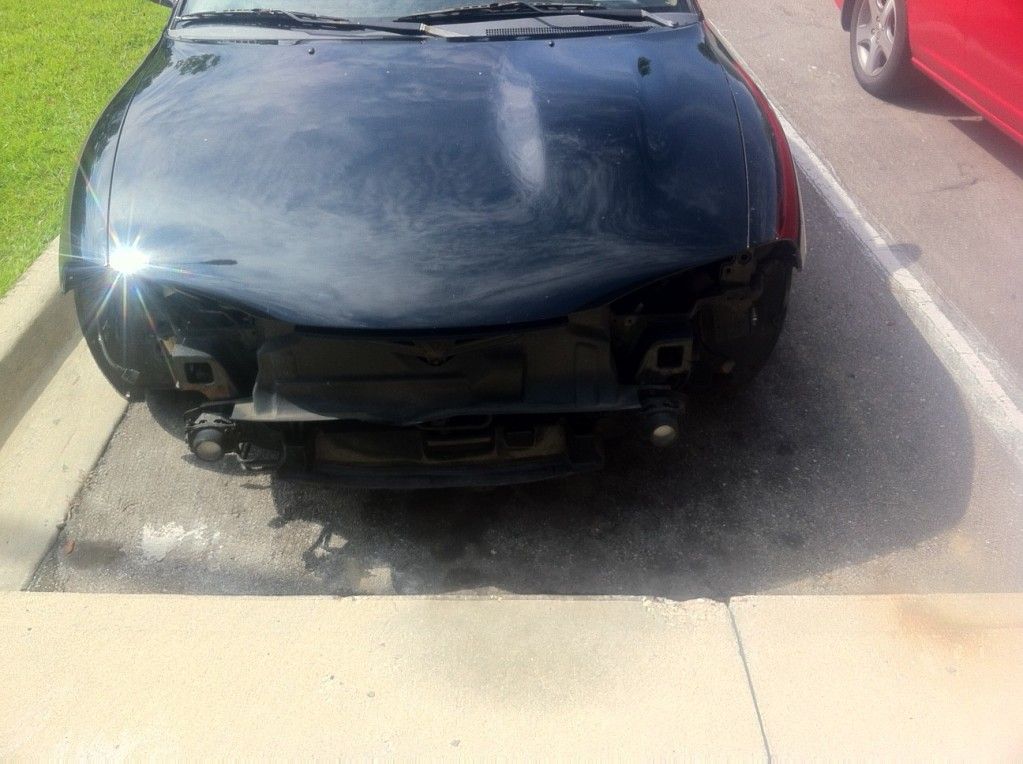

First here's some pictures of the car before purchase:
Once I was able to give the car a good look over I noticed a few issues:
- Someone sealed the sunroof with silicone, seemingly common leak "fix" with these cars.
- The hatch struts were blown causing the trunk latch to not disengage all the way so the trunk would only partially open. On top of that the key would only work 25% of the time.
- Headliner was ripped and had signs of water damage.
- Headlights were horribly yellow
- Missing the trunk floor panel, cargo cover, and mats
- Factory radio replaced with some horrid aftermarket radio, only the rear speakers worked because of their shoddy wiring.
- Obvious broken door handle.

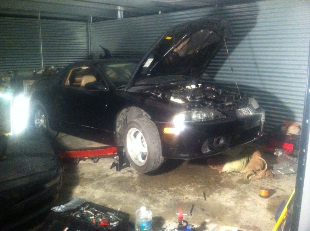

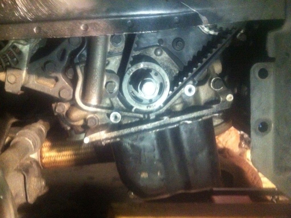

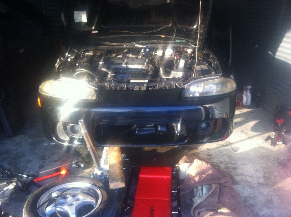

Soon after I decided it would be a good idea to start giving the motor a go through. So I'll take a second to mention that, yes this is a 420a and yes I wish it was a 4G63T of course, but I do enjoy 38 MPG highway and 21 city so I won't complain and I'll just have to get an identical GSX twin some day.
Timing component were first. I didn't know how long ago the timing belt and components were changed if at all. So to be on the safe side I changed them anyway. This included the belt, pulleys and tensioner which I purchased from a user here.
So here it is during the first go over, friend letting me use his shop AND helped me.
What seemed to be a flawless repair quickly went south when the crankshaft bolt was stripped. :ohdamn:
After a quick run to a local Ace Hardware, one tap, and 15 minutes of careful re-tapping later all was well again and she drove home avoiding the dreaded overnight stay in the shop.

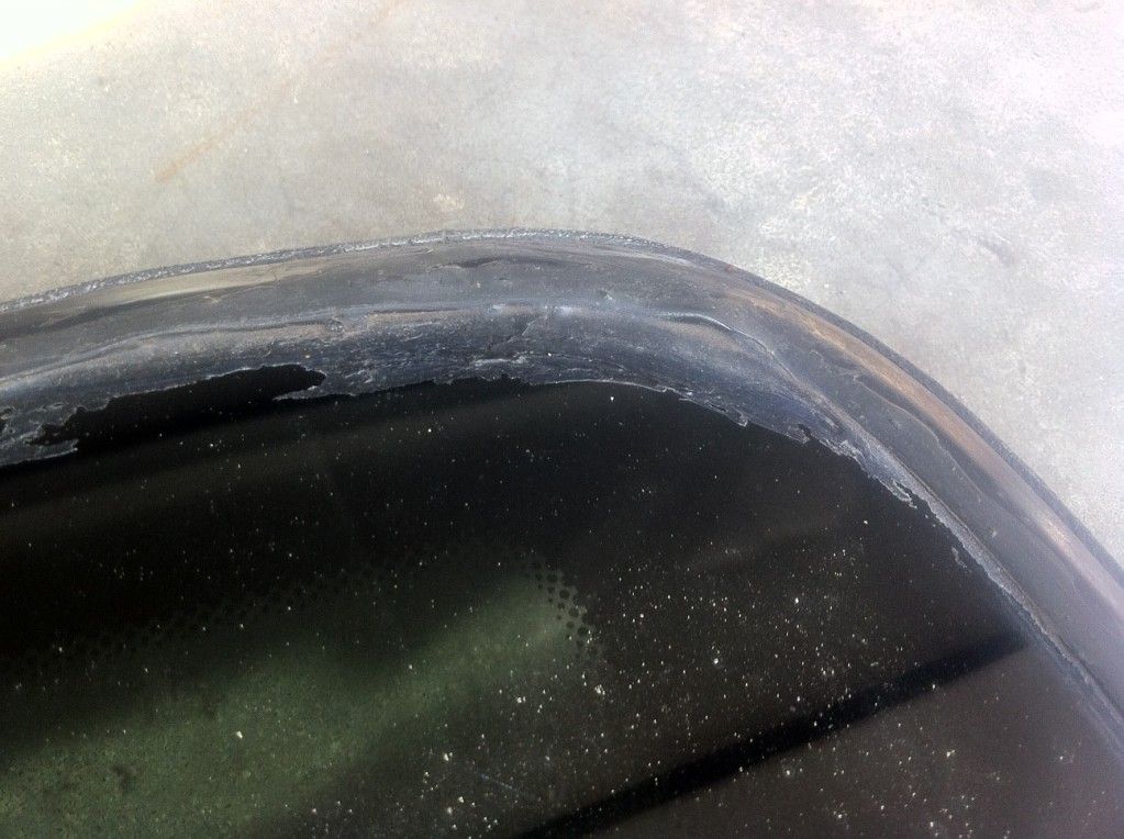

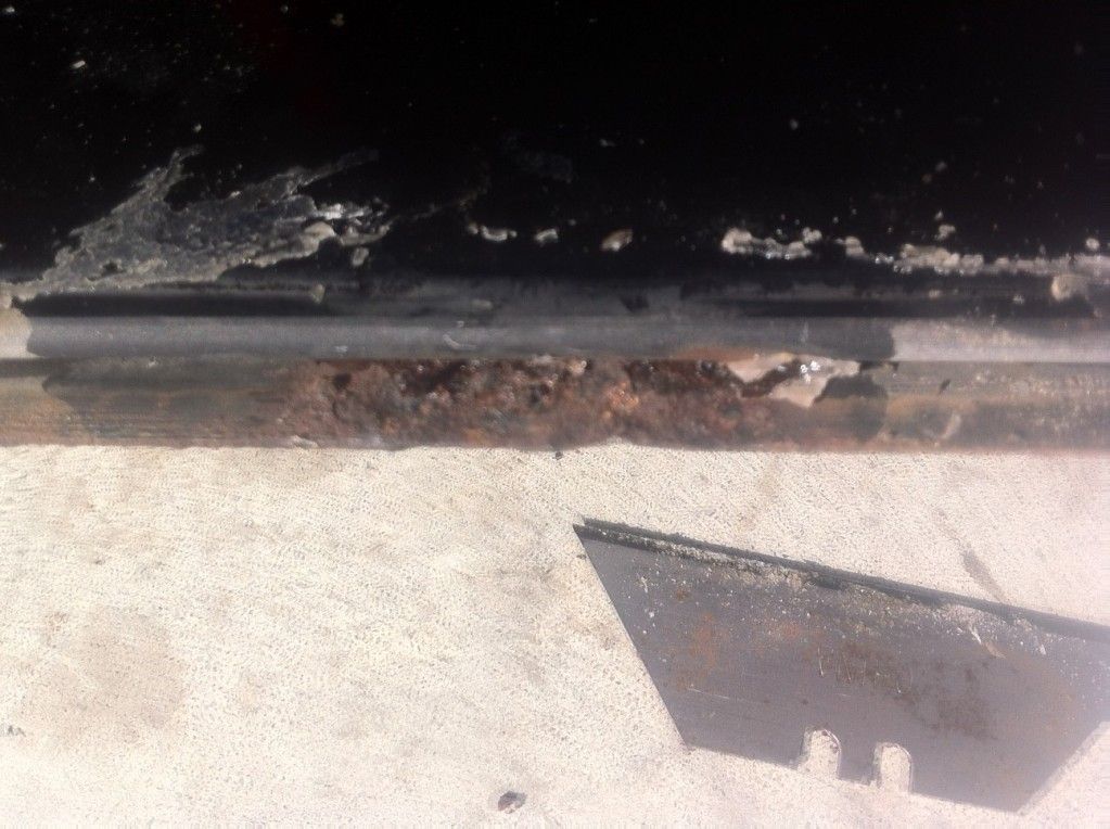

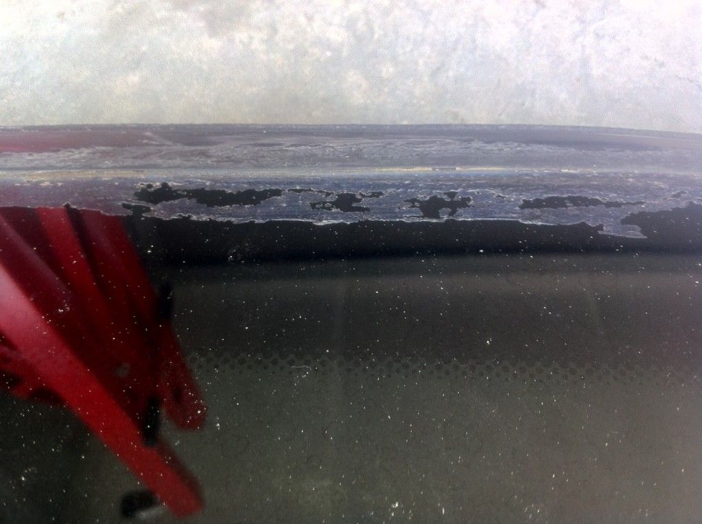

Next I had to address the leaking sunroof. Not only did it continue to ruin the upholstery but it just made the car damp after a decent rain. So off it came and I ordered a brand new seal online. But before I could put the new seal on I had to address the rust on the sunroof, which I expected to be there, and the silicone that the idiots before me applied.
So after scraping on the rust and applying and anti rust paste I slapped on the new seal, cleaned up the silicone, and off it went. Leak free. I had never opened the sunroof since purchase until this day. I wish I hadn't. The damn thing would open just fine, but didn't feel like closing under its own power.
So I took a trip to the junkyard and grabbed a working assembly.
For those who don't already know, there is a key that lets you open the sunroof manually to test whether or not the tracks were OK. You just need an Allen Wrench or a ratcheting screwdriver with an Allen bit.
After this it worked like a charm.

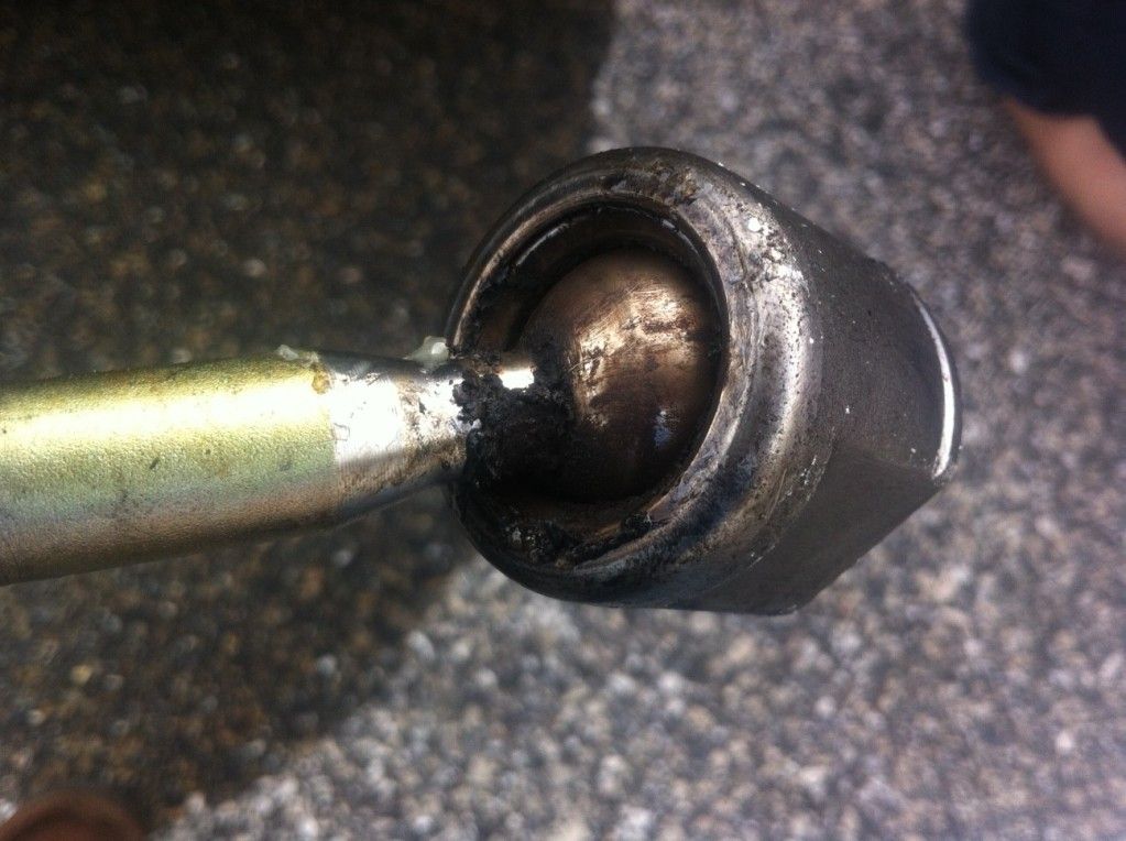

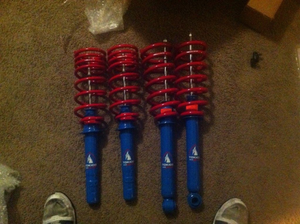

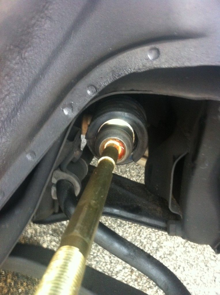

Soon after the Timing Job I continued to notice a clunk in the front right wheel when going over bumps. Well as the days and weeks went on it got progressively worse. It was decided that I'd try and replace the inner tie rod.
The tie rod was worse than I thought...
The pictures don't show but the tie rod rattled around like crazy.
So we slapped on a new tie rod and began dialing in the alignment the best we could until I was able to arrange a two year alignment with the local Sun Tire.
I drove the car home and there was STILL a clunk..
We checked out the car and decided it was ready for its first upgrade.
It was Christmas in April.
Not only did these bad boys get rid of the clunk but it improved the drive and feel of the car, not to mention the look.
They provided great handling with a 1.5" drop which was great, but it still wasn't enough.

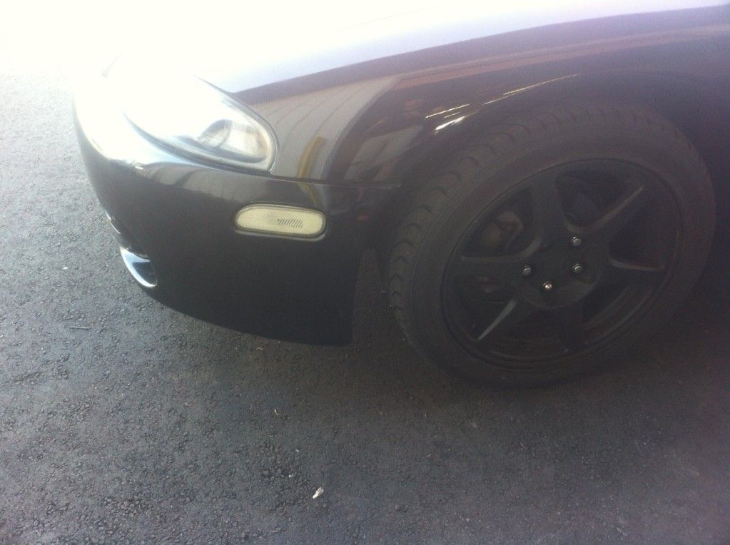

Here's some pictures to go along with the suspension upgrade.
Here's to show how flush the wheels are after the drop. The reason for this photo will become apparent soon.
So far this is my favorite upgrade. It provided an excellent feel for the car and I couldn't be happier with the look. Or so I thought. More on this later.

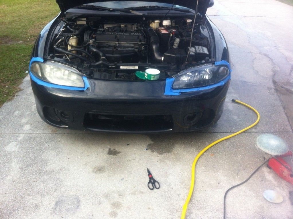

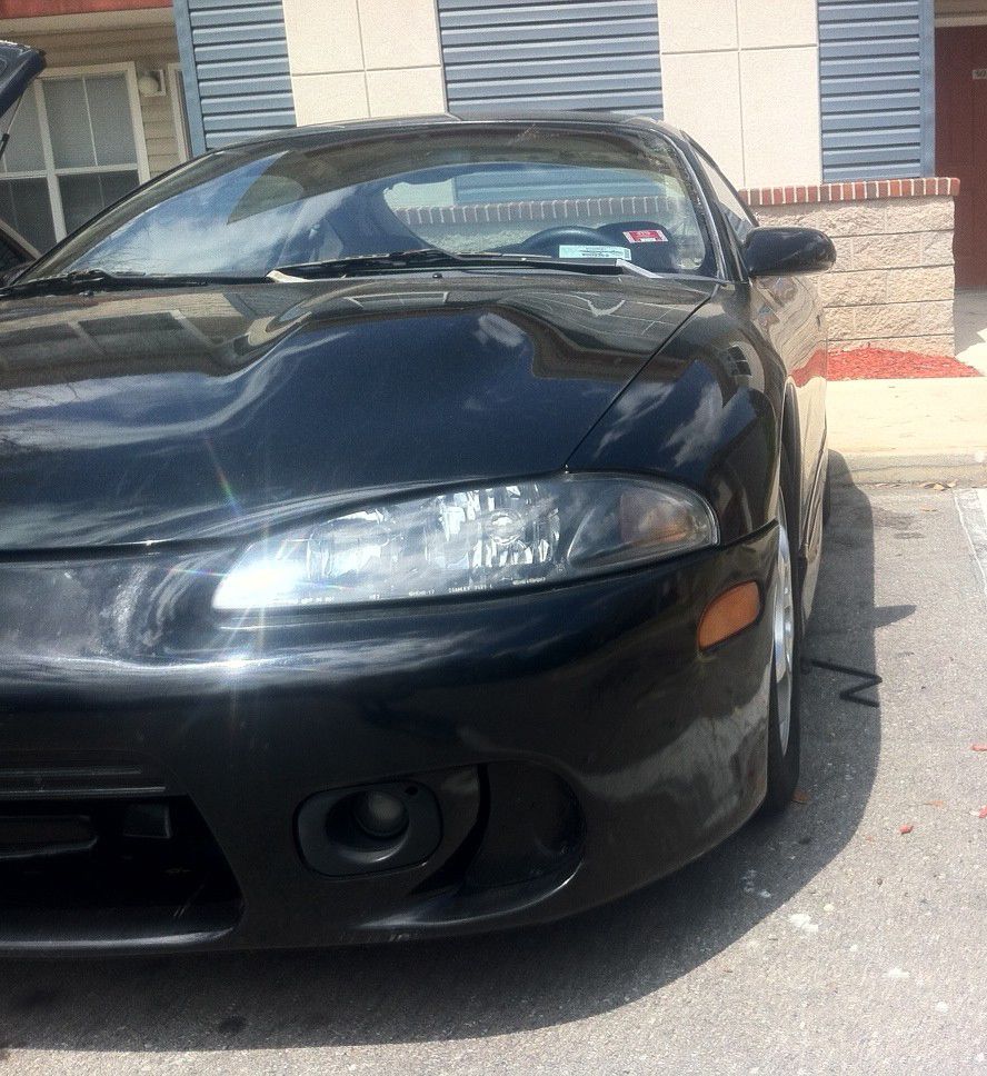

The yellow headlights started bothering me more and more. Finally I just decided to use my dad's tried and tested method of clearing up yellowed headlights. No special cleaners and headlight restore kits.
Here's what I used and the process in order:
Tape off around the headlights to avoid damaging paint.
- Wetsand using 600 grit sandpaper until you get a white paste. Rinse.
- Wetsand 800 grit, then 1000 and then 1500 or 2000 grit sandpaper. White paste. Rinse.
At this point you can use either a buffing wheel or do it by hand. I used a buffing wheel which yields the best results.
- Use rubbing compound with wheel ( or by hand) until hazy. Spray off with hose doing this 2-3 times. You'll start to notice it clearing up at this point.
- Next do the same thing using polishing compound. 2-3 times or until it's as clear as you like.
- Finish with your favorite wax. I used Turtle Wax Classic Hard Shell.
The Result? You tell me. I was satisfied.
Before and After.

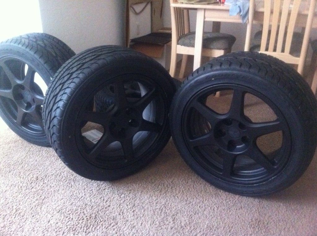

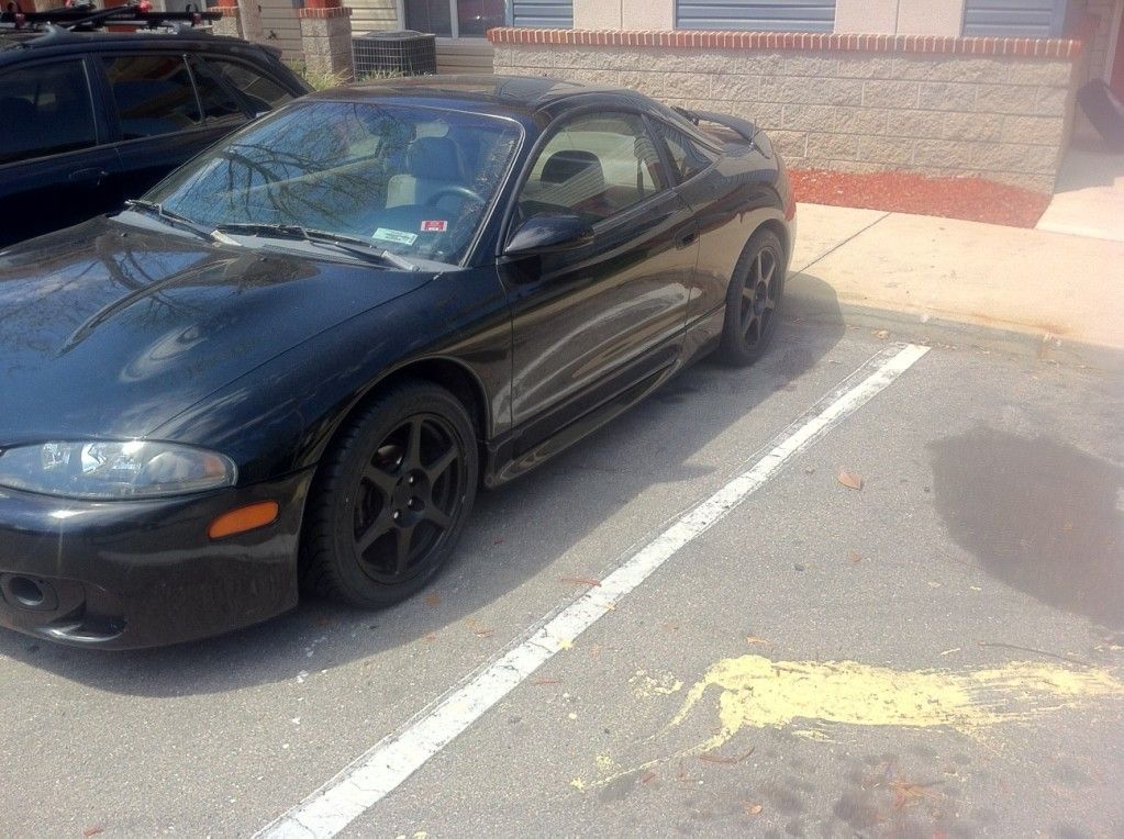

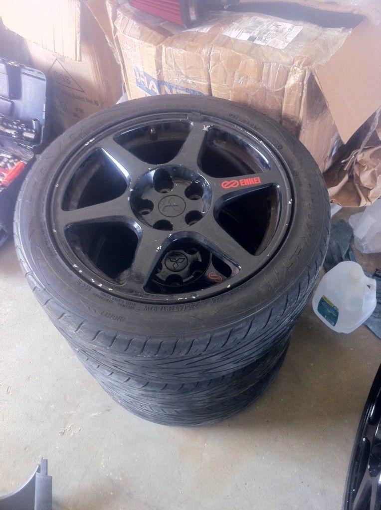

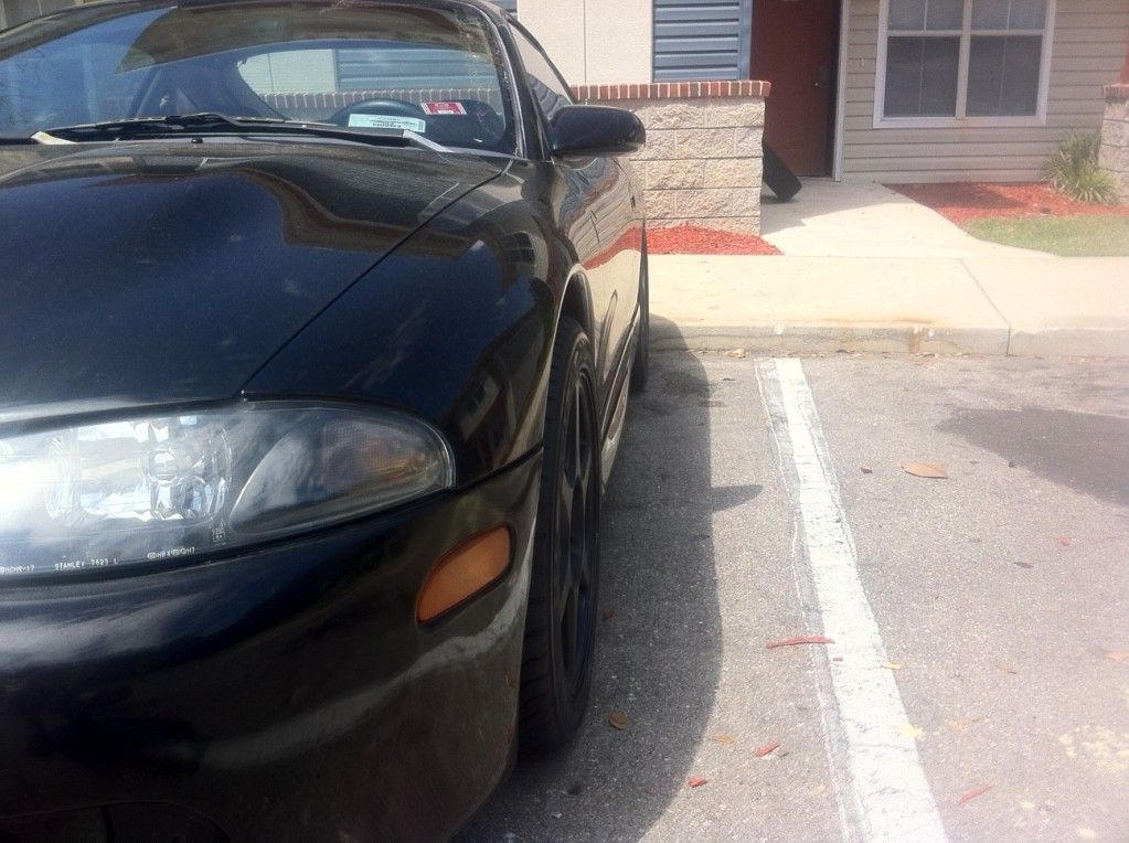

My MIF (Mechanically Inclined Friend) picked up a set of Evo 8 Enkeis that were painted black with spray paint....:ohdamn: unfortunately. So I tried to strip the black paint and ended up ruining the factory powder coat underneath. After I was done cussing myself out I decided I'd paint them later.
After that I grabbed some new rubber for the wheels. So I decided to go with Eagle Gts 235/45/17.
Then I decided I was going to go flat black with the wheels and grabbed 3 cans of black Plasti-dip. I really liked the outcome of the Plasti-dip. It made them look super aggressive.
This further improved the look of the car and again, handling was increased.

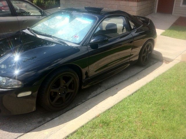

Now the reason for the picture earlier. The wheels ended up being completely flush with the car, which was great.
These pictures are also right after the suspension upgrade, so naturally the springs hadn't settled yet and will still end up lower.

These wheels were a great deal, I jacked up an Evo and ran off with them. The tires ran me about $650 minus a $100 rebate card.
I got the wheels in a trade for my stockers plus cash.

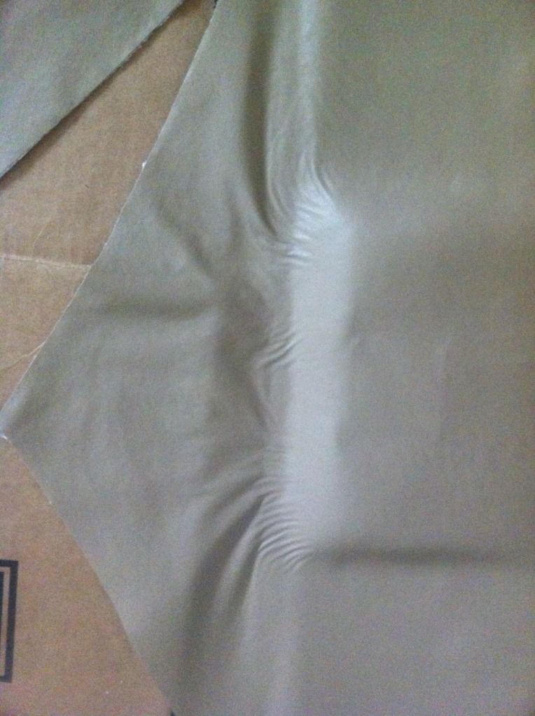

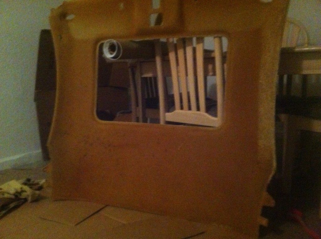

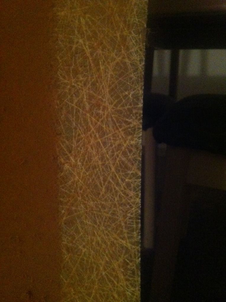

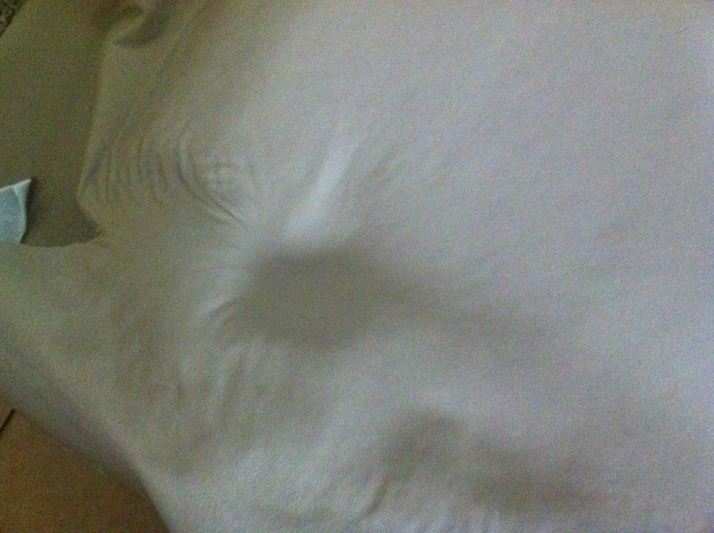

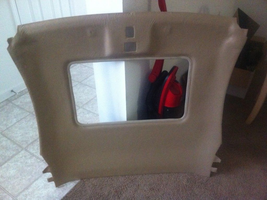

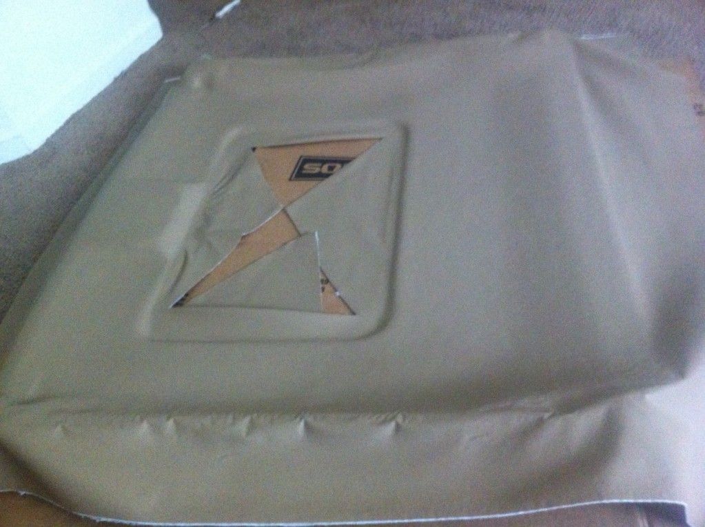

Interior upgrades were next. So I yanked out the old messed up headliner and pulled off the old fabric. I didn't realize how annoying it was going to be to get the foam padding off of the board until I started. Here's after 20 minutes of scraping...
After scraping everything off I went to the local Jo-Ann and picked up a huge roll of tan "leather" fabric and a can of Loctite Spray Adhesive #300. This sprays out like spider webs and give a pretty good coverage. I only did one coat but I probably should have done two. So I sprayed to entire board and layed out my fabric. The flat areas laid out nicely but some of the curves proved difficult.
After all was said and done the final product came out really nice and I decided to shave the visors for now. There are some wrinkles but after I had it in the car in the heat they released and are barely noticeable to me now.

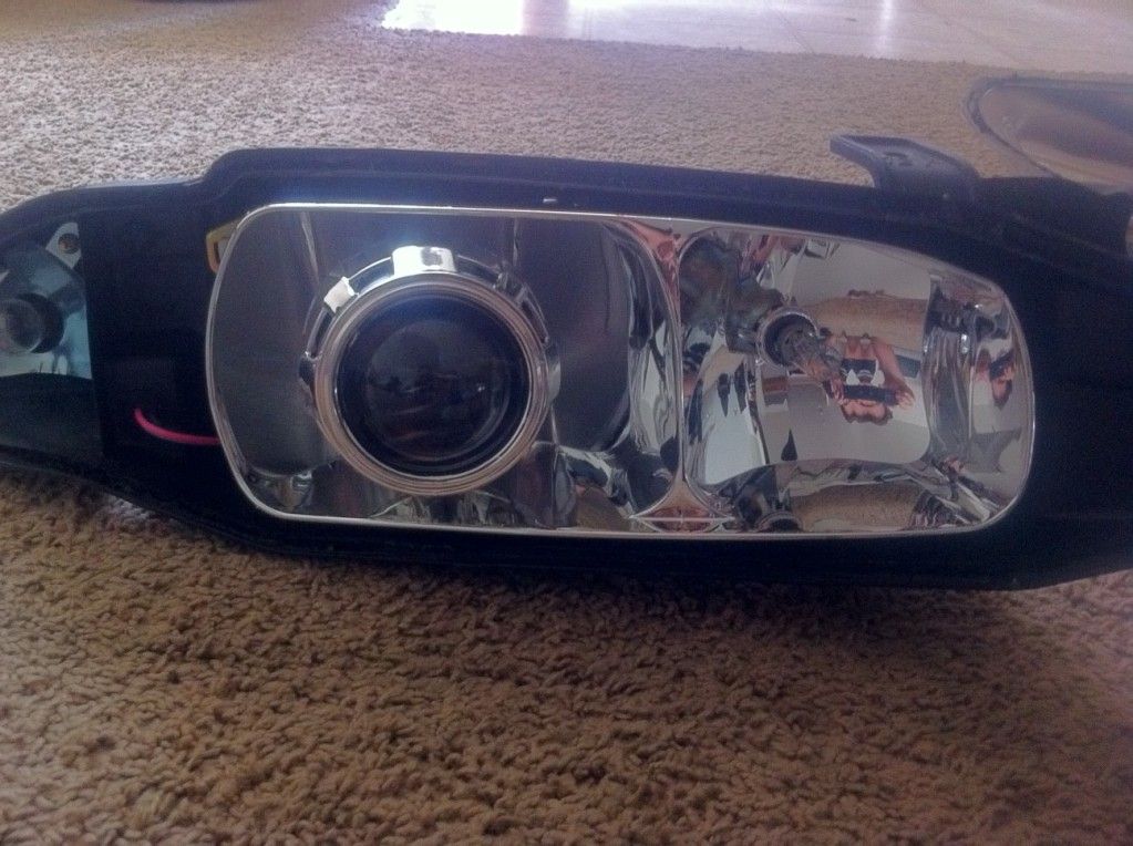

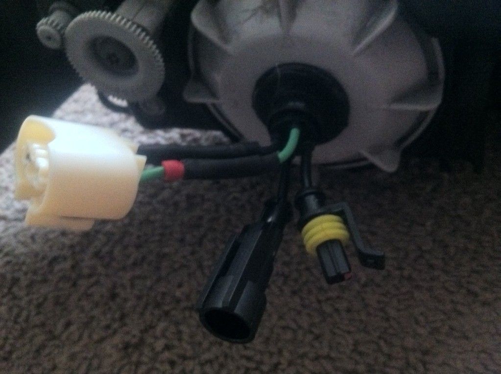

Then I found a deal that I couldn't pass up. I found some Morimoto Mini H1 projectors for a great deal. They had minor defects which I could live with. So I began the retrofit. First, off came the bumper.
I was a bit weary with everything especially with it being my first time disassembling a headlight. It turned out to be a little easier than I thought especially since the projectors were fairly PnP. I did everything clean, I tapped and soldered the wire for the bi-xenon flapper into the hi-beams. This allows full light to come out of the lens instead of just a cutoff when the hi-beams are turned on.
I'll be snapping some more photo's after the install and some night shots to show the cutoff.
It came out a bit crooked but when I get some more time all I have to do is give them a little spin to flatten them out.
Overall I'm very happy with the improved visibility.

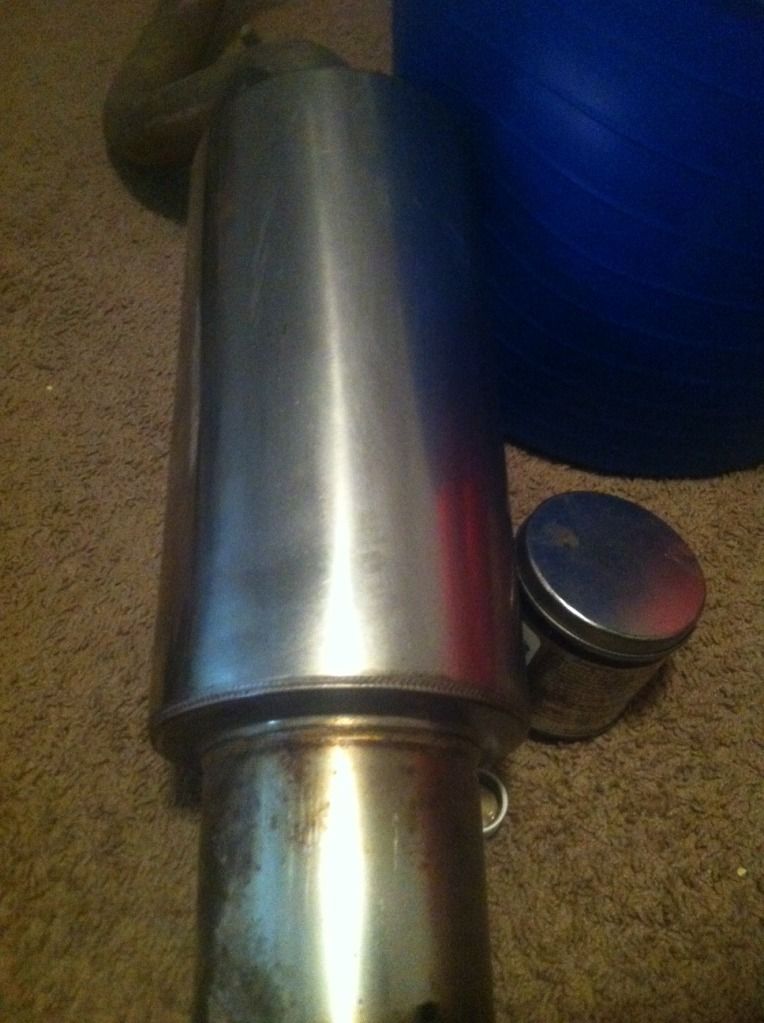

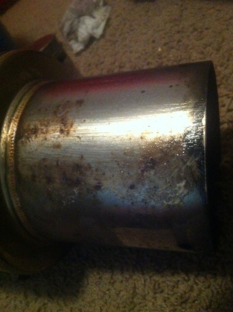

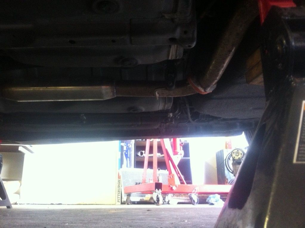

Next was exhaust. I got a super deal from a guy here on the forums. I couldn't thank him enough. I bought a Tsudo N1 style exhaust from him.

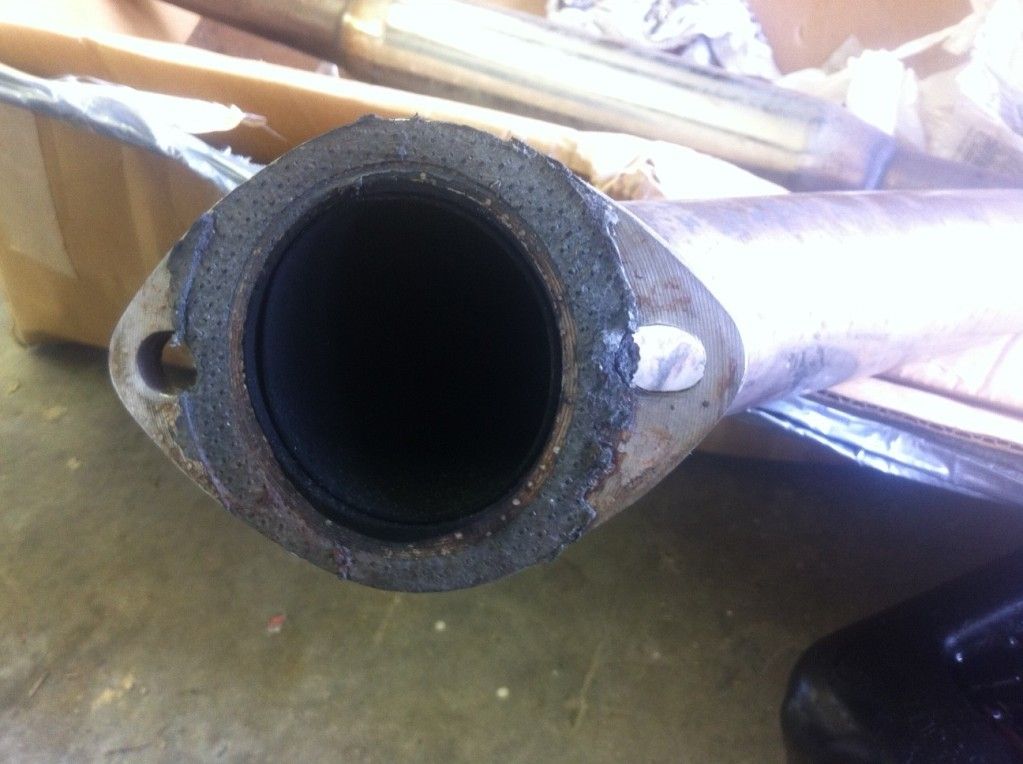

Here's how it looked out of the box. It had obviously been sitting for a while and I knew that. This was right after I started polishing
After about 10 mins or so of polishing.
The gaskets were worn out and falling apart as well. No big deal! That's what copper RTV is for.
You can see here how I used the RTV. I put a 3/8" bead where the gasket goes and then a thin layer around the areas that bolt together.
