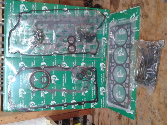

My gasket and head bolts came in today. Exciting almost got everything.
I have used that gasket set before on a beater talon and it leaked a lot, soon and everywhere especially the valve cover gasket. This may be the source of your oil leak problems as well. My solution was to replace with fel pro set from local store.

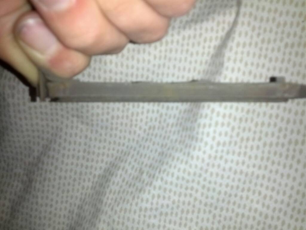

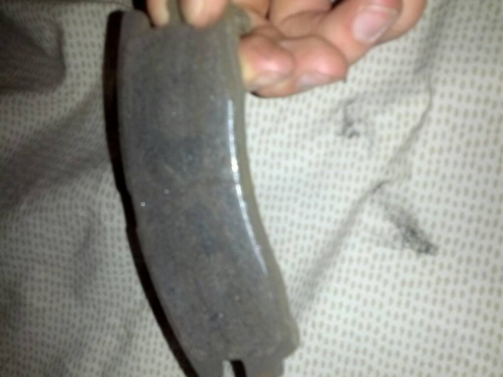

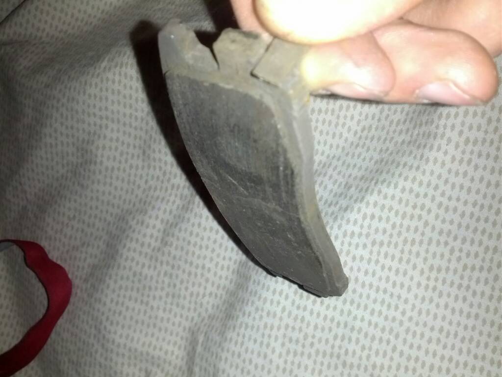

Over the weekend I thought I was going to have to buy new bushings, a horrible sound was coming from my right-rear tire well.
Turned out the brake pads were shot. OMG
The other side was worn, but no where near as worn as that side was.

That is good you figured out that problem. A lot easier to fix than replacing the bushings and a lot cheaper.

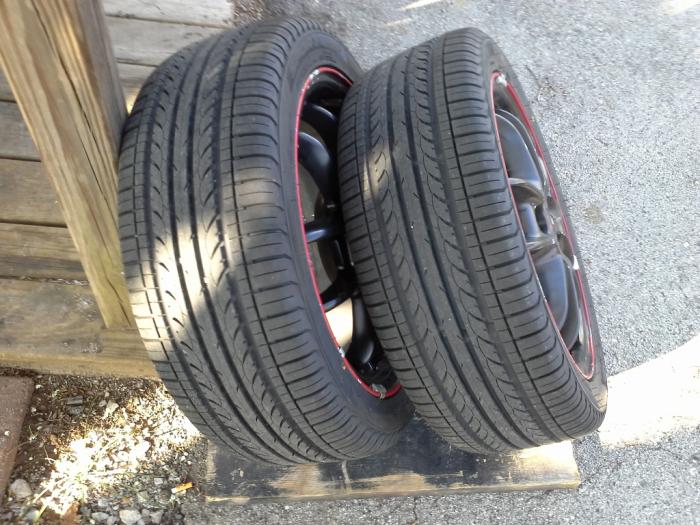

Well finally got tires and had saved up for more goodies. Yay.

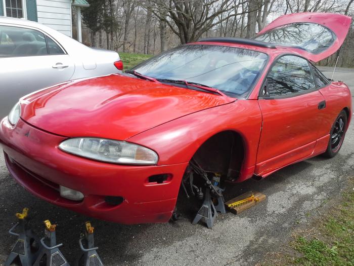

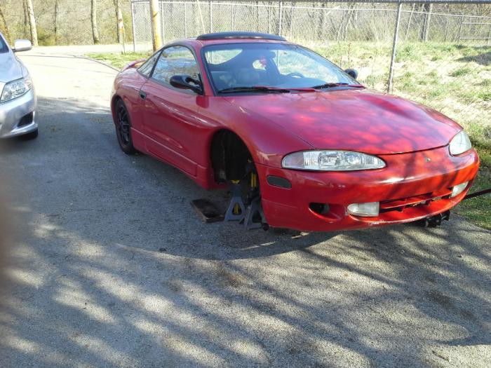

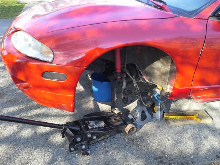

But car decided that she wanted me to spend my money else where. Right after I got my brand new tires I was driving on a back road. Well when I finally got to 55 the car started shaking really bad. Seeing that it was only when I started going over 55mph I assumed my tires were not balanced right seeing how it was right after getting new tires. Well place was already closed so I was going to call next morning so I went home.

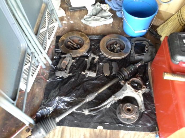

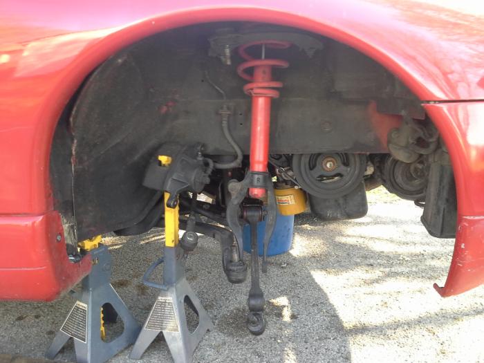

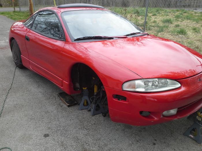

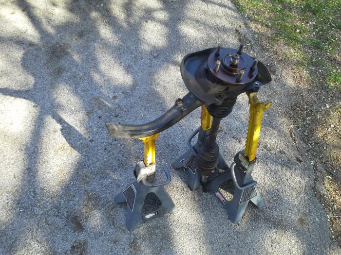

Next day I decided I would jack the car up and make sure it wasn't something else. Well it was, both front wheel bearings where shot and the tires where so loose. I remember hitting a pot hole that went across the road but didn't hit it hard for me to worry I thought but this also explains that loose part up front I never could find.
Car is up on jack stands and taken apart ready for me to get parts from a pull a part tomorrow. Going to get spindles hubs and c/v axles for both sides.

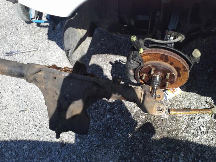

Well I decided to just get all new bearing and c/v axles. Still had to go to the pull a part to get another driver side spindle because we could not get the c/v axle out of the hub on the driver side. We had tried everything, so I cut my losses and got another for $20.

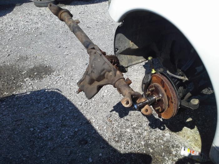

There we had to brake the axle nut lose. So we stuck a screwdriver in the rotor to stop it from turning. That's when I realized I forgot my breaker bar. We we spent about 20 minutes looking for something to use as a breaker bar. Well we found the perfect use for a front axle out of a jeep. :hellyeah: This made our day and worked perfect. :D

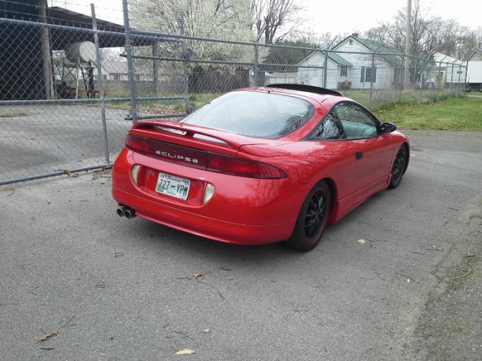

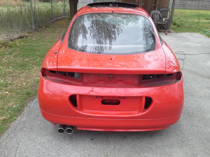

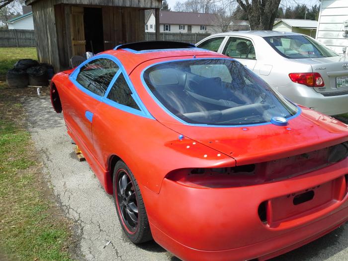

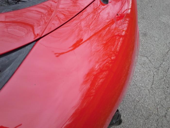

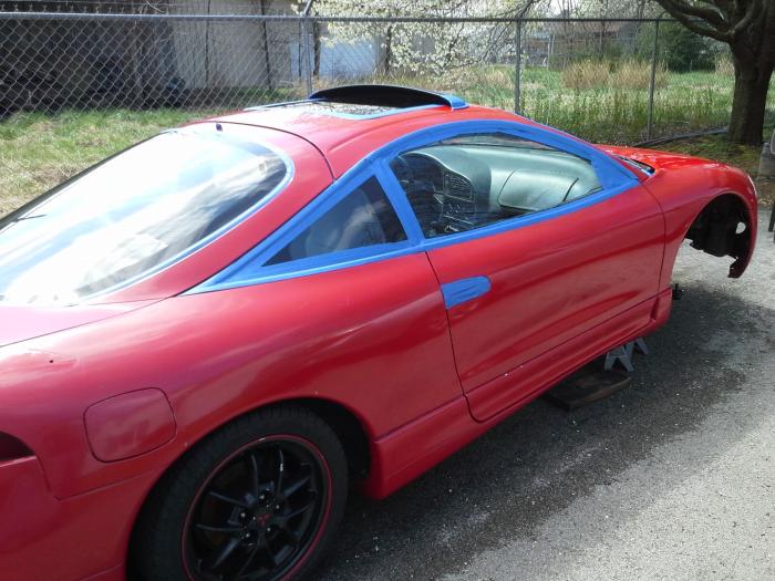

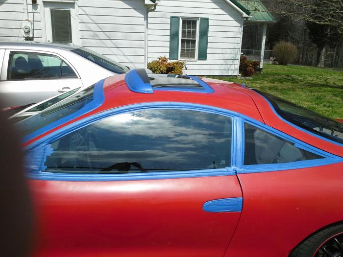

Well yesterday, I decided to start working on the badly faded paint, so when its all put back together she will be looking good. Stripped the body of all parts to get out the way. Spent a hour masking it up, than waited for the tree to put shade over the car.
Spent I believe 8 hours of determination to get it done. I used Meguiars ultimate compound, than ultimate polish, than finally wax. I used a good buffer that could hit 3,000 rpms (didn't go that high though) so I could cut the paint.
It turned out amazing, never had it shine like this. :rocks:
Now today I got to do all the black trim on it and clean the rims. Than when my bearings get in I can get it fixed than go cruising again. :cool:

Not catching a break. Had a shake at 55 MPH after tie still there than found out I had a bad lower ball joint. Got that fixed and aligned still had the shake. Took it back just to check the tires and make sure they were balanced and found the problem. I have bent the crap out of the rims. So now I have 3 bent rims. They balanced them as good as they can and the shaking is gone. Looks like I have to hunt down some 3g rims.

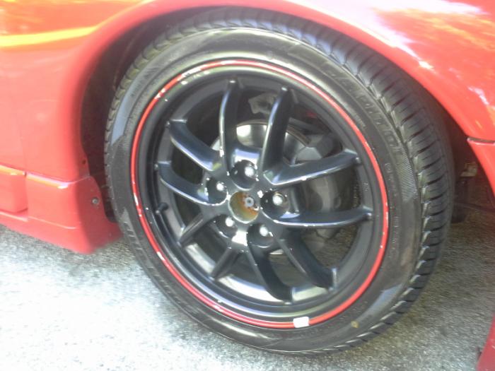

But I really was going to share this tire shine I seen on TV a month ago than finally read about it. I decided to try it cause it sounded to good to be true. Duplicolor makes it, it's a tire shine but it's a apartment paint. You spray it on like you would if you were painting anything else. It's weather proof and last for months. Here is my tire. Let's see how long it last but I already like it.
