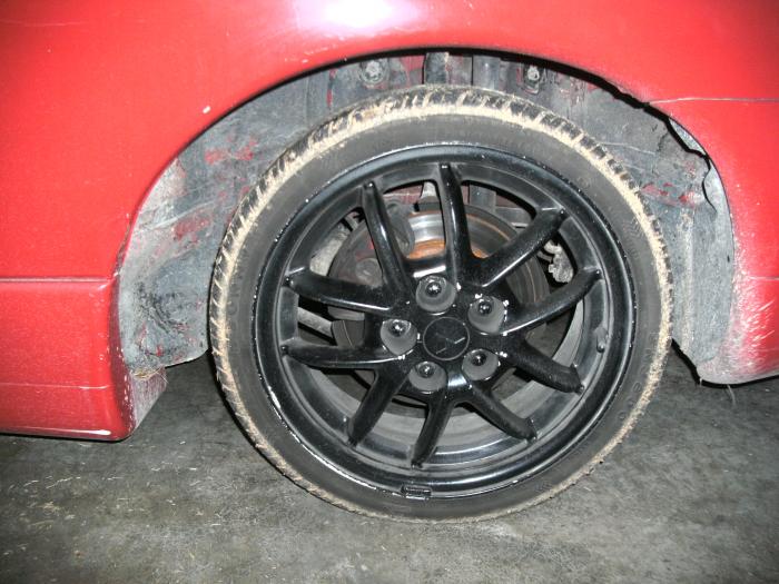

Rims Painting
Decided to paint the rims that where on it to make then look way better. Turned out better than I planned.
First I had to sand them smooth and get the chips out. Took about 10 hours to sand just one rim. :banghead: But it was well worth it. Mad the end product way better.
Than of course I used primmer. I used Rustoleum from Lowes. Worked great.
Then I painted the red lip and than painted the black and had to do it right so I painted the back also. I used Rustoleum red and black. The paint is holding up great. Doesn't chip easy.
My car was kicked outside and put on jack stands. She makes me feel like that is what she likes.:rolleyes:
Finally done and I love it.

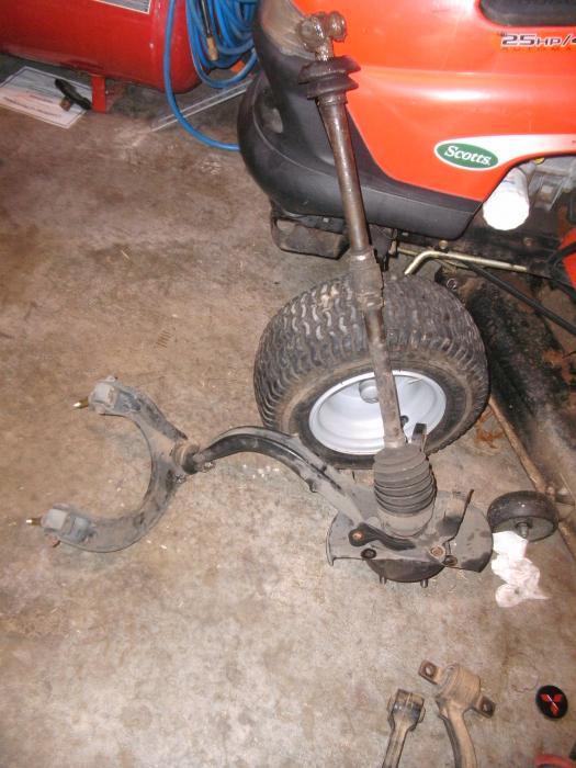

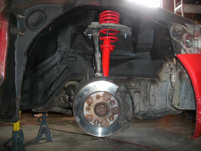

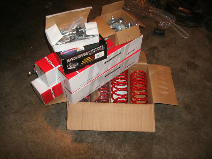

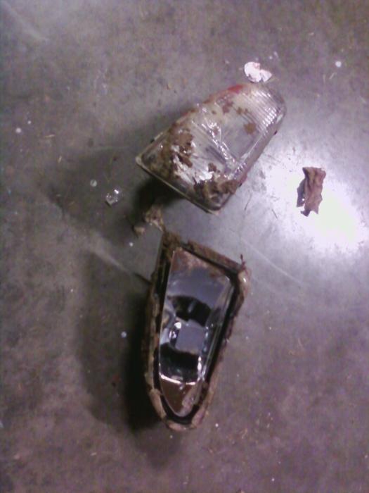

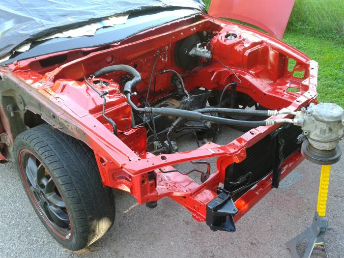

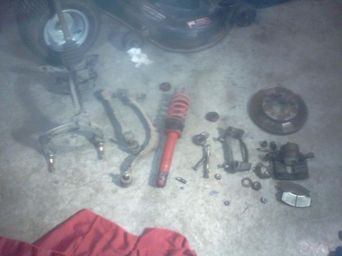

December of last year I spun out and went into a ditch backwards and the only damage was that it ripped the fog lights out. So then I decided it is time to fix the suspension. Because my car was not lowered right I had bad camber and within a year it ate up my new $450 tires. Hint why I spun out.
I went and ordered parts and as I was waiting I started taking her apart.
Out with the old.
YAY:hellyeah: New parts.
2" lowering springs.
1" shorter gas race shocks
Camber Kit (Don't get the cheap kit like I did. Here is why. http://www.dsmtuners.com/forums/hangout/437181-my-bad-day.html)

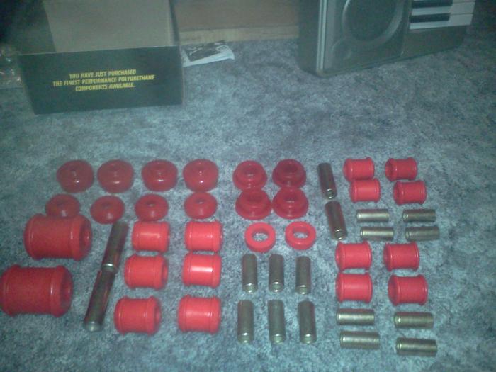

Polyurethane bushing kit.
The old and the new.
First I had to get the old bushing out which is harder than I planned. I had to take everything over to Gateway to get all the bearings pressed out. Cost $100 more than I planned.
Finally got them put in. :rocks:

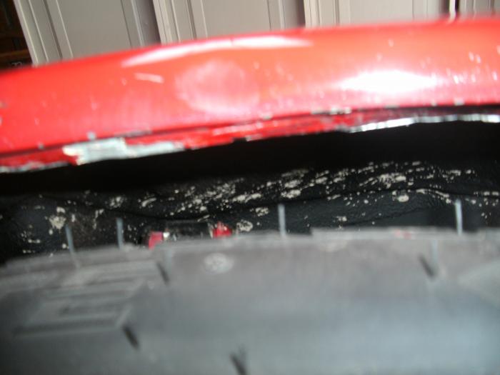

Had clearance issues. The front A-arms where hitting the frame but nothing a hammer couldn't fix.
Than in the back I had to roll my fenders with a nice hammer too. :D
Than the last thing was the shifter bushings. Still don't get how this my my shifter feel way different and better.
Now to see what it looks like on the ground. And get it to an alignment. Oh and tires. Another $450 for tires. So that's $900 in tires this car has seen from me and I have only had it for a year. :ohdamn:

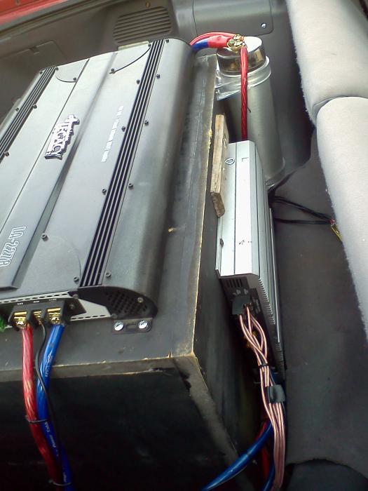

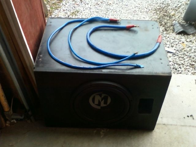

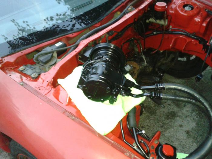

When I got the car. The audio system was trashed. The radio harness was hacked and no idea how anything worked. I could not go without music so I had to rig it to work till I could upgrade and fix. I had two switches I mounted under the radio. One to turn the radio on and the other to turn the amps on. The radio speaker hook ups didn't work so I had everything running off amps.
Well finally got around to it and finally installed a new radio and fixed everything. The right way.
A Pioneer Head Unit
A 12" PR Memphis Sub.
Two Eclipse Amps. :hellyeah:
Got the interior stripped out to run everything nice and tucked.
Had to drill 4 holes in the frame to get the power wire into the car.
The sub. :D

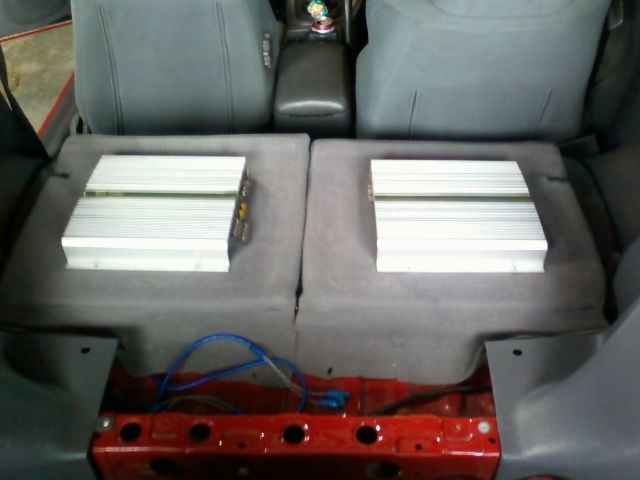

Mounted the amps to the back of the sets.
Had a problem with the seats up the amps hit the panels. Simple fit and looked good.
After that was out of the way it was time to mount the cap and the power and ground wires, And the rest.
Then it was time to get everything in. Looks nice and custom. Only thing left to change is the old box I build for my truck and get the second sub.

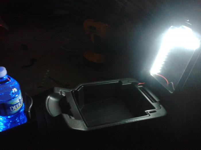

Dash LED conversion
First of all I want to thank WES_393 for taking before pictures for me because I forgot to. :ohdamn:
I got all the info I needed from these forms.
http://www.dsmtuners.com/forums/articles-exterior-interior/274519-how-light-gauge-cluster-leds.html
I got all my LEDs off ebay and I got way, way more than needed, top be on the safe side. It took about a month to do but that was messing with ideas and waiting for the LEDs to get here
Don't have much pictures up here of me putting it together because something is messed up but here are all the end results.
Go here to see more
http://www.dsmtuners.com/forums/hangout/438480-need-pictures-please.html

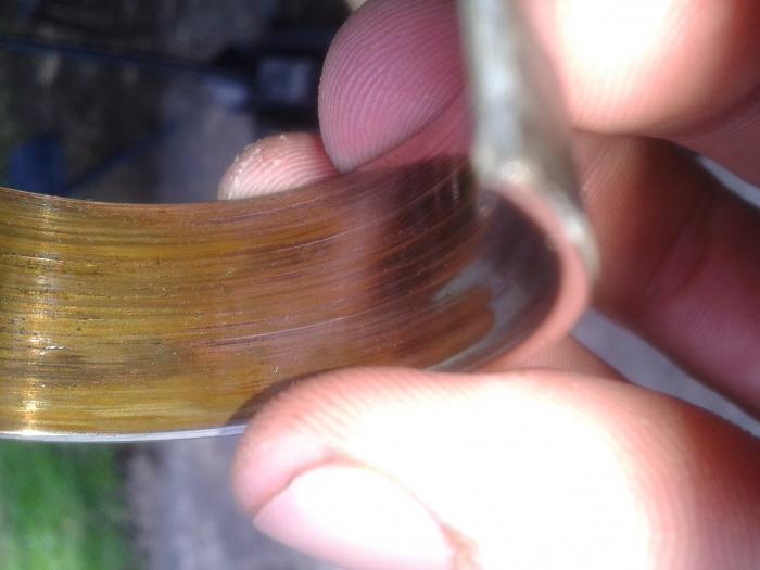

Went to visit my dad for two weeks got back home and took my car for a cruise. Half way through my cruise I spun two rod bearings. :cry: Great way to come back home when your completely broke and just spent your last $60 to fill your car up with gas. :ohdamn:
Got to working on getting the engine out and torn apart.

Rod bearing #2
Rod bearing #3

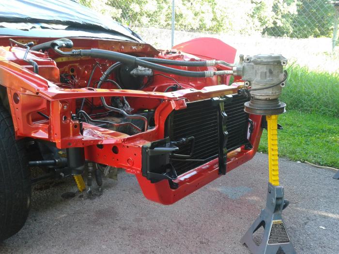

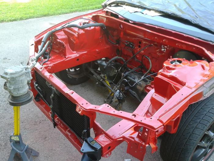

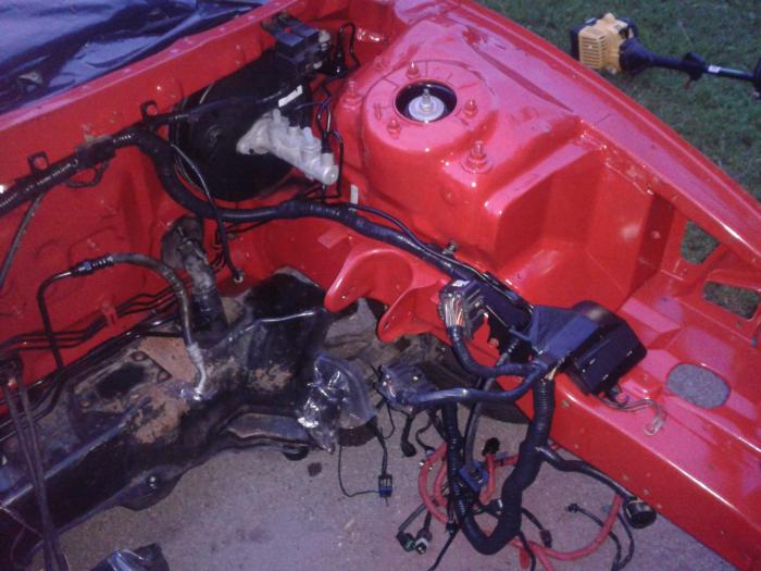

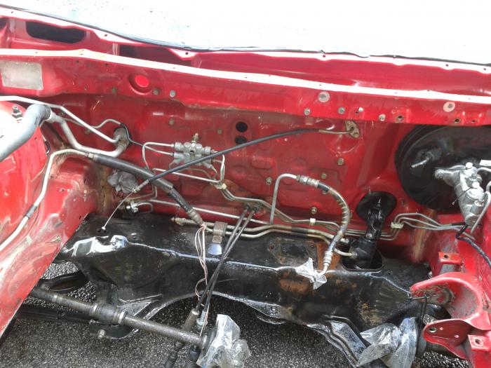

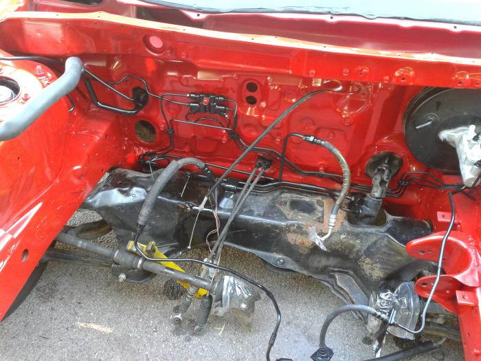

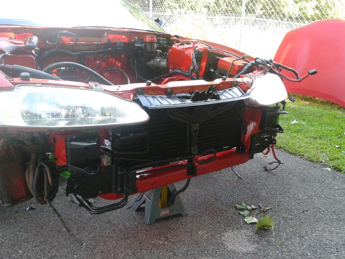

With my engine out and in the process of being rebuild. Just a stock rebuild. :cry:

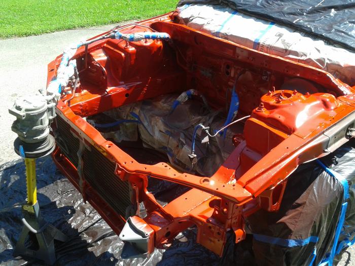

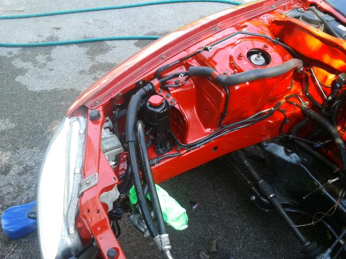

I decided to clean up the engine bay and repaint it.
I used heavy duty oven cleaner, Dollar General Brand. :hellyeah: It worked way better than I thought it would do.

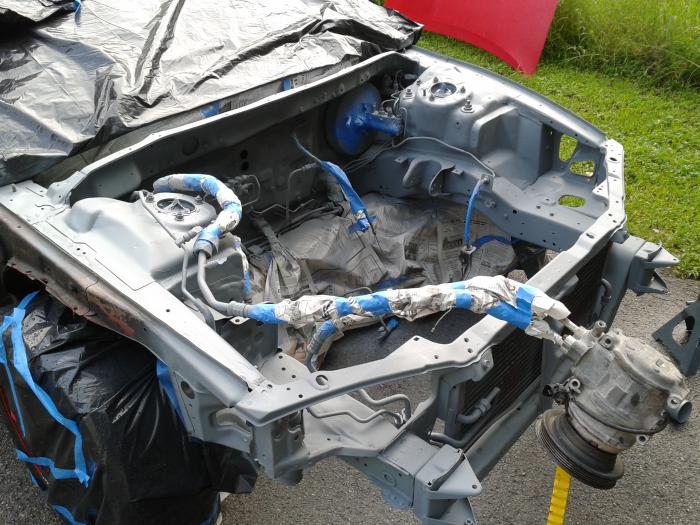

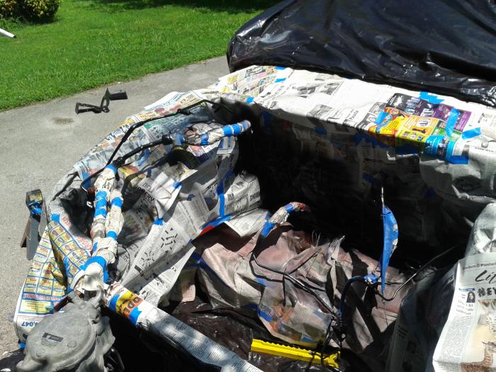

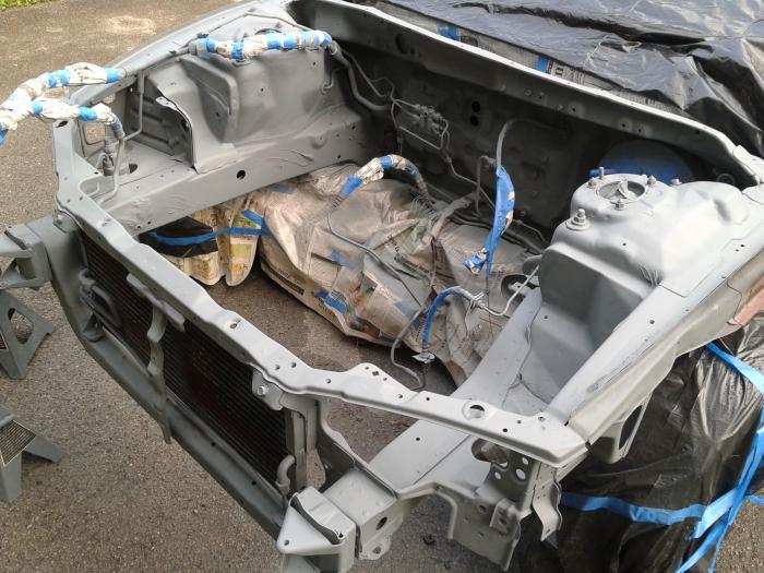

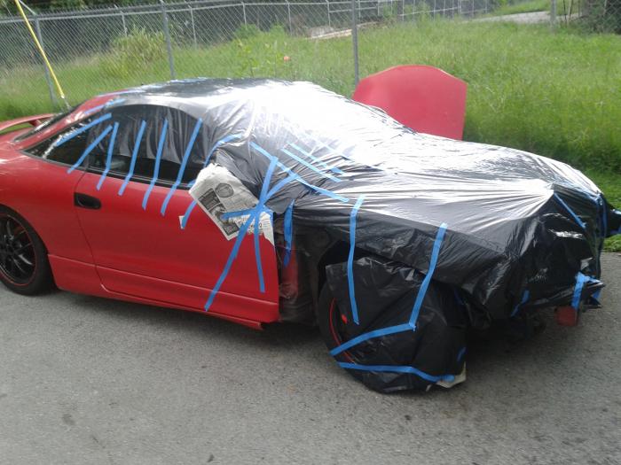

I let it dry over night and got right to masking and taping it off. Once I grabbed a can I heard thunder. Hit panic mode and got it cover two minutes before it started pouring down like crazy.:banghead:
After it stopped raining for half an hour I uncovered and got right to spraying primer.
I gave that the time to dry and it was time for red.

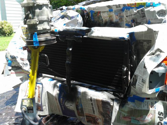

Than it was time to mask of for the satin black.
Ripped off the paper like I was unwrapping a Christmas gift.
Got some of the lines painted on bolted on and one of the harnesses. Waiting on other stuff to dry.

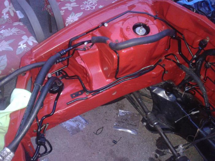

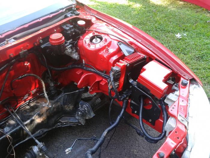

Update On Bay Clean
Got the fuse box and computer in and the everything thing else just waiting on my motor.

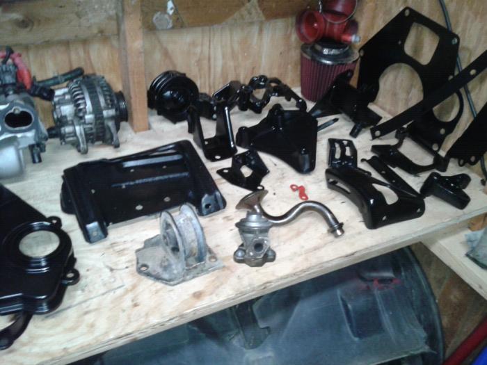

Well really haven't got much done on the rebuild still waiting for some more money. Hopefully I'll be able to get my crank turned and block honed. Then get everything cleaned.

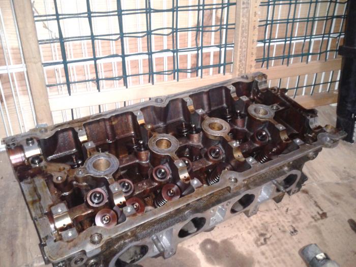

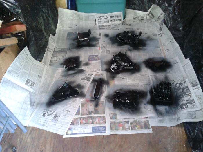

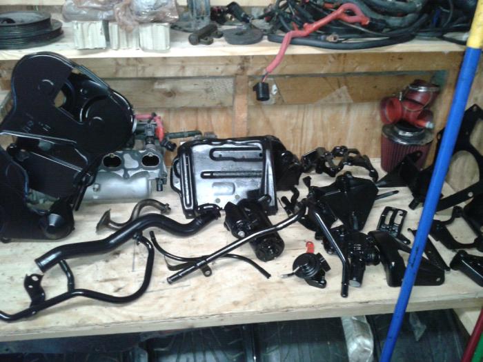

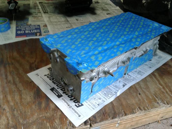

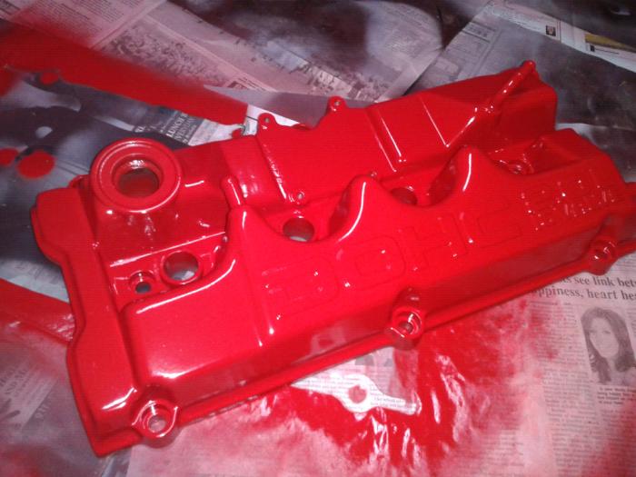

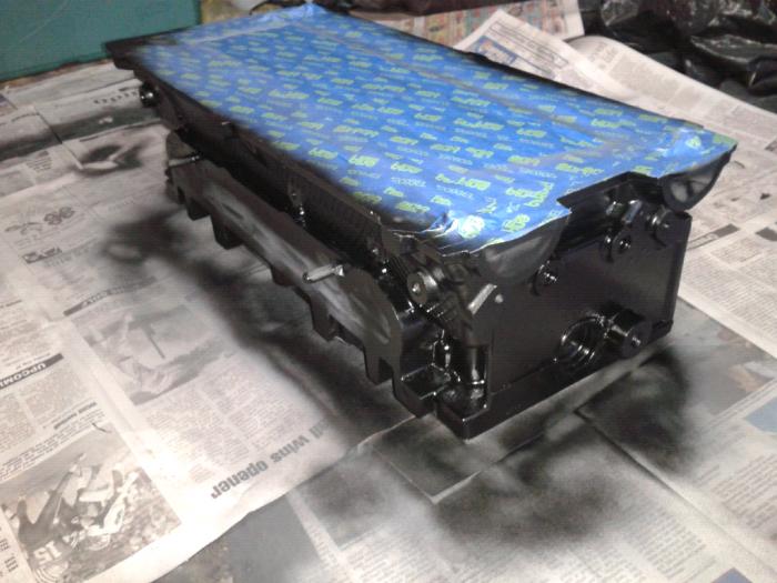

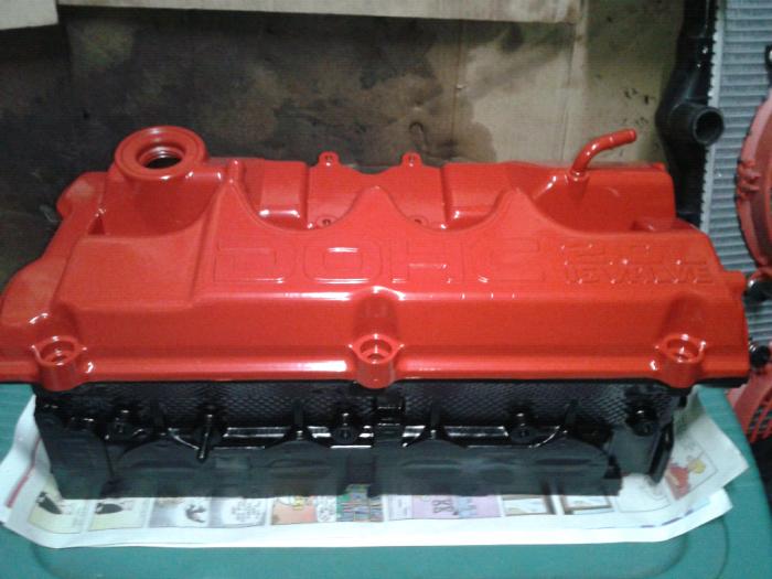

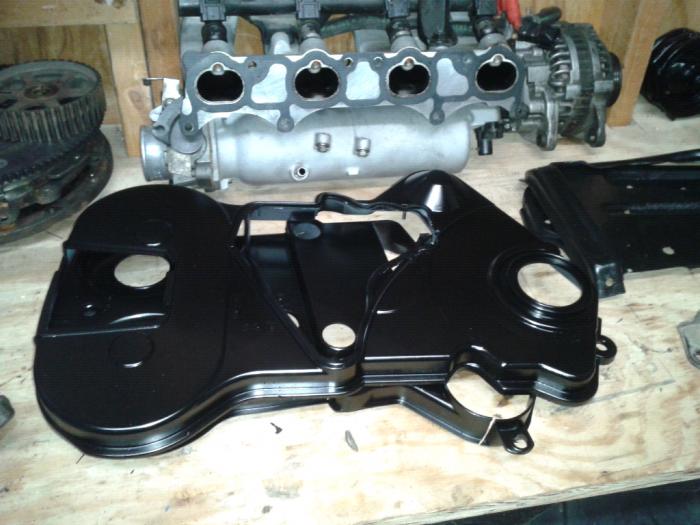

Have been painting everything that needs high heat paint for the motor.

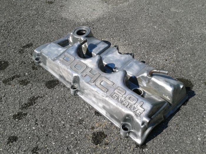

The valve cover was so badly painted and chipped I had to completely strip the paint off and clean it. Then got it painted.
It costs nothing to wire tuck. I bought a multi spool of different gauge wire from harbor freight for 40, sodder for 12 and heat shrink and electrical tape. about 60 bucks total. Made the bay so much cleaner.
The only problem I see that I might not like is that the driver side will be to clutter free and the passenger side is still cluttered because of the power steering, a/c, and the vacuum and evap system. That would cause it not to look right. I've been wanting to do a wire tuck but that's what is stopping me. I've been thinking about just putting my intake filter over there and making an air box.

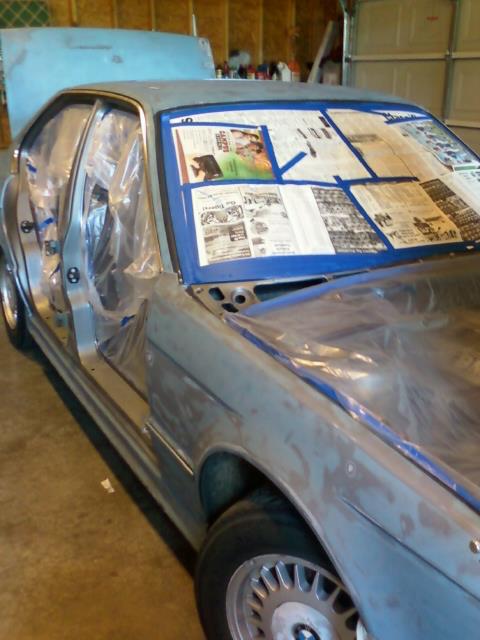

Just found some pictures on Facebook of the BMW.
Before
Ready for primer.
And Done.

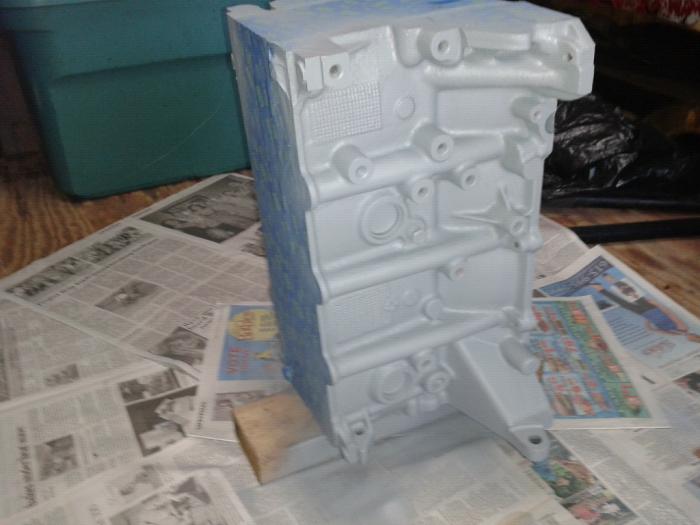

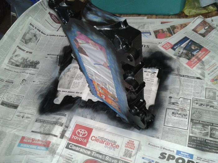

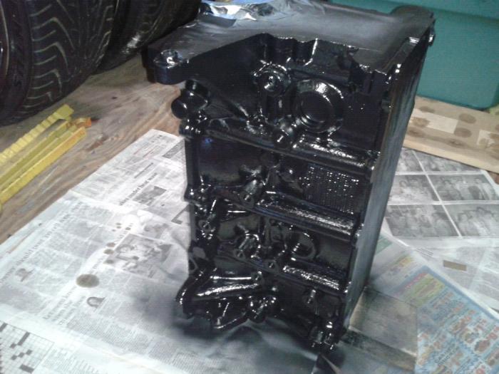

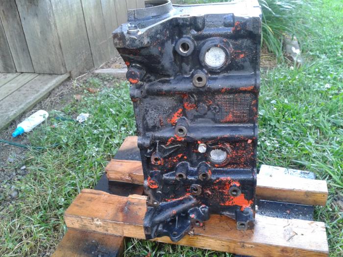

Finally got to do a little with the block. Got it honed and cleaned. Ready for me to throw new parts at her. But first I couldn't have the engine bay all fresh and painted, I had to paint the block.
I want to peel the tape off but I decided to keep it on there and so nothing can get sown in the block so it can stay clean. I'm sure it's going to be sitting in the plastic container for awhile. :-(

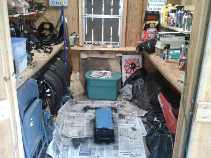

Got more done. Got everything painted now. Got the carbon off the head and cleaned it up. Had to get a spark plug thread chaser because d.a. previous owner had screwed something up and you couldn't really tighten up the spark plugs because they had that feel like they where about to strip. Feel right now.
My little work shop. :)

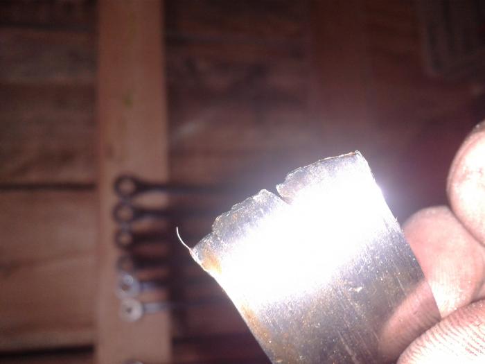

Still waiting to get my crank turned. Ran into a problem. We can't get the crank sprocket off to get the oil pump off. Broke and bent the bolts for the puller. Trying to figure out how to get that off.
