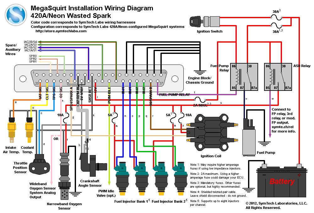

I am not sure what the previous owner had going on there LOL. A little weird but installing ms3 is pretty straight forward and not to bad. you can wire it in as a piggy back alongside with your factory ecu, but they cannot share the same sensors. like coolant temp, etc. I am wiring mine as a full standalone. As far as getting a base tune to run your car there are a lot of base files form symtech that can get you started. ill see if I can find them.
When you put ms in you splice into your ecu harness. then you directly wire each indivisual wire like replacing a stereo? and then you run a usb to a computer with a program and you program it and such?
No... MS does not splice into the factory ECU wiring. You will remove the OEM wires with the ones you want MS to control. Then you just roll up or cut the oem wire and enjoy a CEL :)
Time out... if you do a stand alone system to completley replace your factory ecu do you take out all of the fireing sensors like everything and you buy new sensors or what happens here
Not everything needs a new sensor, some you can use with the MS (TPS, CPS, and so forth). Now it does need different sensors for like the coolant temp and the intake air temp. Other then that, most things for a standalone unit you just splice wires together like the photo shows. Image is per symtech labs -
I think i understand now like you dont change the wires on like your cam positioning sensor because you already have it and the sensors you do put in the engine doesnt have them right? or is is like that
What grothe says LOL. He's giving you the right info :thumb: The install is pretty easy I am working on a clearer write up right now for a full standalone install.
