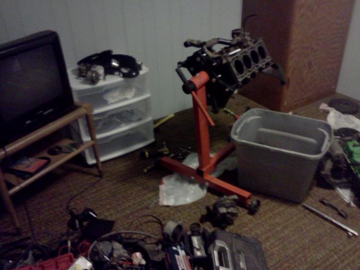

Like I said if anyone wants to help me learn more about my motor I'm perfectly fine I'm not getting pissed ### I don't give a shit about what you think about my car I'm gonna take the motor out and stick it in my base ment and have a machine shop look at my stuff and replace my rods and maybe my pistons i don't know the guy that did my wiring before did a half ass job so I need figure it out, but my plans are to build my engine up on a stand with taxes and me and my friend are going to re paint it to my best ability, and get my transmition taken out I did all my torque specs and everything on the motor using a overhauled service manual I found on google. And move on with my project I'm not being a #ick when I said I will take help if you would want to inbox me if you want to call me I would appreciate it and did not mean to get pissed about all he last post I'm sorry. I will post pics with what I want to do with my motor and am more than willing to learn more. Thank you.

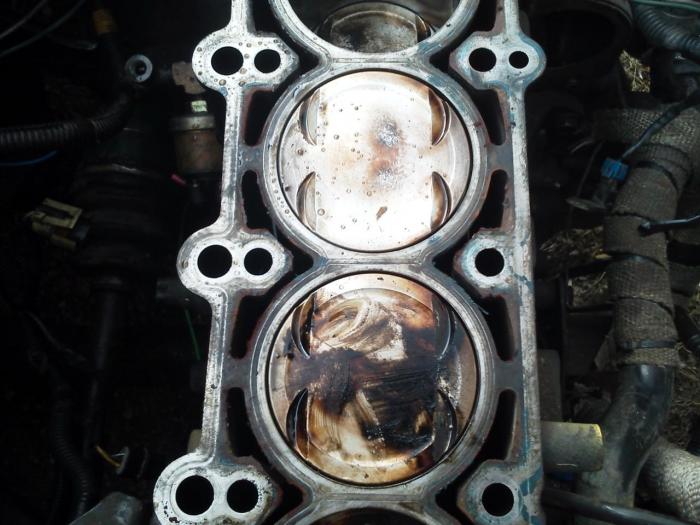

Oil was on my pistons and oil was black when I drained it only ran it for 40 mins max
See oil! Lol
Someone said there burnt but I need to lap them or replace them

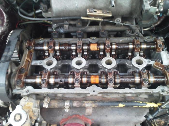

the lsd wont help you at all you have a 420A motor. look at your head looks like one of your spark plug holes is leaking oil into your pistons which might be a valve cover issue.. also your block if filthy looks like there might be oil on the block to.. pay more attention to the internals of your motor then looking at your extra add on.. you will need more work on your block pistons crank and make sure you pay attention to your cylinder head.. you want those built first before anything...

Have your rods checked at a machine shop, if they are truly eagle rods you might get away with those. But if you over bore you NEED new pistons, no way around it. So you'll have to sell your others.

Before cleaning you pistons, when you have the money, take your bottom end (block, rods, pistons and crank) to get them check, ask "Can i use this pistons or my walls are to scratched and i need to buy .20 Pistons and rings for a .20? The motor was rebuild before so are this pistons .20 or standard? After that you can clean your pistons, carburetor cleaner works good.
