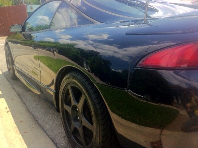

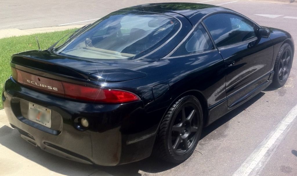

I can't say it's a fresh paint job, mostly because it's not paint. I'll elaborate later. First, since we're on the topic of paint, here's a couple pictures of what the factory paint still looks like. Keep in mind this is after a GOOD wax job.
Also, don't mind the dent.

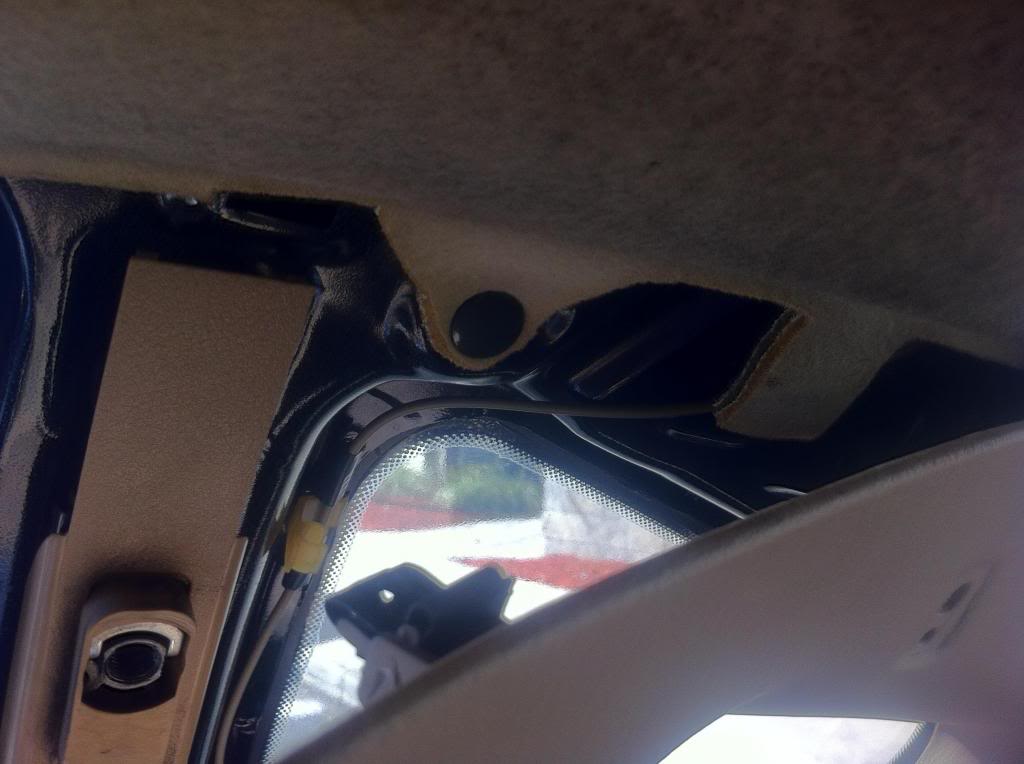

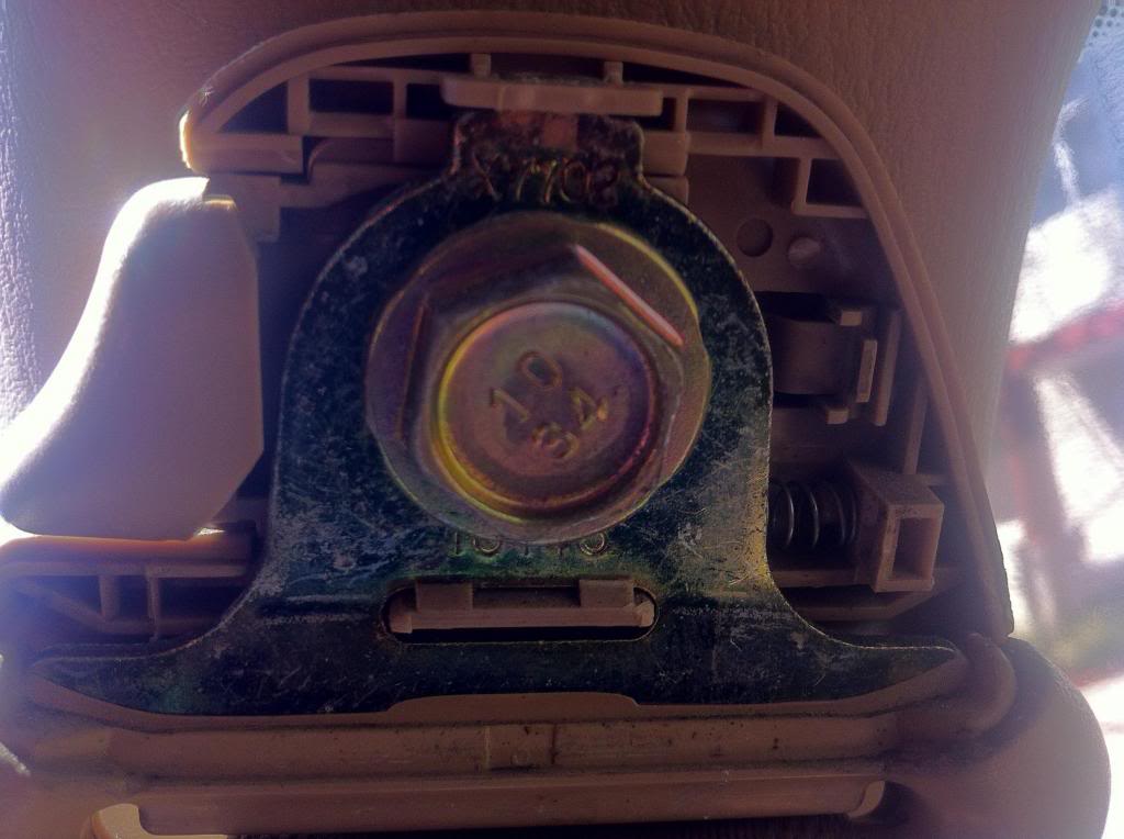

I also managed to find some pictures of the process for removing the rear panels in order to get to the rear speakers and also to remove the headliner. This is more-so for those who don't already know or couldn't figure it out.
First pop the cover off of the seatbelt guide and remove this bolt.
This next step is only for removing the headliner. First remove these few screws. Then locate and remove the small black push clip. They are on both sides.

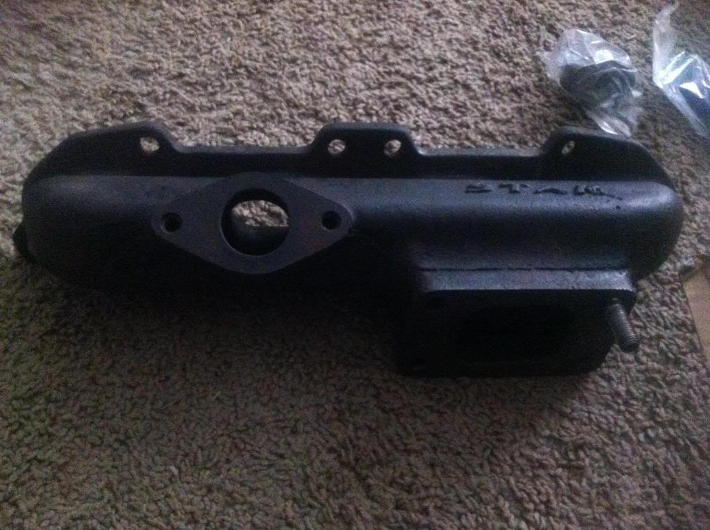

Star Turbo Manifold

It's somewhat old tech as far as the wastegate is concerned, but the setup would surely make the 275 - 300 hp I was looking for. It also came with a downpipe, gauges, gauge pod bezel, hardware, and few other parts. Sweet, now all I need is an intercooler, injectors, bottom end, and a few misc parts and I'm good to go. That is, until I decided to scrap the build....
Instead, I decided I'd find myself a 4g63 and do things the right way. Sold all the parts and moved on.

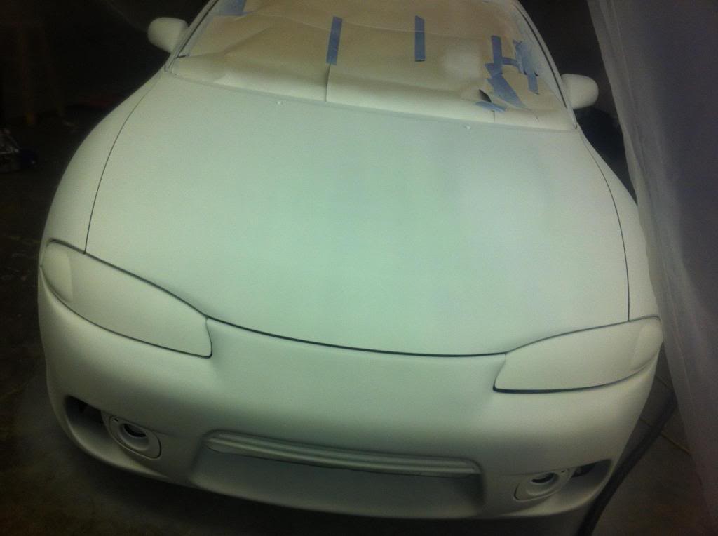

Then I started reading a bunch of threads about PlastiDip. After a bunch of research I decided I'd PlastiDip my entire car, or at least try it out. Not only would this protect my paint from the sun for a short period, but it's also temporary and completely removable. So I built a booth from scratch, and unfortunately didn't take any pictures. Either way it was nothing to run home about. The previous month I actually PlastiDip'd a friends civic, which turned out really well. So I went ahead and grabbed 4 gallons of white and sprayed away.
The end result came out decent. I say this because the booth began to sag a bit up top which caused the booth to become constrained. This meant that all the little PlastiDip particles in the air fell onto the car instead of being sucked through the vent fan. The worst was on the hood, which actually wasn't THAT bad, and it was only noticeable upclose or if you touched it. It was mostly just a textured feeling. Otherwise I was happy with how the matte white came out.
In the booth.
The day after.

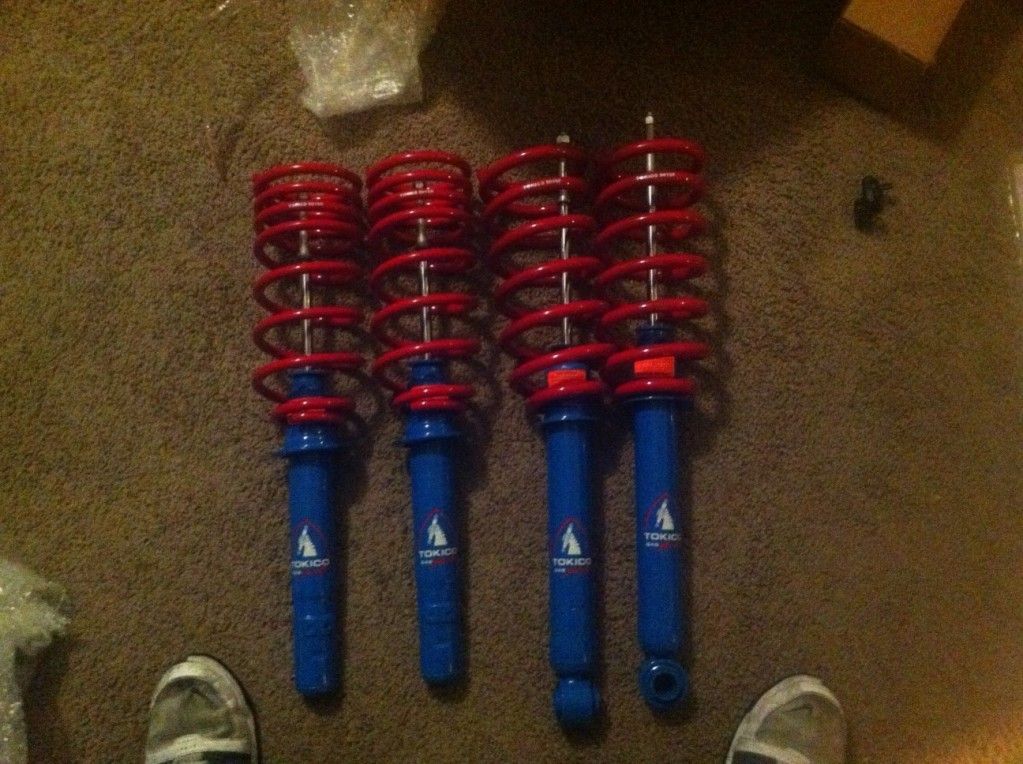

We checked out the car and decided it was ready for its first upgrade.
It was Christmas in April.
Not only did these bad boys get rid of the clunk but it improved the drive and feel of the car, not to mention the look.
They provided great handling with a 1.5" drop which was great, but it still wasn't enough.

Question for you? Did you get a Camber Kit for that Tokico kit?
Actually no, the fronts ended up sitting on factory camber. The rears were a little different. I'm pretty sure there's a thread on here on how to do this, but you have to buy longer bolts and some washers to use as spacers for the upper control arms. Basically what this does is push the top of the control arms out, thus correcting the camber based on how many washers are used. The thread will tell you how many to use since I don't remember the exact number. I haven't had any weird noises, driving conditions, etc at all with this setup and I believe it to be safe. If I'm weighed down enough or take a corner too hard my tires will rub on the fender in the rear, so I do still need to roll my fenders to avoid that. I still take it to have alignments done and they are still able to correct it enough to true up the camber with this setup, however they are limited without a camber kit.
