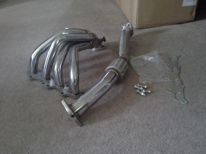

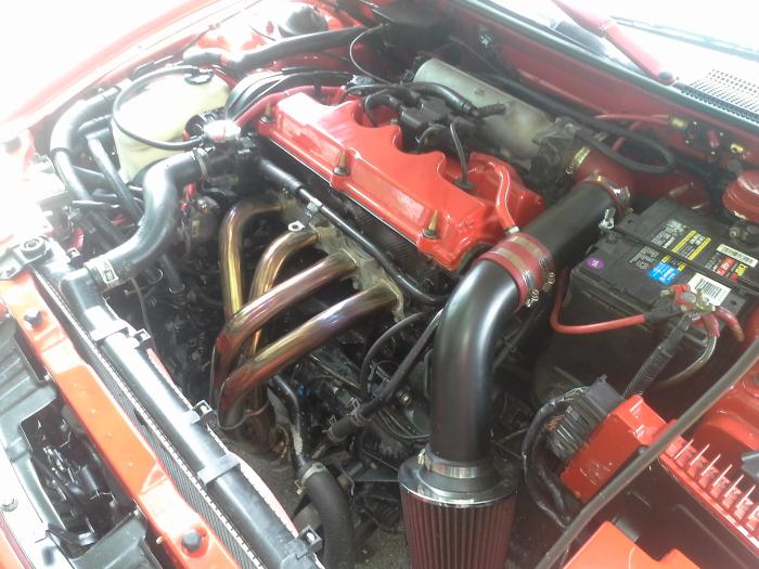

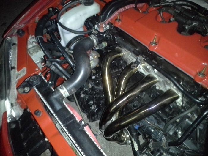

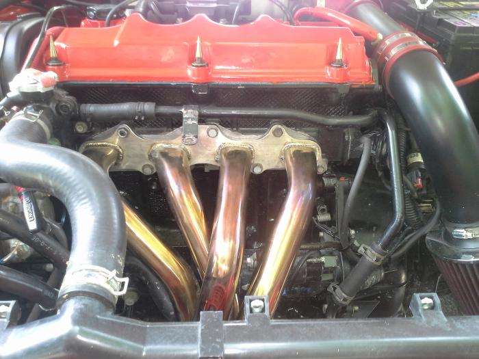

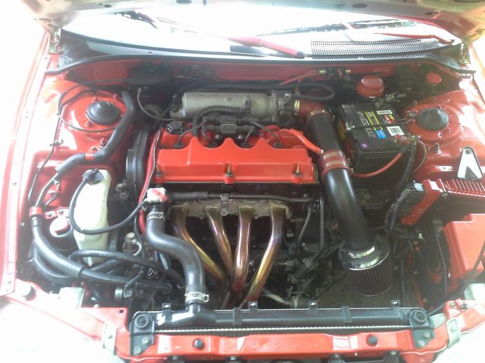

FINALLY found and got me a header. I didn't want any of the slip joint headers that I see everywhere. I wanted a flange one. Seen one for little less than $200 and was saving. Then I came across this one for $75, risk it and got it. To me it seems like a good quality one and fit perfect.
Planned on it turning bronze because I didn't want the chrome/polished look in my bay. Turned out great.

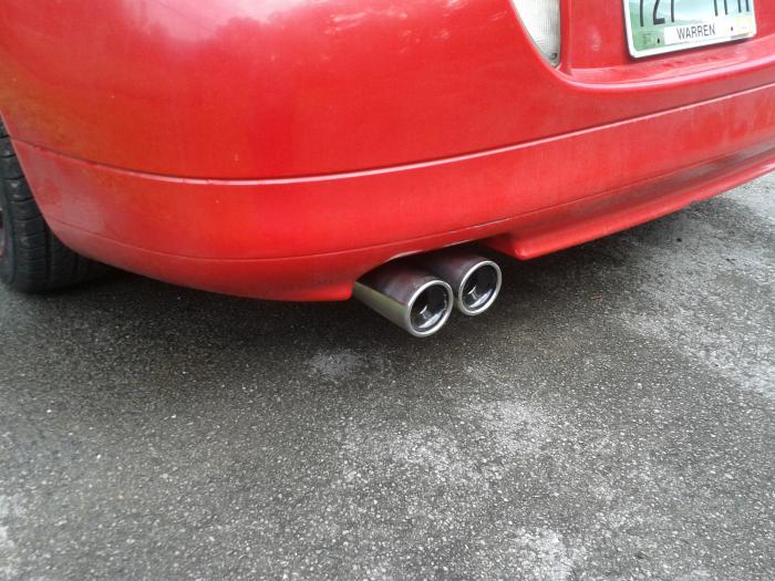

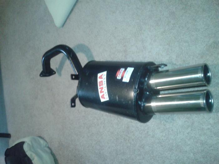

With that heading fixing all my exhaust leaks from the flex pipe, I was finally able to hear my muffler I got for $150 a year ago. Video soon. It's not loud or ricey got a good sound. Also got rid of the 4 inch tip I hated.
Eclipse 420a Headers, ANSA Sport Muffler - YouTube

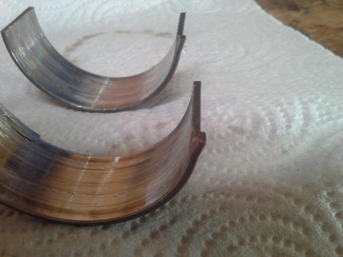

Well ready to drive my car off a cliff on fire. On my way to my grandma's house, 20 minute drive spun a rod bearing again. Not even 5,000 miles on the motor. Just feel like killing the car.

I don't mean to insult you, but what did you do to break in the motor after the rebuild? I ask because, and correct me if im wrong, you roasted a front pair of tires within that 5k miles.
Also, how often did u change the oil in that 5k? Personally I like to go on a 25, 100, 500, 1000, 3K after a rebuild. It is a lot of oil changes in a short period of time, but this way you can make sure you get out any small shavings from those new parts that are seating together before the shavings do things like grab to rod and main bearings.
I agree with the oil changes. I do the same it's expensive but cheaper than the possible alternative.
Also I am curious on how you broke the motor in as well. Sorry to hear about the bad luck!
The front tires where bad because of a bad alignment. I did a lot of oil changes. I did 20 miles than 70, 500, 1500, 3000, and I was about to do one this weekend. My car is 250 mile to hit 5000 on the rebuild
As of breaking it in I know this is controversial topic and some will say I was right and some will say I was wrong. But I followed an article I was show on here that made since to me. I did read more than one way.
One I started it up I went straight on a cruise. I let it warm up for a few miles to the highway. I did acceleration and decelerating in 1st gear and 2nd gear. For the first 20 miles then drove it back to the house and changed the oil after I let it cool down. Than I did normal driving since than.

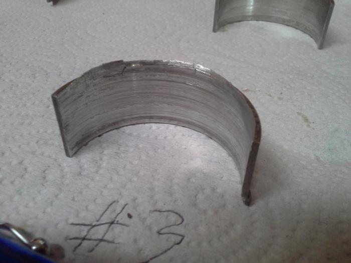

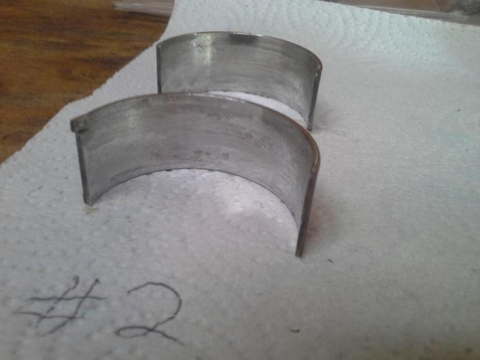

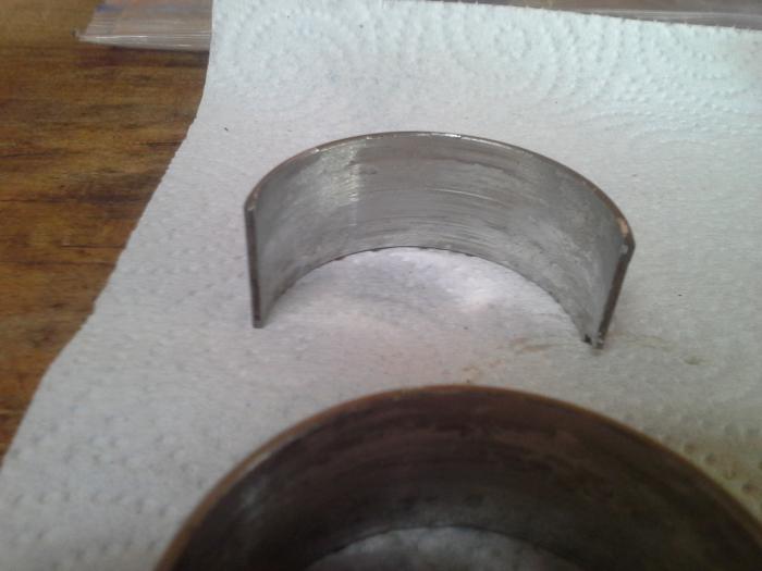

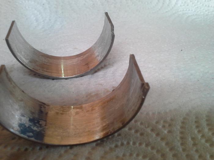

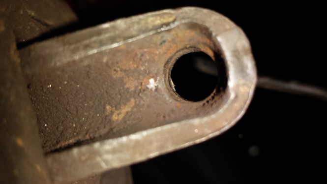

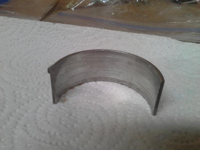

Well when and pulled the oil pan and got to look at my rod bearings. It's very clear the cause, Oil starvation. But the confusing part is my car has never been low on oil, I checked it constantly, the light never came on, and my lifters never started ticking, which I've been told is the first sign of low oil. :confused:
#1 and #4 look the exact same as #2, and #3 of course was the one knocking to come out the block.
Finally got the email back from King. It was cause due to oil starvation. I have no idea how always was full of oil.

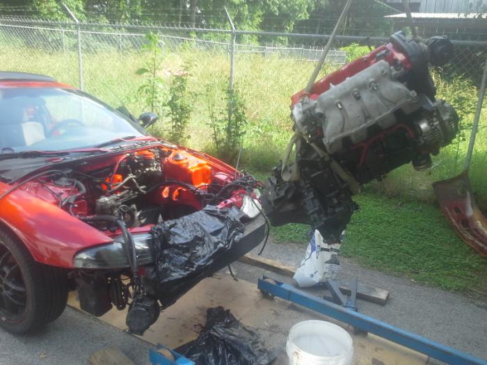

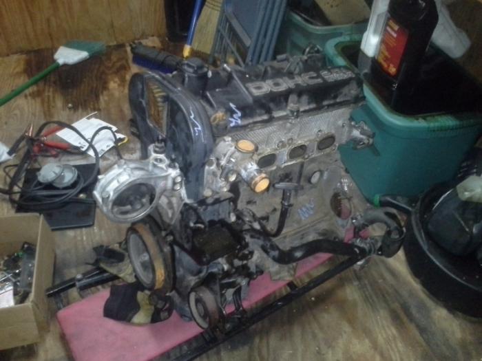

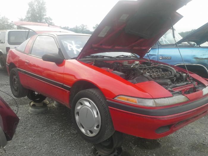

Oh well went to a pull a part today and got me another engine that had 127000 miles on it. Car was there because it was wrecked. No leaks everything looked great on it. Spun freely just like my engine did. Could feel the compression. Oil that was left in it looked good. Also had a new gates timing belt.
Hopefully tomorrow I will have the engines switched out.

Well I guess its about time to post an update about my car. Not to much has gone on pulled my motor and got the junkyard motor put into my car. But for those of you that seen my post that motor only lasted for 4,000 miles and it spun a rod bearing. Fed up with this I just slapped a new bearing into it and called it a day.

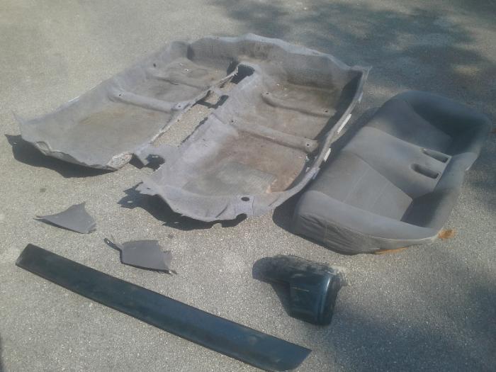

I decided to try to fix so things that have been bothering me since I got the car. Trip to the pick n pull and got a few things.

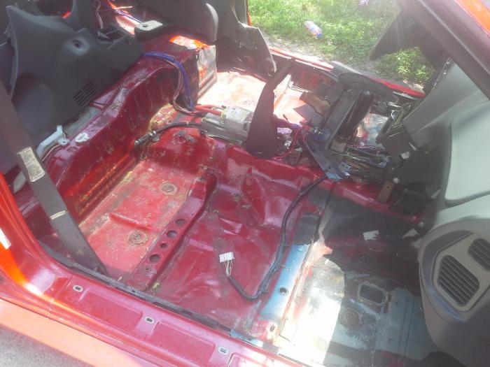

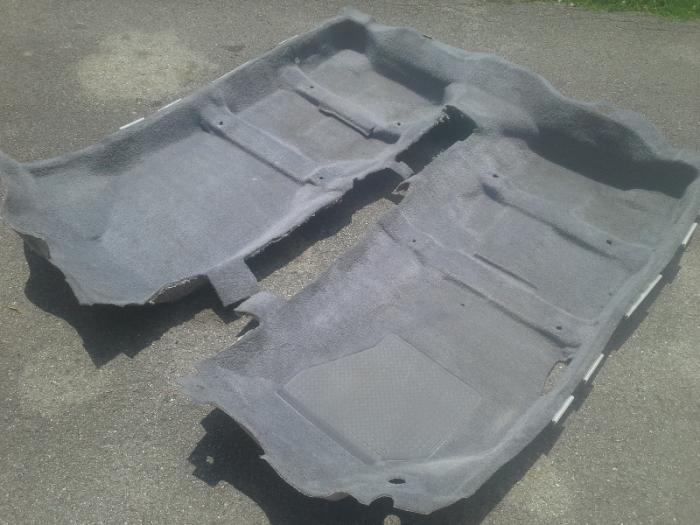

Finally for rid of seeing the old lovely medal floor I've had forever after cleaning the carpet.

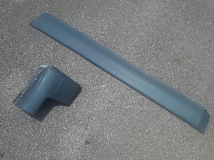

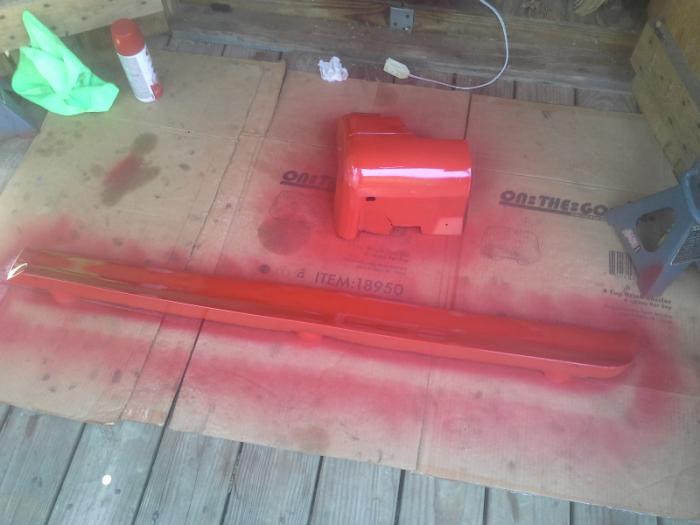

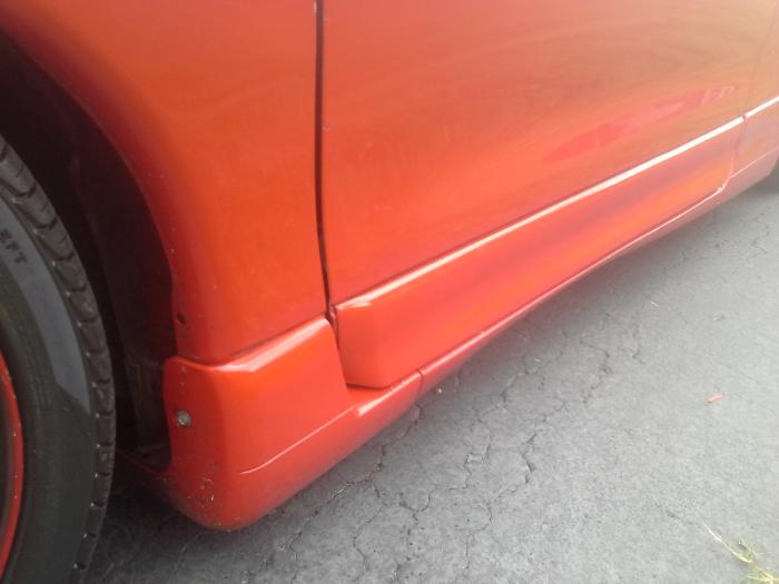

Also was able to finally get my driver side ground effect cap and door piece. It was green so sanding and paint was in the works. I just used some red spray paint from Walmart I had laying around. Turned out to not be to bad off in the shade and hard to notice its different but looks way better than missing and broken parts like before.

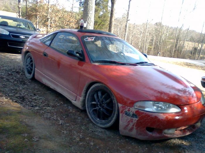

Got to have fun with my car, finally. was flying down gravel roads for lug trucking around 45 mph :hellyeah: car drove great, was a lot better ride comfort than pavement. WTF There was also a dirt trail we took. Then finally when we were heading back to the house the damn intake fell off and I ran over it. :ohdamn: With some quick thinking my friend took his sock off and now have a better intake, higher flow :thumb:. Time to get another intake I guess.
Also, now that I live in a city, my car has to pass emissions so seeing how either my cat or rear o2 sensor was bad just made a simulator to help me pass till I get money to completely fix it the right way.

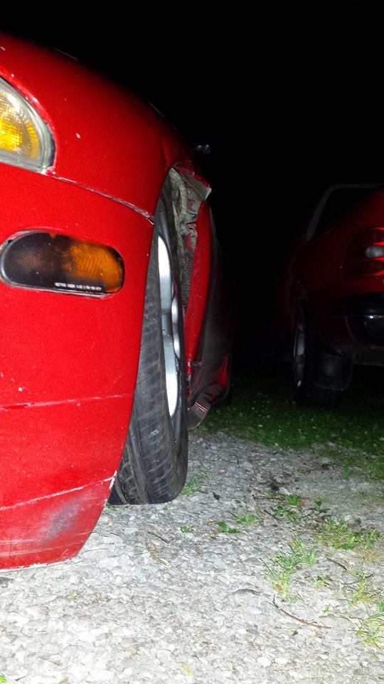

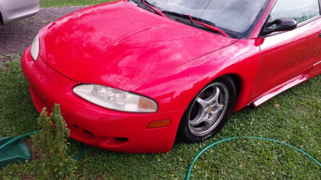

Lol at the sock. You need a rear camber kit!
Sadly I have a rear camber kit maxed out with 3 thick washers and longer bolts and it is still at -2. I am saving up because going to do another suspension overhaul. So, hopefully I can fix the camber because I will be going lower. :hellyeah:

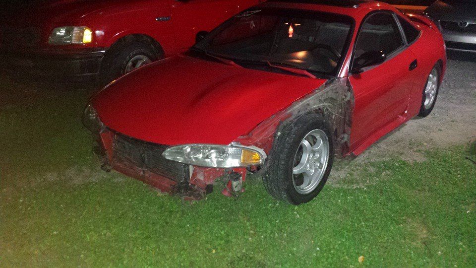

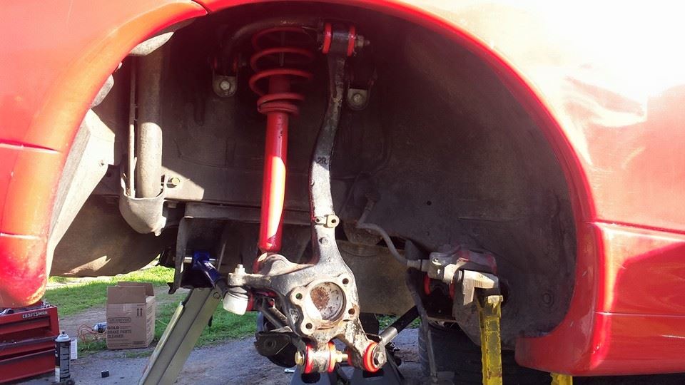

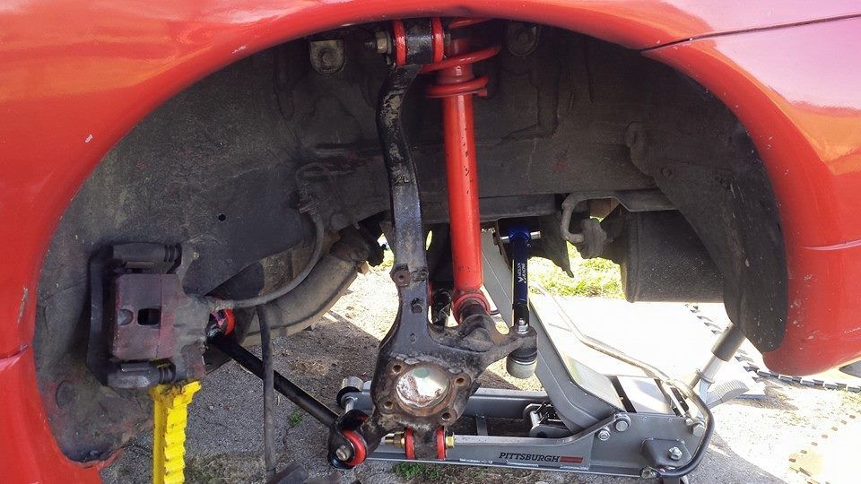

Well been waiting to do something to my car for a while with this move and finding a job has put a lot on hold. But finally getting back on my feet then Saturday night my ball joint went out at 45 mph a mile away from home. Cost $175 to get it home. The tow company was retarded and busted my from bumper trying to wedge the well locks under the car which was pointless how are you going to pull my car by the wheels when the wheel is no longer attached to the car. It finally hit them they had a perfectly good bed to put it on.

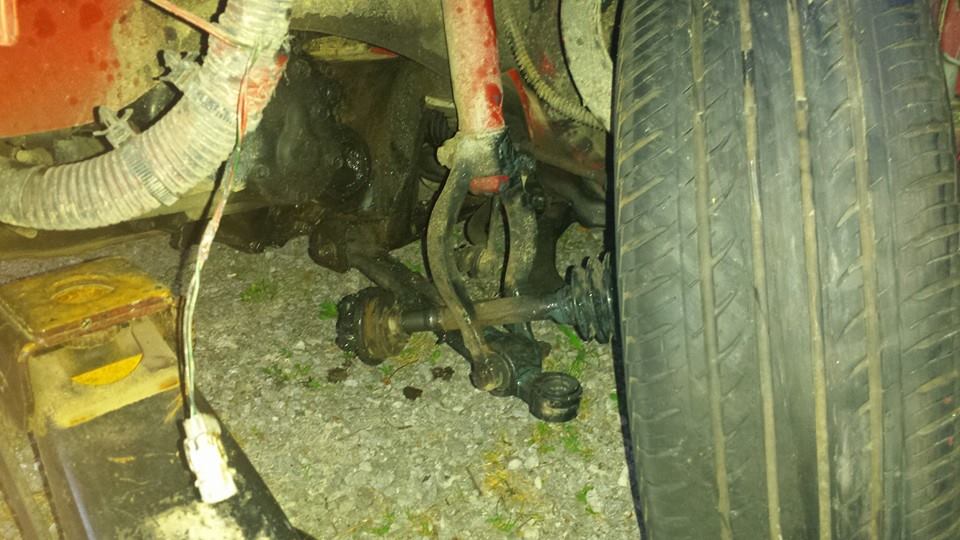

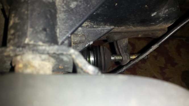

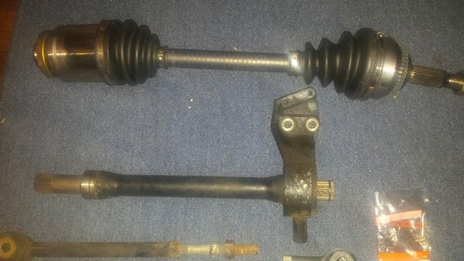

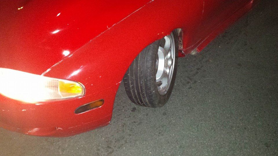

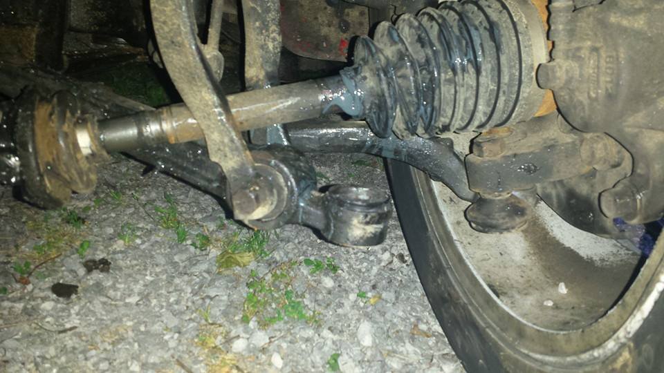

Got it jacked up to see what all is broke just the ball joint and cv axle.

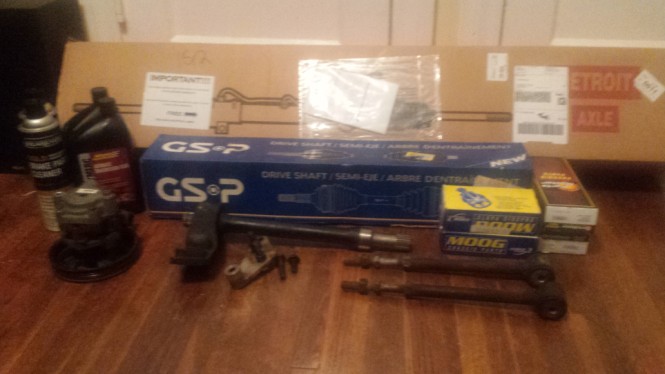

Got both lateral arms for both sides to replace the cheap ones with Moog and a new cv axle for only $104, Love my job ha.

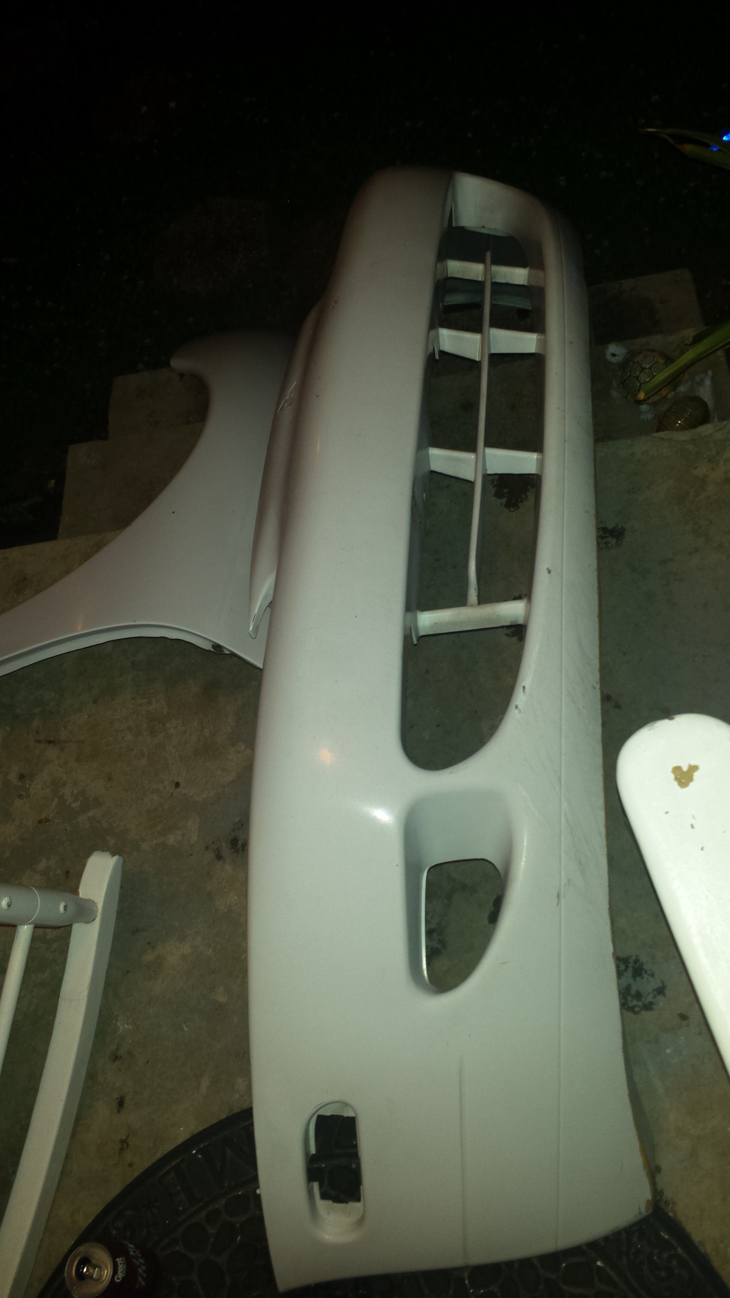

Got it took a part and back together in less than an hour. Now I need a new bumper and finder.

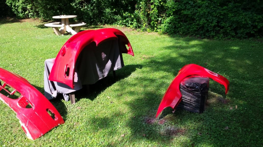

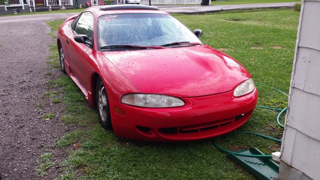

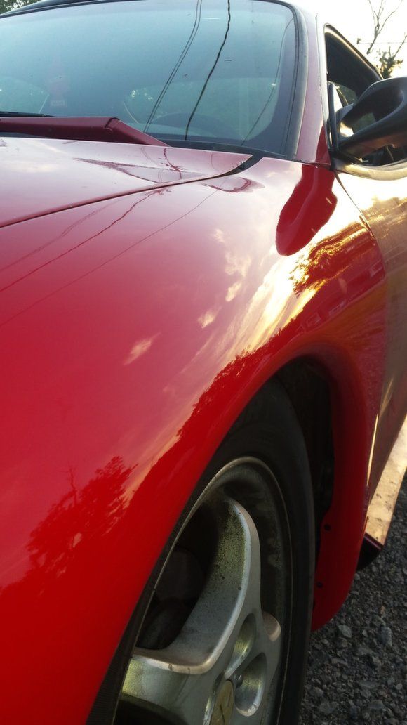

Finally got me a bumper and fender. Got it all painted and mounted color is a little brighter than the rest of the car but close enough for using spray paint.

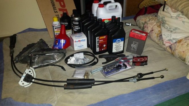

Not a lot has really happened but getting this up to date. Had a odd thing happen to me. My slave cylinder rod decided it was going to go through my clutch fork. Did a quick fix to get me home then got all the parts I needed.
Got a few other things to fix other issues.

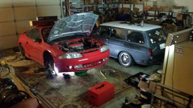

Next it was time for a repair and an upgrade. My rack and pinion was bad so it was getting replaced. I also decided to do the equal length driveshaft. Got everything together and got the mount that was needed.

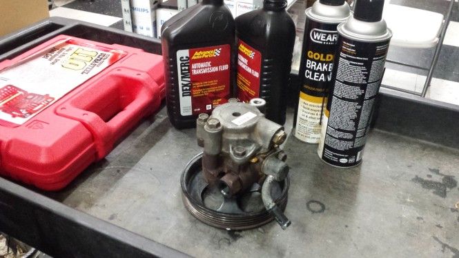

Before I could get started I rebuilt my power steering pump at work.
Was time to get working. Yes we are fancy working on a nice rug haha.

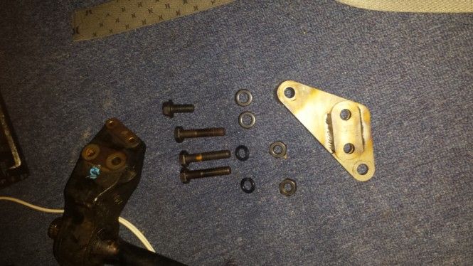

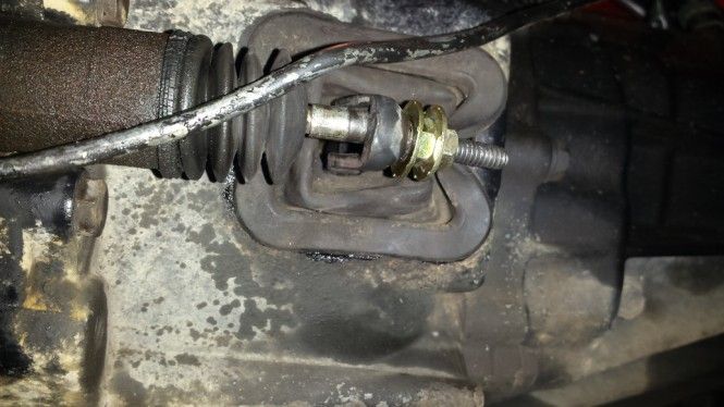

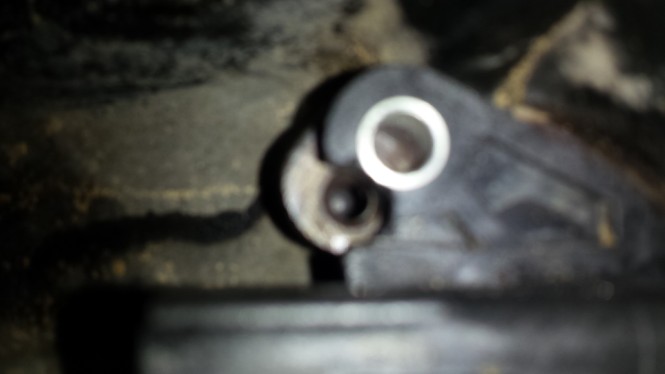

The only thing you have to fix is the Crankshaft sensor. It is in the way of the bracket for the shaft so you have to cut a groove to twist it. Always fun to cut on a $120 sensor.
Got it all put together and I will say that equal length drive shaft will make a difference. My suspension is still messed up but traction wise you can tell both tires pull. In my neighborhood there is a stop sign on a hill and if it rains I always spin taking off and always was the passenger side tire. (And no I am not trying to spin or show off) After the new set up at the stop sign it spins both. Same tires nothing changed but will really test it this summer when I autocross and compare to it the past.

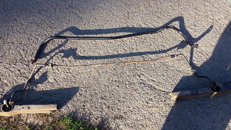

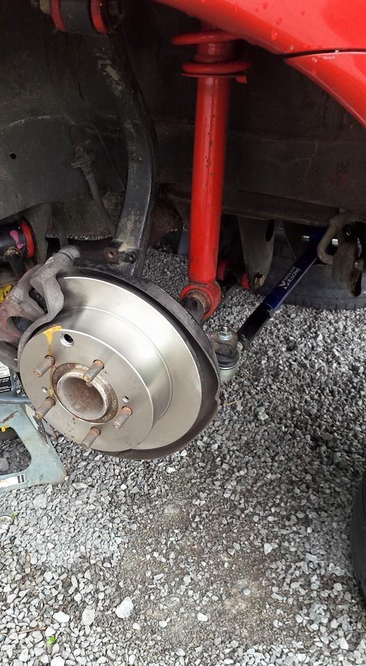

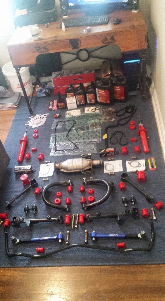

Still have a lot more to do to my car. Doing the 3g control arms in the back and sway bar. Replacing my front shocks with the same ones I had for now till I get new for front and back. Also doing routine maintenance on the poly bushing. (joke) But to anyone just in case you didn't know get the 2 piece poly bushing set not the solid ones. Just way better, easier and my thicker sides.
Got Megan Racing toe arms because the cheap toe arms setup with the Dodge Intrepid didn't work for me. Arms wouldn't get short enough.
Also got to do some engine work been looking for a place to work on it but hopefully soon.
Wasn't able to get the sway bar on yet because I forgot you have to make a 7/8" thick shim to mount the sway bar away from the lower control arm to work right. Working on that this week.
Still a lot more to do.

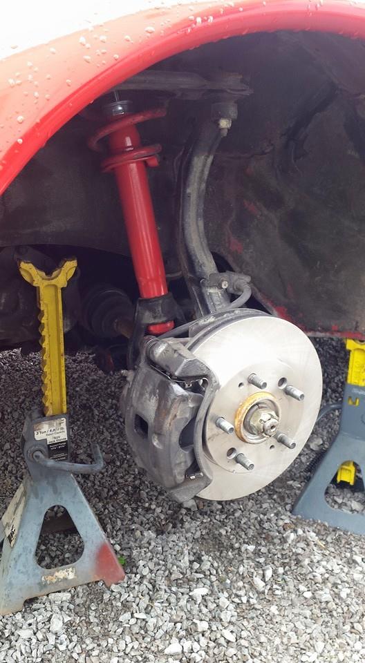

Finished up most of the suspension this weekend besides the rear sway bar working on the spacers. Also got the exhaust fixed but come to find out when I had the new flex pipe welded in the guy made the down pipe an inch shorter which now puts the exhaust against the rear sub frame so need to add some exhaust to get the clearance to install the sway bar. I got brakes finally and car stops 10x better than it ever had sense I have owned it.

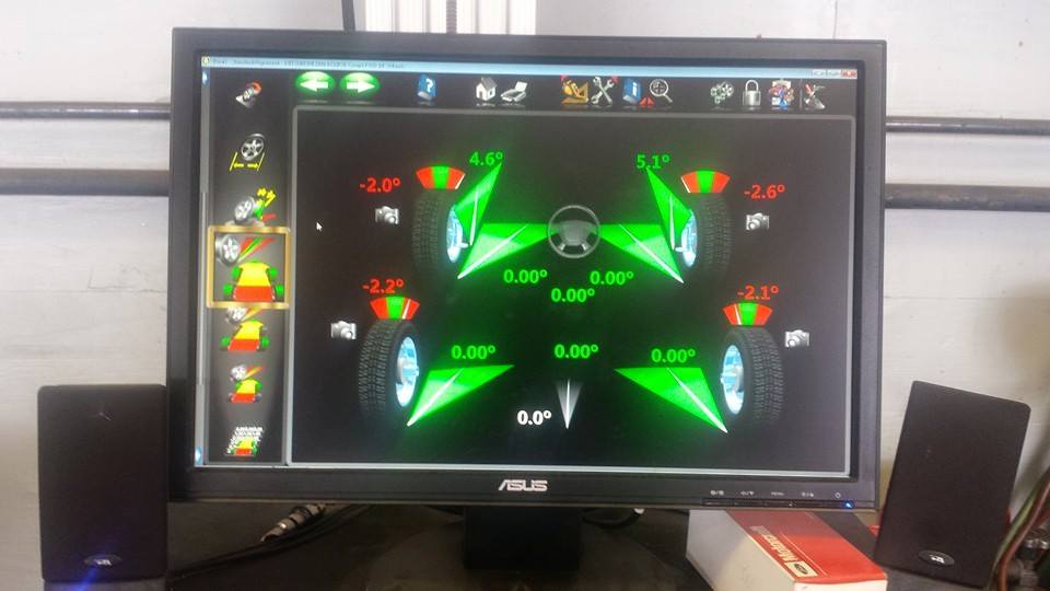

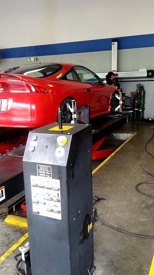

Got it aligned for the cost of lunch for the shop, got to love working where I work get discounts at most any shop in my area. Car has camber though but my camber kits are maxed out. I guess -2 is a lot better than -4. Think it is really time to start working on my upper control arm idea for front and back.
