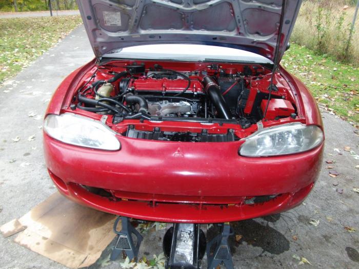

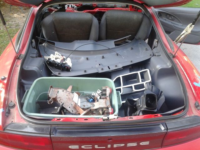

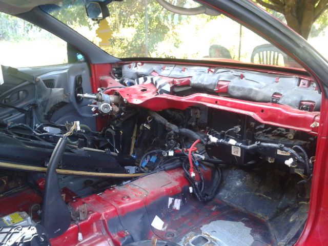

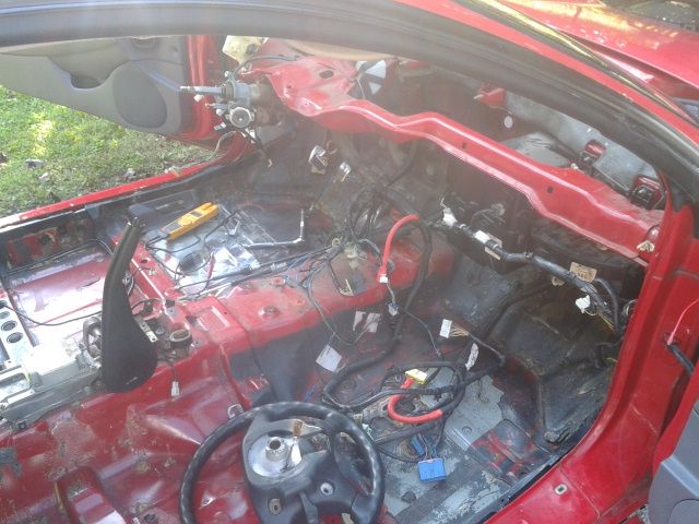

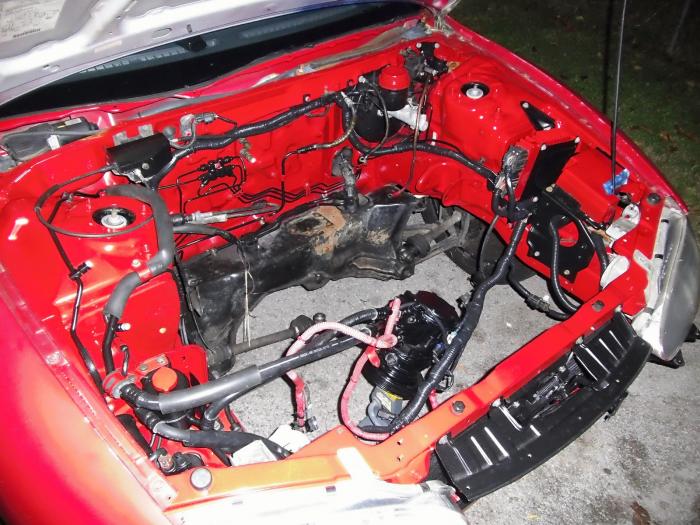

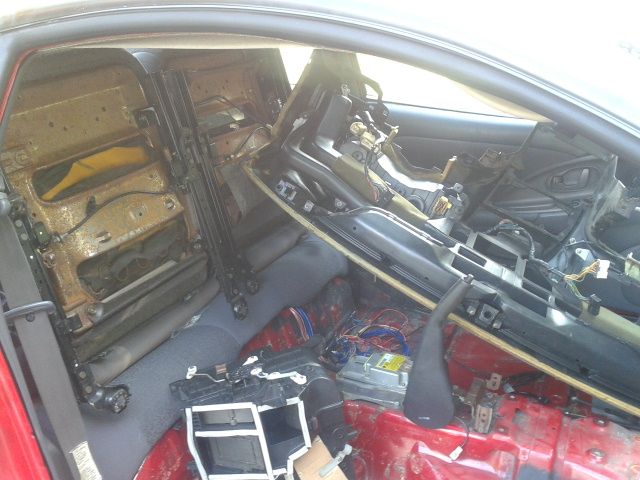

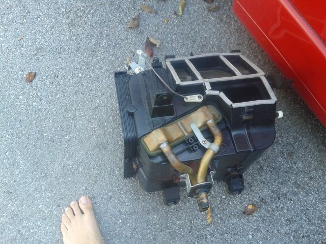

Got the dash out to finally put a heater core back in the car, going to need heat by the time I get this car running again.
Everything had to stay in the car, engine parts and everything else is taking up all the space in the shed.
Heater core, thanks to 96ETT.

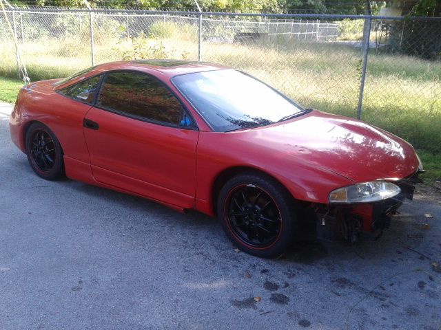

Still got to put the rest together, but bored so I working on getting the cigarette lighter replaced and getting some LEDs mounted.
Also I am trying to get my paint back to looking good. Sitting out in the sun under a tree with no wax on it, she needs some TLC. Took the wing off to get it waxed and clayed better. And I really like it wingless. :D

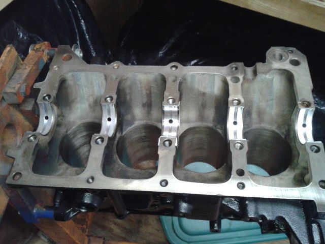

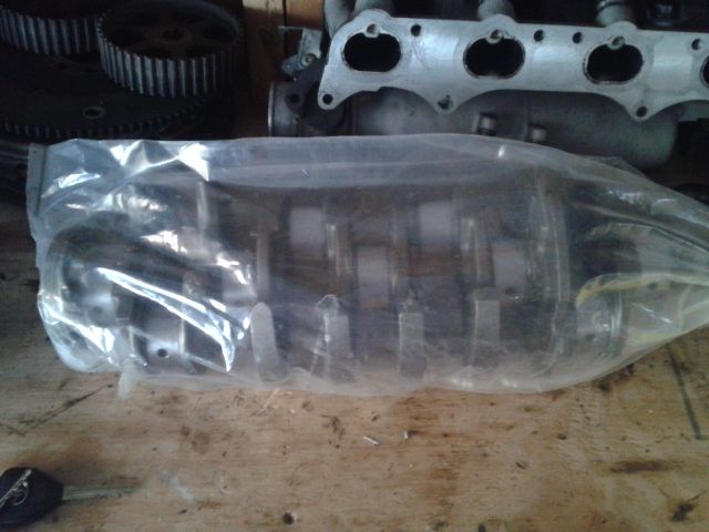

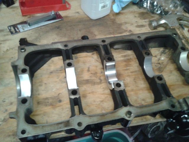

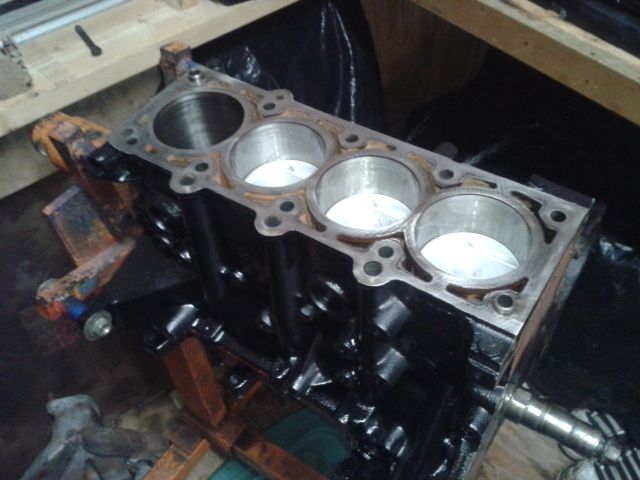

Got the crank turned. Turns out the mains were turned before, but they just needed polished. The rods on the other hand had to be turned .05 over.

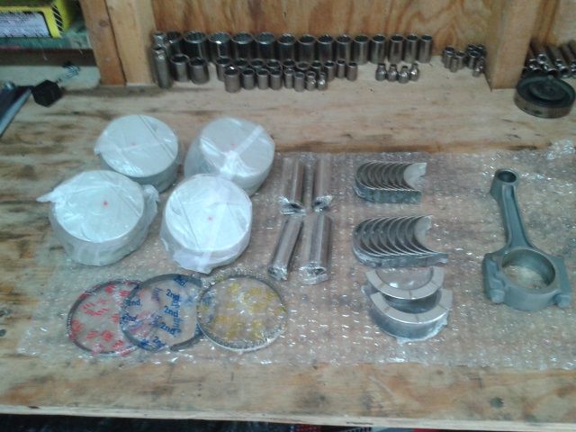

Parts came in today when I get a ride I'm taking them to the machine shop to get that done. Pistons, rings, and bearings.

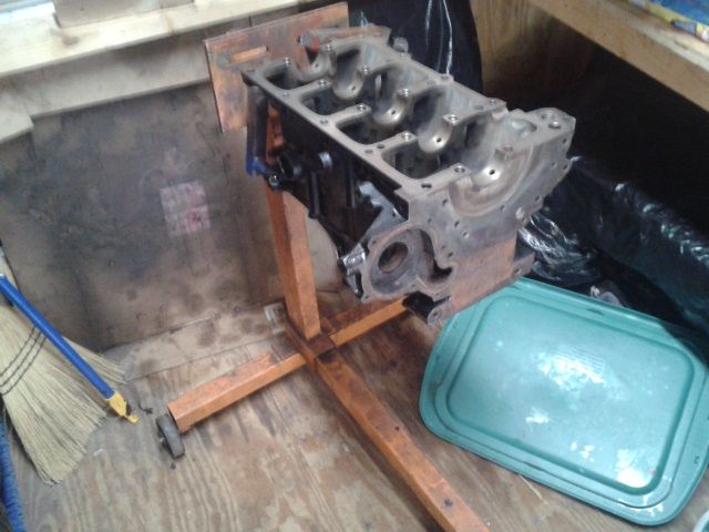

If I can find a engine stand I can start the rebuild. Really don't want to risk it building the motor on the shed floor.

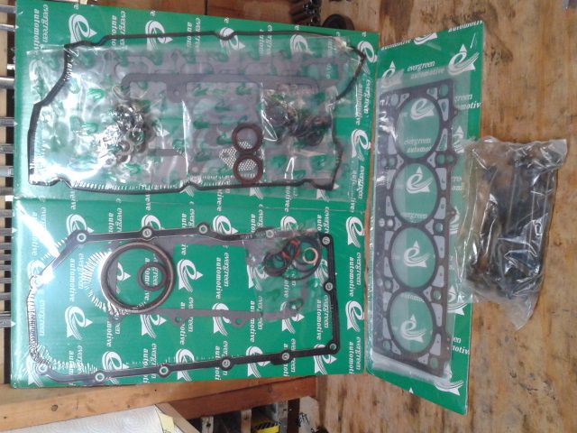

My gasket and head bolts came in today. Exciting almost got everything.

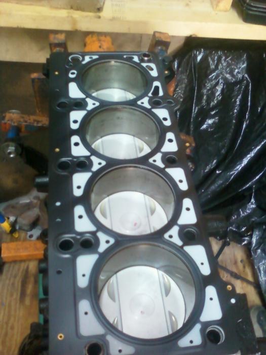

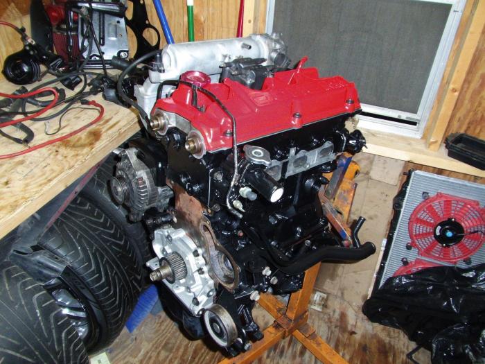

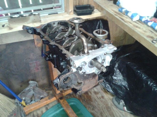

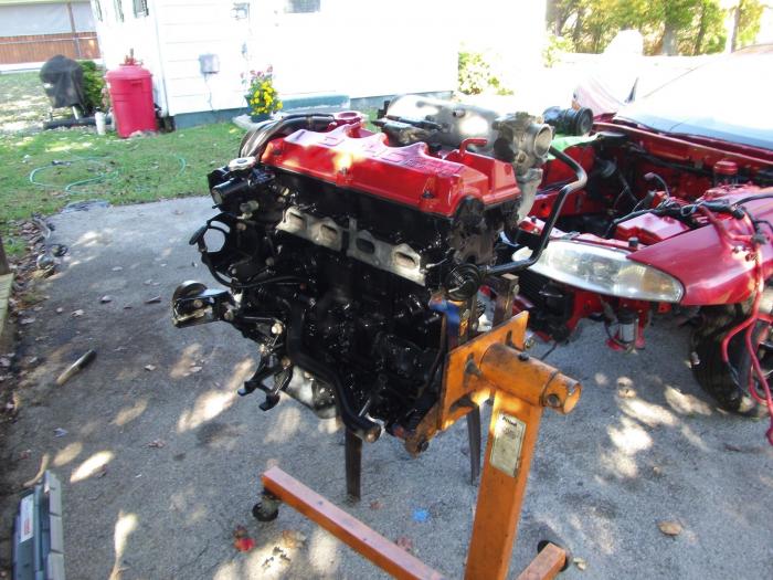

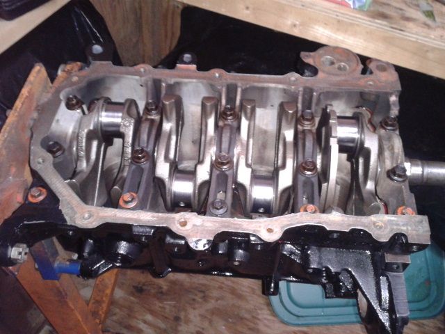

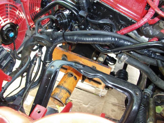

I got the block on the stand and put the crank in. Got three of the pistons in. I have to get a second rod unsuspectingly. Comes in Monday so I got to wait.

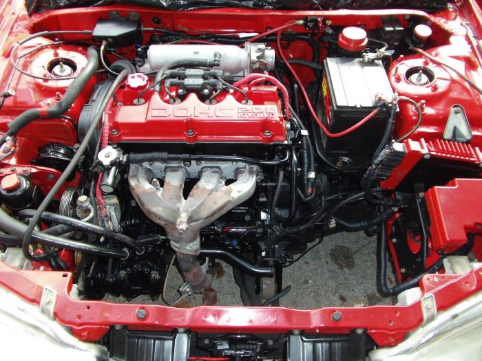

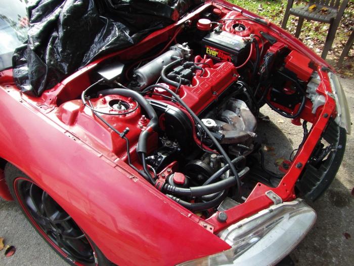

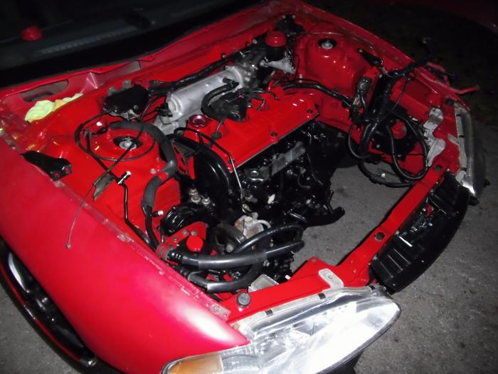

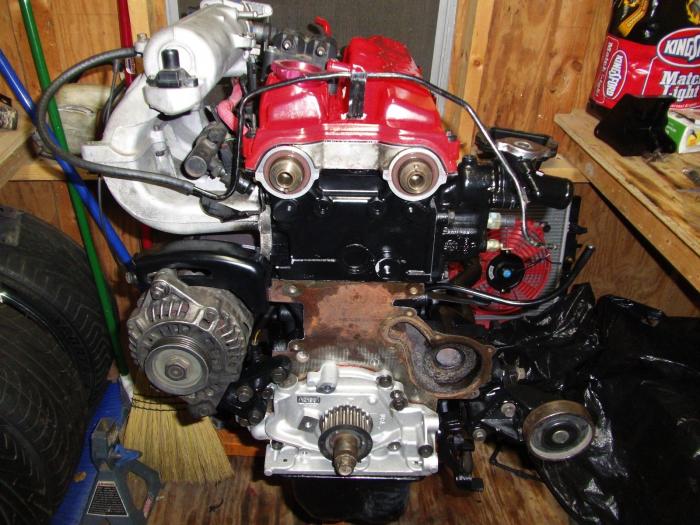

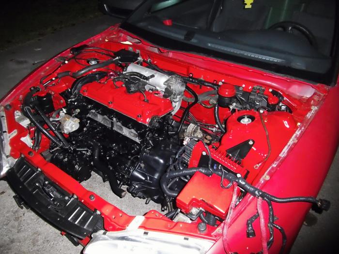

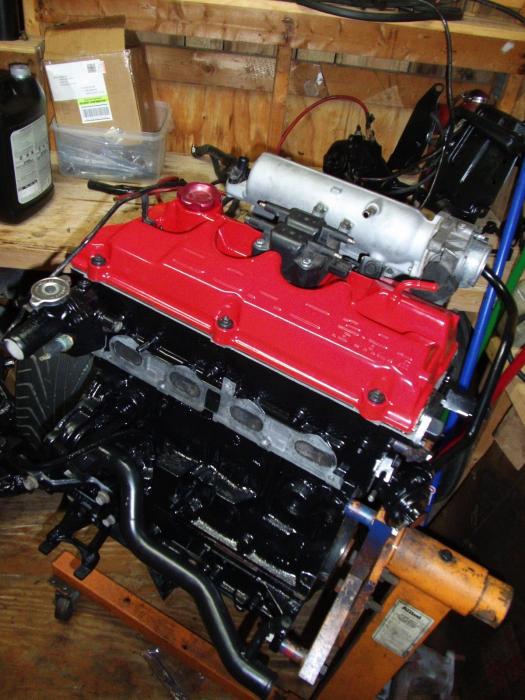

Well I have got a lot done, just waiting on a few things.

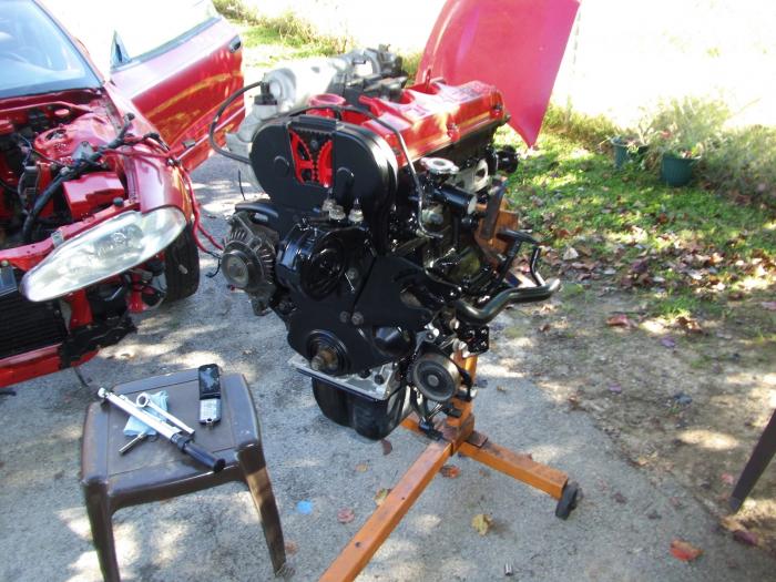

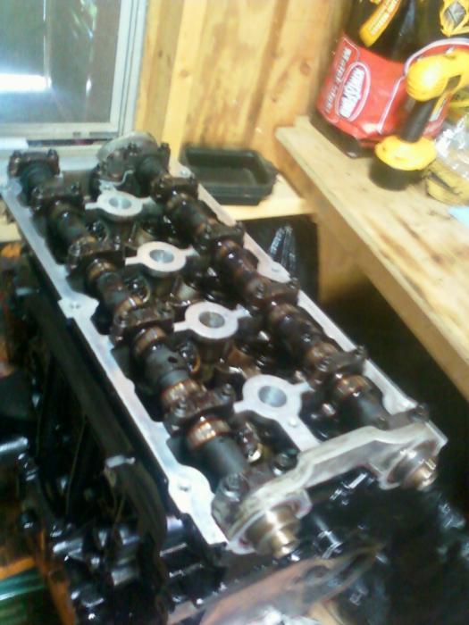

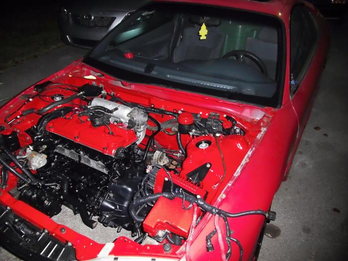

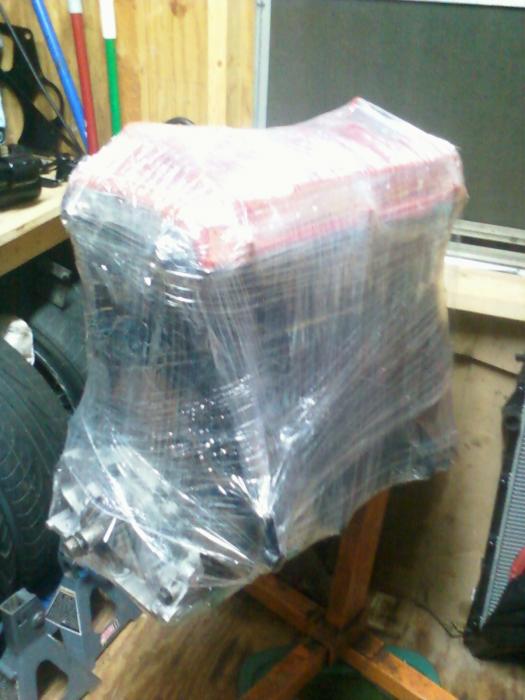

Had to wrap it up for a few days till I could fix the valve cover and get the oil pan on.

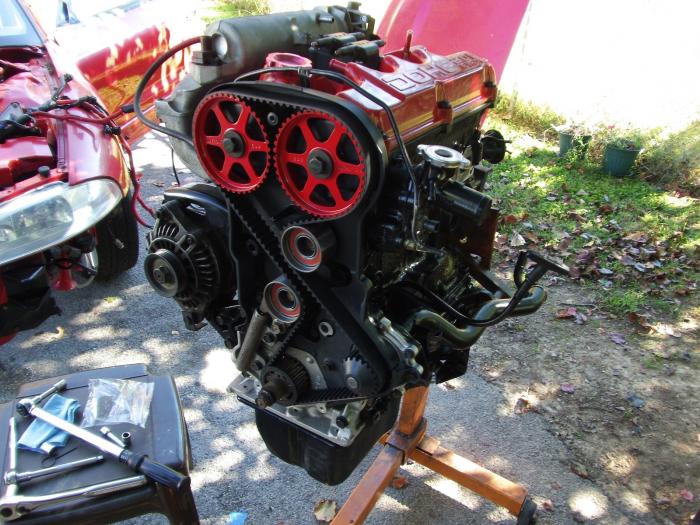

Everything is on just waiting for the timing kit and the water pump to be ordered tomorrow hopefully.
I do say that it has turned up to look a lot better than I planned just cant wait to drop it in.
Just waiting for the engine.

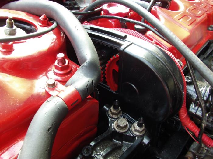

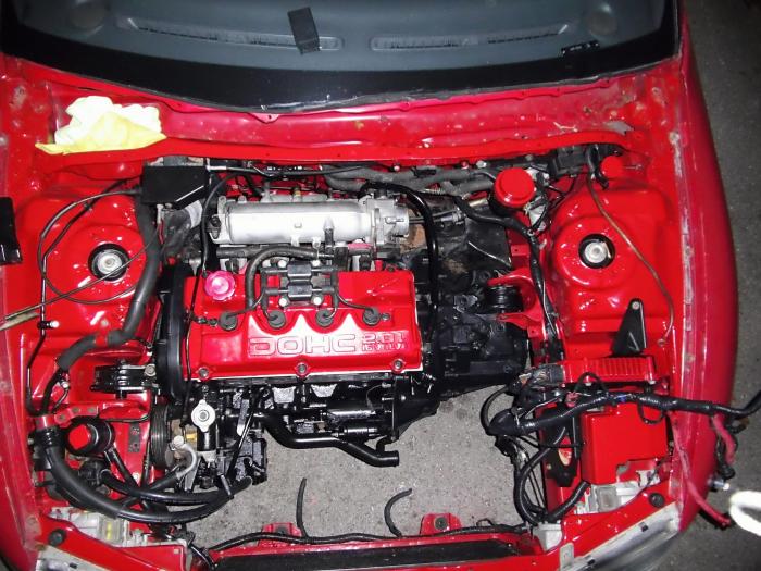

Thanks, I'm hoping to have it running by mid next week. I'm excited and can't wait to drop it in. There will be a few things not painted like the exhaust manifold and the powersteering pump due to they are going to be replaced so didn't want to wast time.

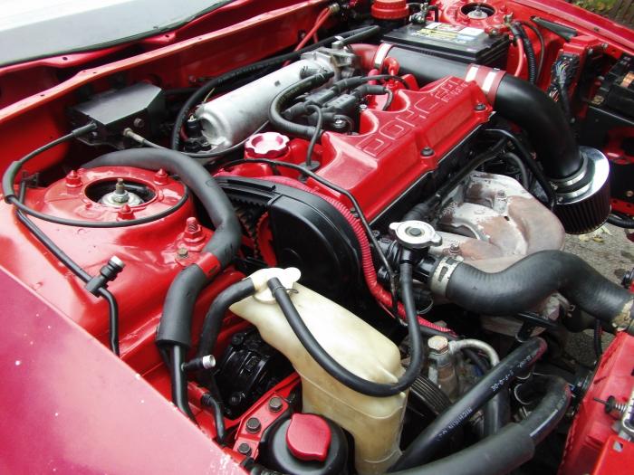

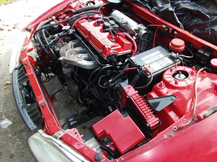

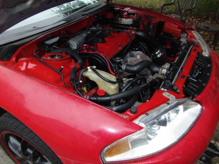

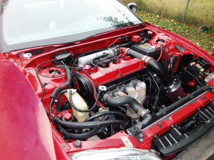

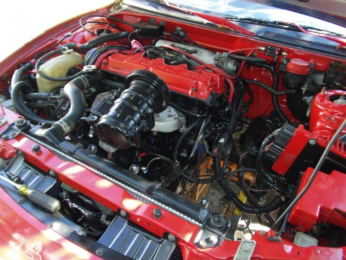

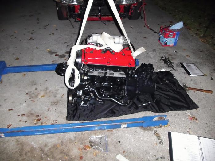

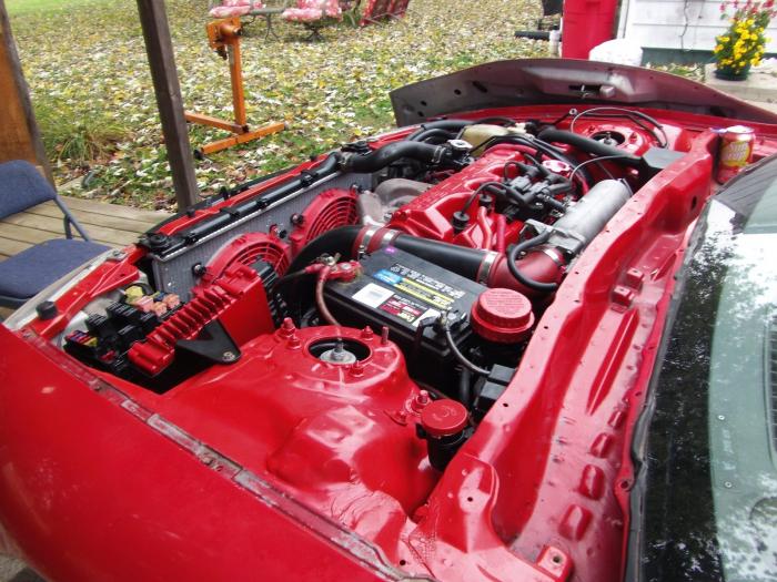

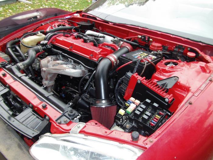

Finally got everything together and already did the 20 mile break in on the motor. Just have one oil leak to fix and she will be back to being my dd. :hellyeah:
I am planning on replacing the exhaust. Head all the way to the tip, and also I have to replace the power steering pump. but other than that most of it all is there to stay for a while. :D

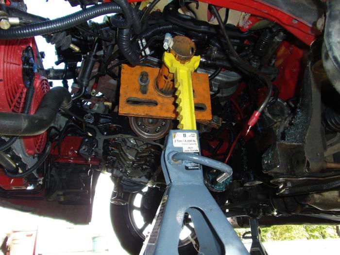

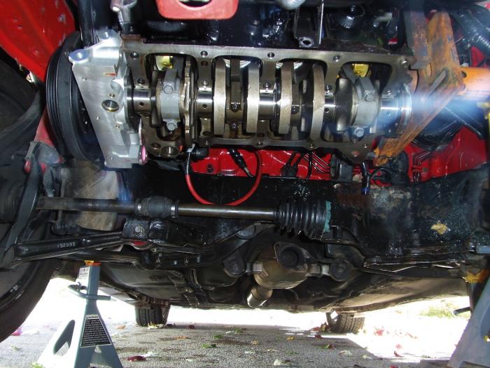

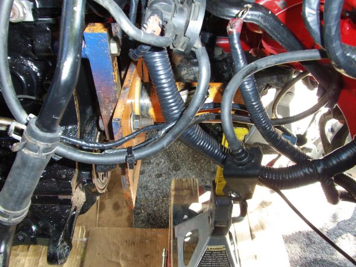

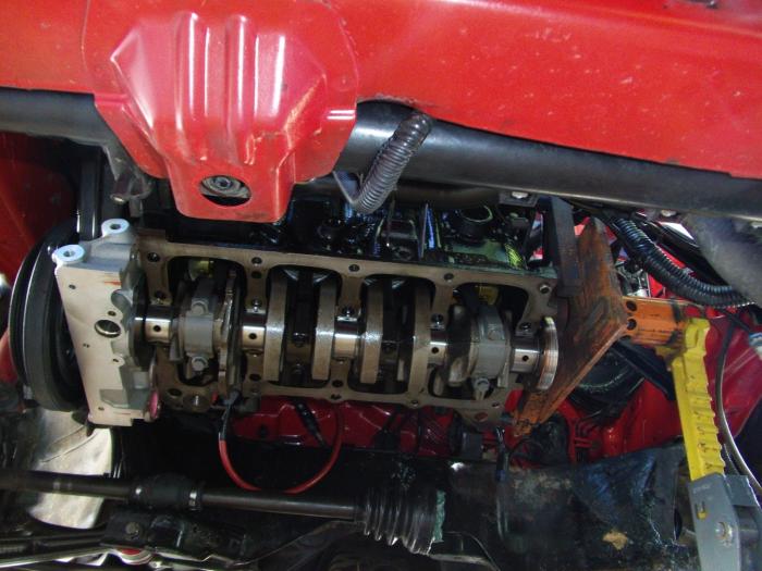

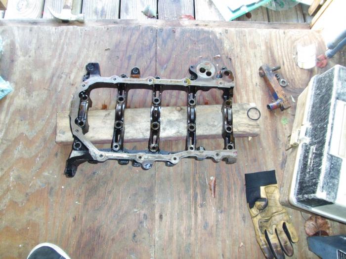

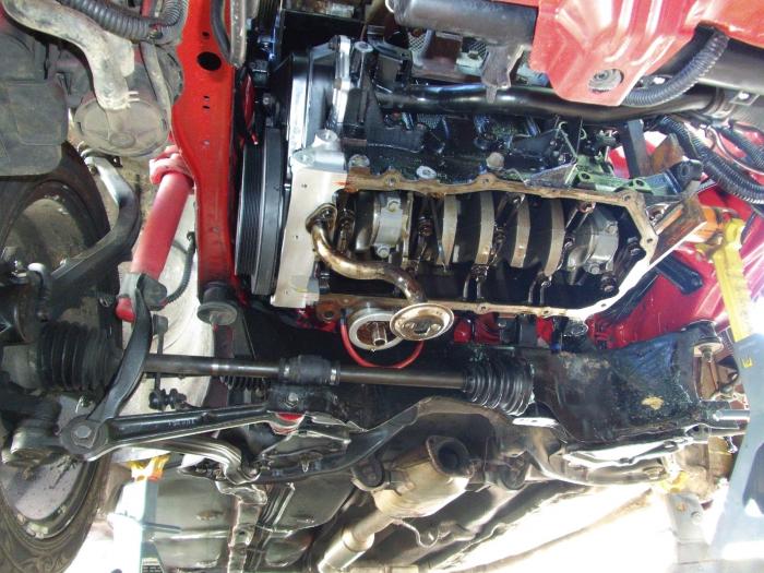

Had an oil leak above the oil filter between the bed plate and the block. I had pinched the o'ring. So long store I had to pull the bed plate. :cry:
Figured I would save the trouble and do it with the engine in the car. It was completely easy. The only pain in the whole thing was putting the transmission back in.
Came up with engine stand mount bolted to the block and held up with a jackm to support the block. Worked great.
Got everything back together and fixed the leak.
The oil leaks i still need to address is a leak on the firewall from the heat core hose, and the exhaust leaks from everywhere beside the manifold.
But planing on getting a full exhaust.

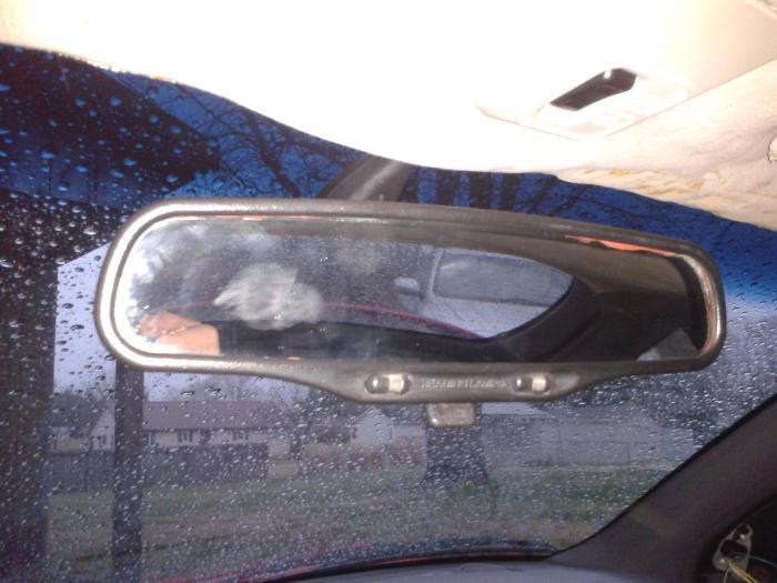

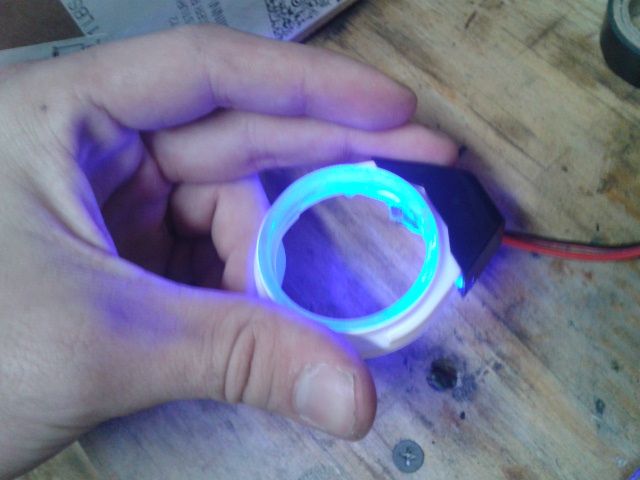

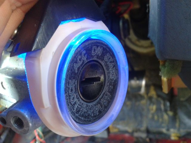

The LEDs will be fun. It wasn't really that hard or time consuming. The longest thing was waiting forever for the LEDs to get here.
The only problem I ran into was the tec. post I was following the white LEDs only needed to run in a series of 3 but what I learned quickly is the blue LEDs burnt out quickly in a series of 3 so I added a 4th one and works perfect.

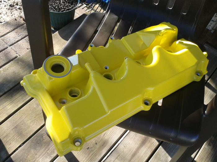

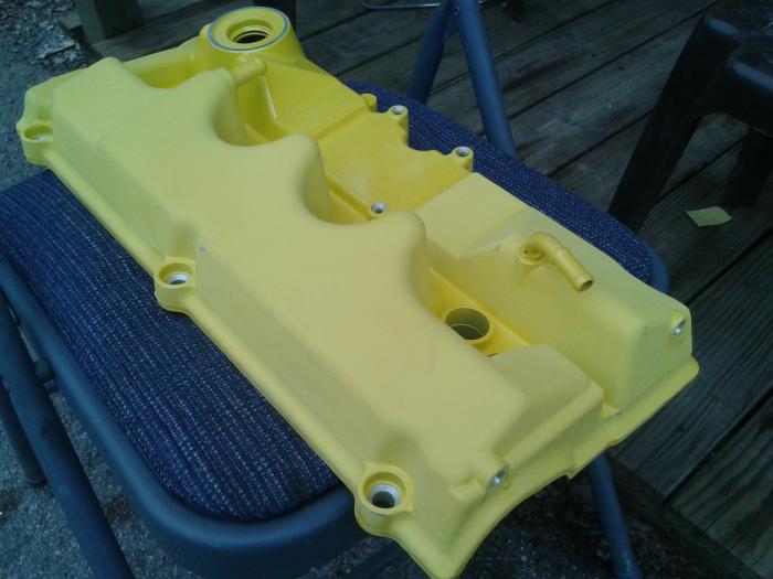

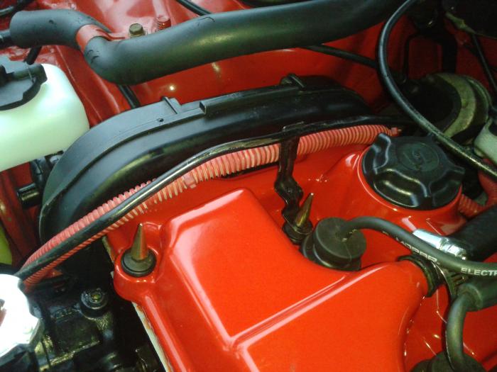

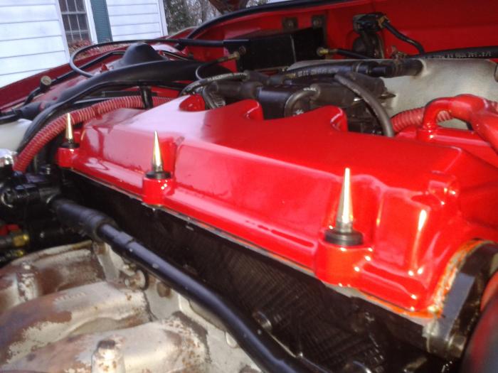

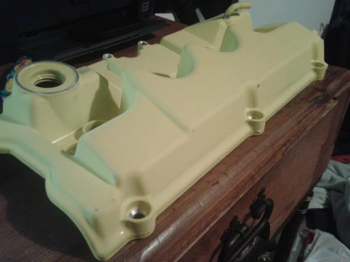

Finally got a valve cover. It's shaved and it was half off couldn't beat that price with it being powder coated.

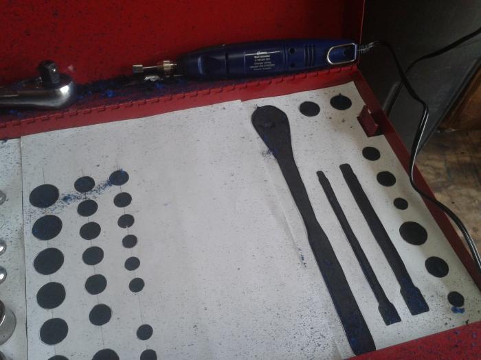

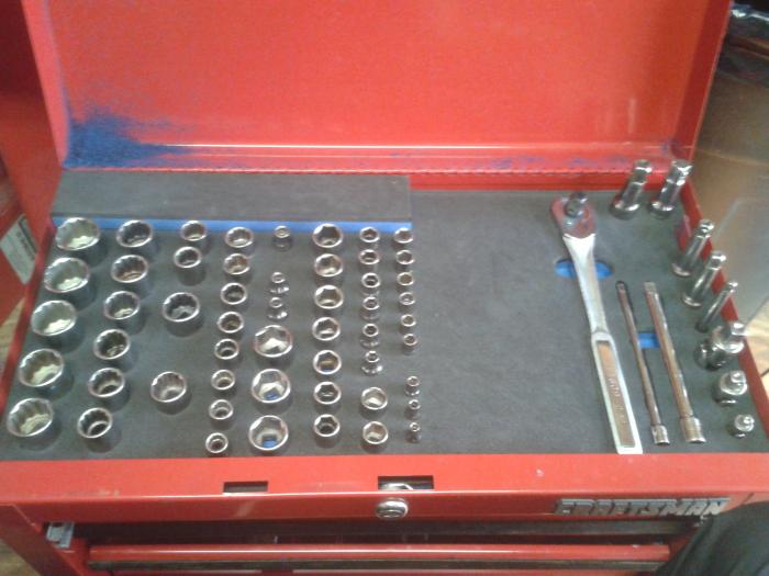

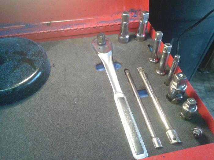

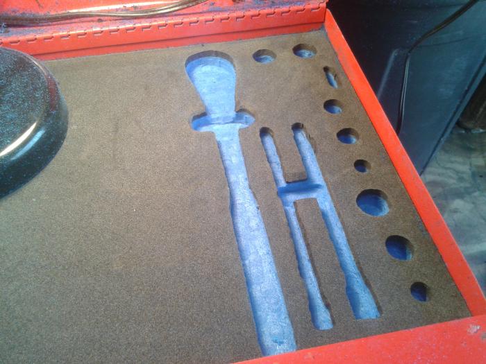

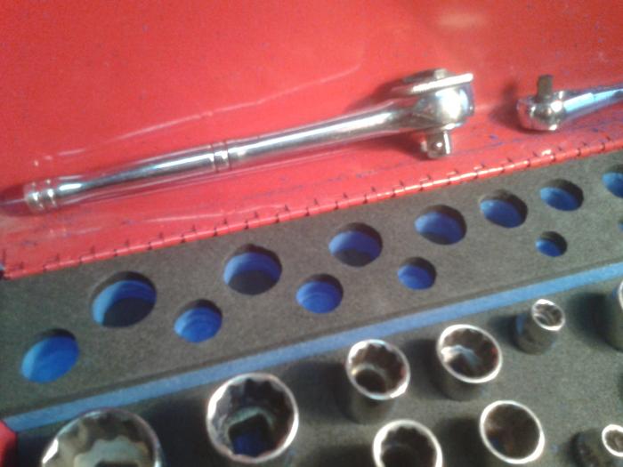

Well around Christmas time I got bored and tired of my sockets going crazy in my tool box if a fly landed on it. I hate being unorganized so I bought a $20 tool box foam. Figured out my lay out, traced onto paper, cut it out, got a small dremel tool and cut it out. The big gaps are for the missing size. All I put in my tool box is metric, hate standard and no need for it.

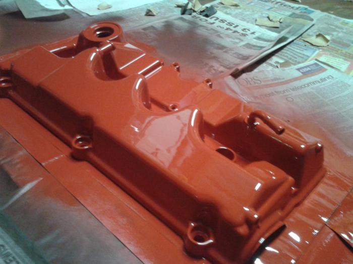

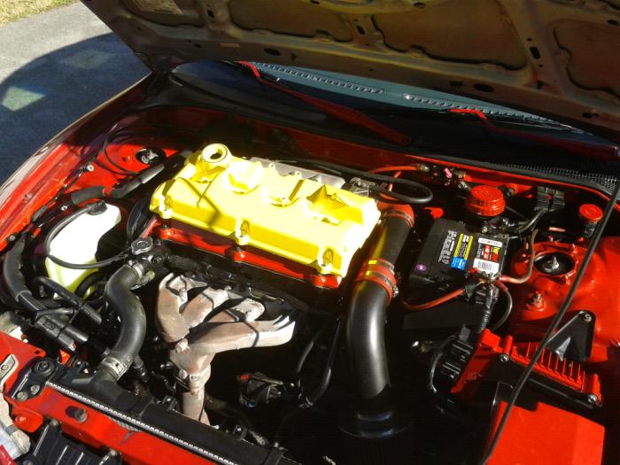

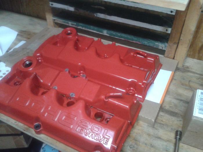

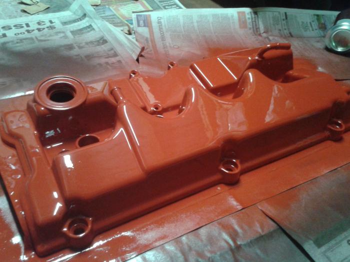

Was not keeping that valve cover yellow, was going to see if anyone said anything. I was shaved and half off sale for the holidays. I was going to get a gold powder coated one but it was missing the breather.
I sanded the whole thing smoothed. By the way the worst powder coat job and I don't know what the heck these people did. Every whole was countersunk, there was over spray powder coat in the seal lips, and dirt all in the paint.
See how the holes are countersunk?

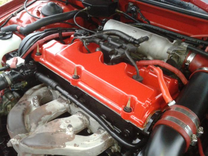

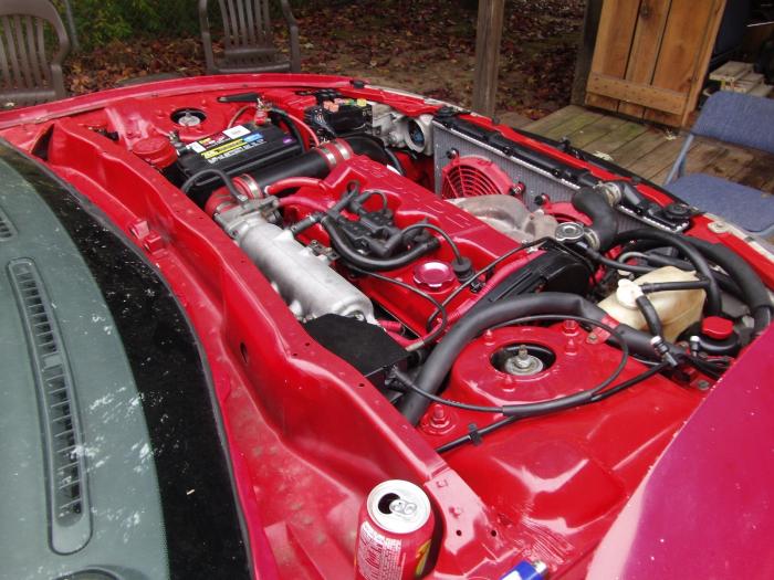

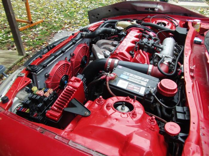

Well got it all painted to match the rest the bay.
Regular vs. shaved. I like them shaved. Looks way cleaner.

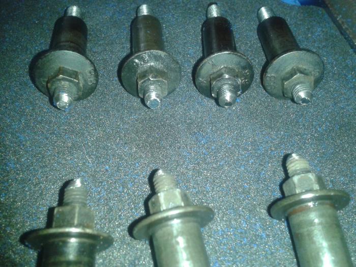

Me and my friend were talking and going to order another set of bolts to get rid of the ones that have the long stud coming off the top of the head. Well he mentioned putting a 1'' long spikes on them instead. So when I got the extra set of bolts I gridded them shorted so the spikes would sit flush and did enough to do all the bolts besides the one under the coil pack.
Now the finished product.

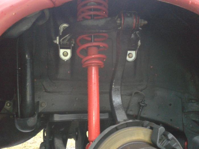

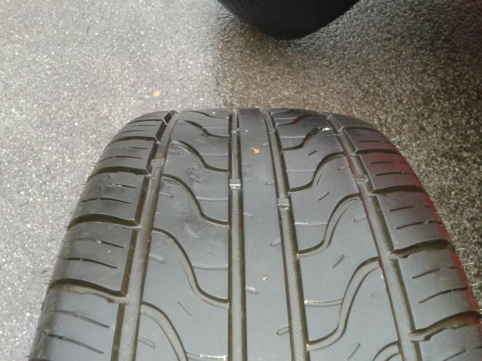

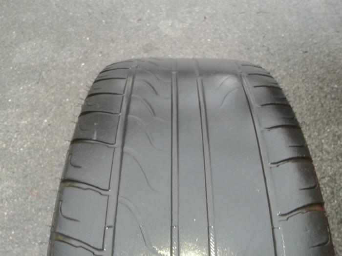

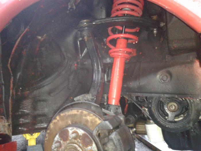

Well went to check everything on my eBay suspension after a year of driving it as a dd. Everything has held up beside the cheap front camber kit, (see bad day Thread).
Front tires look like the on both sides, :D no idea why. But also was stupid and haven't ever got them rotated like I use to so that doesn't help. But very even wear I think.
Now my back tires still look like brand new and evenly wore also.
Now after a year on eBay shocks and springs and polyurethane bushing everything is still in great shape. Still rides amazing for how low it sits. I would say it rides better than most lowered cars I've been in.
After I looked at everything I put the bold tires on the back. Is this a bad mistake. I know when I spun out a year ago, it was because my bad tires.
On the way to the pull a part it was raining and at one point the car swimming in the back. I can't think of the word. Should I put the bold tires up front anyone know if its a better idea.
Hydroplaning
Leave the good tires on the front.
It's easier to control a FWD car that's over steering than it is to control a FWD car with no front traction.
with that said, replace your tires ASAP in the back.
I moved them back to the front for now. I live on a curvy road and my back end sliding out scares the crap out of me. With them up front I seem to still have great traction. Once I am able to get them replaced I will but $220 is hard to save up when you only make $100 a week.
