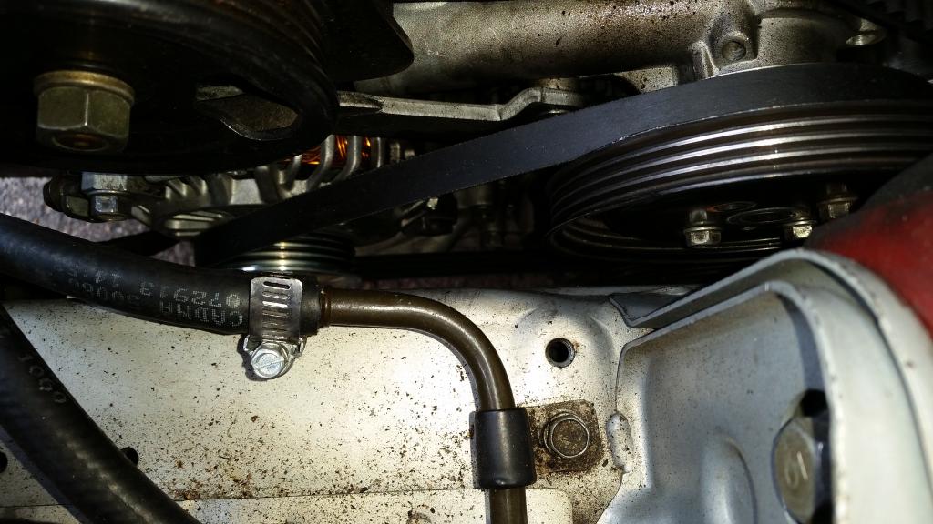

So last night as I was returning home from school, I heard a weird noise coming from my engine. This morning I found out it was my alternator sparking like crazy. So carefully drove to work and bought a new alternator. After I pulled the old one out, found out one of the bolts inside had worked loose and was spinning around with the stator assembly. No fires thankfully.

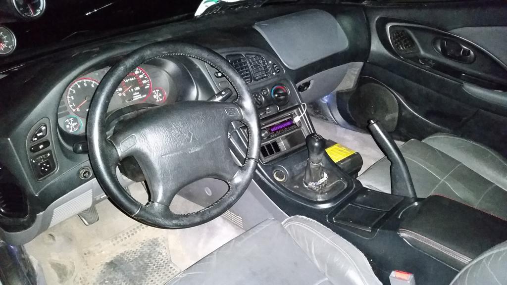

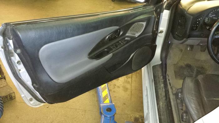

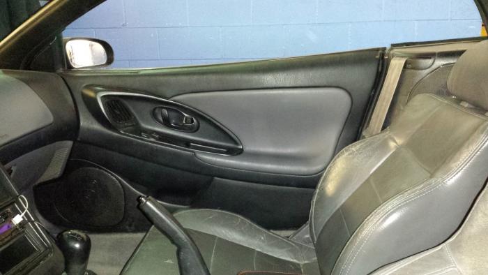

Also got my black door panels put in yesterday :D so now only the carpet, seats, and the random kick panels that weren't made in black are still gray.
Hell yeah :D I found a wiring schematic for it, but it's not very helpful, so I have to research more.

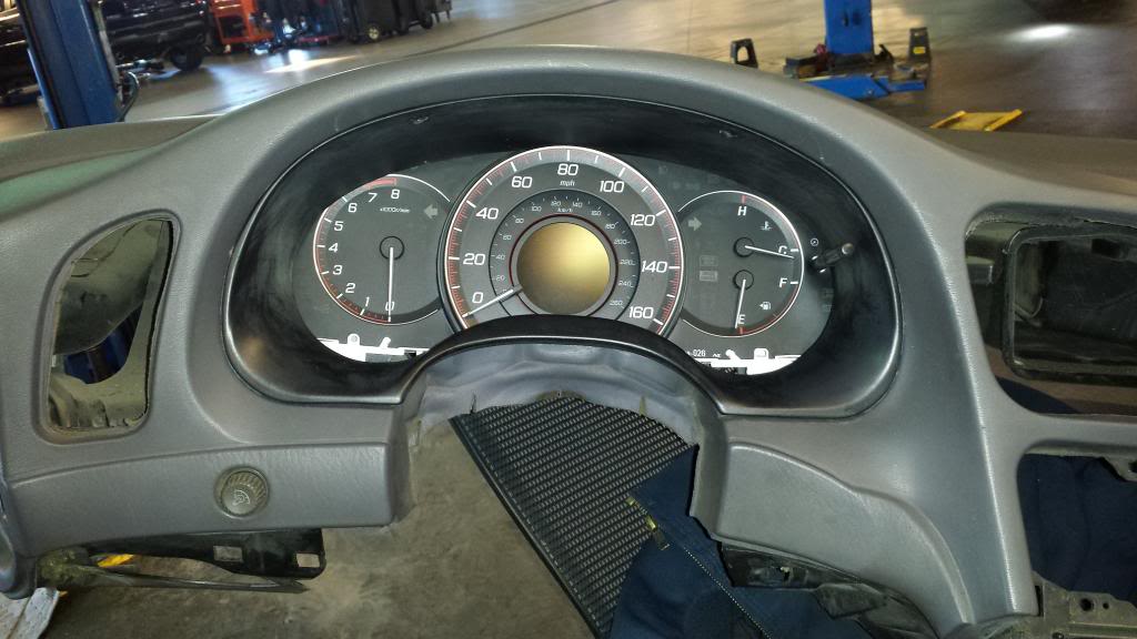

And speaking of the cluster, it can now sit it the dash with the bezel fully installed.
Unfortunately it got a little overlap on the bezel, but a slight adjustment is all it needs to go away.

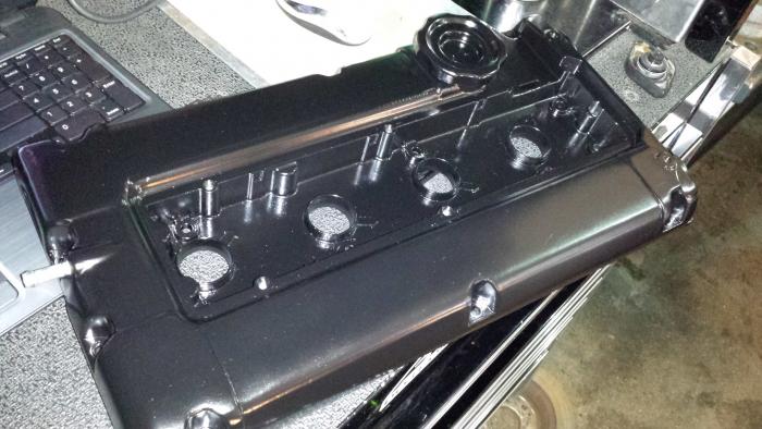

Also painted the shaved valve cover so I can put it on and get the none-shaved black one off. That one will get a better shave job, probably with a milling machine, and then a custom paint job.

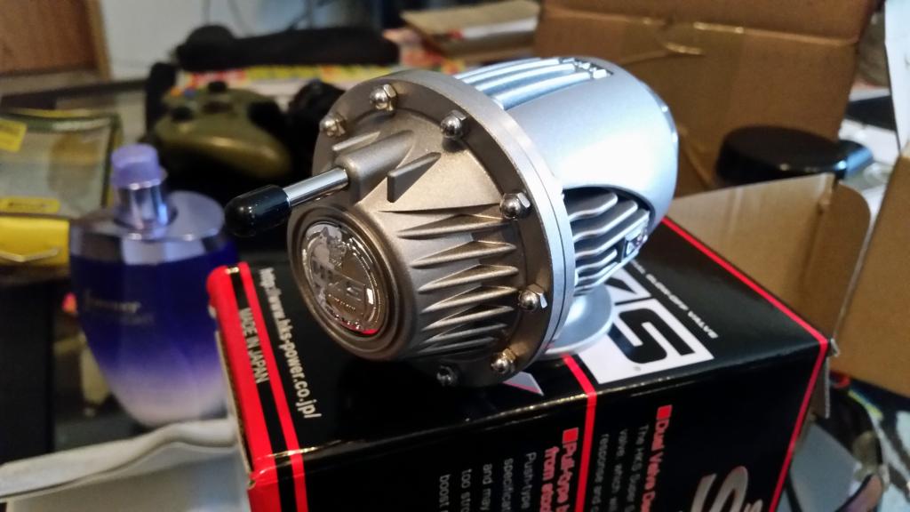

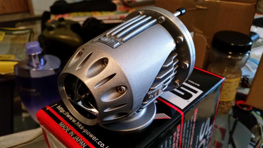

Been a long time with no updates, so here's how things have gone. Started buying my Prosport gauges, got a new HKS sqv4 bov, ordered a VRSF fmic (which comes in on Thursday), and replaced my water pump. That last one almost killed my engine. I forgot to remove the gear stopper placed between the cam gears during the timing process, and then I started the engine. Long story short, it obviously didn't start, but I jumped timing bad. Somehow though, not bad enough to bend the valves or sheer teeth off the timing belt, even though the crank spun almost a full revolution. Very lucky. I reset everything and my spyder lives on once again without being broken. Drives as good as before the water pump started leaking.

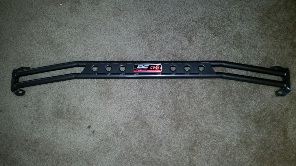

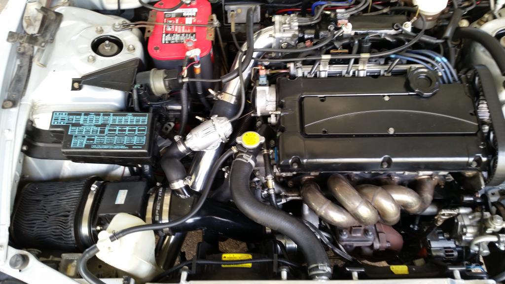

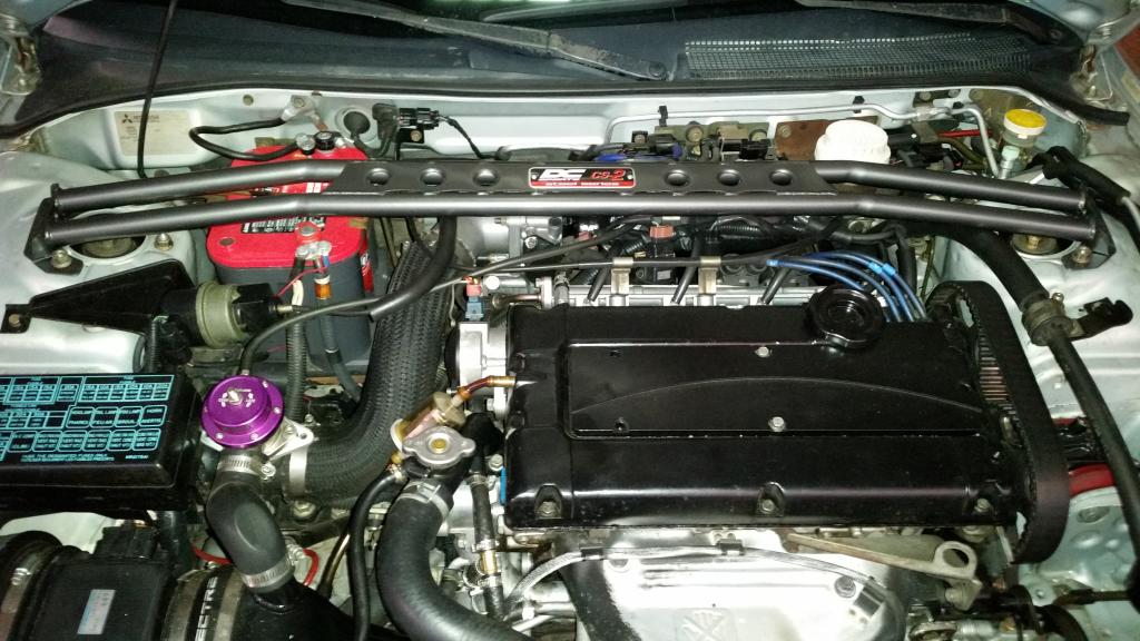

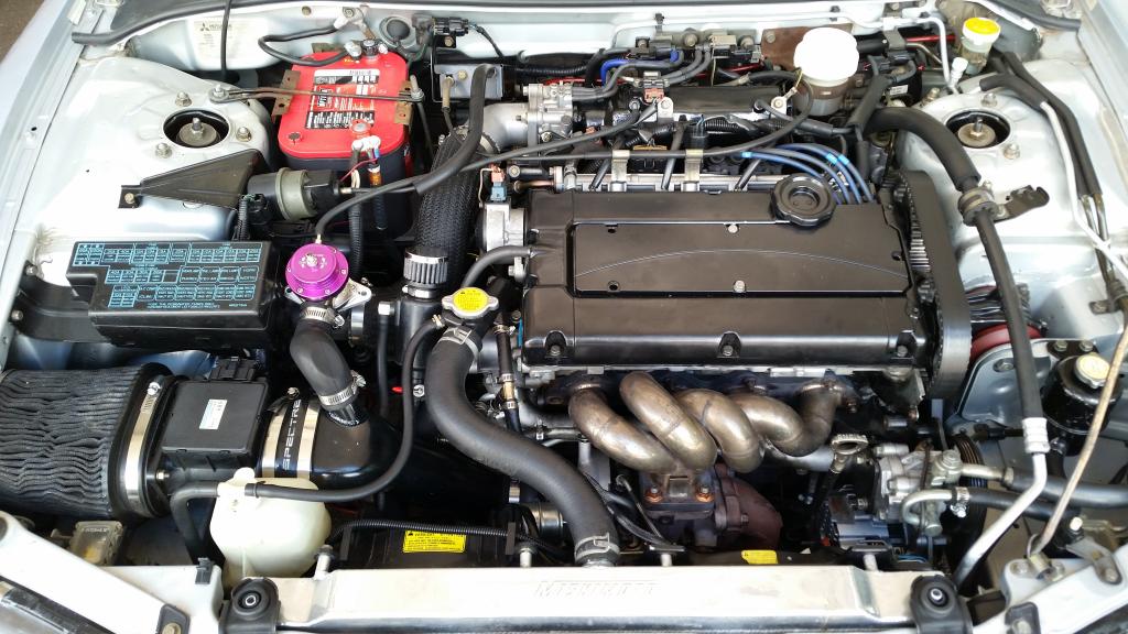

Got my new strut bar today. I know it's for the non-turbo, but it will be adjusting my battery so that it fits properly, and whatever else my be in the way.

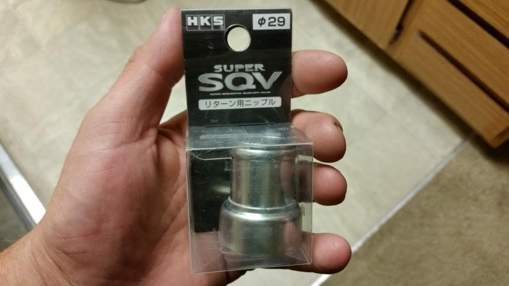

Here it is in the engine bay. Gotta get the adapter for relocating the MDP sensor so the strut bar can mount properly, unless I get Link and SD first.

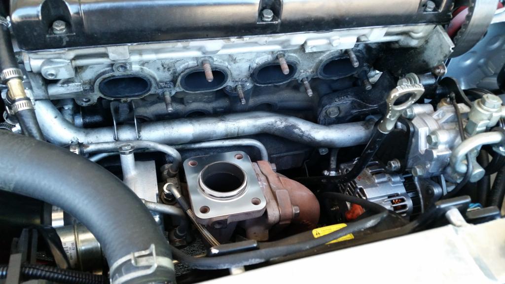

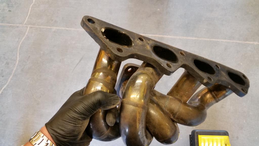

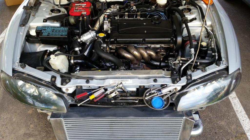

However, even though the car was horribly abused, I found this tubular exhaust manifold and it looked to be in good condition so I bought it for $33. When I got home I cleaned it up and there's no cracks or anything else wrong with it. There's no brand, so I suspect it to be an eBay part, but that's ok since my factory one is cracked a little.

Installed the new manifold today. I had to elongate the 14mm bolt hole at the end of the flange so I could get the bolt in. But got that done and she runs smoothly. Feels like I'm getting better throttle response now too.

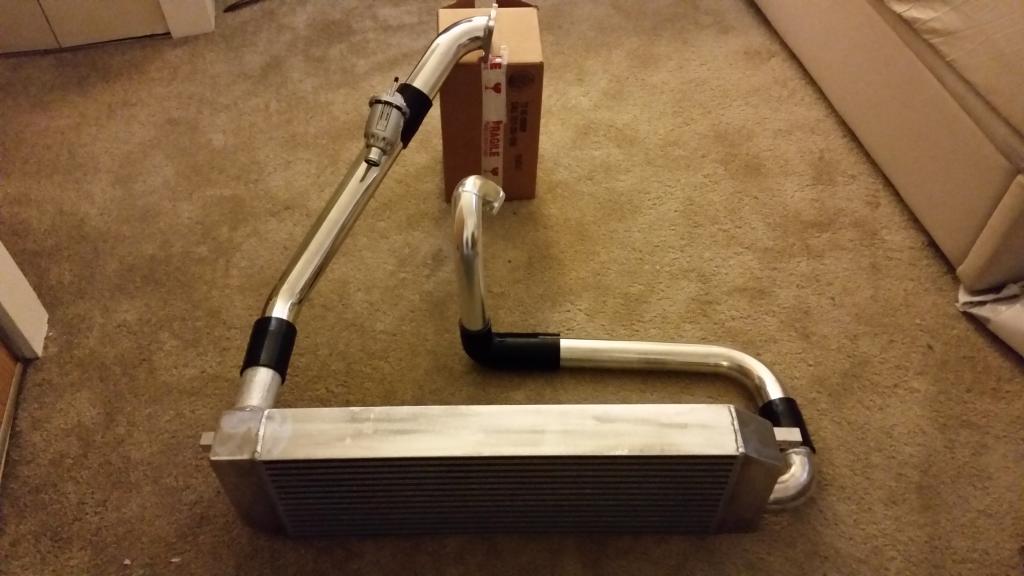

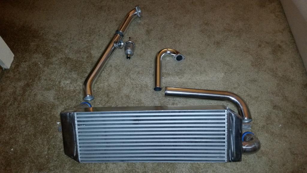

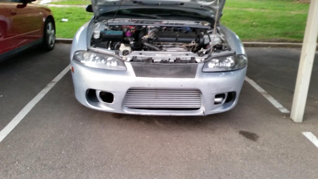

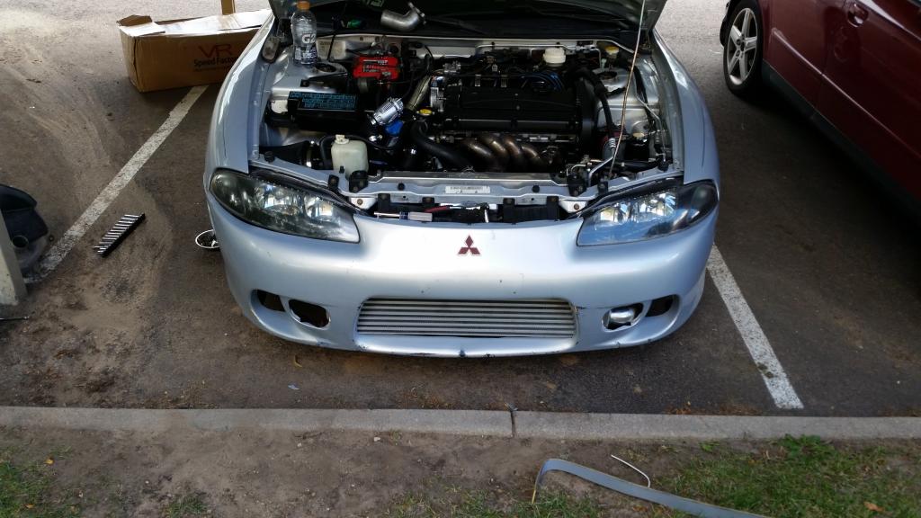

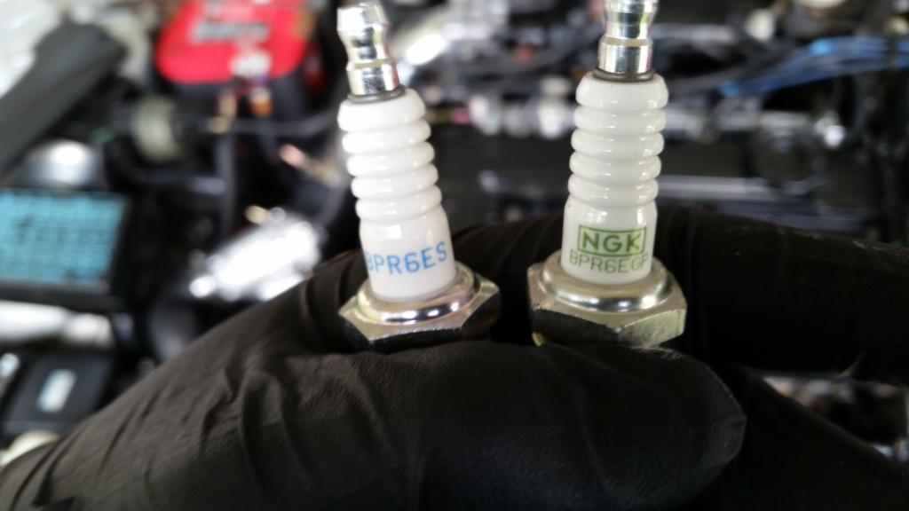

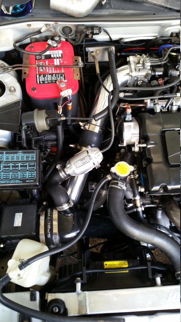

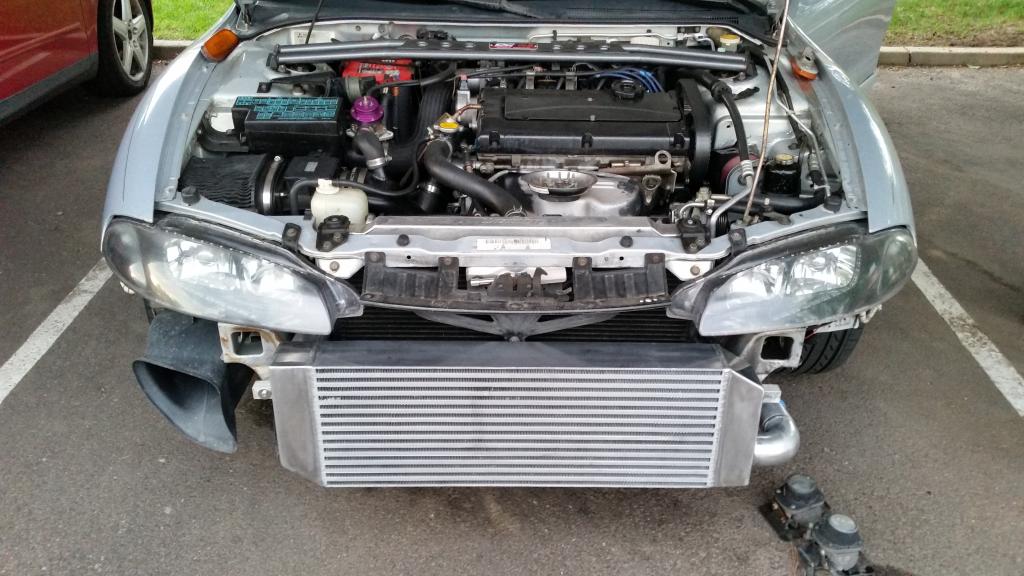

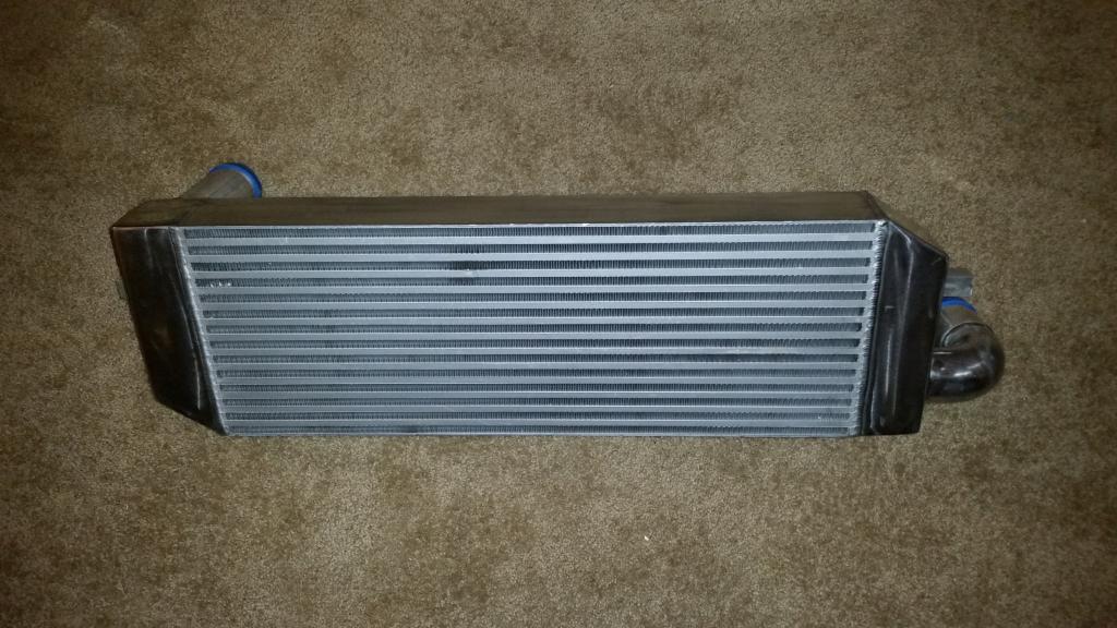

I decided to change my oil and spark plugs today and install my VRSF FMIC. Found out my previous plugs were the wrong ones somehow. Maybe I over looked it last time... the one on the right with green writing is the old one...

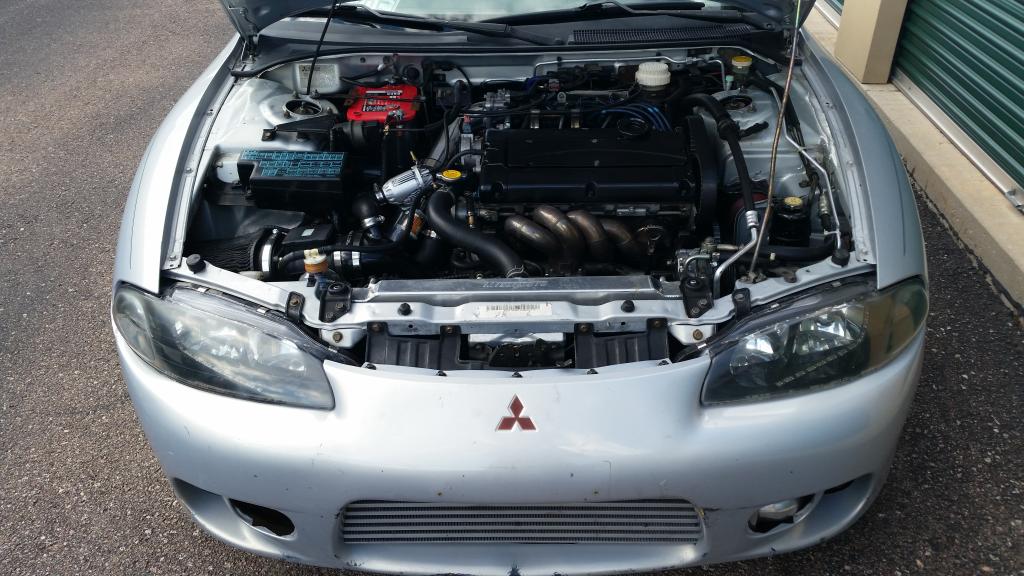

Here's the fmic install:

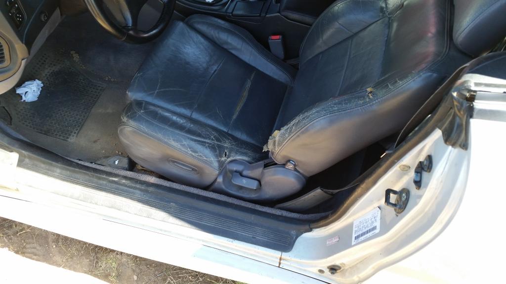

Haven't done much of anything with the Spyder since getting the new GSX. It's being torn apart and rebuilt, so it has my main focus until it's running. I did however put it's power seat into the spyder since the Spyder's driver seat rail is messed up and has one real adjustment position.

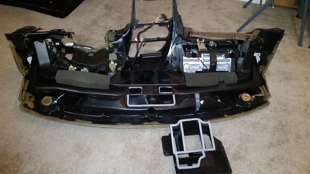

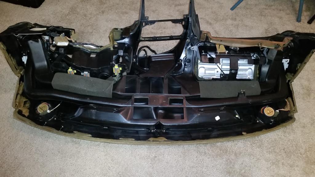

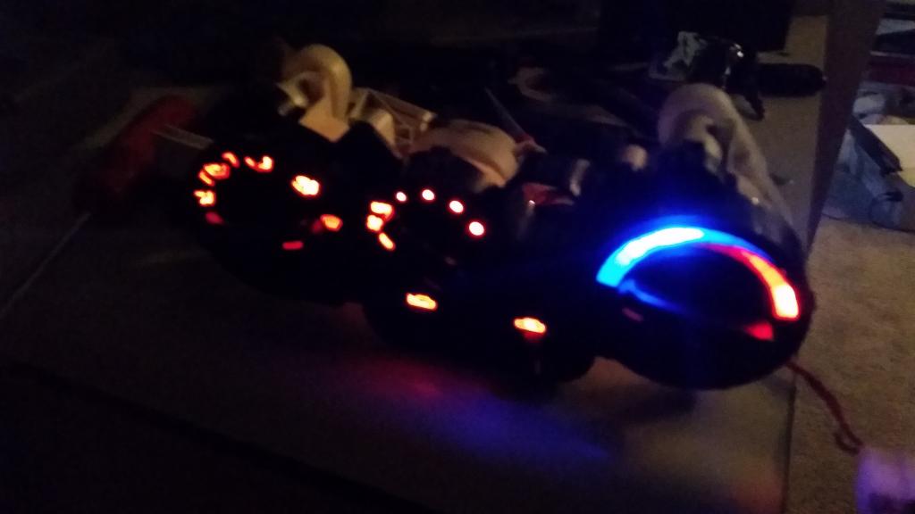

I pulled the dash out of the Spyder to replace all the vent seals like I did on the GSX last weekend. I also took this t I me to replace the blue LED in the HVAC unit, so it now works again. Found out the wire for the original blue LED got pinched and broke the wires inside the rubber coating. Made sure that didn't happen this time.
Before replacing the seals:
After:
20141129_201407_zps03zjikzy.jpg[DOUBLEPOST=1417395527][/DOUBLEPOST]Got the dash back in. Was such a pita for some reason. Never had issues like this before, but it's now over... finally.
The air does feel like it's blowing a little better, so hopefully this wasn't all for nothing.
