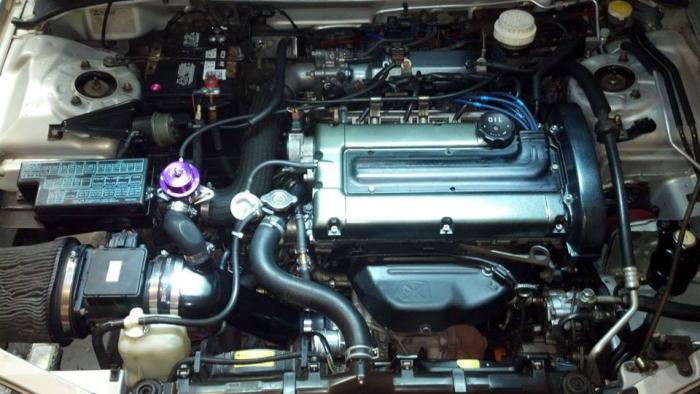

Well, I've finally driven the Spyder enough to be satisfied with my new idle setting. She hasn't stalled out since the part swap and adjustment :D I also decided to swap in the Injen intake I picked up from Albanator when I bought the exhaust and that coupled with the new BOV (which isn't new, I've had for several years but never used it) makes her sound a lot better. It's only a knock off Greddy Type S, but it sounds just as good. No more muted BOV like when I modded the BOV recirc fitting. The exhaust note is now a lot clearer too. Once I replace the piston rings, she'll be running and sounding great. Here's a pic and video... I need to get a replacement filter and then I'll be happy with the intake. The video is a little muffled since this was shot with my phone's camera :dsm:

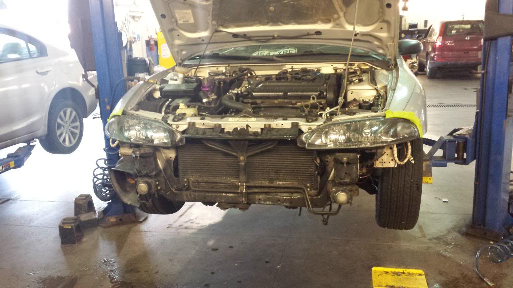

Well, in 12 hours I'll be tearing apart the Spyder again. Finally got all the parts and fluids so I can change my piston rings and fix a couple oil leaks. Can't wait to have full power back. I checked the compression one last time today, only in cyl that has been the lowest, and just to see how far it's dropped. It's at 120psi, which is just below the 6 bolt limit. Despite the low compression and the loss of power, she's still been performing decently, which came as a surprise compared to my last Eclipse. Since my shaved and painted valve cover has been leaking oil for some unknown reason, I'm swapping it out with another spare VC that I painted black, so now everything under the hood will be black except the BOV and the aluminum radiator I'm putting back in. Will take pics here and there of the work, and post them later on. After this, and my next focus area (replace all brake pads and rotors), I'll finally be able to breath and start plans for my 2.1 build.

I got the engine apart on Friday and found out I had 2 broken pistons..... my mood sank and all that ran through my head was that my Spyder was gonna be sitting in the garage again for months. Then I decided to look through all my spare parts and I had a full set of spare OEM 6-bolt rods with pistons. So after I finally breathed relief, my girlfriend and I installed them with the new rings (she actually installed 3 of them while I watched, was quite impressed). Took a break from it til Monday where I put everything back on, got her timed and fired up. Went for my 20 mile test drive and holy hell she's come alive. It had some balls before, but now she's a whole new kind of beast. Got my rings seated and all has been good since. I'll get some pics of the broken pistons up later tonight.

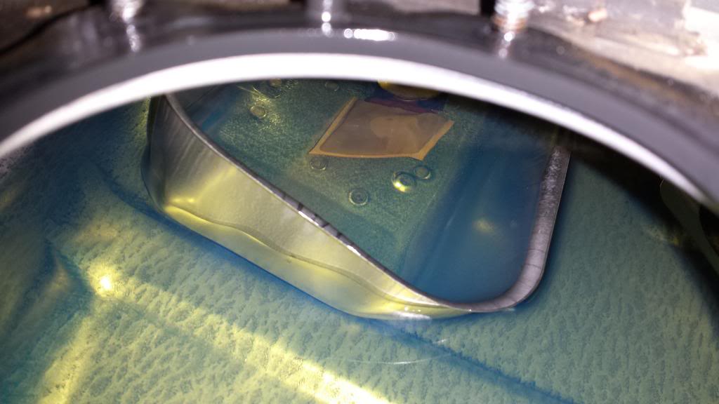

I found this all out because I got sick of filling up my car after only 170 miles each tank. It would say i was nearly empty on the gauge. So I decided to pull the level sender unit out to see if it was bad. Checked the resistance on it and everything seemed fine. Also at the empty level on the gauge, I had 3 1/2 inches of fuel left in the tank... WTF So I ended up checking resistance on the gauge too, and it is indeed bad. It reads 81 ohms instead of 122. So I'll be getting a new one soon.
This was the level at empty...

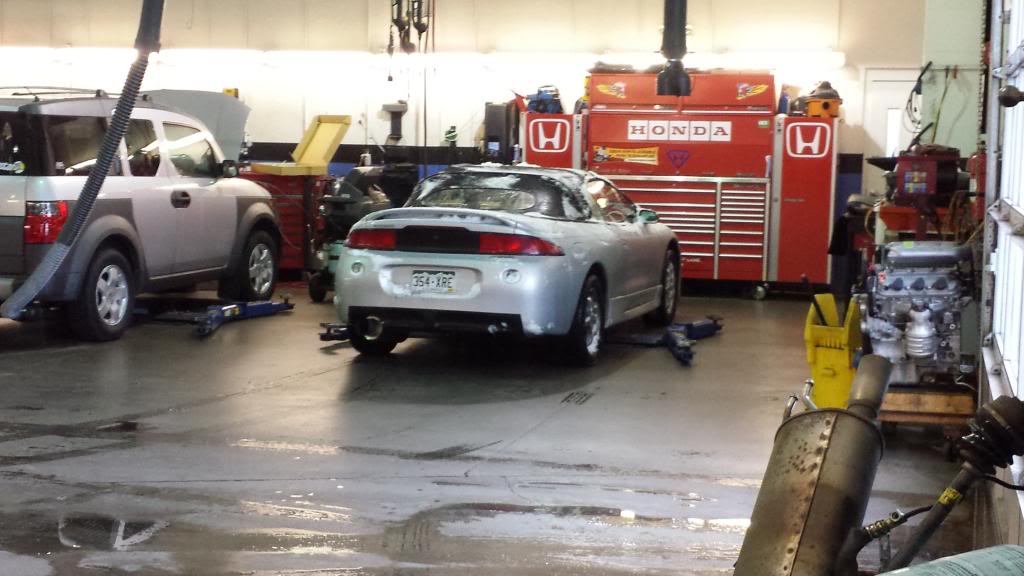

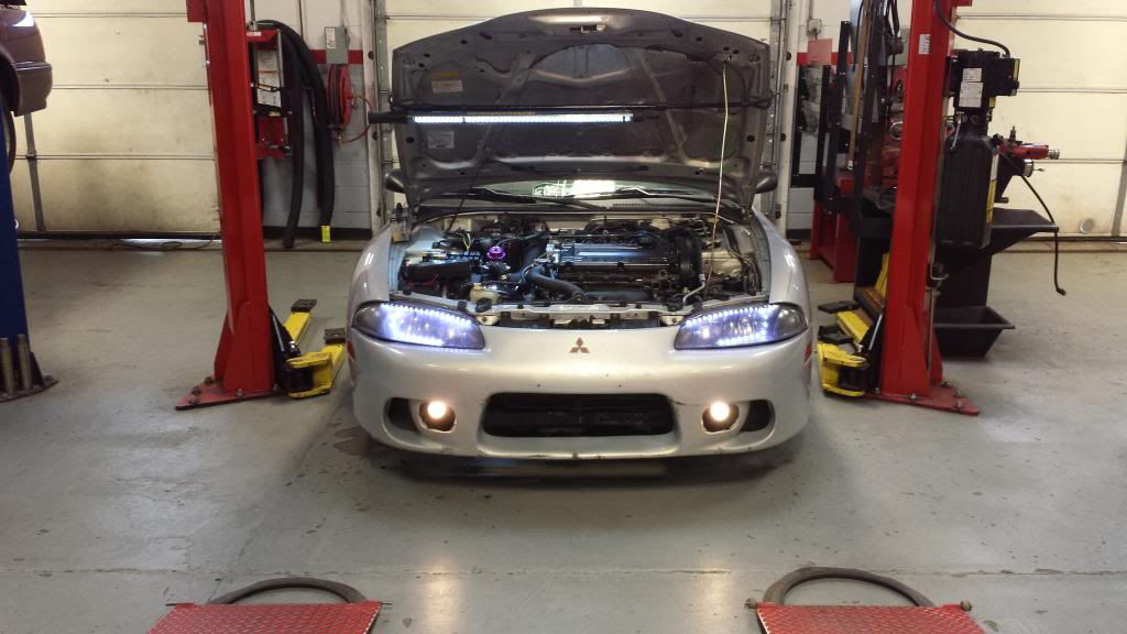

Yesterday it decided to snow all day, and work was slow so I decided to bring the Spyder in from the cold.
(not my toolbox or bay... would never stick those stickers on my set up)
I decided to attempt a washer sprayer swap with one I had from an Odyssey. It worked and atomized the washer fluid better than our oem ones. Gotta get another one now.

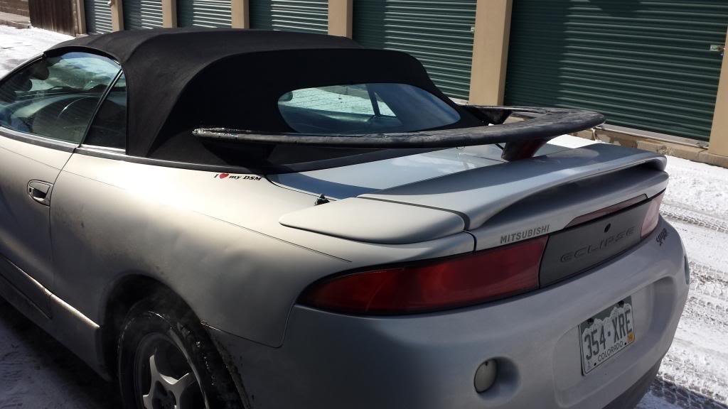

Also picked up a 2gb Talon wing from the salvage yard today.
