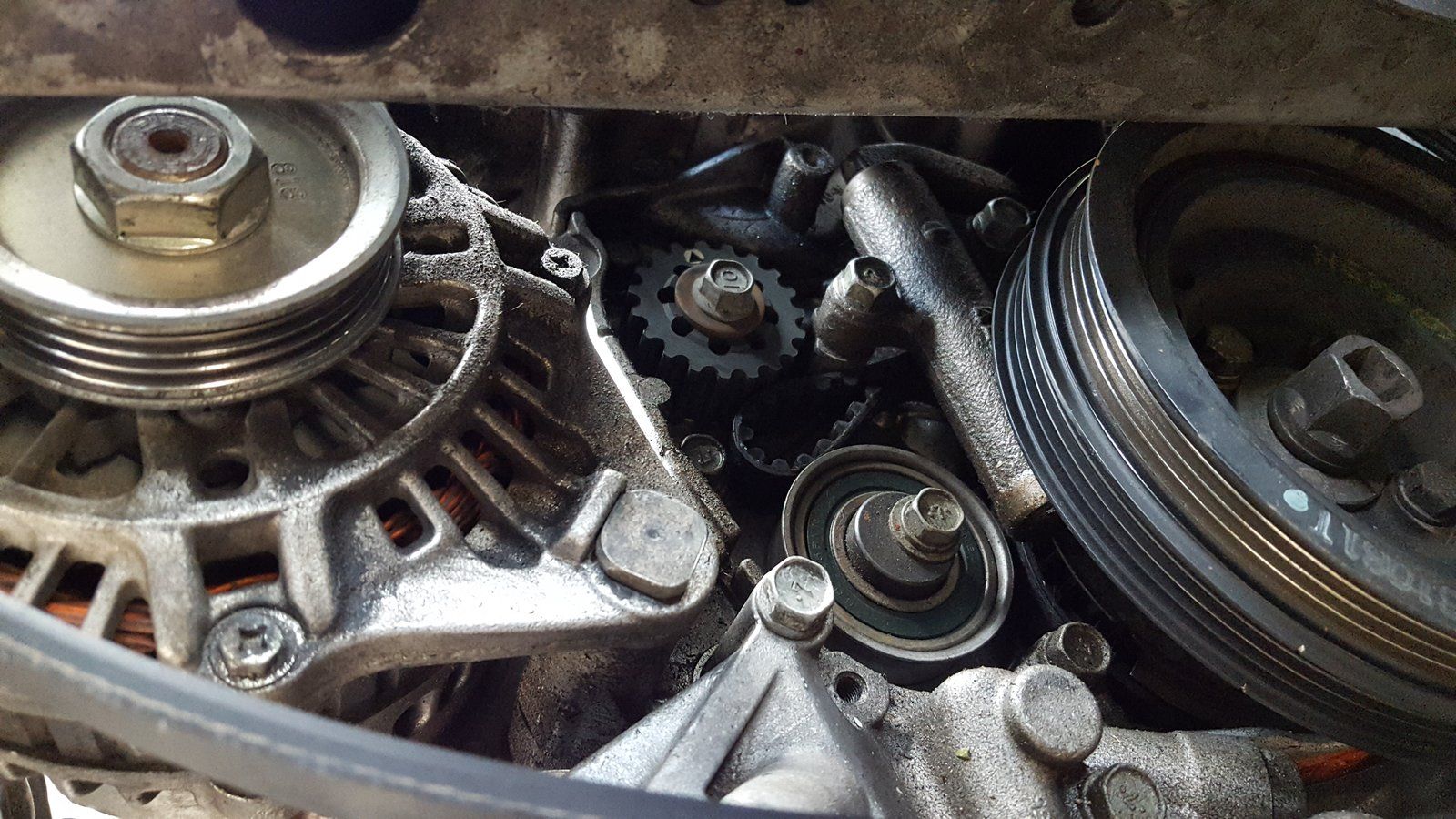

I had to do an oil change today and decided to remove the crank sensor that was making the horrible click sounds every time I push in the clutch, due to the crankwalk. Since I have the 1g CAS on the engine, the normal crank sensor isn't needed. Earlier this week I was driving to go have lunch with my wife, and heard a weird noise I couldn't even begin to describe, and my car seemed to act a little funky afterward, so I hadn't driven it until today. So as I was beginning to remove the harmonic balancer to get to the sensor, I discovered that my balance shaft belt broke, which had to have been the weird noise I heard. That has to explain the little extra vibrations I feel at random moments as well. So I got the broken belt removed along with the sensor and my car drives fine. Not the greatest on vibration, but it's fine for now. I'm planning to put my old 6 bolt back in before the weather turns cold again here, so that'll be coming soon.

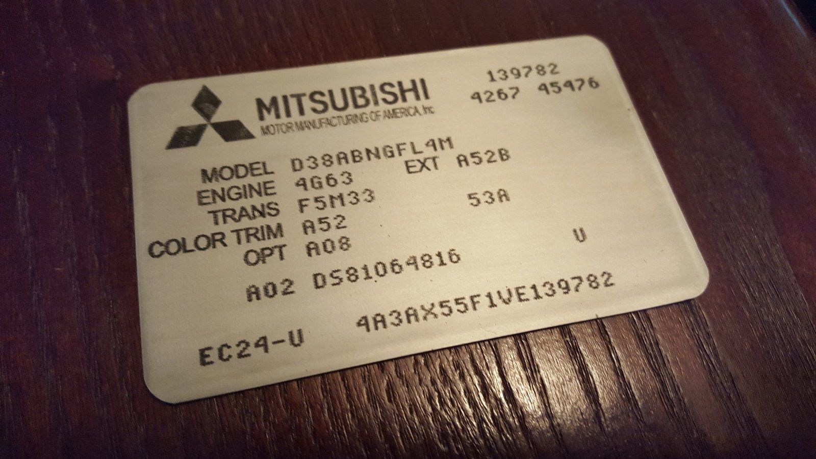

Little update, I'll be putting my old 6 bolt back in at the end of September, and I got my new VIN plate from Justin Drew today. Looks pretty good. Now just waiting on my paint to paint the driver side front fender.

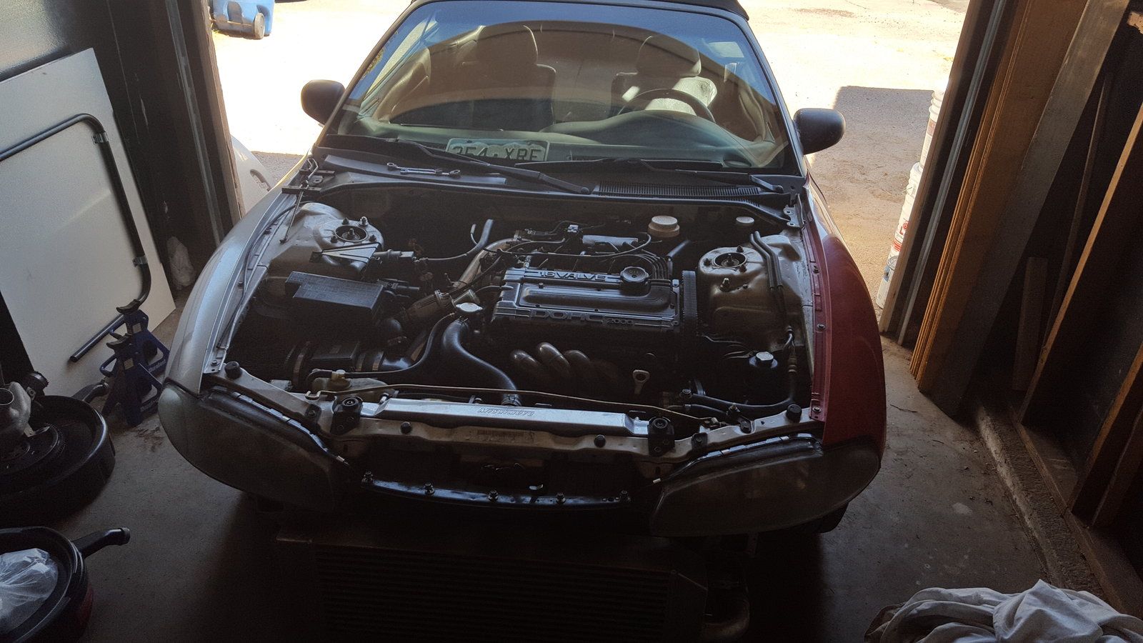

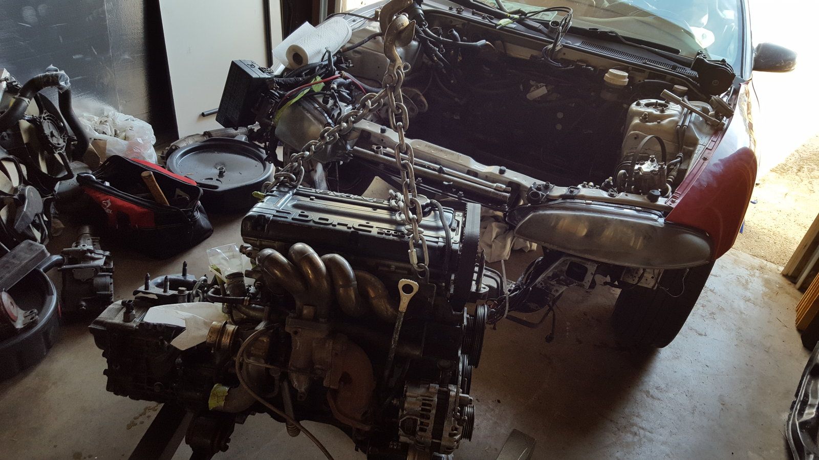

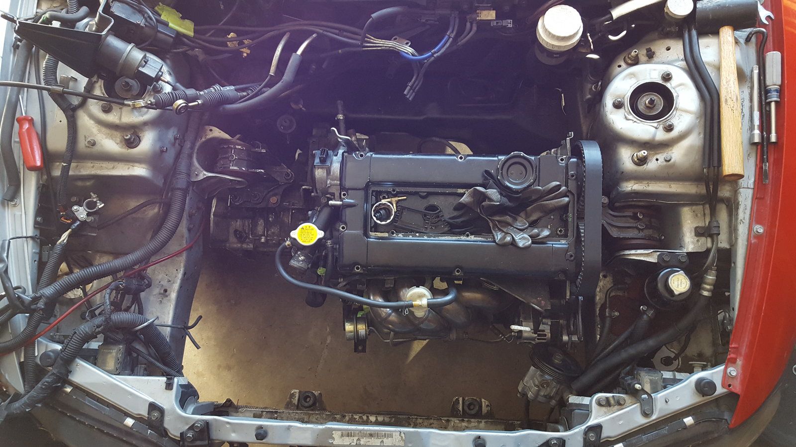

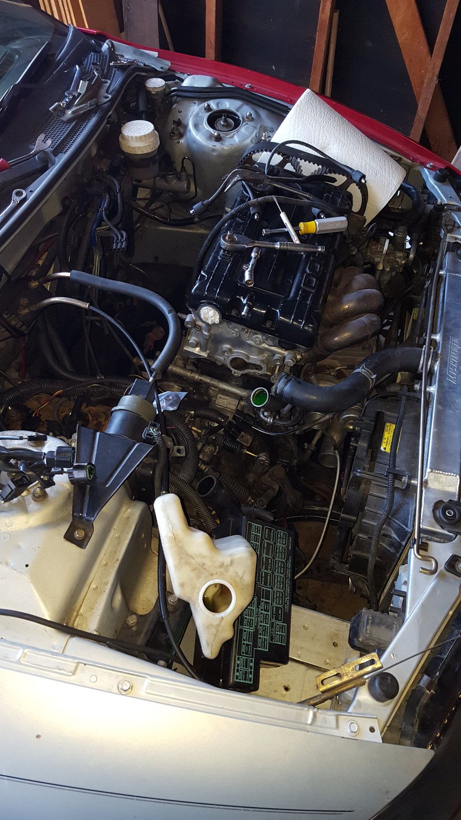

Getting set to put my 6 bolt back in starting on Wednesday. May take the 7 bolt apart, but haven't decided yet. Since my usual friend that helps me and had a garage for me moved, my parents have been nice enough to let me use their small garage. Hopefully this will be the last major thing to do to the car for a while, but it being a DSM, that's subject to change. Will most likely take pictures like always, may post a few.
I've also decided to put my smic back on along with its' flex pipes, put my fog lights back on, and a few other things. I don't remember why I decided I was going to do this, but I figure if I don't, I'll remember why later, and wished I had but won't have the time to do it again.

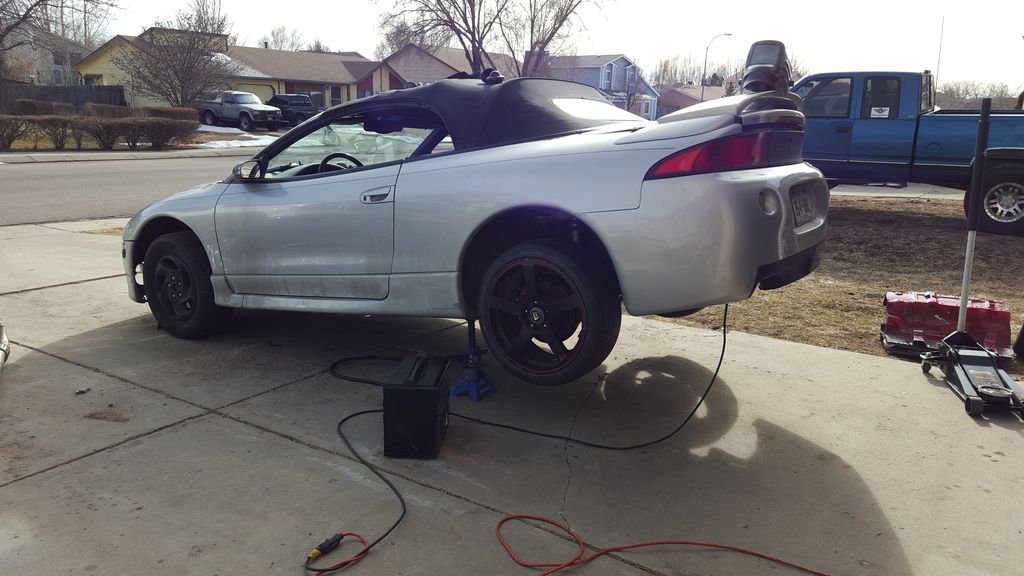

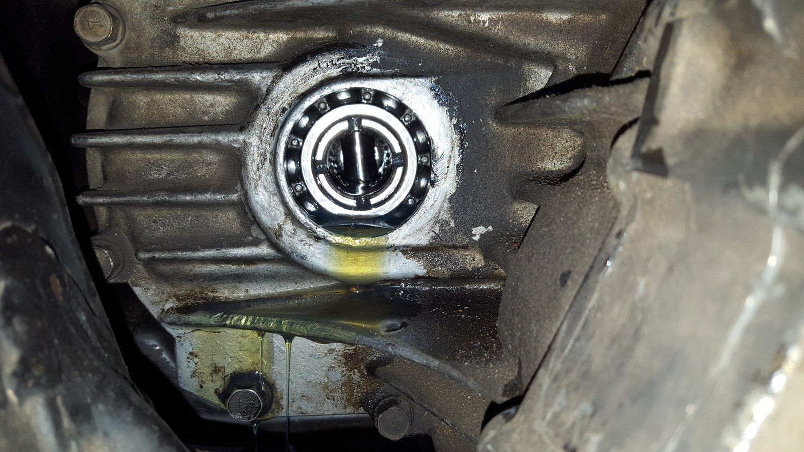

Got everything finished up this morning, and got it started. Only one problem remains. The passenger side axle seal started leaking gear oil after I filled the transmission. So I ordered a new seal for both sides. Will have those tomorrow and replace both.
So the seal I ordered, even though it was chosen from the AWD menu, turned out to still be for the FWD transmission. So, I have ordered the correct, yet over-priced, seal from ExtremePSi. I'll have that in a week and then can get the Paperweight back on the road.

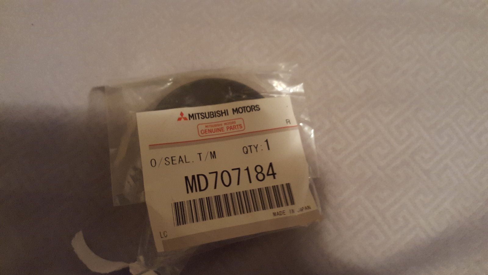

Got my seal replaced today, but guess what? It still leaks...!!! FML...
Old seal was loose enough to rotate by hand, but everything looks good inside from what I could see.

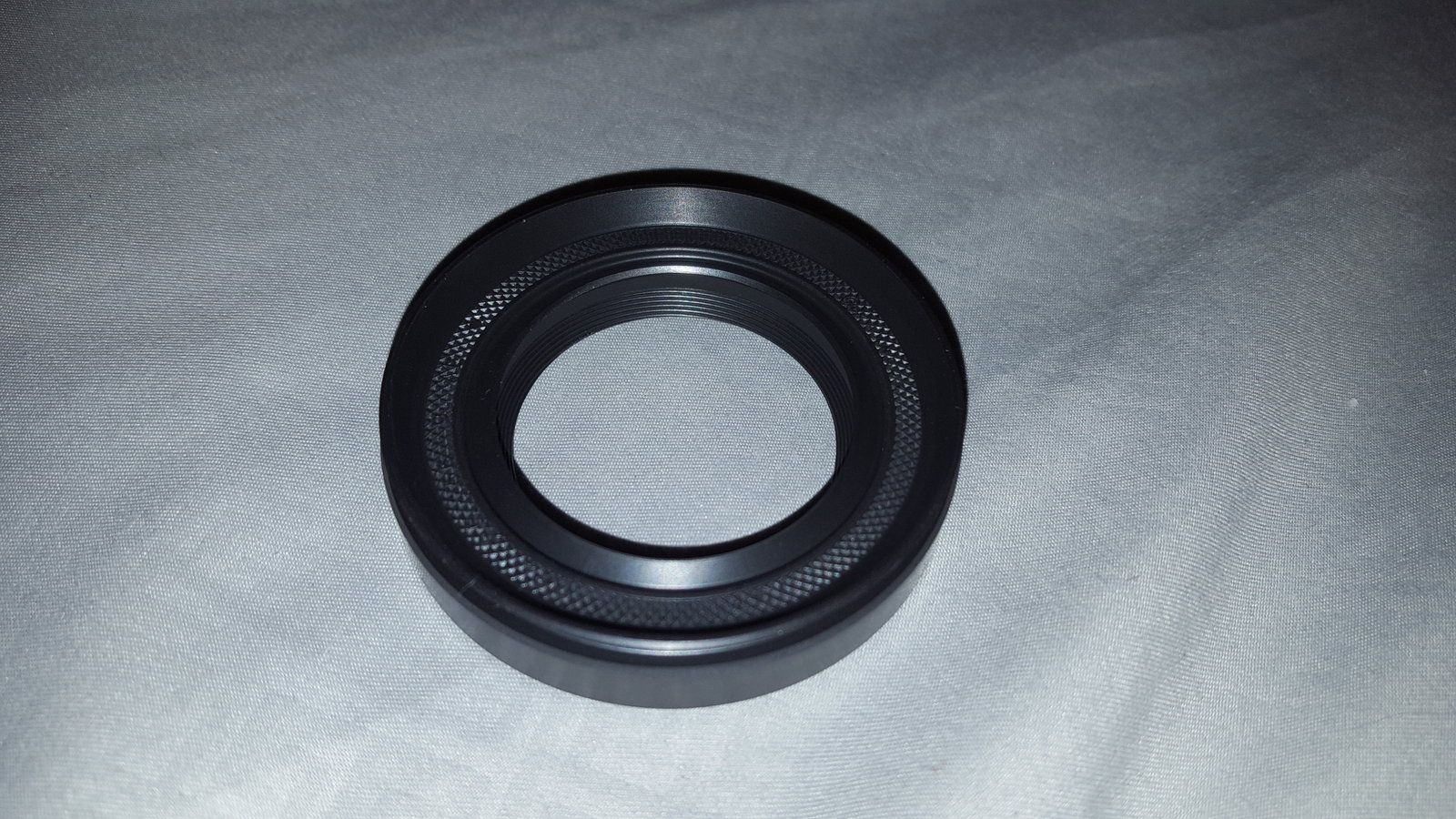

This is the new seal from ExtremePSi: MIT-MD707184
Based on what I've read so far, it looks as though I probably pushed the seal too far into the transmission casing. I made it flush and it shouldn't be. Guess I should have researched that prior to wasting a seal.

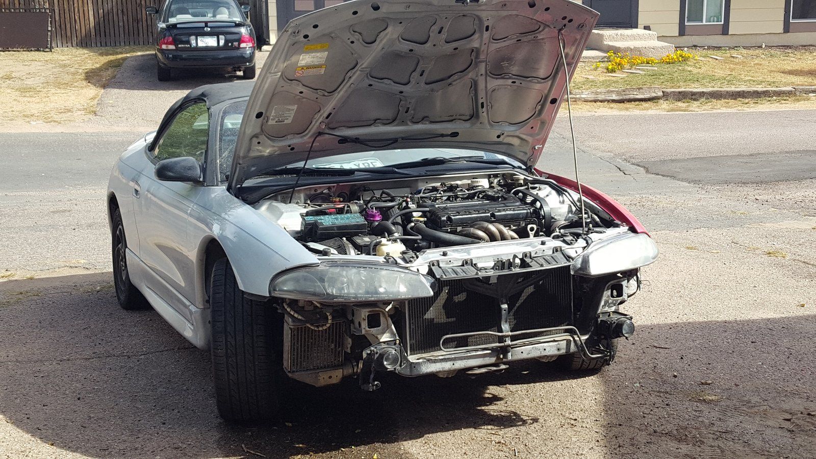

Removed the VRSF FMIC. Even though I love the kit, I'm going to sell it. I'm looking at getting the one from Punishment Racing so I can keep my fog lights with the FMIC, unlike the VRSF kit. That's the only thing I don't like about it. SMIC is back for now.

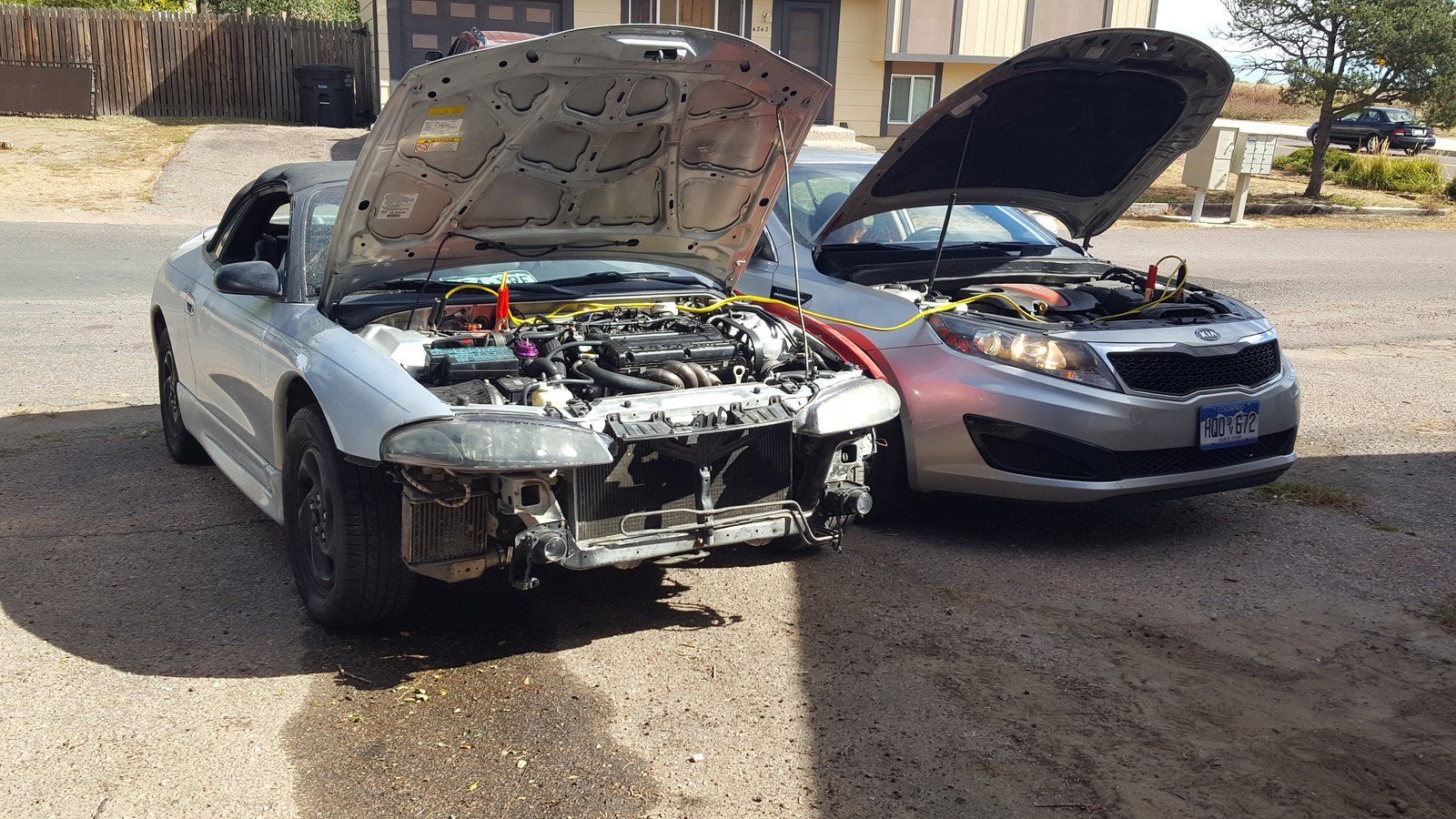

Had to jump start my car :(
Update to the last issue. I ended up buying another new axle seal for the passenger side. After doing some reading, I realized I probably pushed it too far into the transmission. I made the outer seal lip flush with the trans casing, and apparently, that was wrong. With the 2nd new seal, I made sure I didn't install it flush, and the subsequent test drive was great until the end. The seal worked out, no leaks since. I did buy a new axle seal for the driver side as well.

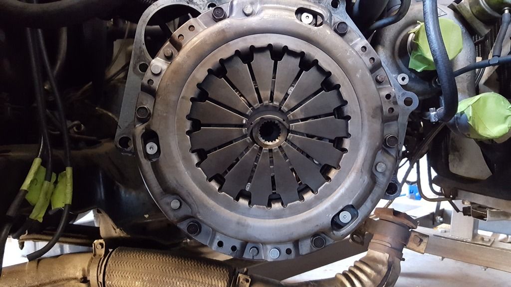

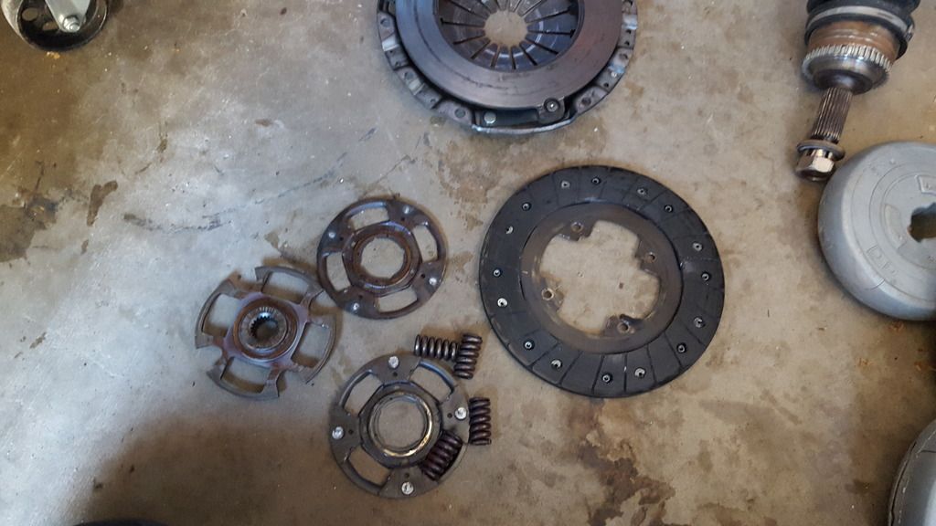

I say the test drive was great until the end because when I got home, I could hear a couple unusual noises. It sounded like there was too much ticking coming from under the valve cover (which I haven't heard since), and a loud scrapping coming from the transmission area. When driving through my apartment parking lot, it felt kind of notchy while shifting from 1st to 2nd, and when in reverse. The following day, I decided to go get a new alternator belt since mine is a bit old, and the alt keeps squealing regardless of how tight or loose the belt is. I barely got 2 miles down the road and the scrapping came back louder and I could no longer shift. I called a tow truck and got my car home. I'll be pulling it apart tomorrow to see if one of the clutch components failed as it had been mentioned on another post. Hopefully that's all that failed.

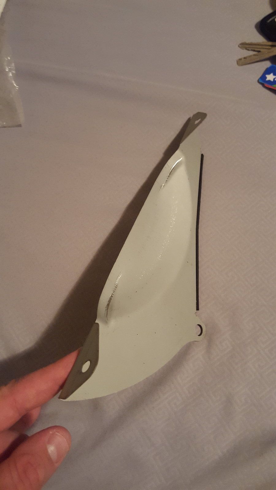

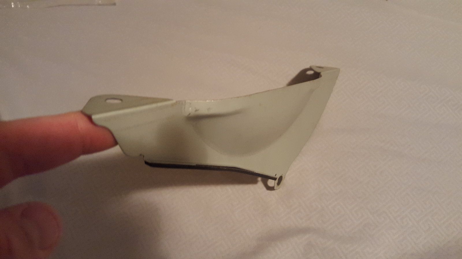

I'm not even mad, kind of impressed. I've never seen this before in person. I think it was a defective part because I don't drive my car hard enough to explode my clutch disc....
After pulling the transmission out, I saw that the ring around the splined part had shifted down, then all the parts just fell out after I unbolted the pressure plate.
I got 80% of reinstalling everything done yesterday, and finished up this morning. Got her started and test drove after a letting her warm up for 20 minutes. Drove great again. Also replaced my alternator belt so I no longer have that squealing like a pig.

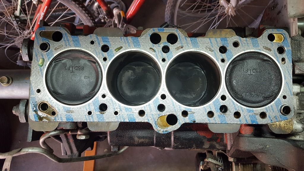

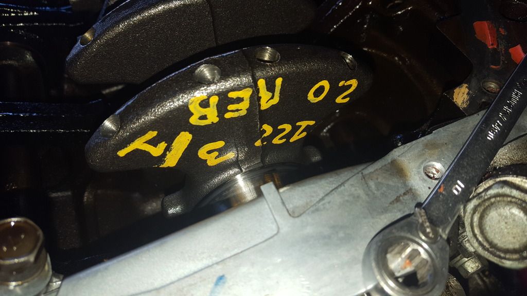

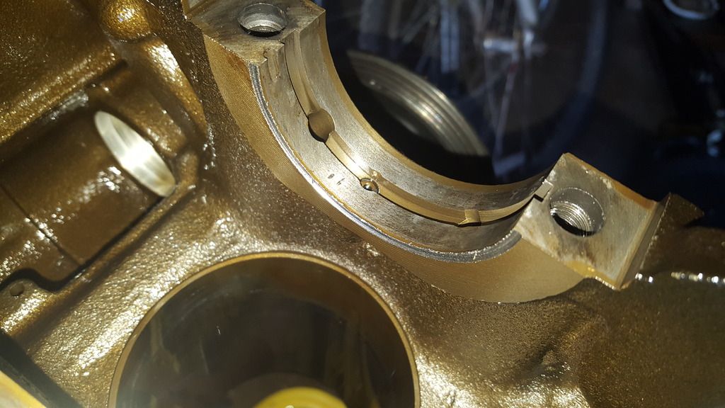

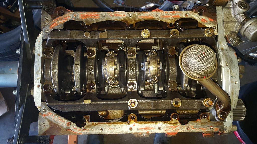

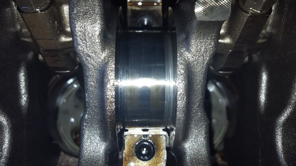

I finally got around to tearing my crankwalked 7 bolt apart this past Thursday. Upon first glance, I thought the block would at least be salvageable.

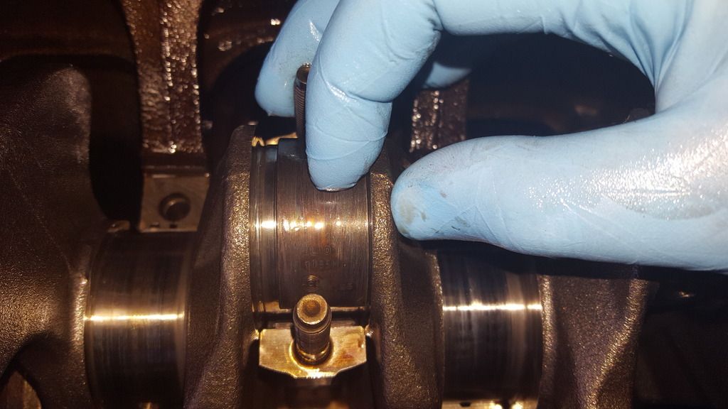

Sadly, that was not the case. The crank did wear into the journals and I didn’t see it at first. It’s noticeable in this picture:
Three crank journals had this wear grove in them on the block side and the girdle side. You can also see how much play it had in the video.

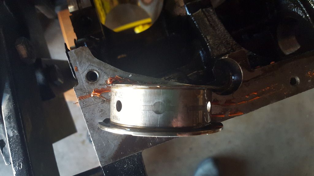

Here you can see the gap between journal and crank on the thrust journal.
And here is the block half of the thrust bearing, the knife edged side was facing the flywheel.
I also think the rods were too narrow, maybe someone can verify….
This however, may have been what caused the crankwalk. Looks like the crank came from a salvage yard. Perhaps someone didn’t know better, and took a gamble on a bad part.
