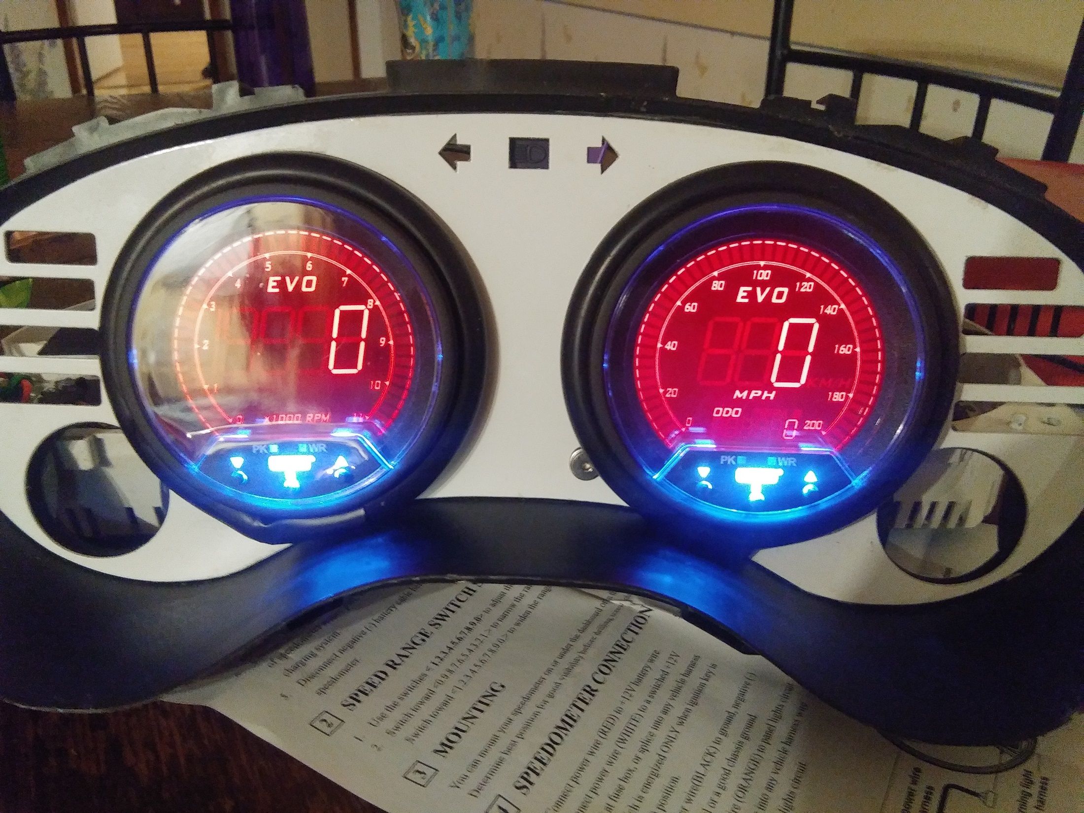

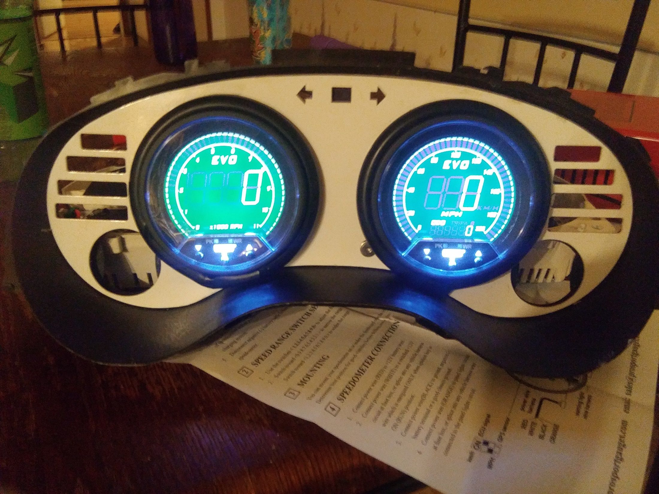

It's been an issue for almost 3 years now I've chased it and failed so I decided to go a new route with a really responsive gps sensor. I have a lot of things I still need to sort out and I'm ready to get it permanently fixed. I'm sure you are right about a wire or connector somewhere I'm just done chasing it.
Benefit to the GPS unit will be accurate speed regardless of wheel/tire size.

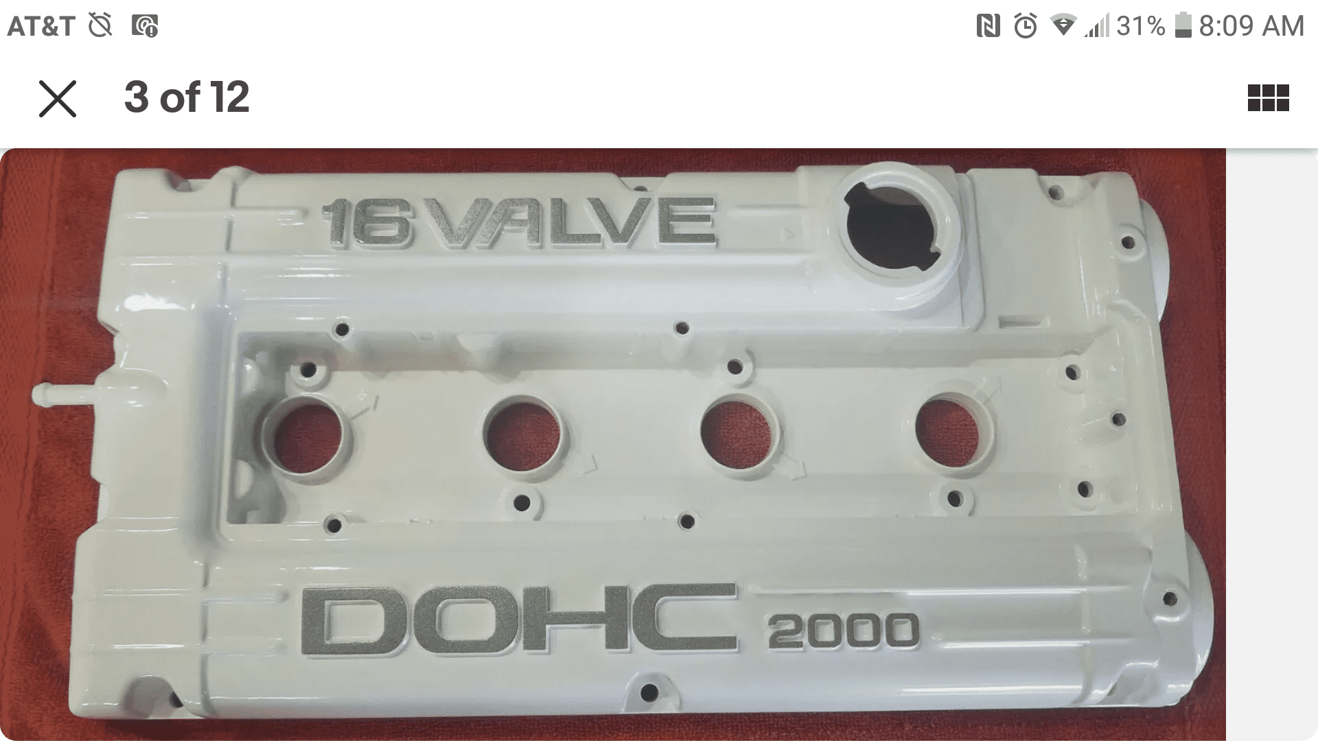

The next change i will make is a new powder coated white valve cover and a billet plug wire cover, billet half moon plug, and oem gasket. I look forward to posting the new pics. The powder coater should be finished in the next week or so.

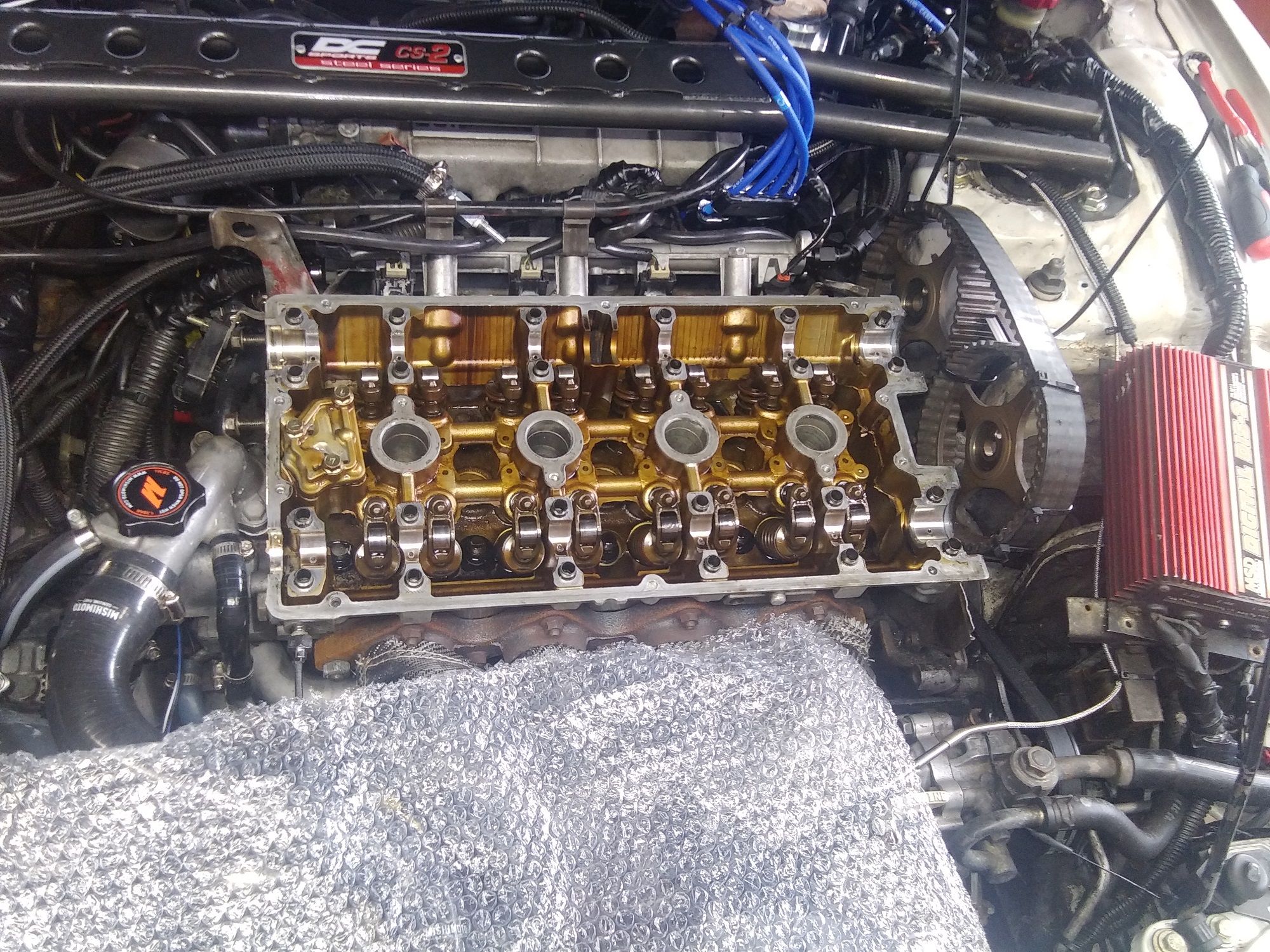

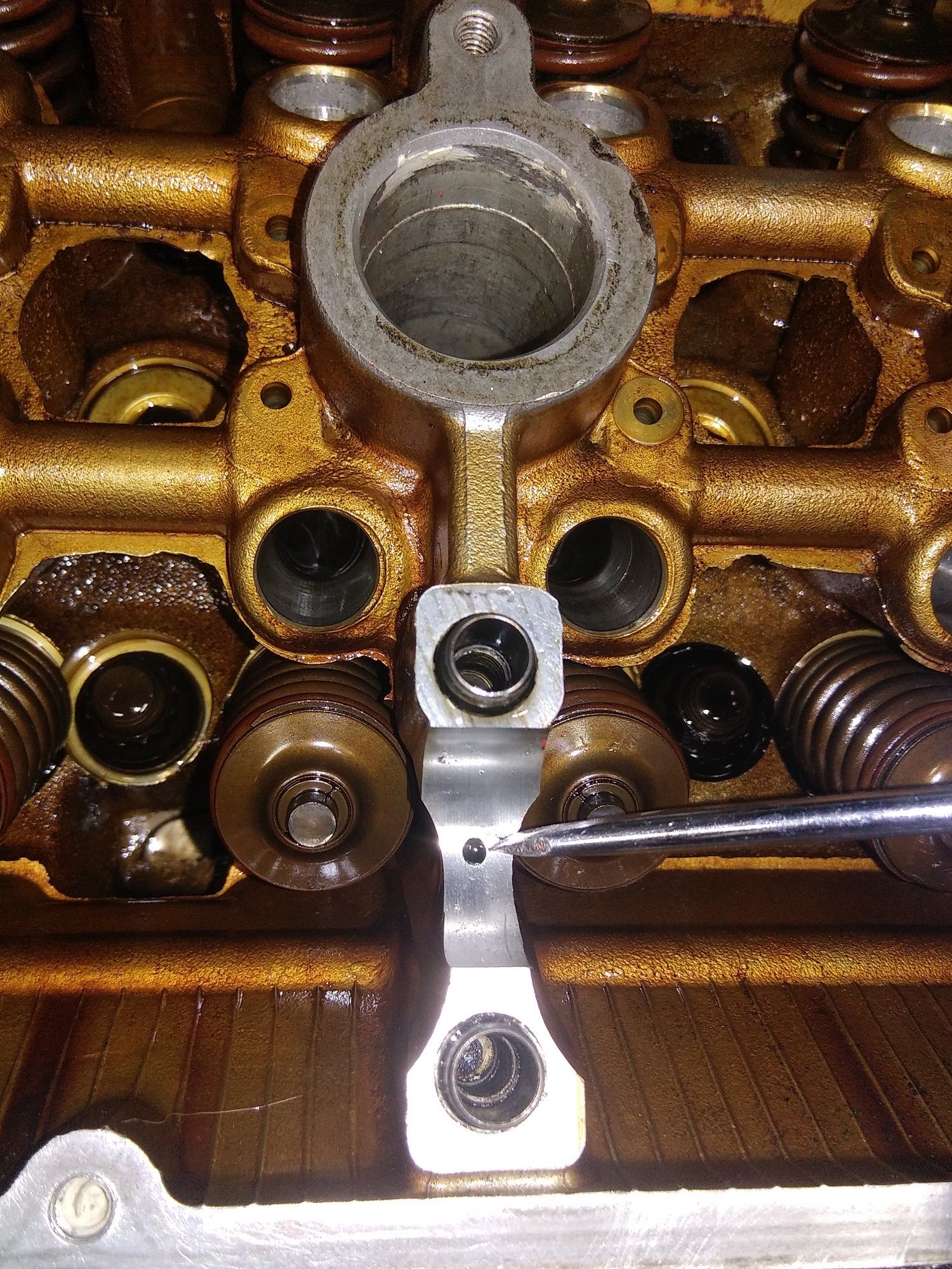

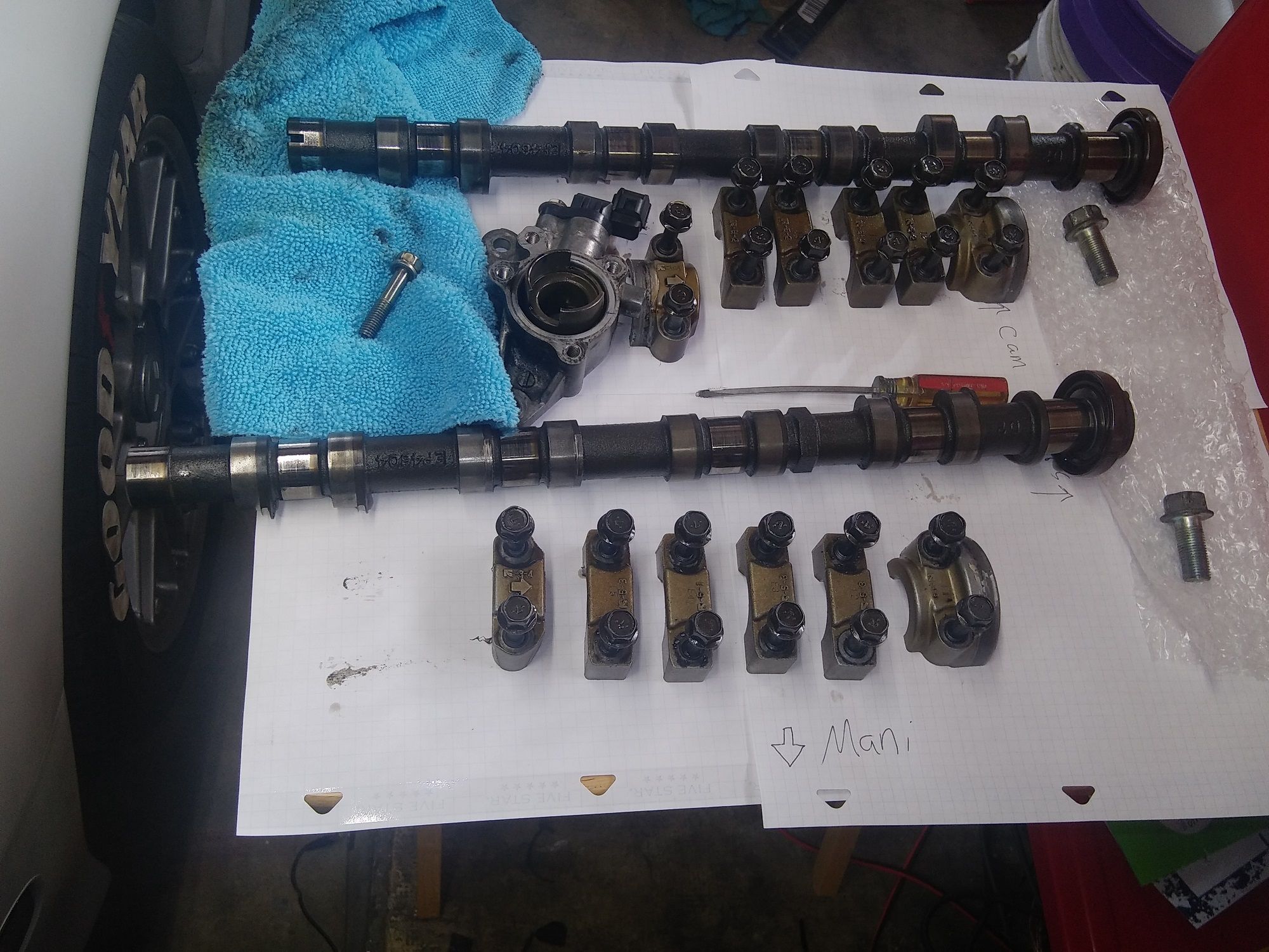

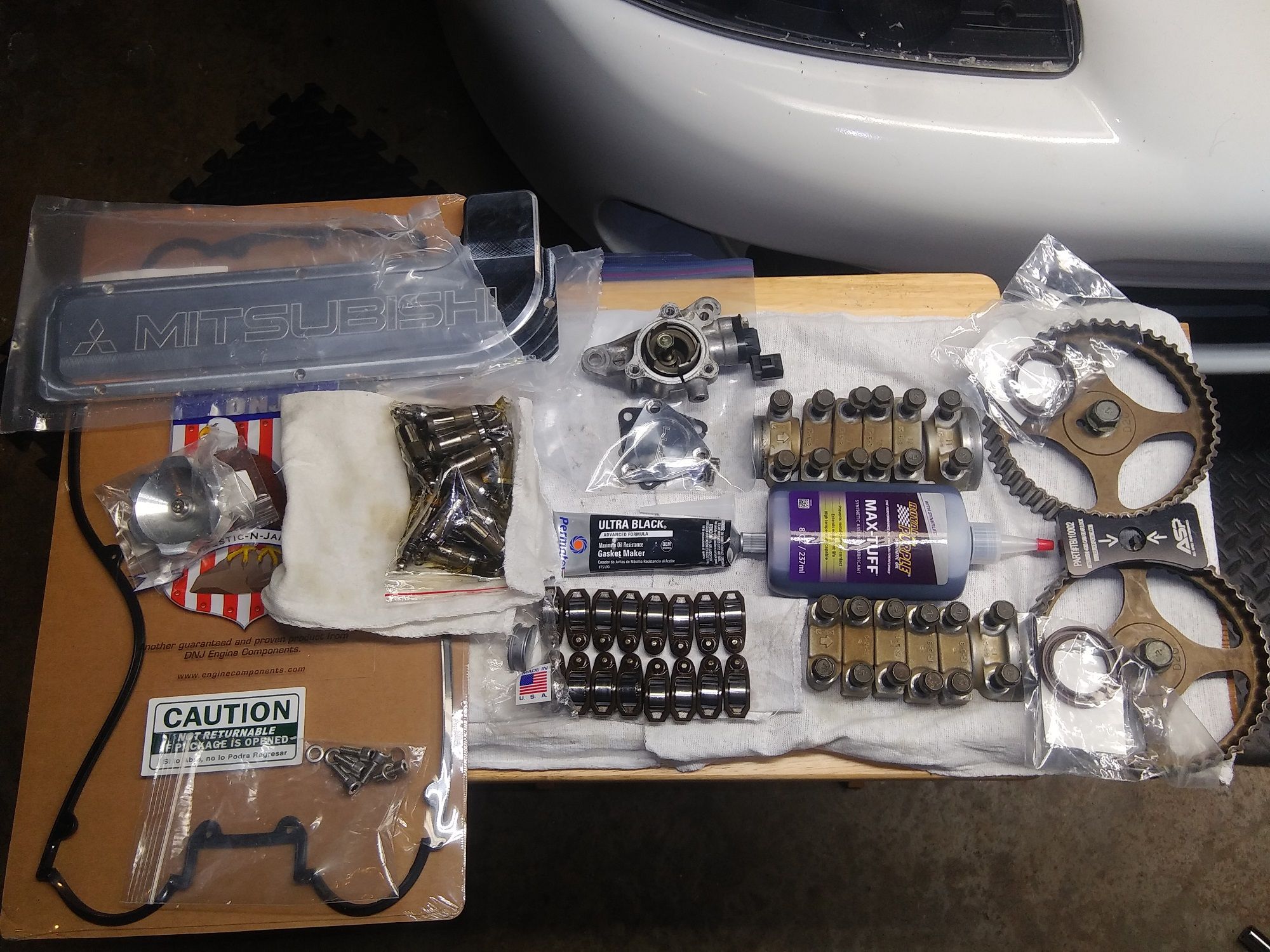

Pulled valve cover to prepare for my new ceramic coated one being professionaly done. Noticed some rounding to the cam lobes. I replaced the oil pump and oil sump and got ahold of some 276 Crower cams. Valves are still in good shape. Got some better springs and retainers and need one new rocker. Seems like a good opportunity to upgrade the head needing these parts anyway.

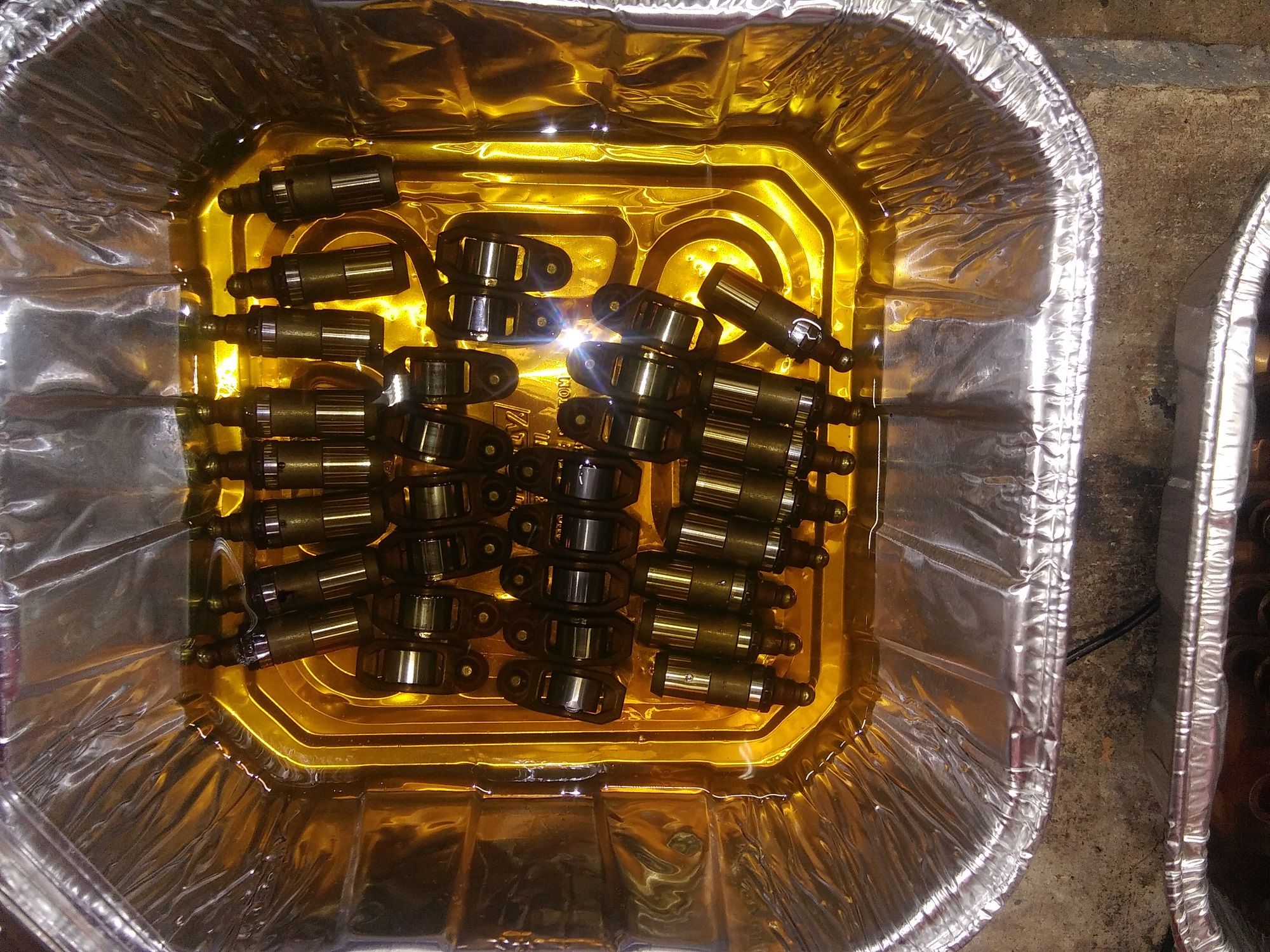

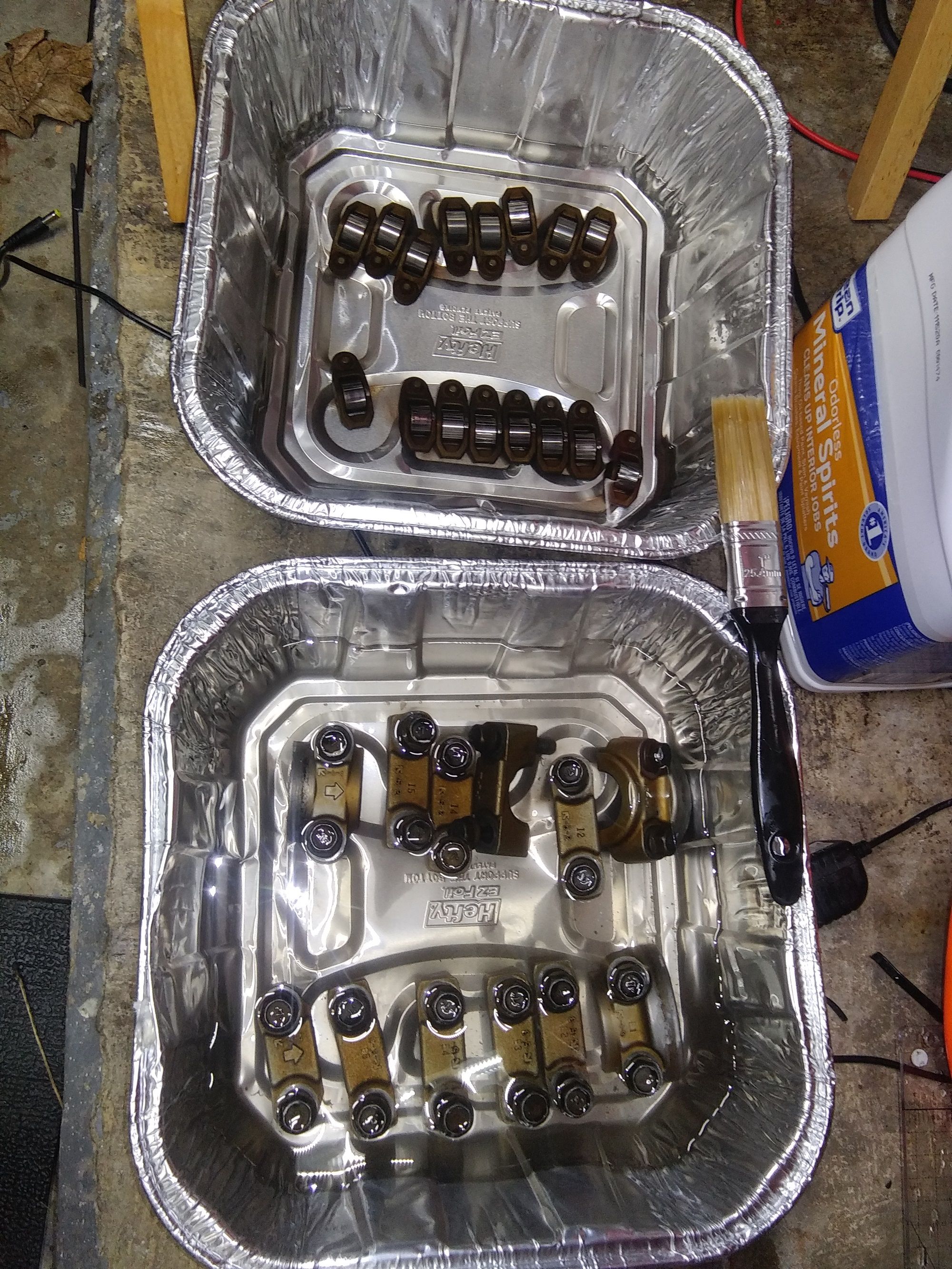

getting everything cleaned up about to run and get some mineral spirits to clean the cam bearings and journals roller rockers ect. I'm a little disappointed that only my cam seals showed up today oh well. I bought one of those cam gear locks and that thing was worth every penny. The cam journals have never needed to be smoothed up before or after my most recent rebuild. I guess the oil ports are just very functional still. But I did put in a new oil pump and sump which after inspecting didn't look bad but this is my baby so I'm going on the safe side. Got one more day off and fingers crossed they show up tomorrow.

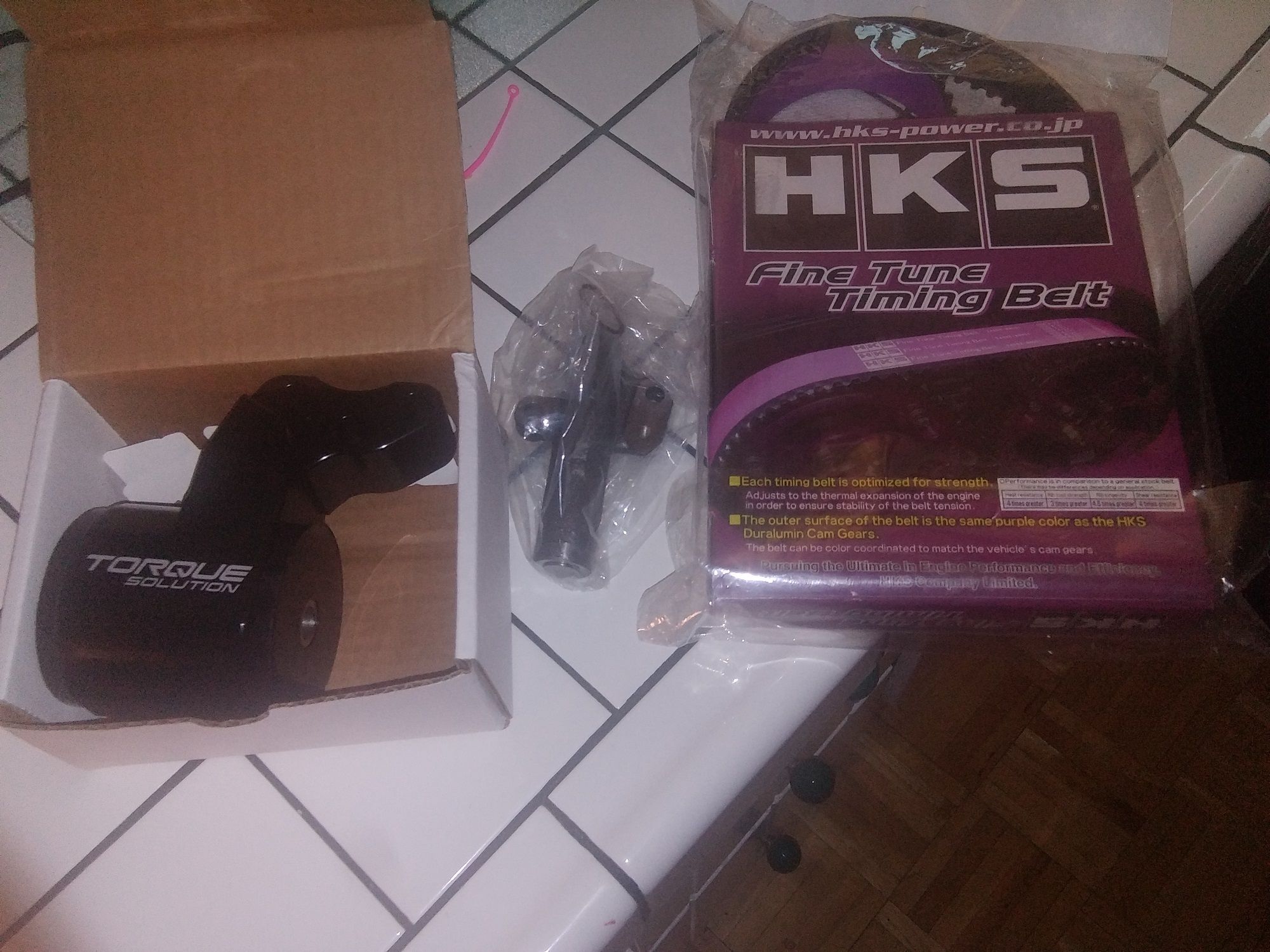

ordered all my timing components today. Camshafts are taking forever through STM. still waiting on the new valve cover too. I went a bit over board on the timing belt as I chose to run the HKS belt. I feel much better knowing the timing belt will take way more than my setup can handle. I don't want all my hard work being destroyed by a simple belt. Im going to post more once the other parts arrive. I should be able to raise the hp a decent amout. with
The wait continues for the cam shafts. The head is back in the car with valves reseated and cleaned. I had cleaned my lifters had them soaking and decided last night to a change for the head rebuild. I am currently running 1g lifters or i believe them to be because of the coke bottle style cap and the tiny weep hole at the top. I have ordered a set of the 3rd design lifters. The 1g lifters may be fine after a good cleaning as i have done but i really want to try these out and see what all the fuss is about :hmm:

Thanks man i think if i could go back i would have gotten the kelford shafts, they must be good if you and Marty use them. But i got those 3g lifters going in new torque solution motor mounts and a really nice timing belt goin in with those cams and the head should be solid. I had to get some timing parts because i neglected changing the tensioner and timing pulleys after putting in all new bottom end parts. Never changed those on an internal rebuild. I feel kind of silly in retrospect. Should be fun and reliable when im done, I'm ready to finally put some miles on that thing.

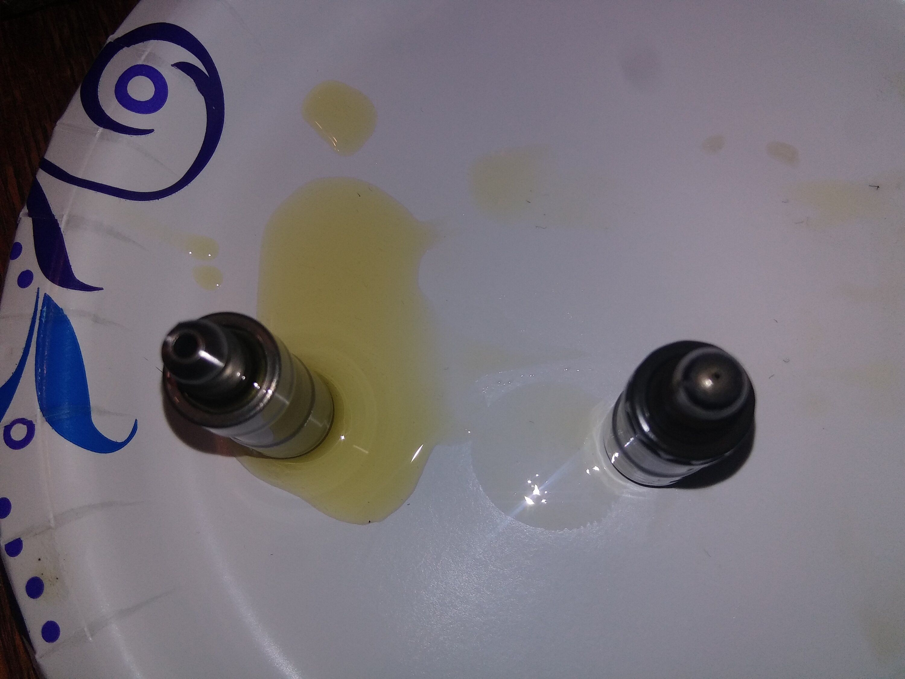

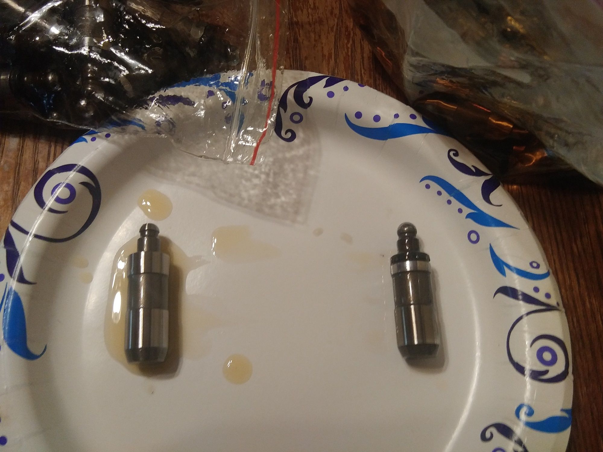

The 3g lifters came in the other day. Heres a brief look at the differences of the 1g lifters (Right) and the redesign 3g lifters (left). From the experience of both I have found the 3g to be quite a bit easier to bleed. The 1gs have a very small oil hole and easy to break a needle off in while depressing the inside to bleed. Though I have not tried them out yet do to the ongoing no camshafts issue, I think these are very nice solid lifters that will make a great addition for the head rebuild I am in the process of doing. I gave about 100$ for the set which surprised me.
The 1g lifters were not collapsing all the way when bleeding or after removing the bottle cap and doing a good cleanout, I have 4 that are like this. If you are having a similar issues these seem to be a great replacement if you need a set.
Called STM got some annoying news that my camshafts are on back order and will be shipped directly from Brian Crower to reduce shipping time which is awesome. Problem is the ETA is April 4...
