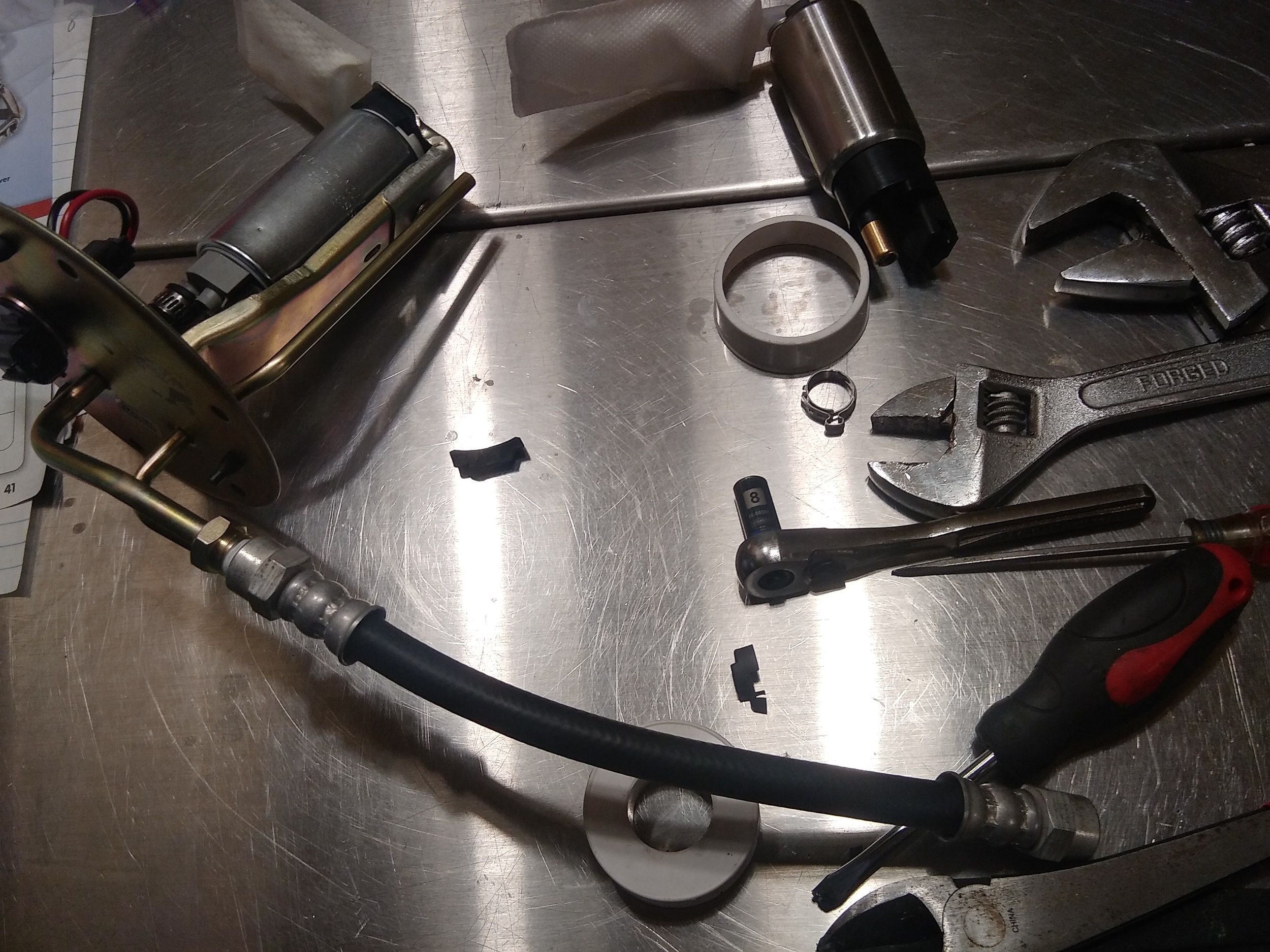

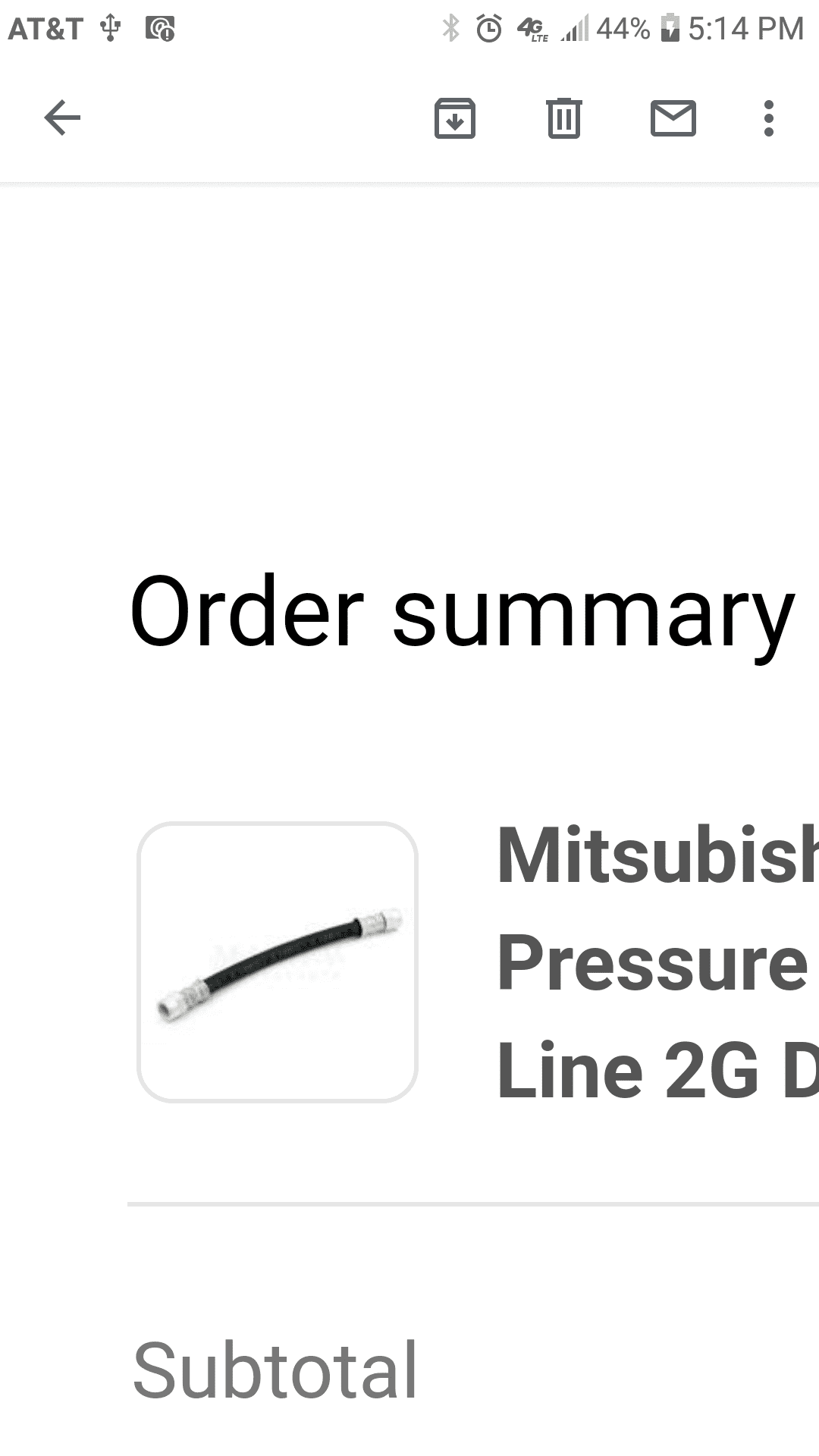

made some headway on the fuel leak issue ended up being the high pressure line right off the fuel pump hanger. Not sure if anyone else has had issues with this line. I was going to make my own but hydraulic hoses and fittings available at the shop i work at aren't rated for fuel but I did find a direct bolt on line available on Mach Motorsports. It's a bit pricey but I guess I just wanted to make sure I got something that would work.
I was a bit surprised myself. I usually have to custom make some stuff or buy different odds and ends together to make it work. I'll be sure to update after i get it and install to share how the quality is. I'm pretty much just taking a gamble on it, I've never bought from that company before.

The high pressure fuel line i ordered came in and i picked up a new fuel pump hanger as i damaged the original the last time i removed the pump. The hose is a direct fit so its the real deal. got the walbro attatch and hope to be running soon.
