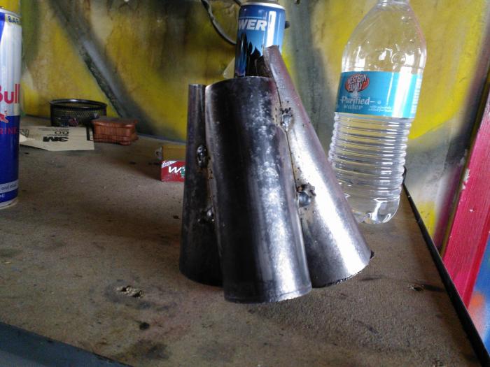

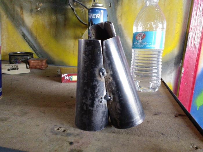

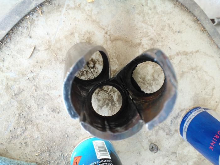

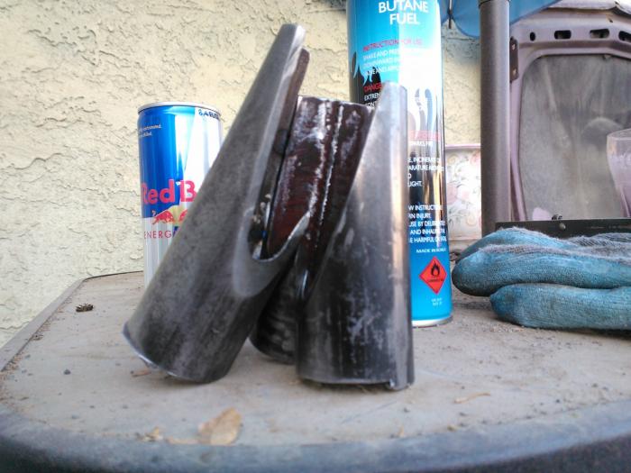

I started playing with some 1 1/2 pipe making a collector and decided that it is just to big of pipe. I am going to take these back and get some 1 1/4 bends, pretty bummed really wanted to get some work done. I did up the DD boost 2psi to a whooping 12pounds today :hellyeah:.
Hey got a little update for you guys, its not much but I am pretty proud of the product so far. I started trying to make a merge collector a few days ago (have a super old wobbly chop saw), this is what i have came up with so far. The angles are not lining up real well but i think it will work.
some pics....Be nice guys haha.
Haha nice looking project, Iam actually doing something similar as well rwd wise, I have't made a manifold before but hope to do so for my project as well. The manifold needs a bit more work but Iam sure it will look 10 times better once complete. Good Job so far and keep it up !
Thank you im glade you like it. I hope it turns out 10 times better :) I might end up buying a new chop saw and make a new one. I had made some nice ones but I only turned the pipe 60* after first cut so it made a 3-1 instead of a 4-1 collector. Practice makes perfect ;).
Things are really starting to come together. I'd really prep the metal before you tact anything together. All that paint and crud will cause pin-hole leaks and will lead to cracking. And I'd possibly look into purchasing a merge collector pre-made. I also plan on building a manifold and that's the route I'm going to take, it'll save a lot of time and headache. Anyway I'm really digging the build, I love these old z's.
Thanks for all the tips. These were some pieces I has laying around that I wanted to play with. I am going to buy some flanges because I don't have the means to cut some out nicely, but I think with a better chop saw i can make a collector. Hell this chop saw wouldn't cut threw all the way so I had to finish up the cuts with an angle grinder. Plus the whole thing will be welded with a flux core wire feed from harbor freight :). I plan on saving money sending off the manifold I make to be copied (and improved) in stainless in the future. This is all new all but a great learning experience.
