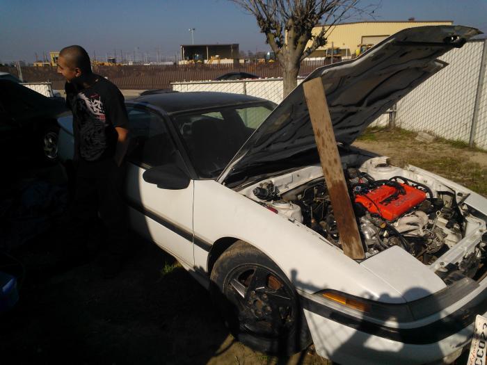

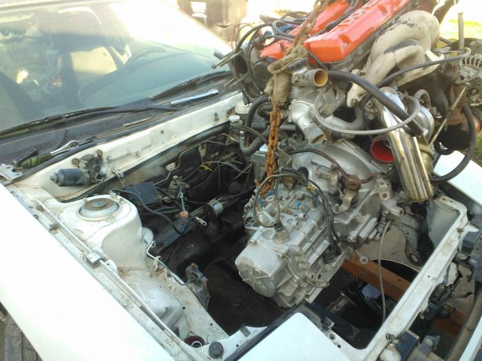

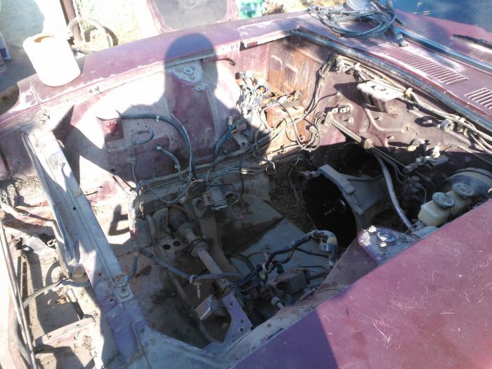

I have pulled the L28 out and have done a little clean up in the engine bay but thats about how far iv got.
The donated 280 :)
Out with the old
Little Paint

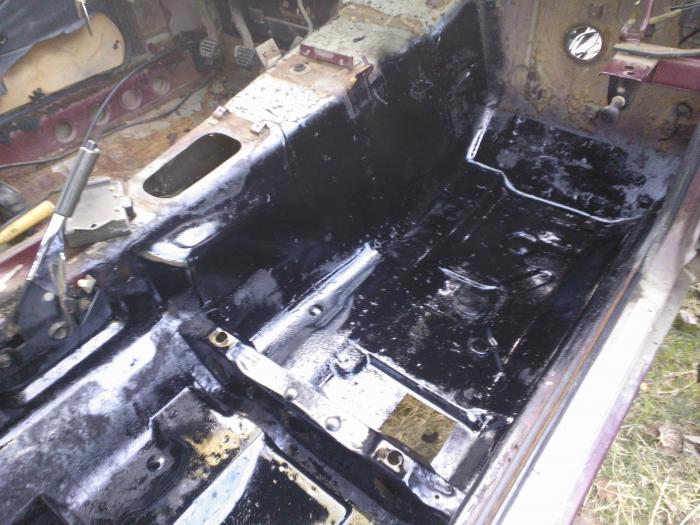

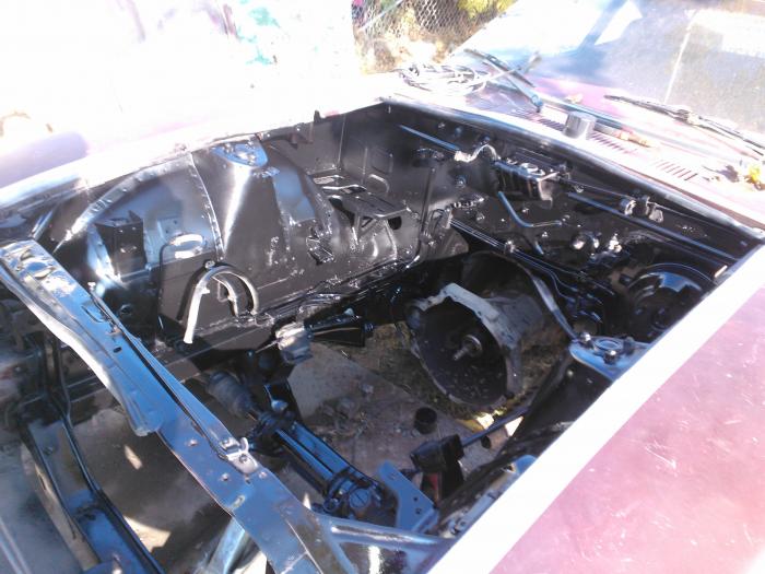

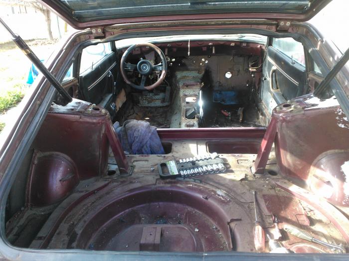

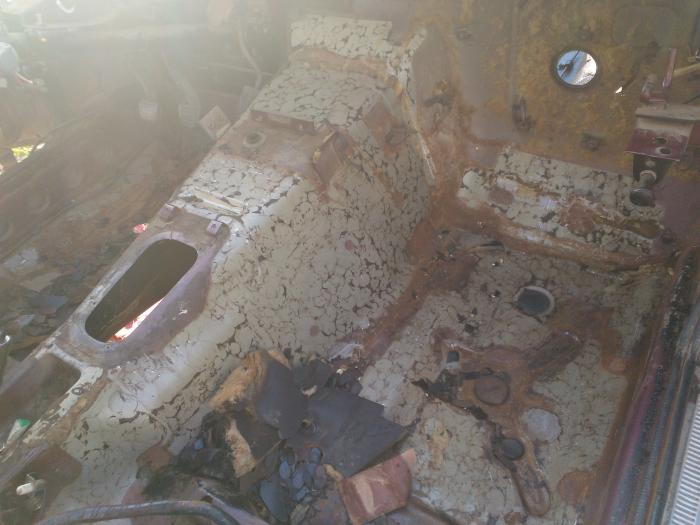

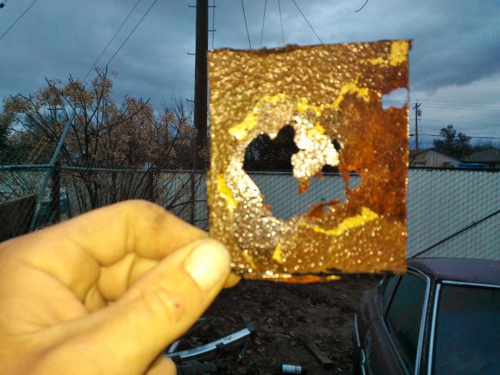

Well I got some time to mess with the car the other day. I got the dash pulled out along with the rest of the engine harness and chassis harness. Pulled back the carpet (what was left of it) and found some rust on the floor board, most of it surface but it did have a nice hole through it.
Got most of the sound matting off (stuff is on there way better then the gst's).

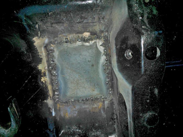

Cut out the rust hole and threw a little paint after i cleaned up some rust, dont want it to get worse.
My patch job :p...sorry about the pic from phone

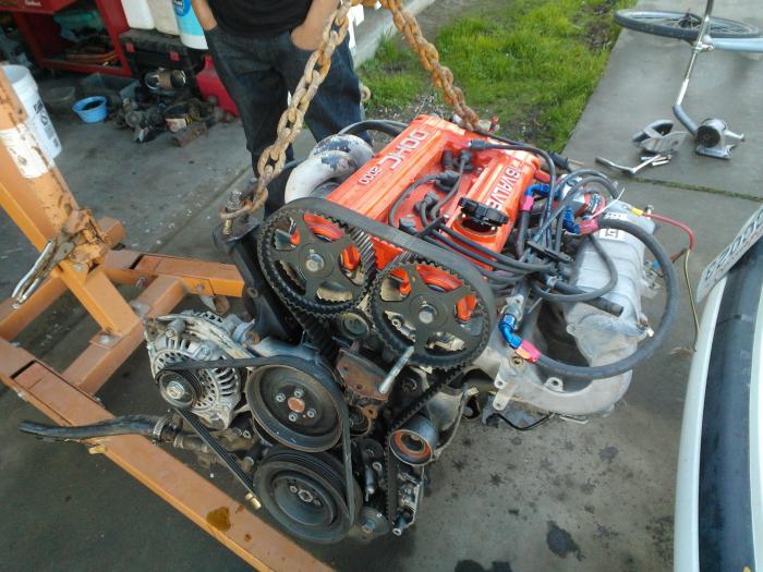

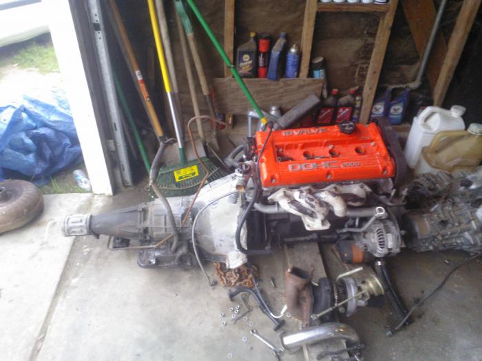

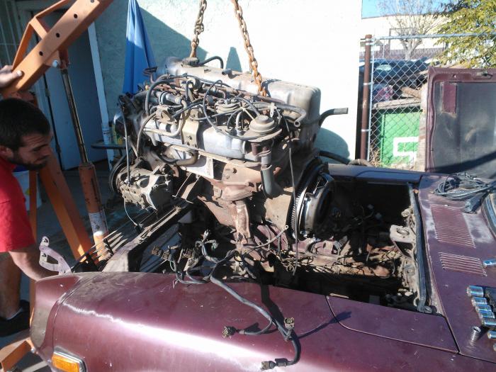

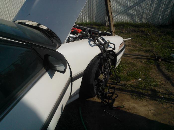

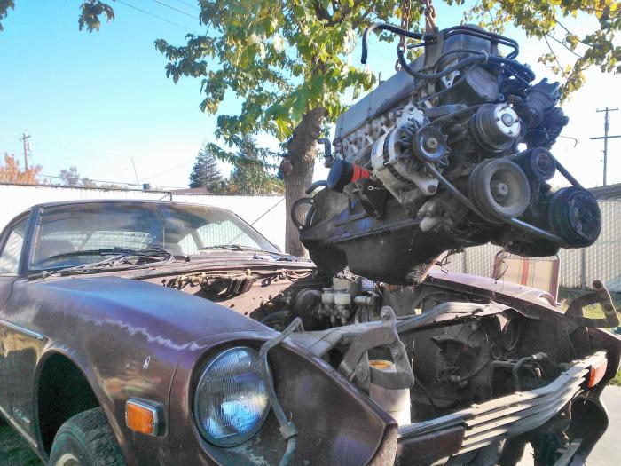

Ok so i haven't done much on the car, been busy at work and other projects. I did pick up a powerglide trans for dirt cheap. So i got the rest of the interior pulled out of 280, and the motor pulled out of the 1g. Been playing around with how im going to mount the turbo and it looks pretty good just fliping the 16g around. Waste gate actuator clears block by a long shot. The outlet of the turbo is at a funky angle shooting toward the block but i can work with it
Its naked!
My car throwing up the harness.
First pic i think i posted of the car not just engine bay.

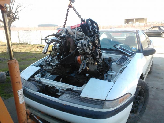

Few shots pulling the motor.

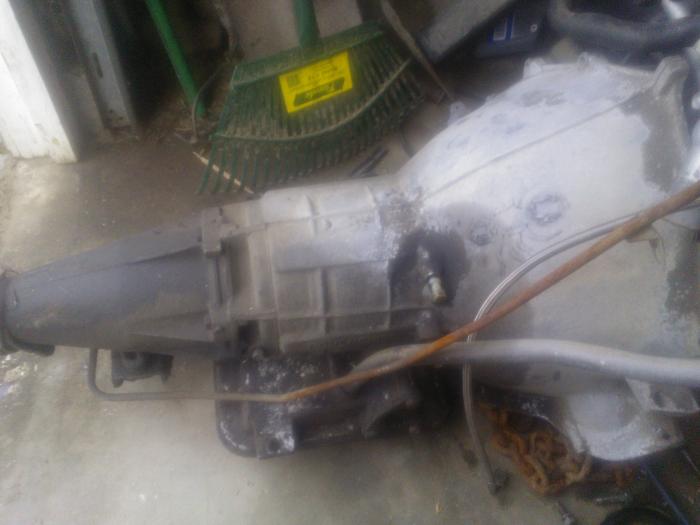

So I picked up a powerglide for 75 bucks thats one more step closer. Its a newer trans (70's i think) aluminum housing, its pretty light i can pick it up by myself.
Its not much to look at but heres some pics
Wish I had an adapter plate already :)
